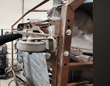

I am looking for information on the wall thickness for the 1 1/4" square tubes that I am planning to build my rotisserie out of. There seem to be many choices, and I don't want to use stock that is too thin (it will bend) or to thick ($$ steel = weight). I am planning to build rolling base with cage frames that I can add on (see image).
Thanks for the help and happy Labor DayAttached Image

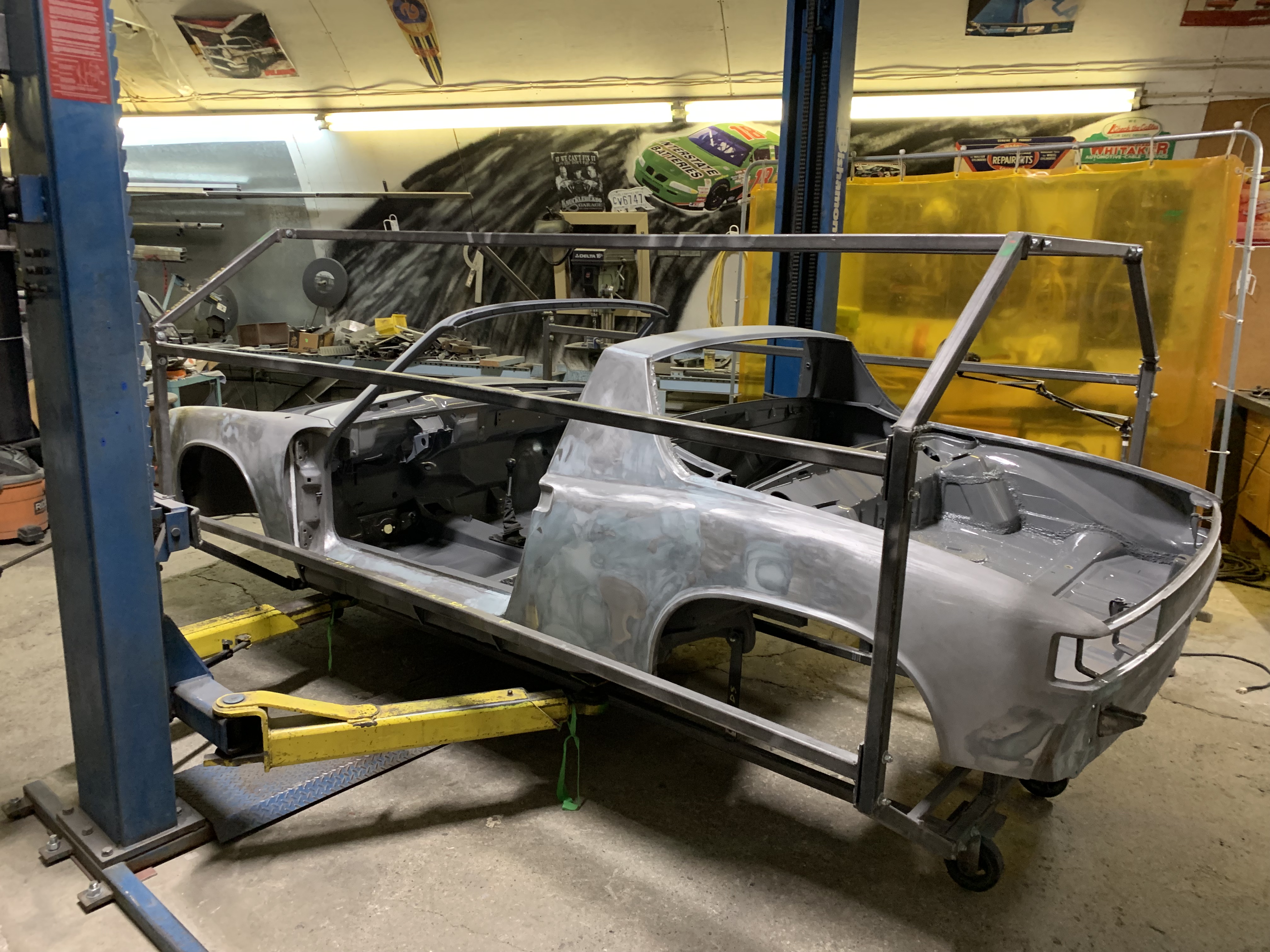

Yeah, that’s about right. I will highly recommend cleaning and priming everything before you start handling the metal. That Cosmoline stuff they put on it makes a mess. See post #75 on how I built rotisserie #2 for the LE. I used 1-1/2” tubing on my first one and it was too heavy to rotate to a 90 without 2 people. Going down to 1-1/4” tubing for the LE made things more manageable. It was plenty strong enough and I could rotate it by myself. Something to think about.
