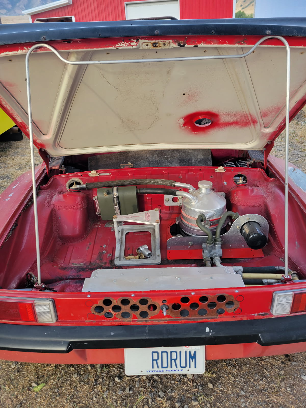

sixnotfour
post Oct 14 2026, 08:17 PM
Posts: 11,397
Joined: 12-September 04
Member No.: 2,744
Party in the Front ..Business in the Rear.. 964 0il sytem:beer1:
Maltese Falcon
post Oct 14 2026, 08:25 PM
Posts: 5,439
Joined: 14-September 04
From: Mulholland SoCal
Member No.: 2,755
QUOTE(sixnotfour @ Oct 14 2026, 07:17 PM) *
Party in the Front ..Business in the Rear.. (IMG:style_emoticons/default/beer.gif)
Totally dig the oil-fill access through the decklid ¡
(IMG:style_emoticons/default/marty914.jpg)
