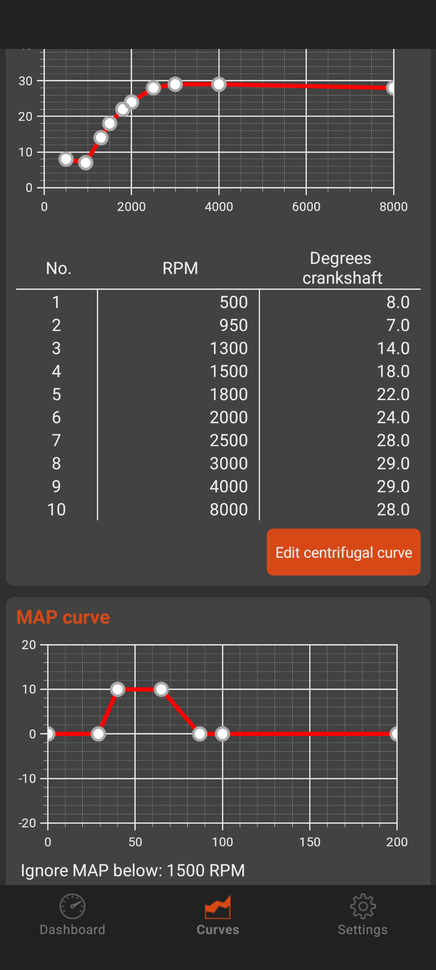

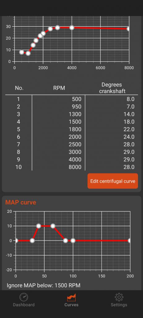

Yep. Even if you have low vacuum you can set the dizzy for the lvl that will trigger it and then how much advance you want. Here is what my curve and vacuum advance curve looks like (MAP curve). Since I have it hooked to ported vacuum it is a little silly but I may switch to plenum vacuum at some point to see if it's worth tweaking. There is also a cutoff rpm for the vacuum advance where under that it doesn't activate (default is 1500).
