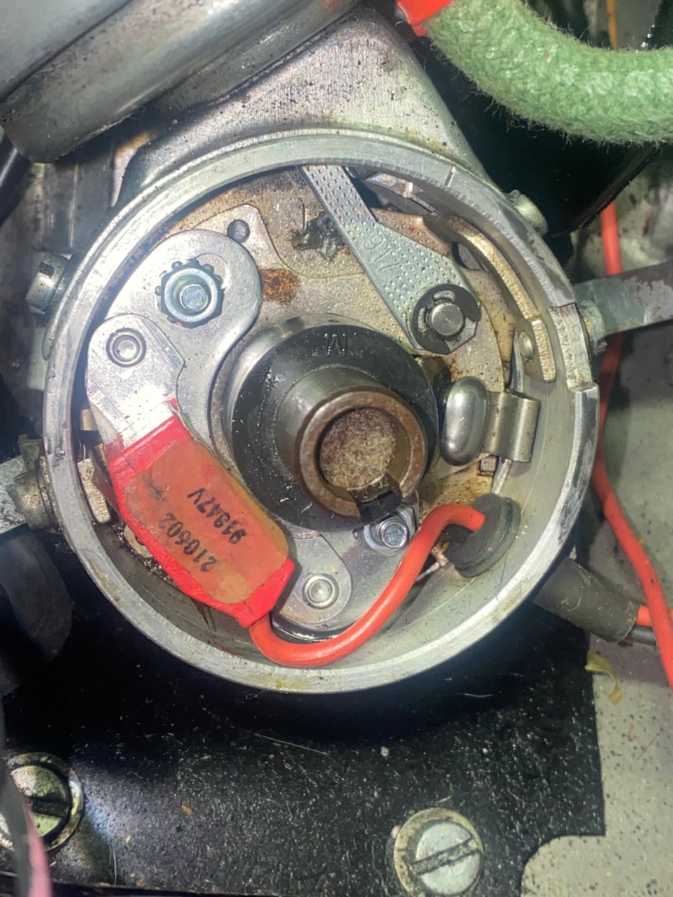

I did the “trick” which I remember from my VW days and that does work. Got a vacuum gauge thing to see what the pressure is, just need to figure out how to measure it correctly. If I use a bulb to produce the suction it will hold.
When I replaced the vacuum hoses I found that the place the hoses connect was actually loose on the distributor body. I tightened that up but if does not move smooth or easy really like I think it would.
The PO installed a Petronix. I notice the little ground wire is essentially gone. Does it not use one?

It could be the pertronix unit, as that is sending the 'ground' to the coil. However, those symptoms are not what you would get from mechanical issues from the distributor like a gummy advance.

Looks like a Petronius fault to me. They can be glitchy and typically effect the tach signal as you are seeing.
They are great when working but

That pertronix looks like it's worth a little double-checking of the set up gap. I'd also peel that sticker off the top of it - don't need that floating around in there.
