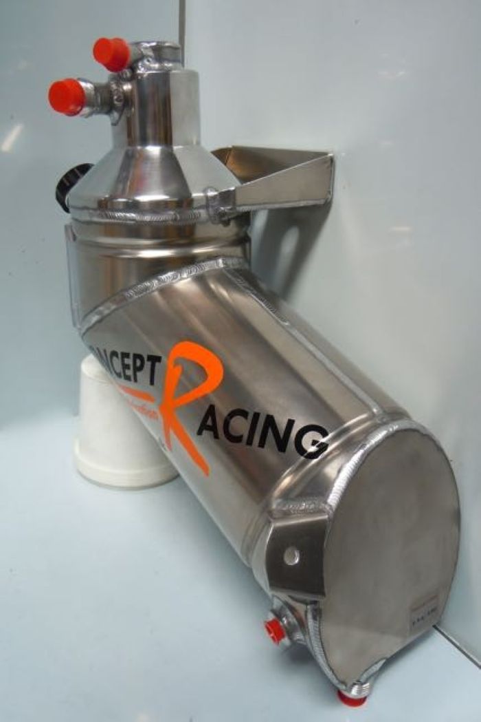

It is for a 4 cylinder type 4. I have been thinking about a dry sump for Howard and he is moving along now. Soon I will be in the engine, so now is the time to see if it is possible to get what I would need.
I saw a used FUBAR 914-6 oil tank for 1000.00, with my budget that is not possible. Or anywhere near it. But with a set of plans I could make a tank without the filter console just a tank with fittings for oil lines and a filler neck. Thanks

Or reach out to me and see if I might be willing to sell it in kit form? I have a few not built up and a few that are 75% done that I can sell much cheaper. Let’s talk about your budget. I want to move on from these. I will not be making anymore once they are gone

I built one to stock dimensions
Remote oil filter was easier
I could loan you the card board templates but want them back when your done.
Pictures in a little bit later today
Do you tig?
I went aluminum for corrosion properties

Yea, it’s a tight fit in there. Making it just a bit off would be super frustrating. Ben has already spent the time and money. I think you will benefit over diy.

I did this. Used the money to buy a TIG instead. Bought aluminum sheet and pounded out tank halves using the plans made available by Porsche. I don’t remember the links, but they are out there. I retrospect, it was a lot of work and worry, but also satisfying. And I can TIG.
