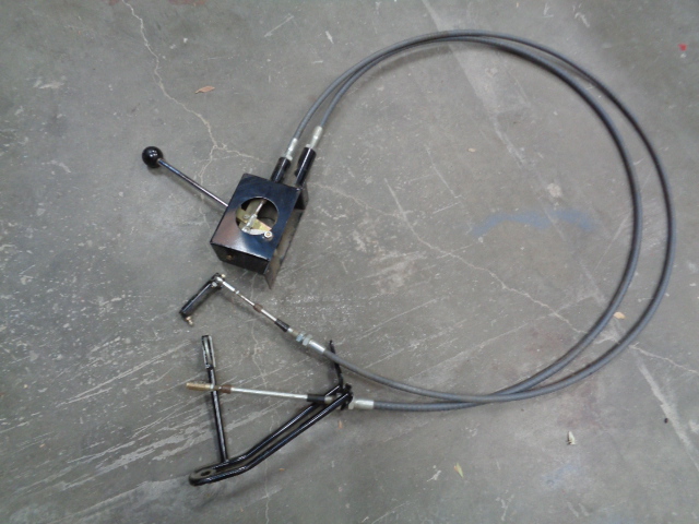

Many moons ago i helped Brad adding a custom cable shift solution to a 915 in a 914.
It worked surprisingly well and costs a fraction of the side-shift kits available.
I have a 915 that was meant to go with the 3.6L engine but i never got around using it.
The plan was to do the same thing and go cable shift.
Weird to think that there are maybe only a handful of us that know who you mean when you say you helped “Brad.” (IMG:style_emoticons/default/rolleyes.gif)
Our plan (Mark) was a cable shifter set up. Glad to hear it worked well.
Cable shift is still in business, but I don’t know if anyone still makes the rear mount for a 914.
https://cableshift.com/product/ols/products/porsche-930
I noticed PMS also sells the cable shifters. Curious if they sell the rear mount.
To the best of my knowledge, PMS stopped selling the cable shift for the 915 conversion cars. Years ago I bought one new from a pelican member. Tried it out on a test stand. It was a joke. Sold it. There’s a reason nobody uses them. If anyone here has a working example, I’ll be shocked and surprised.

I had the cable shifter and a PMS tubular transmission mount. It wasn’t even close to working so I ditched it all.

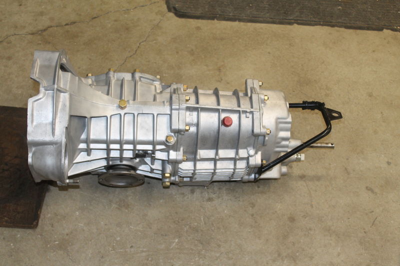

Jaide Car Co. or very early Rengade also had an adapter mechanism which attached to the tail shifter of the 915 transaxle. I discovered it in my shop racks the other day while re-arranging shop stuff.
Picture coming in a day or two.
Looks like when installed, the mechanism would sit 10" past the license plate (IMG:style_emoticons/default/blink.gif)

Jade Car Co. or very early Rengade also had an adapter mechanism which attached to the tail shifter of the 915 transaxle. I discovered it in my shop racks the other day while re-arranging shop stuff.

QUOTE(mepstein @ Oct 25 2026, 09:17 AM) *
QUOTE(Maltese Falcon @ Oct 25 2026, 10:42 AM) *
(IMG:style_emoticons/default/marty914.jpg)
That was another challenge with the cable shift. I didn’t really want independent mufflers.
The Martin Bott kit is really pricey but if you want the equivalent of a 914 side shift trans, it’s really the best way to go.
I’m custom gearing both the 915 trans in my 67 and my 914. Peter Dawe told me it’s the best performance upgrade you can make on a car. We’ve done it on a couple customers cars and it’s true. It takes the whole driving experience to another level. It doesn’t sound like it should but having the right gear for every shift is amazing.
(IMG:style_emoticons/default/agree.gif) I had PMS go through my 916 trans, the previous two well known Porsche shops in so cal, could not figure it out. The car now shifts better than my 901 trans ever did. I just finished my second autocross with it. What a blast with the 3.6. But... I am curious if the Boxster S / Caymen S six speed kit would be a better option now for bigger motors.

QUOTE(Steve @ Oct 25 2026, 12:47 PM) *
