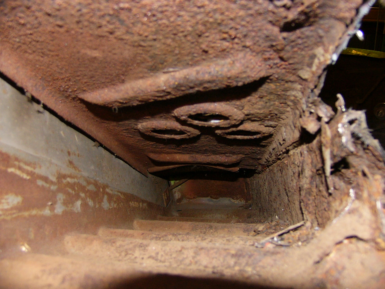

I started this thread:
http://www.914world.com/bbs2/index.php?act=...t=44014&hl=long
so everyone interested could take a look at the deconstruction of a shoddily repaired 914, and what the rust patterns look like in the spots you can't see. The stiffener kits are great, but where there is obvious rust, I can guess it's like an iceberg...you can't see the other 90%
I m using the RD stuff, but I also built some pieces much like the Brad siffener, which is going on the cockpit side of the long.
Good luck!
Pat
