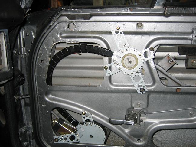

So I took Scott's advise and shimmed my assembly. It made everything so shallow that I had to notch my door to make the assembly fit flush. Of course I took pics for ya'll.

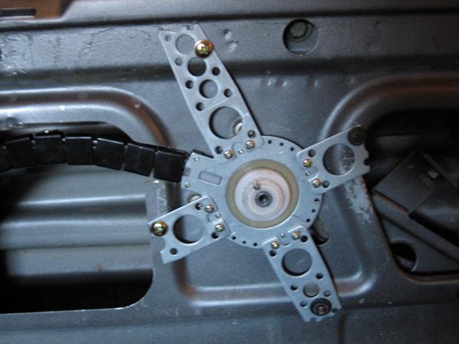

Close up (a little blurry). I kinda over did it on the reinforcement, but it looks nice (IMG:http://www.914world.com/bbs2/html/emoticons/wink.gif)

Great news and enlightening finds today. I jumpered the motor on the pass side and it worked perfectly. It was just as fast as it should be. The fascinating thing was that when I tested the drivers side it moved much slower (due to it being mounted a bit differently which will be addressed later). I can take video of the window working, but I have no place to host it (and no interest in starting such). If some one want so to host it, I can shoot it maybe tomarrow.
