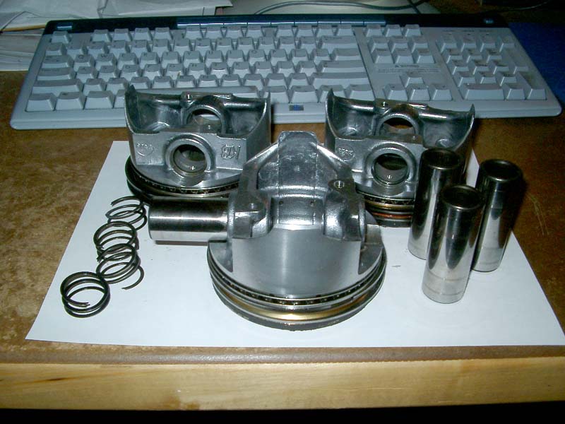

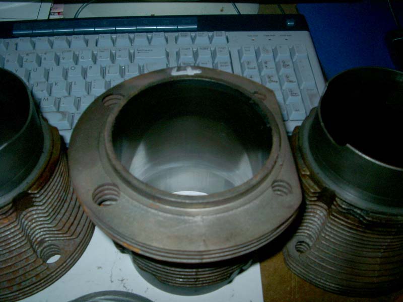

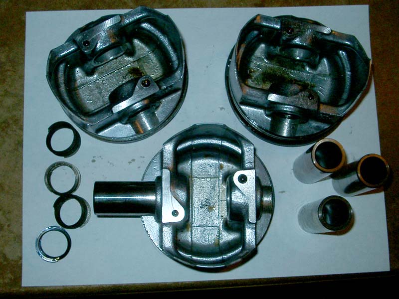

to clear up some of the confusion, i got 4 good 96mm cylinders and 3 (three) good 96mm KB pistons.
pistons and cylinders used to run together, so i know for a fact those 3 will fit the cylinders.
all mike needs is a 4th piston to match the rest and he's good to go.
(IMG:style_emoticons/default/smash.gif) Andy

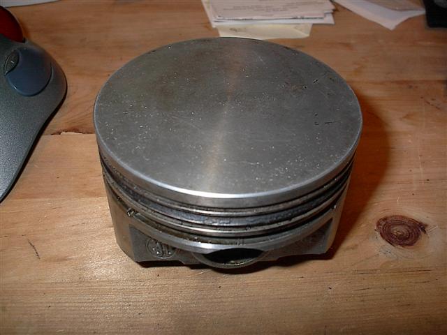

Looks like you'll be good to go. Here's a pic to tide you over til it makes it's way to the left coast:
I'll add in a couple extra wrist pin clips, just in case.
Andy - what are the cylinder's from? I ran into a problem with the jugs that came w/the KB's but that was prob b/c I ran the temps too high. This most recent time around I had Rimco bore out a set of stock 94mm's to match the KB's BUT as long as the skirt clearance is within spec (0.0025 per Jake) they'll be golden!

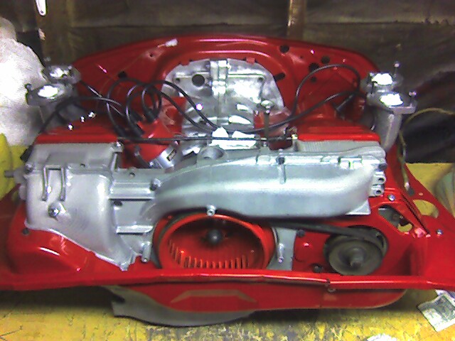

Here's a gratuitous pic of "this most recent time around"... I just put the mag & tin on today....
