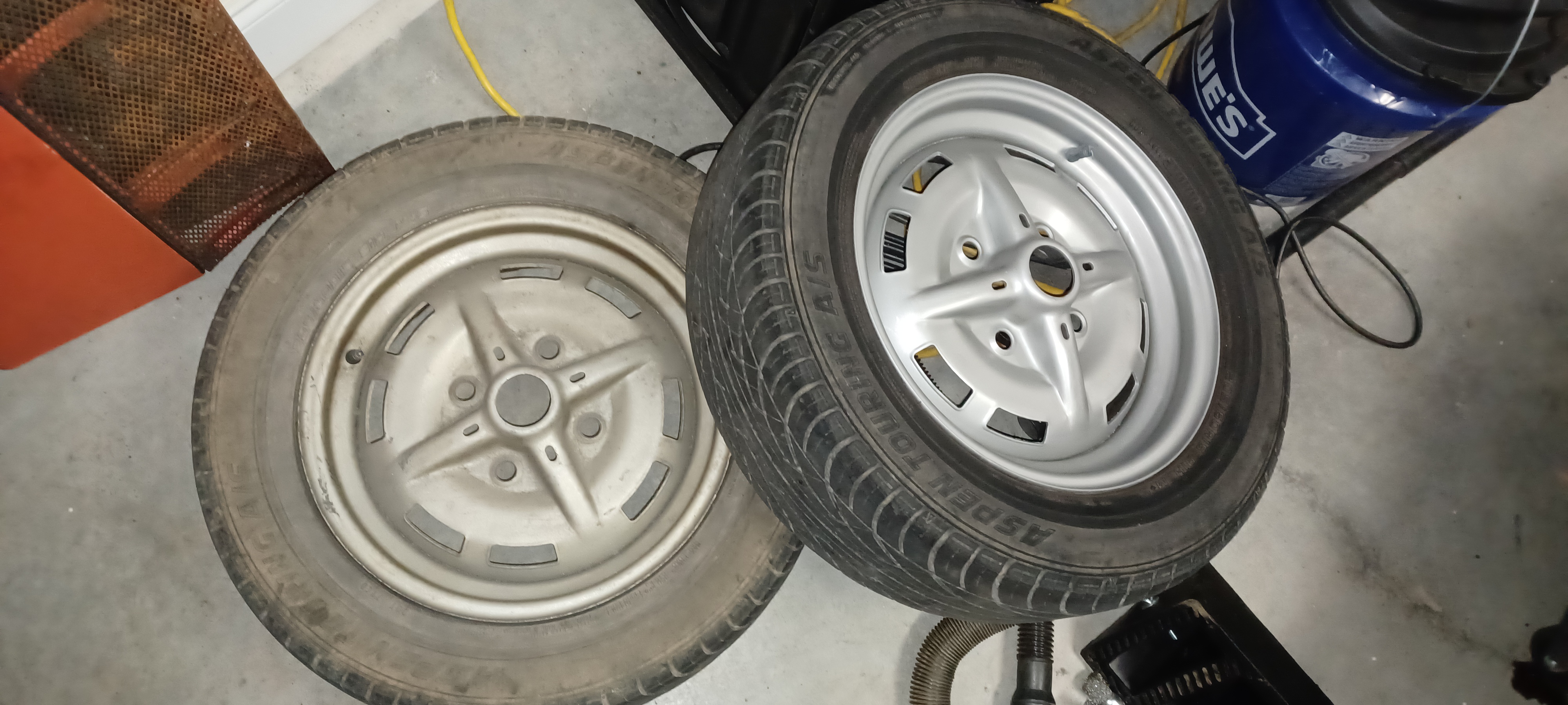

I may have stumbled onto a decent facsimile of white alloy / argent silver rattle can paint. I used Glidden Shining Armor Satin spray paint that I picked up at Home Depot. I'm going for a 10 footer kind of paint job on these wheels while the my teener is under resto. I did a quick couple of passes with coarse and 0000 steel wool. One benefit is that this is a paint + primer and covers incredibly well. I've painted 3 wheels with 2 light coats and still have paint left in my first can.
Here's a before and after shot.

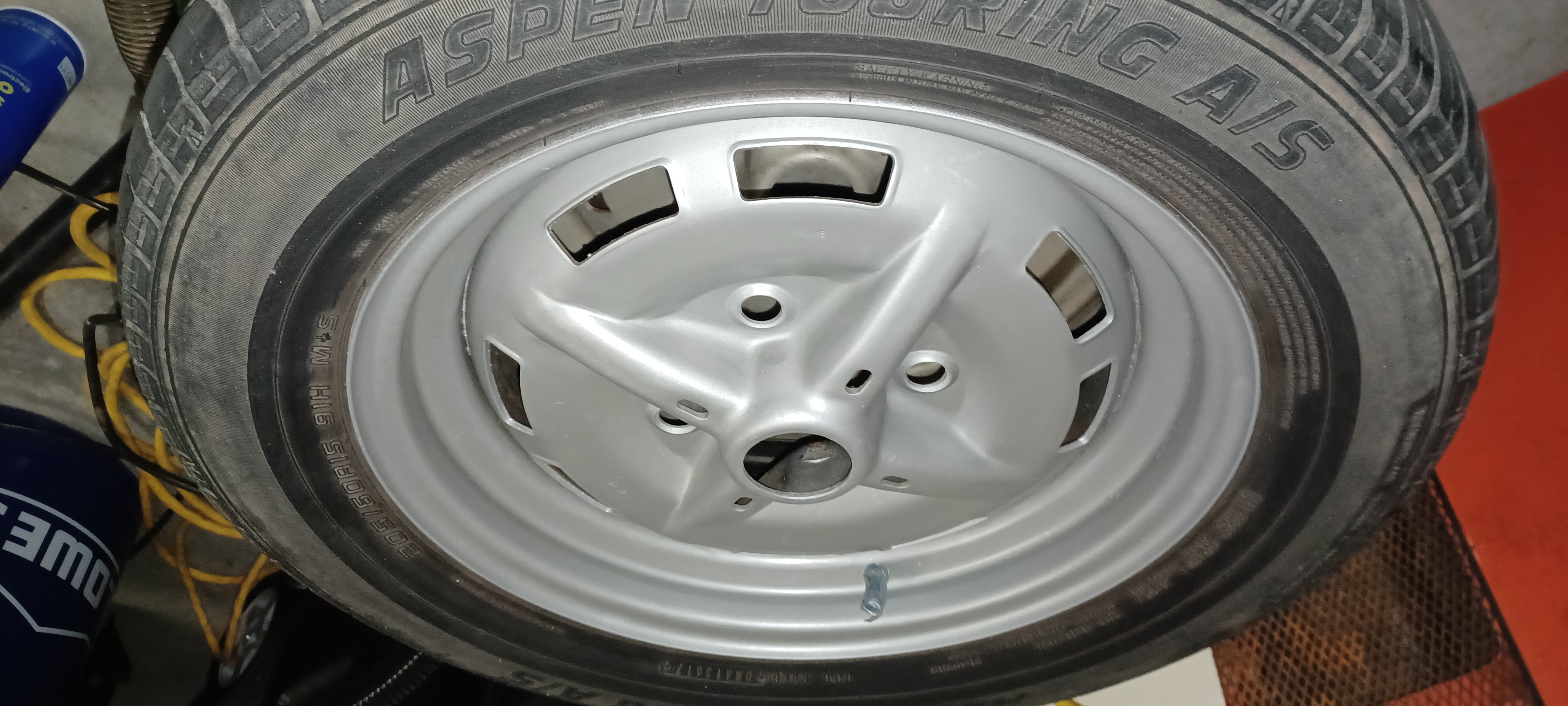

Another one...

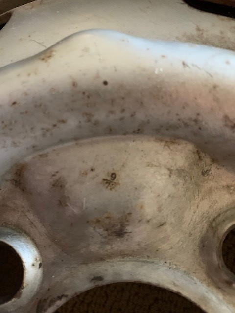

In the past I've read through this thread (and others) and it appeared to me that the 74 steel wheels (which were often discussed as having dark grey centres and black barrels) may have received a different treatment than the 73 steel wheels in some respects. Below are some data for 73 steel wheels.
I believe the wheels that came with my car are the originals. The chassis went into production in August of 72 and the wheels are stamped September of 72. I bought the car in May of 85 and not long after installed empis, so the original wheels show an appropriate amount of wear for 12 years of use and 40 years of indoor storage. Here's the date stamp on the wheel:

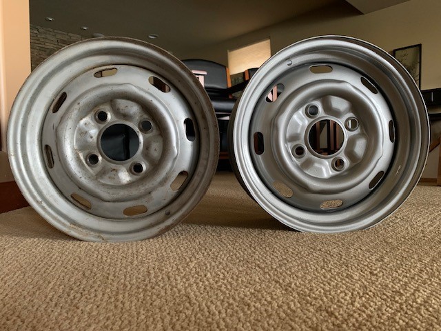

My wheels did not have dark grey paint in the centre and had silver (not black) barrels.

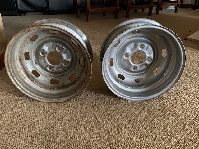

The wheel on the left is not refinished and is clearly silver:

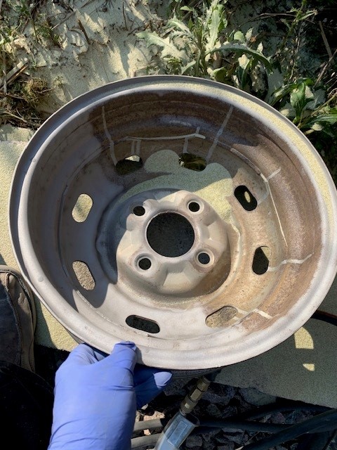

Upon blasting there is no evidence of repaint (multiple layers of finish). I suppose they could have been blasted and repainted back in the day but, given the way that the rest of the car was treated in its first 12 years, I highly doubt it:

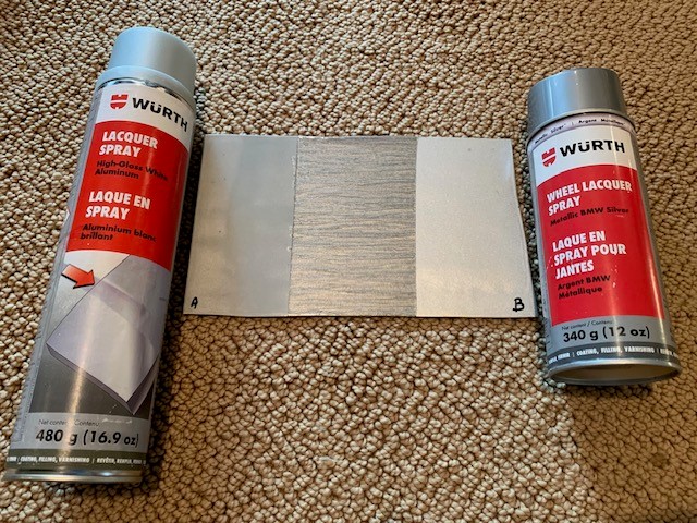

In an attempt to get the colour correct, I did some testing of different colours that have been mentioned:

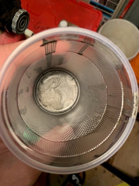

The Wurth wheel paint on the right is labelled as BMW and it's a good match for modern BMW wheels but is not even close to the original 914 finish. The Wurth White Aluminum (on the left) is closer because it's darker but it's not as dark as the original finish. The centre colour is brushed on (badly) RAL 9007 as mentioned in this thread. There is black in it and it needs to be atomized to appear even, so brushing on a test piece didn't give an accurate representation. But it's evident that the black in it makes it darker. Here's a pic of the RAL 9007 in a cup and it's visible how the black stays largely separated even after stirring.

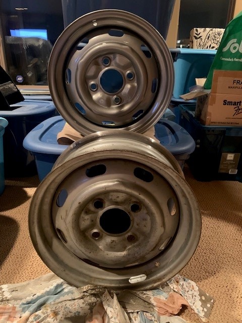

I sprayed the RAL 9007 on the wheel and it came out very nice. When comparing to the original finish in some lights it looks lighter:
In some lights it looks darker:
That suggests to me that it is probably a good match to original (bearing in mind that the original is now nearly 52 years old and assuming that my wheels had the original finish).

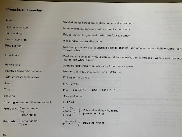

Also, as another related datum point, the 73 manual says that the original wheel was 5.5Jx15 with 165/15 tires (SR for 1.7; HR for 2.0):
