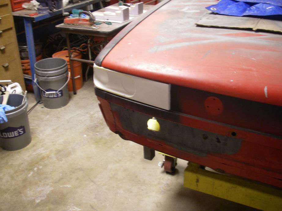

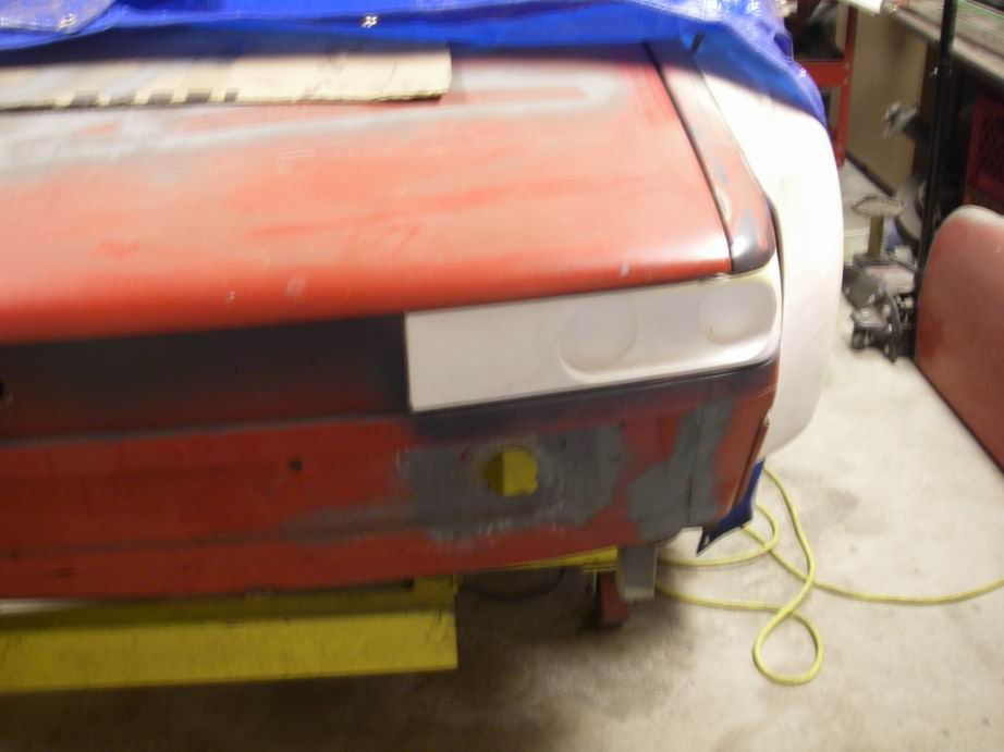

Lookin good, I'm excited to see your lighting solution.

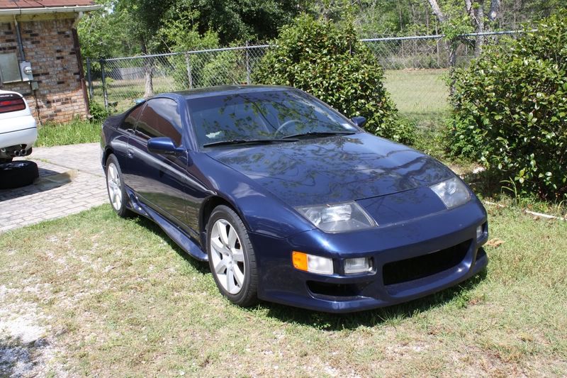

QUOTE(Jeff Hail @ May 6 2011, 10:05 PM) *
If Lamborghini could get away with using 92 Nissan 300ZX headlamps on the Diablo I can do this easily. (bet you never knew that)
I had to see it to believe, wow!

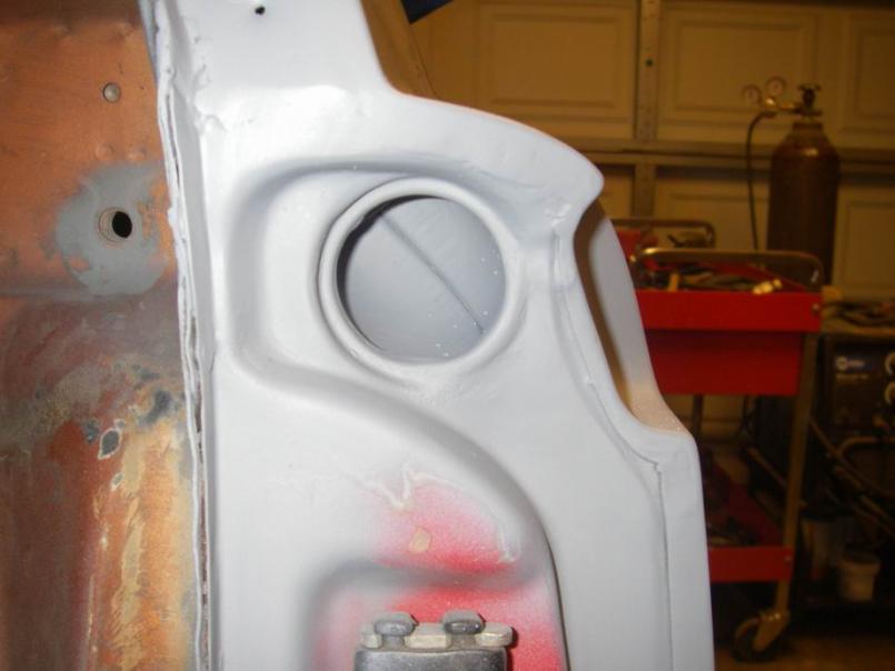

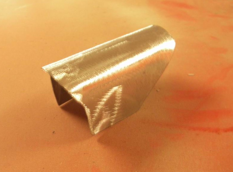

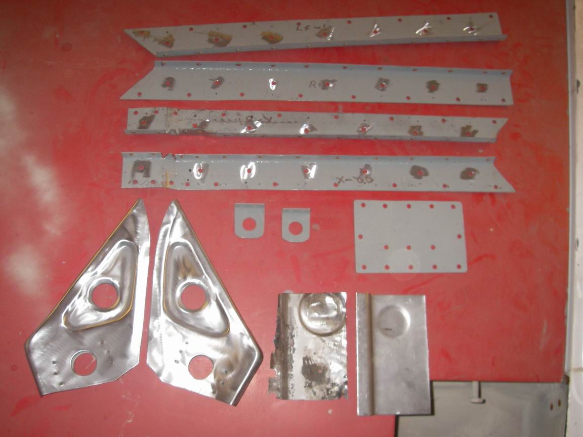

My neck and left shoulder are killing me. Can't keep a good fabricator down.
The tunnel braces for the throttle and clutch tubes are fab'd and installed. Sorry no pics.. Ooops.
Fab'd some other parts. I hate buying stuff that can be made and love making stuff that can't be bought. Access to a 50 ton press is helpful.
Name those parts?
majkos
post Jun 3 2011, 07:07 AM
Post #564
Posts: 1,370
Joined: 29-February 04
From: Mile High 914
Member No.: 1,729
I LOVE the near "donut holes" shelf
(Don't know what to call 'em)
Better than original

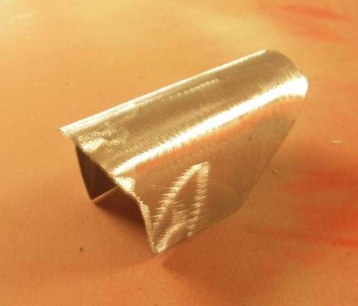

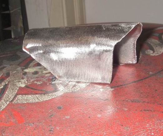

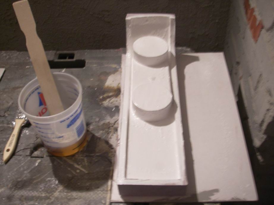

Guess that part? Hint: Qtr panel.

I guess no takers on: "Guess that part".

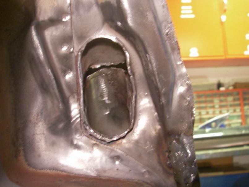

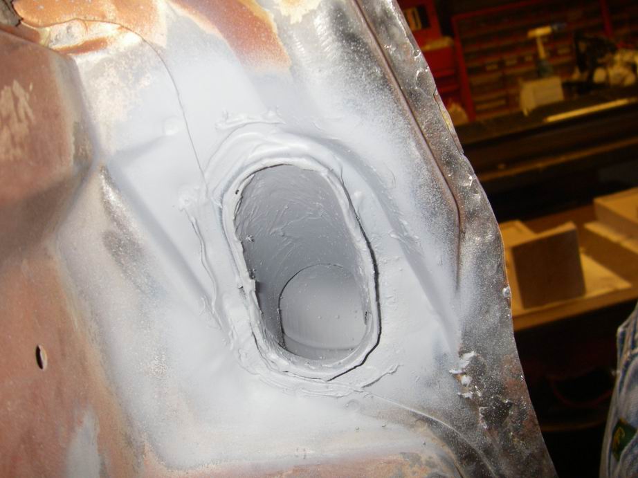

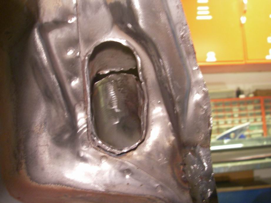

The prior owner had the left quarter panel replaced at one time. I assume this was done probably when the car was fairly new judging by the grey filler and some brazing. Space age microspheres (Dynalite used red hardner and the filler ends up pink) so I know its old old work.
Well the bodyman used an air chisel here and a Sawzall there. He cut right through the vent duct and never bothered to repair his fine error.
That weld you see at the lower rt corner of the photo is where I removed some brass at the pinch weld. I didn't like the way it looked.

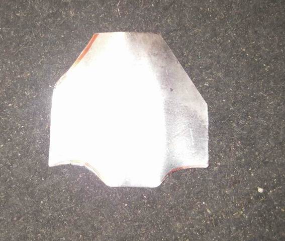

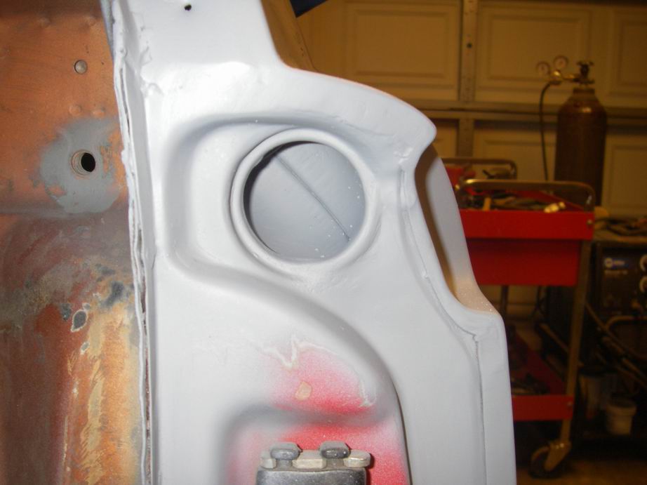

My conundrum was how to repair or replace it with the quarter panel still on the car? No room for tools up there.
So grind out the gash flat and fabricate a piece. Used a drum sander on an extension to get in there. Sand blast it bare.
Jeff Hail
post Jun 28 2011, 08:15 PM
Post #570
Posts: 1,141
Joined: 3-May 07
From: LA/ CA
Member No.: 7,712
The piece is then bonded with structural adhesive. First because I can't get a welder in there. Second I can't grind the welds down because its too confined. Third because the structural adhesive make sense for a repair of this type and it comes out clean.

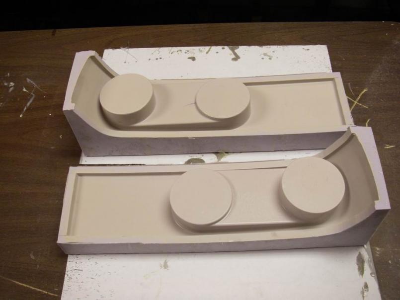

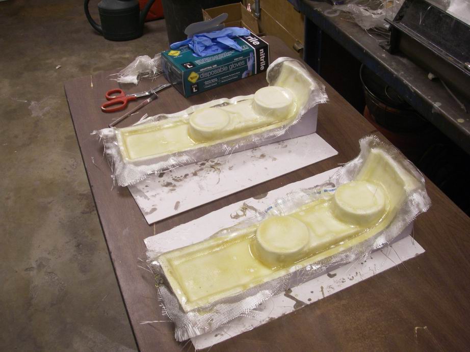

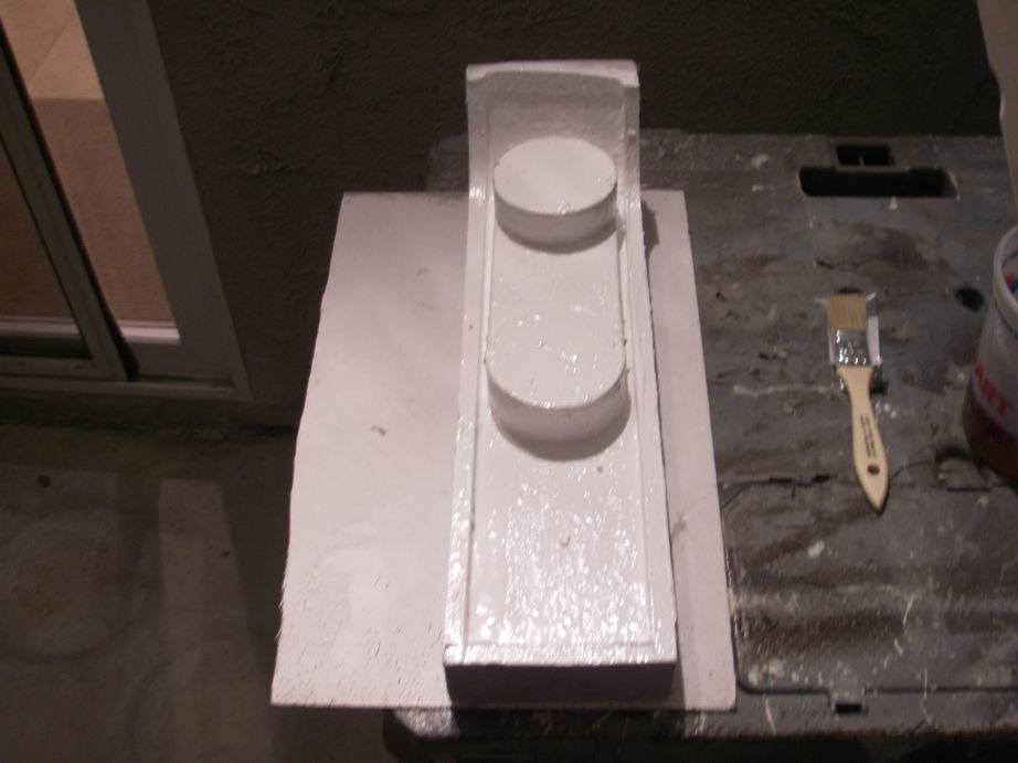

Lets play "Guess that part" again.
Jeff Hail

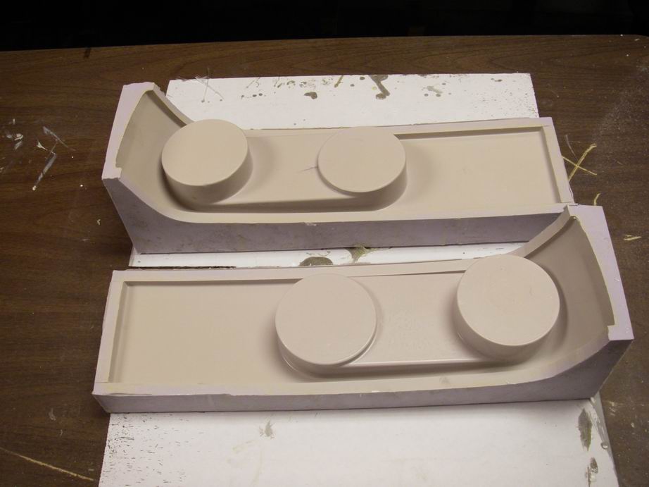

Hint !

No winners today.

Member No.: 7,712
Spare me the the mass PM's please. (IMG:style_emoticons/default/biggrin.gif)
These were a test run only for now. (IMG:style_emoticons/default/stirthepot.gif)
I will let you know when they are ready.

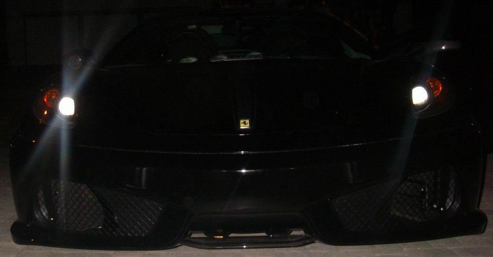

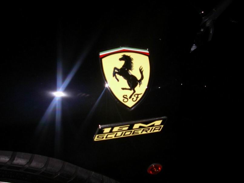

Sometimes life goes so fast.
post Sep 18 2011, 12:12 AM
Post #577
Posts: 10,798
Joined: 12-September 04
Member No.: 2,744
You know the movie quote "Italian trash"
Nice Ferrari.
