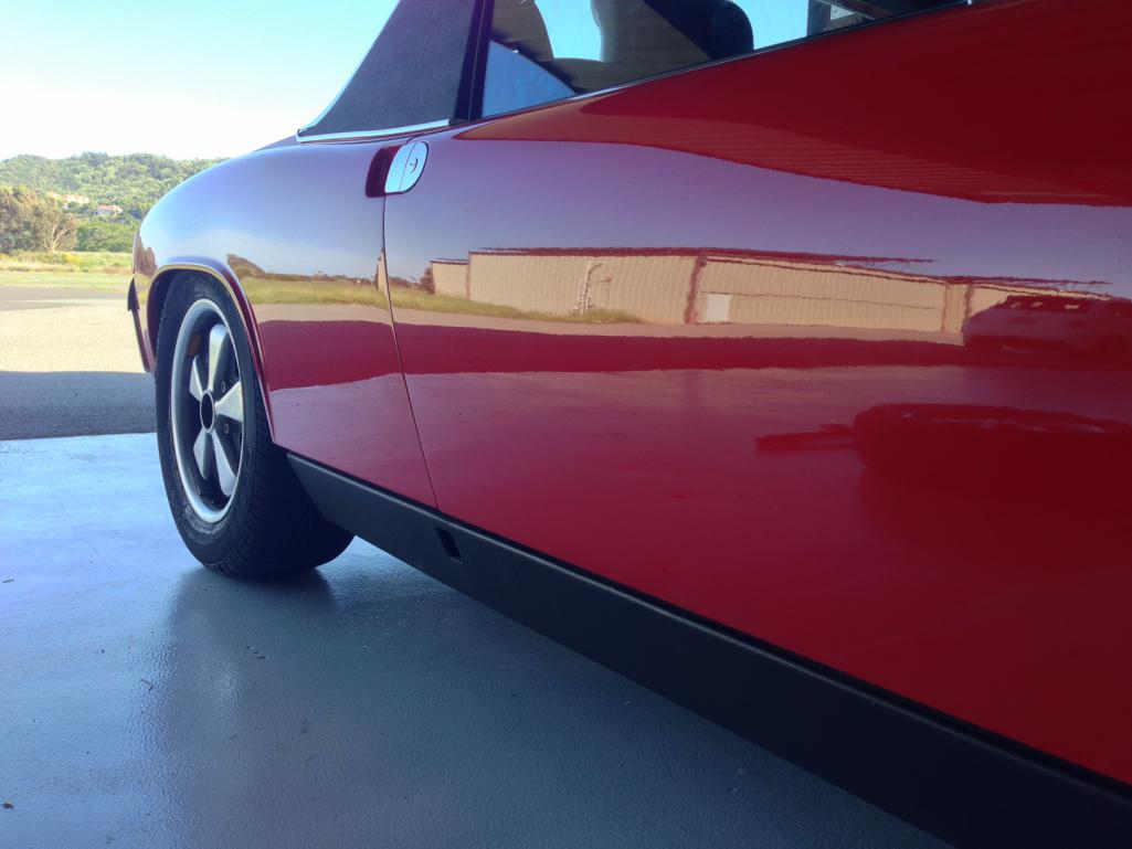

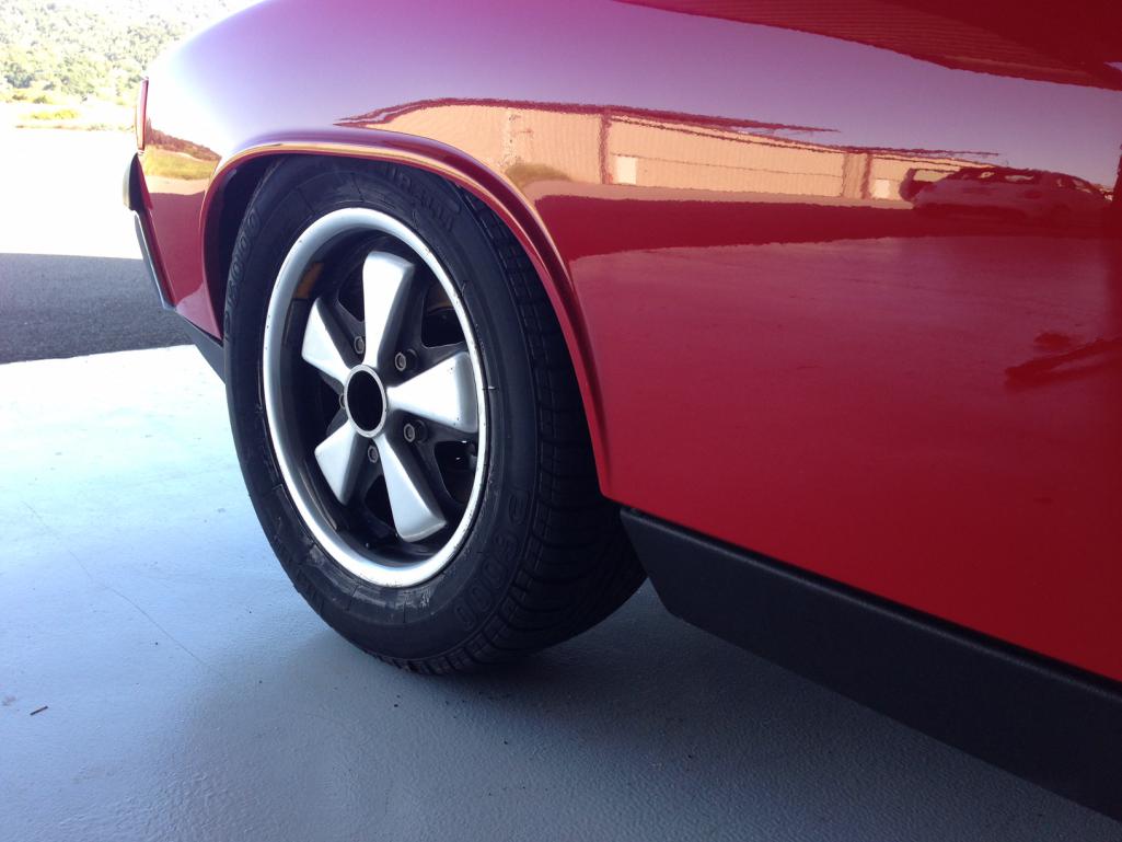

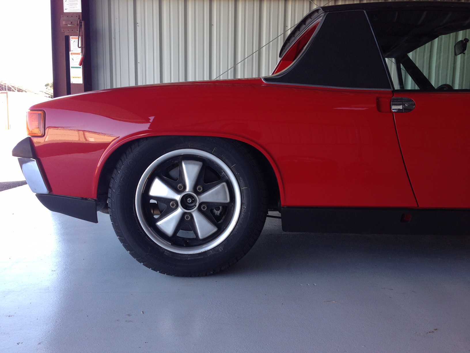

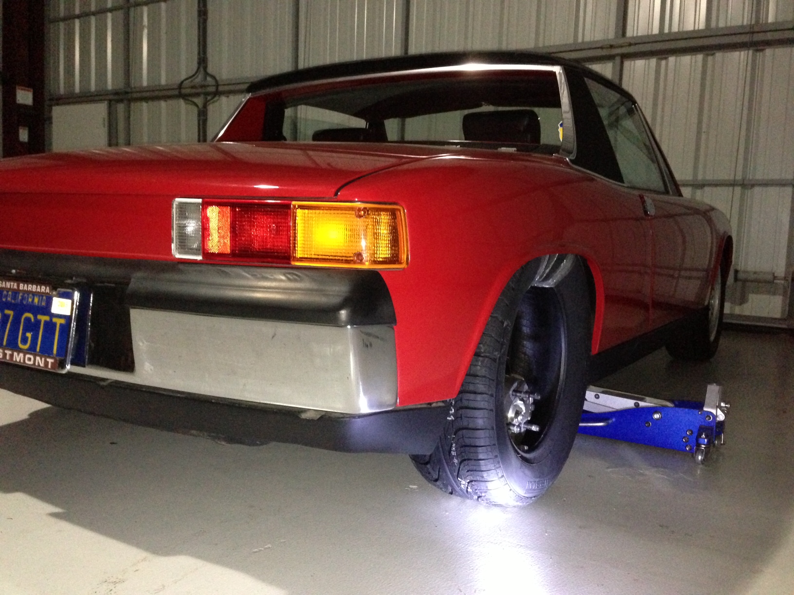

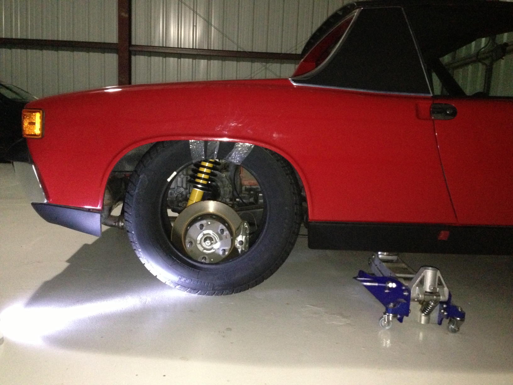

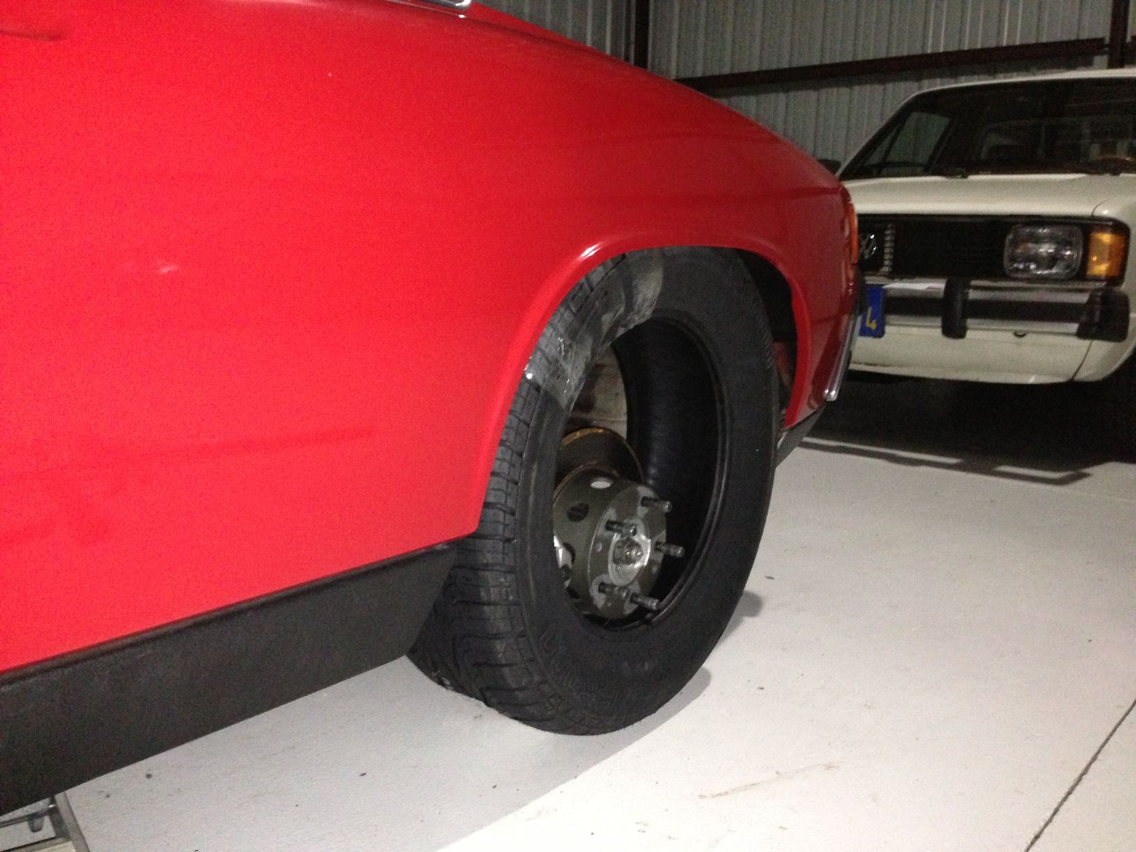

Next step is finalizing the wheel/tire package, then sending the car back into paint to have the sides redone. Test fit of 215/60R15 rears below, just to see if they would even physically fit in the wells. They will, though it is tight on both sides with the LR. It's a bit better on the RR, but I suspect I am going to have to play with the fenders just a bit.

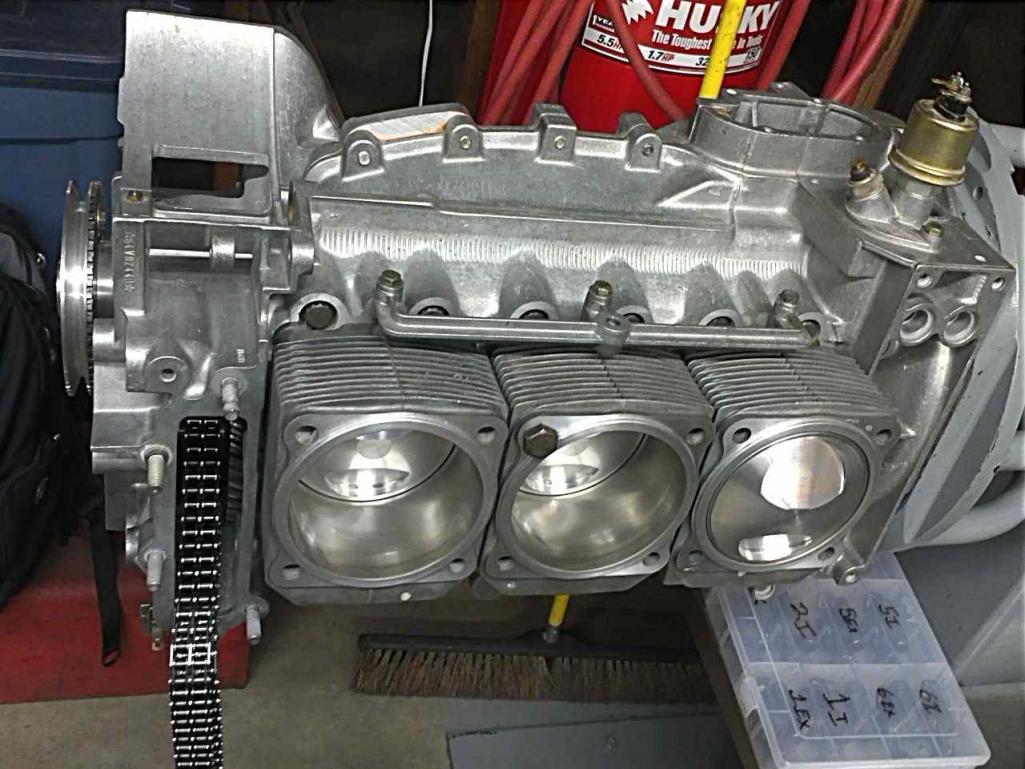

Good job. Looked back over the engine pictures. What is this thing? It is obviously
not your engine

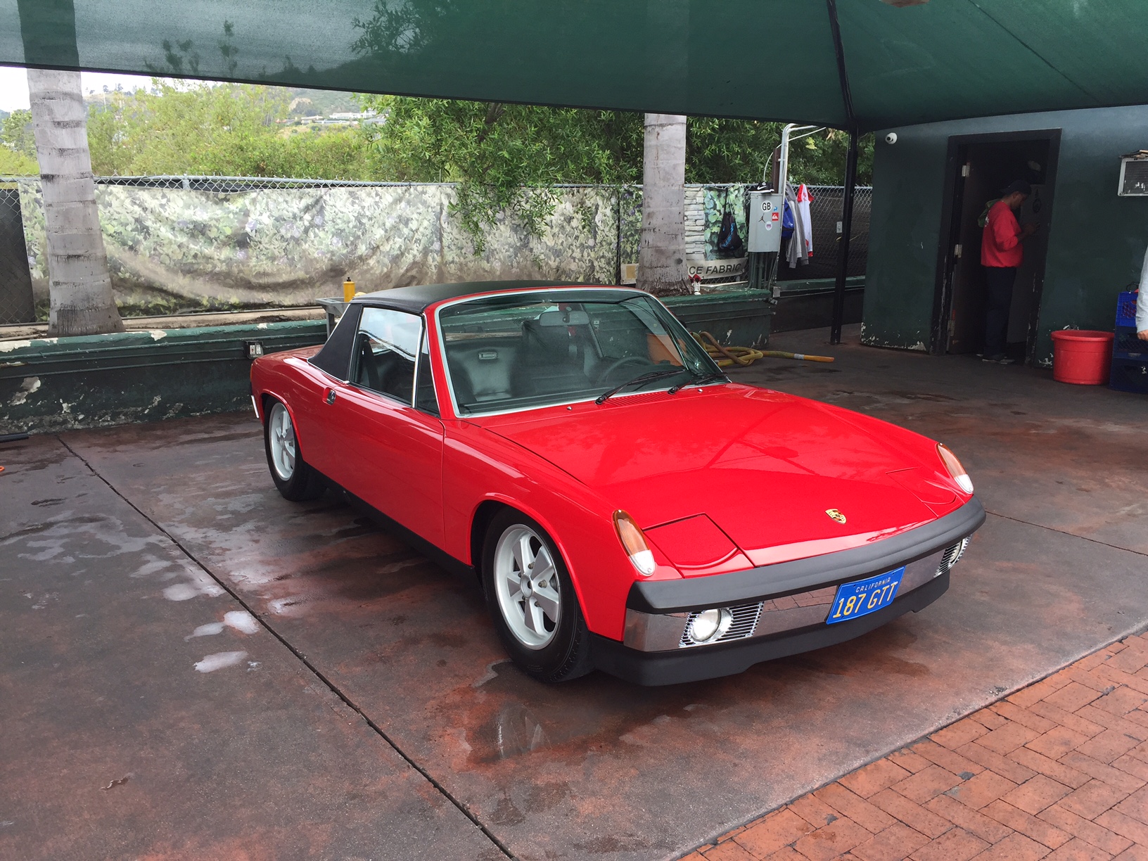

When it got down to LA, it got checked into the Malibu Car Wash, where a 914 looks a little funny next to some of the other iron (and carbon fiber) that is usually being cleaned, but the crew there did a GREAT job, and for a lot less than the detailers I use up in Northern California.

QUOTE(mskala @ Mar 27 2015, 04:25 AM) *
What is this thing?
Good question—was in the group of pics I got from the engine builder. Suspect that's one of his other builds.

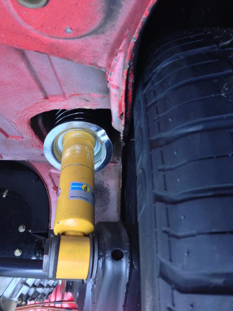

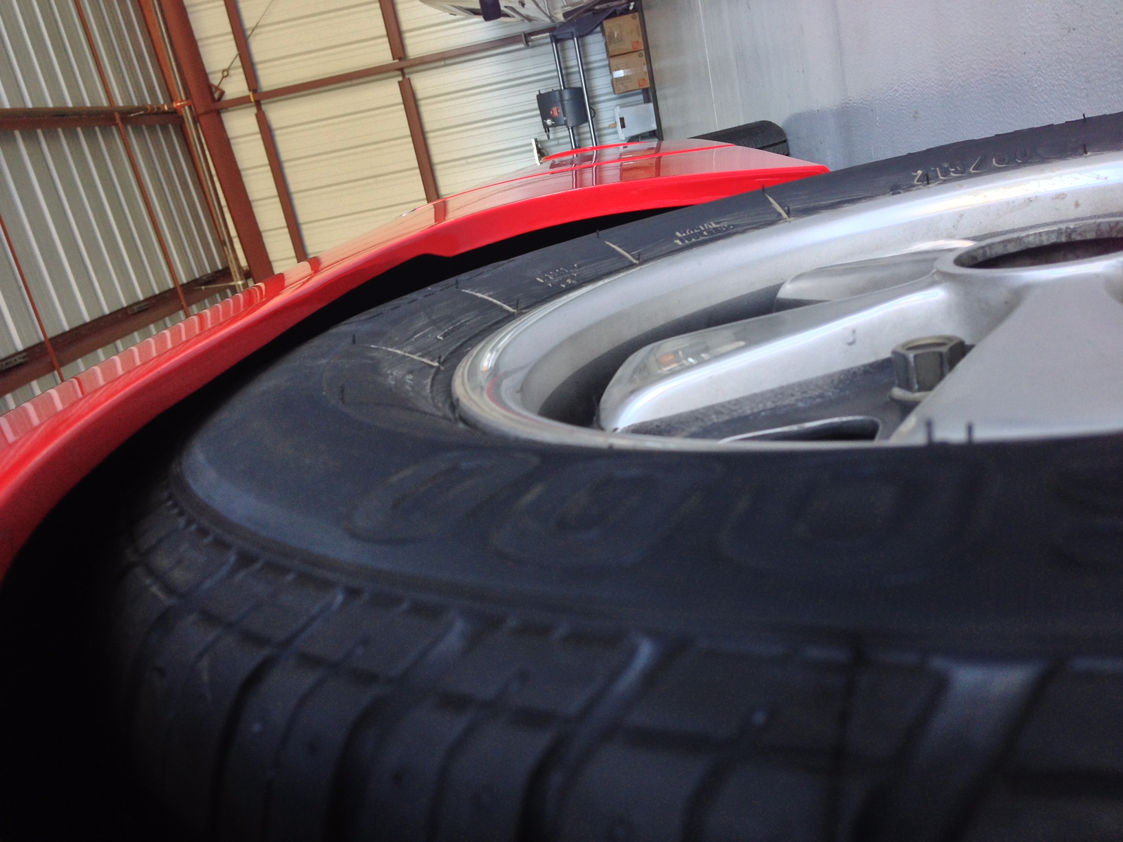

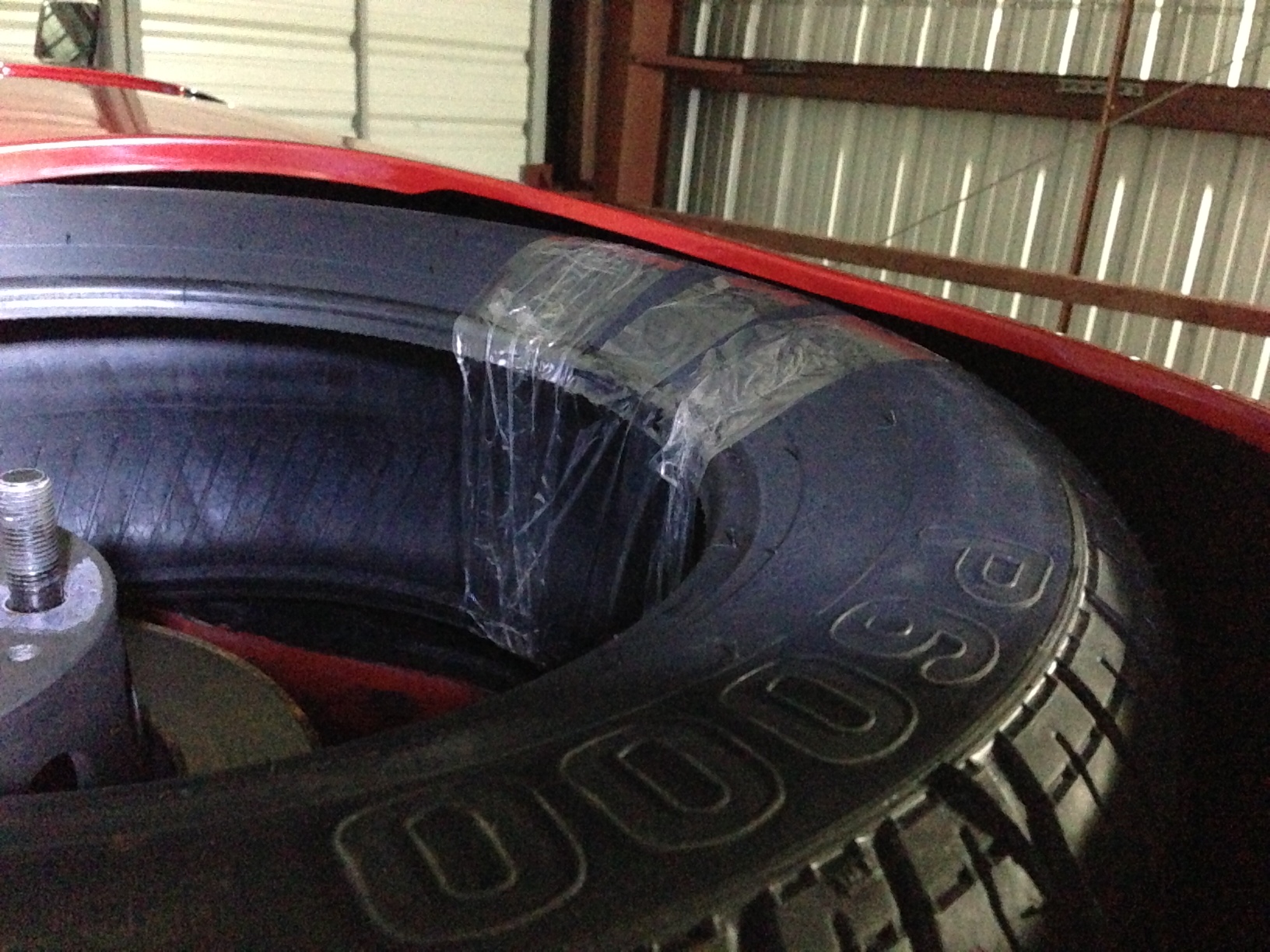

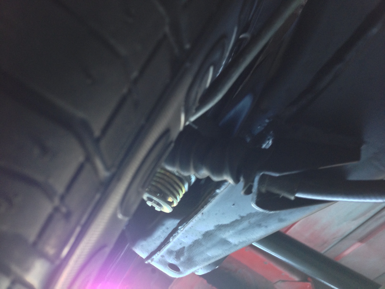

Btw, need to find then pics, but I eventually did mount that 215/60R15 to a real 15x7R to see if it could be snuck into the rear fenders.
Working with washers and longer studs, I was able to get it into both sides, but the inner tire was rubbing on the trailing arm and car brake line, and there was NO room for the tire to "walk" around under load. So I skipped and went to 185/70R15 Avons for now. I like them, but miss seeing fatter rubber tucked under the car. May move to something else. We'll see.

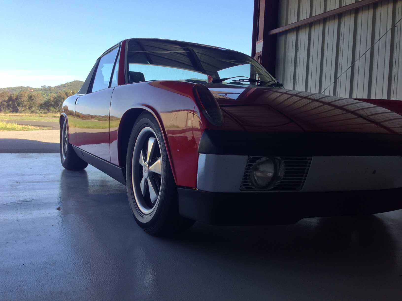

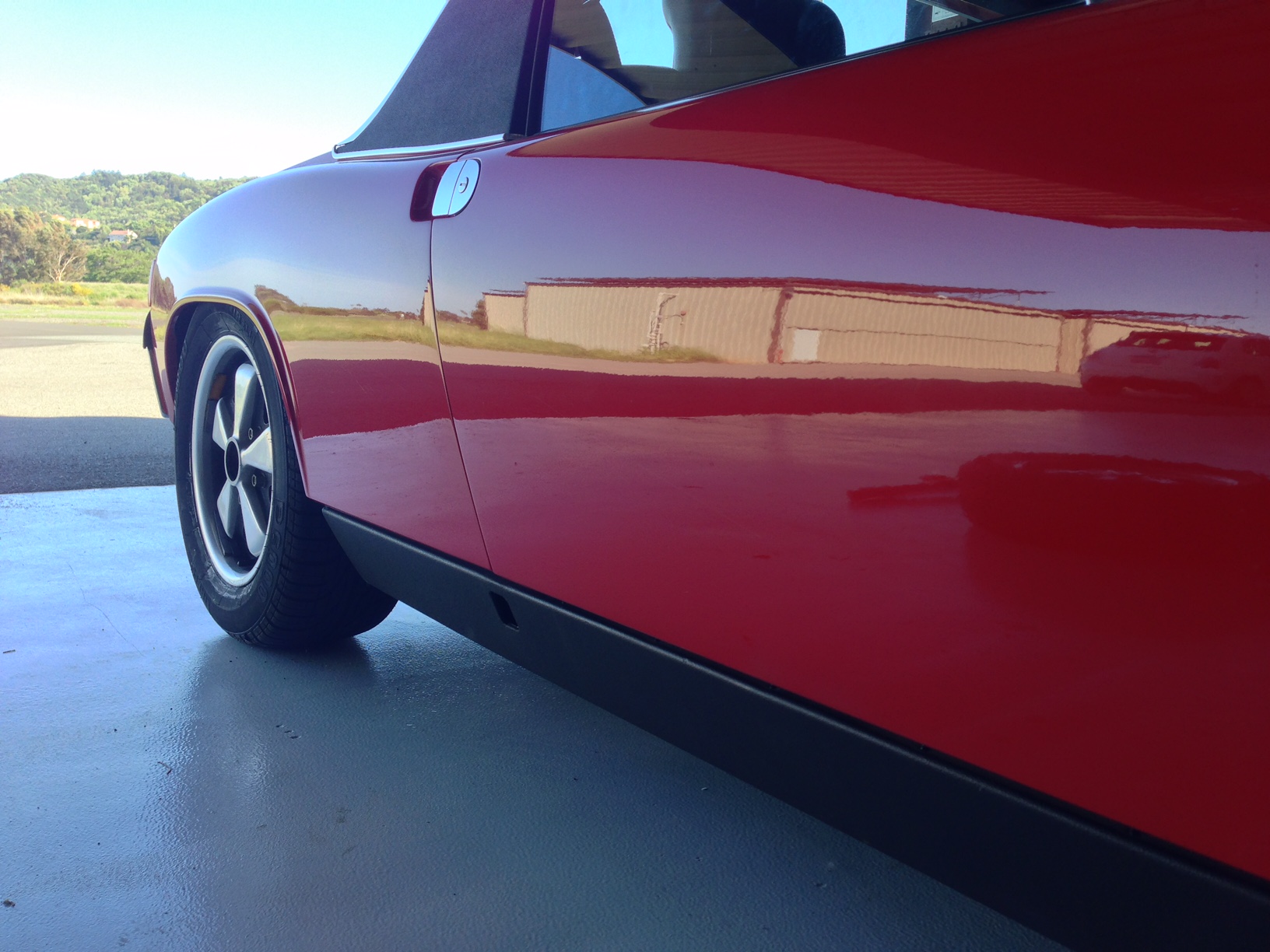

Here we go...
