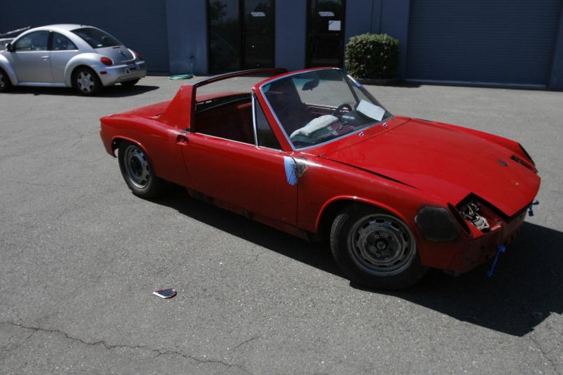

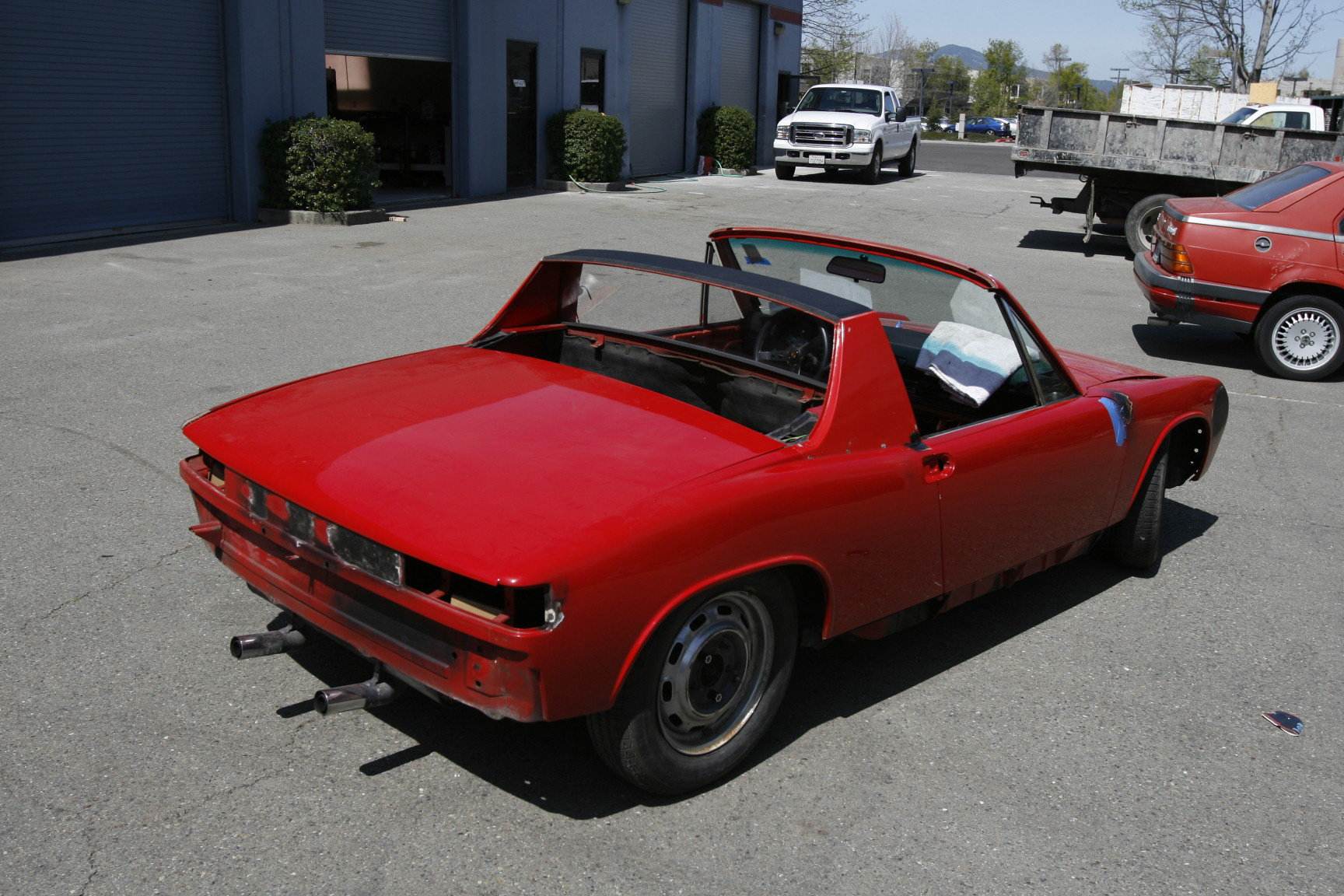

Another angle of hell...

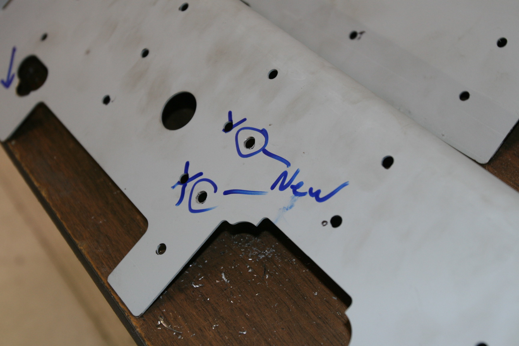

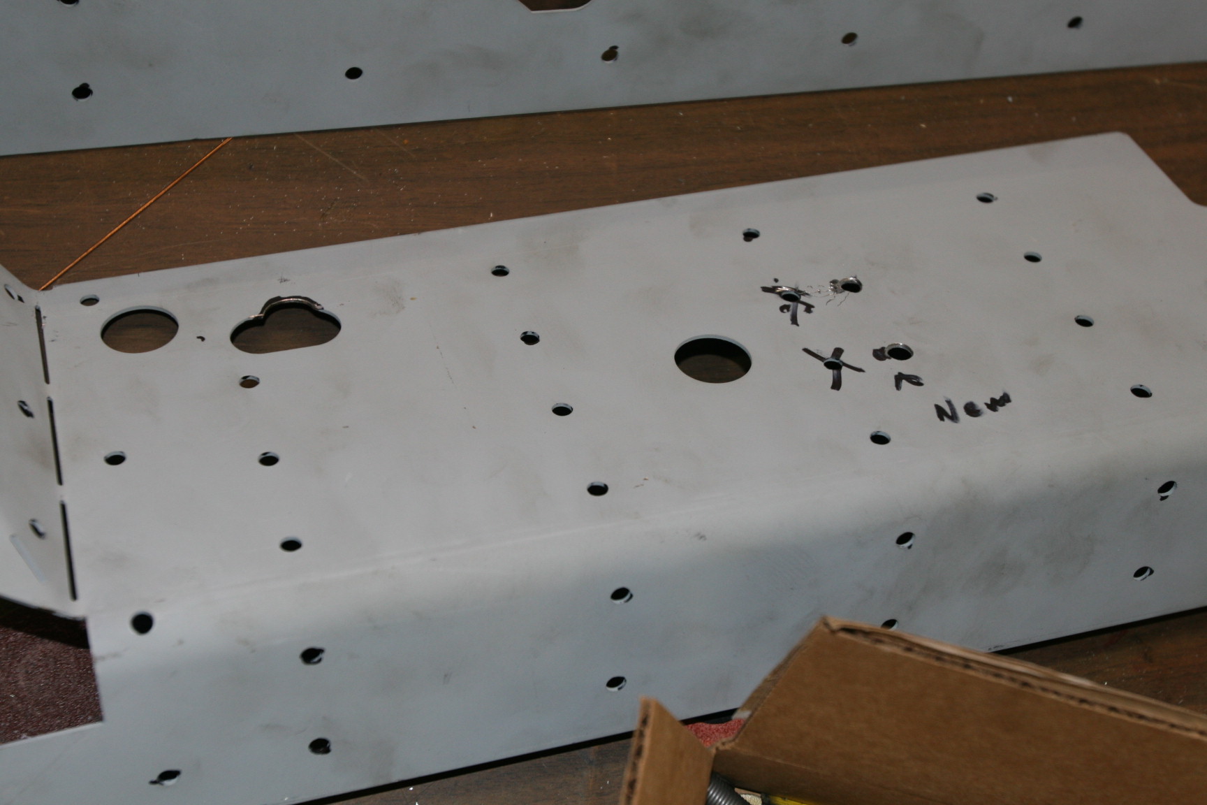

Engman kit preparations. Very nice kit. Some holes seemed to be in the wrong spots for my early '73...
Perhaps these pics will be helpful? (IMG:style_emoticons/default/confused24.gif)

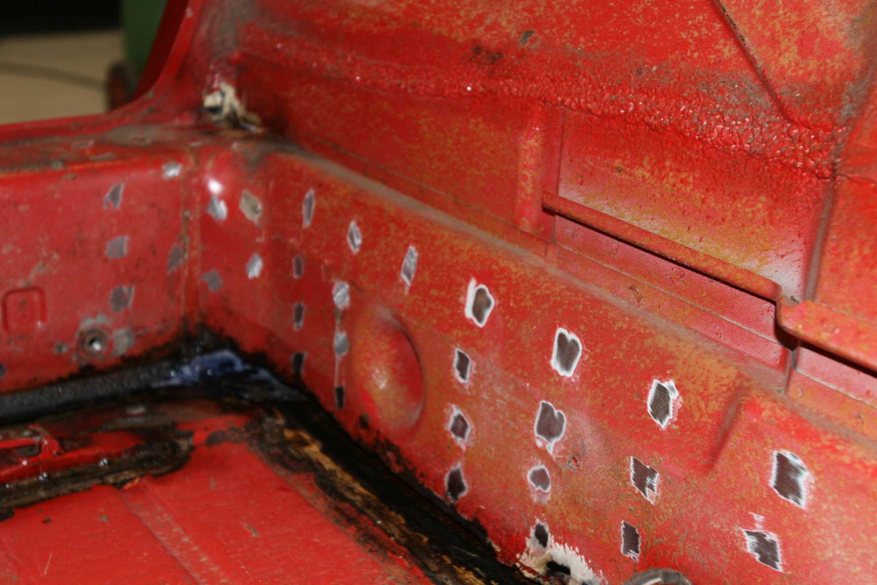

Another...

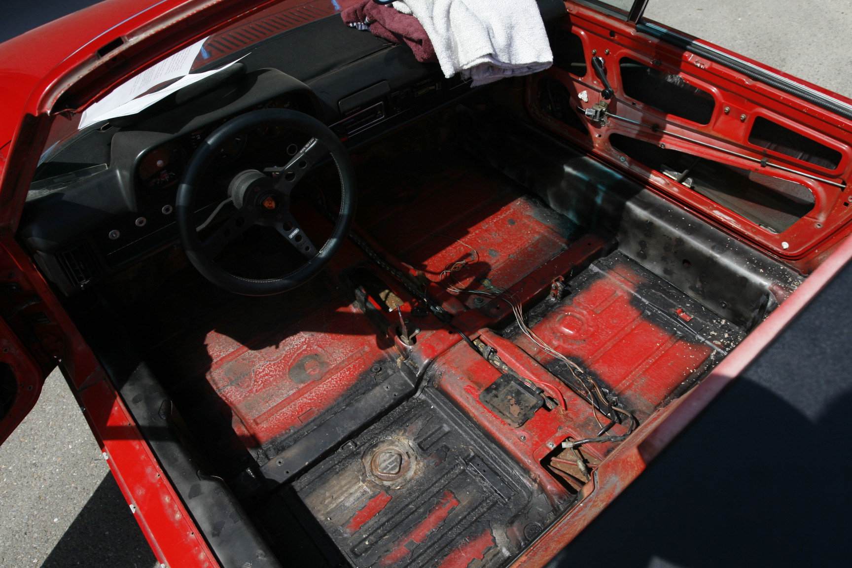

And one more... of the seatbelt bolt hole. Both had to be modified slightly.

After much discussion, reviews of all the installations detailed here on 914world and on 914club, reading the Engman instructions, and reading over PRS's directives, two race mechanics and I talked over how to actually install the kit -- with the car on the lift or on its wheels. Since you could watch the door gaps grow when you lifted the car on a *very* good lift, and because the gaps were good when the car was on its four wheels and there should not be any distorting if you follow everyone's advice, we decided to weld in the pieces with the car sitting on its suspension. To that end, I went back and got the car's real wheels, with four brand-new Vredesteins, bolted them up, and left for an anniversary weekend.
Imagine my horror when my welder told me he started to see the door gap close up on the passenger side as he started to plug weld the rossette holes -- following everyone's instructions and following his own experience and being cognizant of this potential problem. That's when he decided to finish the right side with the car on the lift, and do the same with the left side. The left came out GREAT when the car was back on its wheels, but the right side was a bit tight. You could still open and close the door, but it was a bit sticky. So, he jacked up the car at a carefully selected point along the longitudinal under the door, and then heated up the plug welds until we arrived at the right gap.
I'm not saying we got it "right," but it is one more data point in this ongoing saga of learning the best way to add the stiffening kit. And no idiots were working on this. Well, at least if you don't count this one...

Thank you for posting the pics! I always ask for feedback and am glad to see some. I knew the one hole was close to the dimple on the side that you redrilled – and I will relocate it in future production runs on both sides – Thanks! As to the location of the seat belt mounts – I purposely made it a slot as I have seen the front to back variance. Mc Mark is getting ready to do another install and hopefully he will tell me what he sees here. Based on your comments I will have to be more specific on the welding procedure to make sure that the welds are done in a manner to disperse the heat better.
