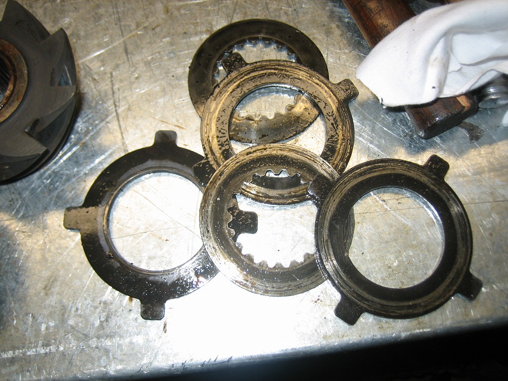

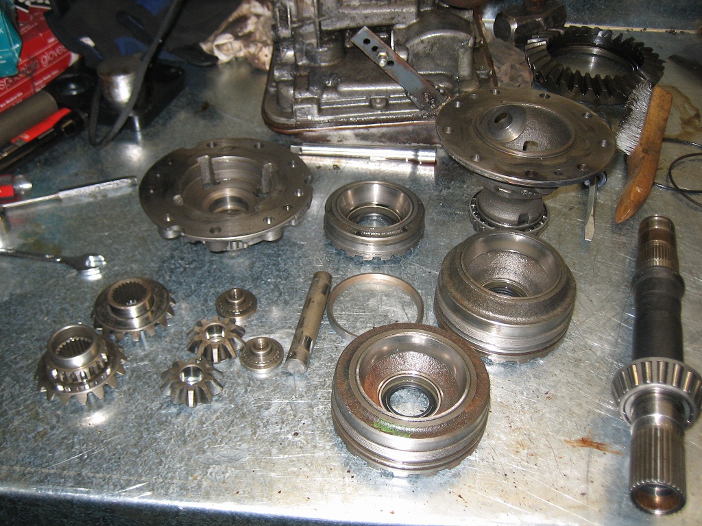

So, the diff is off and completely apart. That squeaking noise and lack of Posi was due to......drum roll please......the posi plates and disks being completely bare and scraping (IMG:style_emoticons/default/dry.gif) So, only $71 shipped to replace them. No biggie....but, while I am in there I thought I would source out a 3.27 R/P set to replace the 3.55 set I already have. Lower RPM by a smidge. I could easily get a 3.08 set, but that has the explicit warning of not using with lower HP engines (not an issue) and not in hilly areas (have that). 3.08 seems too low. 3.55 is actually fine so any small improvement would be cool. Price will tell.

More pics of the carnage. This is what the posi looks like disassembled. Well, the posi and the whole damn diff.

And the completely worn clutch disks and plates.

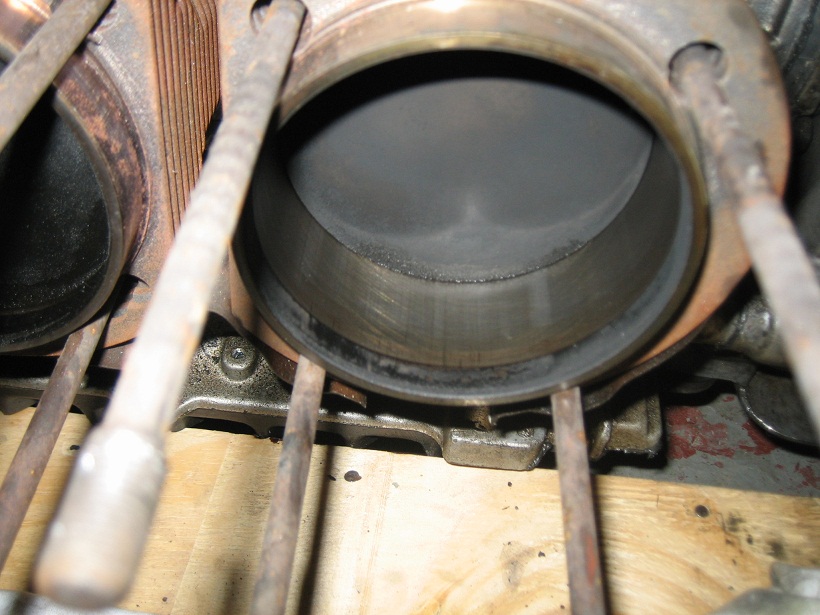

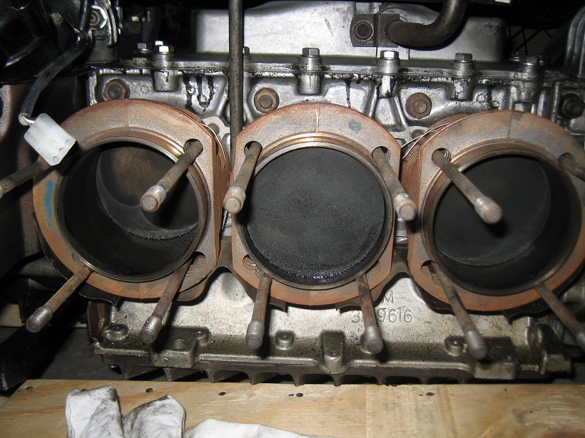

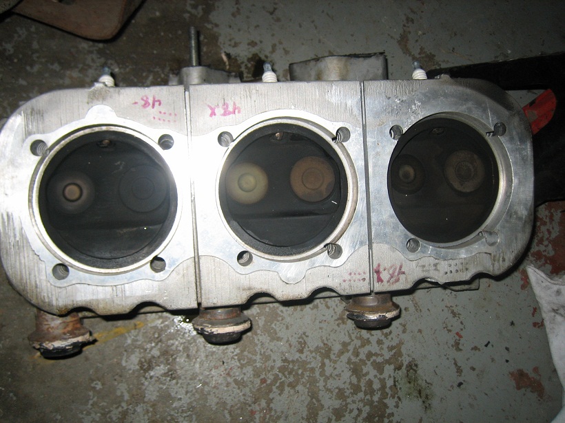

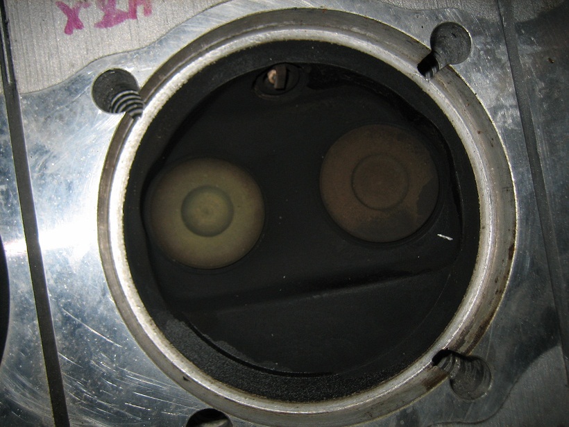

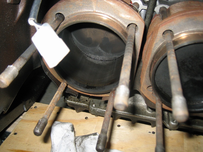

I know we all like pics, so here are some of the chambers and such.

Samoa

Lastly

Your fuel mileage must have sucked. The CIS is not the most conservative but once you get it dialed in it will work better than the toilet flusher.

To note, and to no surprise, the engine ran really cool head temps (IMG:style_emoticons/default/rolleyes.gif)

Engine on the stand, other head off, no surprises there.
