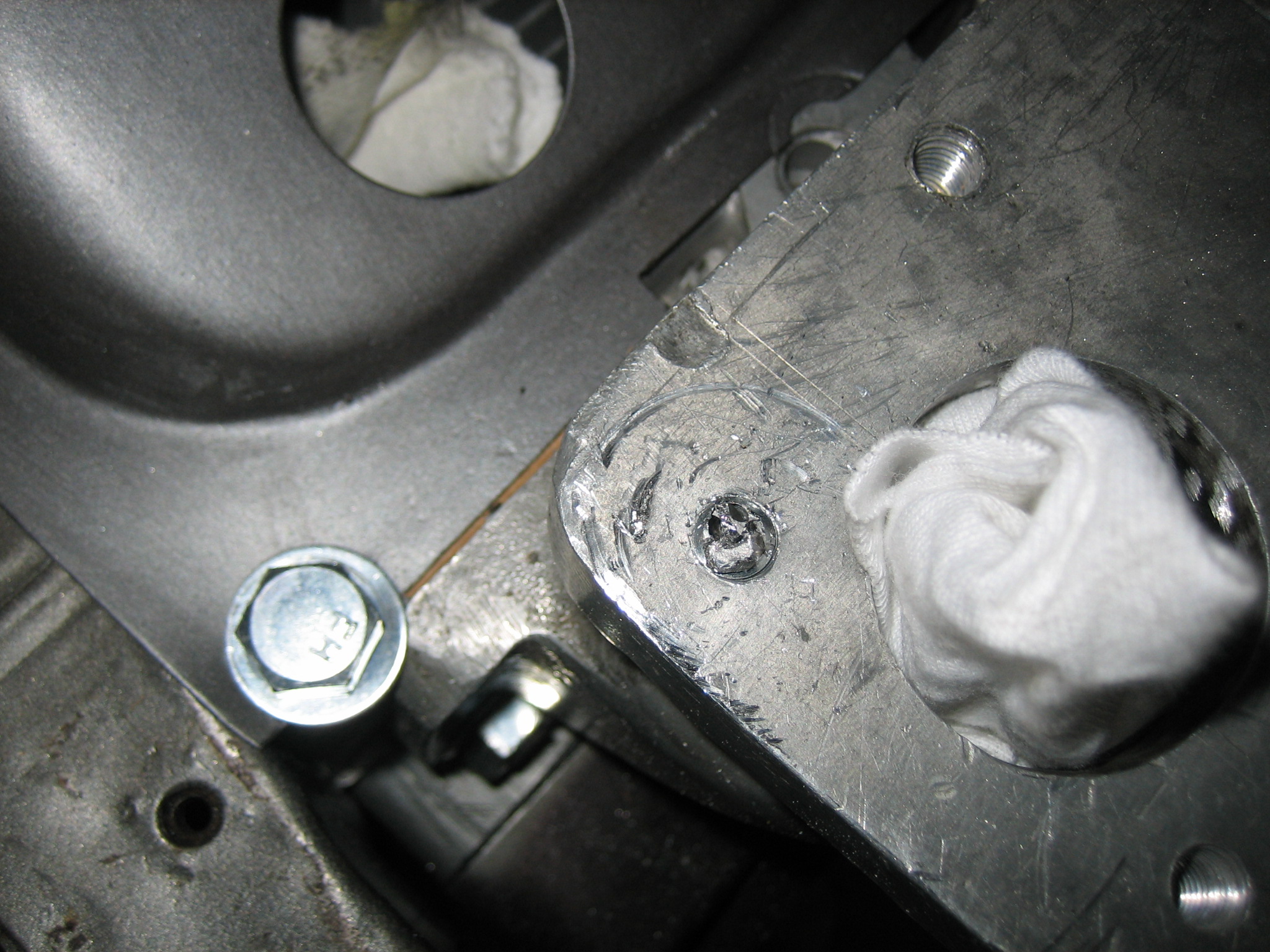

Well, I was forced to take a break when a bolt broke flush in the adapter and the drill bit broke in the remnant (IMG:style_emoticons/default/dry.gif) Looks like I will be converting the welder over to ferrous metal to weld on it and hopefully get it out (IMG:style_emoticons/default/headbang.gif) It almost came out all the way with the easy out, but then the top broke off the remnant so I tried to drill it further.

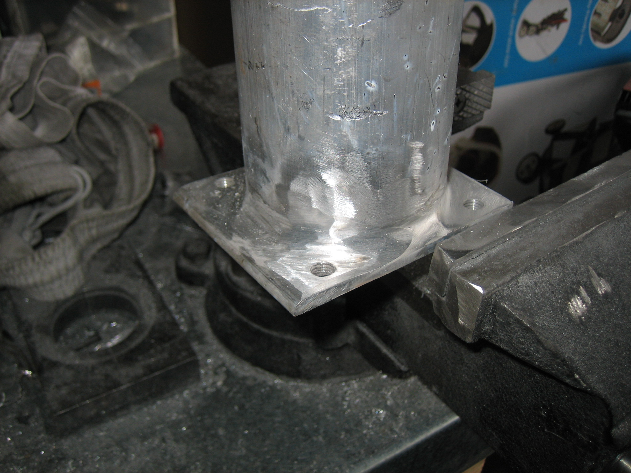

Here is the TB stand pipe (IMG:style_emoticons/default/smile.gif) Maybe I can finish the center connector pipe today.

Done for the day. Gonna have to raise the boxes 3/8-7/16. That damn broken bolt took way to long to fix. I had to drill and drill and drill. Then I welded up the big hole, drilled and tapped. Good to go.

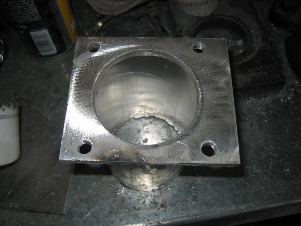

Scored a piece of 3"x0.5"x24" aluminum today. Too bad I was looking for 0.5" x 3" x 2'. I will make it into risers. I had to take a day off to get some DVDs made up. Huge demand lately (IMG:style_emoticons/default/smile.gif)

Tonight I could not seem to drill a hole where I wanted to. I made due. Putting 2.5" holes in 1/2" Aluminum with a hole saw SUX. Its what I have and it cost me $0 so dont judge me.
I got the 1/2" sections drilled and almost completely welded to the feet of the boxes. Gonna pretty them up tomorrow. Then, install on engine, make TB center pipe combo, and make measurements for the fuel lines that I will be ordering. SS braided, goon look good. I hope it runs (IMG:style_emoticons/default/dry.gif)

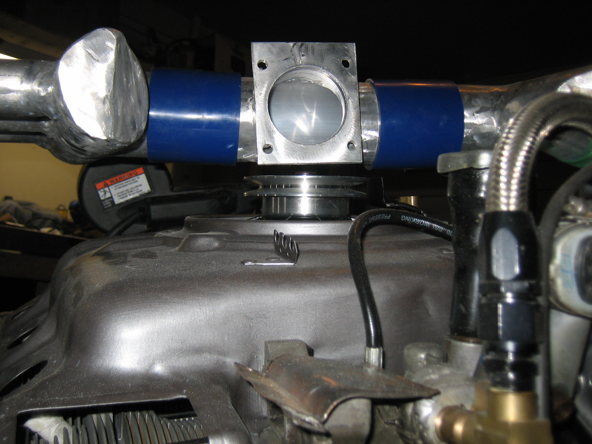

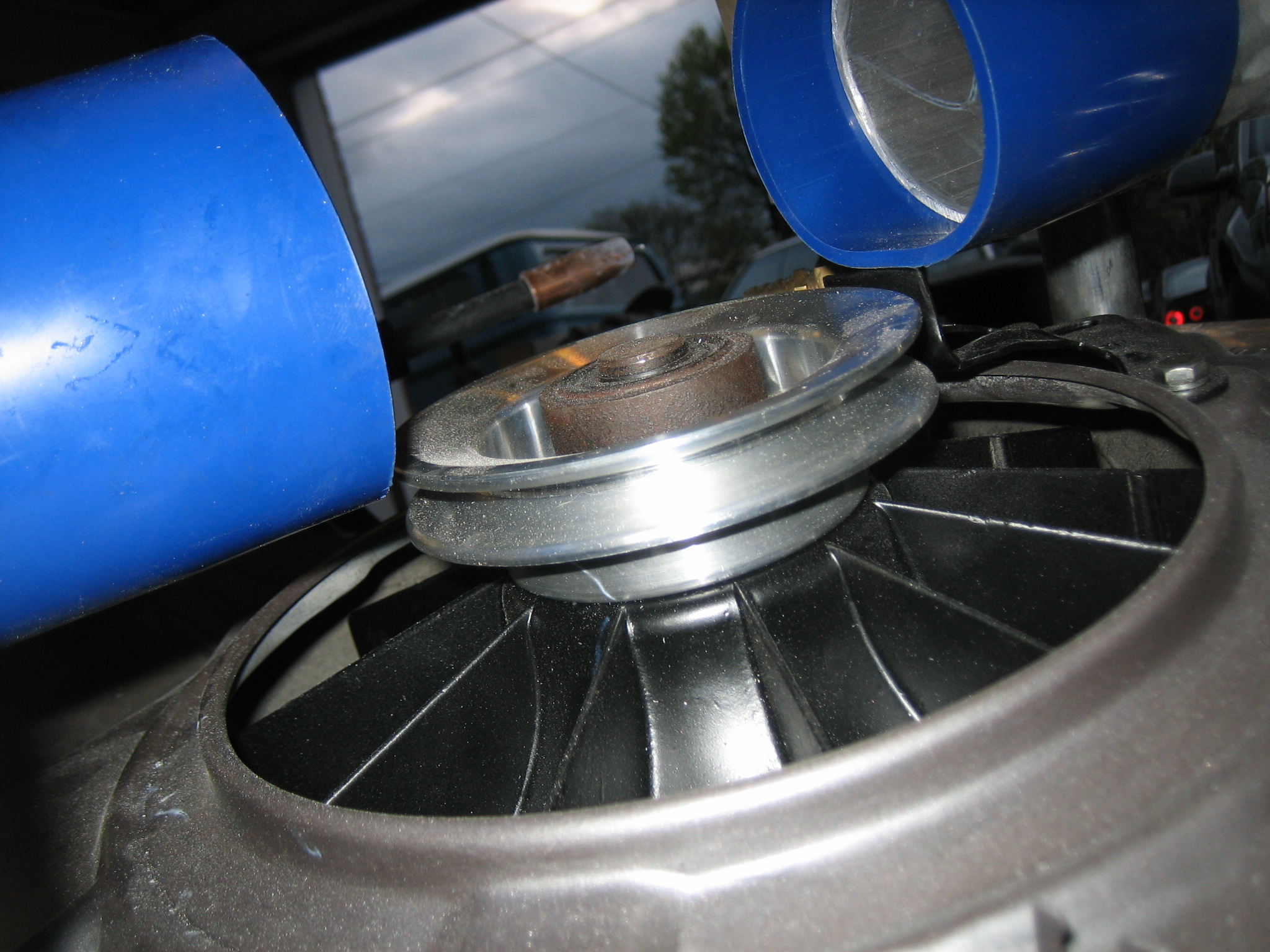

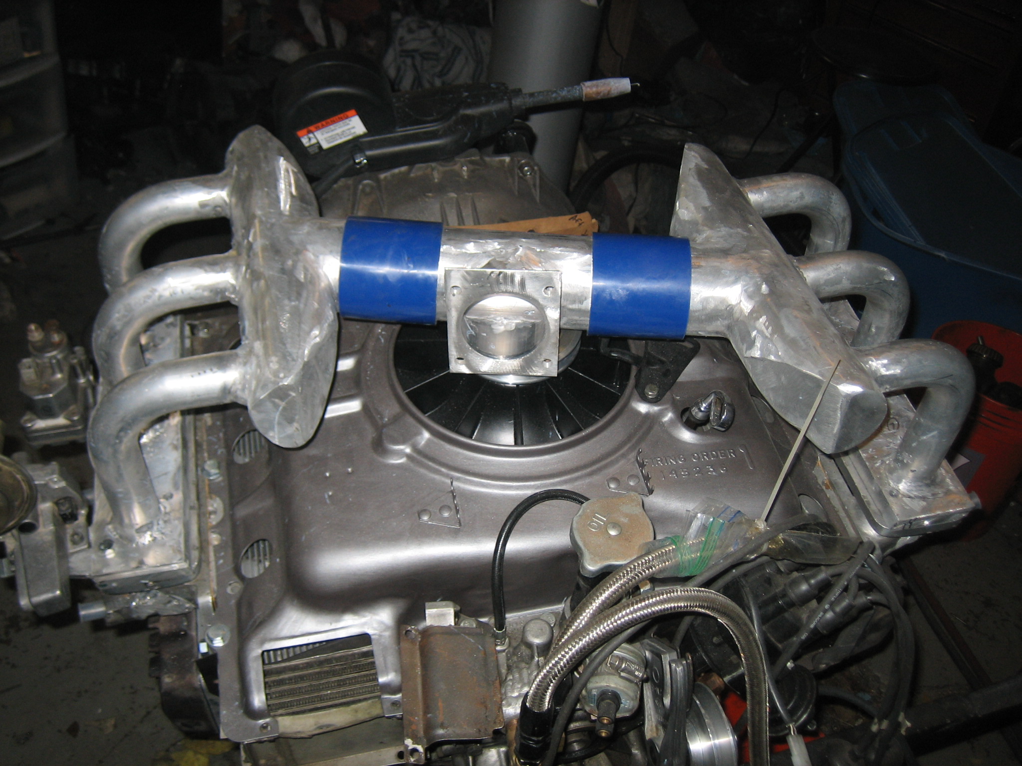

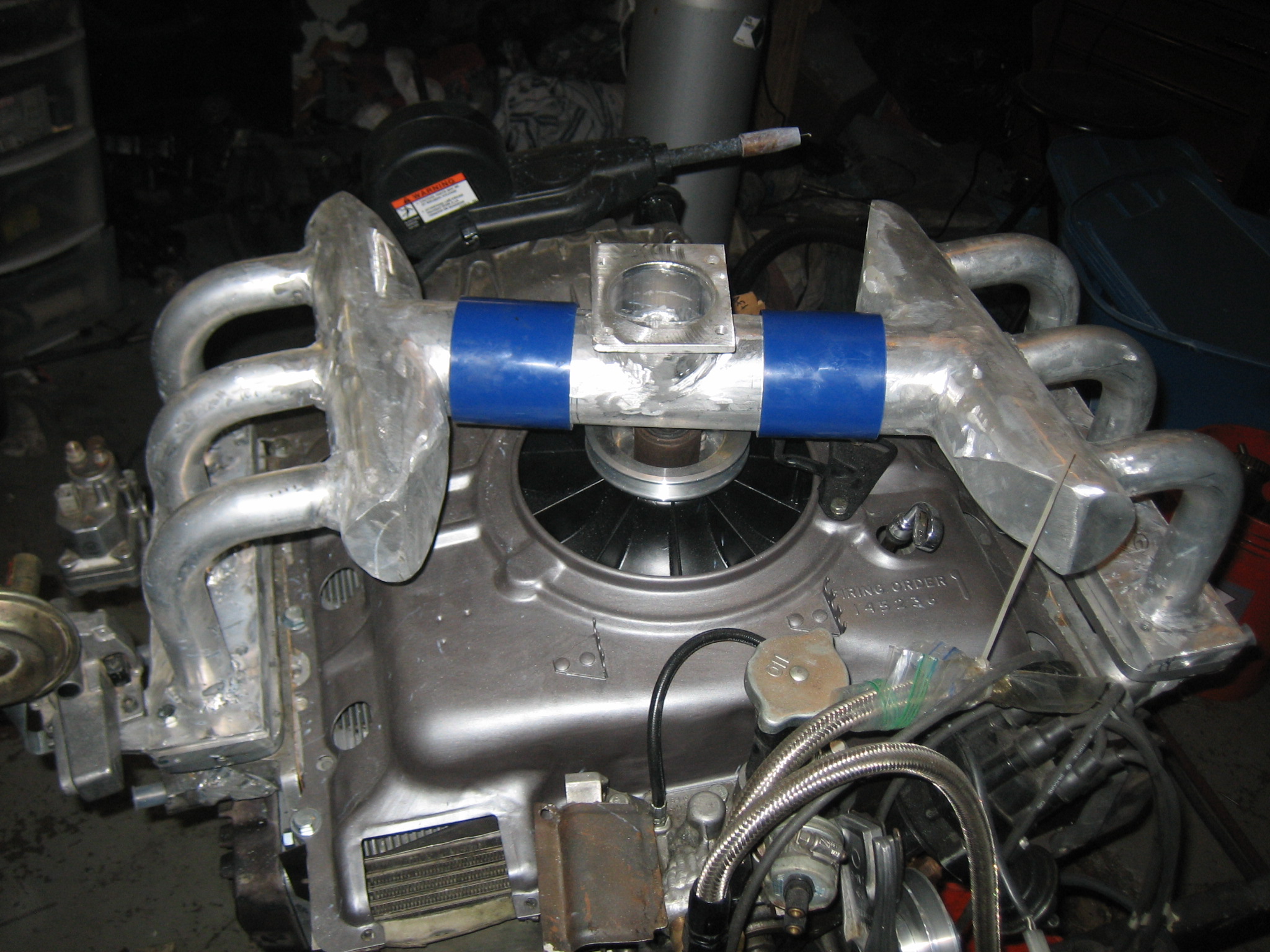

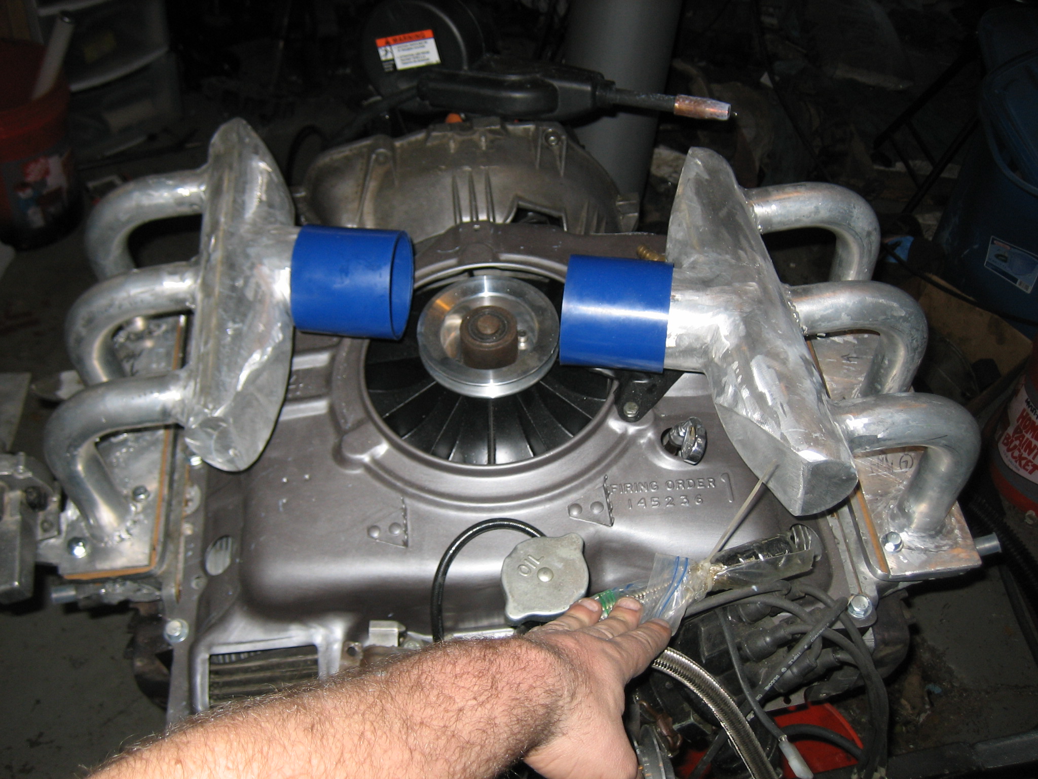

I finished fabricating the center tube for mock up. It looks perfect (IMG:style_emoticons/default/smile.gif) I am not sure if I will have it horizontal or vertical, but I think vertical may be the best bet as long as it fits in the engine compartment, which I think it will. The aux air supply bung/CSV bung needs to be fabbed and welded on the center pipe still, as well as a mount to keep the center pipe in place. As you can see in the pics, there is the perfect amount of clearance now (IMG:style_emoticons/default/smile.gif)

I am questioning the need for a pop-off valve like on the plastic boxes in order to keep the back fires from damaging things if they should happen. Anyone have input on that? How to mount a plastic valve to the aluminum will be interesting as well.
Or, I can carry extra rubber sleeves (IMG:style_emoticons/default/smile.gif)

Wasn't the pop off to prevent blowing up the plastic 911 air box? I don't have a pop off on my CIS 928 engine.
Dr Evil
post Mar 29 2012, 05:54 AM
Post #1176
Send me your transmission!
Posts: 23,038
Joined: 21-November 03
From: Loveland, OH 45140
Member No.: 1,372
Ya, for protection of the box. I guess since the V8 doesn't have one, I don't need one. It will just test my welds.

QUOTE(Dr Evil @ Mar 28 2012, 10:24 PM) *
Don't worry about it. The flapper valves I've seen are used to protect plastic air boxes. I'd hazard a guess the aluminum is a bit stronger, and less sensitive to getting brittle when cold. If not, it may be a weld test.
FYI- If the aluminum used is heat treated (T4, T6) the welding will kill the heat treat near the weld and knock it back to dead soft (T0).
