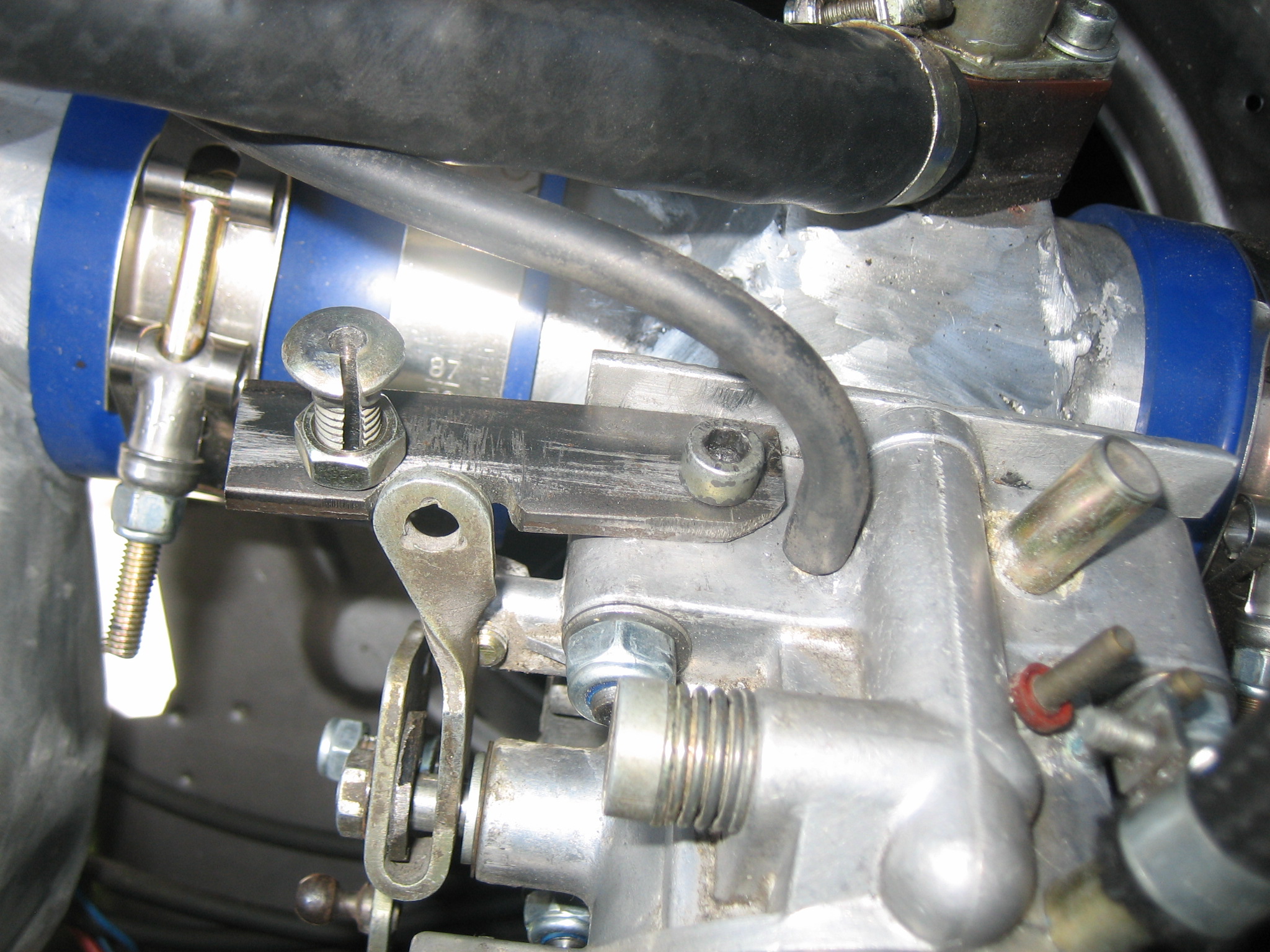

Design on the throttle assembly is progressing well. Lots of stuff needing to be designed around. Probably finish this up tomorrow.

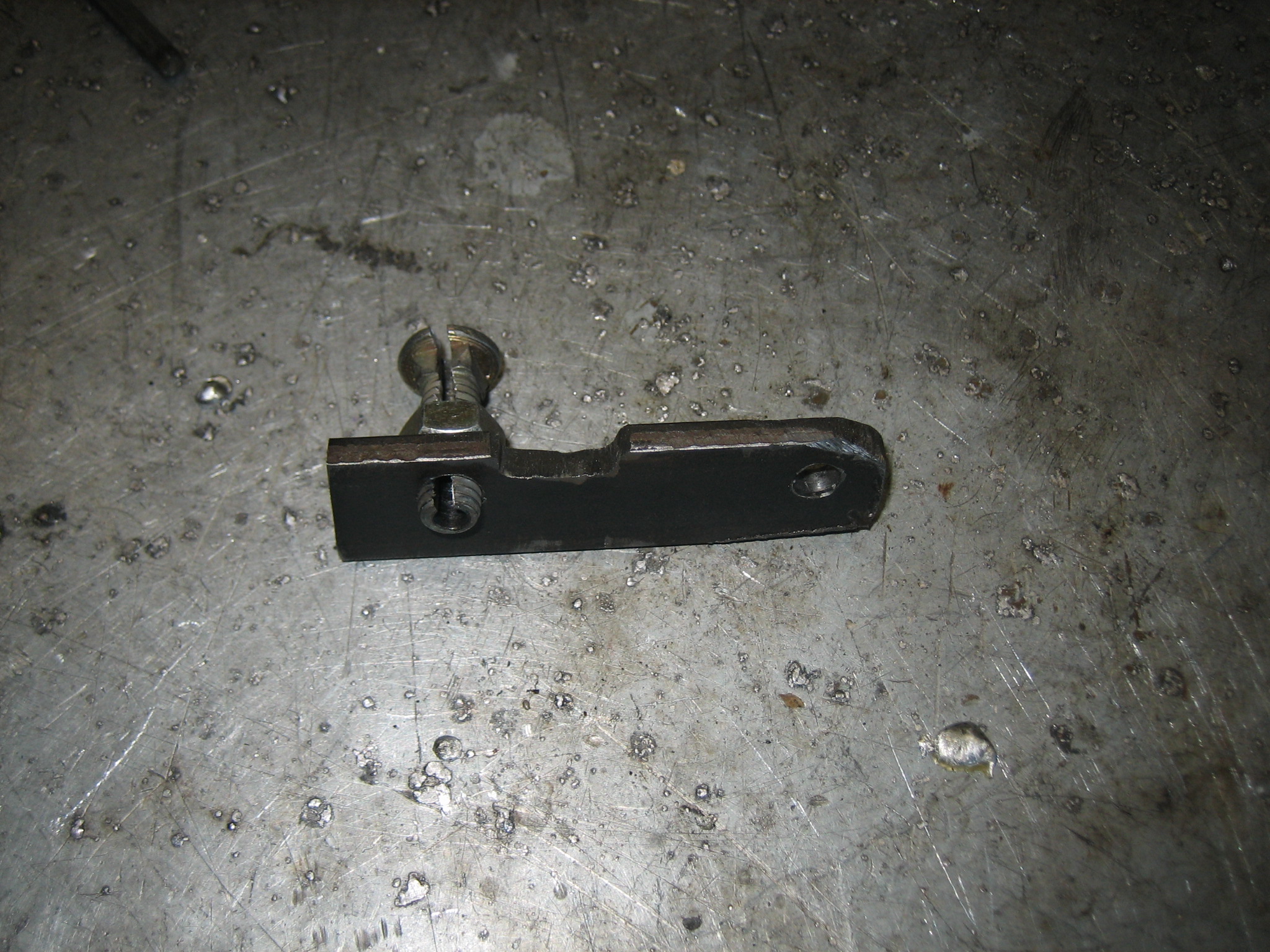

Sometimes I get a feeling of Zen when working on the bus. Since I am creating things the did not exists in the form I needed them it, it often feels like I am actually discovering a design that existed, but I just had to see where it was and make it.
I particularly got this feeling with the mounting of the thermotimeswitch and last night with the throttle assembly. One bolt goes to a hole already in the throttle body, the base plate keeps it from rotating. The needs of the design were satisfied by a simple piece of 1/4" steel that was drilled, tapped, and notched. Not fancy, but perfect. Attached thumbnail(s) |

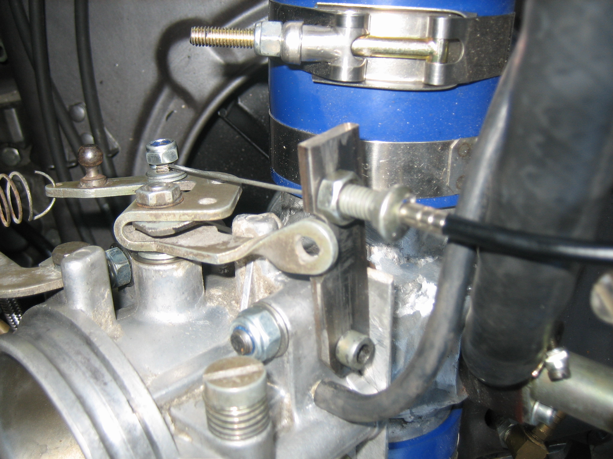

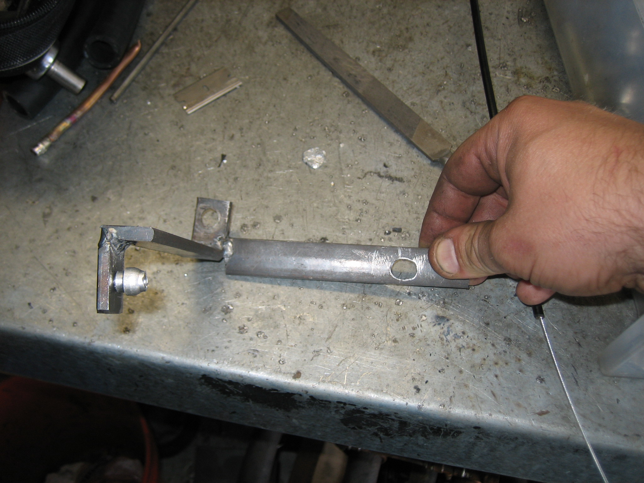

Yet more of pulling designs from the ether. Lower throttle assembly.

Well, here come the excuses, my Suby stole 1.5 days from me this weekend (IMG:style_emoticons/default/dry.gif) Then, while working on it today some guys approached and asked if I could do some work on their 75 CB360.
The throttle is almost perfect. The ratio is off and the TB is not opening all of the way so I need to recalculate that. If that goes well, I will address this tomorrow, install the tins, wiring, turn the key and :bomb: Nice little bike (IMG:style_emoticons/default/smile.gif) Attached thumbnail(s) |

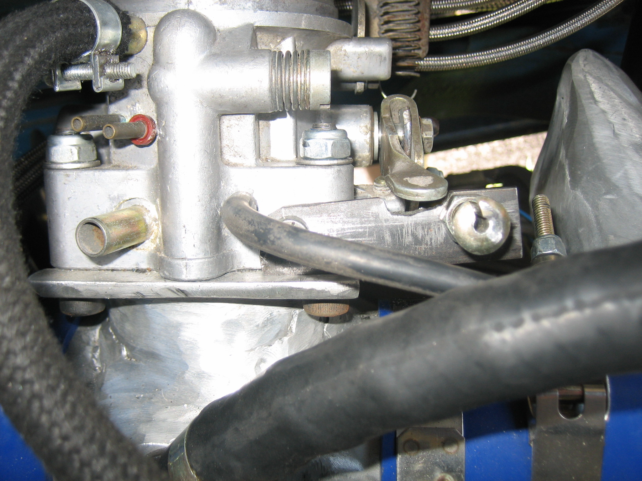

Damn it (IMG:style_emoticons/default/headbang.gif) Damn it (IMG:style_emoticons/default/headbang.gif) Damn it (IMG:style_emoticons/default/headbang.gif)
Spent another few hours on the damn throttle cable design. I changed some parameters, welded up the throttle linkage off of the throttle body to allow for more adjustment in position of where the cable hooks in, and after all of that........the damn thing still does not function correctly. It will not open all the way until pushed by hand, the pedal feels real bad, then it wont close all the way. The weak link, after all the adjustments have been done? The cable from the tranz to the TB. I tried to use a bicycle brake cable, it is not going to work as there is no teflon lining and it is not built for this application. So, I need to either locate a cable that will work, or start to fabricate another rod control system like the one that worked so well on the last setup (IMG:style_emoticons/default/dry.gif) Not working on it tomorrow or wed, but Thurs through the weekend should be productive now that I know what is going on. |

Working on sourcing some motorcycle throttle and clutch cables. These should be more up to the task. I cant believe the others failed so badly.

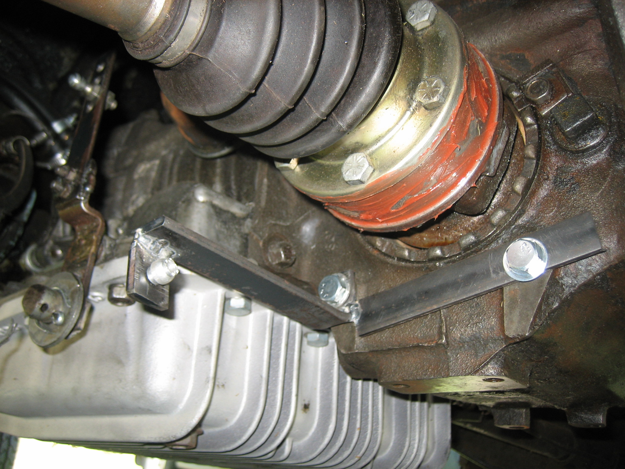

(IMG:style_emoticons/default/blink.gif) (IMG:style_emoticons/default/WTF.gif) RTV much ?
Attached image(s) |
rick 918-S |
Aug 1 2012, 07:40 AM
Post
#1416
Hey nice rack! -Celette Group: Members Posts: 20,680 Joined: 30-December 02 From: Now in Superior WI Member No.: 43 Region Association: Northstar Region |
No safety wire on those bolts? (IMG:style_emoticons/default/poke.gif) (IMG:style_emoticons/default/happy11.gif) Gitterdone (IMG:style_emoticons/default/popcorn[1].gif) |

OK, I met a local guy, my age, that has a sweet collection of parts and vintage bikes to include BSA, Ducati, Honda. He gave me some cables to try and one was perfect. I spent some hours futzing with trying to get the measurements correct....this did not work. What I ended up doing was putting another return spring on the transmission arm, and bending the stop on the gas pedal so that I could get more movement. This worked to solve all problems (IMG:style_emoticons/default/smile.gif) Tomorrow looks to be a day for completion and hopefuly some triumph.
