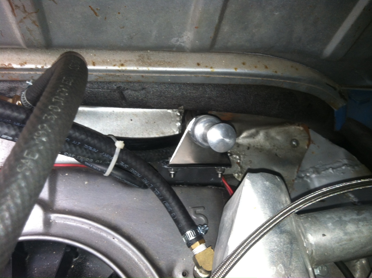

Got a lot done today.
Built a mount to place the trans fill. Mad it out of plate. Made a hose and taps for the case vent. Checked all the hoses, and a good thing I did as I found two hose clips on an air bypass hose that were very loose and fixed that. At this point, I need to install the exhaust, hook up a battery, and start doing checks on the systems (IMG:style_emoticons/default/smile.gif) |

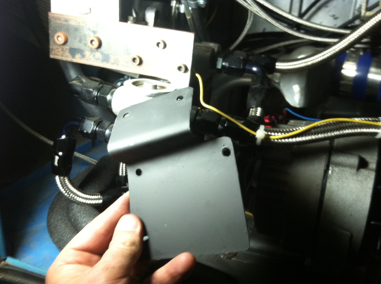

Some stuff I did (IMG:style_emoticons/default/wink.gif)

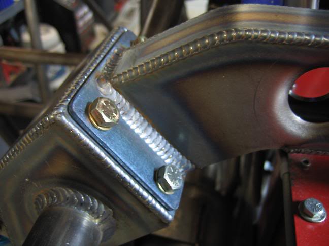

scotty b |
May 19 2013, 01:32 PM
#1491
rust free you say ? Group: Members Posts: 16,375 Joined: 7-January 05 From: richmond, Va. Member No.: 3,419 Region Association: None |
WOW !! you're building a tube chassis for the bus body to sit on now ? that rawksss !!:drooley: Can't wait to see it this weekend (IMG:style_emoticons/default/beerchug.gif) |

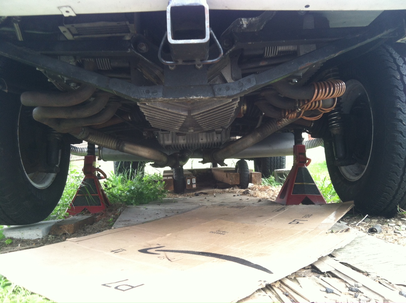

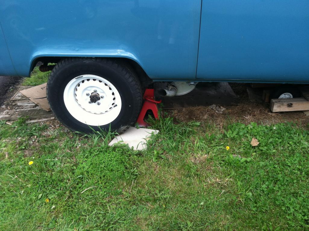

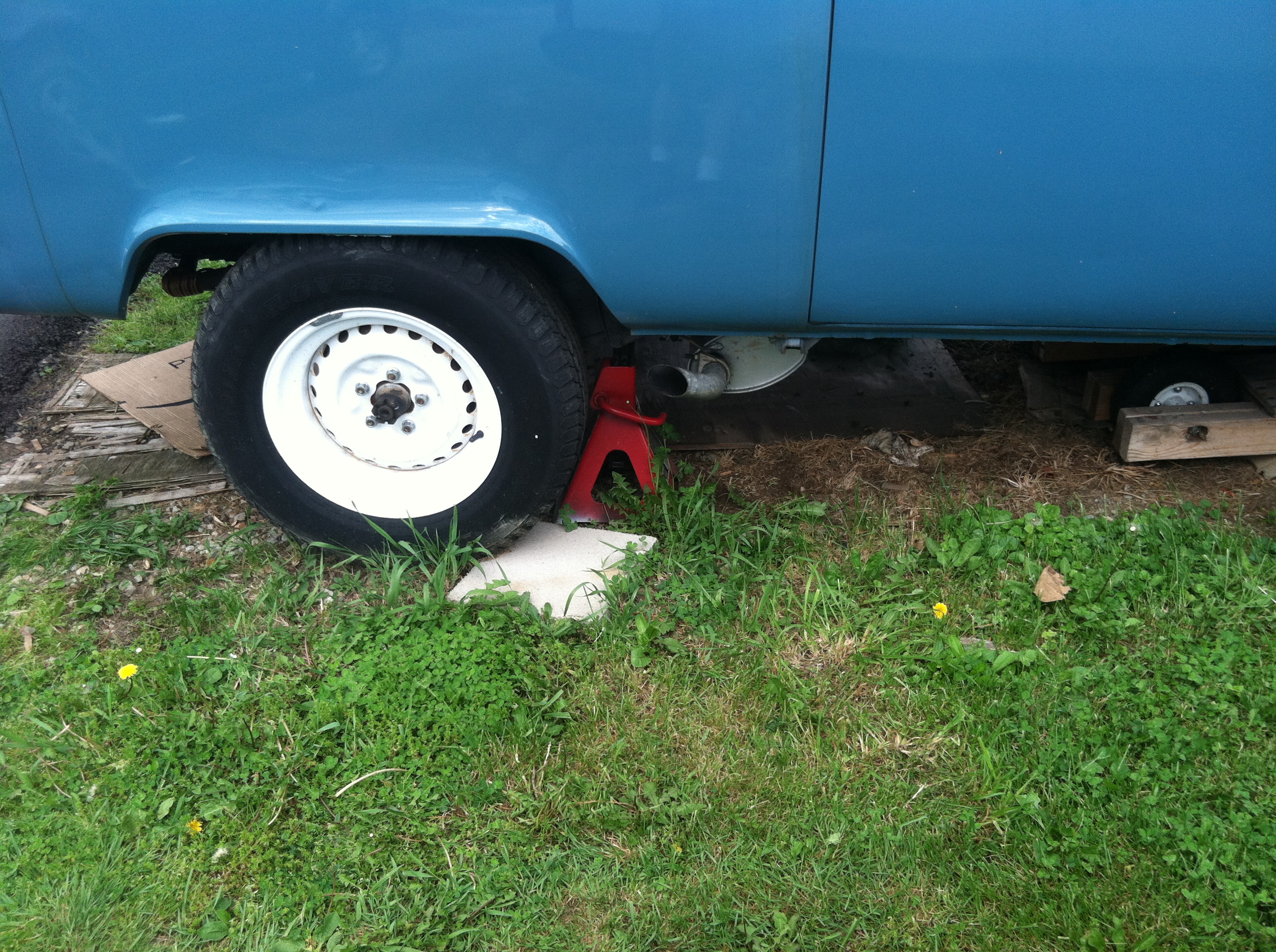

Almost ready to turn key. Welded up the exhaust to be better then previous and installed. Cleaned up wires and remounted fuse panel.
I need help with the throttle cable assembly and my friend is going to do that. Probably tomorrow, though. Attached thumbnail(s) |
