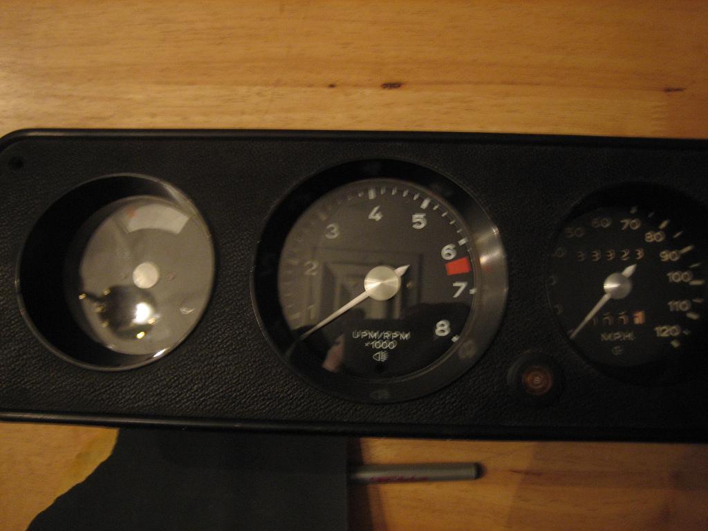

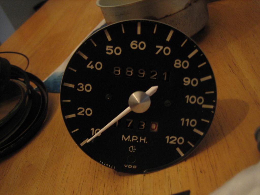

So today I managed to start another part of the program, the instrument panel. I wanted a tach because the blank spot in the stock panel drives me nuts. So, I have make the 914 stuff fit. The speedo is for mock up only. I will be sourcing a 120mph silver buttoned one for the final set.

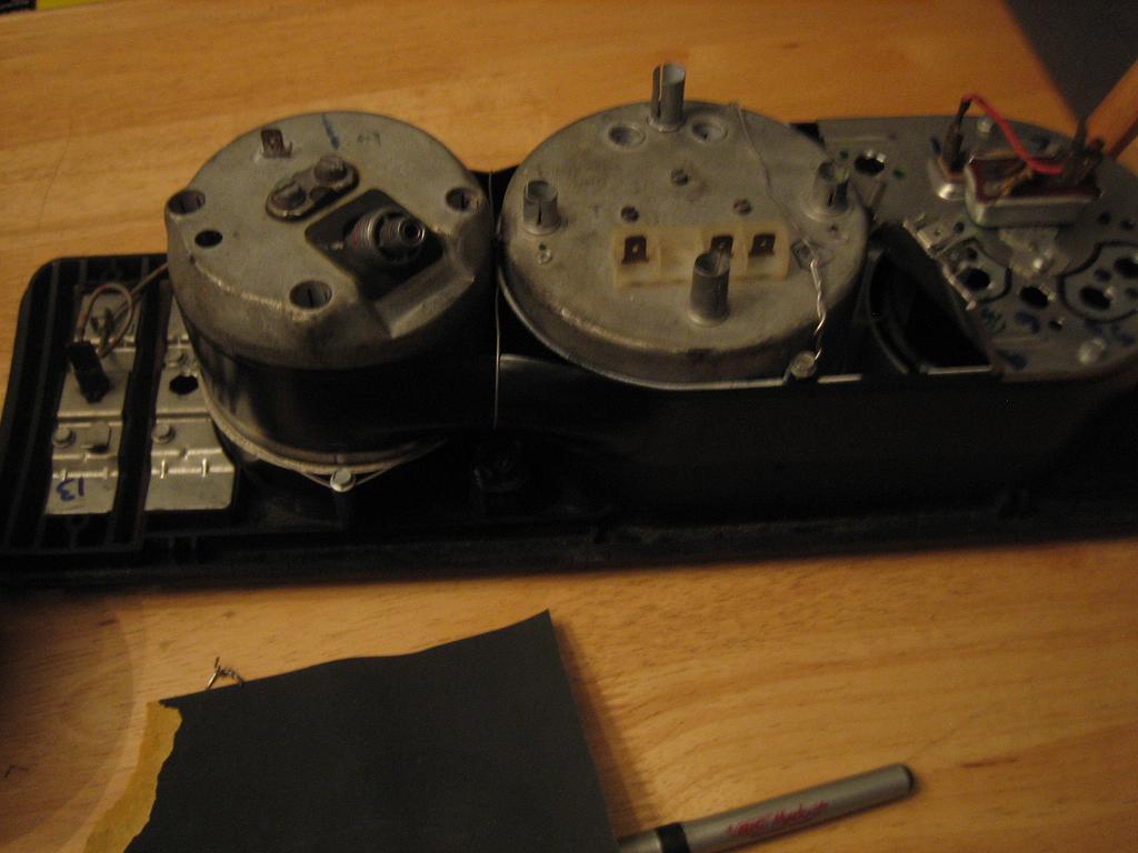

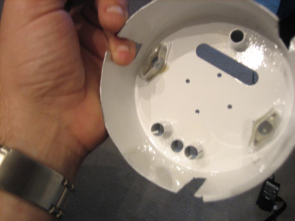

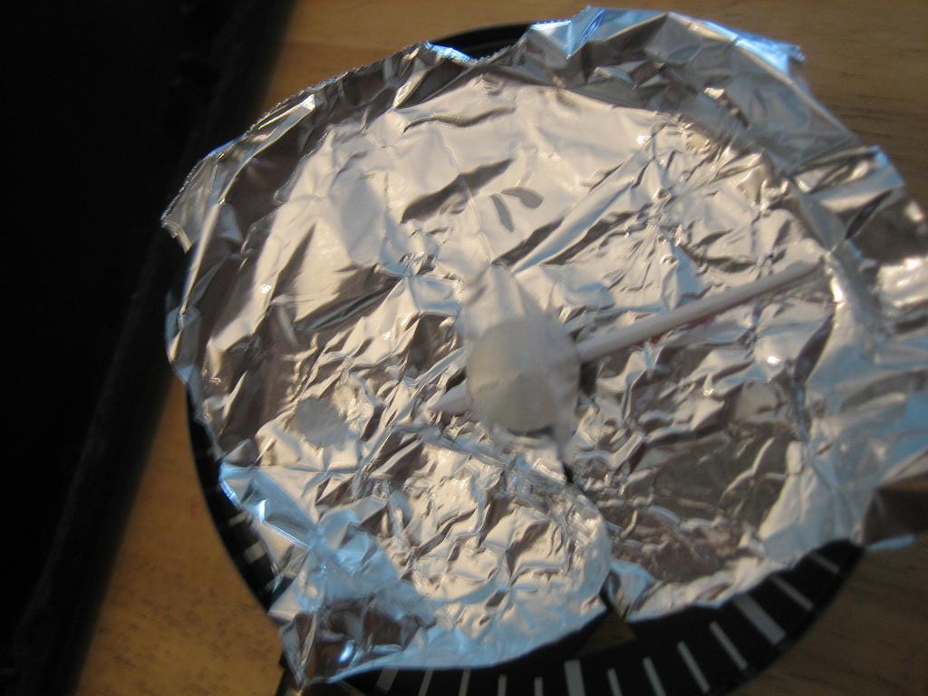

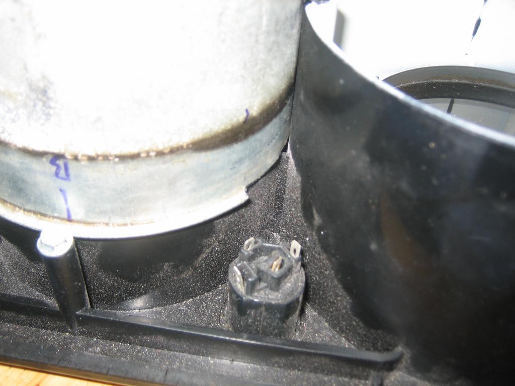

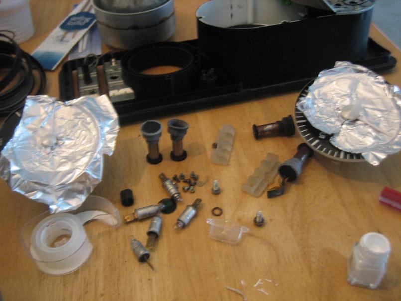

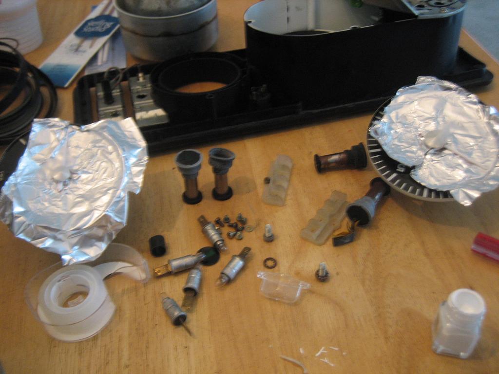

Since I am up here and my bus is an hour away in at a place that it would be unkind to work at odd hours, I decided to finish my gauge cluster (IMG:style_emoticons/default/smile.gif)

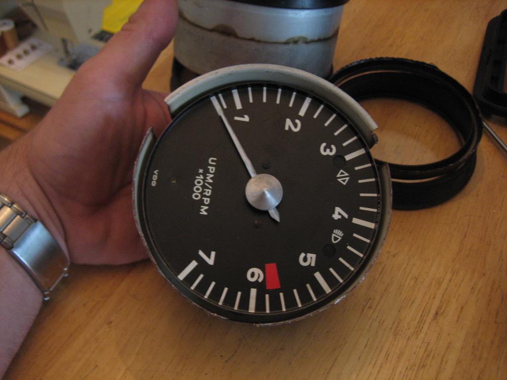

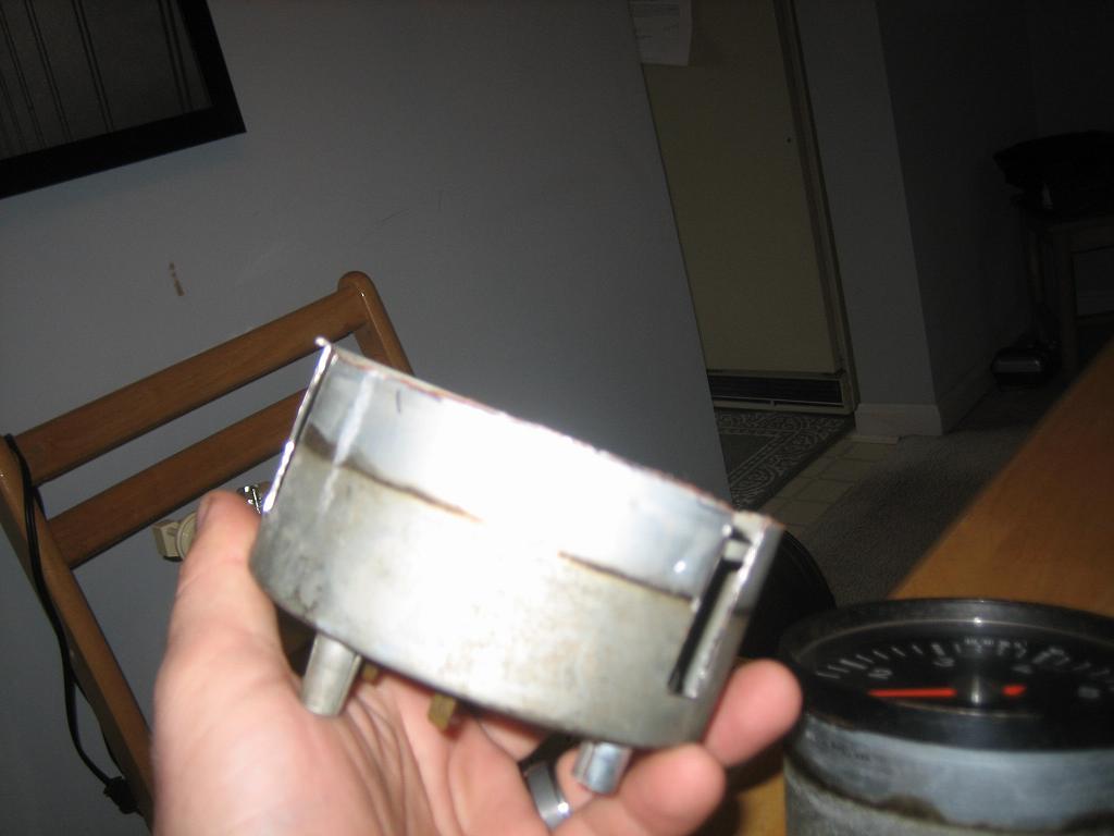

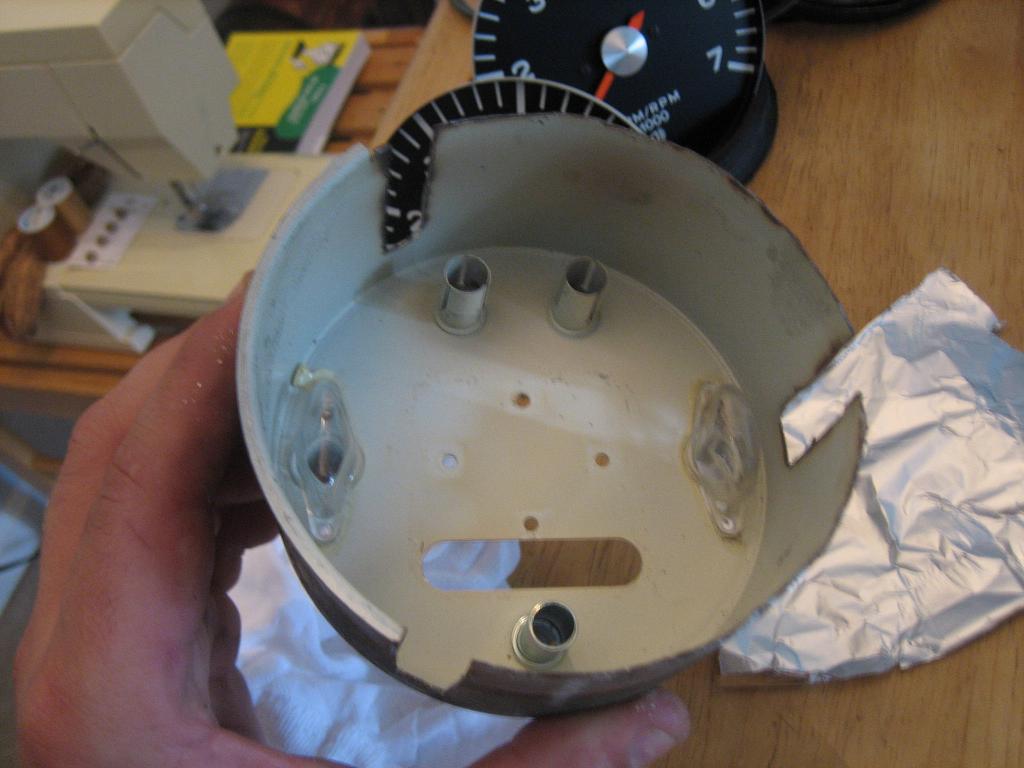

First I gutted a 911 tach and carved up the case to fit into the stock cluster. It fits PERFECT! Crazy how lucky that was.
I repainted the inside of the housing.
Then I painted the tach and speedo needles.
Notice the extra light bung I added in the tach housing in the 12 o'clock position (IMG:style_emoticons/default/smile.gif)

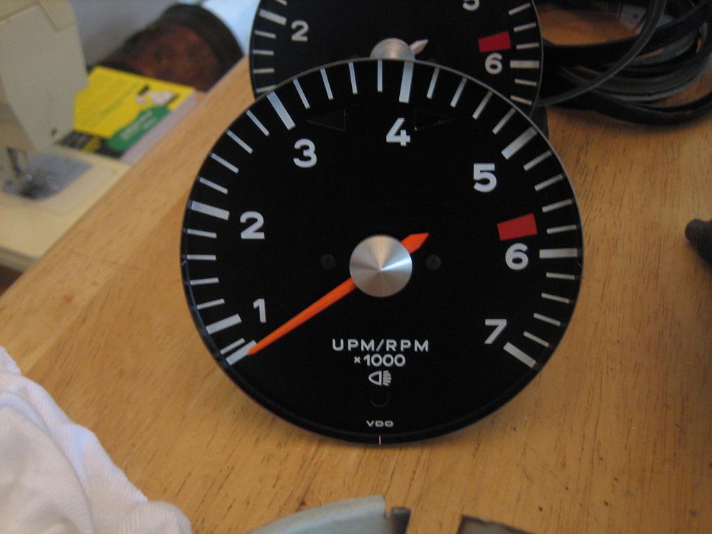

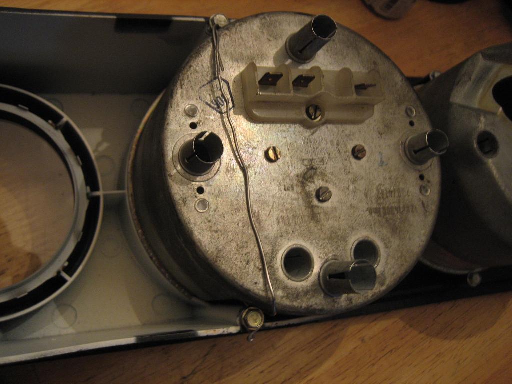

Here are the needles post paint.

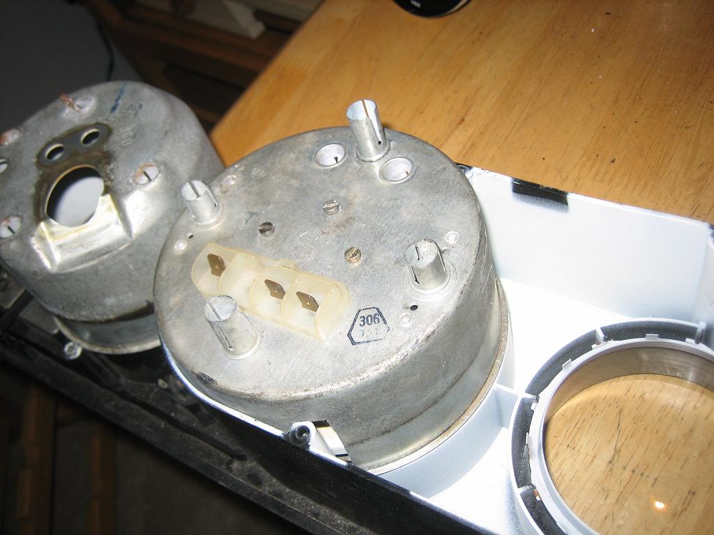

Here is the tach seated in the assembly.
An extra wire to keep it in place, though it is not needed.
For the speedo I just needed to remove the metal lip on the side.

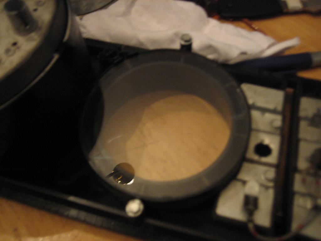

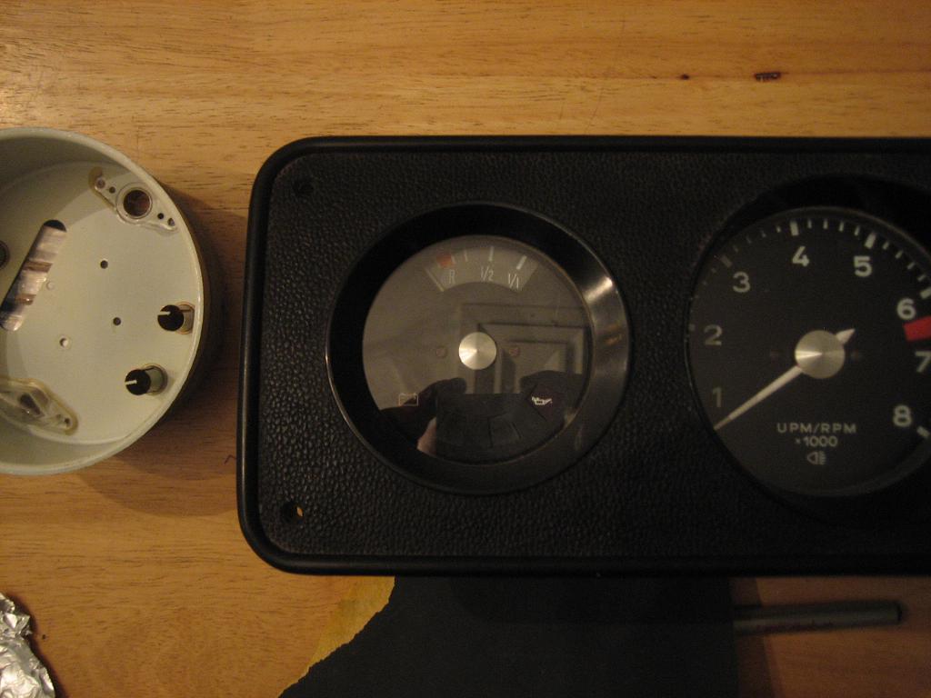

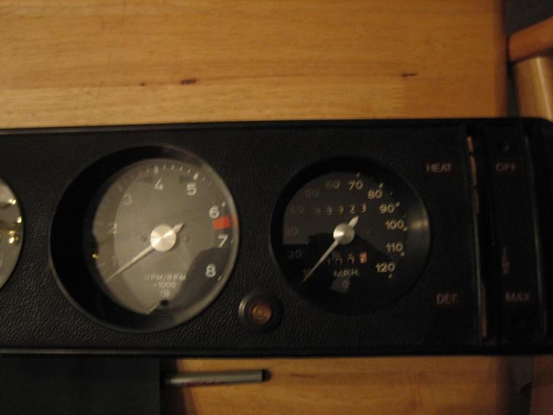

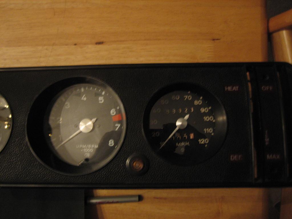

The speedo glass fit perfectly in the empty spot on the cluster.
Here is the speedo seated and wired in place, with the rest of the cluster. The wide electrical tape is only necessary to hold the speedo steady. The whole assembly is stout.
Here are the cluster pics. I blacked out the head light and turn signal indicators inthe left cluster gauge since I will use the ones on the tach.

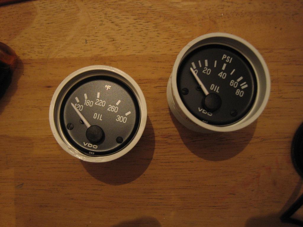

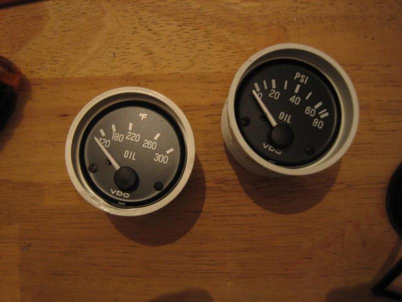

And here are the painted needles of the oil T and P gauges. I dont like red needles, obviously. The blue LEDs work better with the white.
