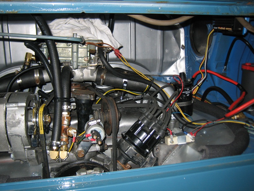

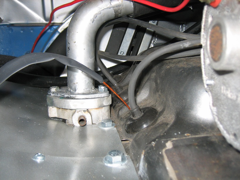

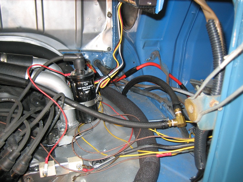

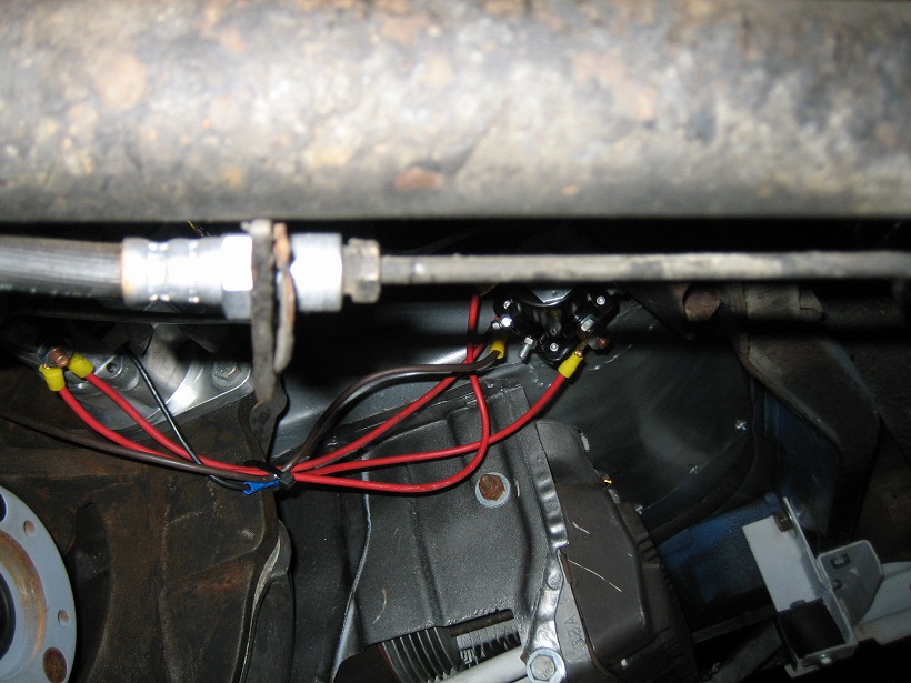

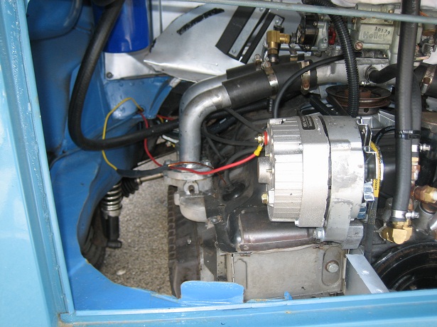

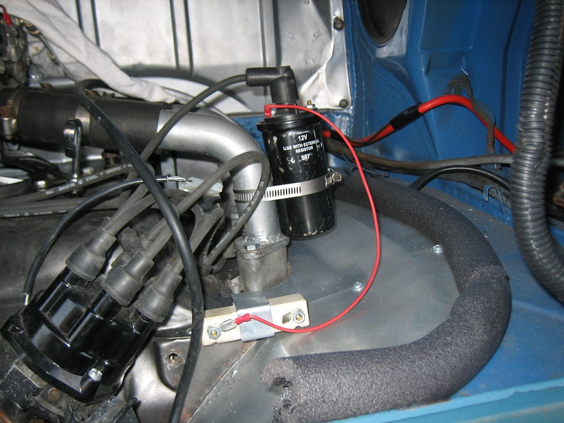

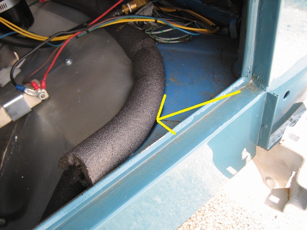

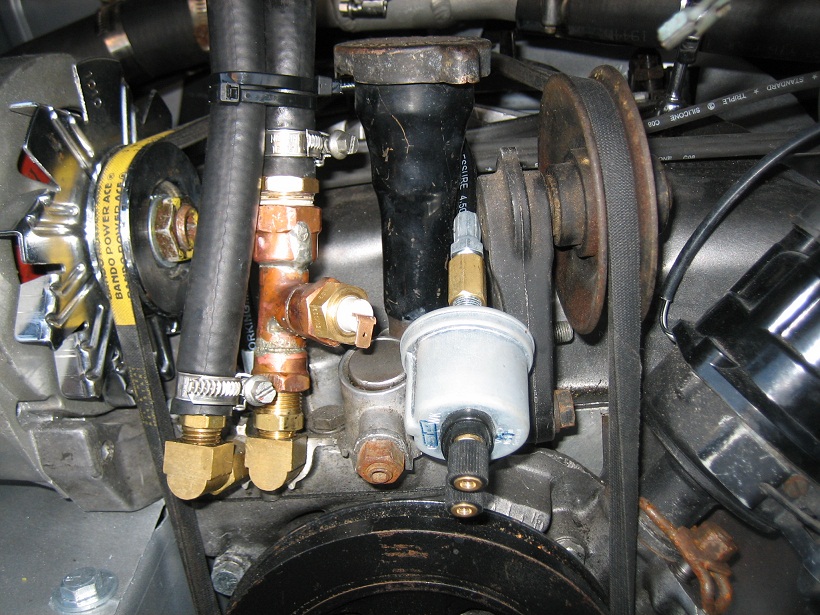

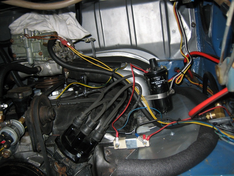

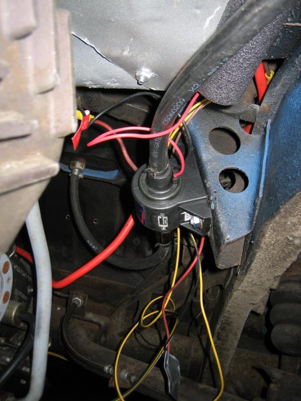

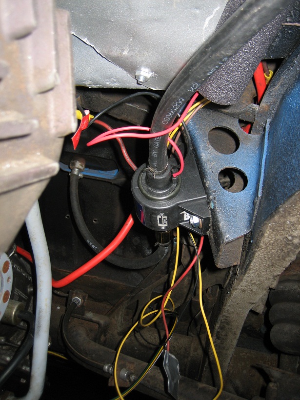

Alright, I know you all dont care if there aren't any pics. So, I took some (IMG:style_emoticons/default/smile.gif)
Over the last 2 days I managed to do the following:
- Starter and hot start relay wiring
- Fuel pump and hoses
- CHT wiring installed
- Oil pressure sensor mounted
- Oil temp T made and installed
- Coil, resistor and optical controller installed
- Completed installation of brake booster suck line
- Gear selector cable installed (what a PITA)
- Majority of the cockpit gauges wired, or wiring waiting for final placement of gauge
All that is left:
- Finish hooking up sensors
- Install gear selector under dash
- Buy a battery
- Axles
- Exhaust
The throttle linkage needs to be re adjusted as it is not working as it did before. I do not know why, but I need to set a day aside to have time to deal with it. It may take 15min, it may take a whole day.
And now, the pics.

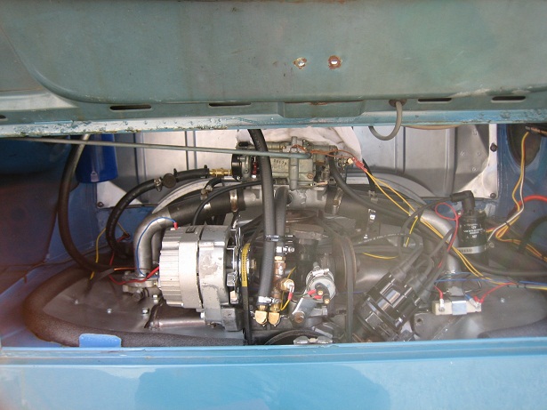

More

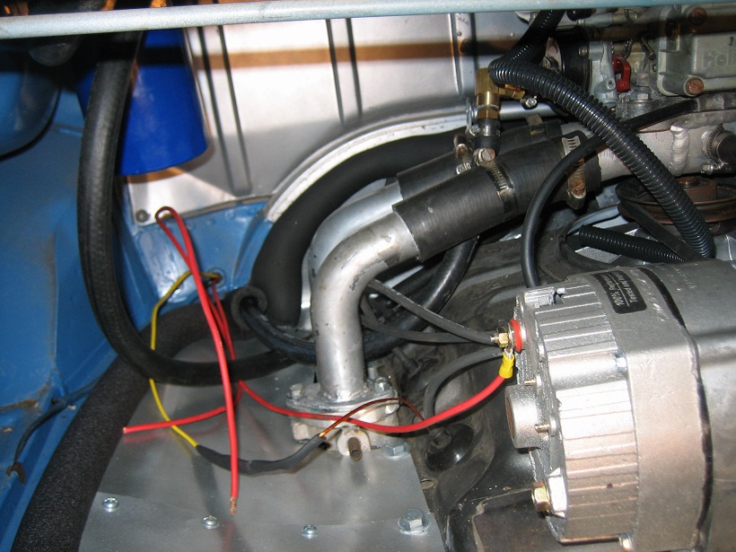

Still more.

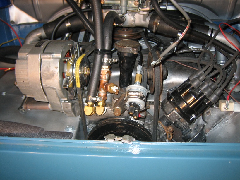

More more more

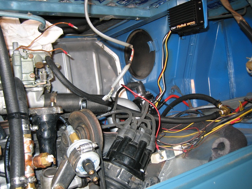

And then...

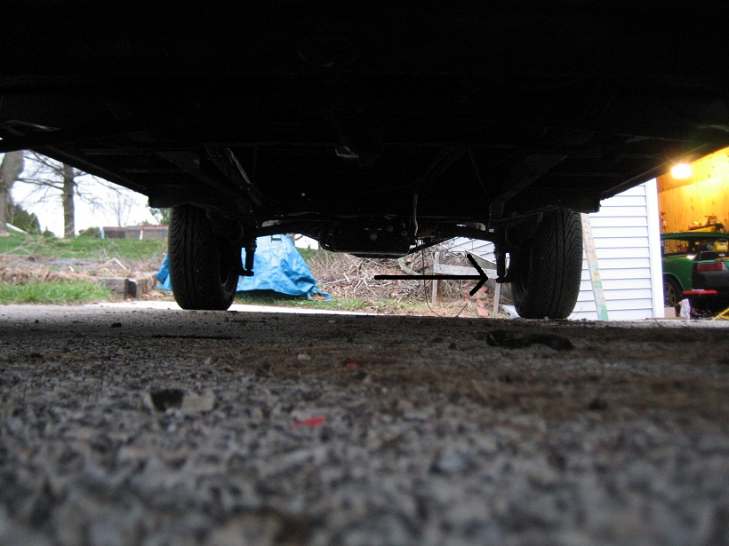

OK, I will be going to be in about 30min so I can get an early jump on this damn thing. I intend to have it running this weekend!

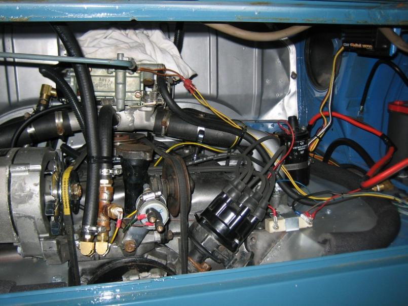

Here are the pics I took just before I found out that my engine was out of alignment (IMG:style_emoticons/default/hissyfit.gif)

Last two.

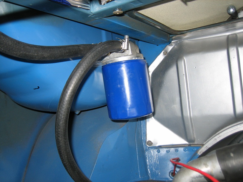

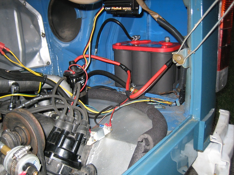

FINALLY! Today was a good 11hr work day (IMG:style_emoticons/default/smile.gif) I started at 1pm and left for home at midnight (and 33*, burr).
I adjusted the tin and installed the seals which went well (IMG:style_emoticons/default/smile.gif)
Start, drivers tin removed.
An example of the gap formed on the pass side when I shifted the engine. No biggie.
And the finished product (IMG:style_emoticons/default/smile.gif)
