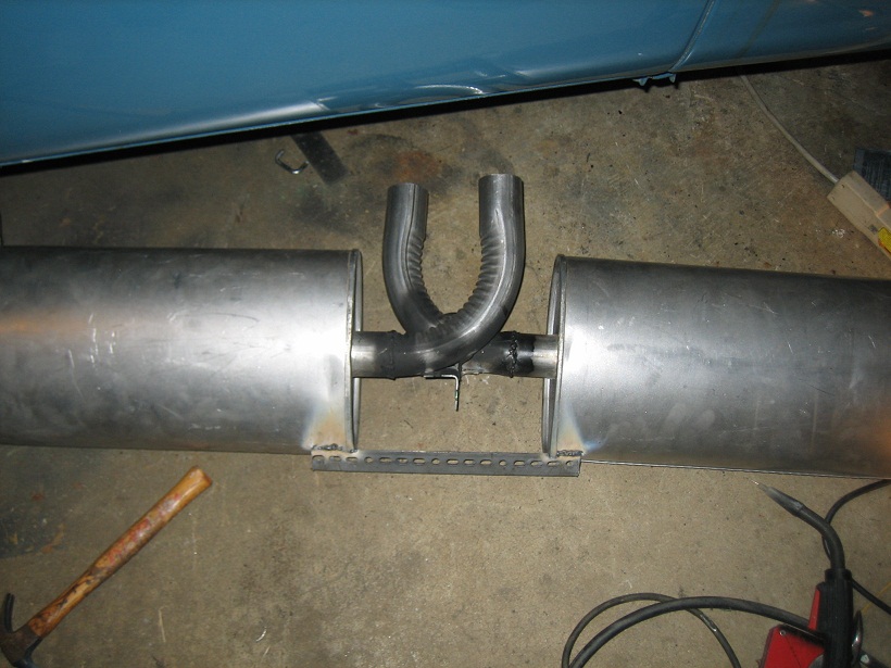

Well, today/night was all about getting the exhaust done. I would have gotten farther if my bike didnt strand me at the gas station for 1.5hrs at 10pm (IMG:style_emoticons/default/dry.gif) Loose wire, easy fix once found (IMG:style_emoticons/default/rolleyes.gif)

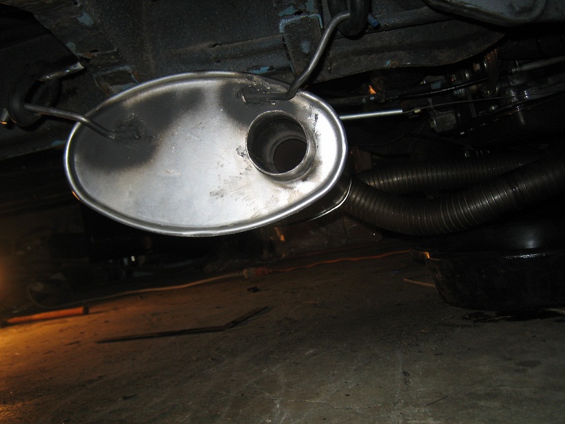

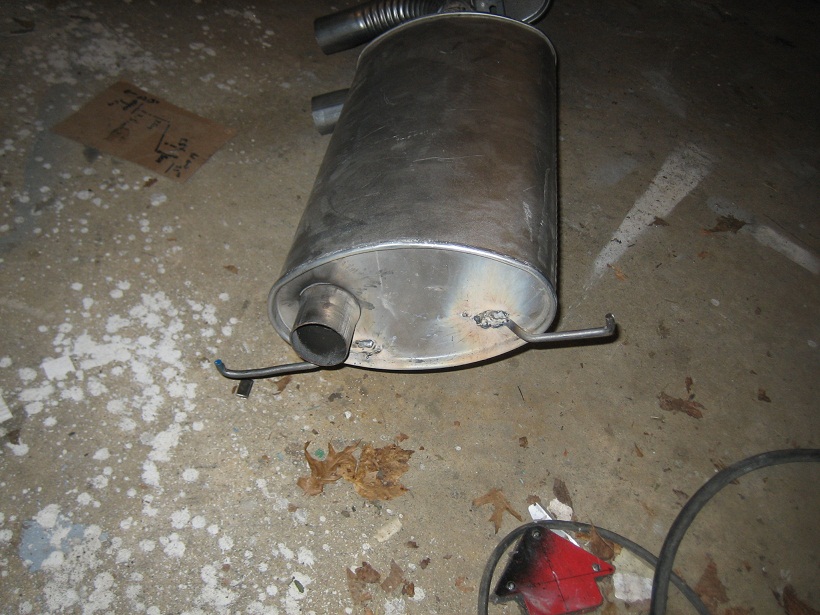

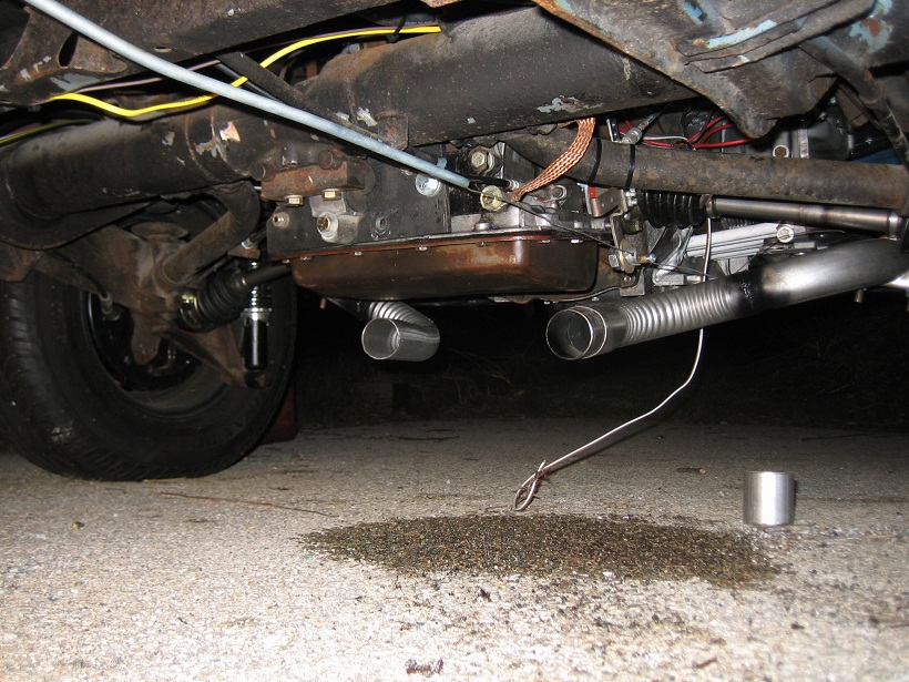

So, here are the exhaust pics.
Here are the tubes coming from the headers, and under the axles. Tight fit.
Here are the mufflers welded together so that they make one unit.

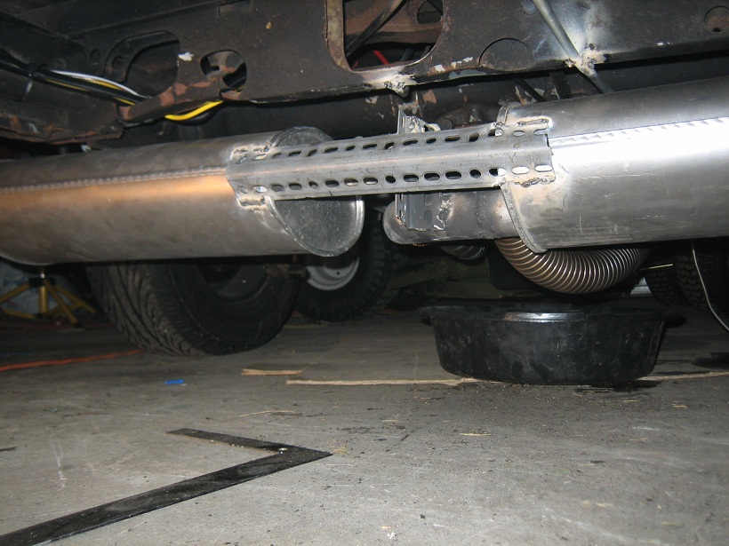

Mounting ears installed
Muffler assembly mounted. I had to cut and reweld the upper pipe so I could aim it down more. The hose for that one needs a little shortening as well.
Where the mufflers end up. I will be putting 45* tips on them last. You can again see the one pipe that is a bit too long.

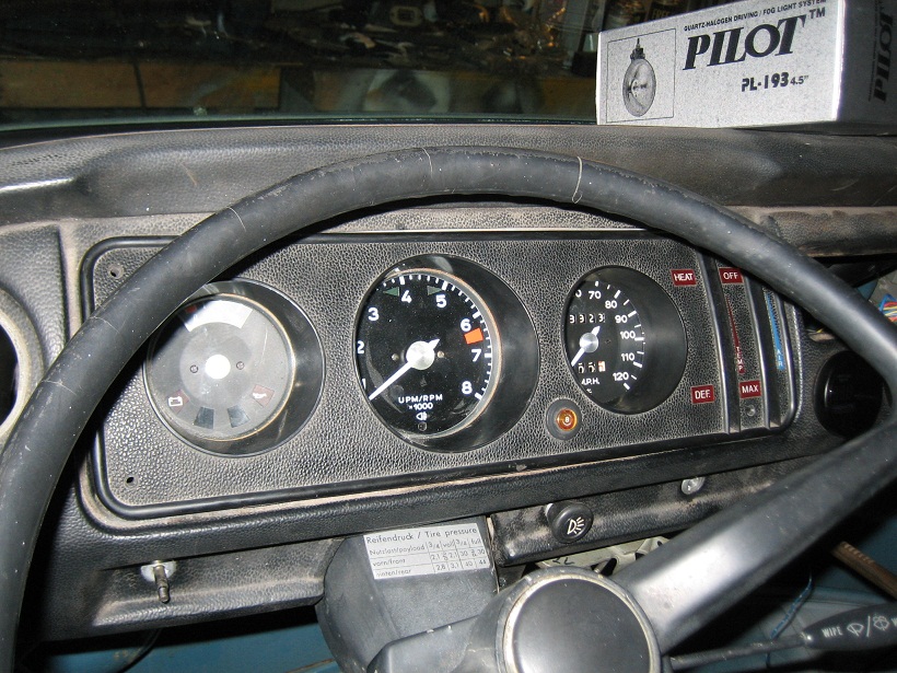

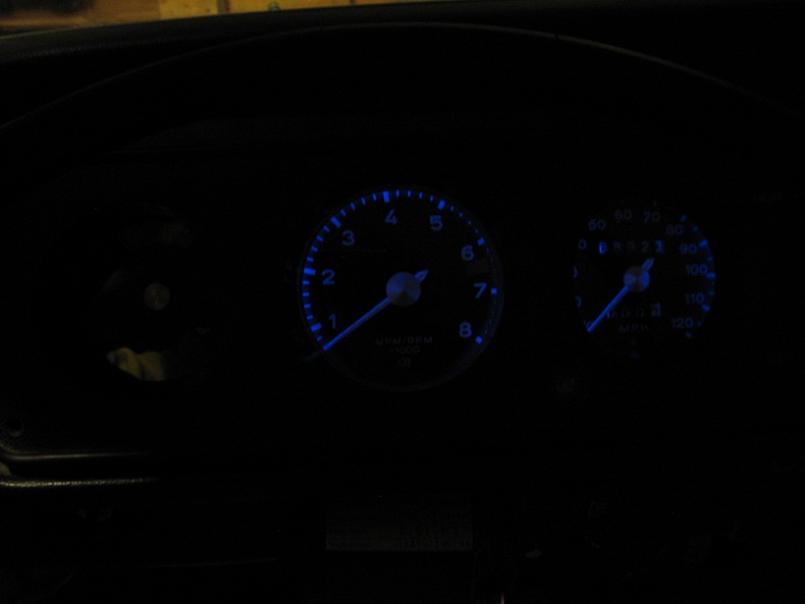

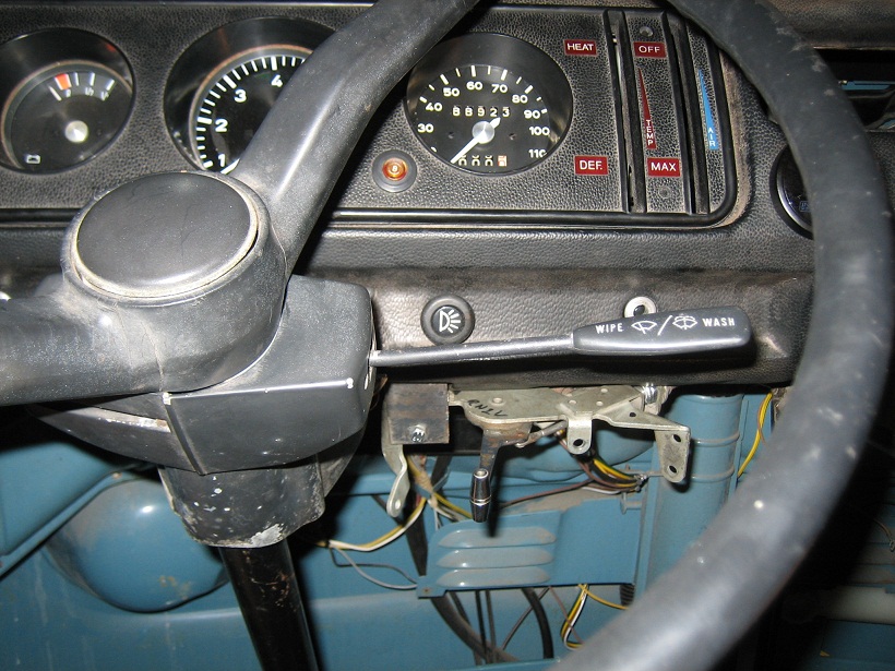

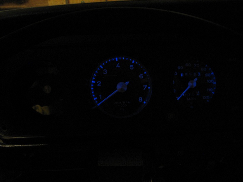

Last night was my longest night yet. I quit at 0245 and got home at 0400 (stopped for a snack). All I did was wiring completion and a rough mock up for the shifter. It is actually very stout and will be where it stays until I decide to move it. I am focusing on getting it moving to my house at this point so form will follow function, as it should be.
The gauges look awesome! I need to adjust the light in the fuel gauge side as you can see.
No work today on the bus, I need to do school and transmission work (IMG:style_emoticons/default/smile.gif)

Gauges

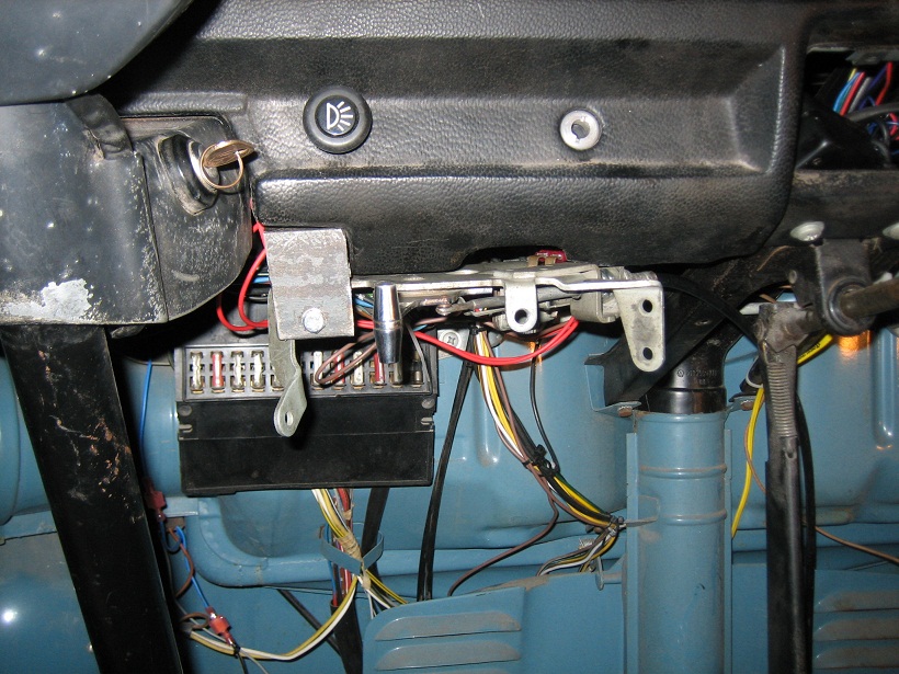

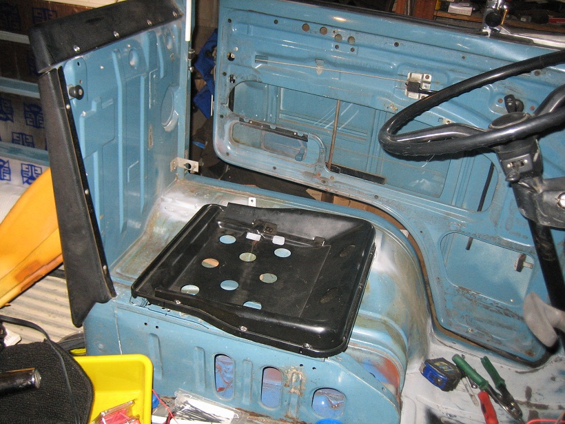

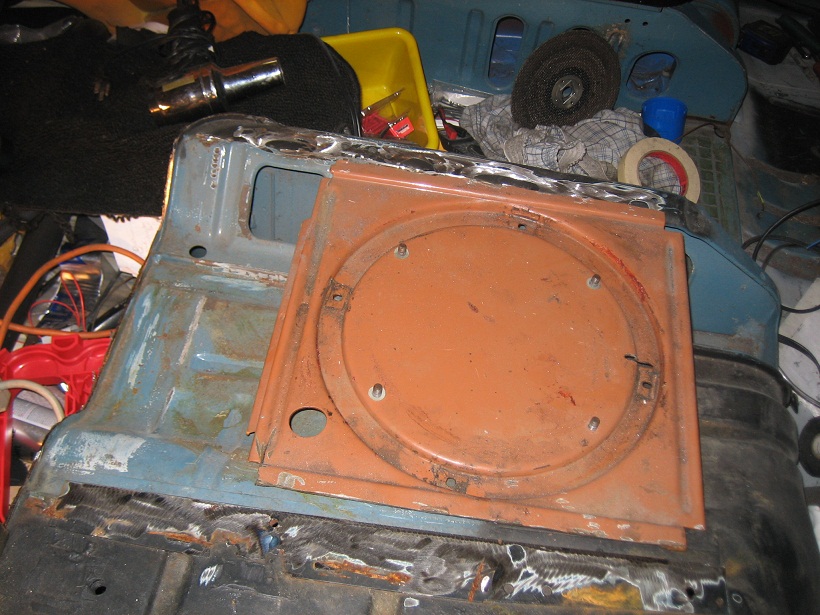

Last night was productive. I got stranded until 0130 by some rain and wind. I got all the wiring sorted out for the signals and instruments. Some dumbass (me) put the turn signal wire to the high beam indicator. Man, that was hooked into EVERYTHING and caused some fun mental exercise. Now all signals work, gauge lights, high beam indicator, oil P, and battery. The only gauge that is not firing up yet, and I am not sure why, is the O2 sensor, but I am not worried about it right now.

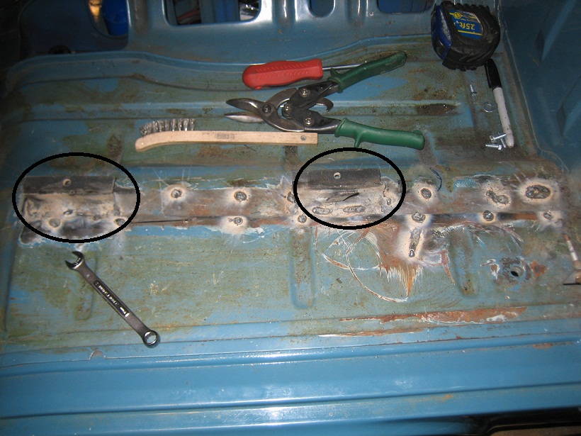

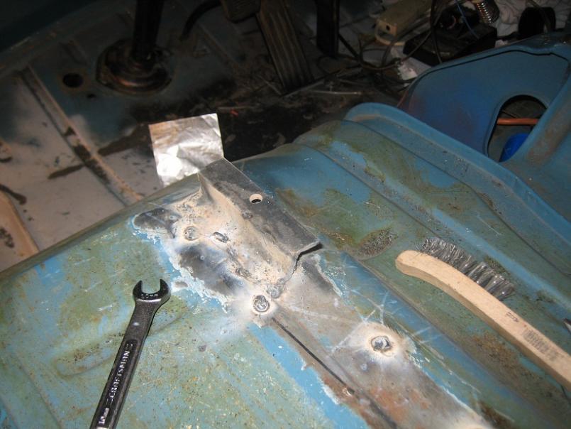

After cramping my mind with wiring diagrams, I decided it was time to figure out the front seat situation. I have captains chairs out of a later model bus and some feel that these are a bit high. After mocking up the bottom of the seat on the drivers side and sitting on it I quickly realized that it is too tall for me. My head was rubbing the headliner when I sat up straight. So, I opted to mount the seat pan directly to the body. One side of the body mount area was lower than the other so I made up some mount tabs and welded them in.

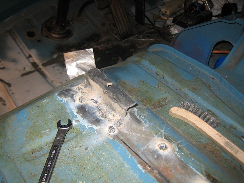

I also welded up all the holes from the old seat mount being drilled out. It was a stinky, smokey night.

The seat in position and the mount for the passenger seat being mocked up. I quit at this point as I need some more scrap metal to fab up a bracket for the passenger seat.
