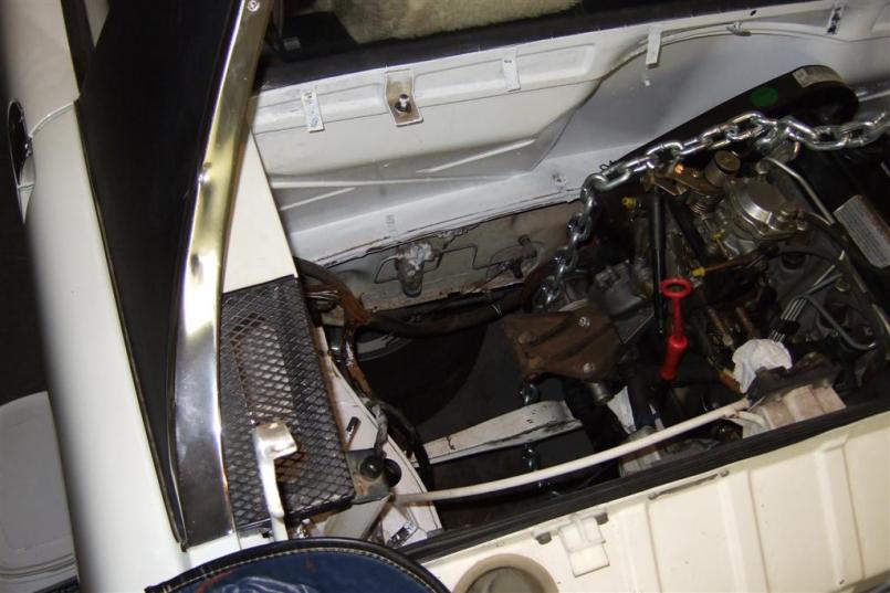

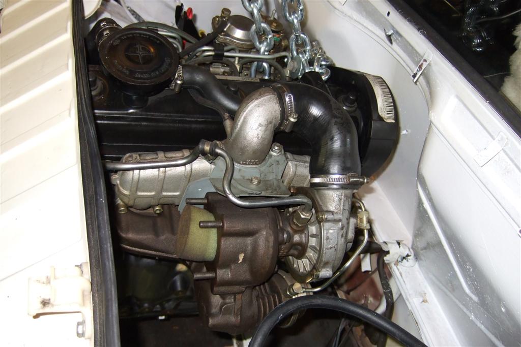

It's kind of in. The motor is laying on the old engine bracket. Still need to fabricate some kind of mounts and crossbar.
Thank you to whoever posted the picture of using 911 engine mounts, good idea. I've already put those in.

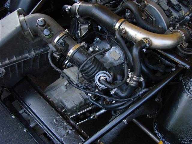

If that's a post '97 motor, then AFAIK any Audi/VW Passat transaxle (model 012 [nee Boxster])will bolt up to it. This would give you a modern 5 speed and only require a cable shifter (and no trans adapter plate). I think the stock CV's will bolt to the flanges; someone here has swapped an Audi/Boxster trans who may be better able to answer that question.

Given the torque that the diesel is putting out, I'd highly recomend using the 012 trans from the Passat. The best, would be one that was behind the same motor as the gearing will be MUCH improved. It would require converting your pedal cluster to accomodate a hydraulic clutch master cylinder. And you would also need to get creative for axles as the lengths will be different, as well as the flange diameter.
I did the above for my 1.8t conversion, and it is heads above in drivability over the 901 I moved from.
