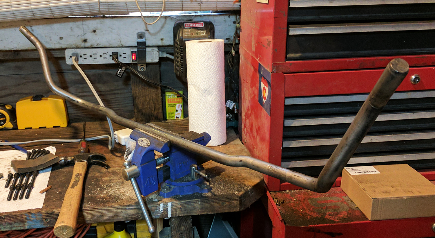

QUOTE(rdauenhauer @ Jan 1 2017, 10:38 PM) *
No front Sway bar?
I am running a Carrera front suspension with an under body sway bar. More on that soon!

22mm carrera sway bar, stripped and ready for paint.
