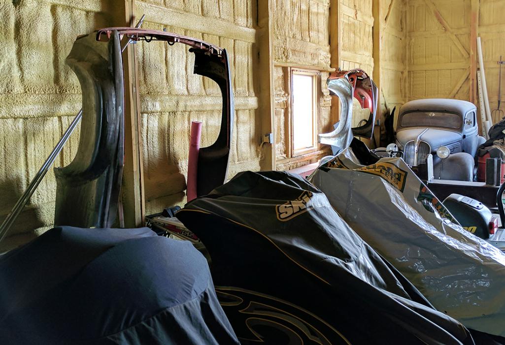

Where is the body now?
plymouth37
post Oct 10 2018, 04:11 PM
Post #1322
Posts: 1,825
Joined: 24-May 05
From: Snoqualmie, WA
Member No.: 4,138
QUOTE(Ferg @ Oct 10 2018, 03:59 PM) *
At my in-laws in Cheyenne WY
Both lids and intact front and rear, at least it is nice and dry there (IMG:style_emoticons/default/biggrin.gif)
I could probably split the nose and tail into 2 halves to help with shipping but don't really want to...

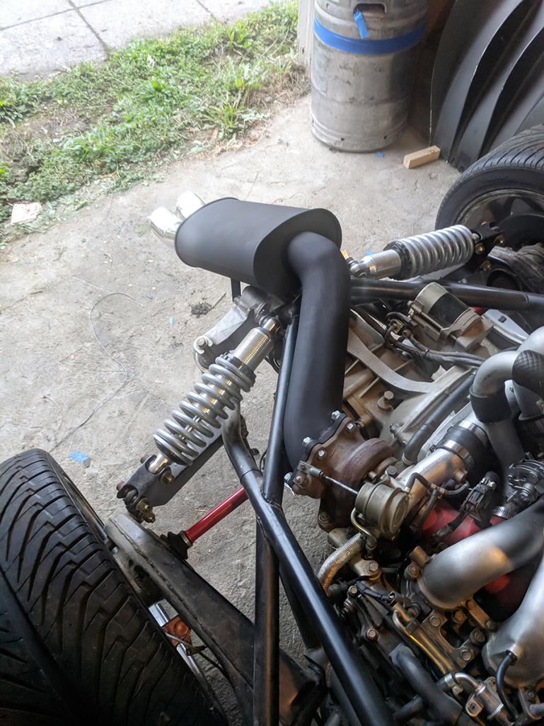

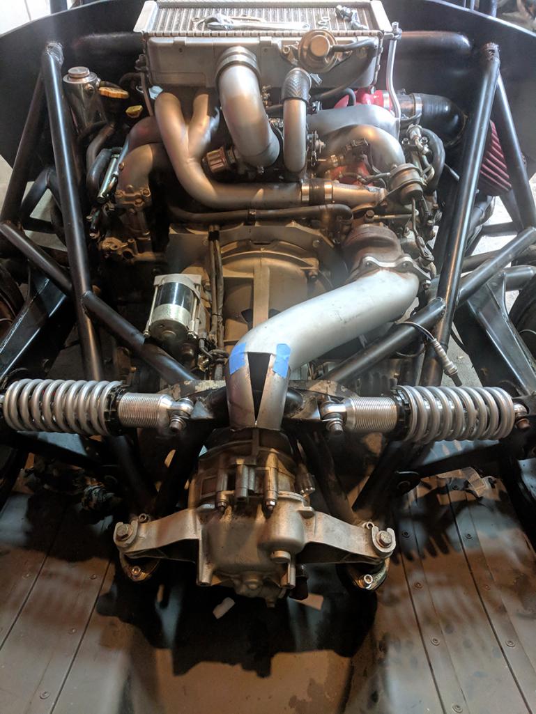

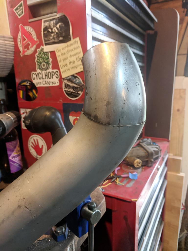

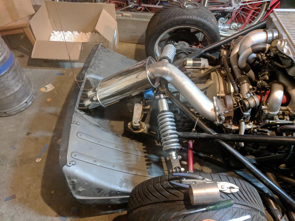

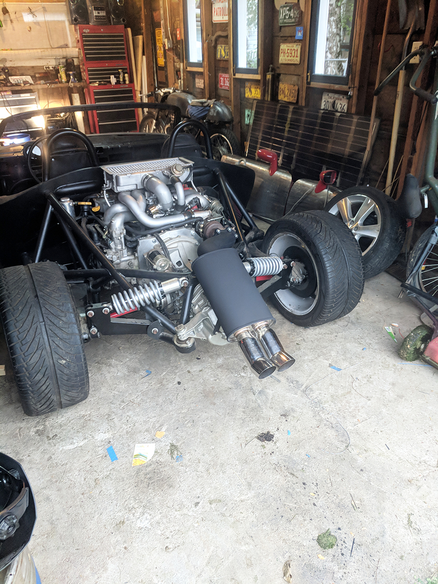

So the car is crazy loud, I thought the turbo would nock the noise down a bit but I really can't drive it with the level of exhaust note insanity that is coming out of this thing. I mocked up the diffuser, and yes, I am doing big double tips that center dump through the hole in the diffuser.
It is impossible to find the type of muffler I need with anything larger than a 3" inlet so I am making a funnel that necks it down while simultaneously bending around the cage and lining up a straight shot to the diffuser hole.
And here it is, my adapter bend from 4.5' oval to 3' circle, ohh shiny!
plymouth37
post Oct 11 2018, 11:24 PM
Post #1324
Posts: 1,825
Joined: 24-May 05
Member No.: 4,138

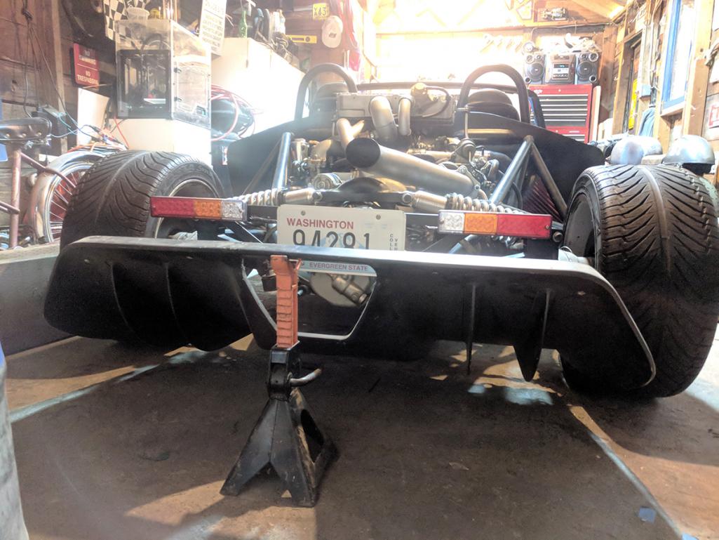

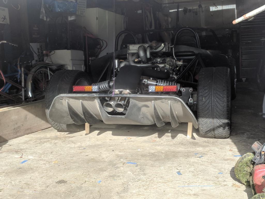

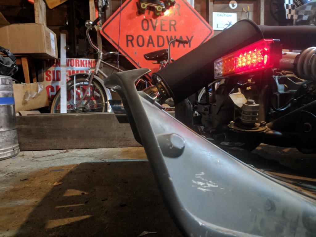

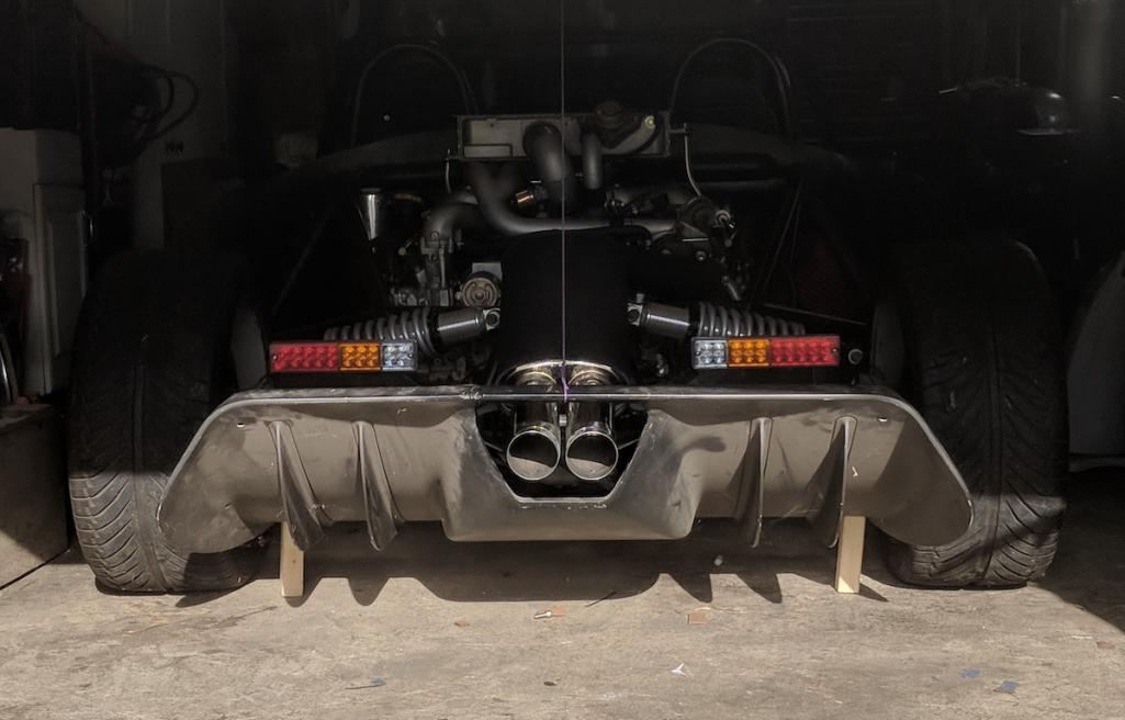

So space is pretty limited, and I felt like an integrated tip would help with packaging, I also figured out that my muffler would sit at about a 45 degree downward slope.
The DTM style mufflers have a 45 degree kick up of their tips when mounted "correctly" so when mounted at a 45 degree angle the tips are dead straight, perfect!
Got everything welded up and mounted, even used the stock muffler mounts on the tranny, muffler is stainless but way too much bling for my tastes, painted everything except the end cap and tips matt black. Fired it up to bake the paint and test out the sound, hard to tell without driving it but i think it sounds pretty good.
Nice stinger!
Here you can see the tip placement, pretty pleased with this. I also cut out the license plate holder from my temporary light bar and remounted it, plate is getting the zip tie treatment somewhere else for now.
It is still going to be a while before i mount the diffuser for real, might rework the rear opening a bit with fiberglass or do a trim piece but I think this is in the ball park as far as how I want it to look
Nothing like mounting dirty Ferrari parts with 2x2s and old wire, keeping it classy! (IMG:style_emoticons/default/biggrin.gif)
Should be nice and dry this weekend, looking forward to taking it out for a spin to see how it sounds at speed!

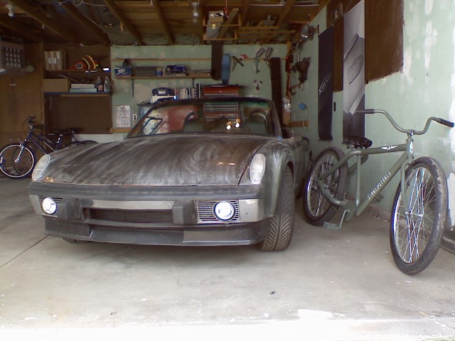

One of the things I really love—and appreciate—about this build is the lack of visual bling and colored/polished/etc stuff. Everything looks purposeful, and that has a cumulative effect that is very, very cool. I even liked the body in naked steel when you had it on the car, and the way you've respected so many elements of the 914 when you could very easily just throw them away. I am very curious to see which way you will go with exterior color...
Re: headlights and putting them where the turn signals usually reside, I am likewise curious to see what you will do there. The treatment has been done in the past, but I have set to see a result that looks right on the 914. As an addition or alternative (or focal point?), have you considered mounting one headlight in each bumper opening, cutting the top and bottom of the lights off with the upper and lower edges of the rectangle? Might be a nice look with the rest of your build, but it's a thought offered respectfully. This is one of the cooler builds going on a 914, and it's been fun to watch it go along.

Yeah, I don't know about the color, won't even pretend to know, the original phoenix red is a great color, so is viper green, and slate grey metallic, and classic Porsche silver, dark blue too. Once I buy paint we will know what it will be (IMG:style_emoticons/default/biggrin.gif)
In the last iteration of this car it had shaved popups and the KC hi-lights I am running now mounted in the fog light holes. That is always an option, not legal though (not that I care). I saw Neo-914s attempt and others, hopefully I can tread that fine line between new and old. worth a shot, although now that you made me find this photo it does look pretty good!
