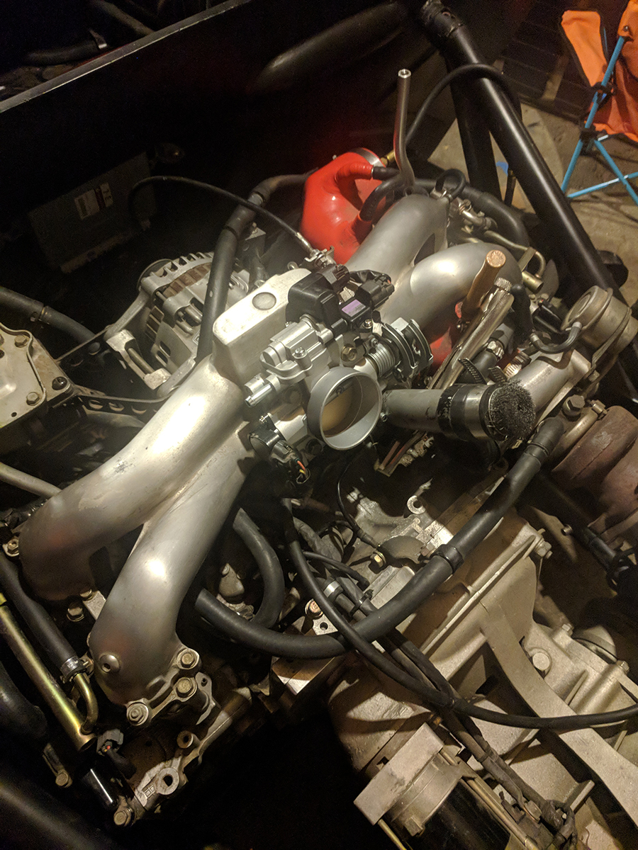

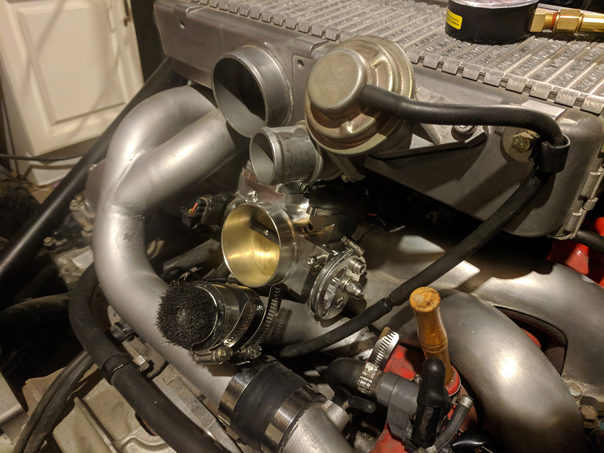

After driving the car a few weeks ago I couldn't help feeling that it wasn't as fast as I thought it should have been. My boost sender hasn't been working so on a hunch I pressure tested the intake. This is pretty easy to do, find the appropriately sized pvc cap to fit your intake and pop a couple holes in it. Screw in a couple schrader valves, then use random objects from around your garage to plug all of the ports in your intake. Once everything was sealed I tried to pressurize the system and found it failed to build any pressure at all, turns out the seals around the intake butterfly shaft in the throttle body were totally shot, I think this thing has been running on no boost!
I found a billet intake on ebay, I liked it because it was simple, didn't have all the stuff for cruise control etc... Unfortunately although this thing was machined pretty well i am pretty sure someone described over the phone to the machinist what it needed to look like, but neither of them had actually ever seen a WRX. Everything looked right but was totally a part for a car that doesn't exist. Needless to say i returned it...
Got a super nice remanufactured throttle body, should have done that to begin with, installed it and reassembled the engine, pressure tested, had to tighten a couple clamps and now it is holding 10lbs of pressure, once it stops eternally raining here I will take it for a spin, i think i just gained 150HP! (IMG:style_emoticons/default/driving-girl.gif)

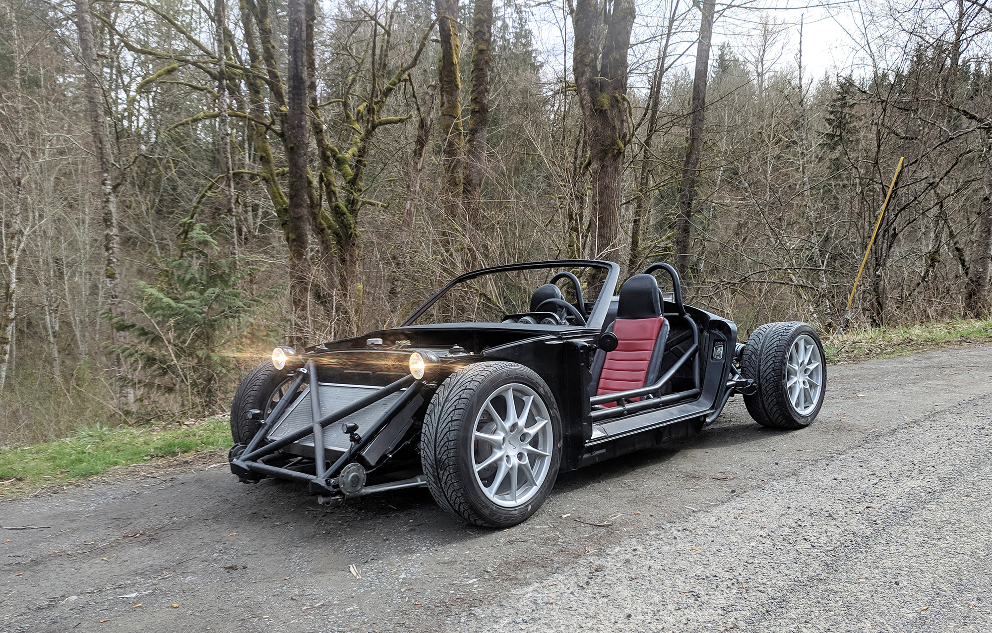

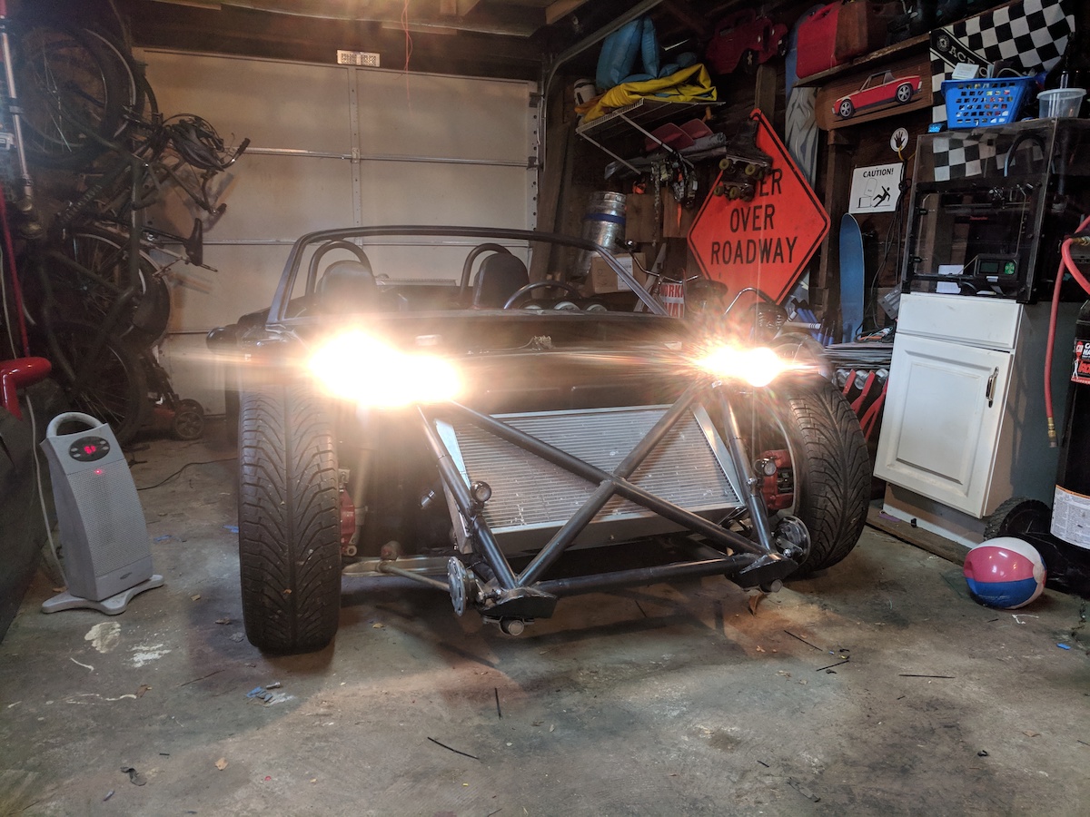

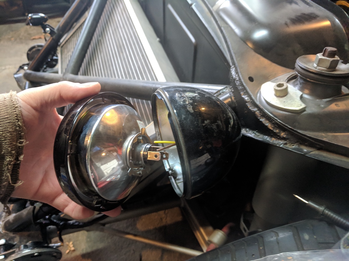

So I got a little spooked when I got pulled over the last time I drove the car, The officer was nice but he made it pretty clear he wasn't impressed. I decided to take another crack at increasing the legality of the car so it follows the law perfectly. One pretty obvious problem was the lighting on the front of the car.
Washington State law states that headlights need to be mounted at a minimum of 24" high to the center of the lens, so I moved the light buckets up to that height. It also states that turn signals need to be at least 15" high, so I moved those up to the old headlight mounts.
So these lights are just some old KC hi-lights that I used to run in the fog light holes in the bumper, and state law says that if you plan on traveling over 20 mph you need high beams. I will never run this car at night in this form so I just need to check the box, not actually create a functioning dual beam headlight. With this in mind I swapped in some H4 bulbs into the light buckets and wired them up, good enough for now! (IMG:style_emoticons/default/biggrin.gif)
There, "legal" front lighting! One less thing to worry about as I drive around in a naked car (IMG:style_emoticons/default/driving-girl.gif)

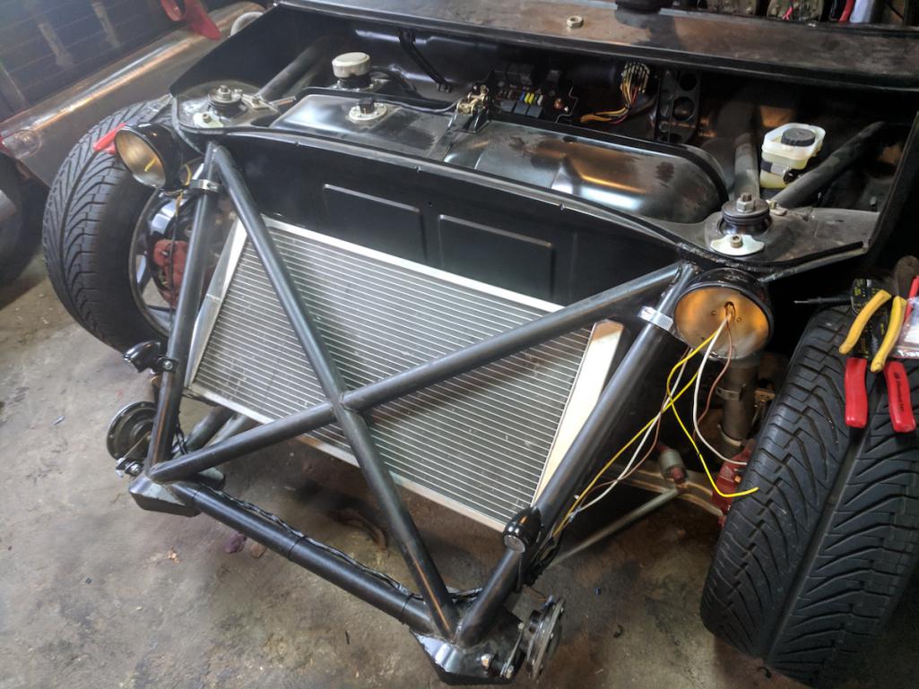

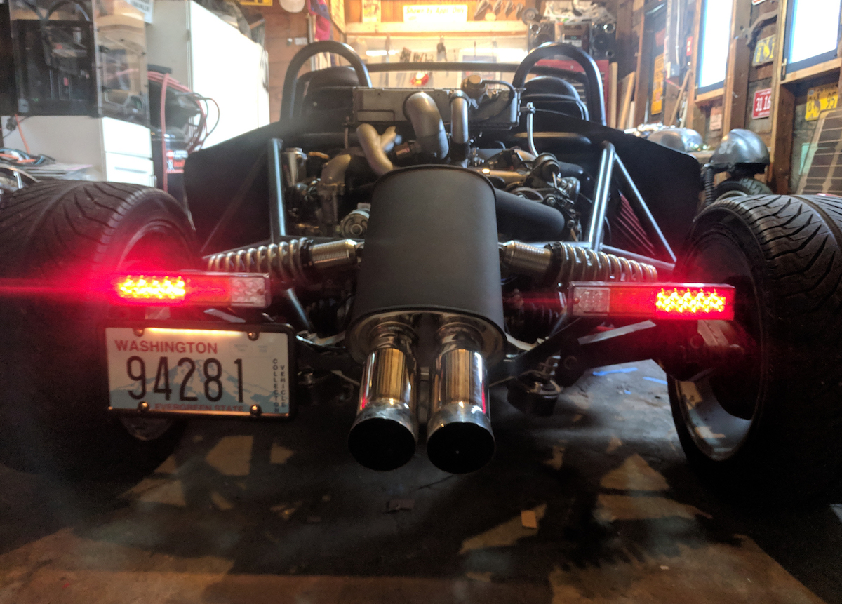

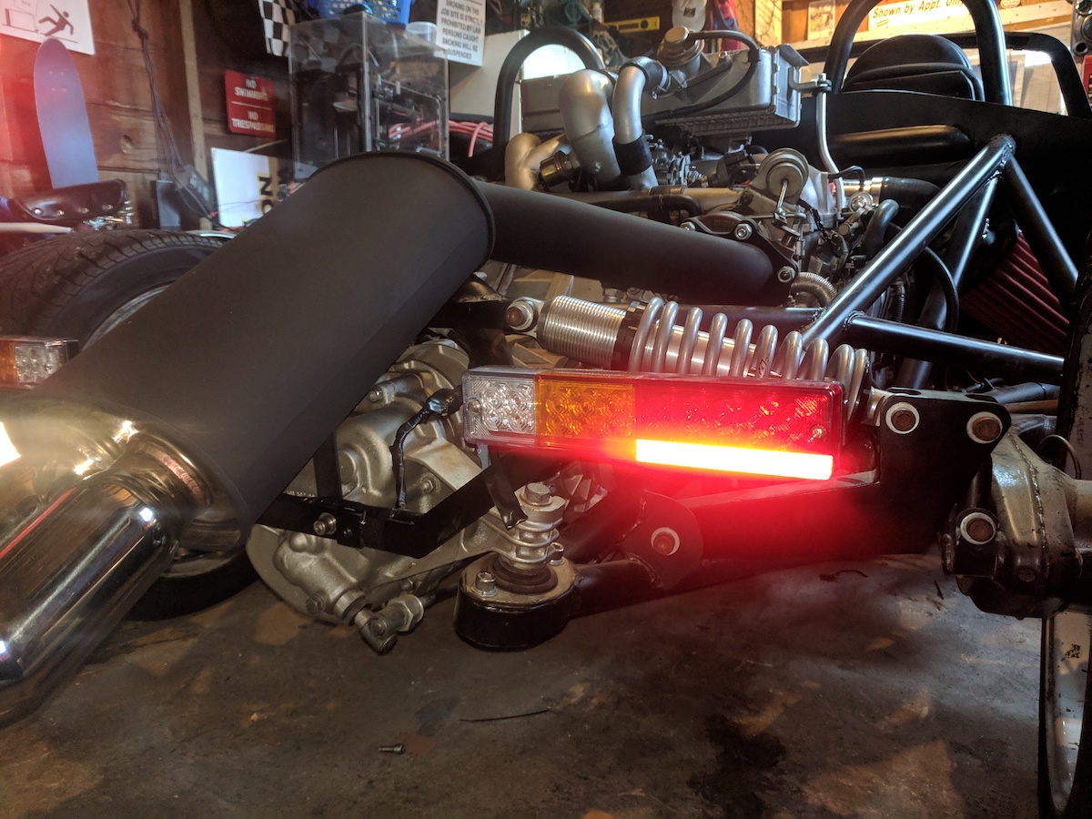

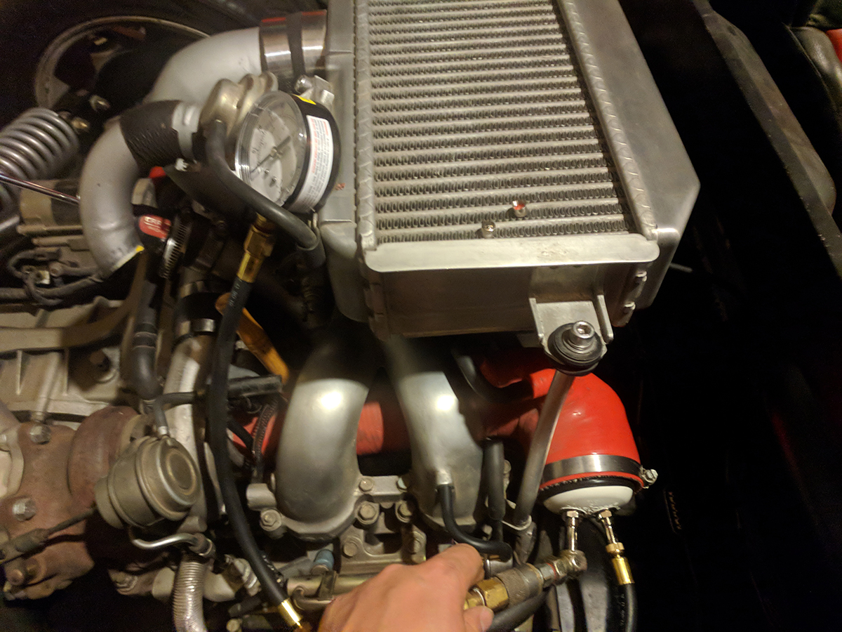

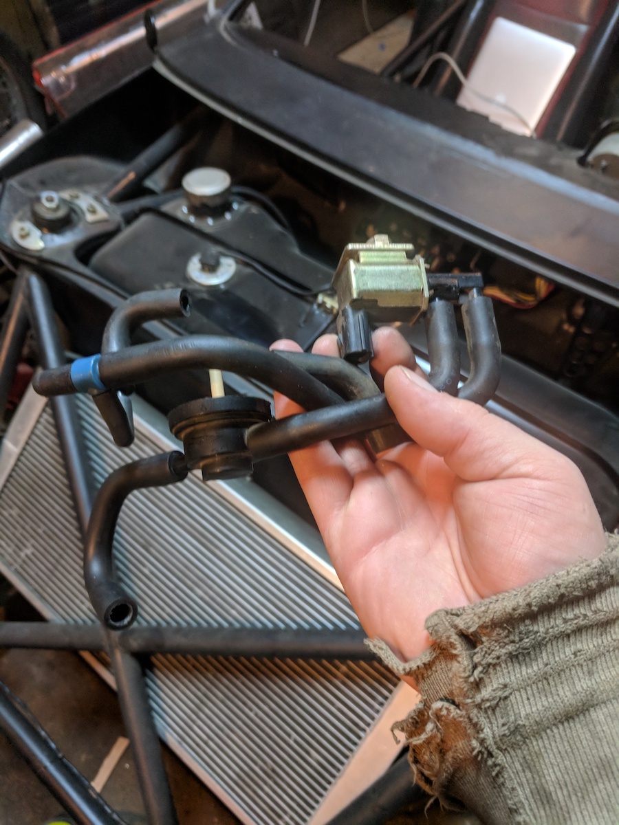

As I was plugging up my intake to pressure test it I started to ask myself what all of these vacuum hoses and controllers were in there for. Turns out these are part of the emissions system that purge the charcoal canister on the gas tank, the little doohickey is the purge valve, needless to say I don't have any canister or emissions anything so I gutted everything and capped the intake nipples, I was rewarded with the code "P0458 EVAP Emission System Purge Control Valve Circuit Low" but it doesn't throw it into limp mode so I will just add it to my list of codes to have programmed out when I get the ECU tuned. Less crap on the engine is a win for me!
Speaking of taillights from the earlier conversation, when I put in the muffler it eclipsed the spot I had made for the license plate, zipties weren't cutting it for Mr. Officer so I welded up a little bracket and hacked in some led lights into a license plate frame. There, that's legal too.
Finally the trailer lights i got didn't have reflectors which isn't legal, so I got some reflective tape on Amazon for $3 and stuck a strip on the lights, Check that one off too.
I think I do actually legally need doors, the law is pretty explicit about that, despite the plethora of doorless Jeeps that I see all over the place. Being the sitting duck that i am and that I guess the ultimate goal is to have a body on this thing eventually I am going to clean up and paint the doors next, stay tuned!

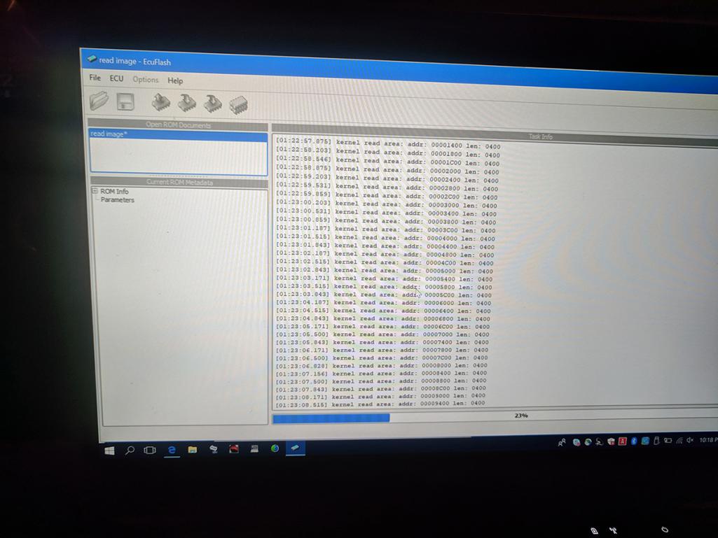

Well spring is upon us and my garage isn't quite so freezing, Lets get some work done!

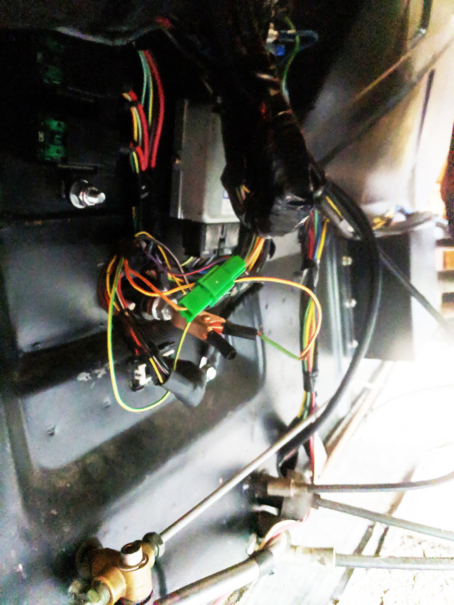

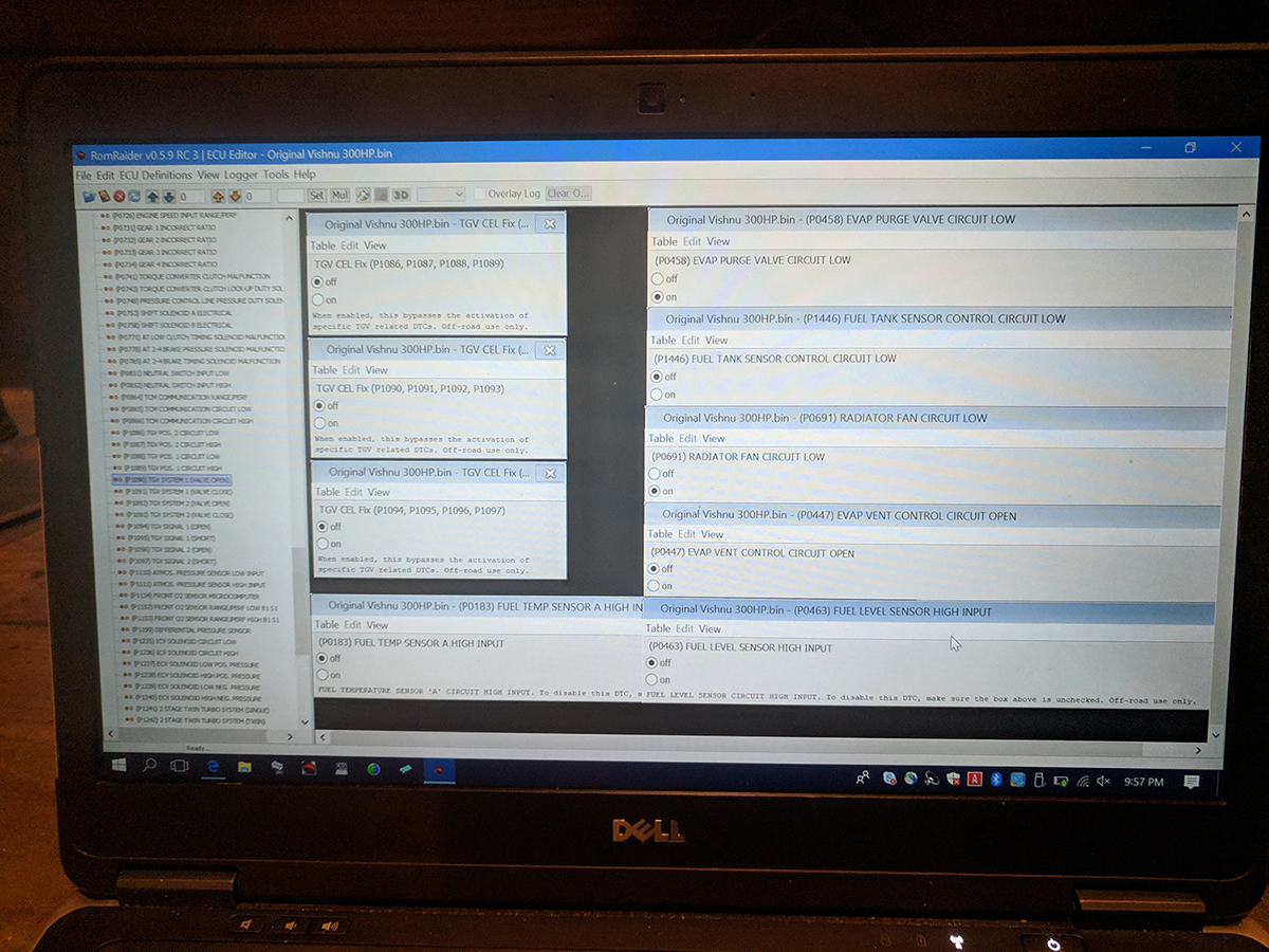

I had been running a stock ECU for testing just incase I shorted something out accidentally but now it is time to put in my Stage 2 ECU from Vishnu Tuning (IMG:style_emoticons/default/evilgrin.gif)
The tune on this should be a pretty good starting point but there are a dozen or so codes I need to turn off in order to get a working check engine light.

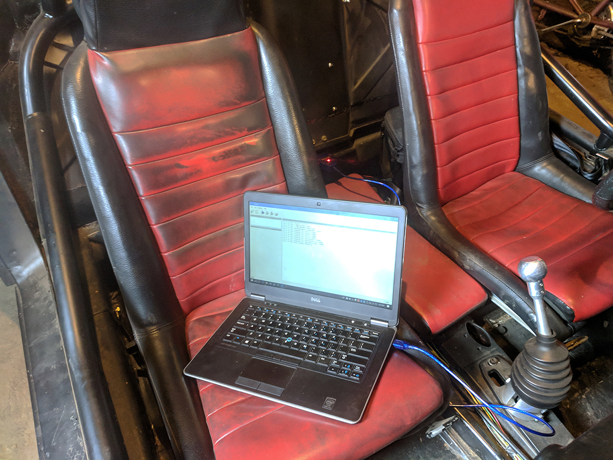

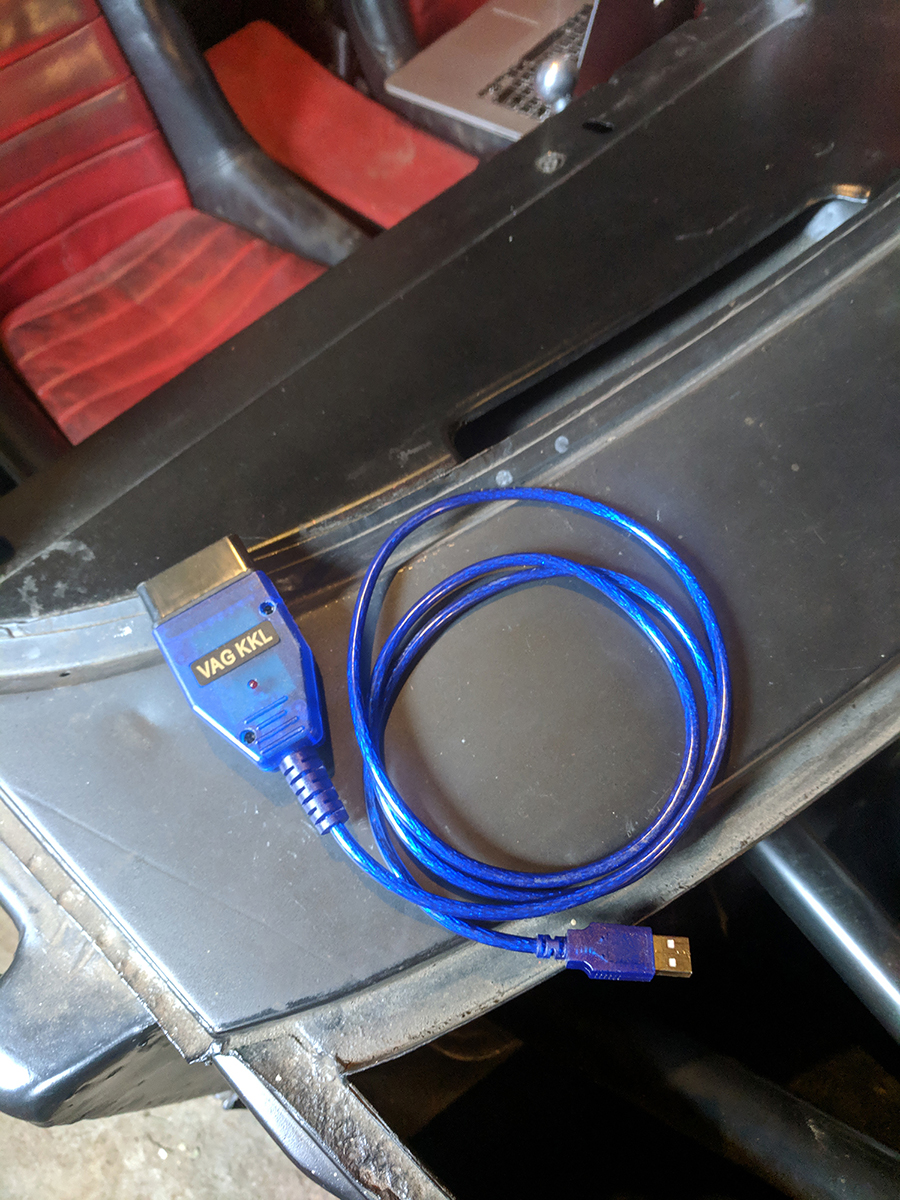

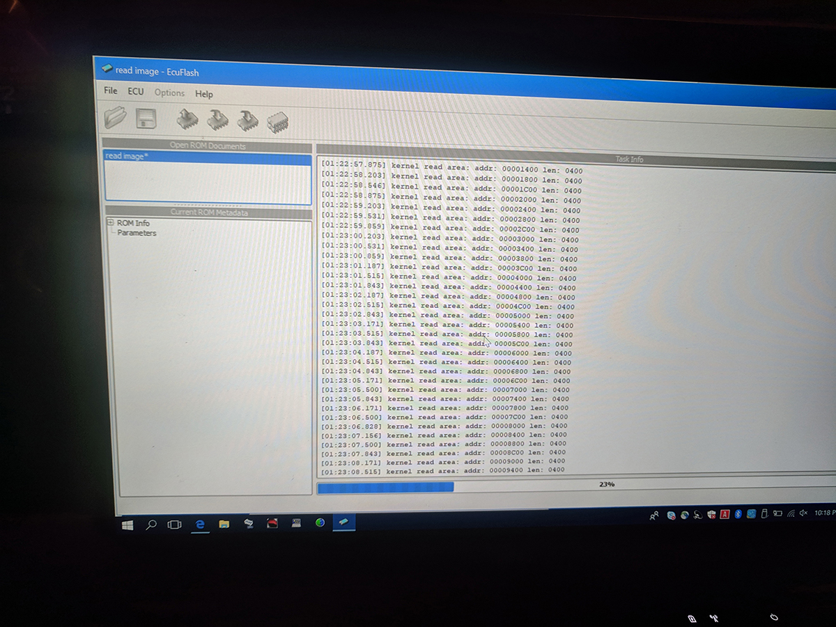

So here we go into the world of editing a car's Rom, and to do that we need a cable to connect my ECU to a laptop. I was initially looking at getting a tatrix tuning cable but these go for like $200 and this is a budget build, we can do better!
I bought this cable on ebay for less than $7...
https://www.ebay.com/itm/VAG-COM-KKL-409-1-...;frcectupt=true
I put the computer into read mode by connecting the green test mode connectors, and then gave pin A10 on the ECU 12V to trigger write mode.
I then plugged the computers together.
To read and write images to and from the ecu I downloaded EcuFLash for free (you need v1.29 or earlier to use the cheap cable).
I successfully downloaded the ROM from the ECU. Now off to Romraider to edit it!

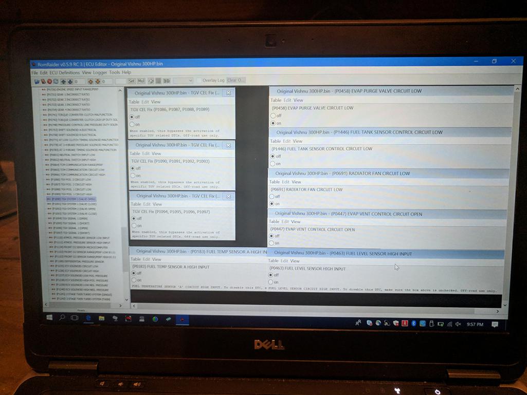

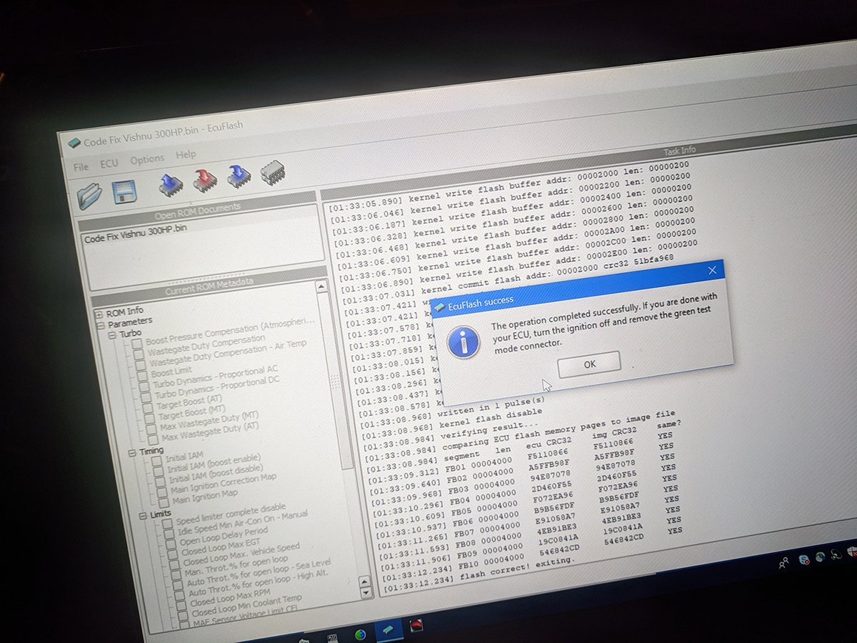

Like EcuFlash, RomRaider is also a free program, you use it to edit the Ecu's Image. I am not going to delve into tuning right now, the goal is just to turn off the error codes that are no longer relevant to this vehicle. To do this select the error code you wish to edit from the menu on the left, open it, turn it off, then close it.

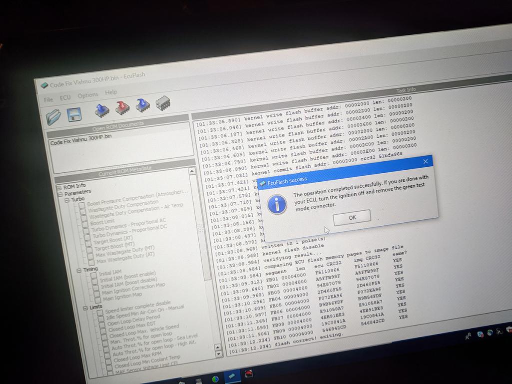

Then after I saved the new edited image, I wrote it back to the ECU. Done, $7 tuning package, heck yeah!

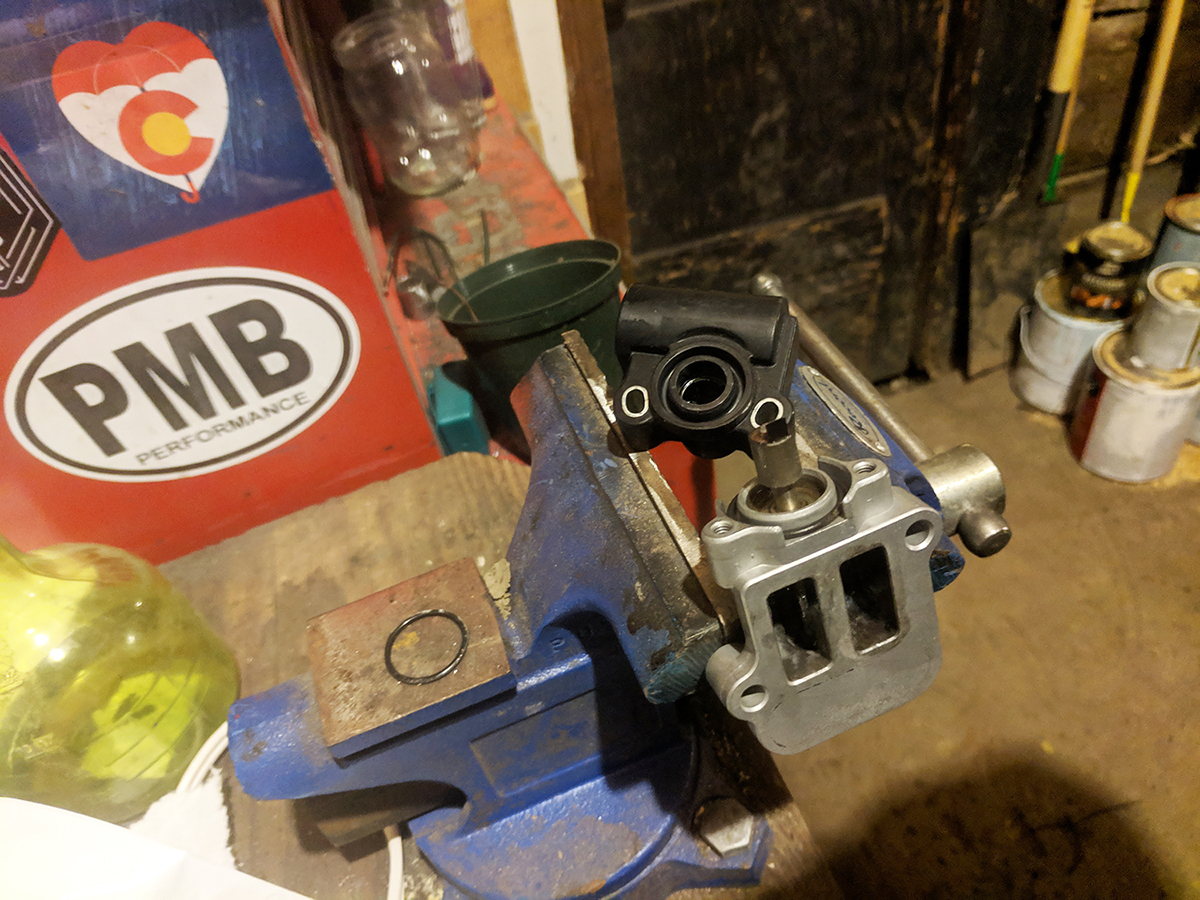

I noticed an interesting thing while I was turning off the codes, p0508 Intake Air Control Valve Error, I had initially thought that this was an inaccurate code because I had deleted the coolant hoses to this controller but after I thought about it that didn't make sense, more likely it was gummed up and causing some of my rough idle conditions. I decided to leave the code in place and pulled out the IACV and cleaned it thouroghly. I was totally right, car ran so much better on startup after a good cleaning.
Ran a test and got a clean bill of health! Now I can hook up a check engine light and have it mean something!

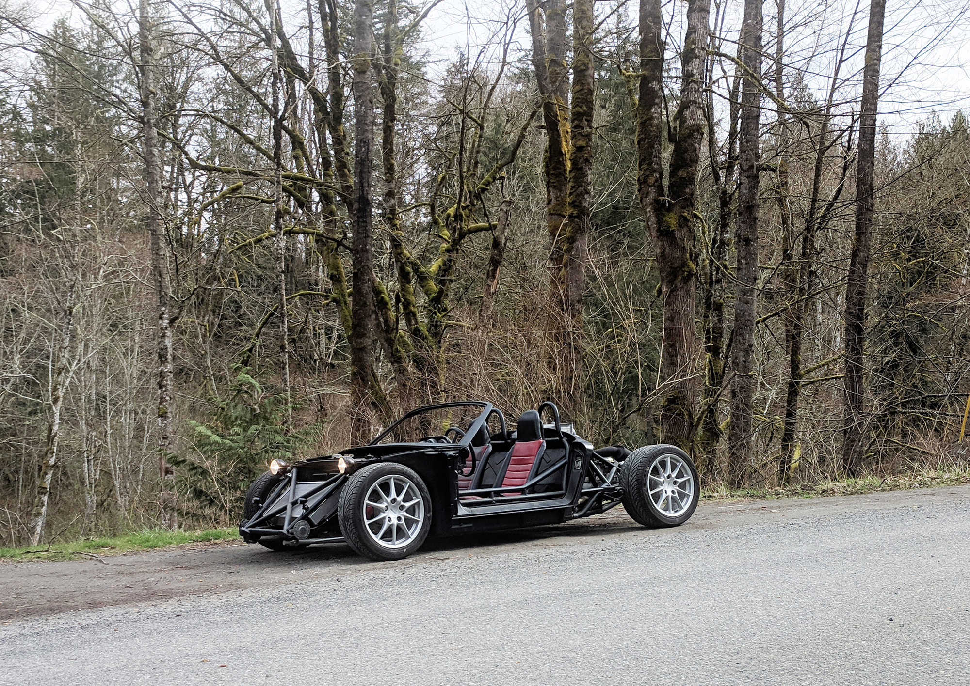

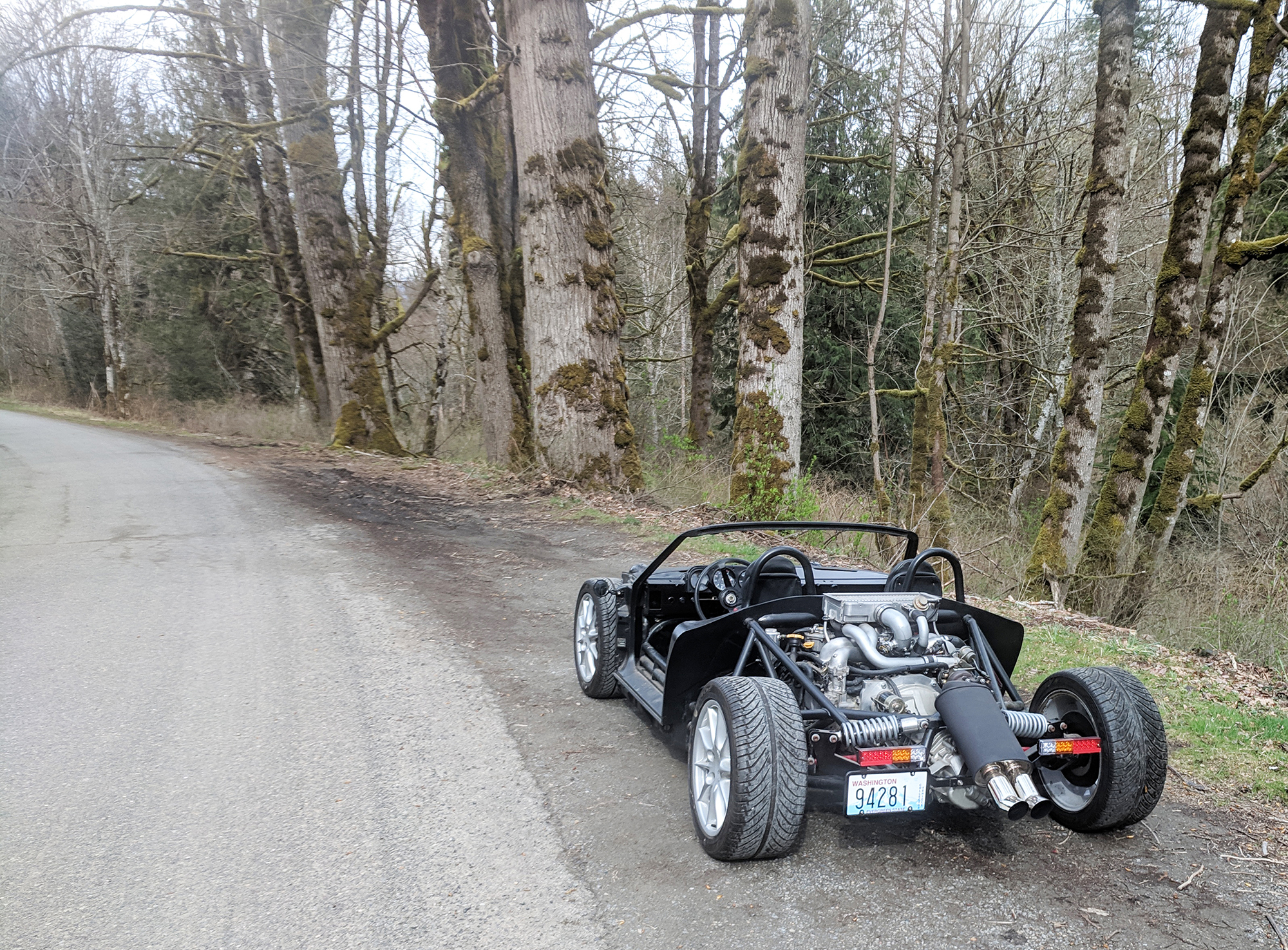

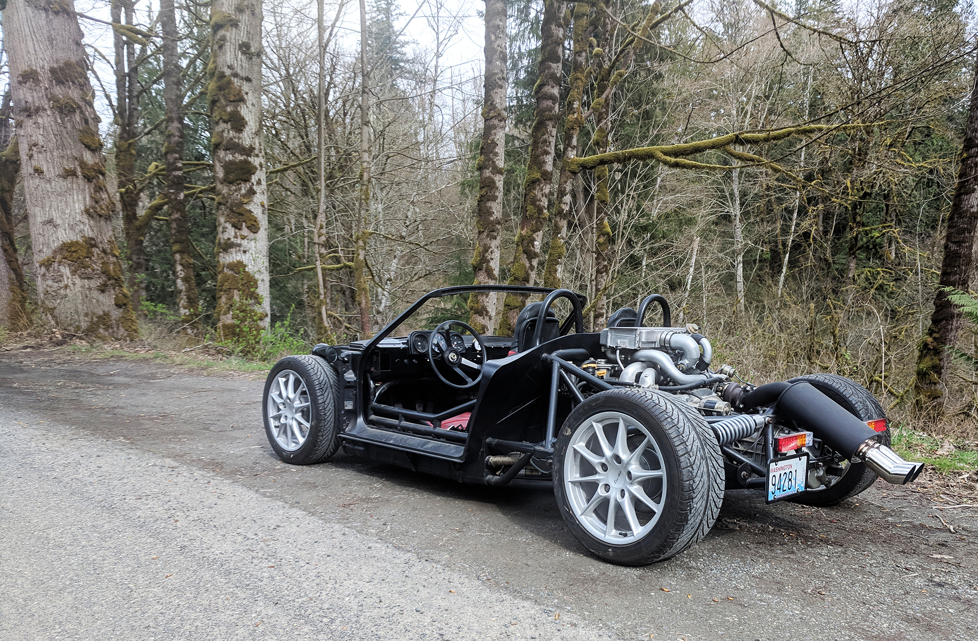

Took her out and I can confirm that we have full boost, and a legitimately scary amount of power, this thing is a monster, what have I built???
