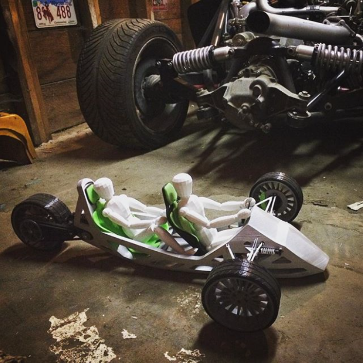

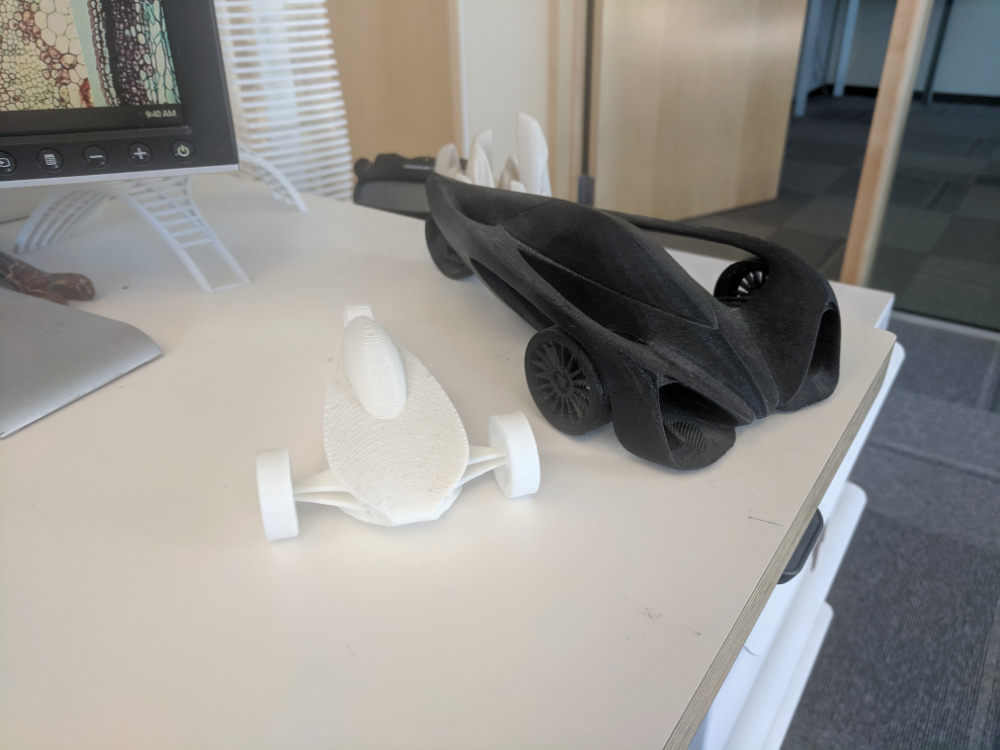

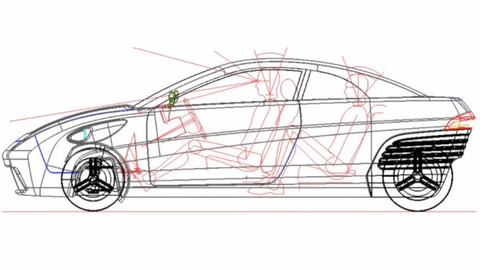

I have actually, my thesis in grad school reimagined Bucky Fuller's Dymaxion car as a modern sports car, retaining the 3 wheel configuration and rear steering, still have the first and last study models from that project on my desk at work.
Fully designed and modeled the chassis and suspension too:
As for the 914 body, I would love to keep it fairly stock looking, too easy to fall into bad kit car territory with these cars, but reproducing the modified flared body in full carbon is definitely on the table if I get bored enough (IMG:style_emoticons/default/biggrin.gif)

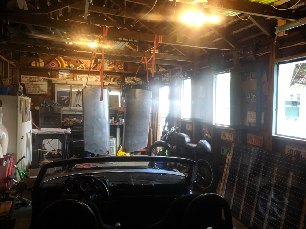

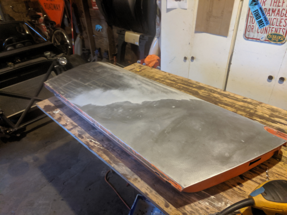

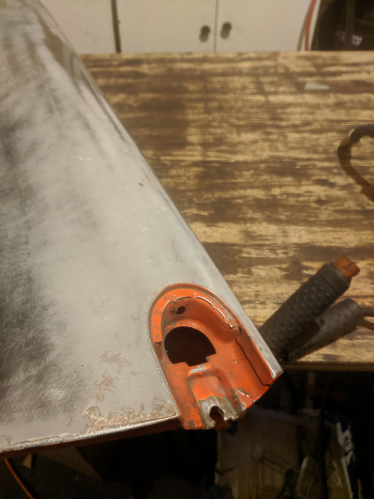

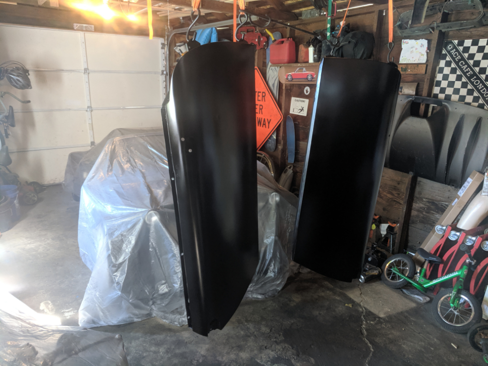

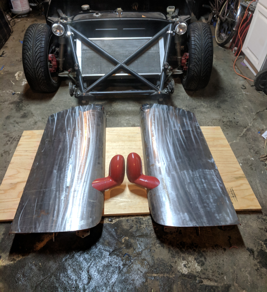

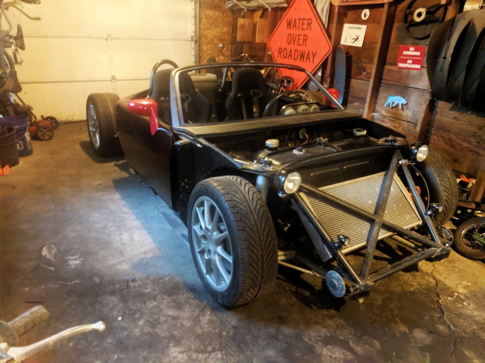

Time to tackle doors, as far as all body components go I am just welding up any damage that requires it, ignoring the dents, and throwing some paint on them, once the dry fit is totally complete at least the exterior of these will get stripped and bodywork will commence for real, still got a few years before that though!

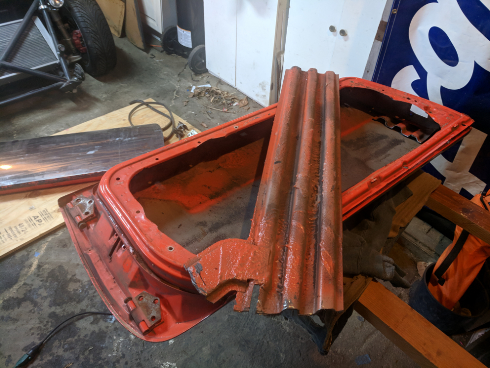

I stripped the doors down and then removed the other crash bar, I pulled the other one about 10 years ago and never got around to this one.

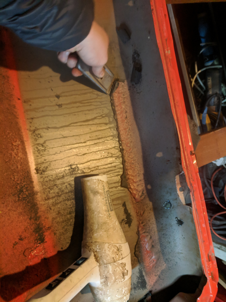

then I scraped the tar from the insides of the doors.
Repaired any damage that required a welder.
And stripped the clear that had been on there since my Vegas days.
plymouth37
post Jul 1 2019, 11:22 AM
Post #1404
Posts: 1,825
Joined: 24-May 05
From: Snoqualmie, WA
Member No.: 4,138

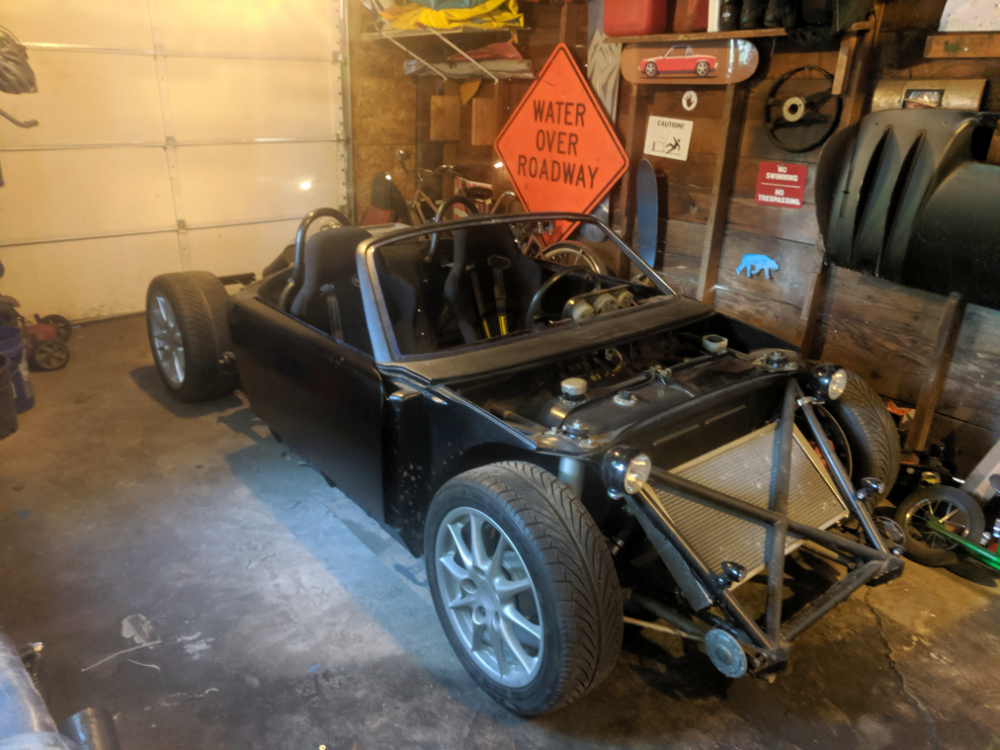

I got them all stripped and hung up.
Primed and painted.
Then threw them on the car, mirrors and latches next!

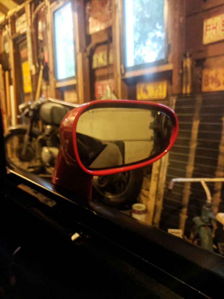

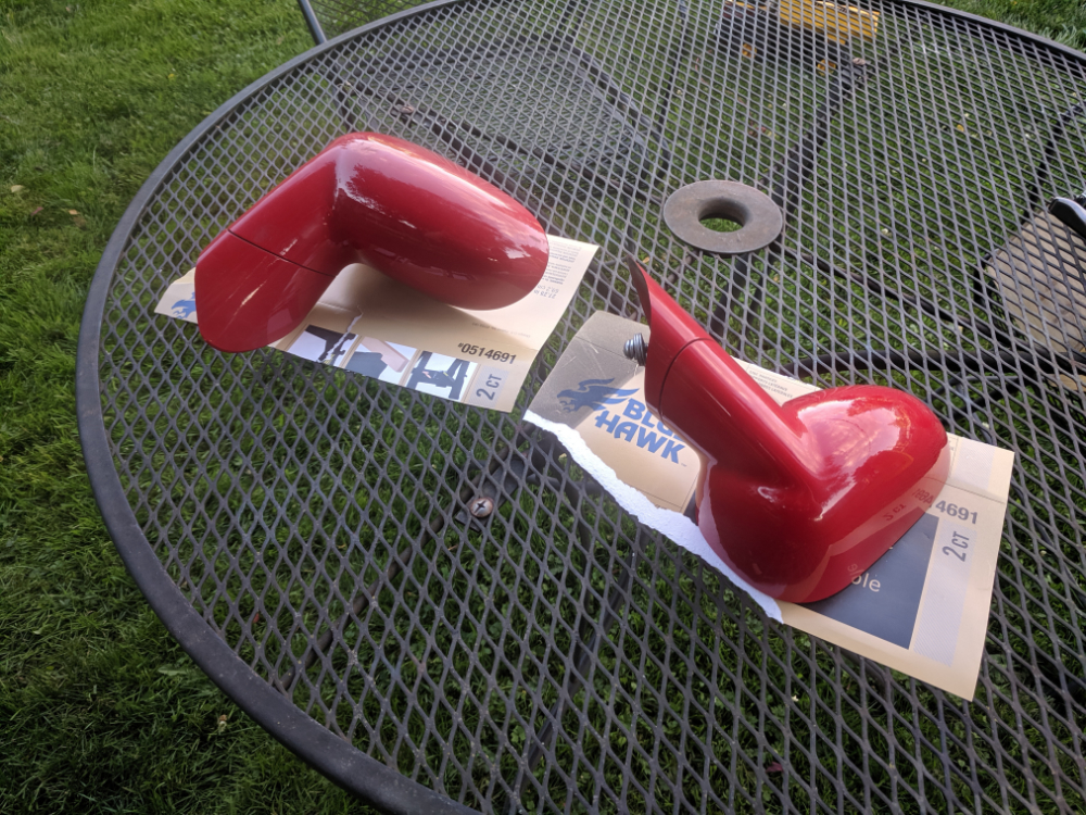

I polished up my Solstice mirrors
and put them on, just going to leave them red for now, they match the other red accents on the car as it is. More on how I got them to fit Here
Behold, the Pontiac goodness...

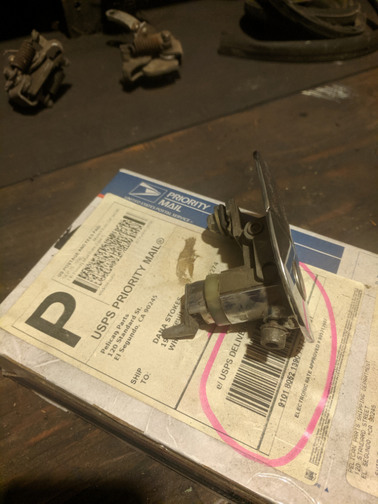

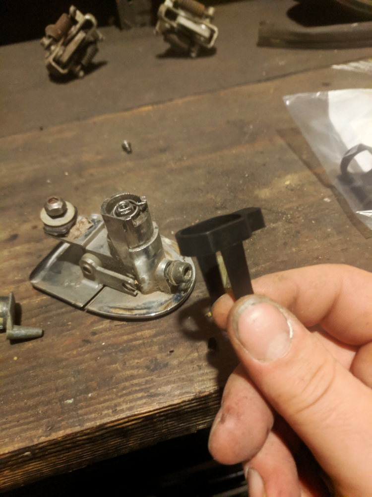

This package has a funny story, if you look closely the date on it is from way back in 2006, when I moved from Vegas to Wyoming, somewhere along the way my door handle broke. I ordered the replacement part from pelican, and as soon as I got the car to my new house in Laramie I pulled apart the door to fix the handle. If you look back at the 13th post on this thread you will notice that the first thing I did on this build was cut out the crash bar in the door, then the second thing was cut off the targa top. This little twist of fate created this build, if I hadn't pulled that door apart I may not have even started this journey.
Well here we are 15 years later, time to finally fix that handle!

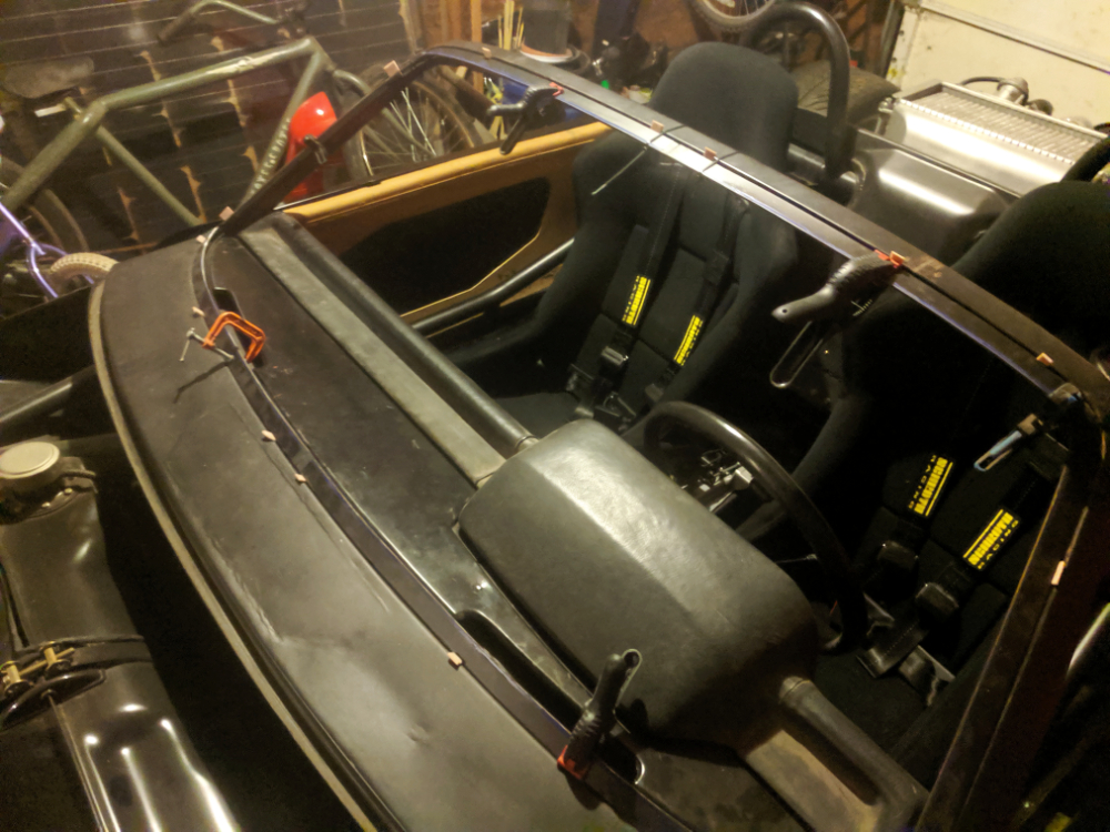

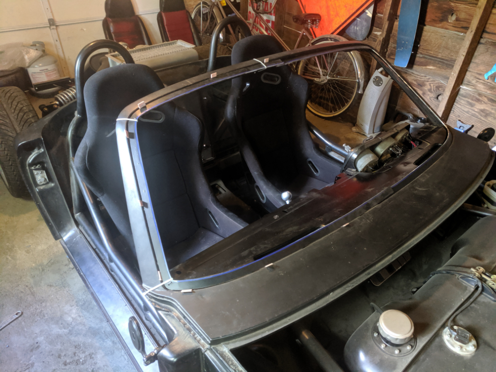

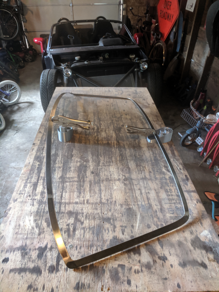

The windshield frame has been a challenging piece to fabricate but it is coming along! I took all of the rough cut pieces I made back in April (here) and welded them into two halves of a frame.
Then I used spacers to make sure it was positioned perfectly on the car and trimmed the halves to fit together perfectly
Then welded it into one piece, getting there, might buy some polycarbonate this weekend!
Sneak peak, I have been working on mocking up the interior components as well, more on that in a bit!
