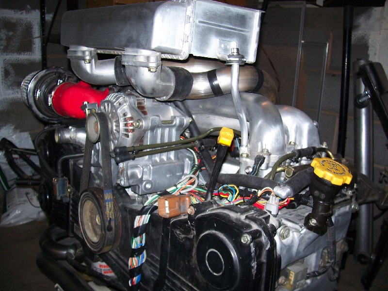

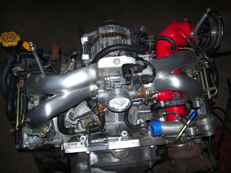

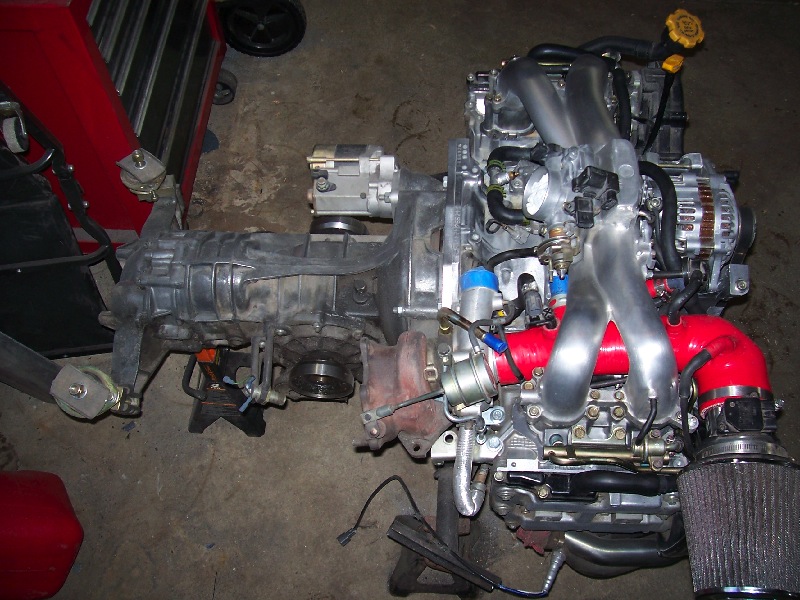

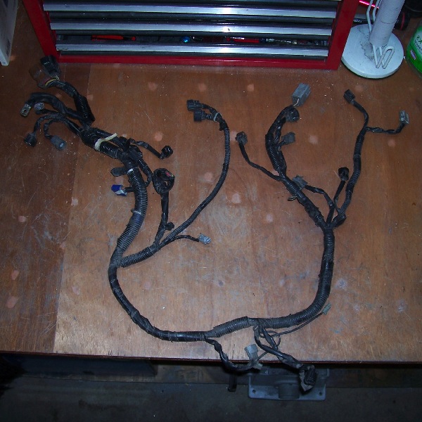

I installed the intake and the snake's nest of vacuum hoses that is associated with it.
Then I started working on the engine's wiring harness:
First I zip tied the harness into its basic stock shape and stripped off most of its insulation.
plymouth37
post Feb 17 2010, 03:29 PM
Post #492
Posts: 1,825
Joined: 24-May 05
From: Snoqualmie, WA
Member No.: 4,138

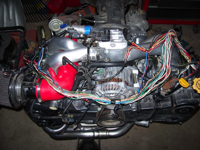

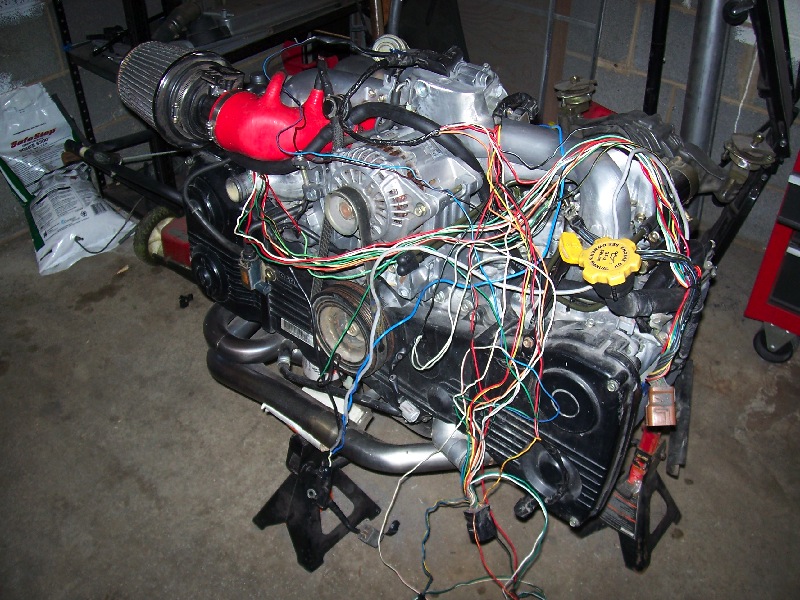

Then I loosely installed the harness on the engine.
Here is the harness half way through me re-routing the wires, I also added a couple wires to the harness for my boost and temp gauges.
This is the point at which you wonder if your car will ever run again.
plymouth37
Post #493
Posts: 1,825
Joined: 24-May 05

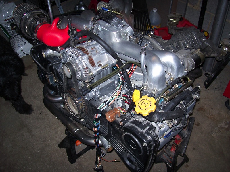

Member No.: 4,138
After tucking, re-routing, and eliminating the plugs for the TVG assembly and a/c pump, this is how things looked, after I get it running and work out the bugs I will pull the harness and wrap it.

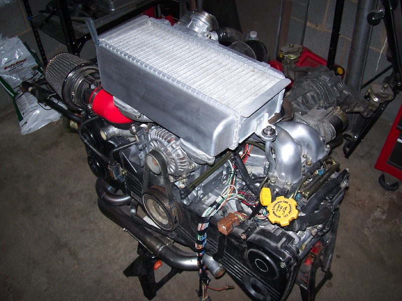

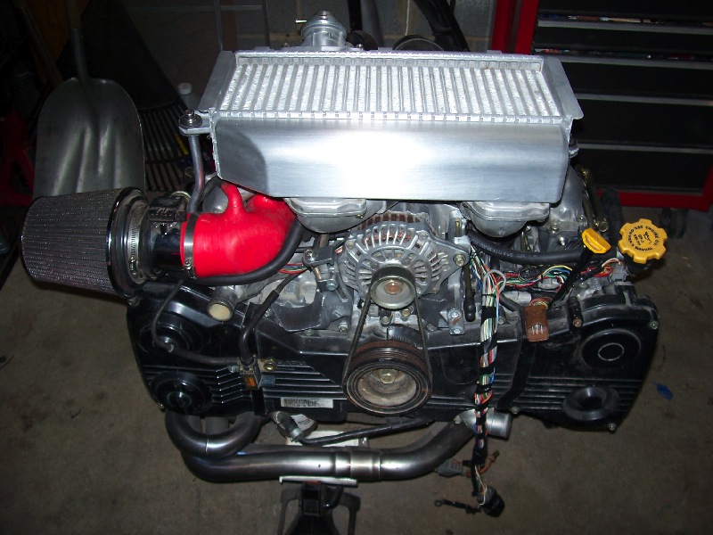

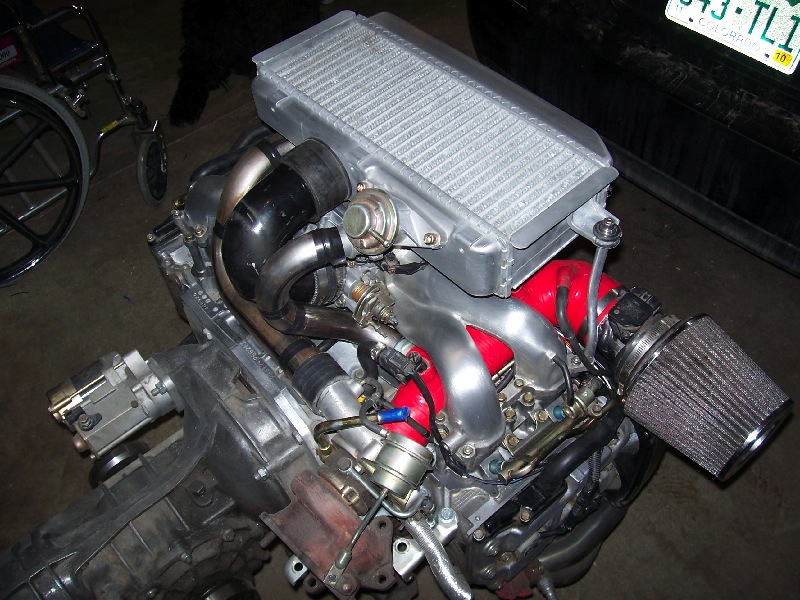

Last night I brushed the intercooler and installed it, I still need to get a bottle of gas for the welder so the intercooler tubes are taped together for now.
I still have a couple little things here and there to do to the engine but overall it is pretty much complete.

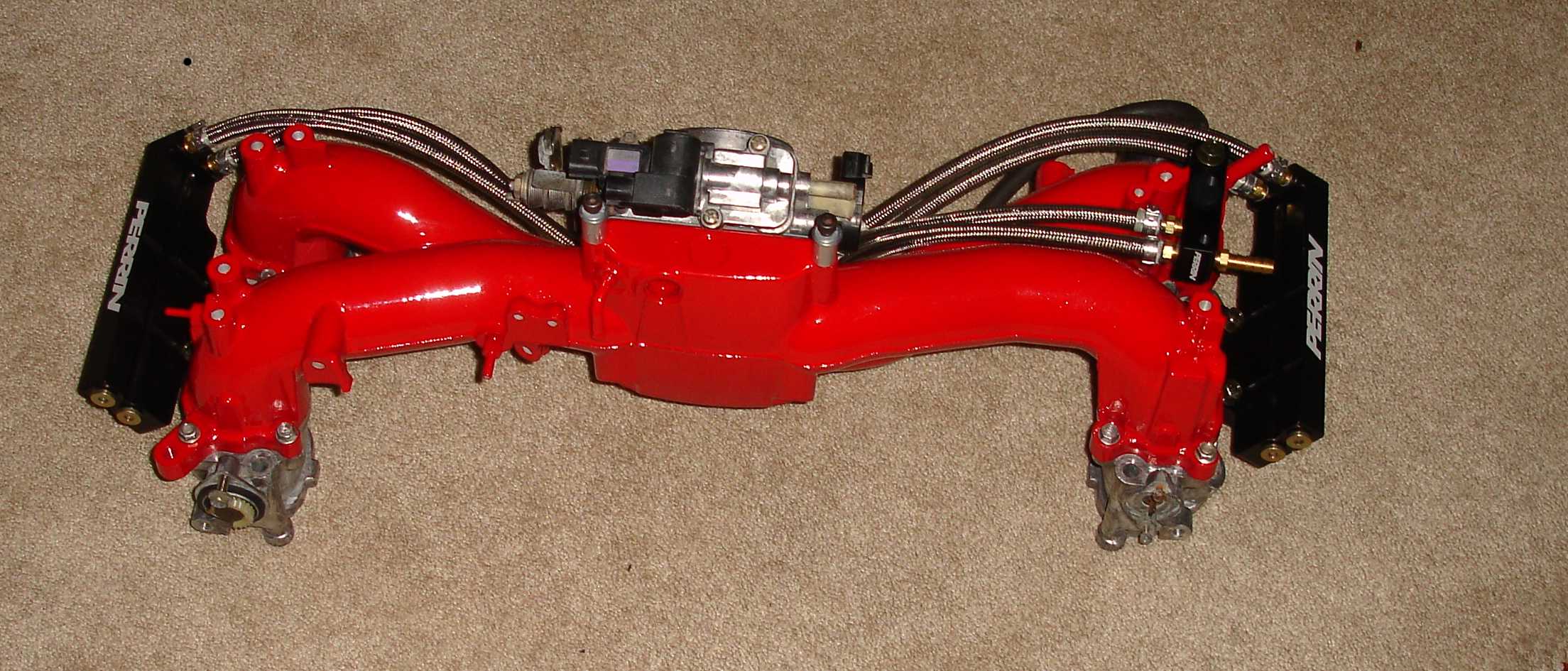

Now if you wanted to get rid of all that annoying FI plumbing underneath the intake manifold change over to Perrin fuel rails....Prettier and supposedly more efficient too.
Ed

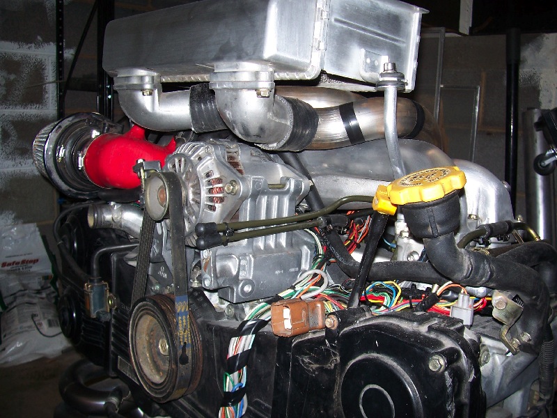

Just wanted to thank Marc (KELTY360) for making a kickass donation to the project.
Here is the original oil filler:
And the SVX filler he sent me:
This a pretty nice upgrade to WRX powered teeners, it looks a lot better and makes for a much more rational location for filling the oil. It was not a direct bolt on, the tube that fits into the head is a couple millimeters to big and needed some light filing to fit, the mounting holes were also a little too wide and needed to be slightly ovaled. It was an easy mod, 10 minutes or so.
Thanks again Marc!

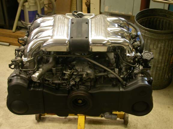

Wow! That really opens up the view of that section of the engine. Your engine is looking great. I've really come to appreciate the underlying simplicity of the Subie engines, once all the modern complexities are stripped away. Glad I could help.
Just for a little more Subie bling, here's a shot of the SVX that's going in my Syncro Westy. Couldn't resist getting the intake polished. As you can see, I went to the Sir Andy School of Photograpy. (IMG:style_emoticons/default/wacko.gif)
Hijack over....now get back to work on the Biter. The 914 Nation awaits your progress.
