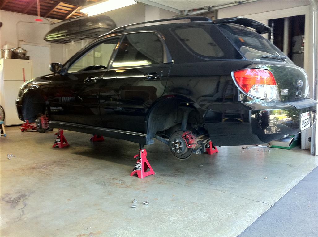

I bought a few things for the car while it has been over at andrew's getting painted.

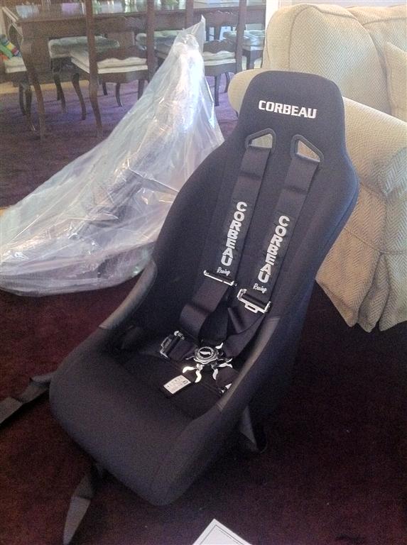

corbeau clubmans... (2 of them and harnesses)

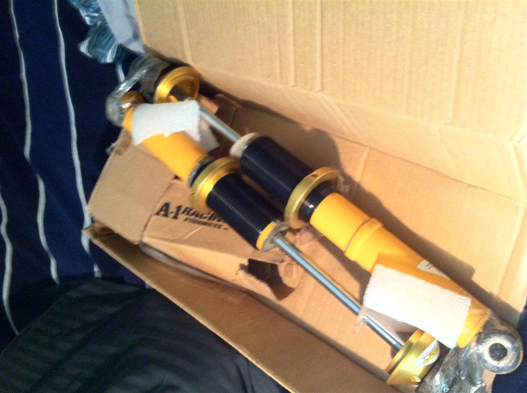

koni yellows with threaded collars (I need springs for these, does anyone have 2.5" ID springs between 140-200#??)

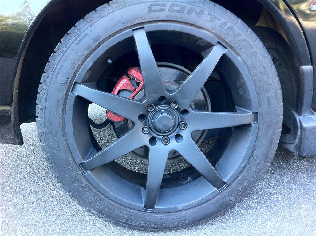

I also felt the need to re-paint my subaru wheels.
When it's not one car, its another...
painted wheel....
all together....

Nice wagon. Now I understand your Subaru engine inspiration. My wagon makes me want an EJ25 in the 914 too!
malaga_red75
post Aug 4 2011, 12:41 AM
Post #132
'74 2.5L N/A Subie
Posts: 454
Joined: 5-March 06
From: Menlo Park, CA
Member No.: 5,674
QUOTE(matthepcat @ Aug 3 2011, 07:15 PM) *
oddly enough, I actually had started the 914/subi project before I got my wagon. But I had always thought the wrx wagon was a great car.
227hp
4 wheel drive
enough room for my drums or 4 guys and ski gear.
and 30mpg.... errrr if im driving 65mph the whole time.
gotta love it.

So I have the Koni Yellow's and I am looking for a set of springs for them.
What is the right height to get for the spring? I have about 4-6" of threads on the collar to work with, but I want to lower the car 1-2" overall from stock height.

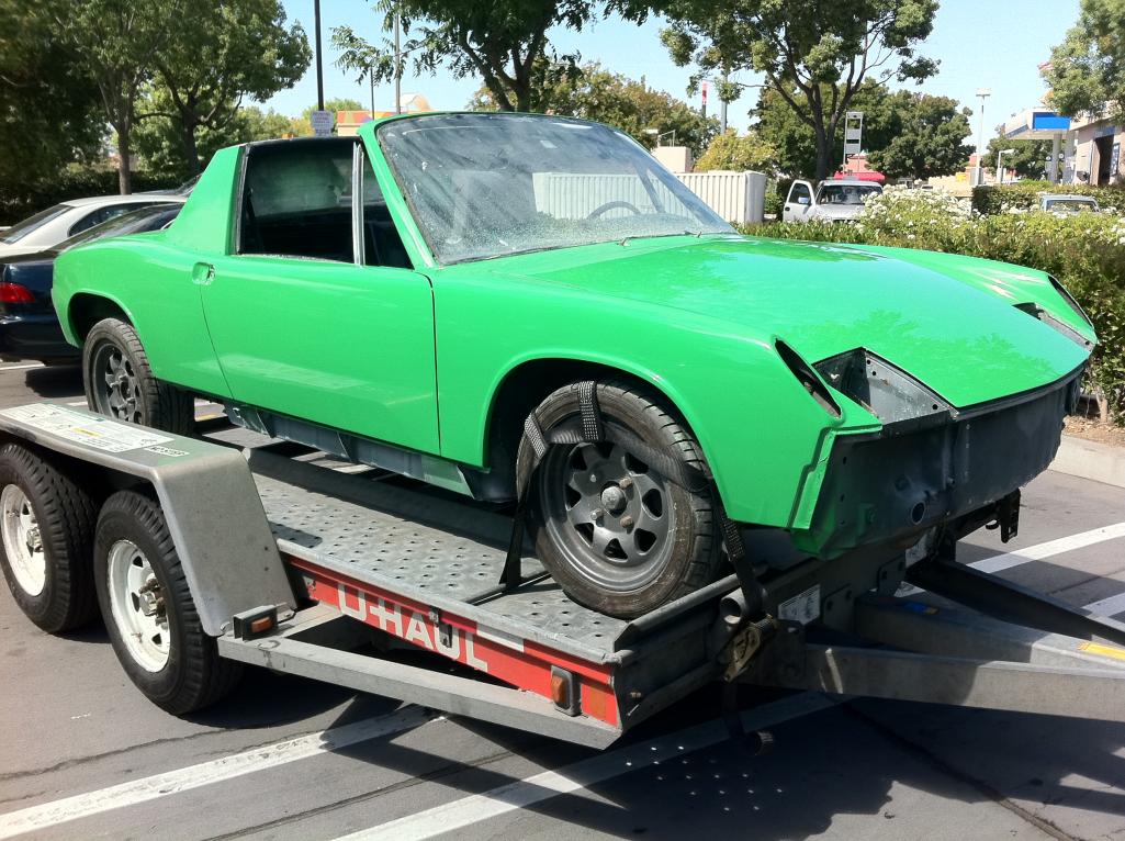

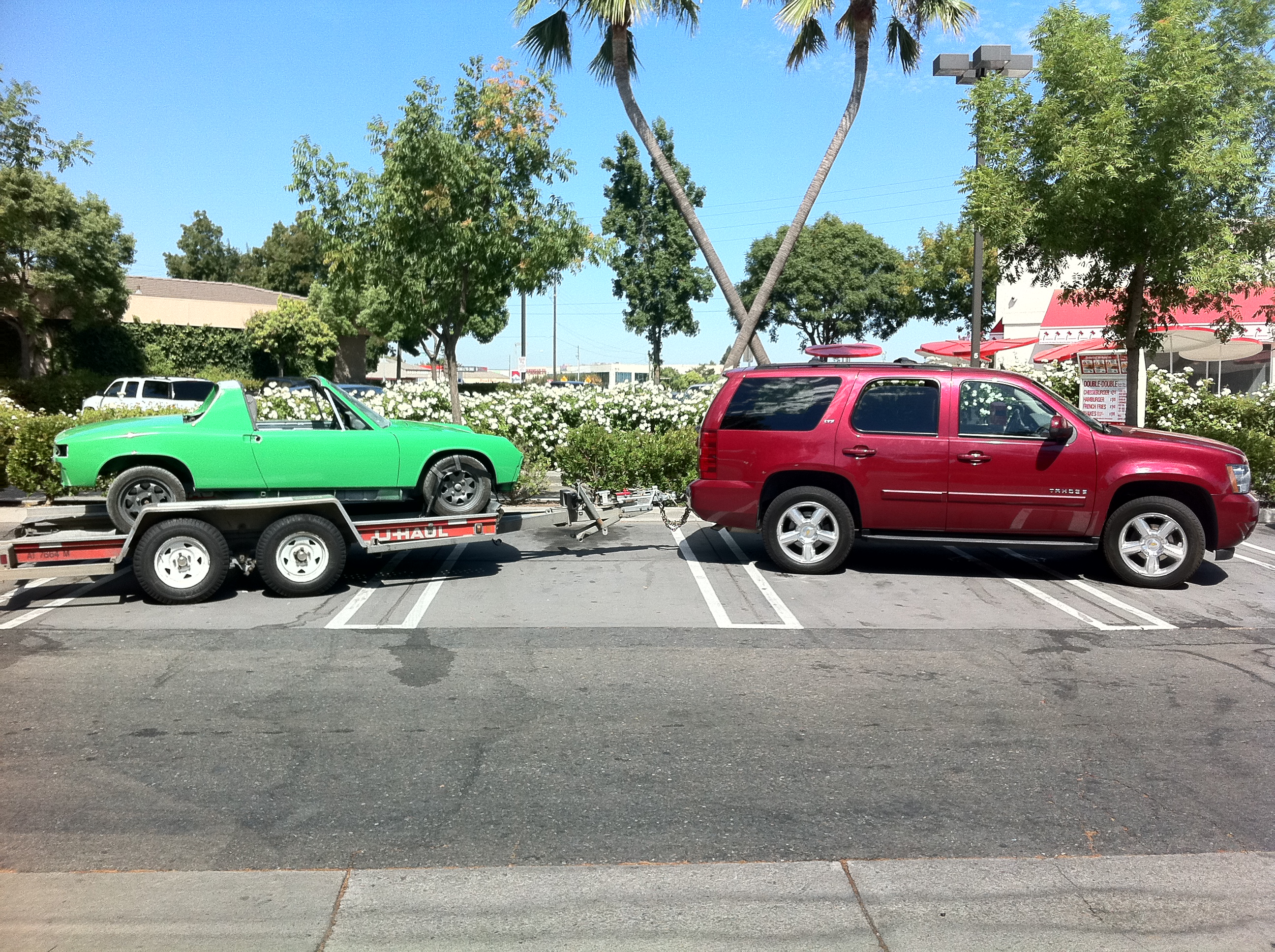

So, I took delivery of my car from Andrew on saturday morning.
I got right to work and had the engine in and fired up within a few hours.
I spent the next 3 days doing as much as I could before having to come back to school. I didnt sleep much, but it was all worth it.
here are the pics
bringing it home from andrews...

Reduce the size of your pics boy!
You stopped at in and out in modesto on your way out (IMG:style_emoticons/default/smile.gif)?

another shot on the trailer
