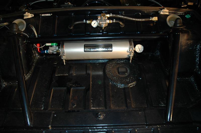

I have Brad's long. kit, GT kit, boxed trailing arms, full cage (not tied into f or r) front and rear stiffening.

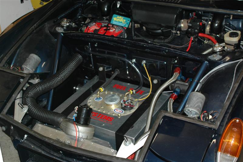

In the first photo there, it looks like you are drawing heat for the passenger compartment off of the cooler in the front. Did I see that right? If so, I think it's brilliant!
-Josh2
jt914-6
post Jun 1 2009, 03:25 PM
Post #30
Posts: 1,787
Joined: 3-May 08
From: Bryant, Arkansas
Member No.: 9,003
Josh, yes I'm using the cooler heat for the winter. Hose from the cooler goes to a "T" and then to orignal heater hose connections. A friend tried it too with his and it works.
Run the hose from the cooler down under the old gas tank area and exit hot air under the car for summer. I have a two speed fan mounted to the cooler to pull out the hot air when needed. Using an Earl's 60 row cooler #26012. It is 7 X 19". Usually run 180 degrees and on the track in mid 70's temp around 200 degrees....

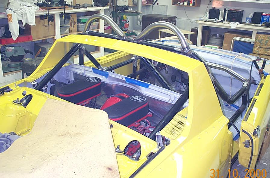

After bonking my helmeted haid on my cage halo, I cut it off and did this.
Tying in the suspension towers gave the best chassis stiffening effect of all I did.

JP would you please show me your engine lid?
Like a dumb ass I followed your design once again with the rear shock tower to cage thing. Now I need to made an engine lid. Probably out of fiberglass and wire FOD screen.

I made a GT type lid then Brit notched it to clear the tubes. Stock mounting with Dzuts fasteners. I'll take a pic & get back to ya.
