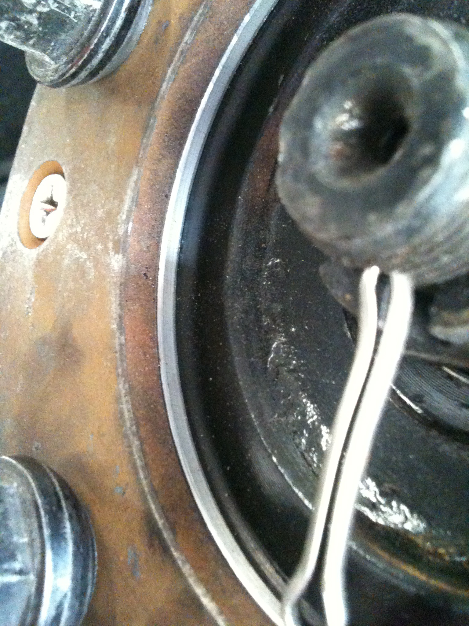

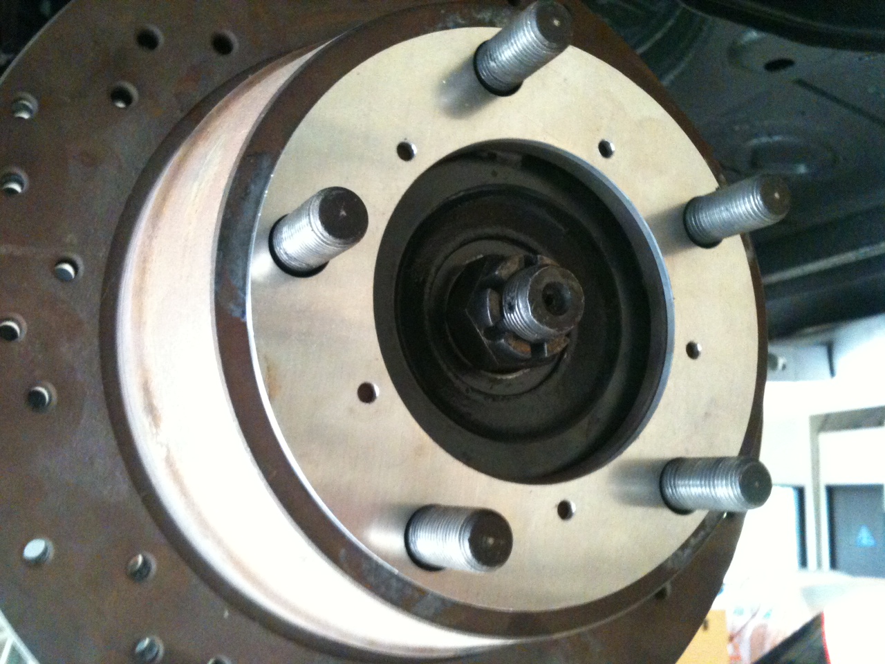

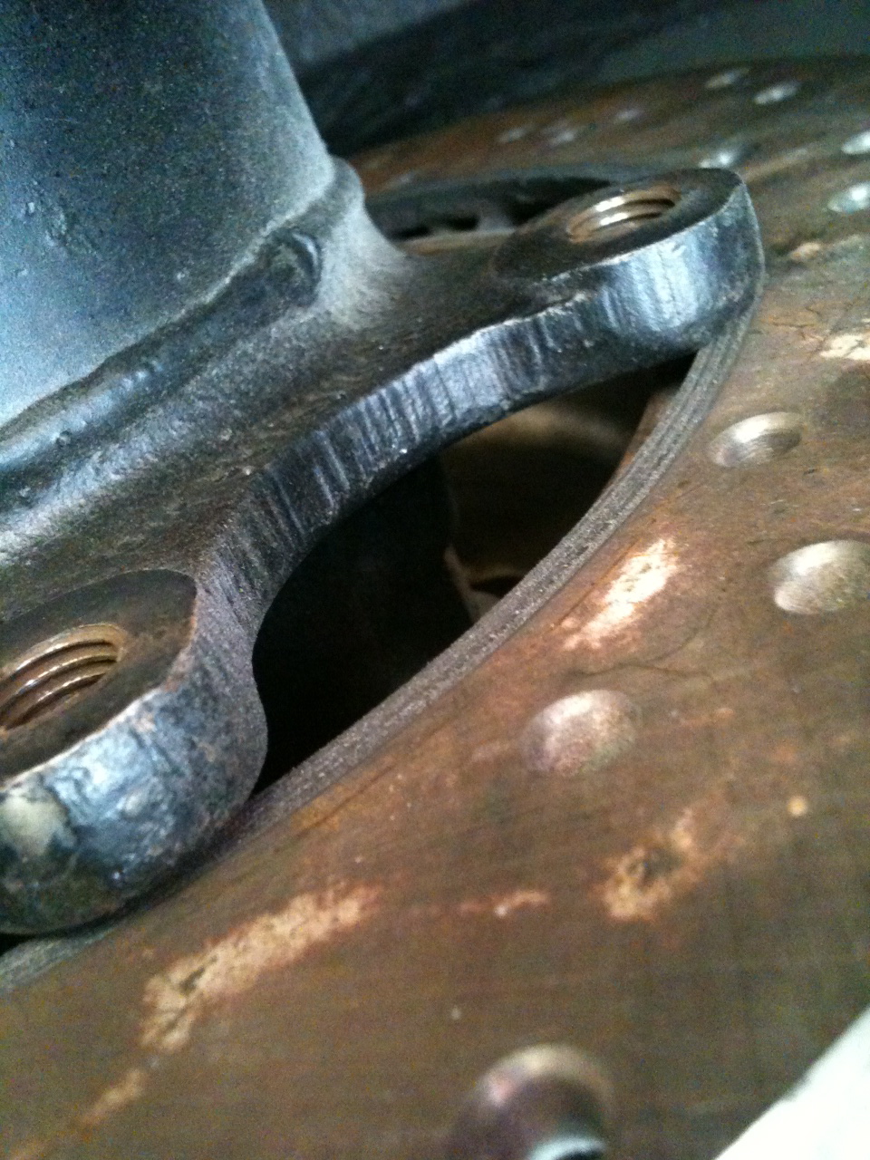

Finally got around to -somewhat- working on the car. Finished the caliper conversion to the GT Calipers, and man am I happy with the result. Shiny calipers, new brake lines, good looking setup, and huge rotors. The spacers I placed under the rotor hats really evened everything out and the rotor is perfectly inside that brake caliper.
Before I added the spacer, this is basically what I was dealing with. The back end of the larger rotor, used for the GT brakes, was hitting the mounting 'ears' for the brake caliper. Per Eric Sheas instructions, you may have to space the caliper back 3-5mm OR space the rotor forward 3-5mm. At first, I wanted to space it back, but found this to be easier as we already had the machining program from converting 4lug rotors to 5 lug as well as the spacers I'm making for each wheel (more on that later).
Once I had the spacer I made sure it fit the 5-lug pattern and would fit under the rotor, I took this picture to try to illustrate how it sits under the rotor, if my explanation above was at all lacking.
From there all you do is place it on the hub, then place the rotor, install your screws (if you like, or don't as you'll have the lugs on there anyway) and install the brakes as you normally would. Shazaam, you have GT Brakes.

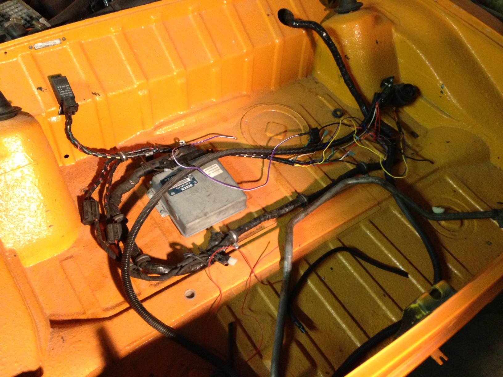

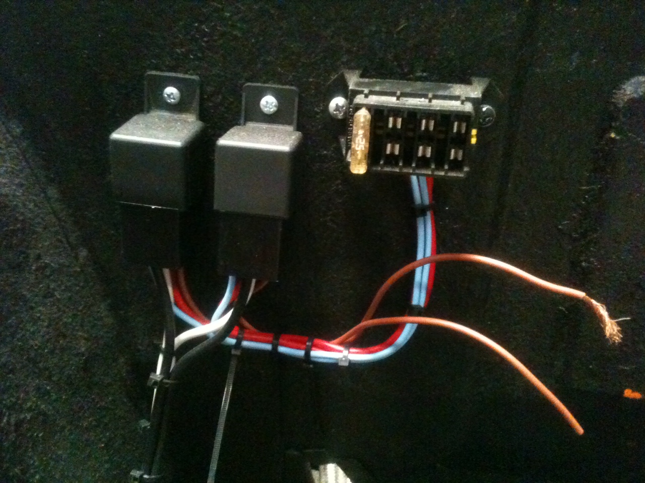

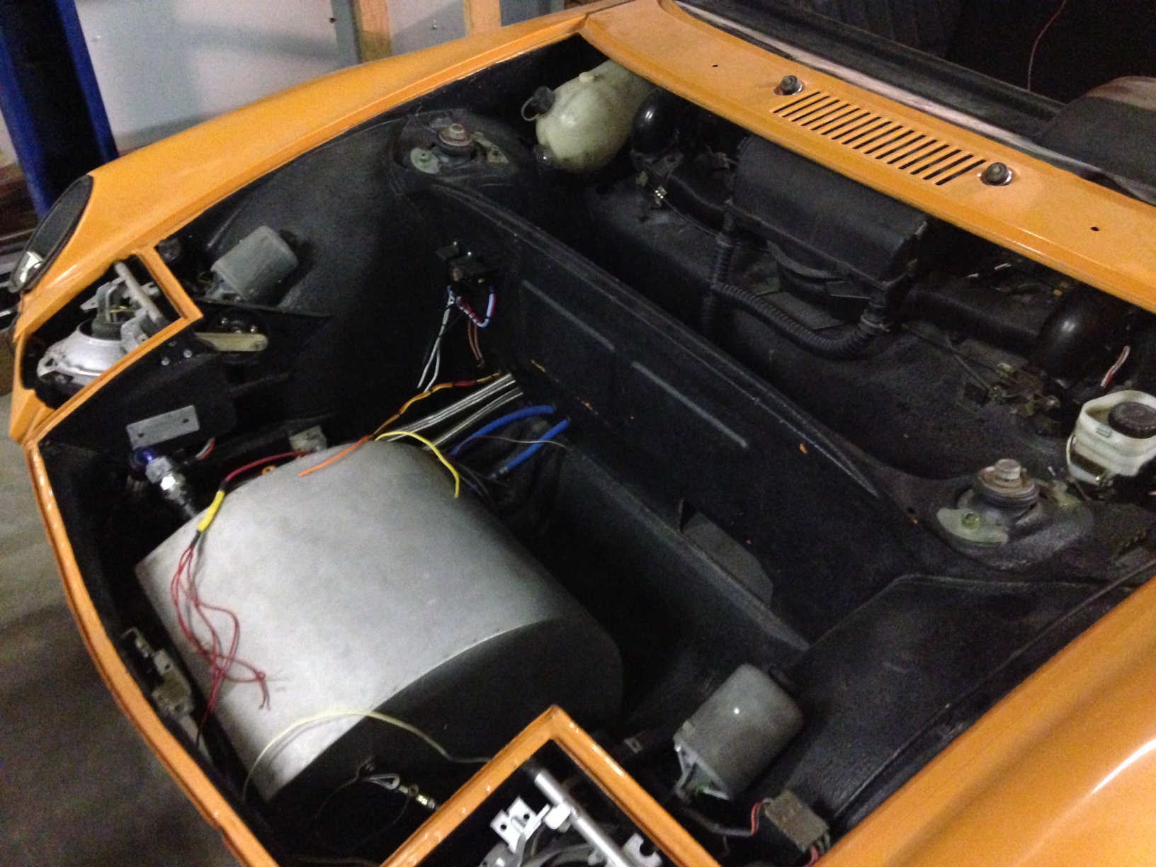

My last biggest obstacle is an important one; finishing up the wiring, cleaning it, organizing, and getting all the components to run correctly. Everything worked with the last owner, but I think it can be done better, so I've focused on installing a remote fuse location on the front trunk wall that leads to the oil cooler fan, fuel pump, and (leaving a few open) an amplifier if I choose to go that route. A little extra work, but I think in the end it will be worth it.
This weekend, I'm installing all new fittings on the oil lines I installed and in some cases, driving larger holes in the sheet metal for rubber isolator grommets. I sort of rushed through this part before, and not only was I not happy with the result, it was dangerous as these are fuel lines we are talking about...

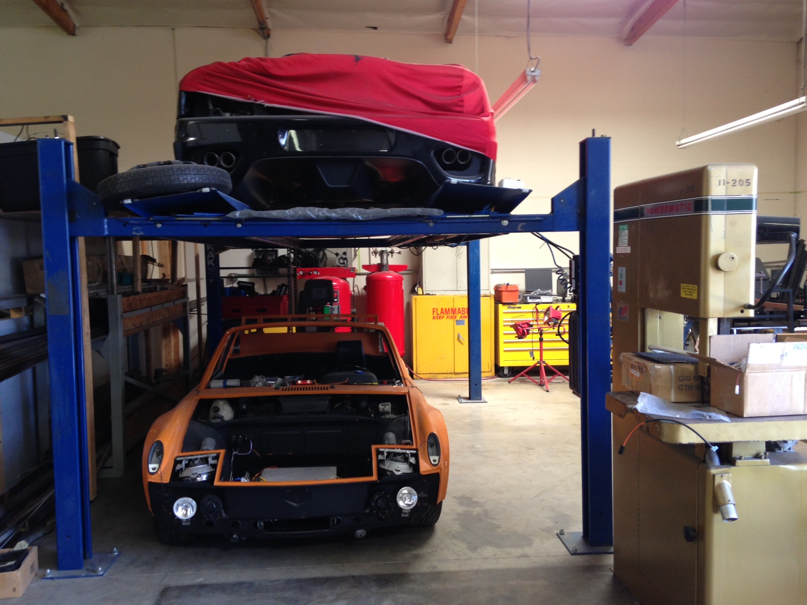

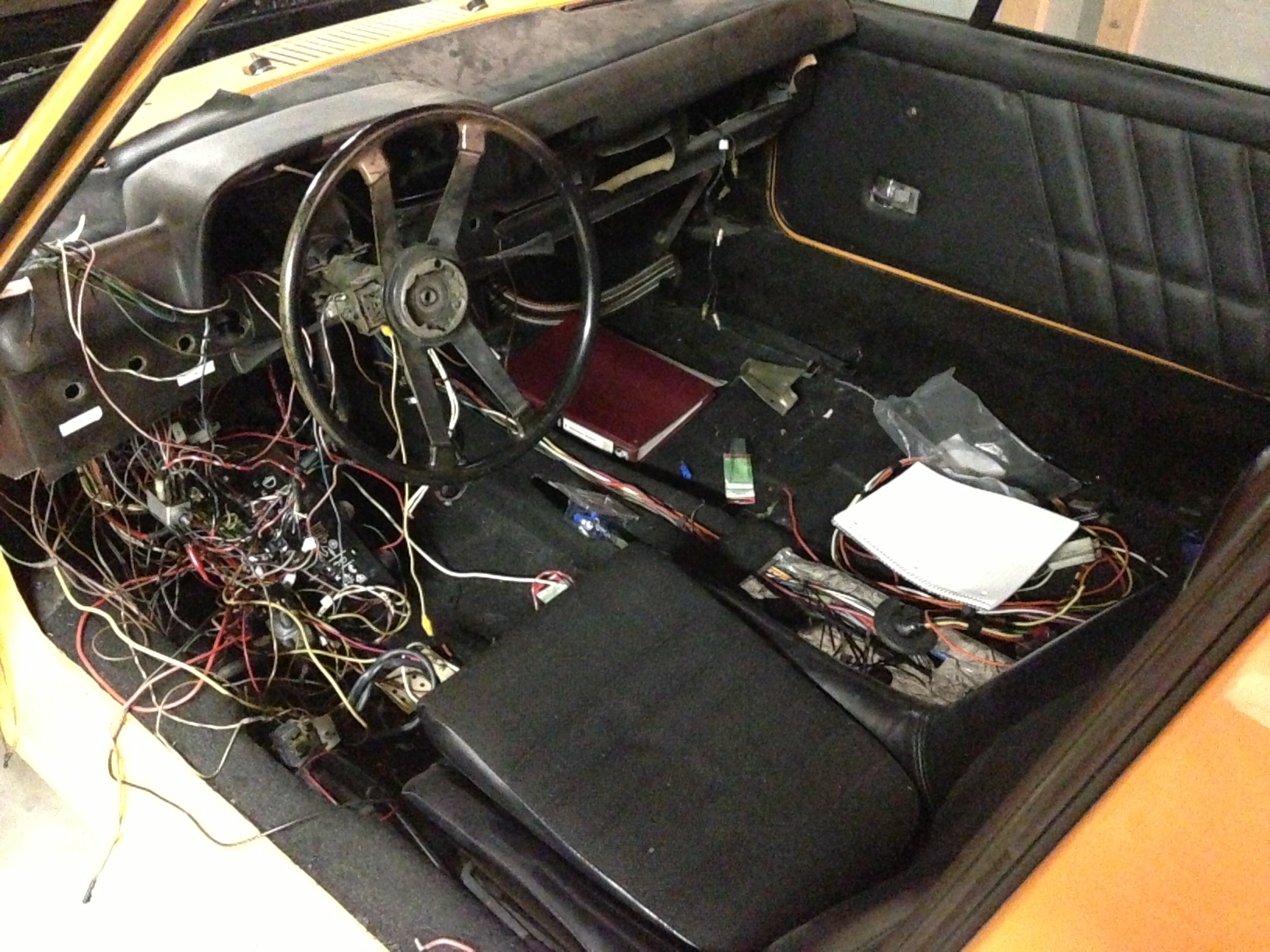

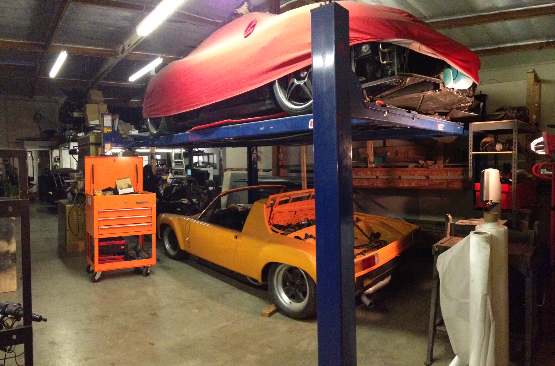

Aaaaand it's August first again. It's been a bit of a busy year, and the 914 has been nearly untouched. Though I havent done much I'm the car, I'm posting and reading threads in an attempt to get motivated!
Attached ImageIt's been a bit of a busy year, and the 914 has been nearly untouched. Getting back on-track, I've moved the 914 to one of our newest buildings and have begun the process of reorganizing.
After inventory, The main areas I have to focus on are the following:
- Wiring
- Brain
- Dash Harness
- /6 Steering column/switches
Interior
- Seats
- Dash covering
- Gauges
- Windscreens
- Misc. Items
- Door handles
- Trim
- Hoods
- Bumpers
Looking at it, it's really not that much.... atleast that's what I keep telling myself (IMG:style_emoticons/default/blink.gif)
