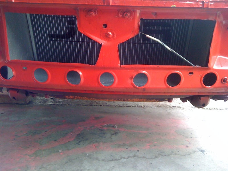

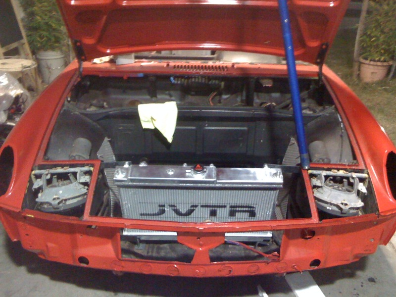

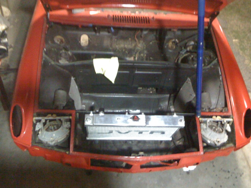

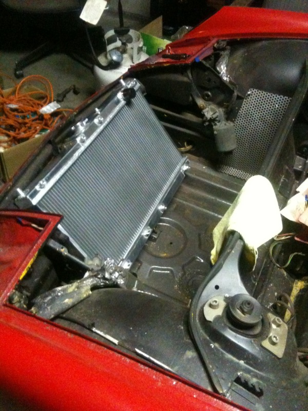

Found some time yesterday after class to mock up and mount the radiator:
mocked-up:
(IMG:http://www.914world.com/bbs2/uploads_offsite/i62.photobucket.com-2697-1295038740.1.jpg)
Top View:
(IMG:http://www.914world.com/bbs2/uploads_offsite/i62.photobucket.com-2697-1295038741.2.jpg)
Front View:
(IMG:http://www.914world.com/bbs2/uploads_offsite/i62.photobucket.com-2697-1295038741.3.jpg)

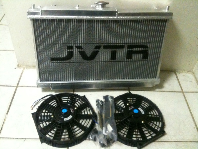

Thats a nice sized radiator! What is it out of?
PS Rubber isolators for the radiator are your friend. The radiator should not be touching metal.
dlo914
post Jan 14 2011, 07:46 PM
Post #130
Whatchu' lookin' at?!?!
Posts: 3,432
Joined: 6-September 04
From: San Gabriel, CA
Member No.: 2,697
QUOTE(Andyrew @ Jan 14 2011, 01:39 PM) *
It's a dual core aluminum radiator for a Miata. I need to hit up Home Depot for some rubber bushings at the moment i'm only using rubber washers.

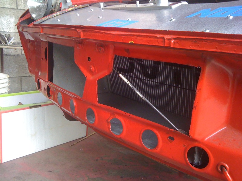

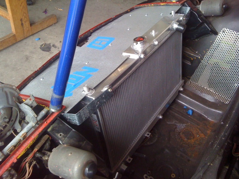

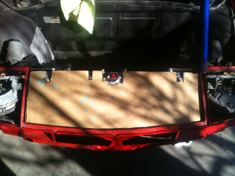

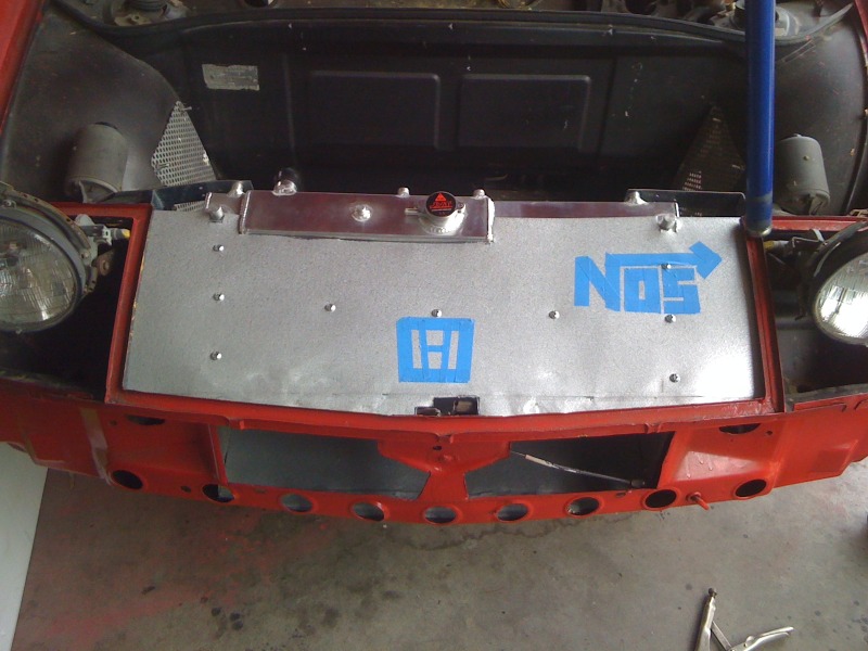

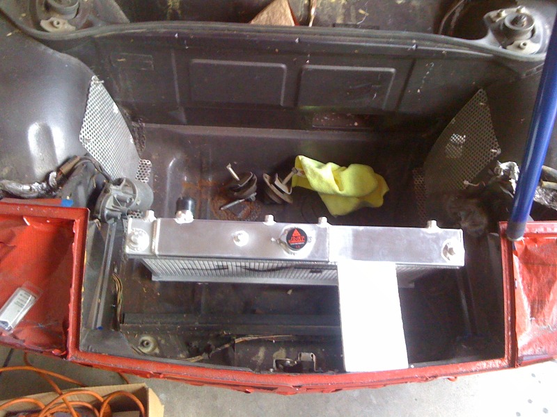

Managed to fabricate the radiator shroud a few weeks back:
(IMG:http://www.914world.com/bbs2/uploads_offsite/i62.photobucket.com-2697-1302888141.1.jpg)
(IMG:http://www.914world.com/bbs2/uploads_offsite/i62.photobucket.com-2697-1302888142.2.jpg)
(IMG:http://www.914world.com/bbs2/uploads_offsite/i62.photobucket.com-2697-1302888142.3.jpg)
then we got bored and started blue taping (IMG:style_emoticons/default/biggrin.gif)
(IMG:http://www.914world.com/bbs2/uploads_offsite/i62.photobucket.com-2697-1302888143.4.jpg)

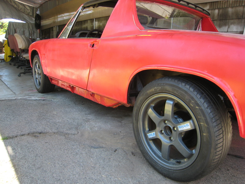

(IMG:http://www.914world.com/bbs2/uploads_offsite/img.photobucket.com-10027-1305491277.1.jpg)
(IMG:http://www.914world.com/bbs2/uploads_offsite/img.photobucket.com-10027-1305491277.2.jpg)
dlo914
post May 15 2011, 02:43 PM
Post #137
Posts: 3,432

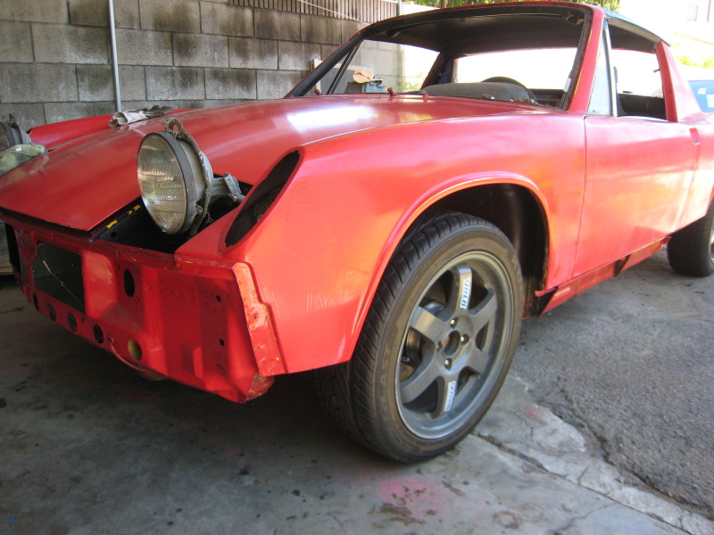

Member No.: 2,697
16x7 +40 offset 4x100 bolt pattern Volk TE37 in gun metal gray, i think we're gonna go w/ 225/50/16 sized tires. These were installed with 4x130 to 4x100 bolt pattern adapters.
