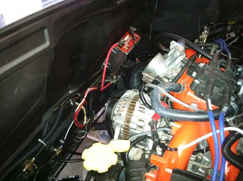

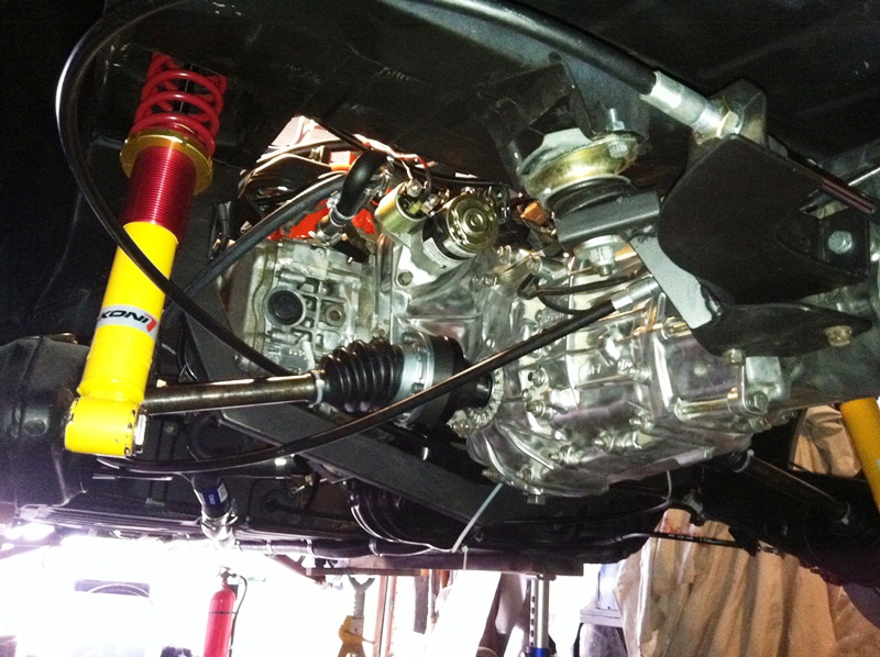

Engine and modified stock engine harness with new Odyessy Battery
Correct length VW Bus axles between Magic Flanges and 944CV's with the cable shifter installed

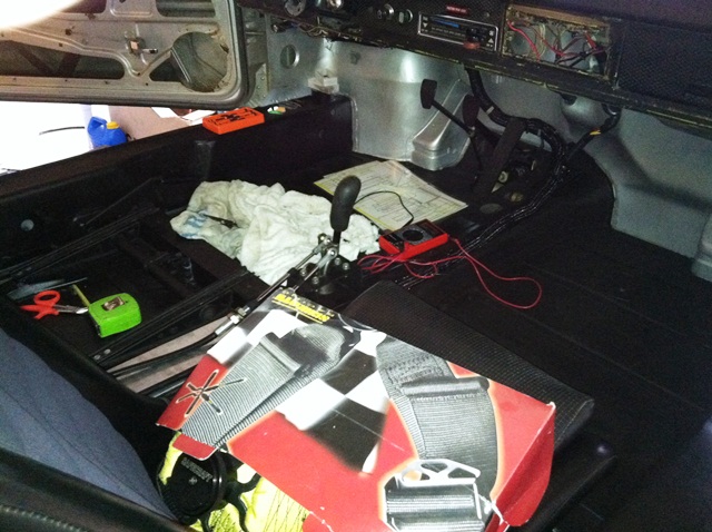

Getting ready to mount the harness for each of the seats
Shifter mounted in the cockpit

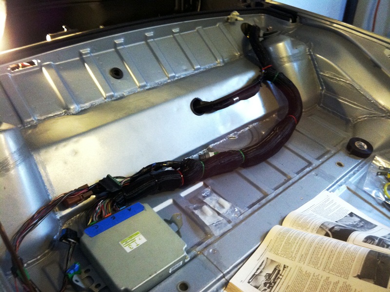

Stock ECU and wiring harness ready to be secured in the trunk

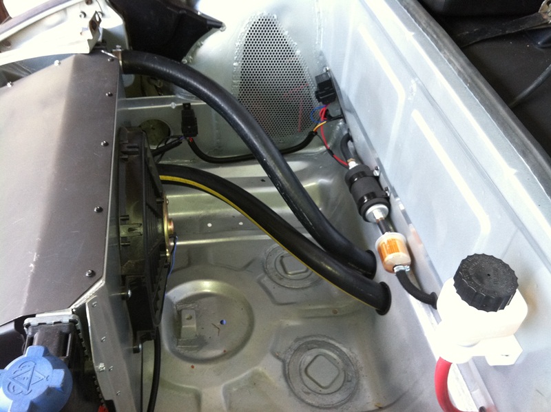

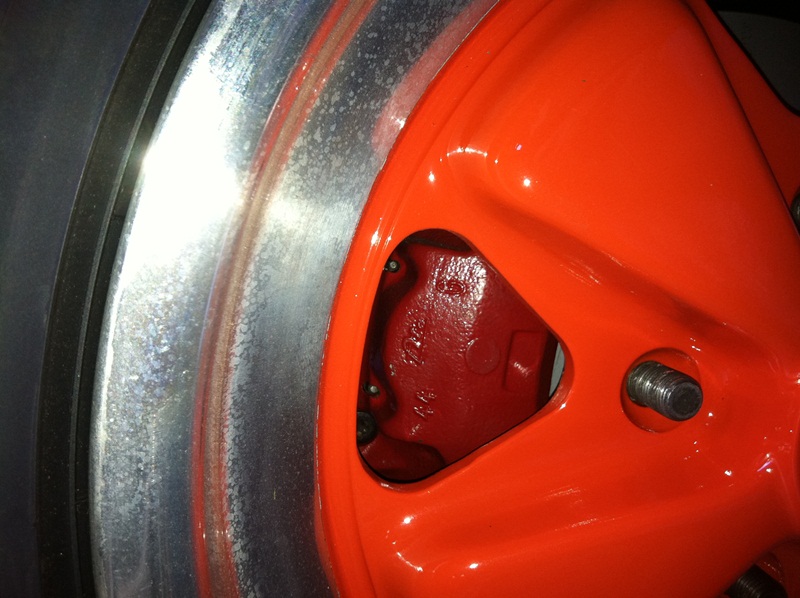

Still need to polish the chrome but the red brakes with the Phoenix Wheels look good! (IMG:style_emoticons/default/aktion035.gif)
Radiator hoses secured and mounted

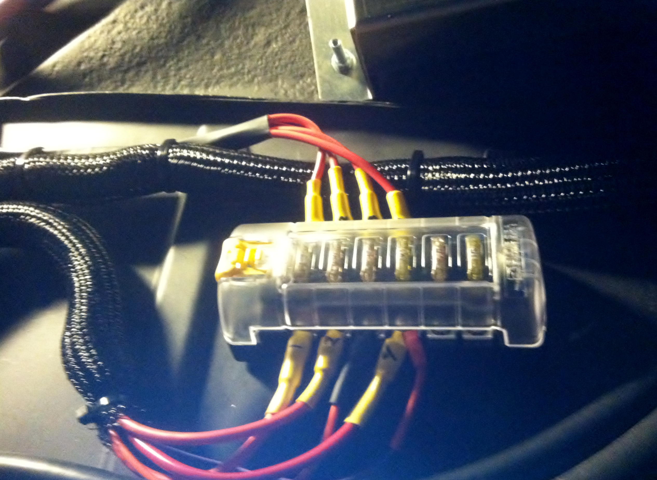

Time to do some updating...
So, this past Fall I was on the path of getting this Teener on the road but...
After a few test drives around the block I pulled into the driveway and noticed a trail of oil following me to a pool forming under my car. I wanted to push the POS out into the street and light it on fire (IMG:style_emoticons/default/headbang.gif)
Instead, I turned it around and backed it into the garage and prepped the car for engine removal. (IMG:style_emoticons/default/sad.gif)
I tore it down to the rear main seal behind the flywheel and found that I had installed the prior incorrectly. So, I went to the dealer and got a new one and researched how to install it properly. Got it done in a long day and put it back in the car.

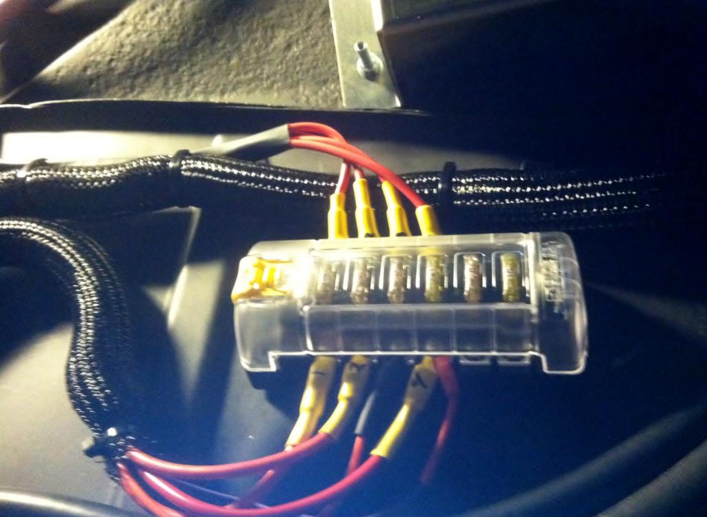

Then, throughout the following months I went through the 914 wiring and tried to weed out any bugs. I have everything ironed out except, that I can not have my headlights on and have the turn signals flash.

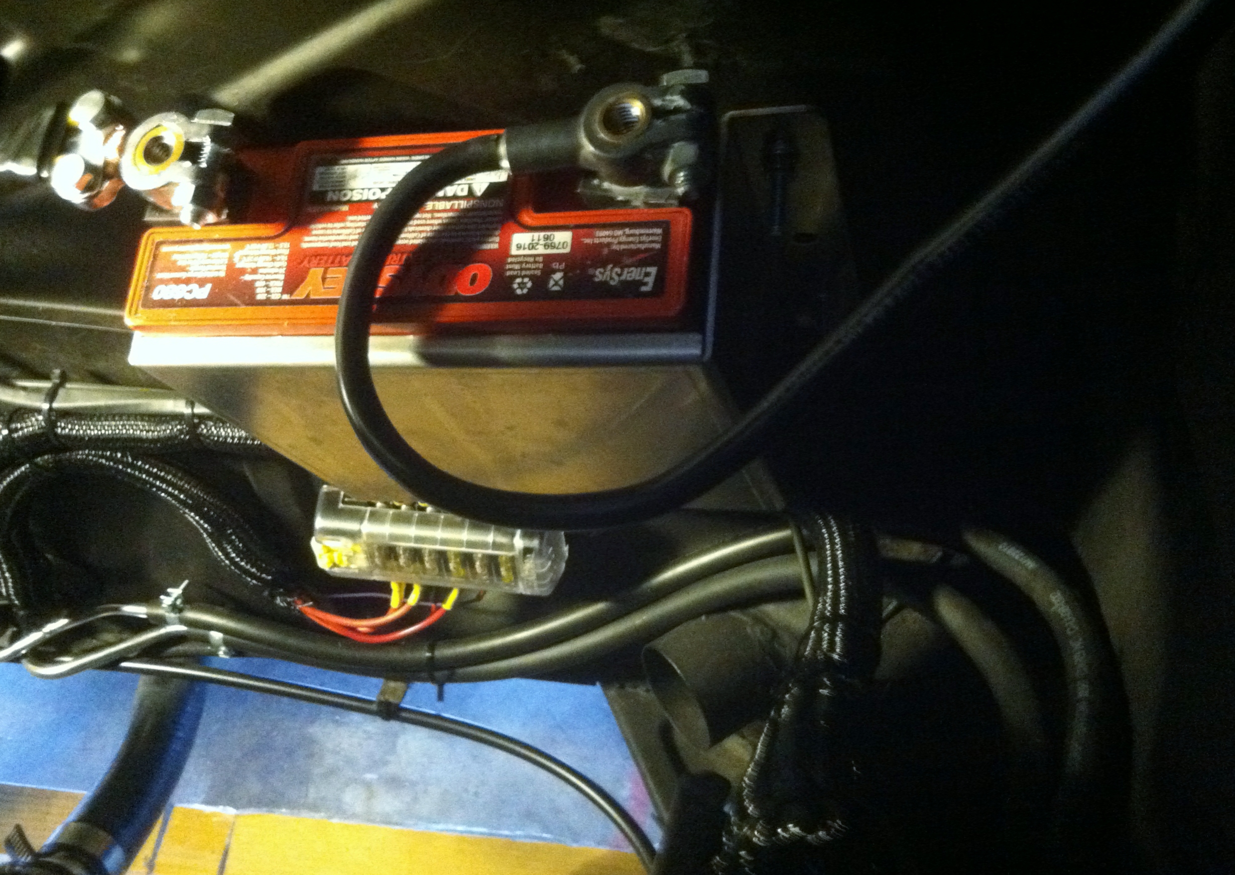

Now, I borrowed the HOT wire engine bay fuse panel idea and replaced my future car fire with a safe boat water resistant fuse box.

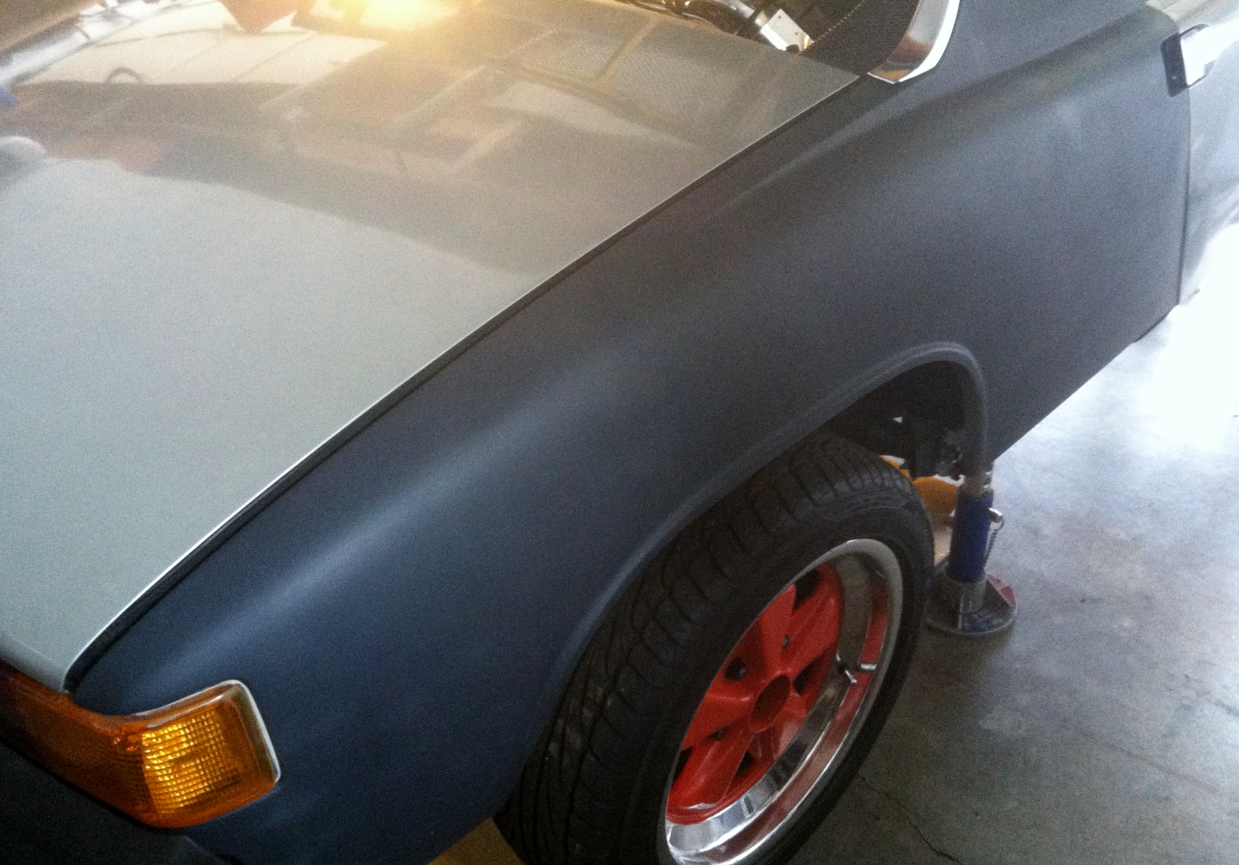

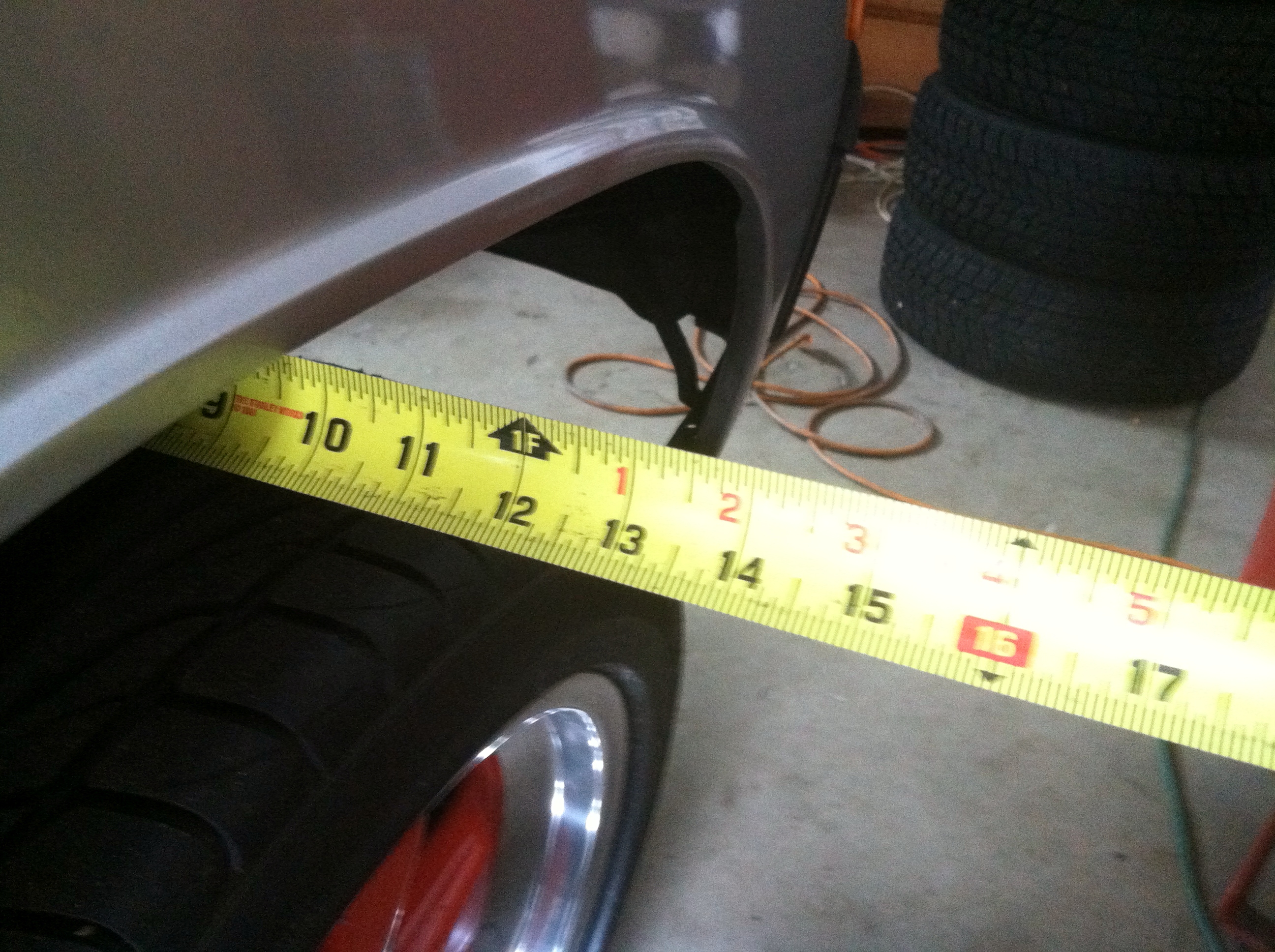

I have to expand my rear wheel wells by about 1/2 inch or so in order to make the 16x7 inch tires fit. My question is should I hammer and dolly the fenders or roll them with the "baseball bat" technique? I am pre-paint so that is not an issue to me right now.
Then, I am off to the alignment shop to dial in the suspension!
Here are the pics!
Blue Sea fuse panel
Cleaned up

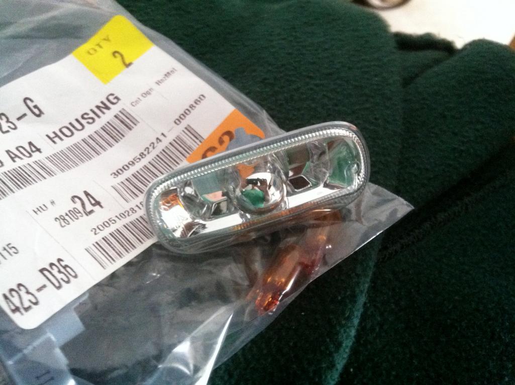

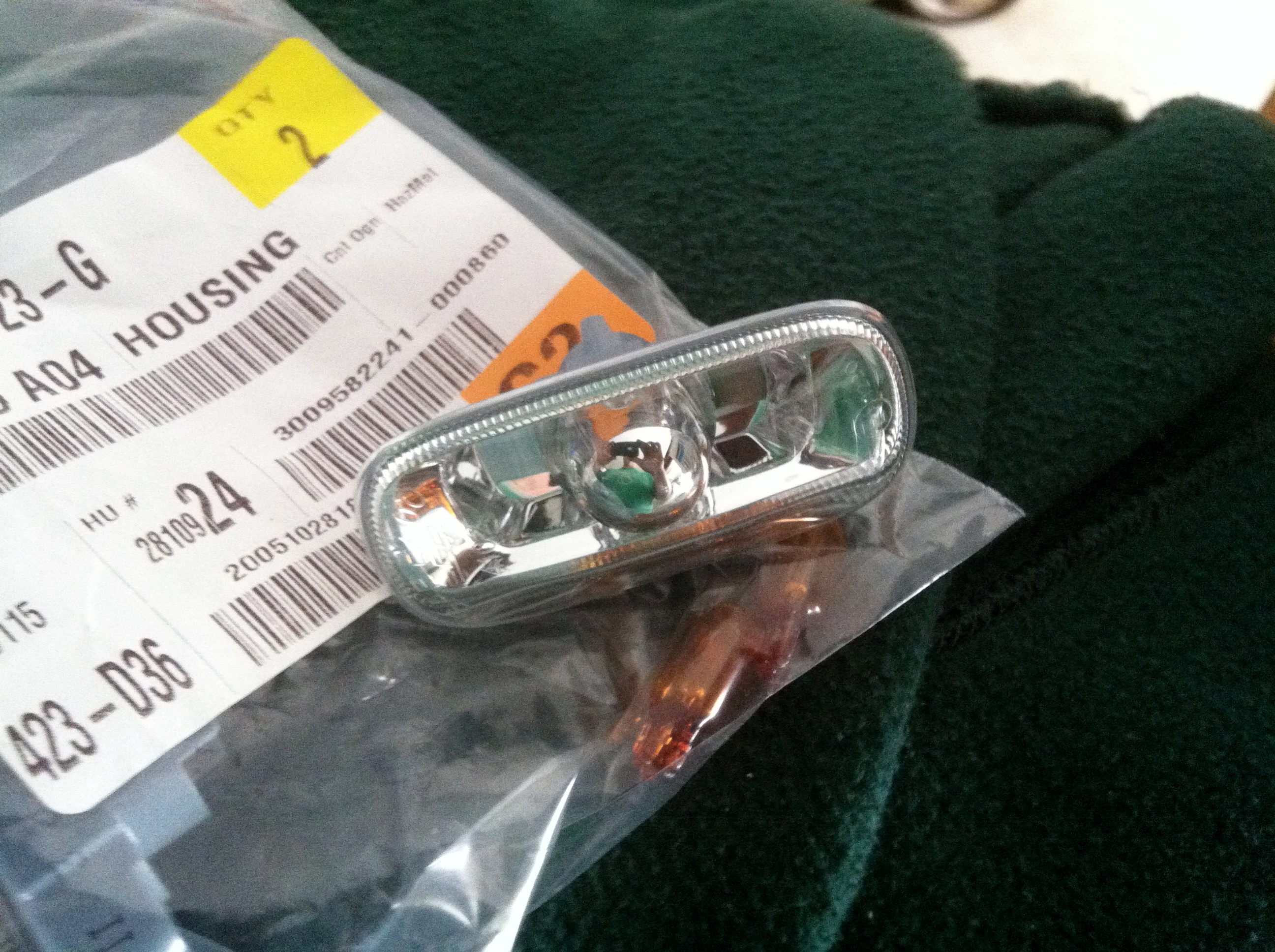

I am going to use these Audi markers behind the front fender well to help prevent me from getting T-Boned.

Here is where I am with the rear fenders before the stretch!
Input is welcomed (IMG:style_emoticons/default/idea.gif)

bat roll it! My 16x7 fit under the rear. I do plan on lifting about a 1/2-1 inch. I like the not slamed look.
