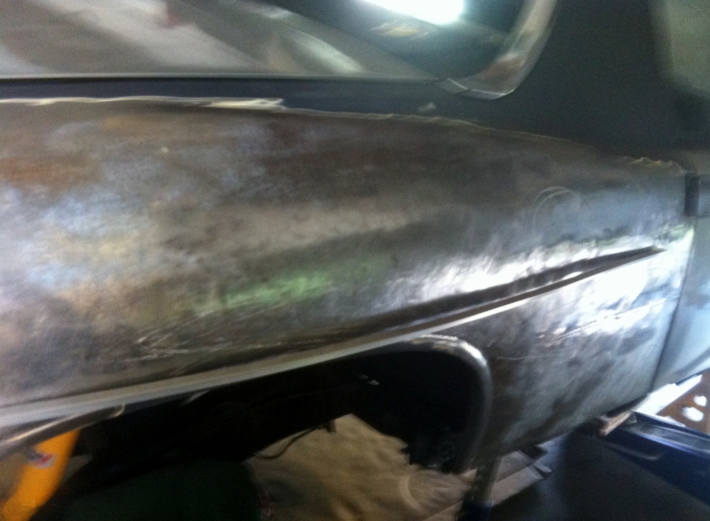

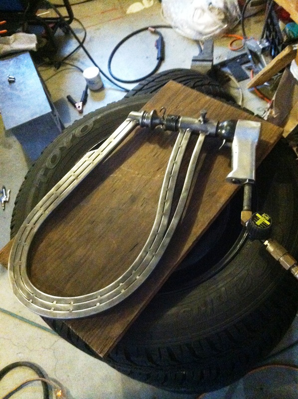

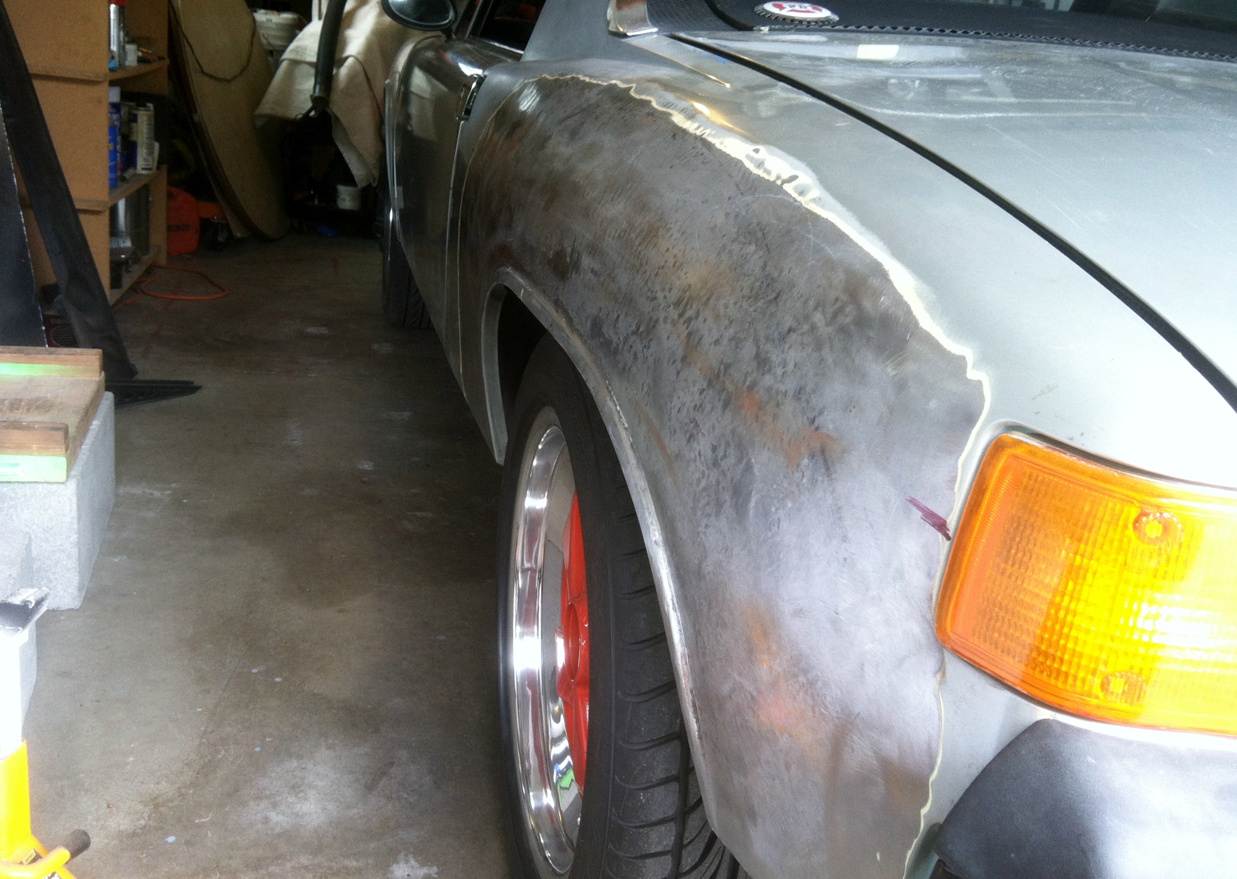

So, I decided to go the CSOB route with the stretching of the rear fenders. Since the weather here in the PNW is still rainy and crappy (IMG:style_emoticons/default/bs.gif) I am using the John Kelly method of flaring my rear fenders.
I contacted John Kelly about his DVD and info about his planishing hammer. It turns out that his hammer was for sale! So, I picked up the DVD and a planishing hammer!! (IMG:style_emoticons/default/smash.gif)
I am trying to contact Zach, the owner of the 914 in the video, to get some better photos of the rear flares in order to get a good idea of what I am doing.

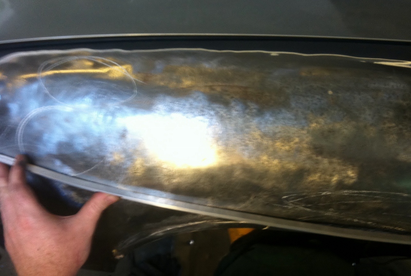

Here are some pics of the experiment!
Stripped the paint and traced out some fluid lines in order to make a good looking flare!
Stretching and smoothing! Slowly!
Made by the man himself, John Kelly!
Now in the hands of a novice (IMG:style_emoticons/default/smash.gif)
To be continued...

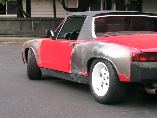

PS> here is a pic from the GS website
Wish me luck on finishing the drivers fender in the next few days! (IMG:style_emoticons/default/smash.gif) (IMG:style_emoticons/default/screwy.gif)

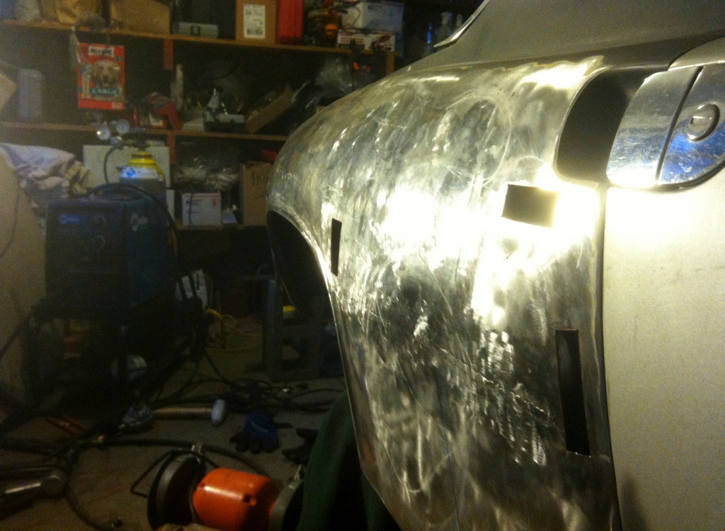

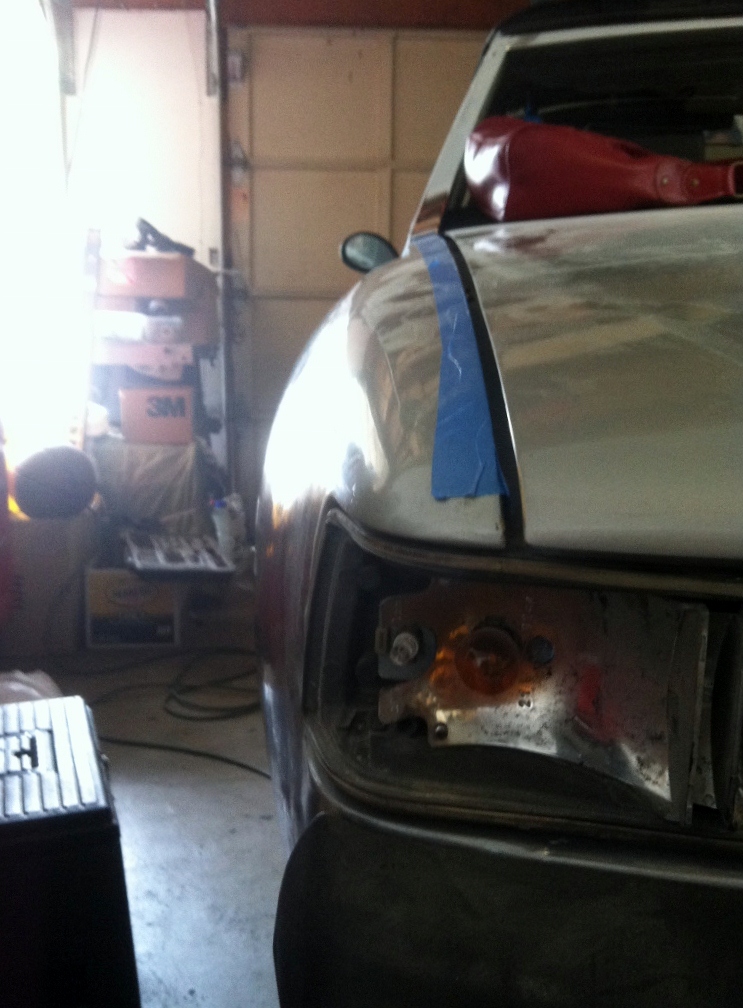

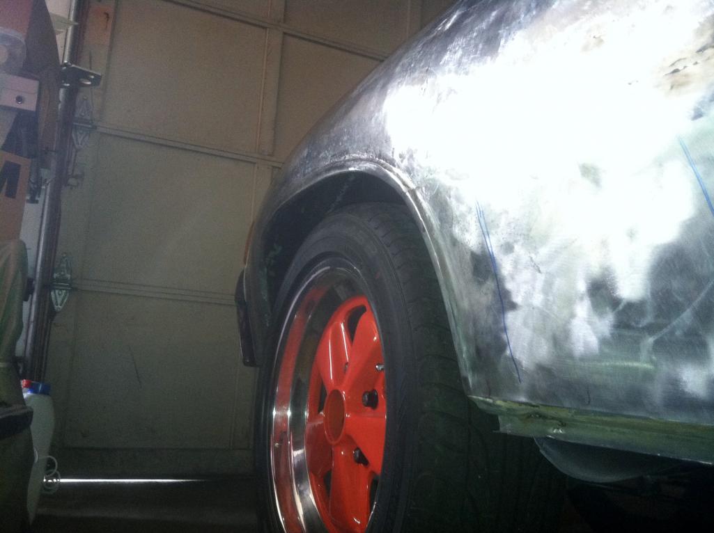

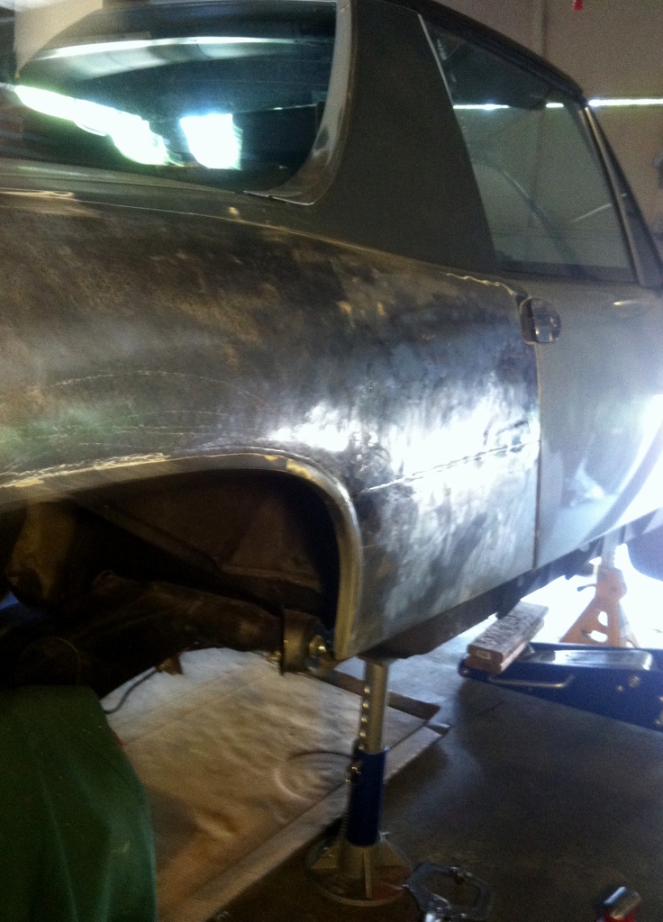

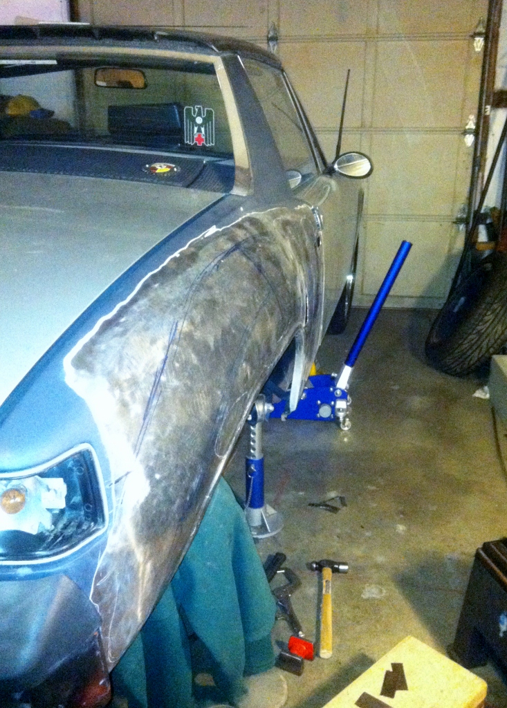

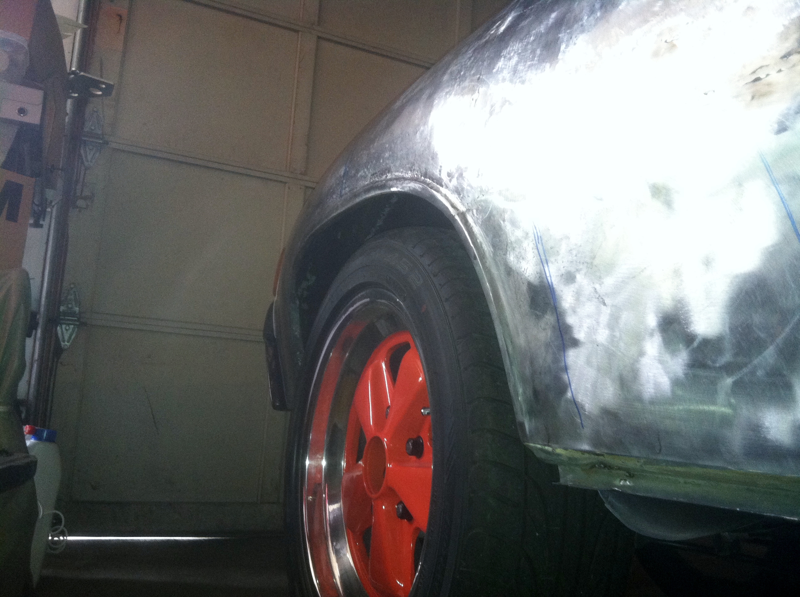

Started on the fender today and made some good progress (IMG:style_emoticons/default/piratenanner.gif)
Now I am waiting on the shrinking disc and slapping spoon to come in the mail.
Here are some pics:
More to come!

I have only worked on the driver's rear fender and have about 4 hours into it including sanding it down to metal. I started to use a palm nailer and sand-filled purse but I found a ball peen hammer gives me more control. Then, followed up with the planishing hammer and hand dollys. All wearing good hearing protection for sure!
I am waiting for a shrinking disc and body slapping spoon to come in the mail. These will help do the fine tweeking and finish work. Then, I will sand off all the filler on the passenger rear fender and start pounding away!
I am still undecided about the front. My wheels fit but I love the look and it gives room for wider 8" tires in the future.
Eirther way, it is fun work! (IMG:style_emoticons/default/smash.gif) You see instant results! Just don't try and skip steps.
Nate (IMG:style_emoticons/default/beerchug.gif)

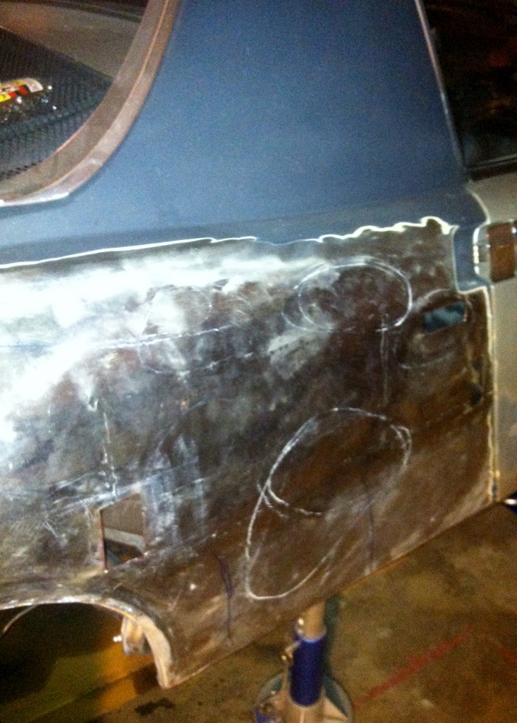

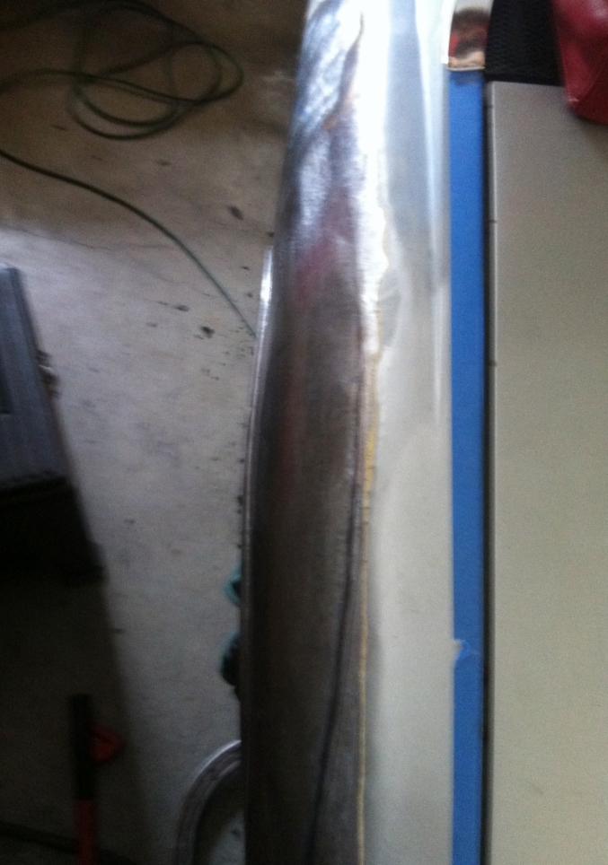

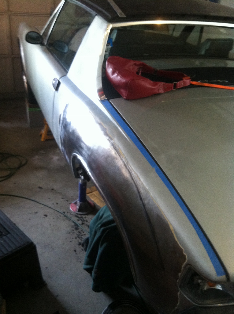

Ok, had a bit of time these past SUNNY days to work on the passenger side rear. Boy, what a mess! (IMG:style_emoticons/default/barf.gif) Up to 1/2 inch of filler applied to an oil can dent (by me (IMG:style_emoticons/default/blink.gif) ) was ground out. Got the entire side exposed in bare metal and traced my template and made some landmarks.
Sorry no pics of the mud but trust me, it would not let a magnet stick (IMG:style_emoticons/default/chair.gif)
My biggest problem is working around the welded seams of my panel repair to the inner long. I eventually had to cut out some thin spots and I am waiting for another free day to tidy it up. However, I did make some good headway on the flare itself! I just need to mirror them better when I get the slapping spoon and shrinking disc this week!
So, here are the pics!

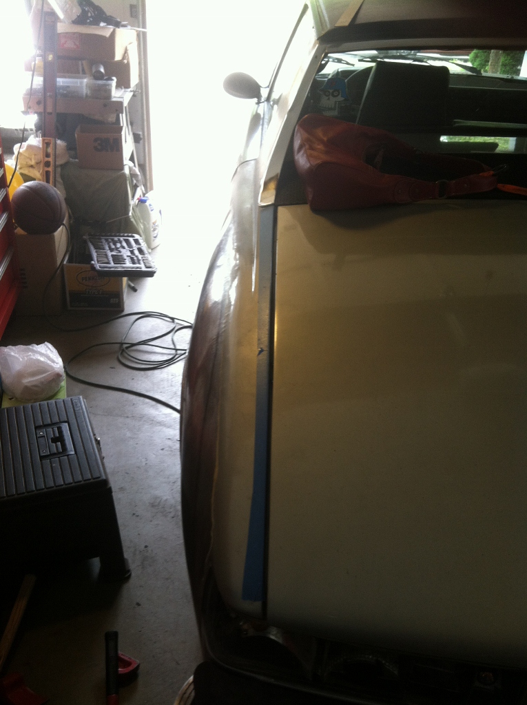

Using a aluminum angle piece for the mold of the flare
Hard to match the profile but close!
Damaged panel mapped out for repair!
Little patches to blend in~!
That is it for now!
Cheers! (IMG:style_emoticons/default/beerchug.gif)
Nate

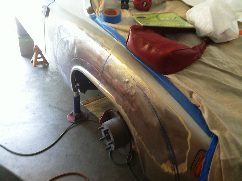

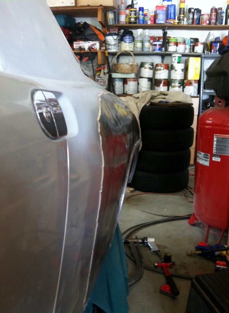

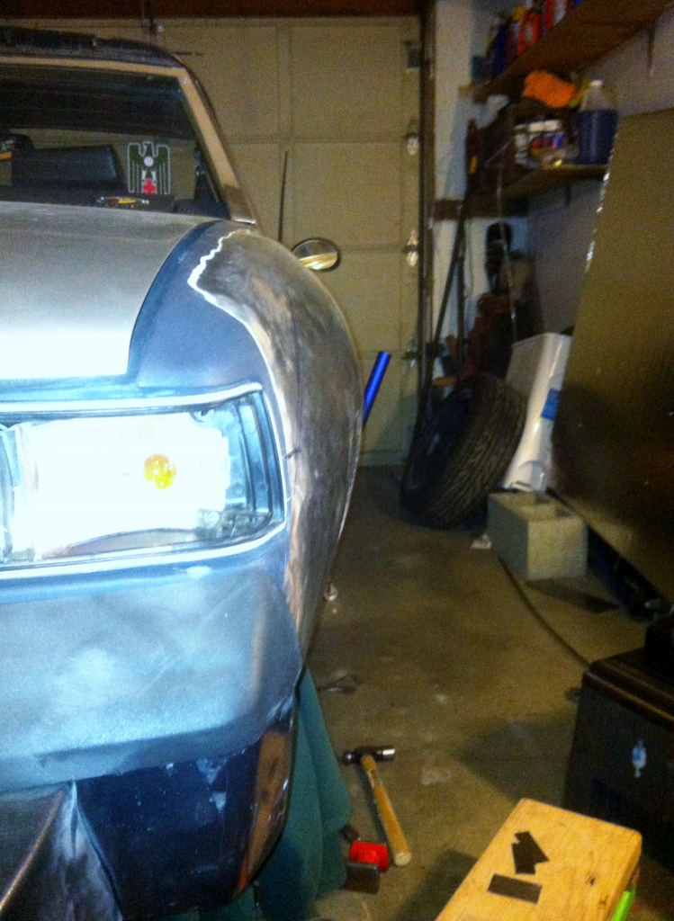

Got some things done today. Welded in the small patches, carefully! (IMG:style_emoticons/default/welder.gif)
And put the car on the ground to compare the flares. I will probably stretch the drivers side a bit more to match the passenger side. I really like the more aggressive flare than the more subtle one. I probably made them big enough for 8 inch tires but, that works for me too! (IMG:style_emoticons/default/driving.gif)
Just waiting for the finishing tools to arrive sat my door so I can smooth out the lumps and small oil cans.
Repairs made but still lumpy for now.

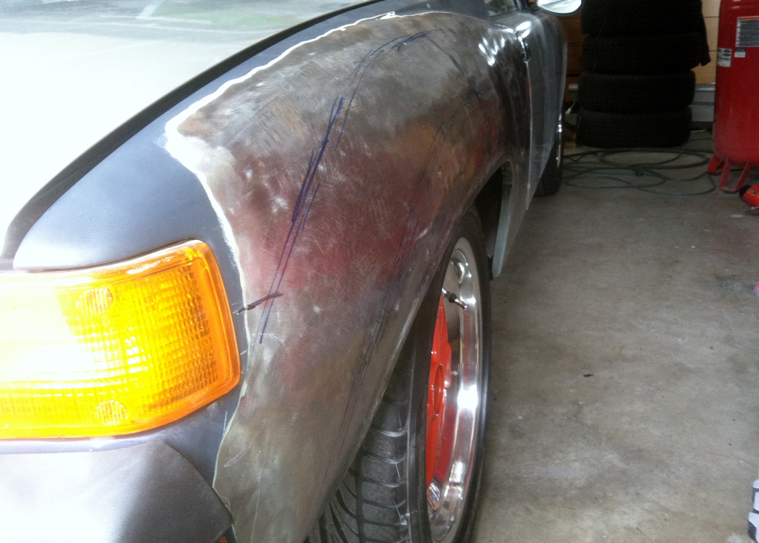

Zaney
post Jul 17 2012, 03:06 PM
Post #140
Deuchland en der Haus
Posts: 461
Joined: 1-March 04
From: Engine 11 Redmond, WA
Member No.: 1,738
Drivers side (still needs some stretching)
Passenger side (still needs a bit more massaging)
More later! (IMG:style_emoticons/default/beerchug.gif)
Nate
