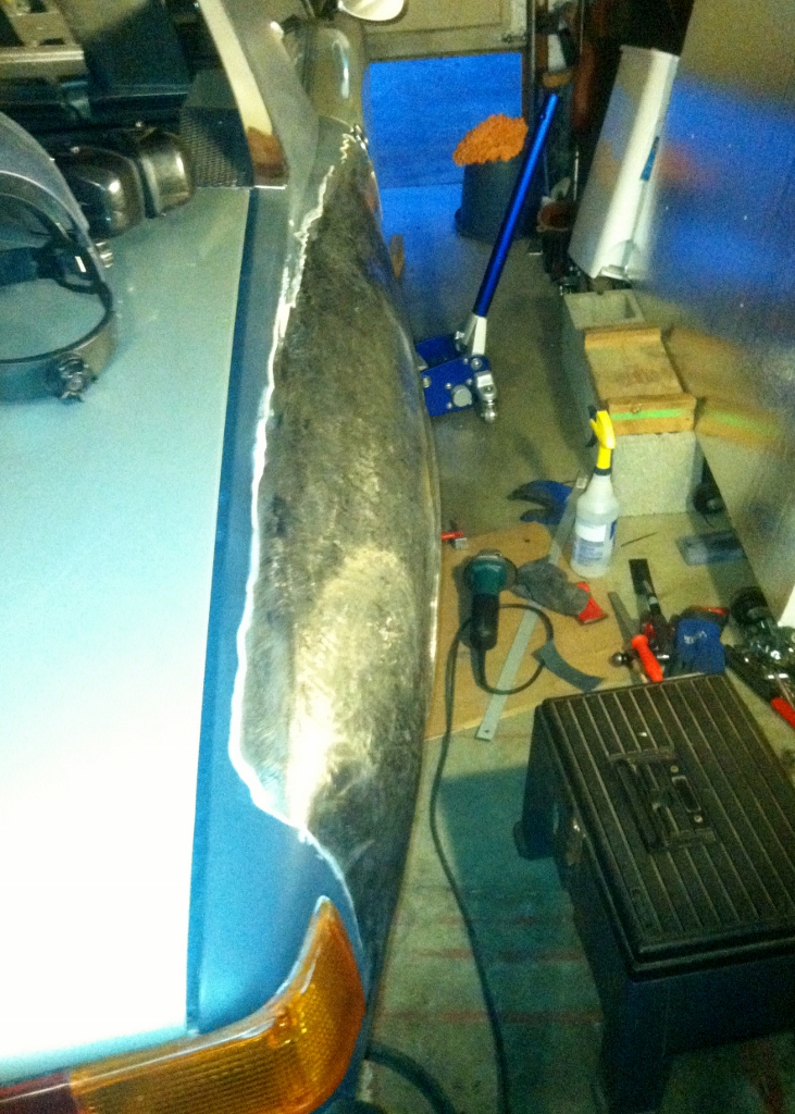

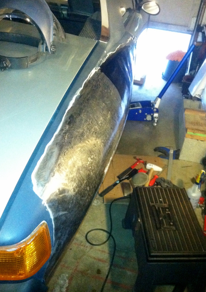

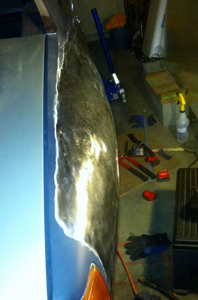

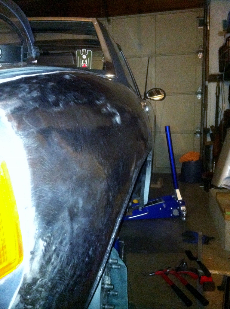

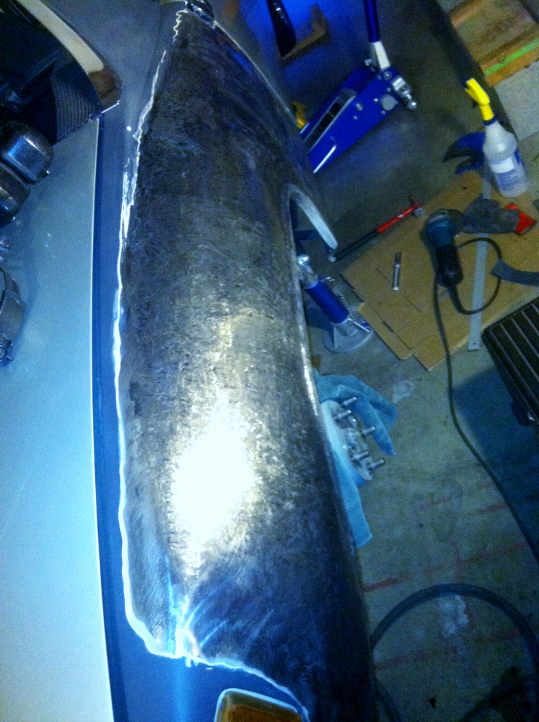

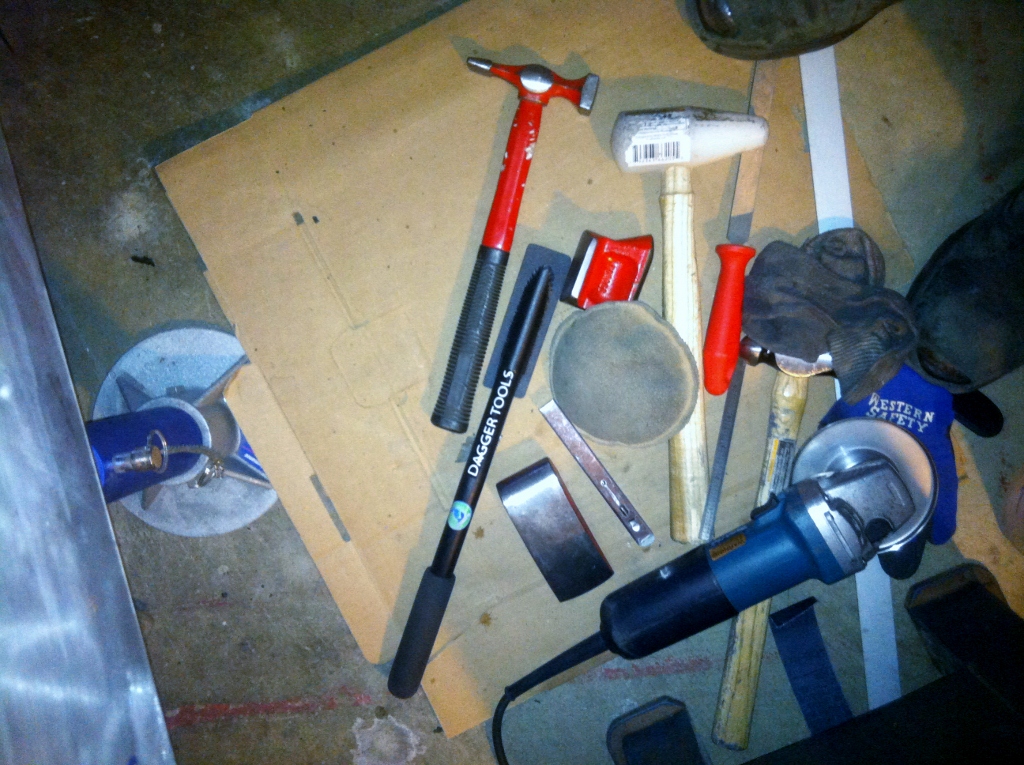

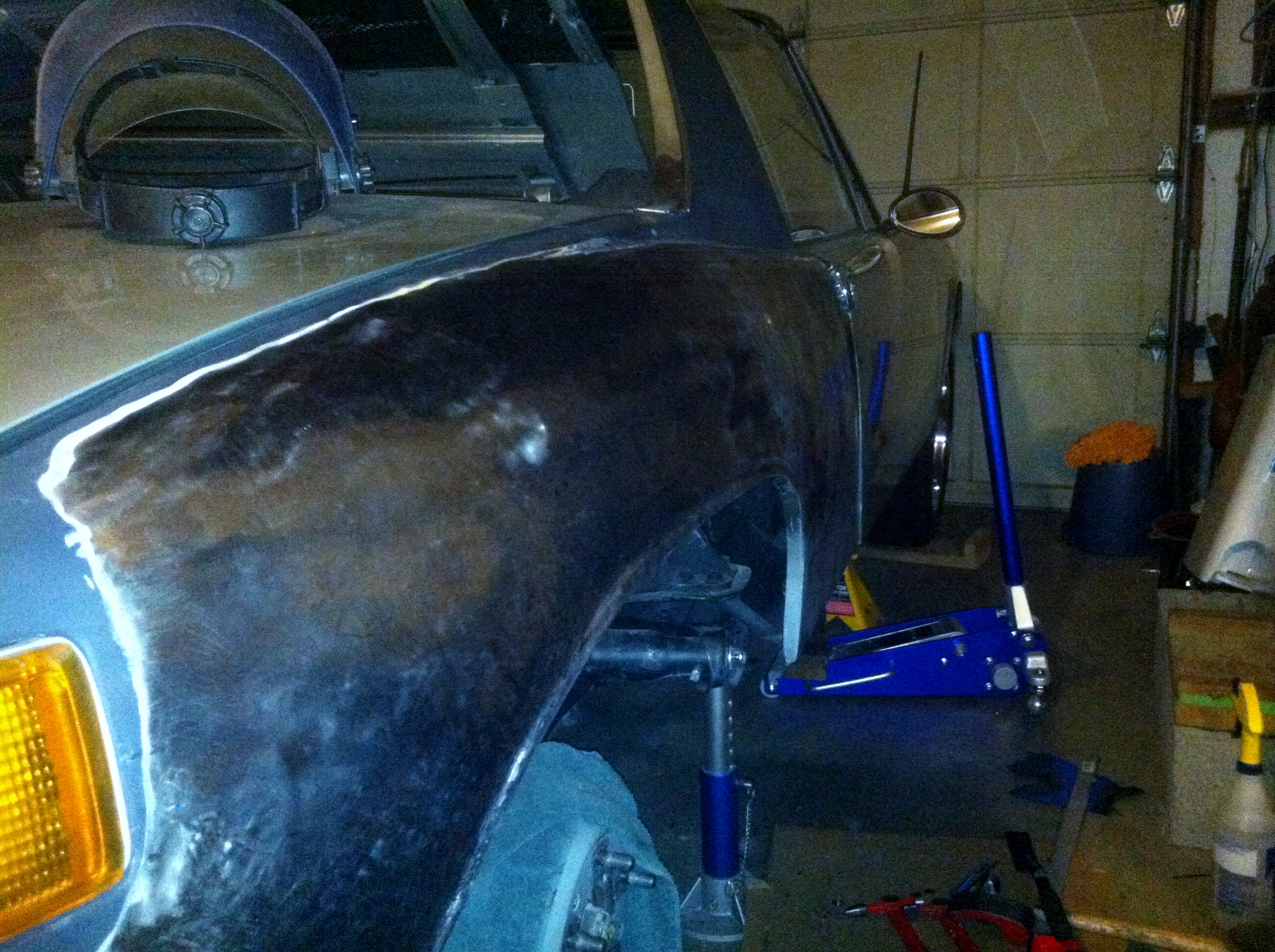

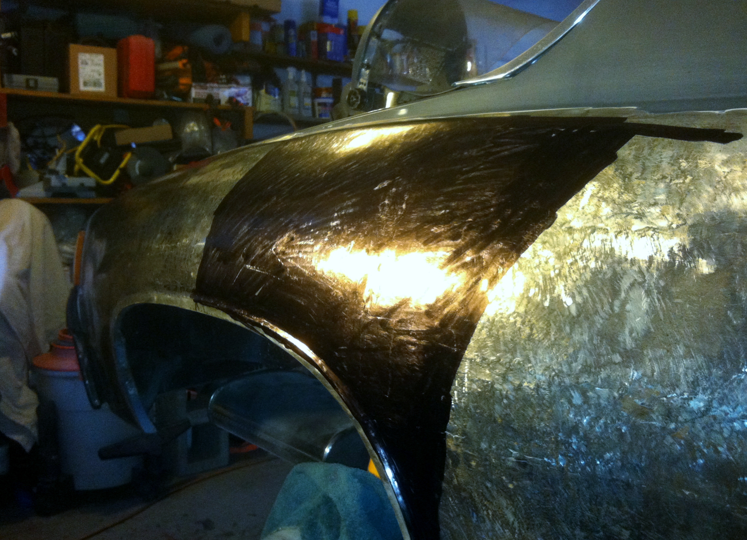

Been trying to work on the fenders with the slapping spoon and the 4 inch SS shrinking disc that I bought from here.
I am working on a section at a time by shading the fender with a Magnum 44 marker and then block sanding off the ink, just like you do for paint prep.
Then, all the low spots will be left to bump up and then, slapped down flat.
Zaney

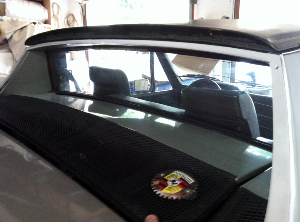

Sorry for the I phone pics but you can get an idea. Better final pics when I am closer to being done.

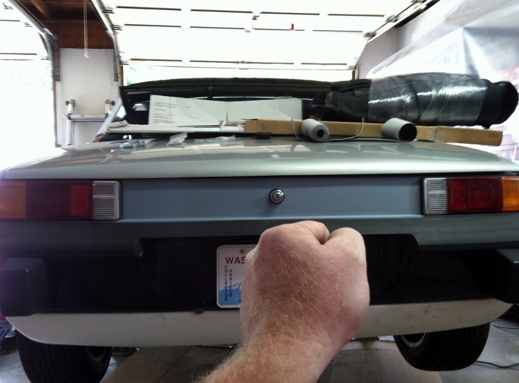

Now, all that is left is: finish the interior, french in the Passat marker lights, finish blending the flares, and prep for paint!

Nice Nate you went to town on the R. qtrs.!!
How much did Johns planishing hammer help?

Thanks Rich! John's planishing hammer was the KEY to having the fenders turn out this well! Without it, I would still be hammering away! Also, having a shrinking disc made the fine tuning a lot easier.
Since then, I have discovered the world of metal working and Kent White

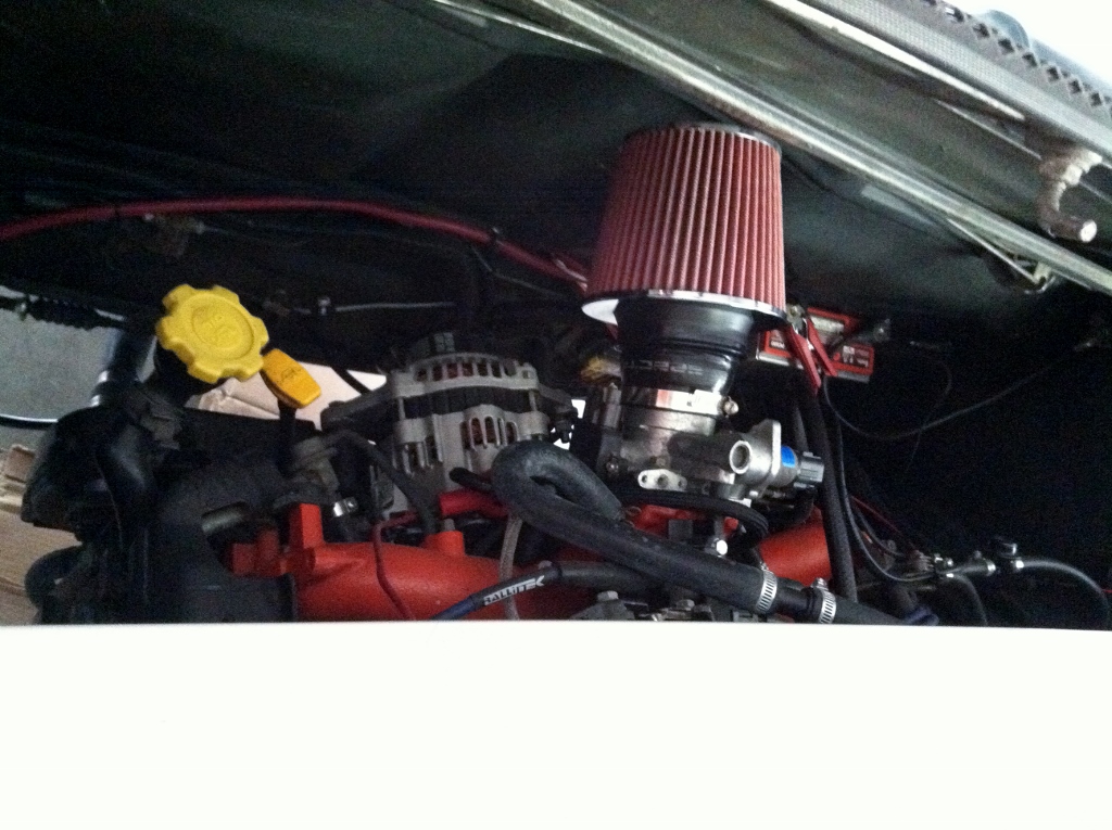

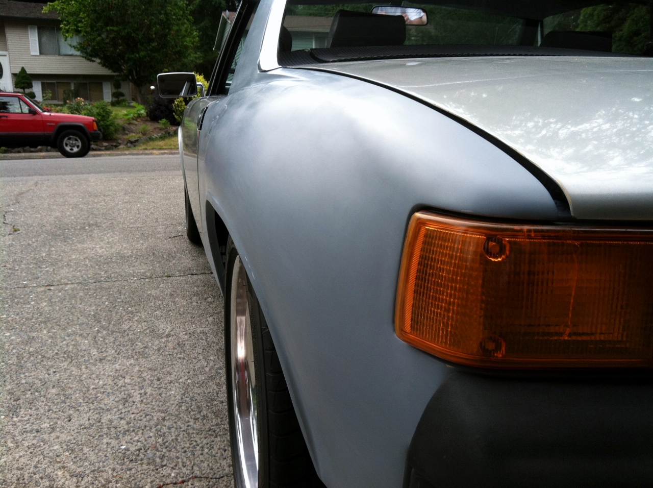

Had some loose ends to take care of: Fill in the passenger mirror holes
Started to smooth out the hand-shaped flares!

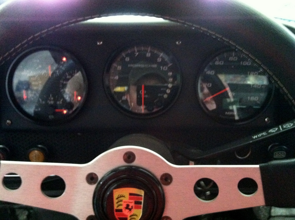

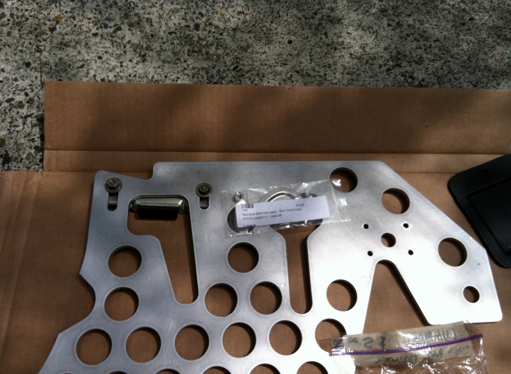

Finally got the SpeedHut Gauges installed!

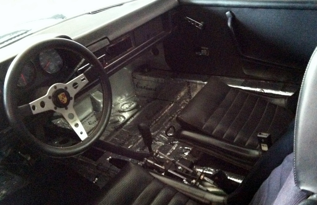

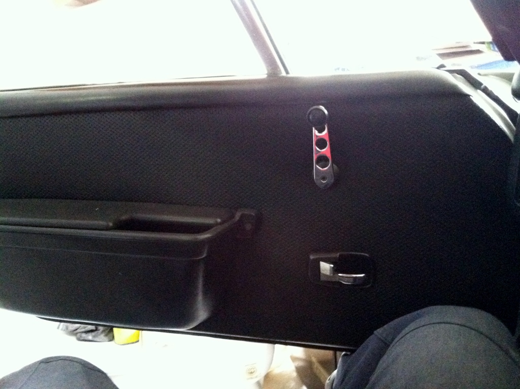

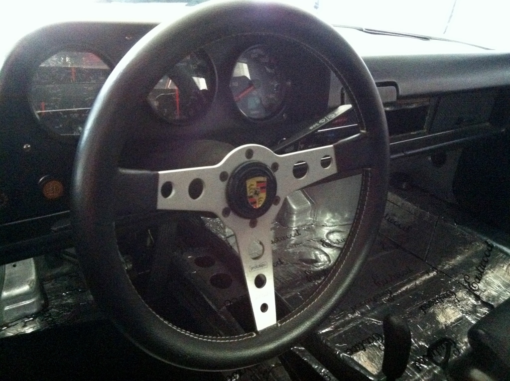

Got the door panels figured out

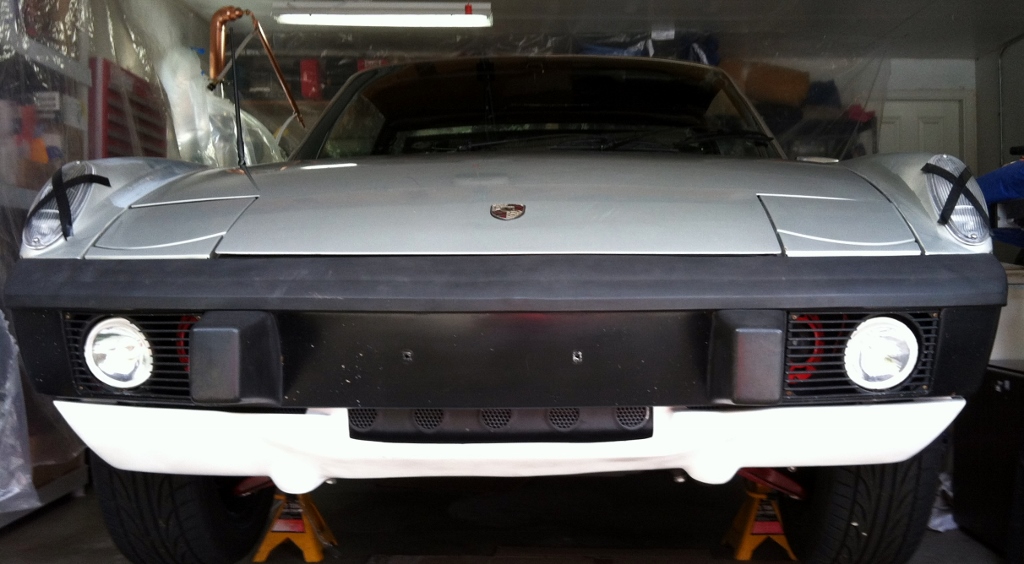

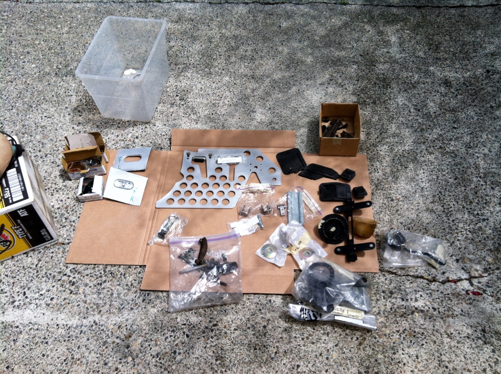

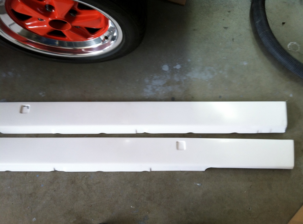

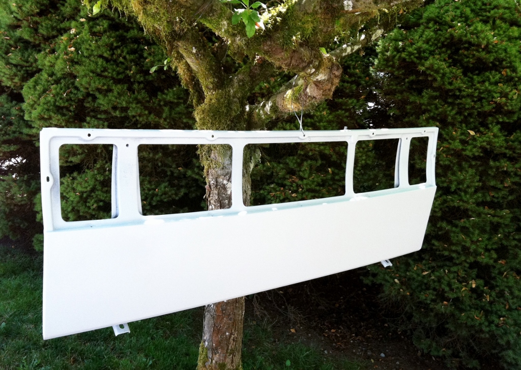

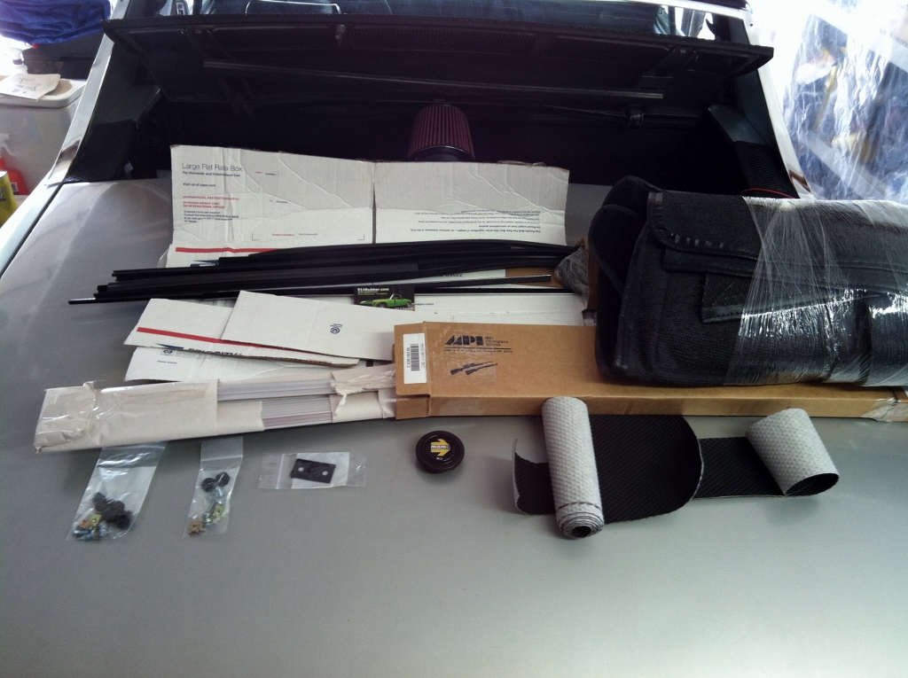

Started collecting body pieces and interior components:
front GT Valence
rear zero cutout valence to be fitted for Suby exhaust
Fiberglass rockers
Suby 2.5L all tuned up and rocking!
Aluminum Floorboard and pieces
Rubber 914 pieces and A&P carpet kit

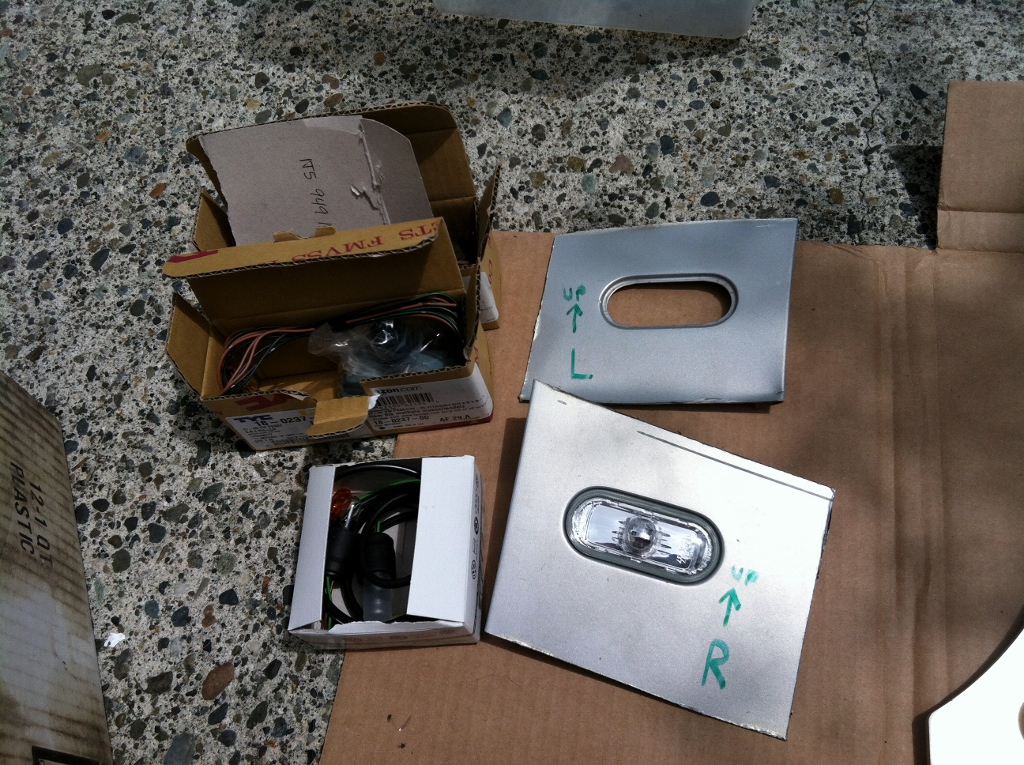

Decided against grafting in the VW Passat side markers
Everything compiled
Ready to disassemble everything!

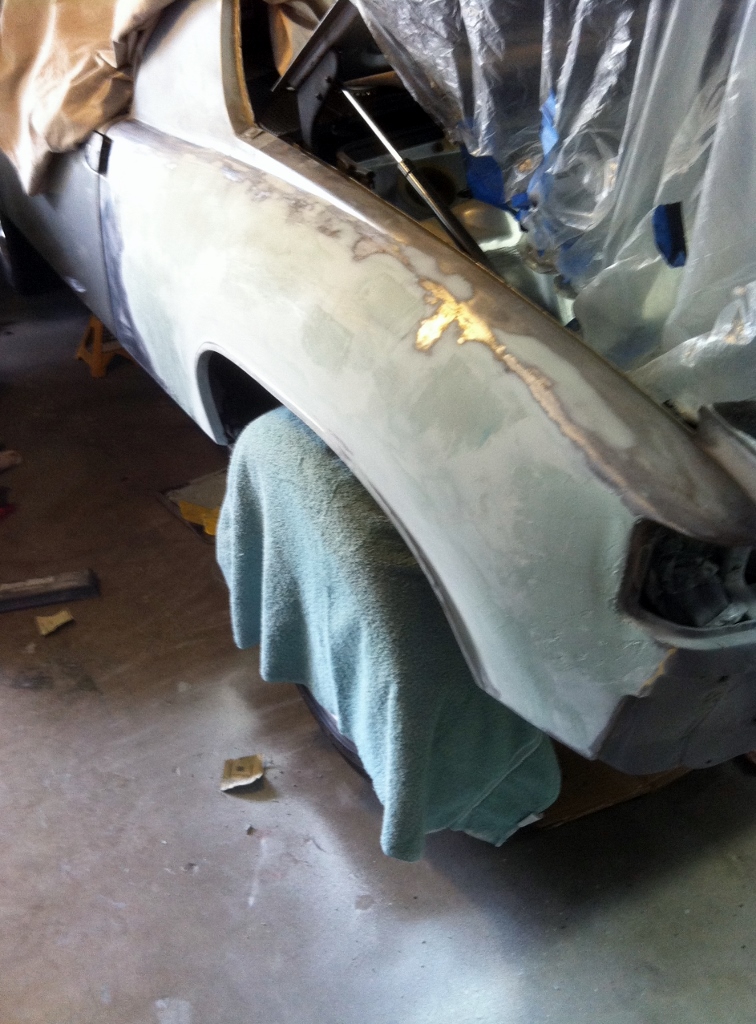

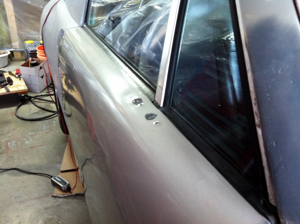

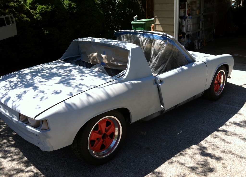

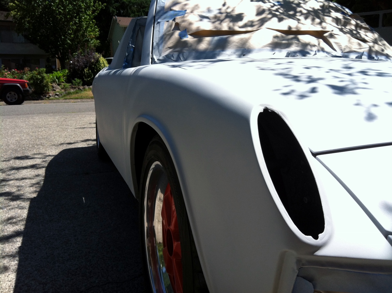

Took the doors apart, interior, and the trim.

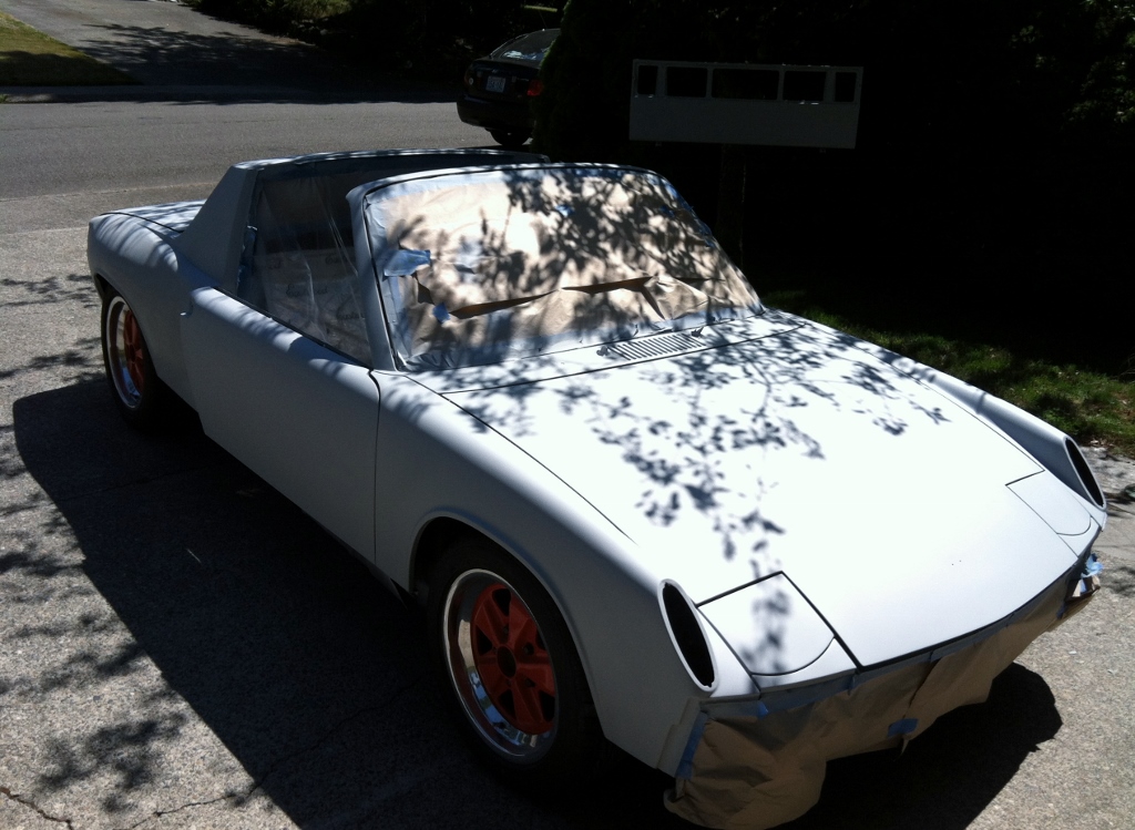

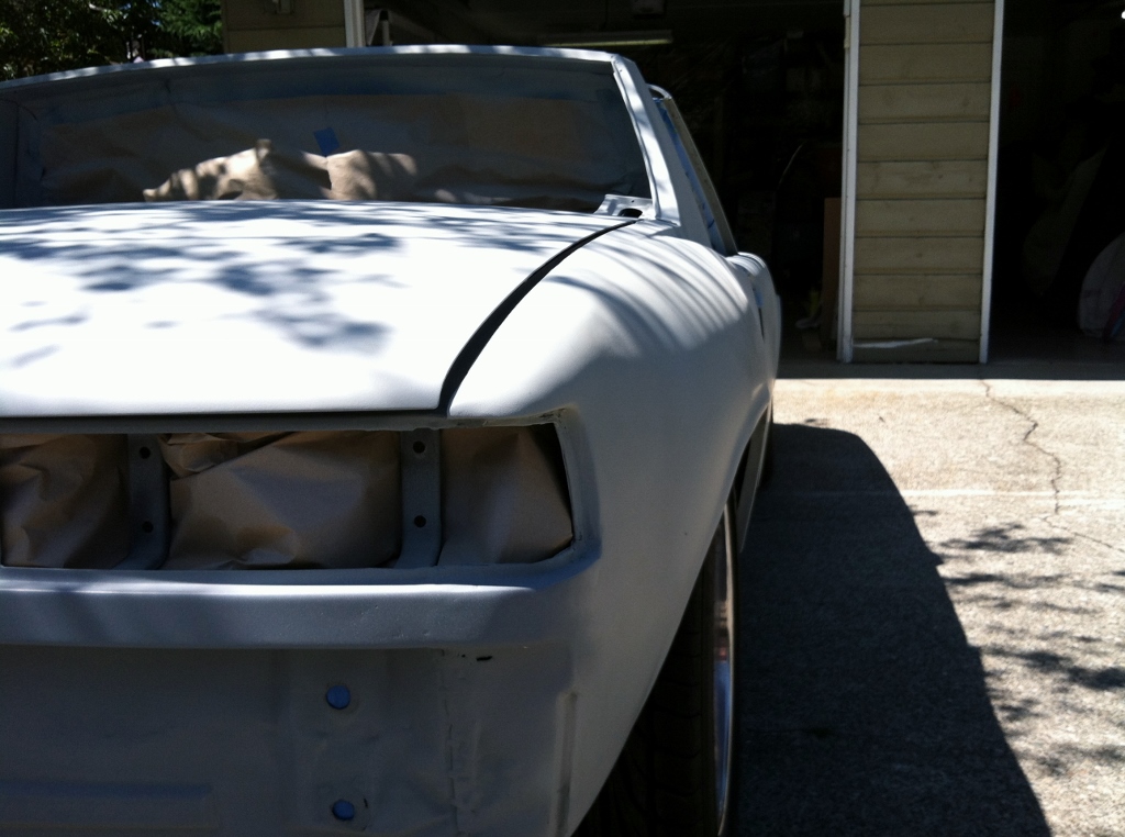

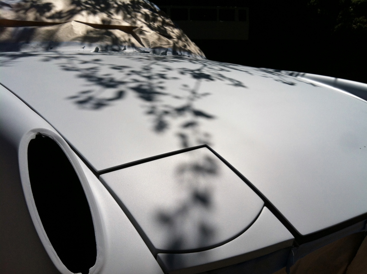

Prepped the car to 400 grit and mask it off for high build primer.
Then, tagged it up for a contrasting guide coat and blocked it down to wet sanded 600 grit! Holy crap that took forever!
Not pictured, but I am smoothing out the bumpers with a hammer & dolly & planishing disc!
More to come!!

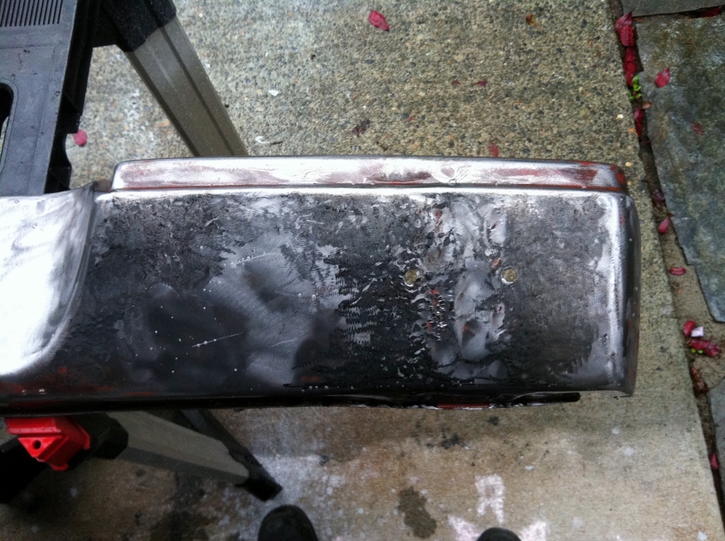

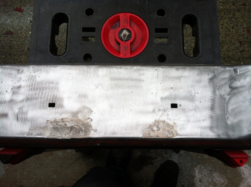

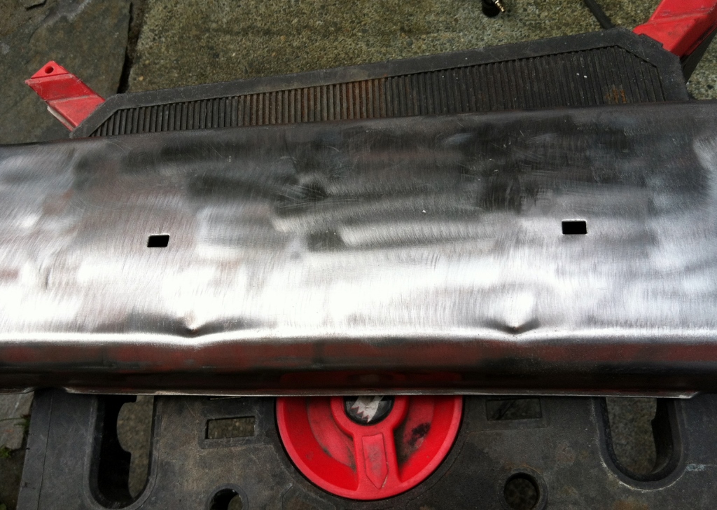

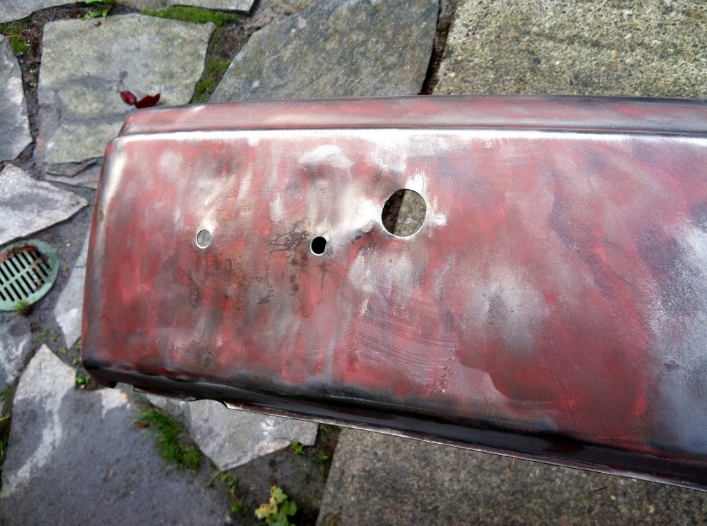

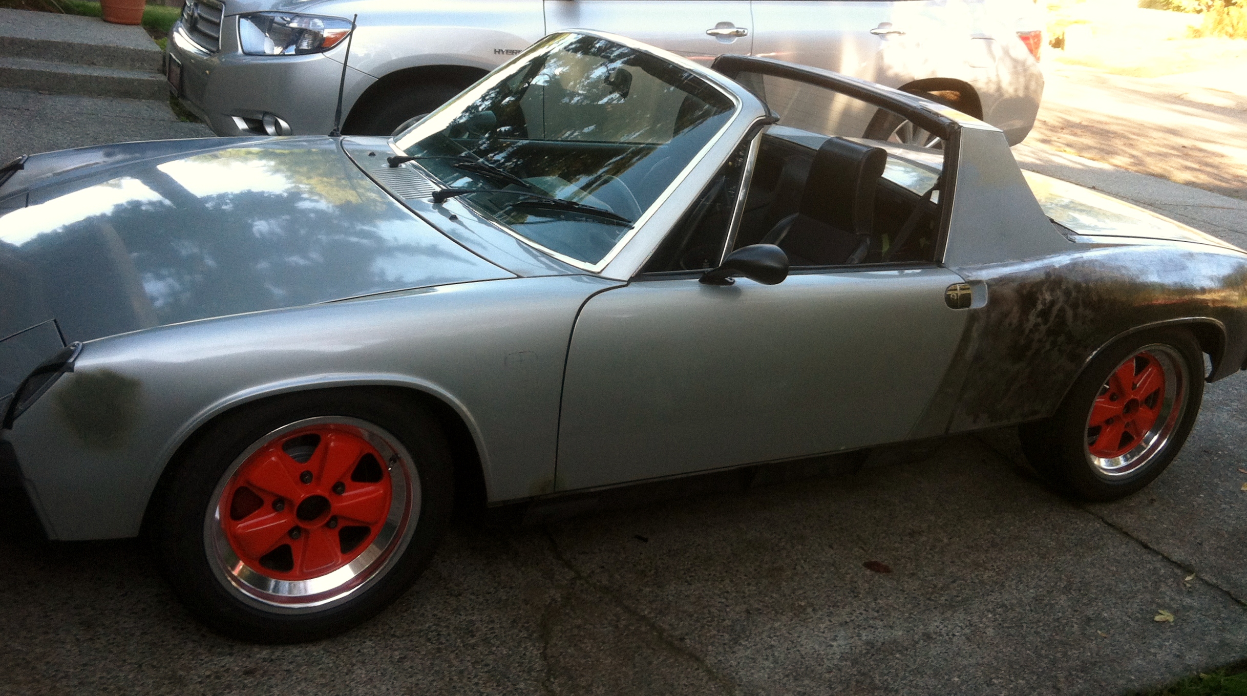

I have been trying to exercise my growing metalworking skills (IMG:style_emoticons/default/smash.gif)

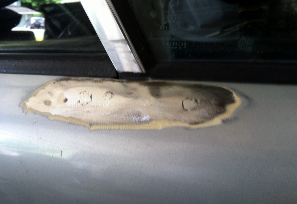

Took the rear bumpers down to bare metal and discovered that it had been bumped into in the past and repaired with .5" of mud (IMG:style_emoticons/default/barf.gif)
So, I used my hammer & dollys with the planishing hammer. Then, tried to smooth it out with the shrinking disc! Pretty good success for the areas I could work on not interfered with by the bumper brackets. Those areas will be finished off with a skim coat of glaze and concealed by the rear bumper tits.
So, put on the ear muffs and start massaging the metal slowly!

Then, got it pretty close for an apprentice! (IMG:style_emoticons/default/beer.gif)
The front bumper was good structurally but I wanted to get it ready for paint. Both bumpers will be smoothed down to 600 grit when I'm done (IMG:style_emoticons/default/piratenanner.gif)
