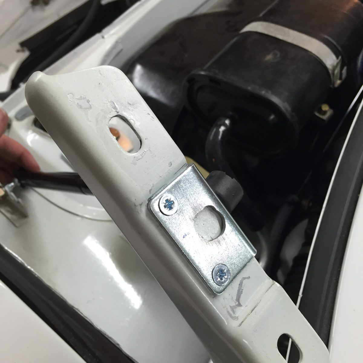

The light weight front hood kit I bought from Camp914 has never been working properly, the struts were too weak to hold the hood up so I finally got tired of it and set to fixing it.
(IMG:http://www.914world.com/bbs2/uploads_offsite/matsgarage.com-15176-1469079105.2.jpg)
Moving the hinge bracket to this location gives it a much better angle to hold the hood up. Drilled new holes and mounted the bracket with M5 countersunk screws and nyloc nuts.

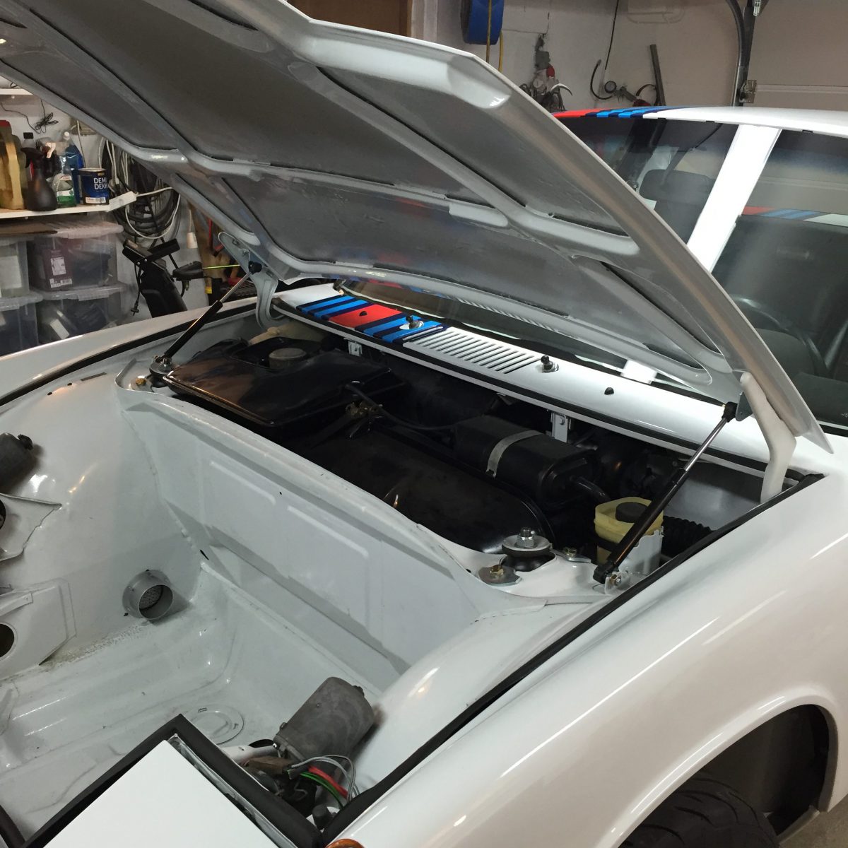

Tadaa! No more shamefull broomshaft to hold the hood up. (IMG:style_emoticons/default/biggrin.gif)

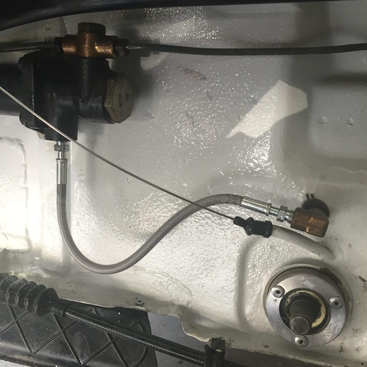

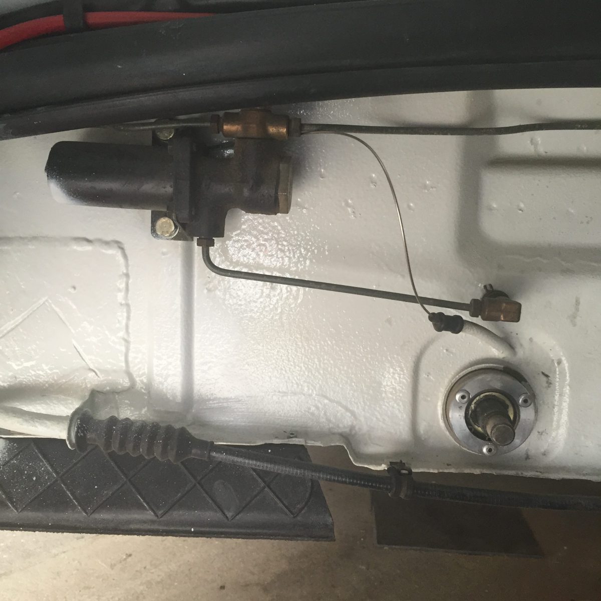

Another thing thats been bugging me is the brake pedal feel. I suspected I hadnt gotten all the air out of the brake pressure valve.
(IMG:http://www.914world.com/bbs2/uploads_offsite/matsgarage.com-15176-1469079108.5.jpg)
One 12 inch steel braided brake hose with male M10x1 in each end later and I can bleed the valve easily with two M10 bleed nipples on it, remount it on the firewall, reattach the hardlines and then bleed the rear calipers as normal. For apparent reasons I havnt driven the car yet but the pedal feels firmer.

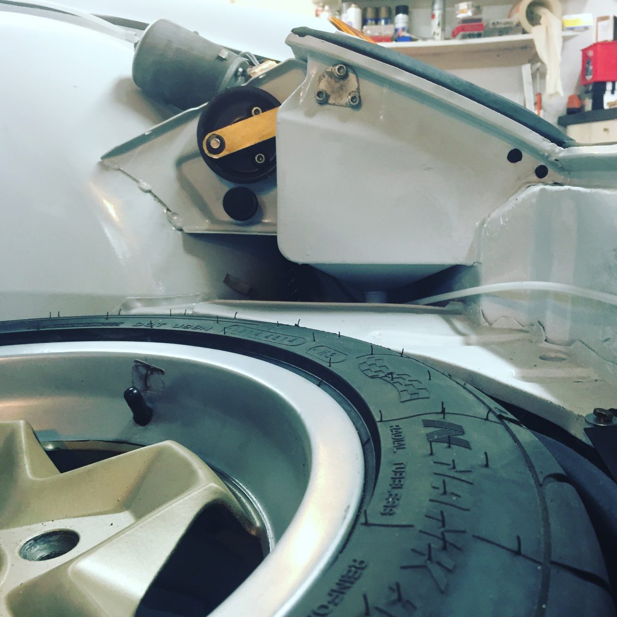

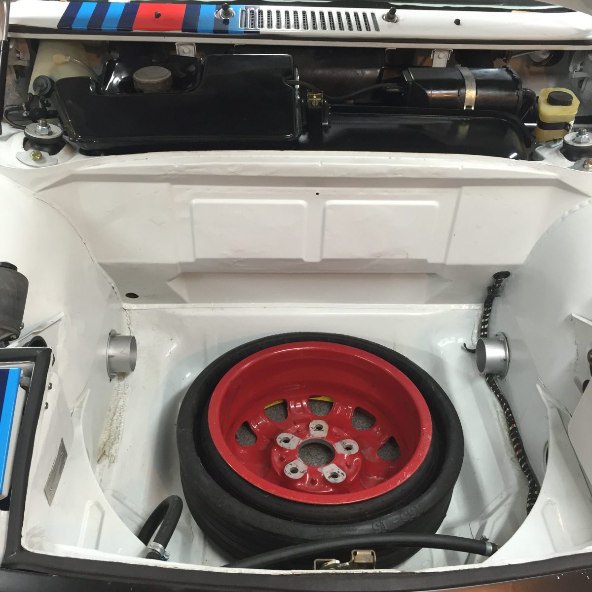

195/55-15 on a 7x15 rim is a bit wide for the front trunk board to fit in place.
(IMG:http://www.914world.com/bbs2/uploads_offsite/matsgarage.com-15176-1469079237.1.jpg)
Spare wheel from a 944 will have to do.

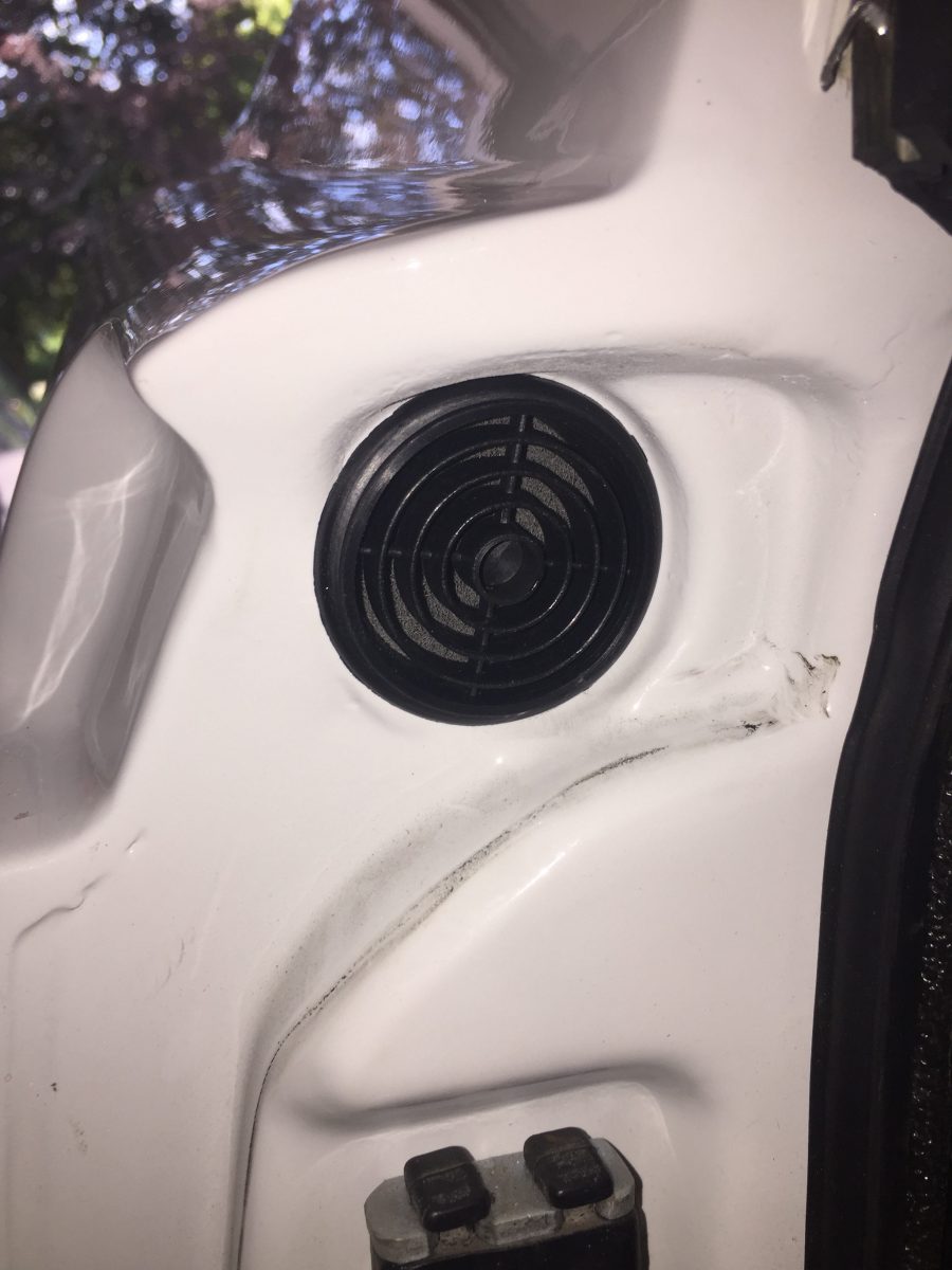

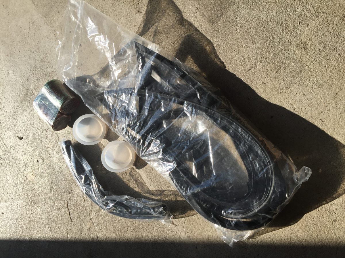

New parts from 914rubber arrived today, the new front trunk seal, heater valve hoses, raintray hoses, trunk targa cups and the door jamb vents.
(IMG:http://www.914world.com/bbs2/uploads_offsite/matsgarage.com-15176-1469210053.2.jpg)
Fit and finish was perfect. Good job Mark! (IMG:style_emoticons/default/smile.gif)

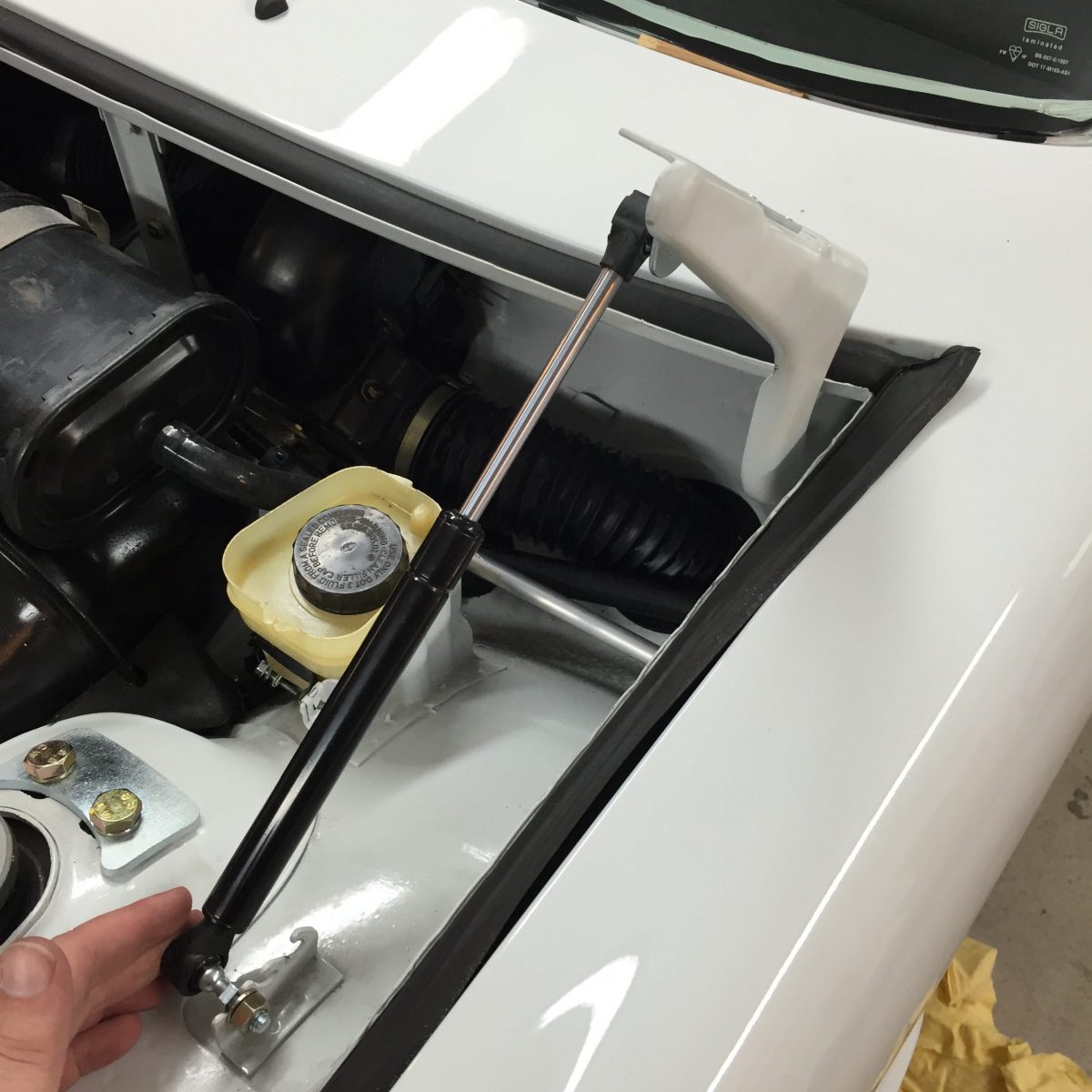

could you measure the gas struts and see what the writing on the side says for how many kilos its supposed to hold please ?
The strut is 30 cm extended and 20,5 compressed. Theres no text on it at all but when compressed and held against a bathroom scale is shows 8,5 kg's.

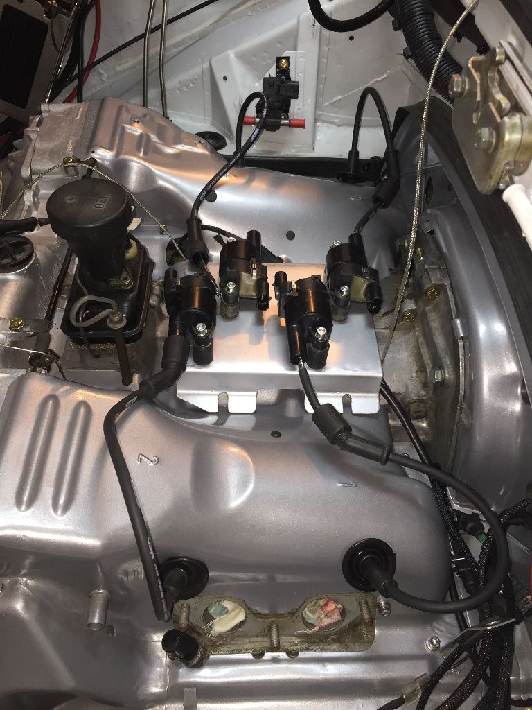

(IMG:http://www.914world.com/bbs2/uploads_offsite/matsgarage.com-15176-1471631873.1.jpg)

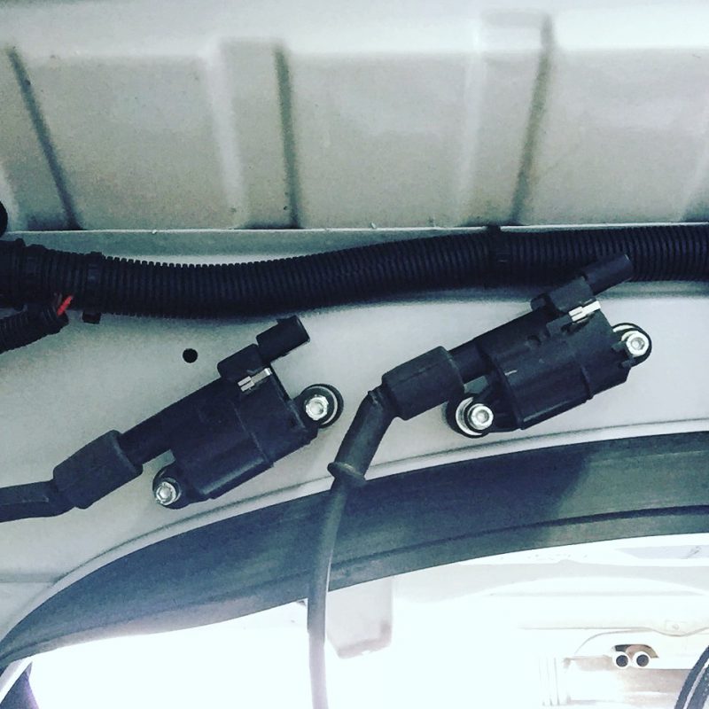

Previously I had the ignition coils mounted on an aluminium bracket sitting ontop of the engine. But I didnt like the cluttered look of it with all the connectors attached.
(IMG:http://www.914world.com/bbs2/uploads_offsite/matsgarage.com-15176-1471631874.2.jpg)
So now I'm mounting the coils on the rear wall of the engine bay. Using aluminium M6 rivnuts to attach the coils to the sheet metal.
jd74914
post Aug 19 2016, 01:03 PM
Post #213
Its alive
Posts: 4,841
Joined: 16-February 04
From: CT
Member No.: 1,659
That look is better!
Are you mapping for ethanol content changes? It looks like you have a Continental flex fuel sensor mounted on the suspension console.
falcor75
post Aug 19 2016, 02:49 PM
Post #214
Posts: 1,579
Joined: 22-November 12
From: Sweden
Member No.: 15,176
QUOTE(jd74914 @ Aug 19 2016, 09:03 PM) *
Yes its an ethanol sensor but to start with I will be running straight 98/99 octane premium fuel in the newly built engine so while the sensor is fully wired up to my ECU its readings will not be used in the fuel map.

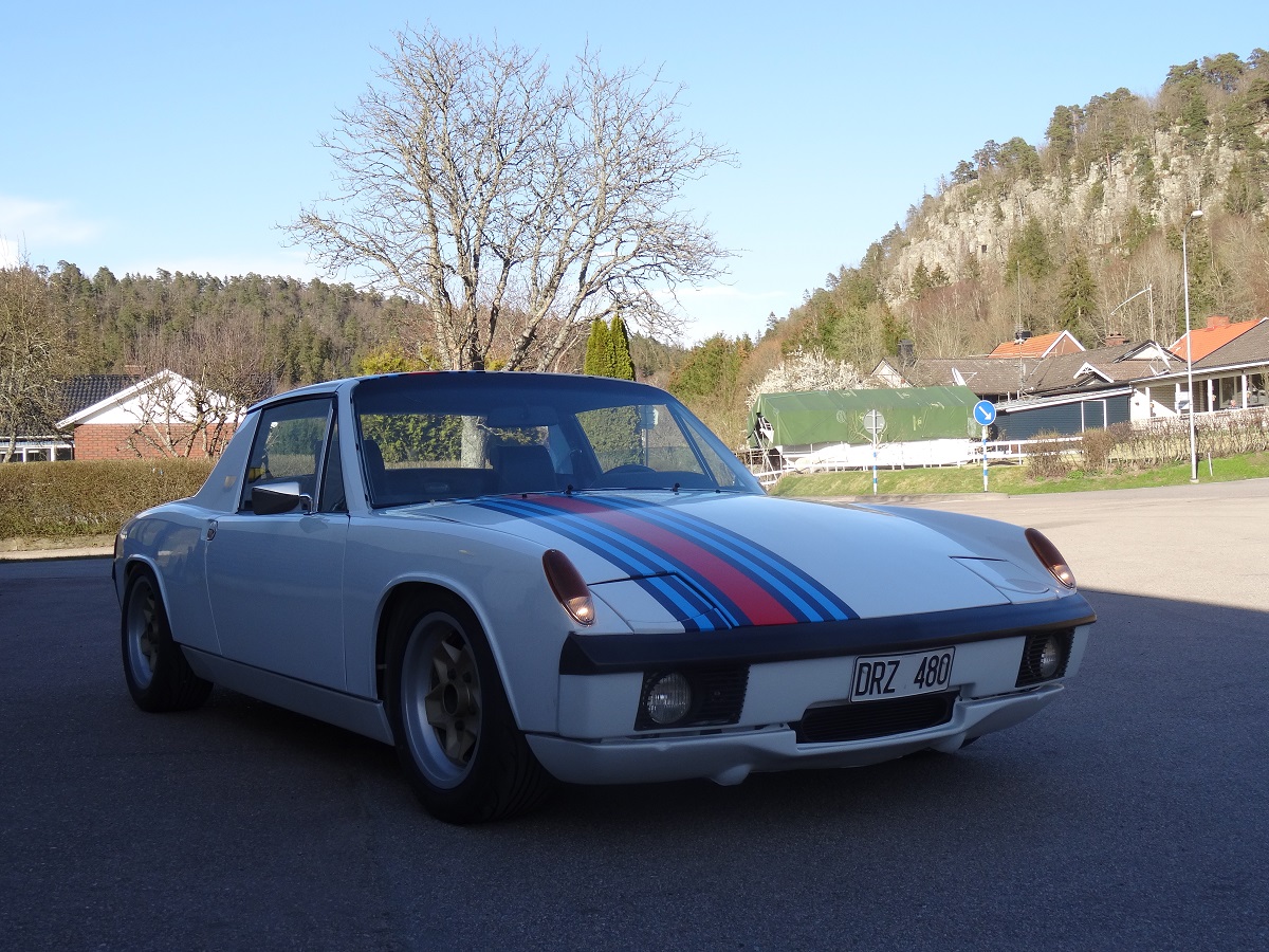

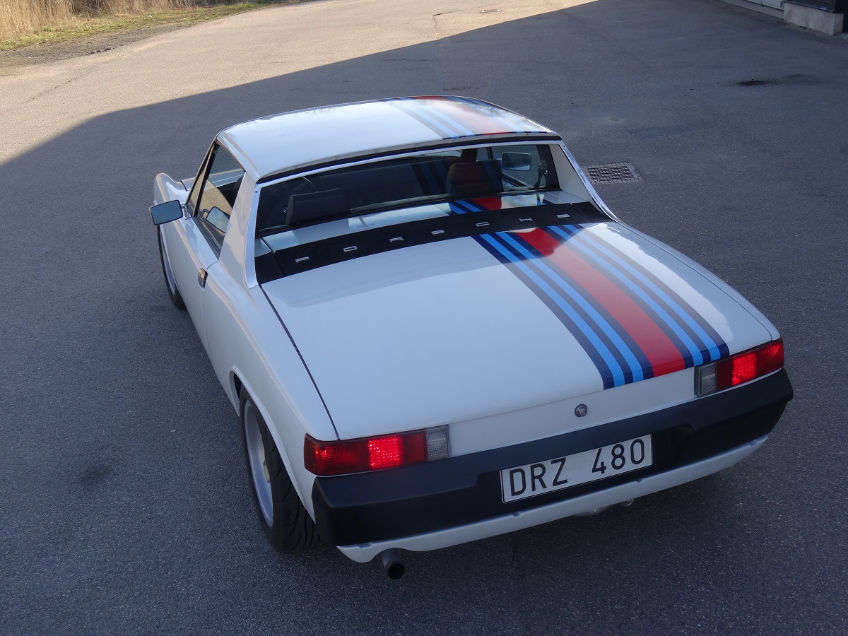

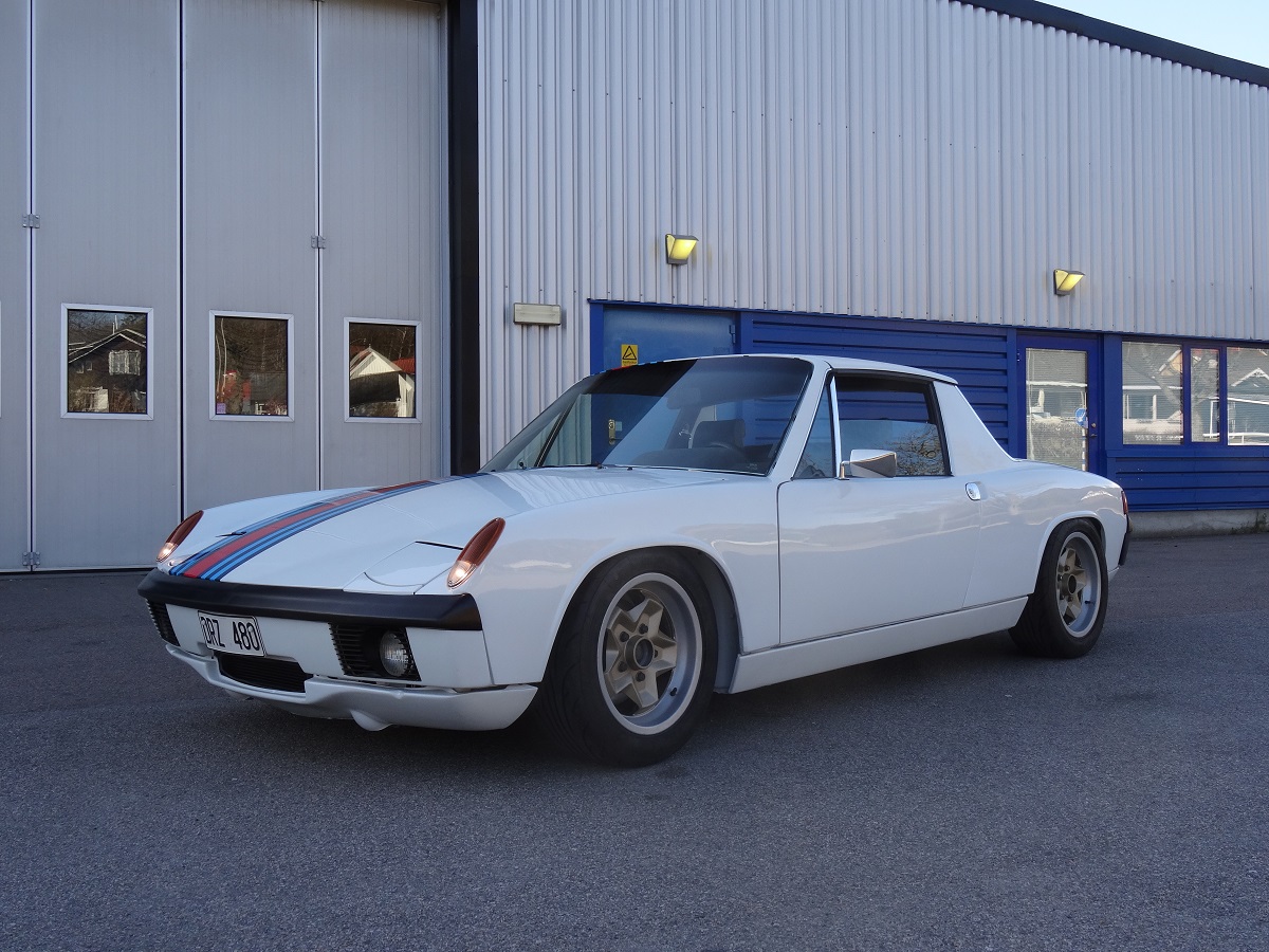

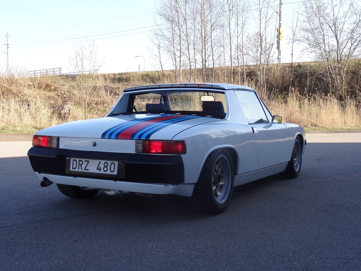

Well as some of you know I've had issues with how my 2270 engine was built so today it was sent back to the builder to be fixed. But here's some nice pics from this spring when I drove around the block with the stock 2.0 for the first time with all the panels on, the only thing missing is the doorcards. (IMG:style_emoticons/default/smile.gif)
Also got Spokes front LED in white/amber waiting to go on but I'll wait with mounting those untill the car has been inspected and passed the "mot" test.
