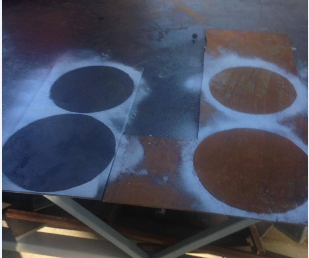

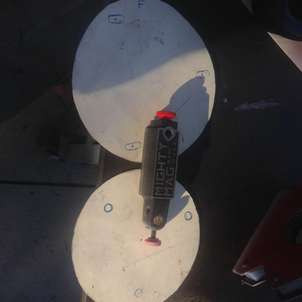

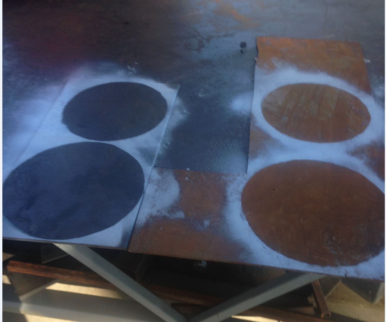

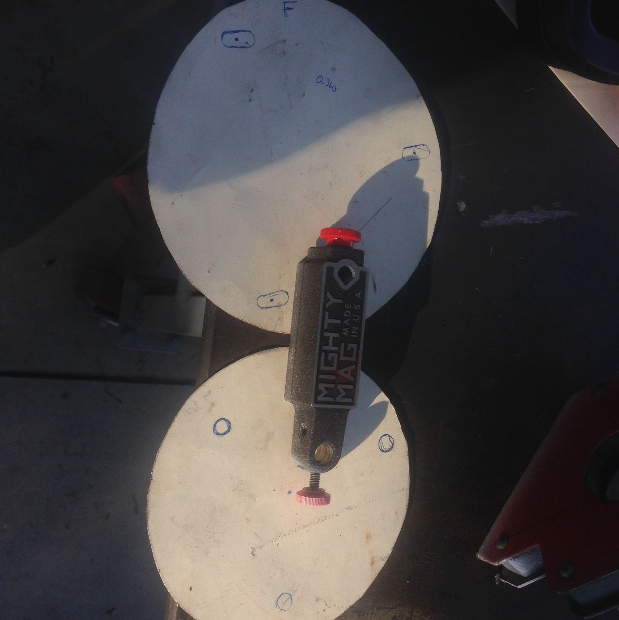

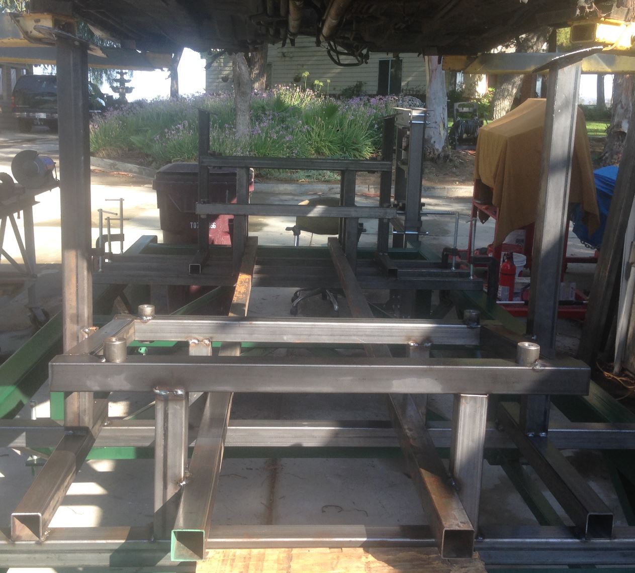

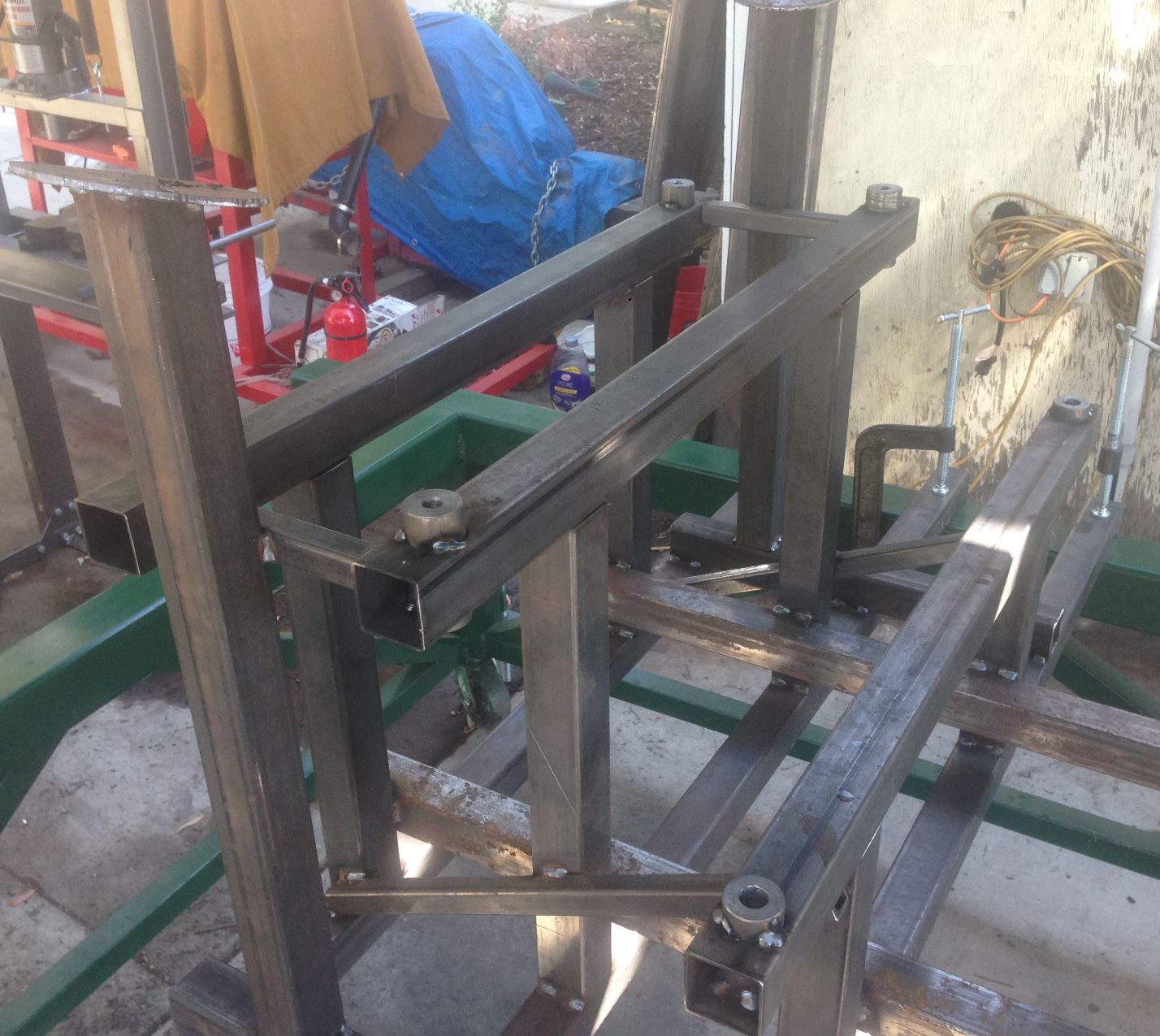

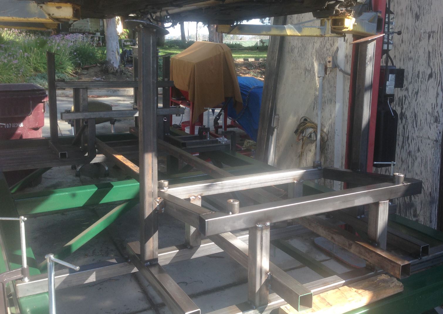

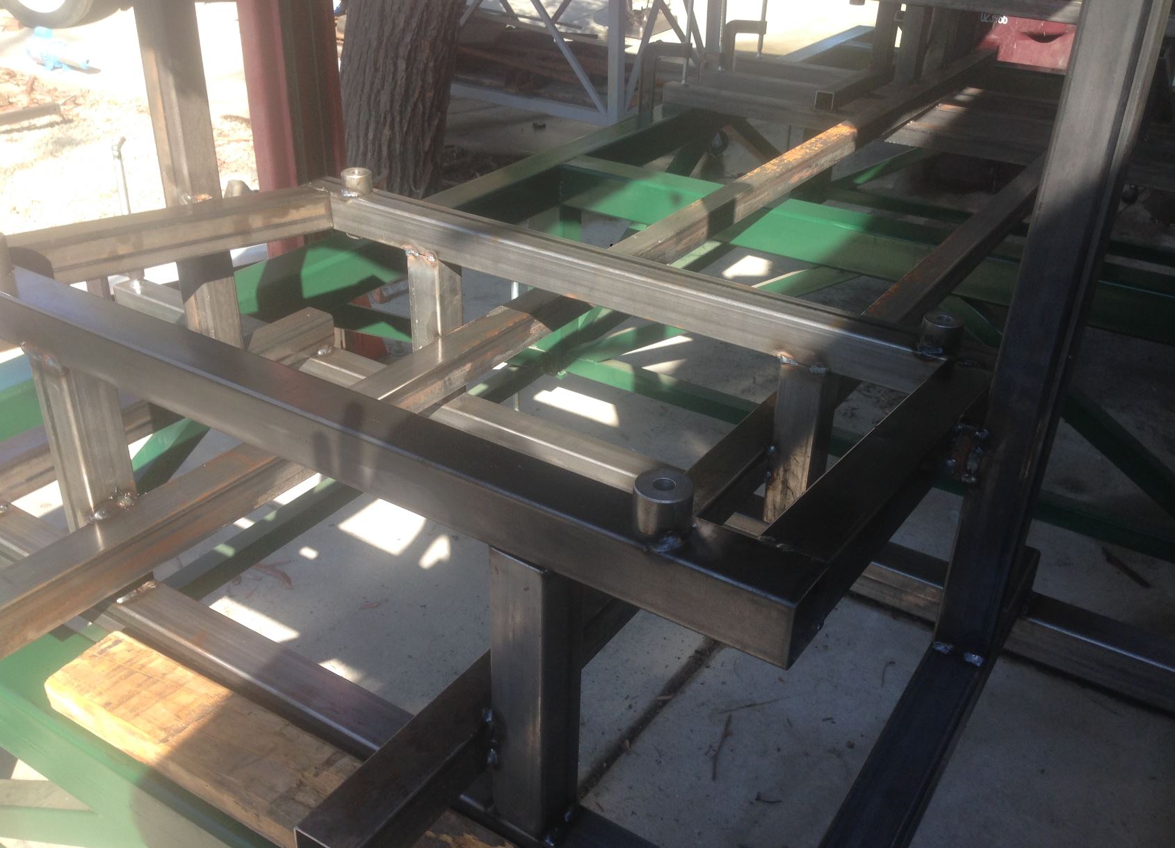

Attached are pictures of how I located and tied the strut locations to THE NEST. Man we had to do alot of (IMG:style_emoticons/default/sawzall-smiley.gif) of the 996 frame to get these locations.
Here is the space age template for the strut towersAttached Image
Here is the space age marking of said templates Attached Image
This is what was used to cut Attached Image
Here it is in place Attached Image

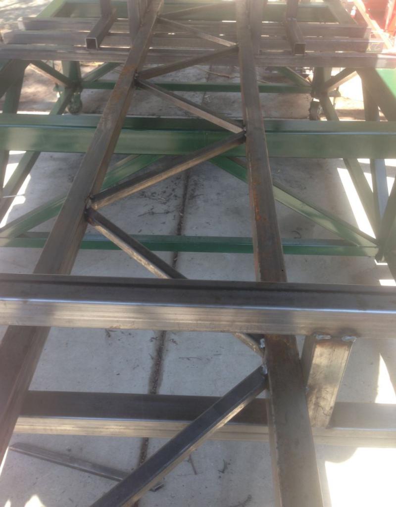

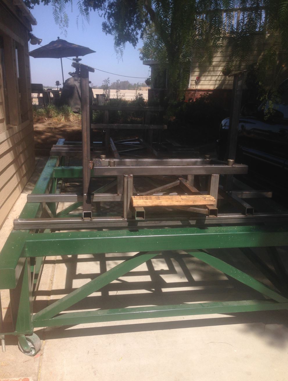

Well the suspension nest is complete and the 996 can be pulled off and put away.

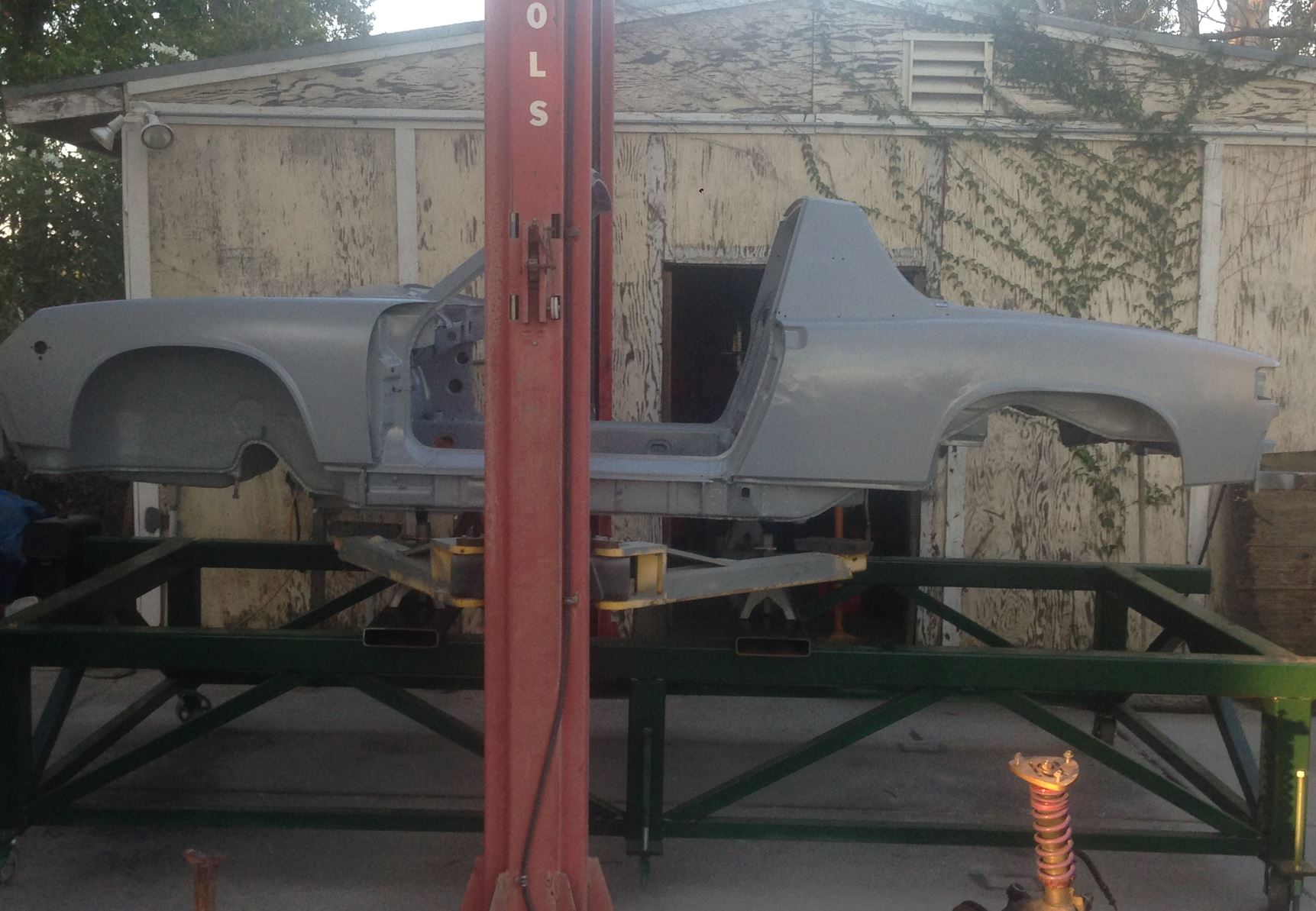

Well the 996 is finally off the nest and no longer needed. Big milestone for me. (IMG:style_emoticons/default/cheer.gif) (IMG:style_emoticons/default/cheer.gif) I'm blasting the 914 this weekend and epoxy primering it.

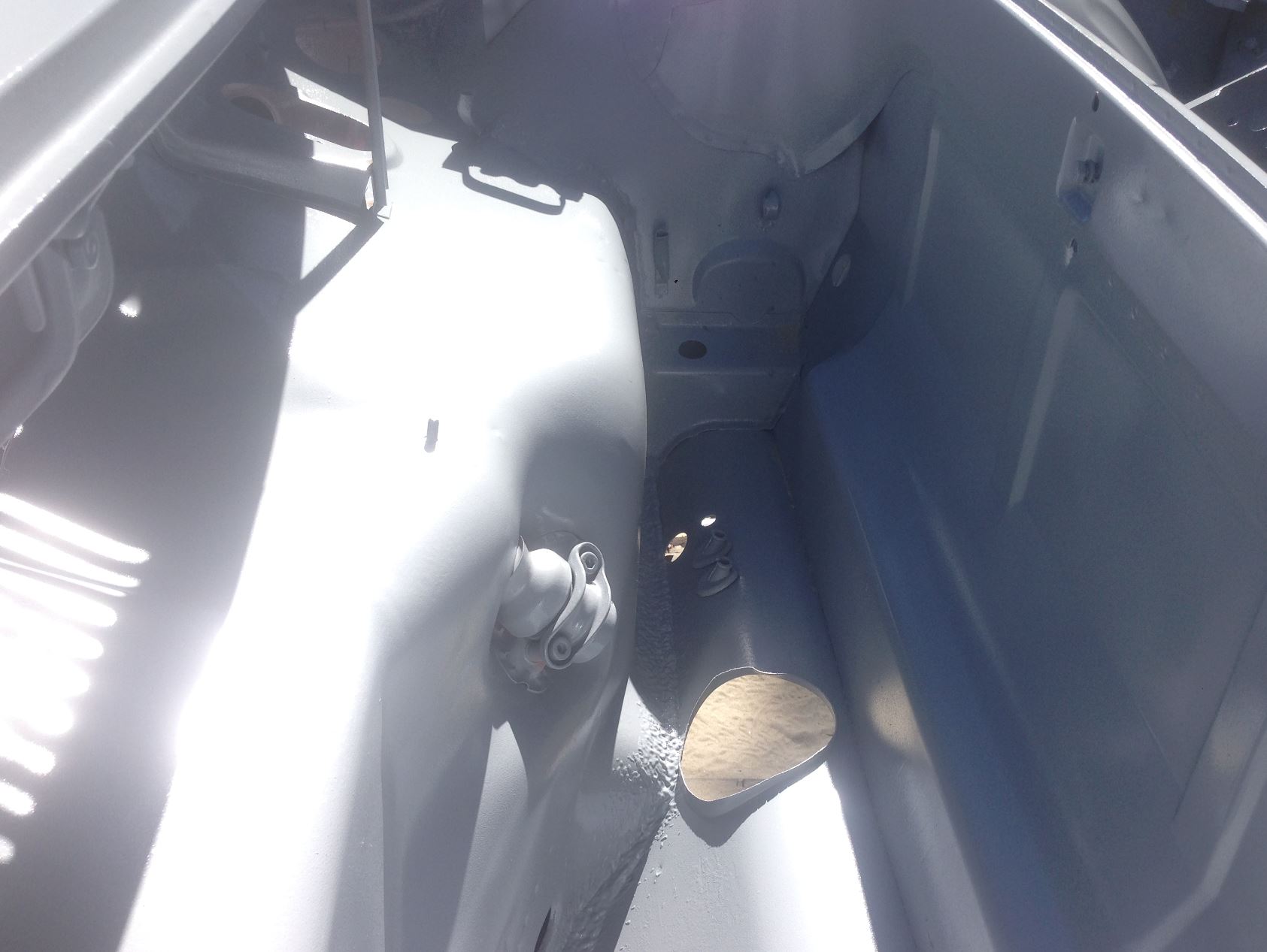

Well I started to wet blast the 914 and I ran out of sand. I've already used 2000 LBS. I think that I can get away with another 5 bags but I'll just get 10 just in case. Sand is cheap. Here is the video

I'm using the Power Eagle set up. I blew by 2000 lbs of sand and no clog ever. I would dump 300 lbs (3 bags) of sand into a 35 gal trash container. Then I covered to keep the sand dry and clean of debris. I absolutely loved the performance. It wasn't cheap though. It cost $300. However, it did not clog once and I even turned it upside down. I am using a Dewalt 4200 PIS with 4 GPM. Sand is #30 silica sand.

Yes I was very happy with the performance. It will probably take another 2 hours. For a total of 7 hours and 2500 lbs of sand. Let me tell you though it is the messiest job you will ever do. It's best to do in an open field or in an enclosure. Definitely not something to do in your shop or in your driveway. I'm on 2 1/2 acres with no neighbors so it worked out for me.

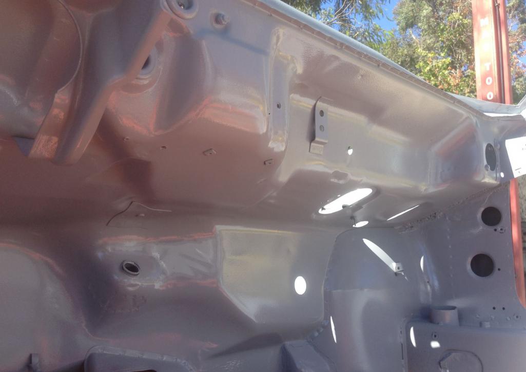

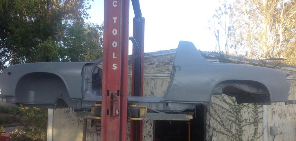

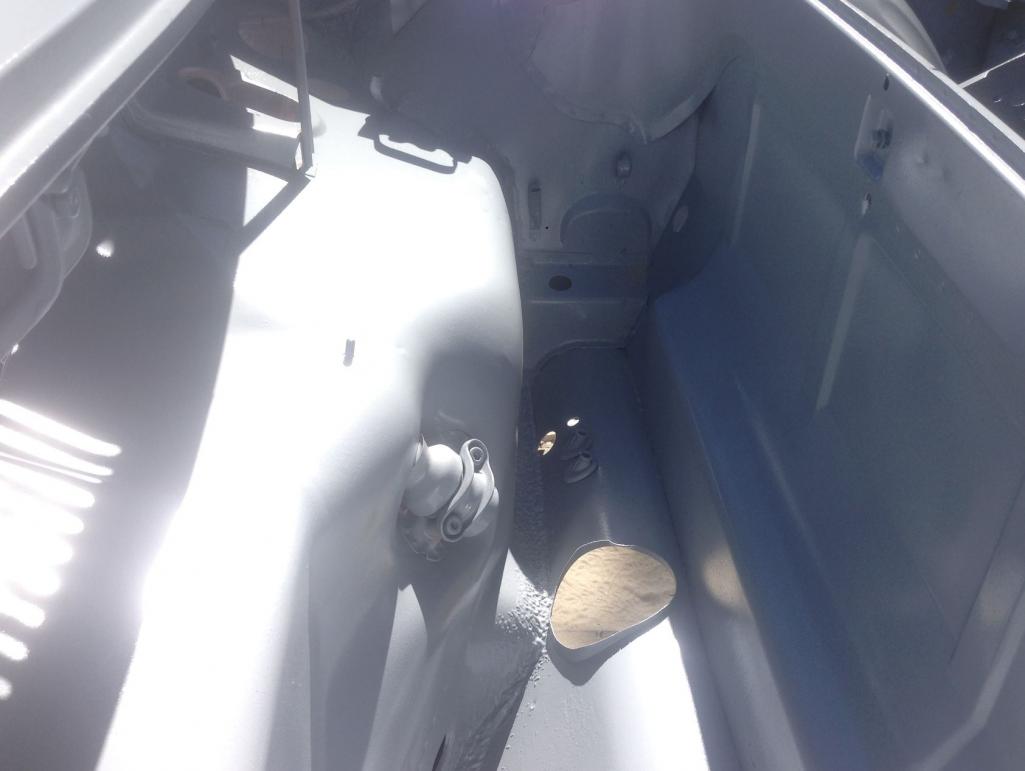

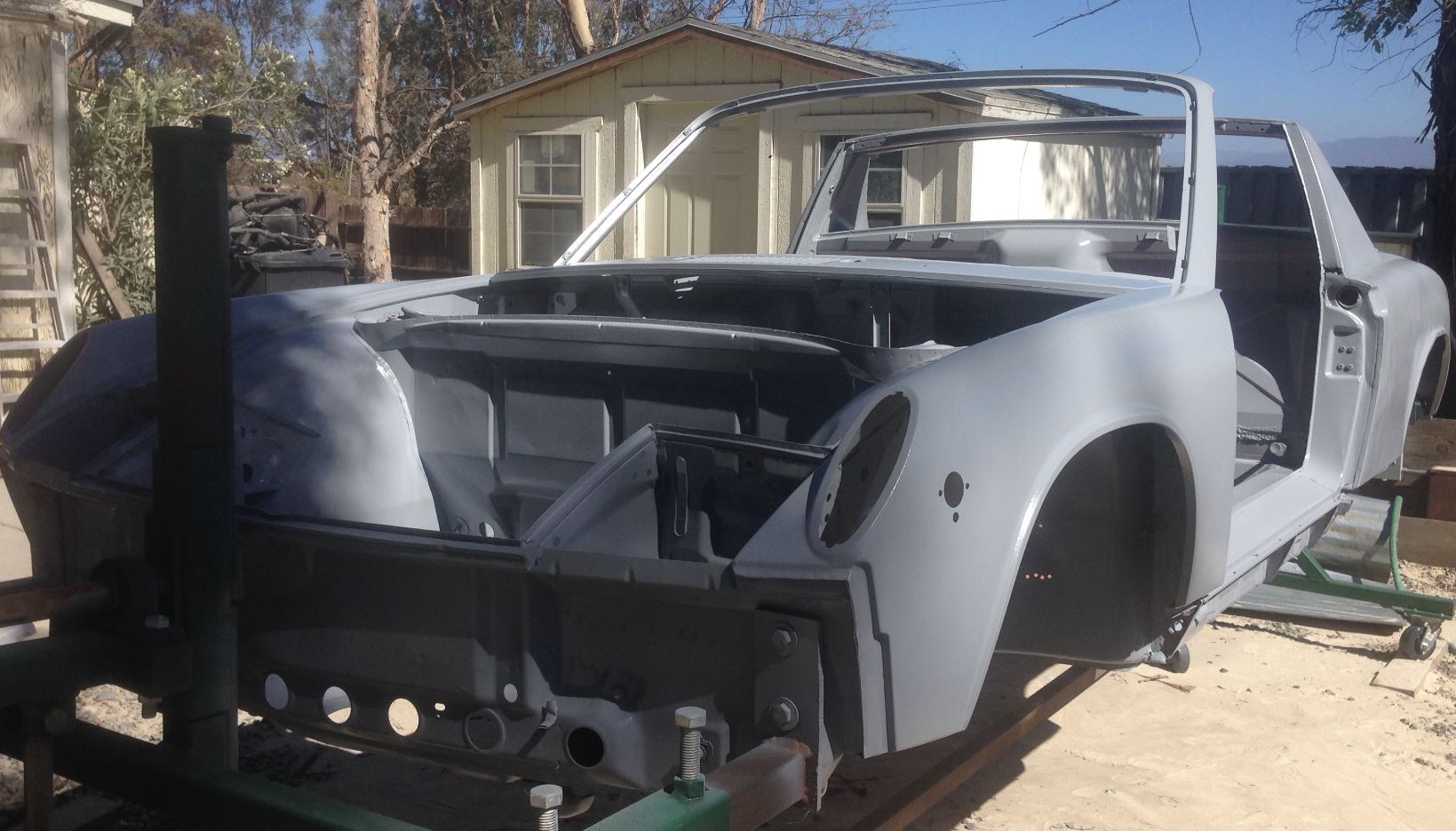

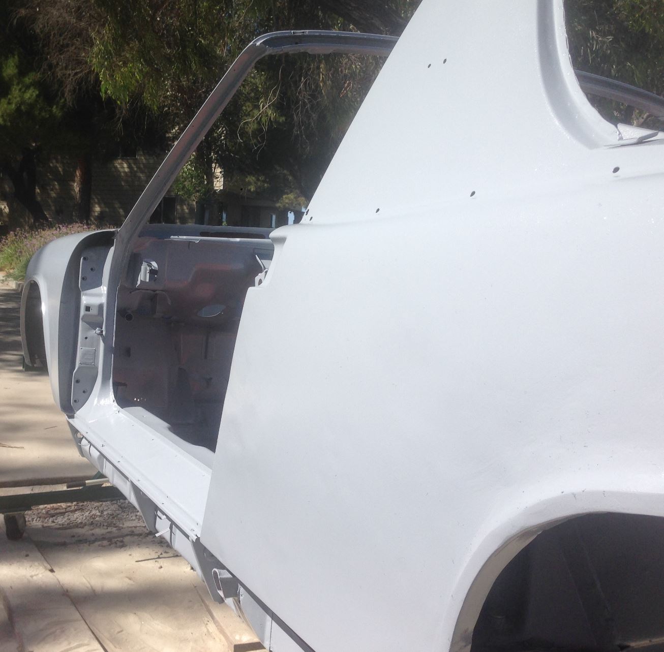

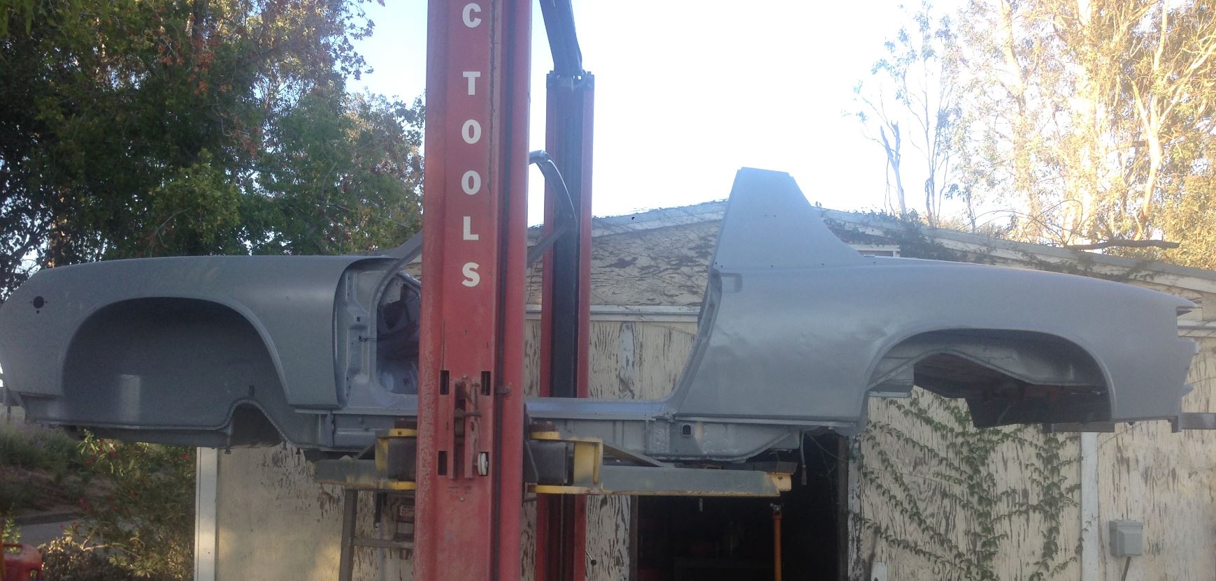

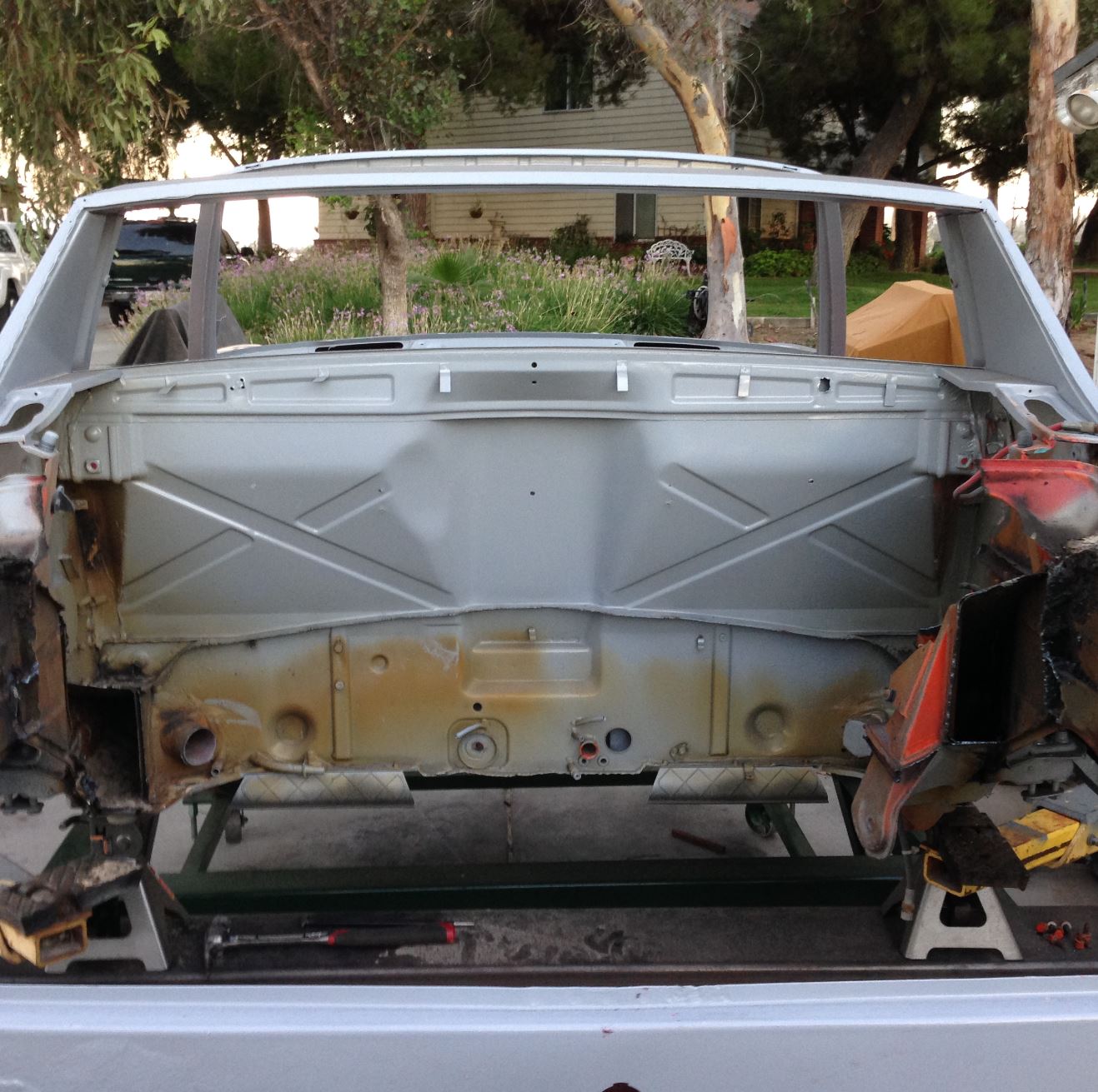

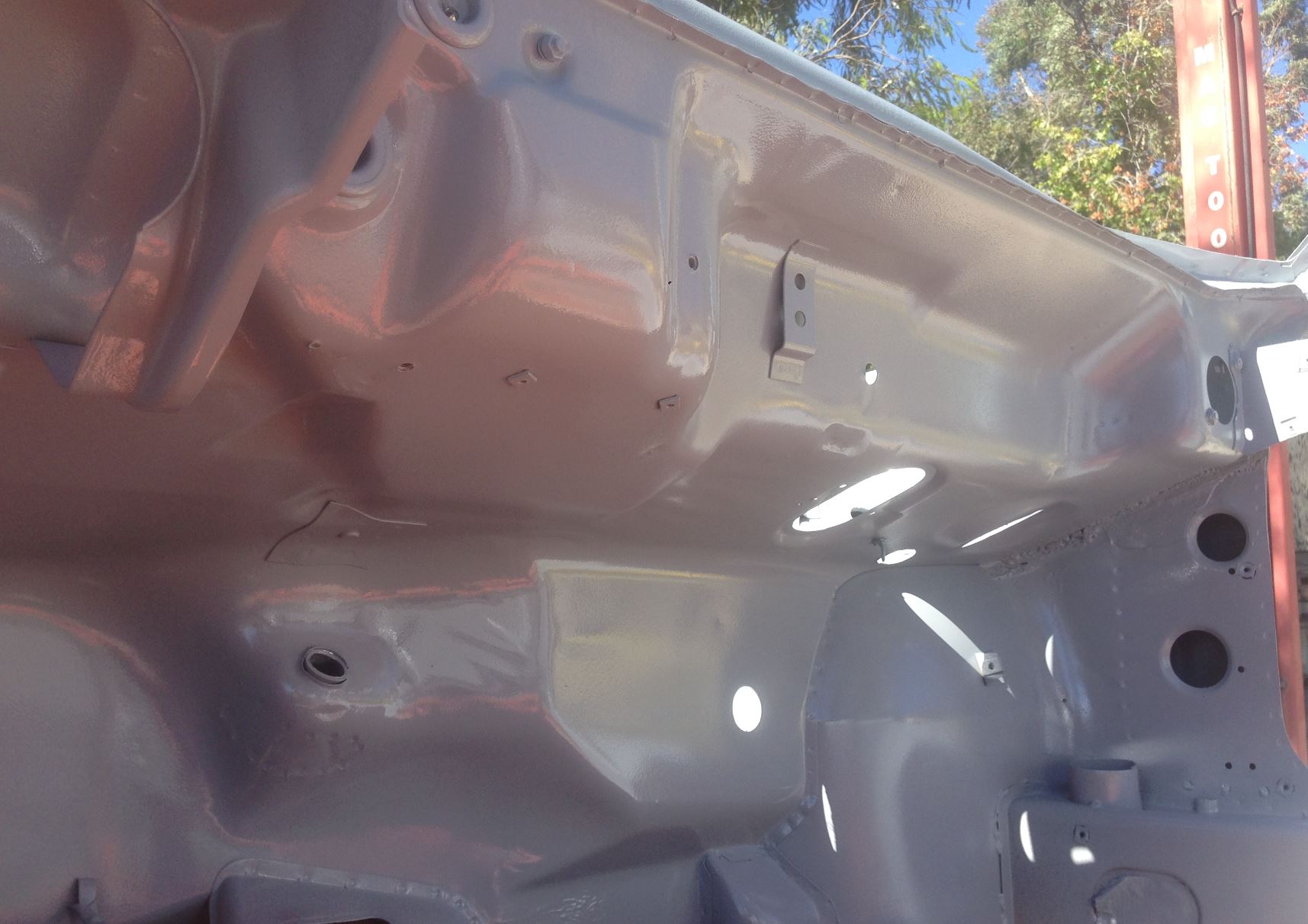

Well I finished epoxy primering the 914. The next step will be to mount onto the chassis table, take some twist measurements and start building the tube chassis. I will be replacing the entire floor. It's just too banged up and rusty to mess with. I will also be removing almost the entire rear half. The entire rear half will be in steel tube and rear half of the body will be bolted to the tube chassis. Found 4 rust areas that I will need to repair. That can wait as they are not in the way of the tube chassis.

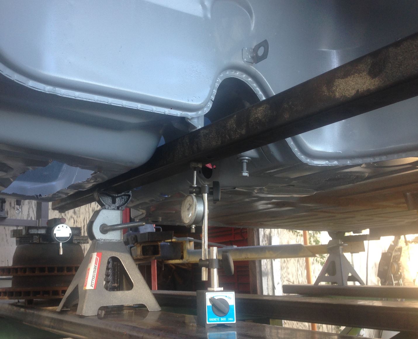

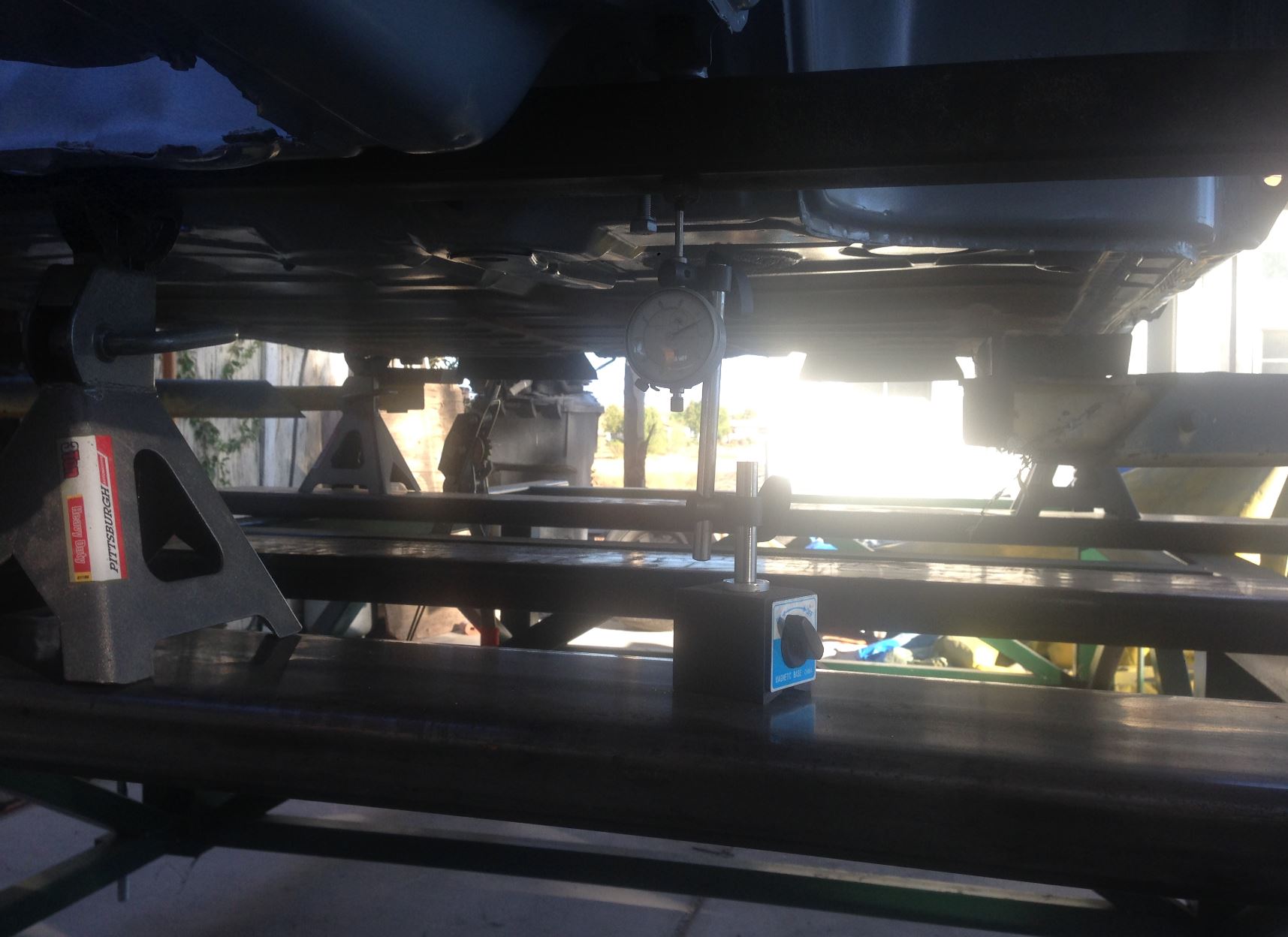

Well CSDilligaf came over today and we did the twist testing on the 914. The final numbers are in! The 996 C4 Cabriolet has stiffness of 4,568 '#/Degree. The 914 has a stiffness of 3,326 '#/Degree. So the 996 C4 Cabriolet is 37% stiffer in torsion than the 914. Makes sense, since you'd think that the newer Porsche should be stiffer than the 914, which was built with technology of the 60's. The next step is to place the 914 on the suspension nest and start building the tube frame. I was thinking of stiffening the longs with the Engmann kit, but I'm steering away from that. I will be stiffening the "longs" with a truss system built inside of the longs. That will be the first order of work. I will twist test again at that point and see what improvement we get.

Why not give Engman a call and see if they will give you a kit to test with? I know if I was the manufacturer I would want to know what it did. Im sure he would give you a kit for free.... Most of us run the Engman kit and I for one am curious what real world difference it makes.

As far as trying to see how well the Engman works (inside reinforcing) or Mayeur (outside reinforcing), bring your car over and we will twist it. Have to wait until I'm done with my car though. I'm in Murrieta Ca. It's about 1 hour north of San Diego and about 1:15 hours South of Los Angeles. PM me and we can discuss.

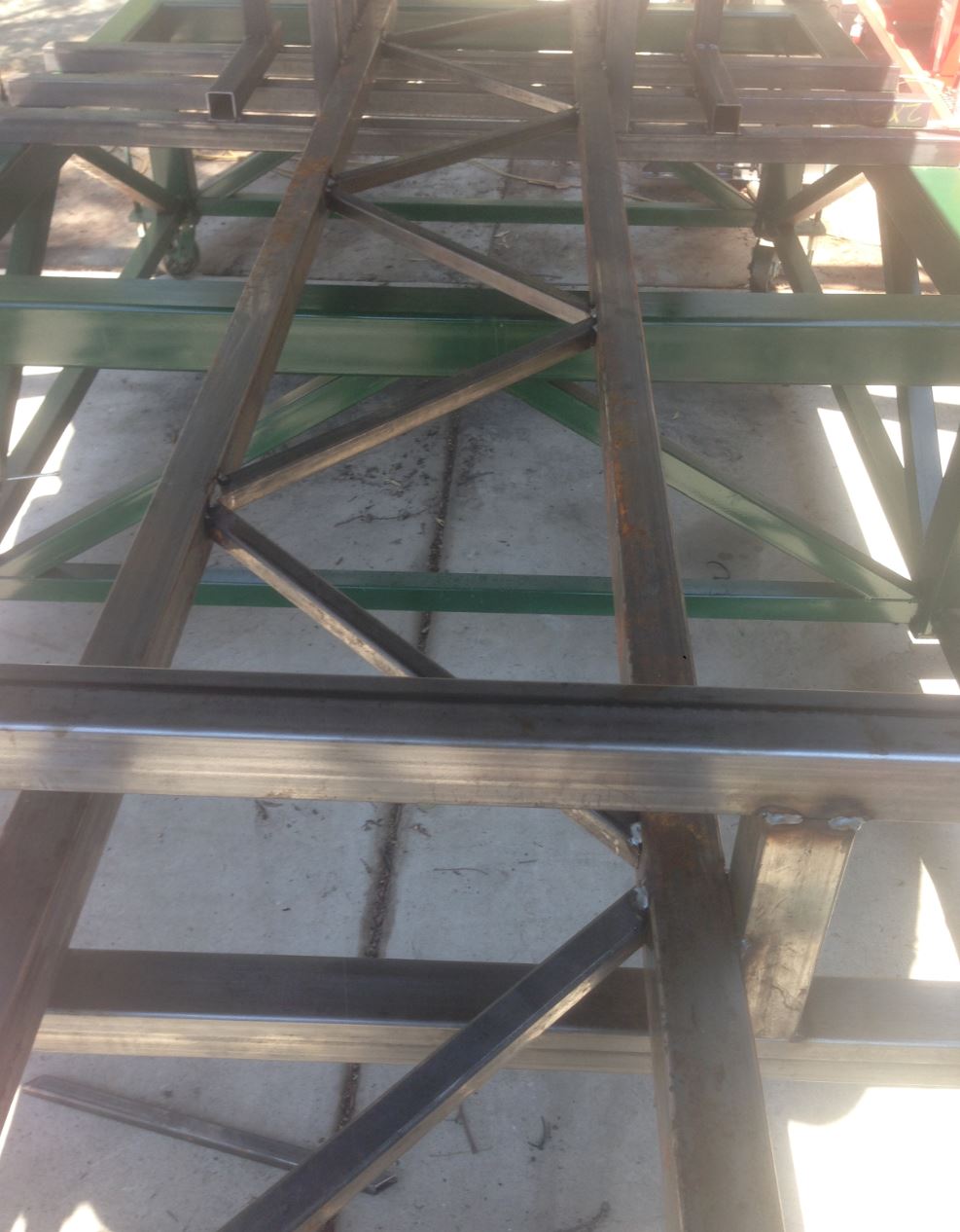

Steel for chassis is coming in tomorrow. Going to build 6 turnbuckle braces to square up driver compartment before I get started. Should have nest in place this week as well. Let the chassis building begin. (IMG:style_emoticons/default/cheer.gif) (IMG:style_emoticons/default/cheer.gif)

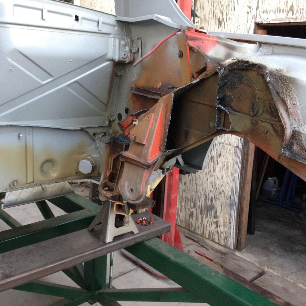

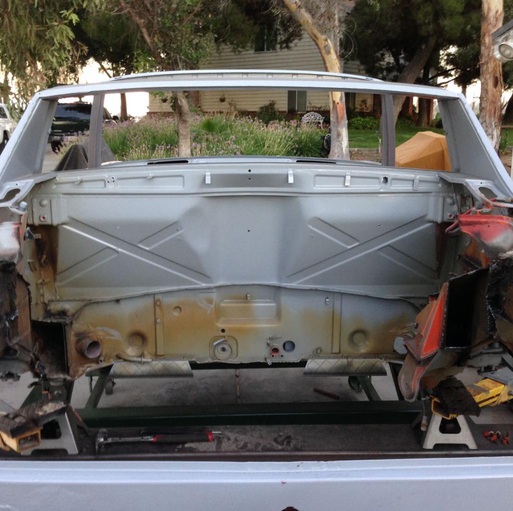

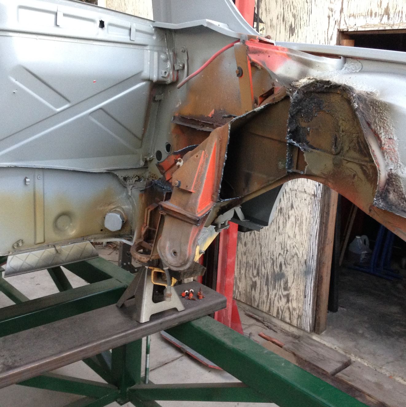

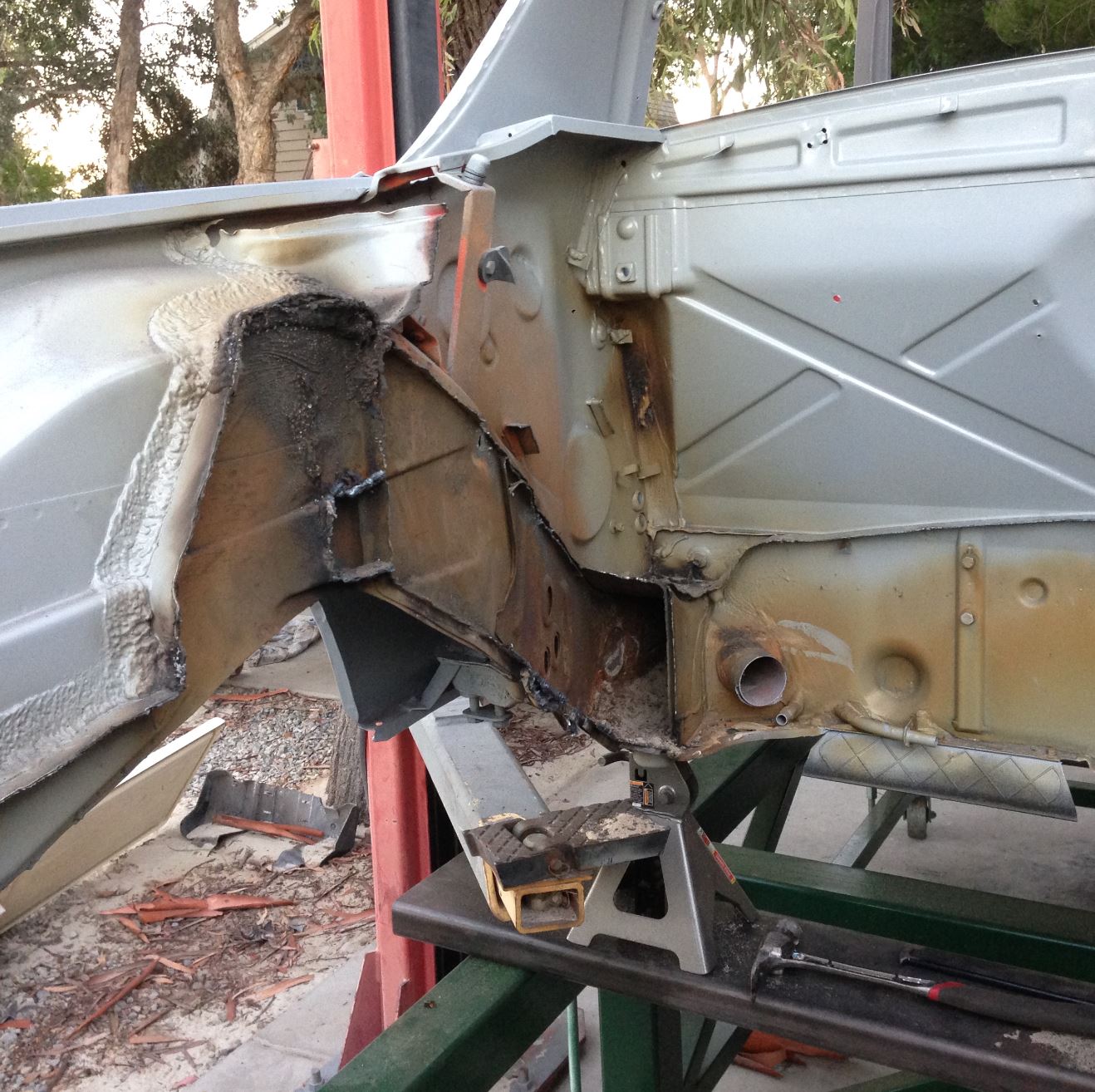

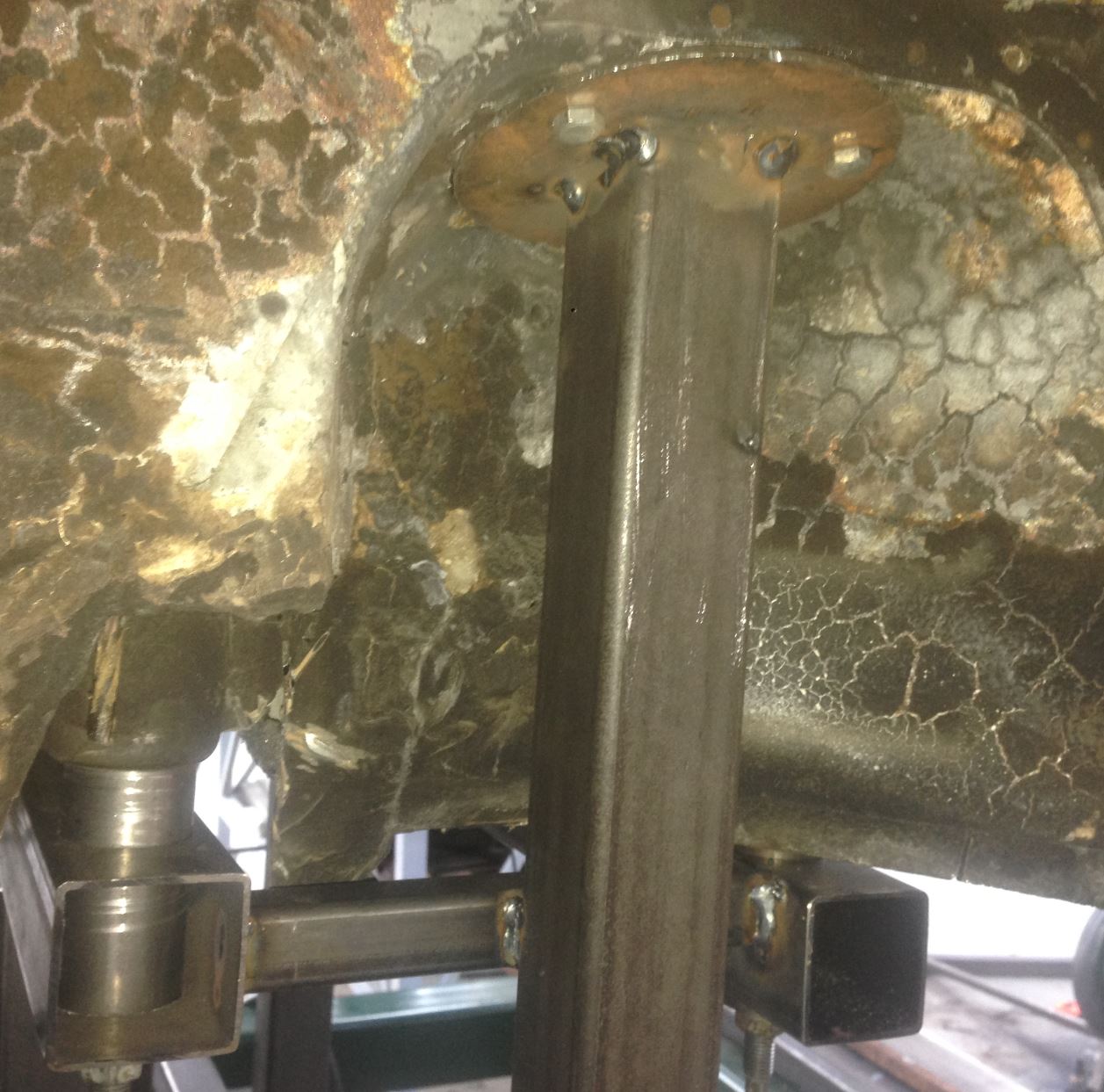

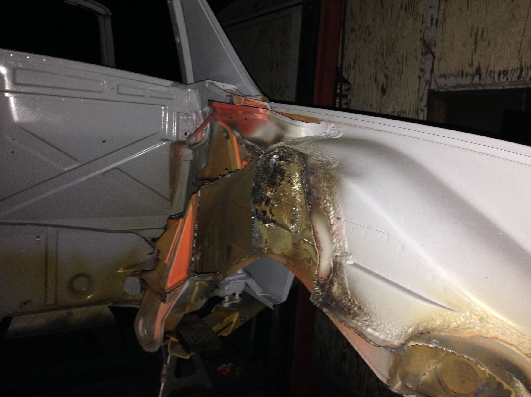

Well..........this officially marks the point of no return. Up to this point the 914 could have easily been turned into a restored stock......but now the fork in the road has been reached and I'm taking the "road less traveled". Started to cut up the engine and transmission well. Planning on installing nest tomorrow and will start with "upgrading" the longs first. I couldn't believe how much sand was in the longs. The left long had about a large coffee can of sand in it. I don't know where it could come from since the left did not have any corrosion. On the other hand the right long, the one with the hell hole, that one only had about a up of sand in it? You would expect it to be the other way around. Also, the left long had some fibrous cotton like material inside of it? Anybody have an idea what this is?

Thanks veekry9. After seeing the "surface" rust inside of the longs......I would encourage everyone to stick some of the Eastwood internal frame coating inside. These things rust from the inside out as well as the outside in.
