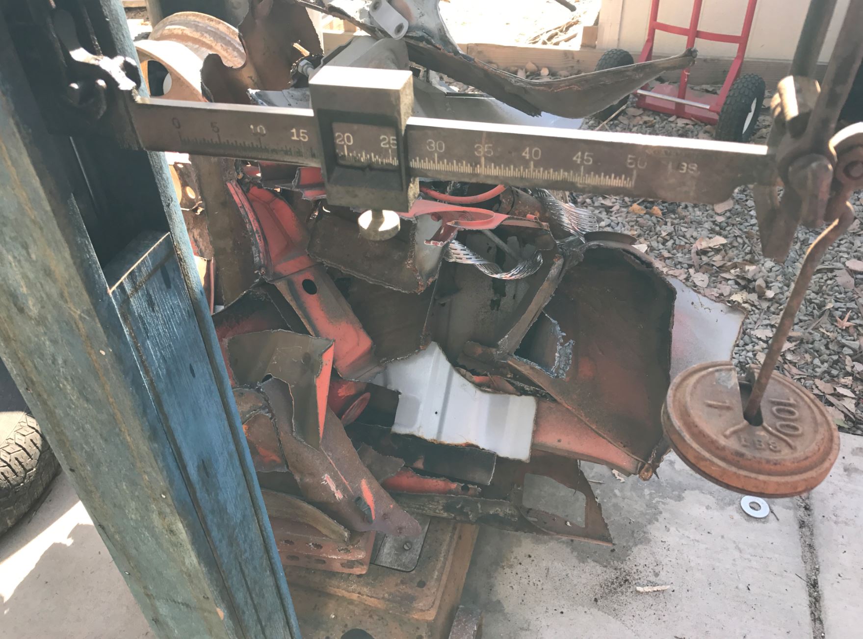

Just in case y'all were wondering.......161 lbs of steel have been added and 124 lbs have been cut out. This comes out to a net add of 37 lbs which is basically the weight of an Engman stiffener. At the end of the day it won't be much heavier than a stock teener. (IMG:style_emoticons/default/cheer.gif) (IMG:style_emoticons/default/cheer.gif) (IMG:style_emoticons/default/cheer.gif)

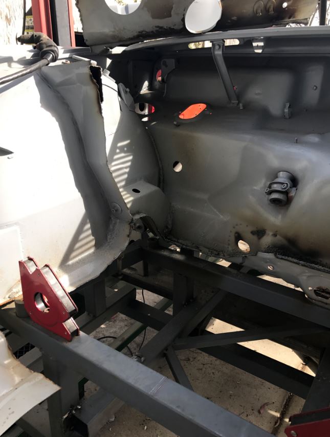

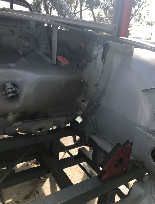

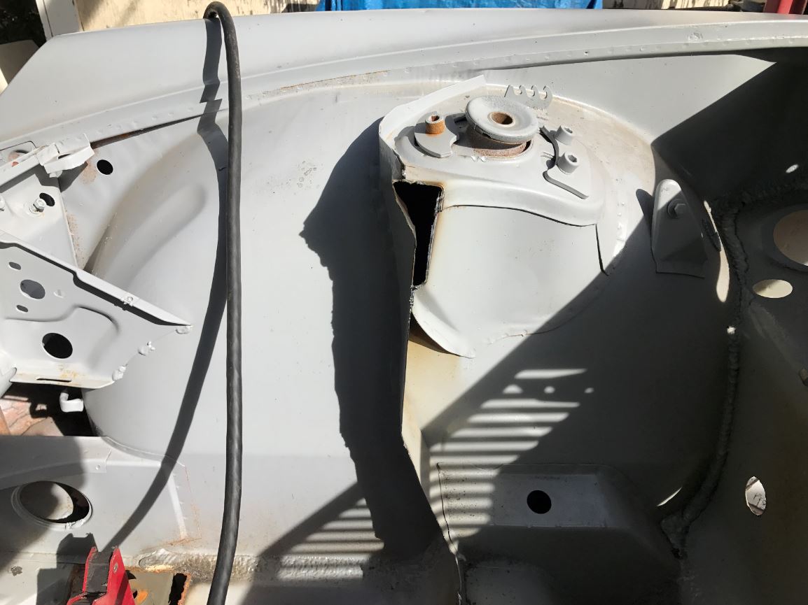

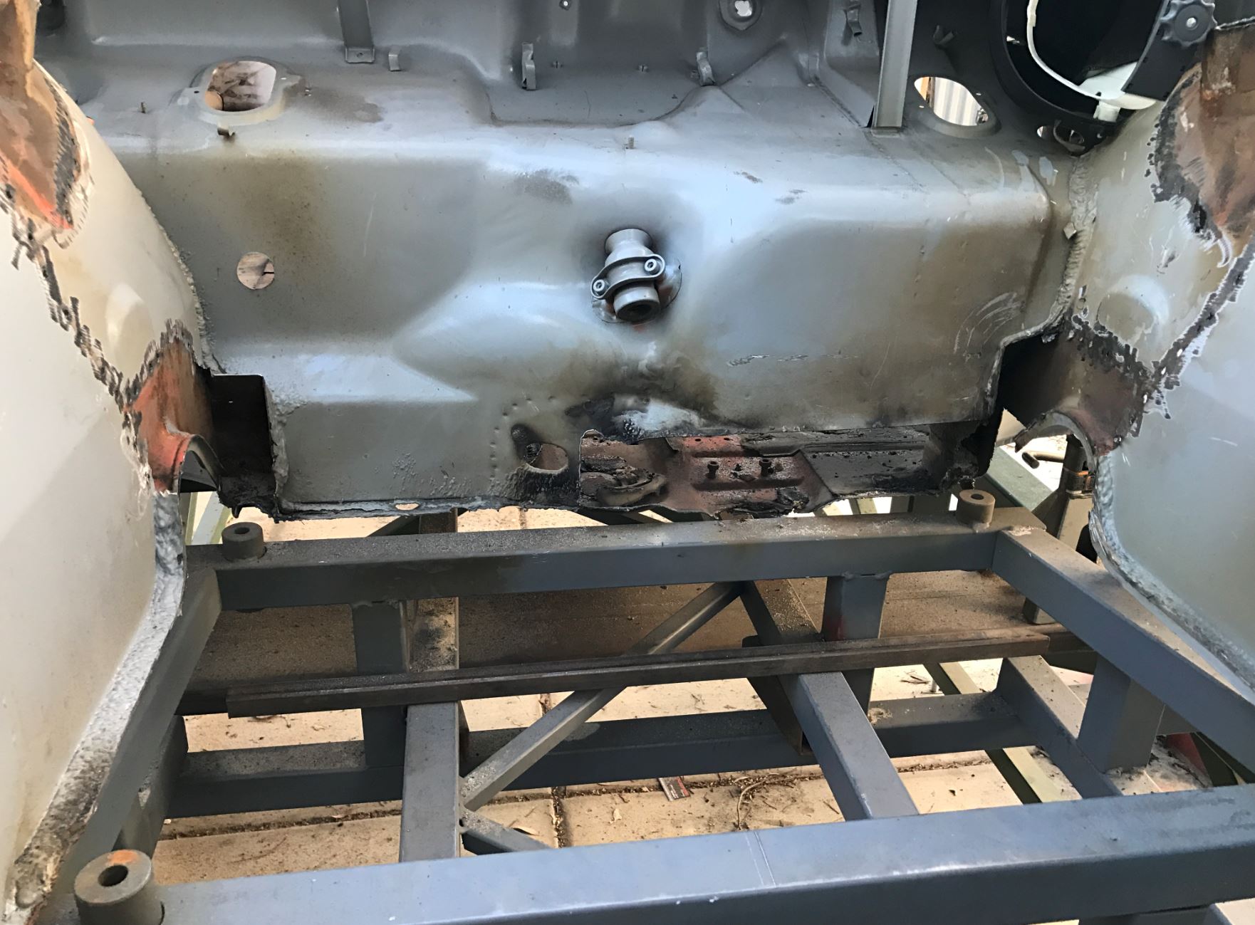

Well wasn't feeling it this weekend wanted to finish the front but was too tired from surveying a project the day before. Anyway here are some pics of the progress.

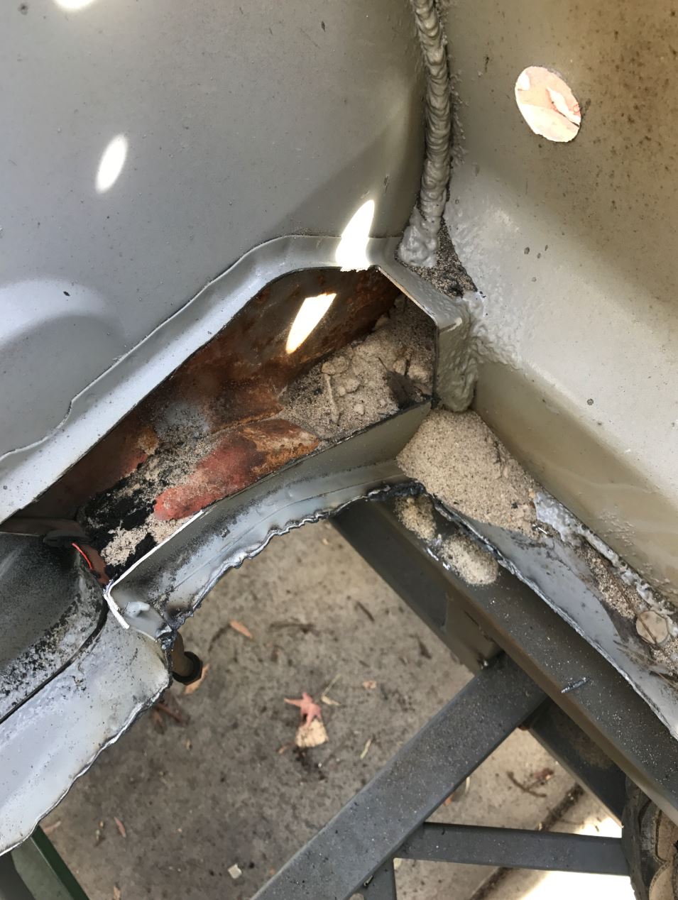

Here is the reinforcement from the factory that many use to feed water lines through. Notice the crazy amount of sand inside of these? Also....the corrosion. Put some paint inside of these whenever you can.
Plenty of room to fit in the front "torsinal stiffener enhancer" Attached Image

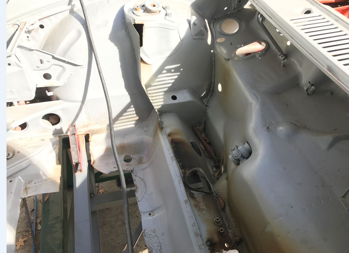

Looks like I need to shorten the strut tower. Attached Image
Smokin some briskett Attached Image
Can you see "the car" in the background Attached Image
csdilligaf
post Nov 21 2016, 12:23 PM
Post #239
Posts: 106
Joined: 18-April 12
From: San Diego CA
Member No.: 14,397
I wondered about needing to shorten the struts. Yours are already adjustable and may in fact go down enough to fit. I am working on shortening my factory ones first if possible. Hmmm! Brisket looks good!

your looking right at the solution.. Gurney bubble..maybe not..
