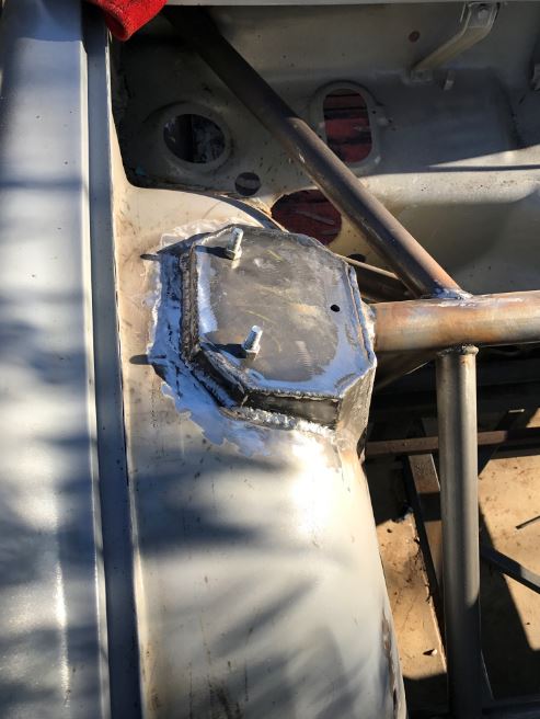

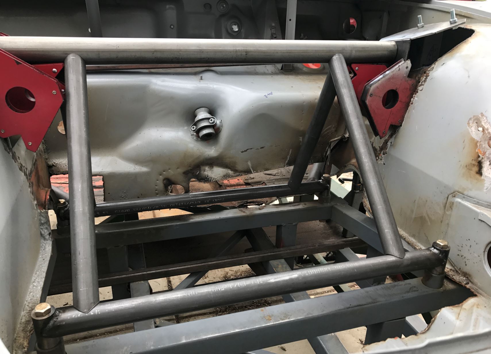

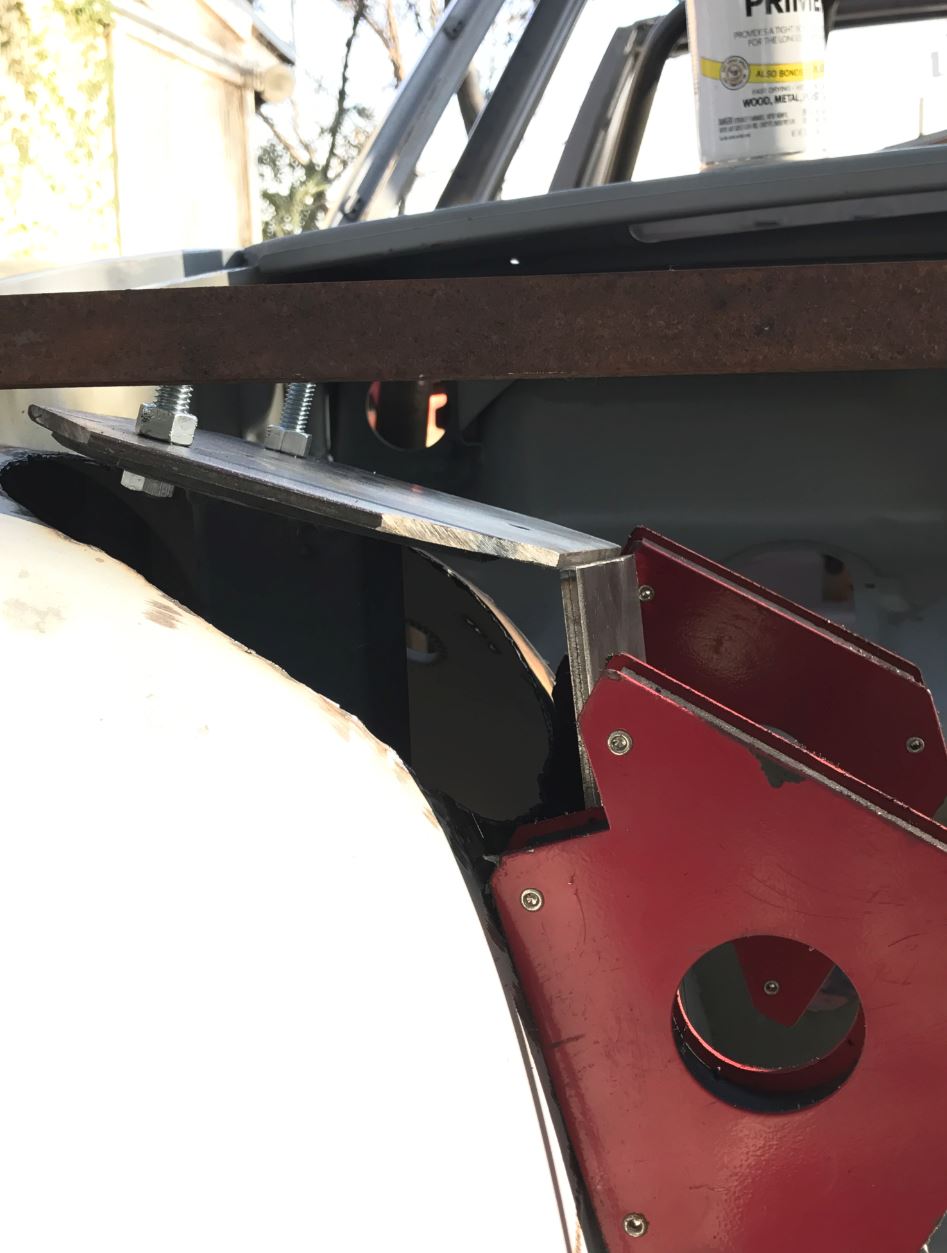

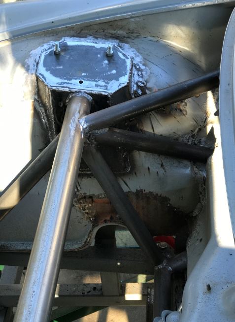

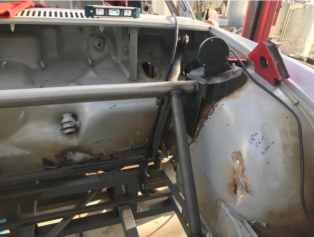

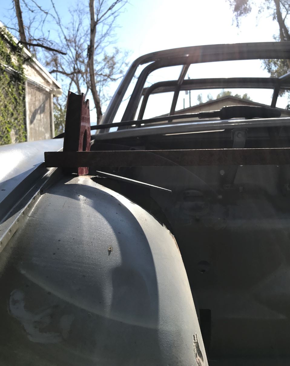

Little update, should be able to finish tying in the front struts to the tube chassis. A couple of progress pics.
Here is the strut attachment point cut down to size. I had to move the tower out and forward to account for the strut inclination angle both sideways and forward and backward. Attached Image
Here is the octagonal shape that I will be using to box int he strut tower Attached Image
Here is the "strut brace" Attached Image

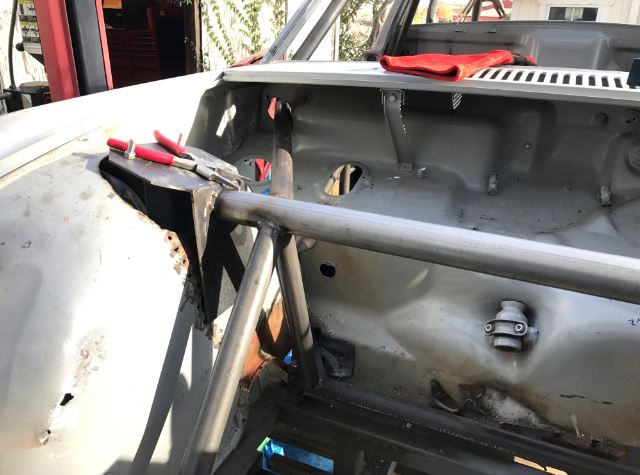

Curbandgutter
post Dec 6 2016, 02:17 PM
Post #252
Posts: 565
Joined: 8-March 13
From: Murrieta CA
Member No.: 15,637
Forgot to add this mock up. Test fit of parts before tacking them in. Don't worry the tubes will line up.

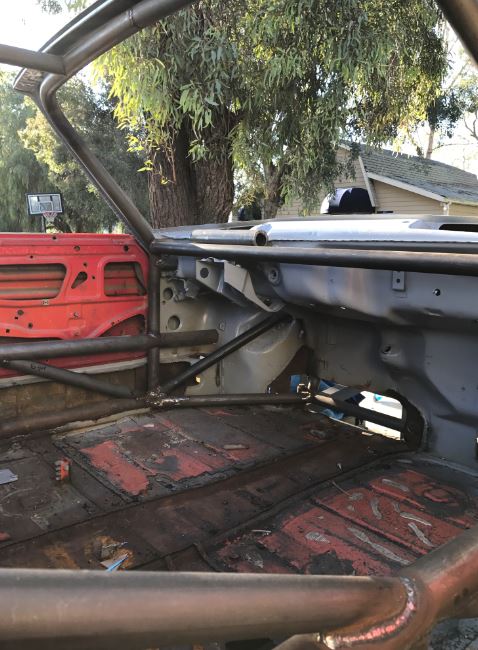

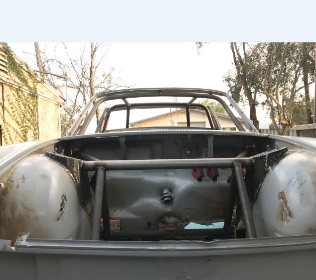

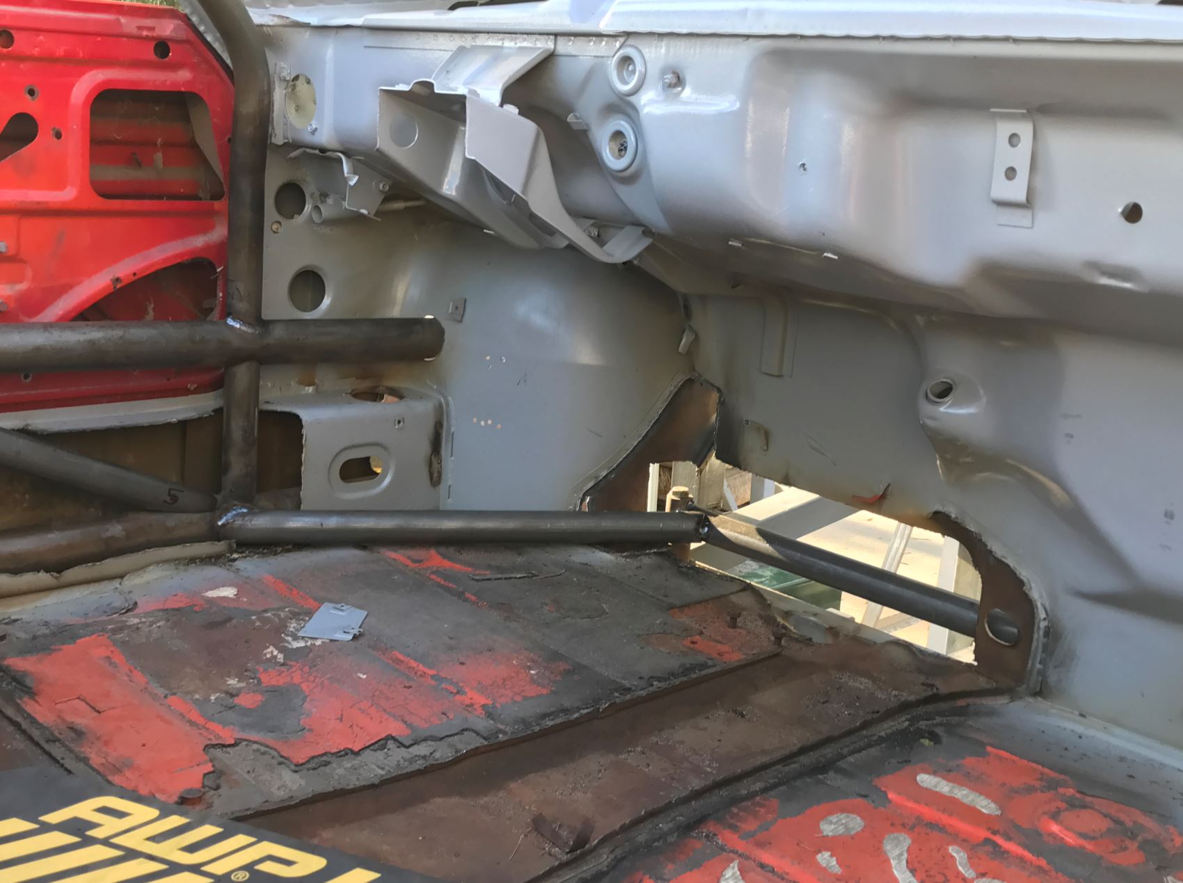

post Jan 15 2017, 06:45 PM
Post #254
Posts: 565
Joined: 8-March 13
From: Murrieta CA
Member No.: 15,637

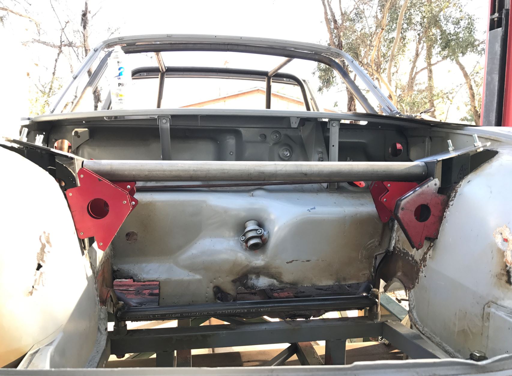

The weather let up a bit and I was able to sneak in some hours into tying the strut towers in. By the way I am really giving it some heavy consideration into changing engines. I'm leaning to a Audi RS4 Stage 3 motor. It will produce 600 HP so its where I want to be. What do you guys think about that motor choice.
Curbandgutter

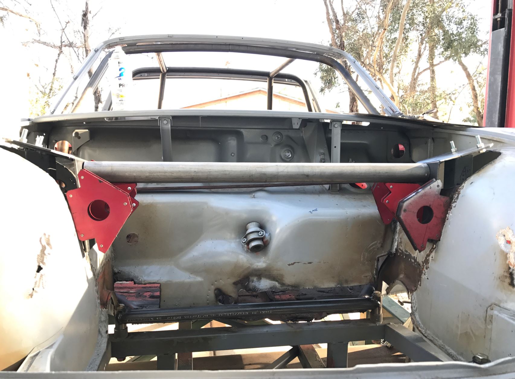

post Jan 15 2017, 06:46 PM
Post #255
Posts: 565
Joined: 8-March 13
From: Murrieta CA
Member No.: 15,637
Attached Image Attached Image Attached Image Attached Image Attached Image Attached Image
