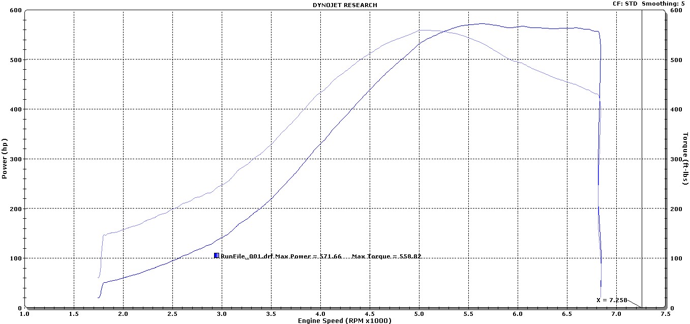

2.7 with RS6's should be a lot of fun. Are you going to get the JHM one's?
https://jhmotorsports.com/shop/catalog/jhm-...th=21_56_60_100
What engine management and fuel are you going to go with? We could talk Audi engines all day...
It will be interesting to see how you build the motor, what you do with fueling, engine management, tuning, clutch, ect ect.
The 2.7 is a nice sounding engine, I will give you that (IMG:style_emoticons/default/smile.gif)
Dyno for comparison.

Yes the JHMotorsports ones. By the way that looks like it may be the dyno sheet for the JHMotorsports RS6 car? Is that it? From reading your posts and the impressive tuning that you have done it looks like you will be an excellent source of input on the Audi stuff.

Here is where I pulled that sheet from. I have no other info than what he posted. I imagine its wheel HP on C16 or similar since its so high.

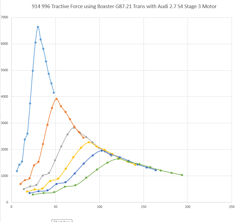

JD74914 I calculated the tractive force based on the Boxter S G87.21 gear ratios and the S4 Stage 3 Dyno plot and this is what I got. Seems like a smooth transition. Looks like Porsche knows what they are doing in selection the gear ratios.

That is a nice smooth parabolic curve-perfect! That's what I've noticed too. If you plot curves from many manufacturers there are some big gaps, but Porsche and Subaru seem to have the gear selection thing down pretty good (for the ideal "go-fast-car" case).
I pulled it last night too and got a very similar curve...sorry I didn't get a chance to post to save you the work. I pulled a number of gear ratios from CM's website and the G87.21 really does seem like a good choice. It's a shame first gear isn't slightly longer, though this seems to be a "problem" in almost all gear boxes (it's really bad in sport bikes).

Jim, your tractive force spreadsheet proves that if you shift at max torque you will drop the tractive force substantially. It proves that shifting is better near max horsepower. I just did a spreadsheet for my car. Very interesting information. Thanks for illuminating me.
Yeah, it's a rather interesting plot since it brings out things you usually wouldn't think about. It also does a good job of justifying peakier, higher overall power engines vs. these flat torque curve monsters. Glad it could be of use! (IMG:style_emoticons/default/smile.gif)

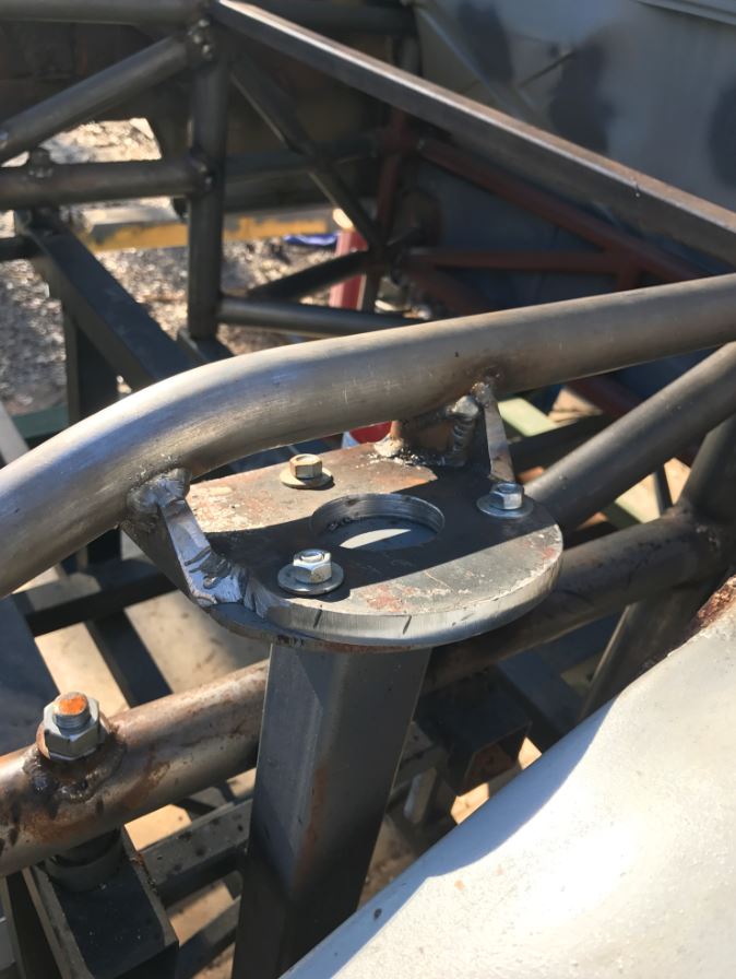

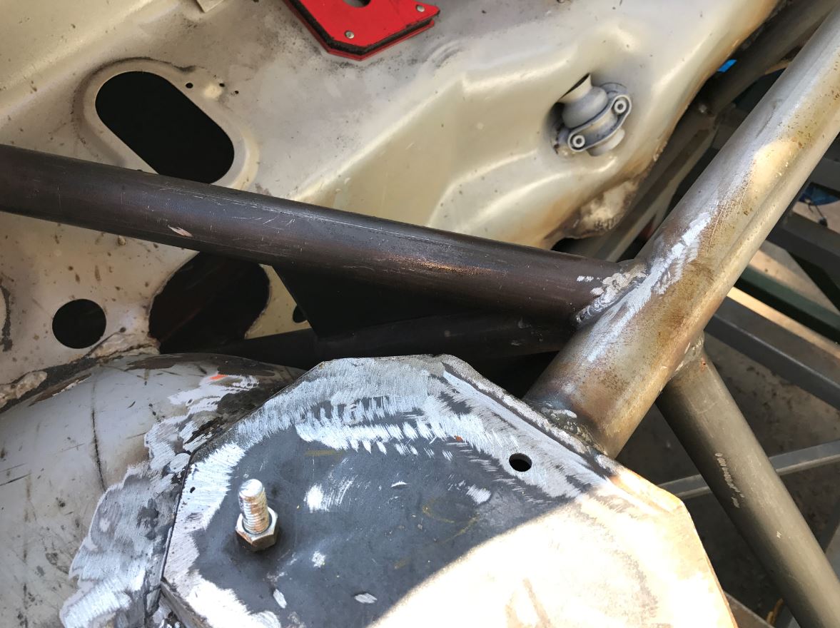

Finished the strut towers with the gussets that were needed. I should be able to bolt up the full 996 suspension this weekend

Rudy - That's looking wicked! (that's a good thing...) (IMG:style_emoticons/default/aktion035.gif)
Can't wait to see the suspension bolted on and this thing on wheels. I'm waiting anxiously to see the extended wheelbase and how you're planning to mod the body, etc. Any details or plans you can share now? Inquiring minds want to know...
Either way, keep the great work and progress pics coming!

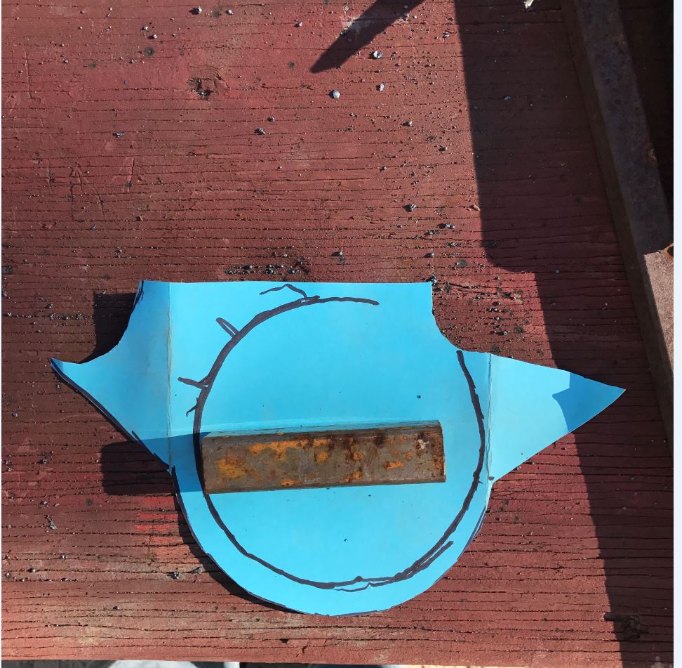

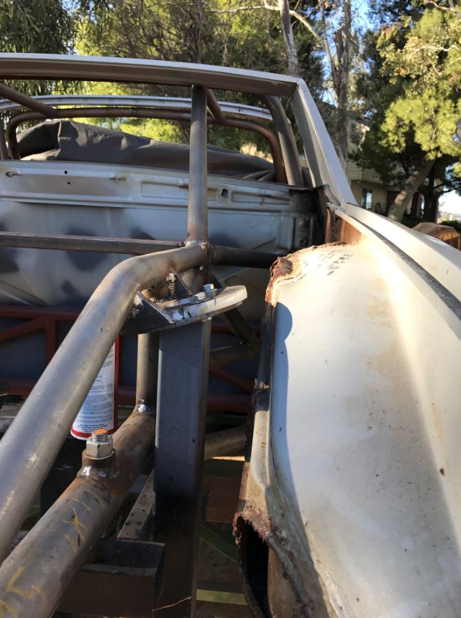

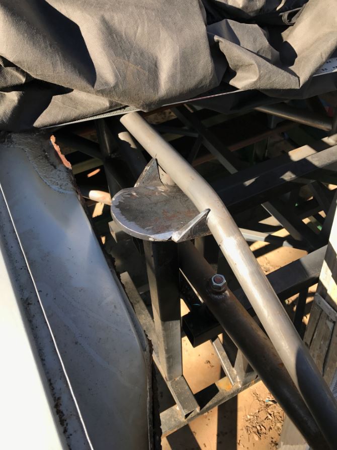

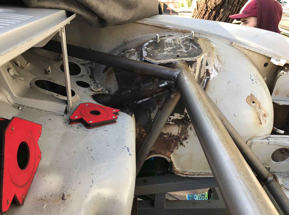

Wow I though that the rear shock towers would take me about an hour each and it took a full 10-hour day to complete both! Anyway here are pictures of the rear shock towers. I took a piece of 6" channel and made a paper template and cut with plasma cutter. Ohh...I'm picking up donor car today. It is a running Audi S4 with 130K miles. Picking it up in Van Nuys tonight. The only major thing left to purchase will be a boxster transaxle. I was hoping to be able to bolt up suspension but that will have to wait until next weekend.

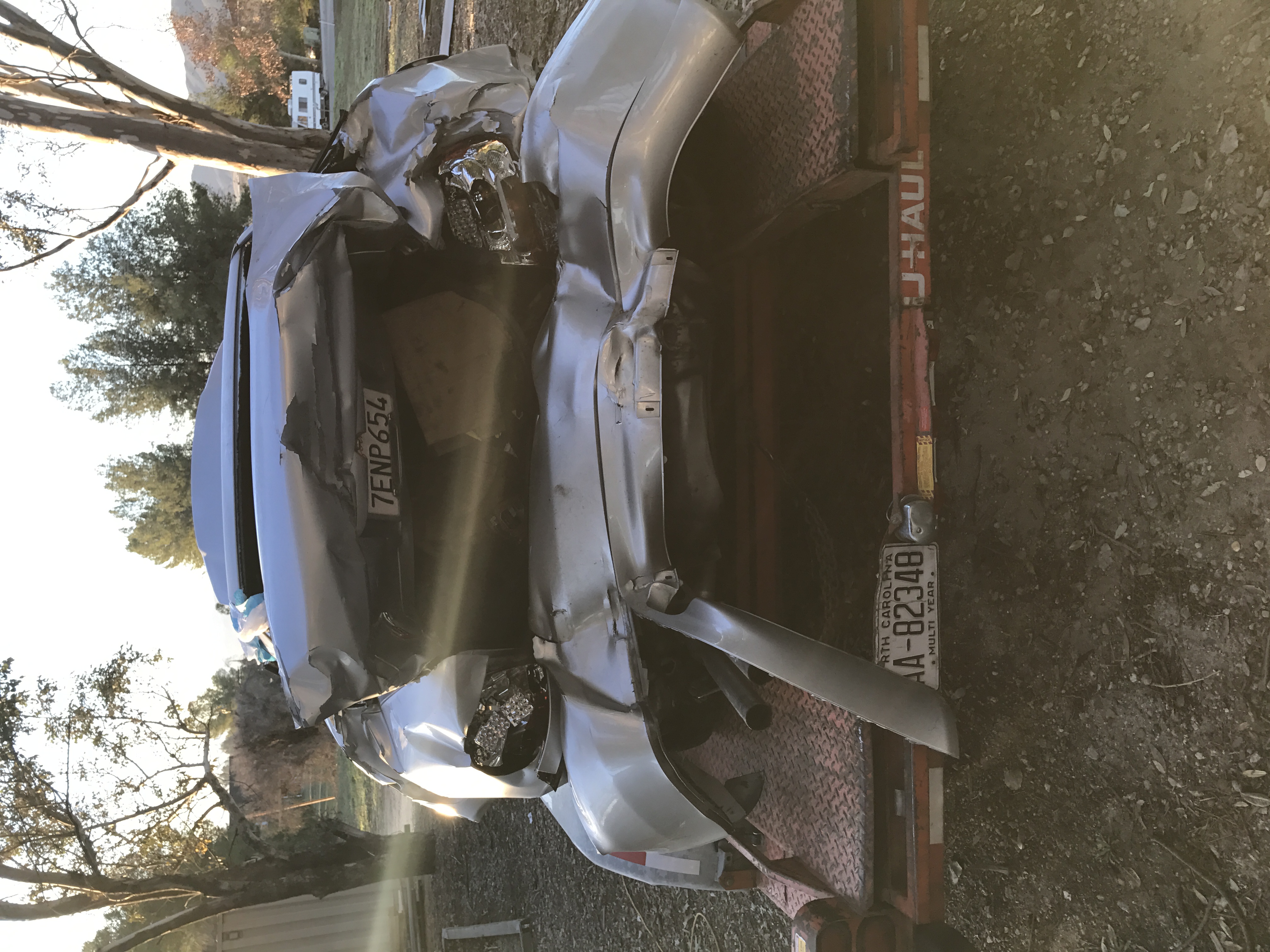

The donor has landed.

QUOTE(Curbandgutter @ Jan 31 2017, 07:17 AM) *
I'll say... and pretty hard, based on that pic! (IMG:style_emoticons/default/lol-2.gif)

post Jan 31 2017, 09:23 AM
Post #279
Posts: 13,698
Joined: 23-January 09
From: Temecula, CA
Member No.: 9,964
Donor car #3? I knew of the 2 Porsche donors. What is the Audi donating? (IMG:style_emoticons/default/beerchug.gif)
Curbandgutter
post Jan 31 2017, 10:11 AM
Post #280
Posts: 565
Joined: 8-March 13
From: Murrieta CA
Member No.: 15,637
996 donated the legs and feet. Donor 914 donated moral support. Audi S4 is donating heart and lungs.
