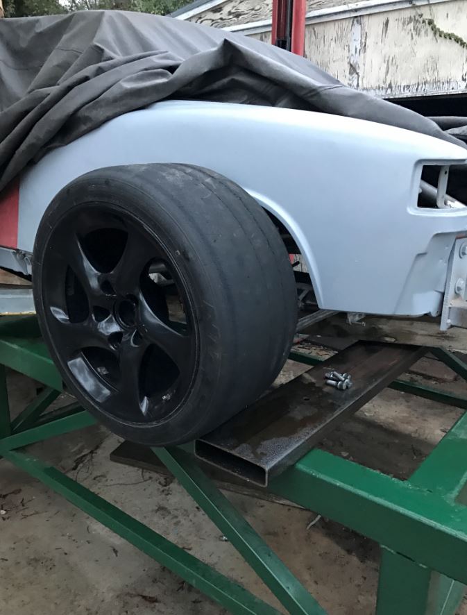

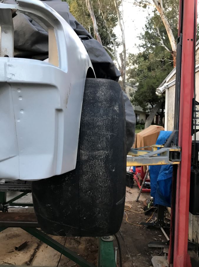

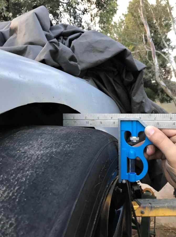

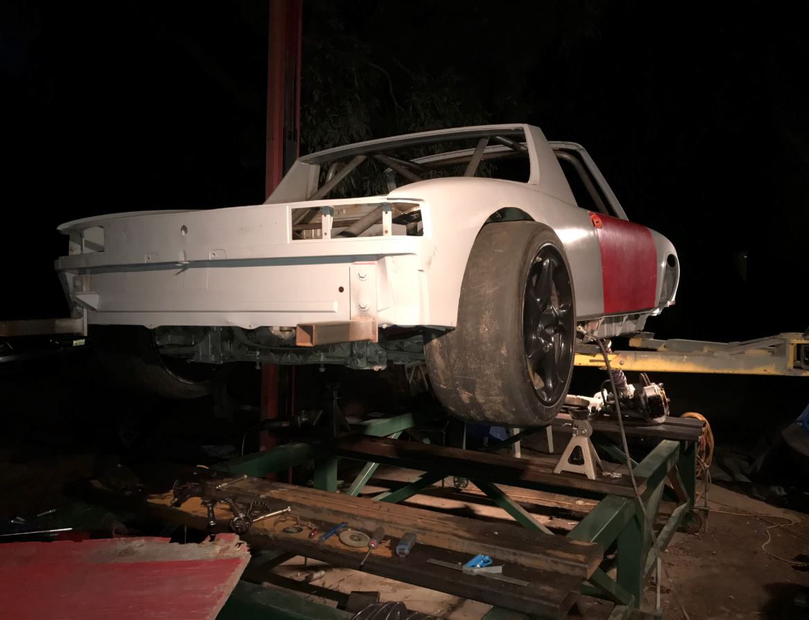

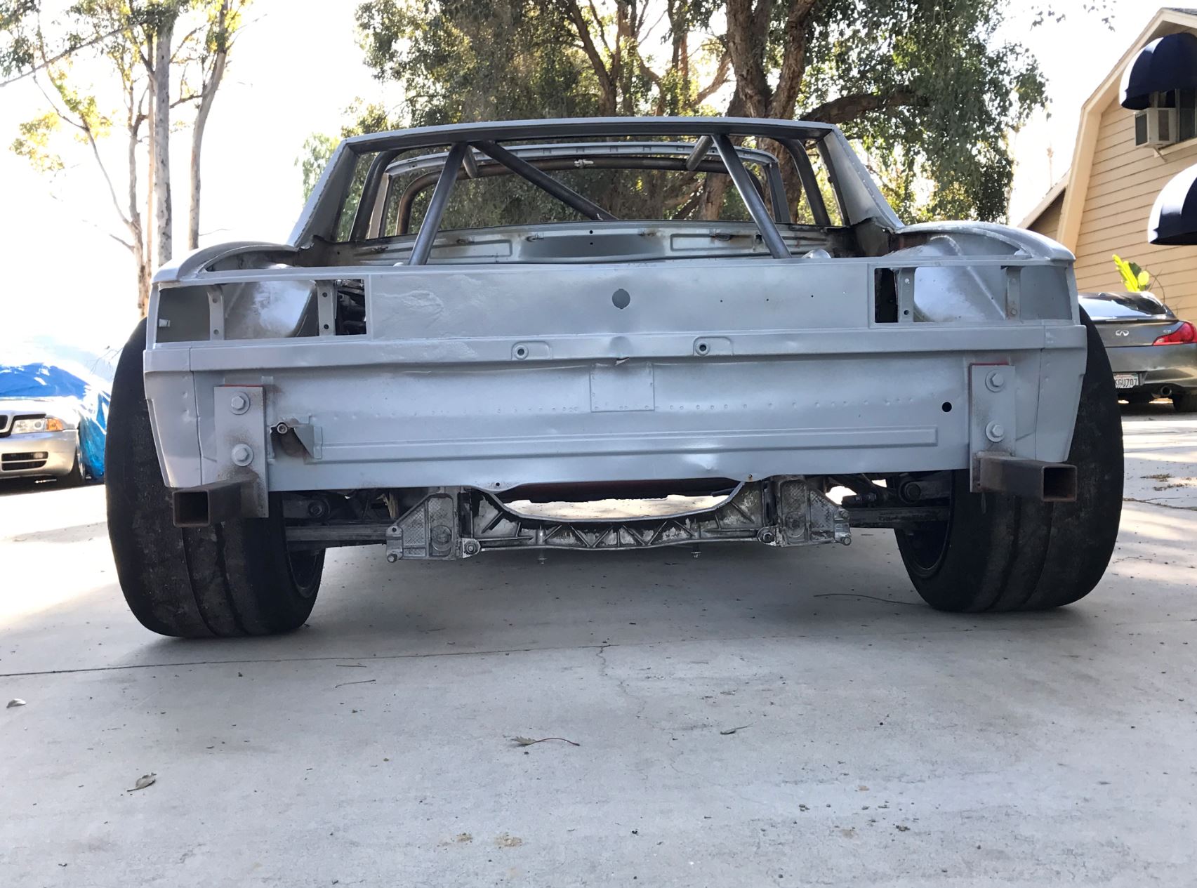

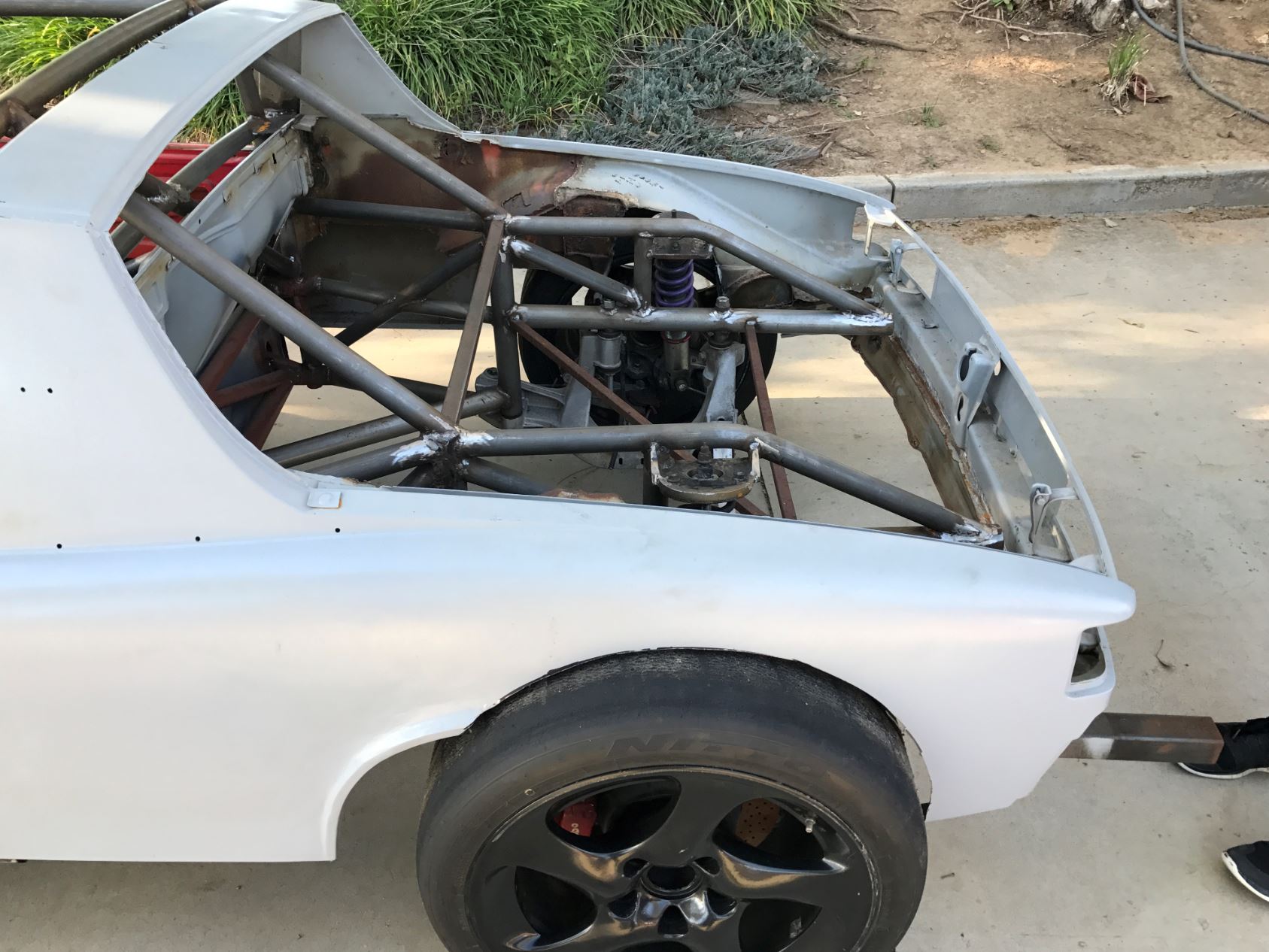

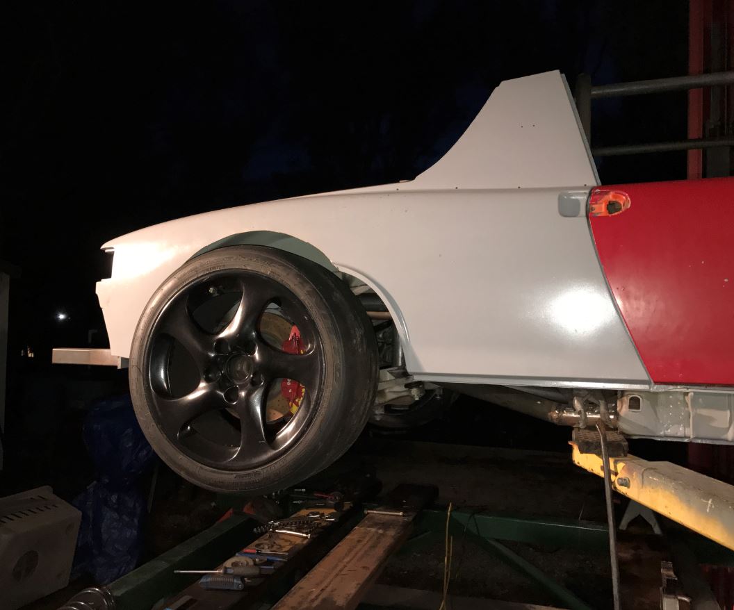

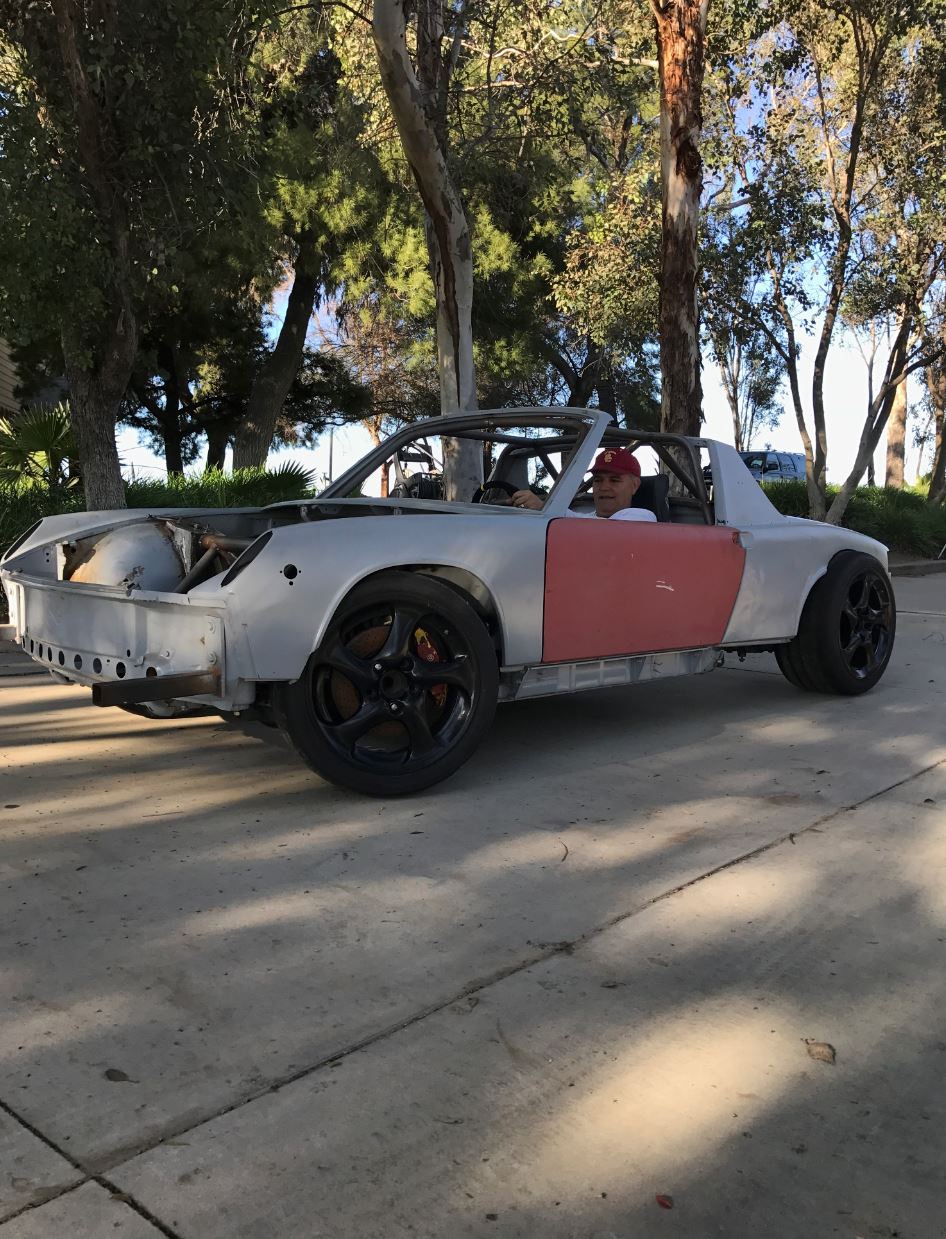

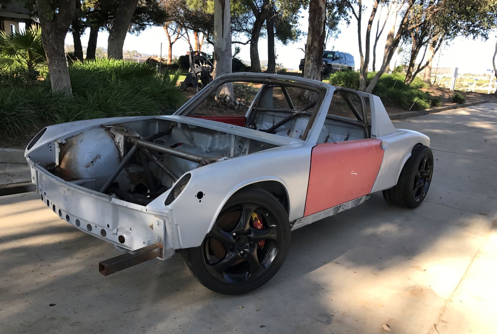

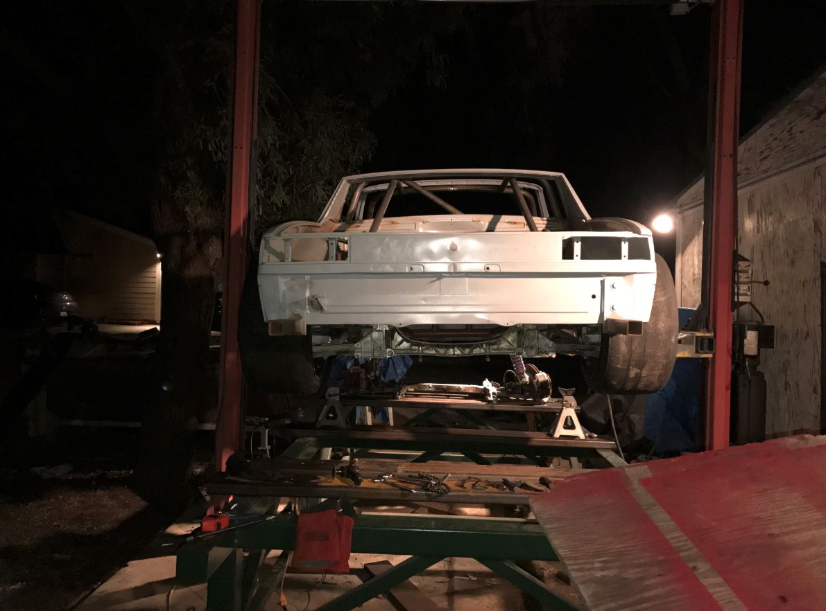

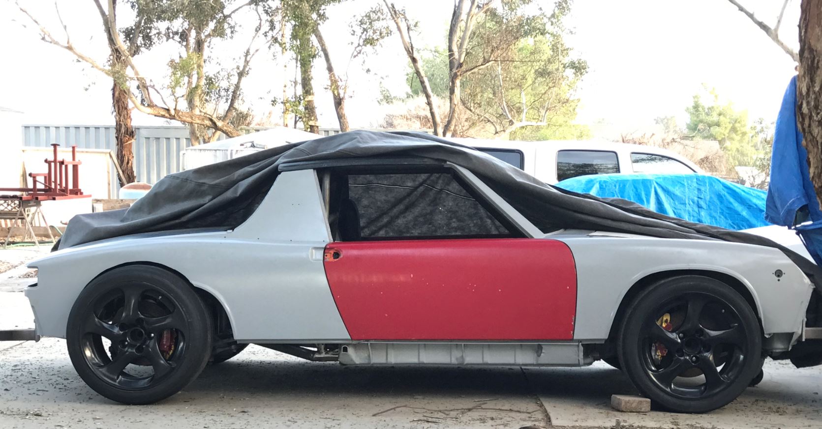

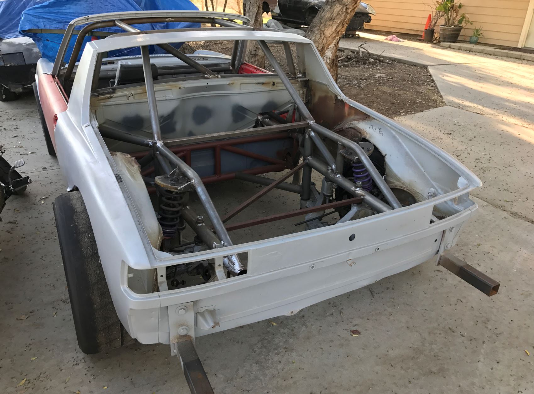

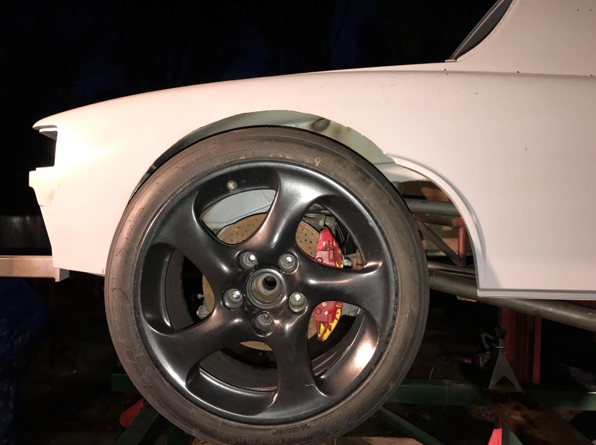

WE GOT A ROLLER!!!!!!!!!!!!!!!!!!!
Attached Image Attached Image Attached Image Attached Image Attached Image Attached Image Attached Image Attached Image
tygaboy
post Feb 12 2017, 06:29 PM
Post #311
Posts: 5,547
Joined: 6-October 15
From: Petaluma, CA
Member No.: 19,241
Sorry, I don't see the milk crate so no points... (IMG:style_emoticons/default/lol-2.gif)
Seriously - what a COOL look! You have to be totally psyched to have it on wheels.
Congrats on a major milestone!! (IMG:style_emoticons/default/aktion035.gif) (IMG:style_emoticons/default/aktion035.gif)

Looks fantastic!! Congrats!

Way to go Rudy!!! I knew on Sunday with no rain you would be up there working on it. I am digging' those wheels on it. And the Momo Steering wheel is a nice touch.

post Feb 13 2017, 11:33 AM
Post #314
Its alive
Posts: 4,841
Joined: 16-February 04
From: CT
Member No.: 1,659

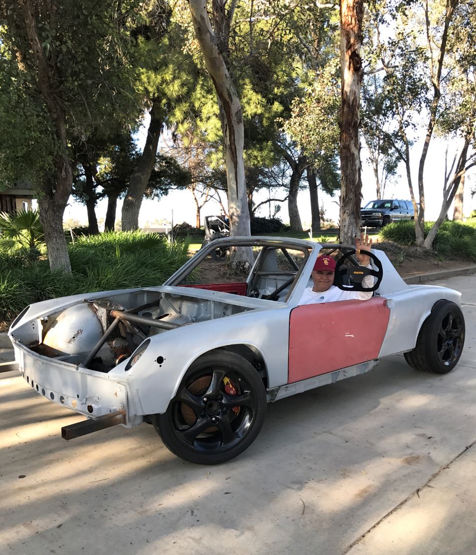

Sweet!! That's awesome!! Can't wait to see it at ride height with some flares!
Could you take a side profile shot? I'm just curious to see how far the rear wheels really are back. (IMG:style_emoticons/default/smile.gif)
Thanks Chip. Damn right I was going to be working on it. Thanks to you, I was able to get the wheels. Yes that Momo was a Christmas present.

QUOTE(jd74914 @ Feb 13 2017, 09:33 AM) *
I can't either. Flares are going to wait a little bit since I want to install motor and tranny and I still have to do the twist test. (IMG:style_emoticons/default/smile.gif)
Attached, just for you, is a profile showing the "extended wheelbase"

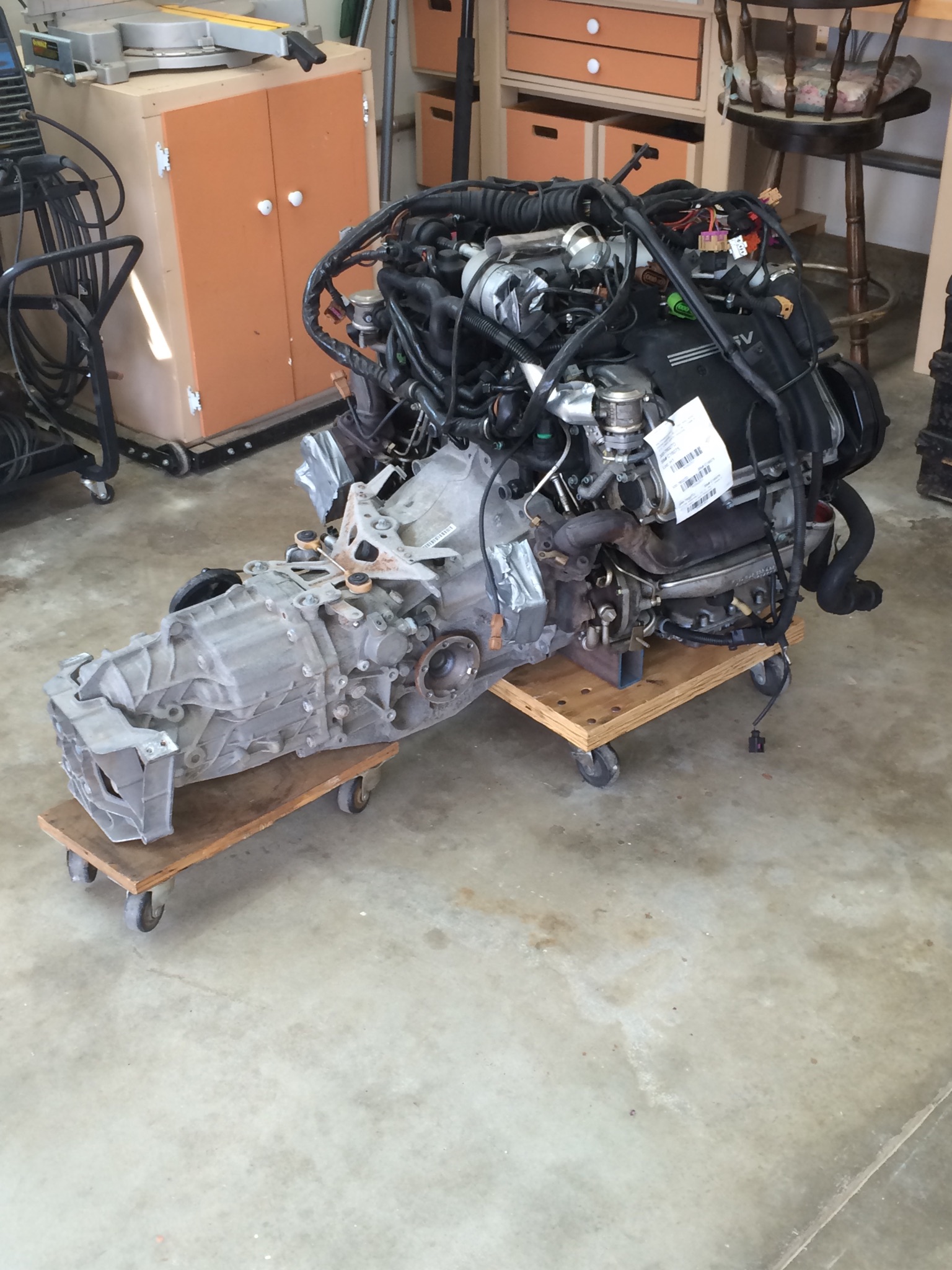

I just got back from California MotorSports in Lake Havasu Arizona after having them install the Wavetech LSD in the Cayman S 6 speed. I have been working on mating the trans and engine so Rudy and I know what to expect. If I work out those details it will speed along the process for him and he can focus on other parts of the build.
I have a Fidanza aluminum flywheel and an RS4 clutch package. First there is a 1" thick spacer on the crank face of engines that came from an Automatic equipped car, I put steel rod in the holes and tapped it a little while going from hole to hole, popped right off. Warm up the flywheel so the hole grows enough to slip over the crank locating boss. The bolt holes will only line up one way, they are not equally spaced. If you warm the flywheel to about 180/200 degrees on a hot plate it will give you time to align it with a bolt or two before it tightens up. Use the 1mm thick shim from the automatics flex plate in the same location under the bolts to prevent galling and help torque to correct specs.
I will make a drill fixture plate with bushings so that three stud holes can be drilled and tapped along the bottom of the G87.21 trans making it fully bolted to the Audi 2.7T.
It appears that the Cayman S trans has a boss that needs to be drilled out for the crank sensor. The boss is in the same location as the Audi manual transmission and I have seen it done on an Audi swap into a Boxster S in the UK.
We will need to use the transmission spacer from the Audi automatic trans that is 7/16" thick. The RS4 clutch disk fits on the Cayman S spline and the pilot shaft fits into the pilot bearing perfectly.
