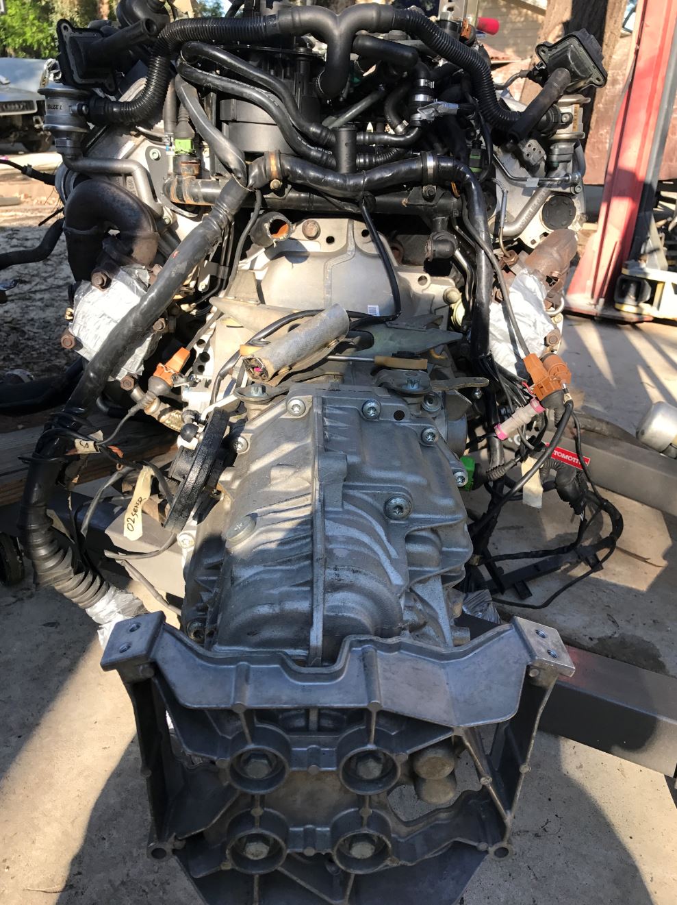

Well motor is out of the Audi. It was amazing how these things are packaged. True nightmare to work on in the Audi but won't be a problem in the 914. Heck I'll be able to walk into the engine compartment. Great motor, but the way it is shoved into the Audi, it sucks big time. You forget how short these Audi V6's are. It measures about 18 inches long. So it's about 6" shorter than an LS1 or Coyote. Makes sense since its 2 cylinders short.

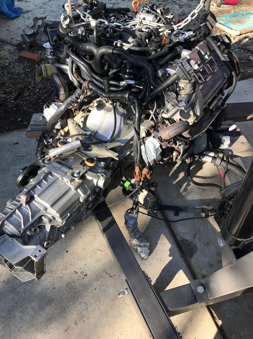

^^^ (IMG:style_emoticons/default/av-943.gif) (IMG:style_emoticons/default/av-943.gif) (IMG:style_emoticons/default/av-943.gif) Well I separated the Audi motor from the triptronic and weighed it with , alternator, power steering pump, air conditioner, Ac drier, full of oil, headers, turbo , electric harness and torque converter. It weighed......a little shy of 440 lbs. I wonder how much a wet and fully dressed LS motor weights. I need to compare apples to apples though. Therefore the LS motor must have flywheel, clutch, exhaust headers, all peripherals, electronics, fuel injection, and intake system. Has anyone weighed this or have good information on this??

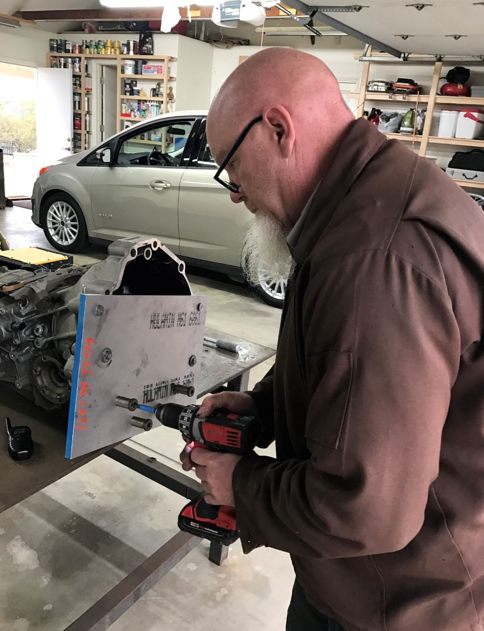

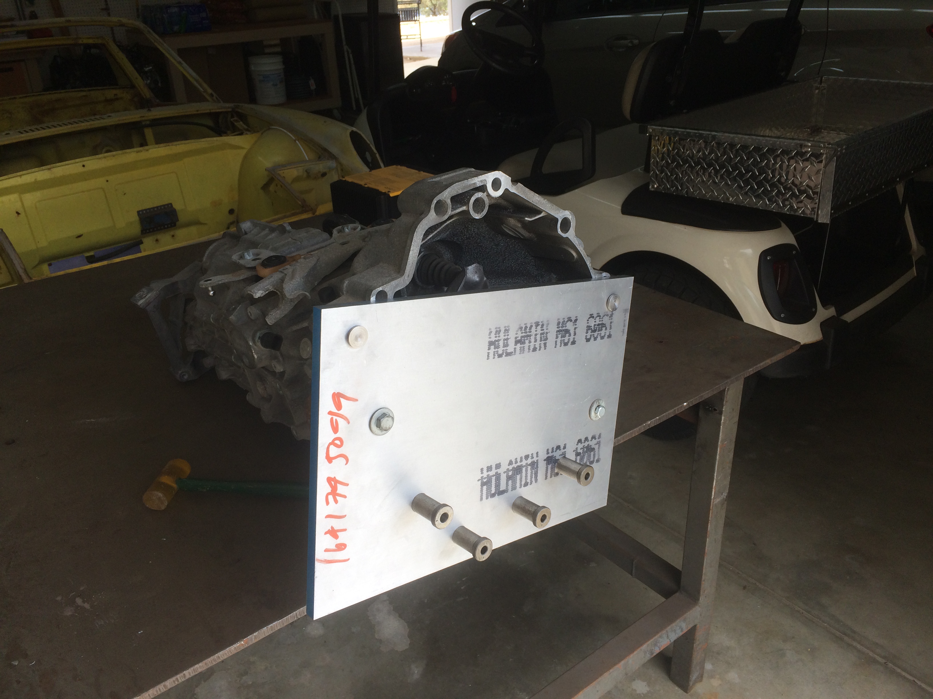

So today's project was to get a drill fixture made so Rudy can have more bolts to hold the engine and trans together. I took the adapter plate and put it on my CMM to measure hole locations. Made the drill fixture with two locating pins in the alignment holes and four long drill bushings for the lower four holes that line up on the engine along with two hold down bolt holes. The Cayman S 6 speed has solid bosses at the correct location but Porsche does not drill them since the Cayman motor does not need them. Its nice that they are there though. Now we can use all of the bolt holes in the engine. I think it will be best to drill and tap the trans and then use short studs as needed. One of the holes is bolt that holds the starter in place and sliding it on a stud will help.

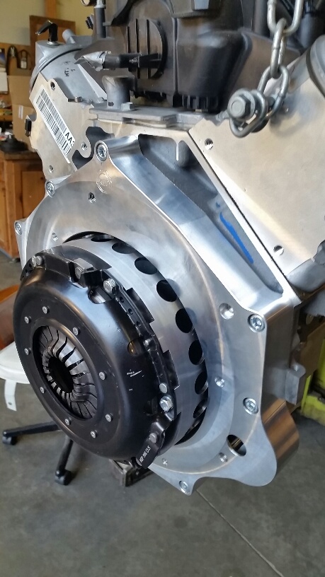

The flywheel, clutch, PP and adapter plate for the LS to G86/87 variants is substantial, heavy (and pretty). I didn't weigh it but would guess that it alone weighs about 55 lbs. Chris could weight his since his is still accessible. My engine only has an alternator and dry sump pump and weighs 425 lbs. A baseline comparison for power goals to engine weight - 586 hp and 553 torque - at the crank. Idles smooth, and can drive at idle with no throttle input. Very docile.

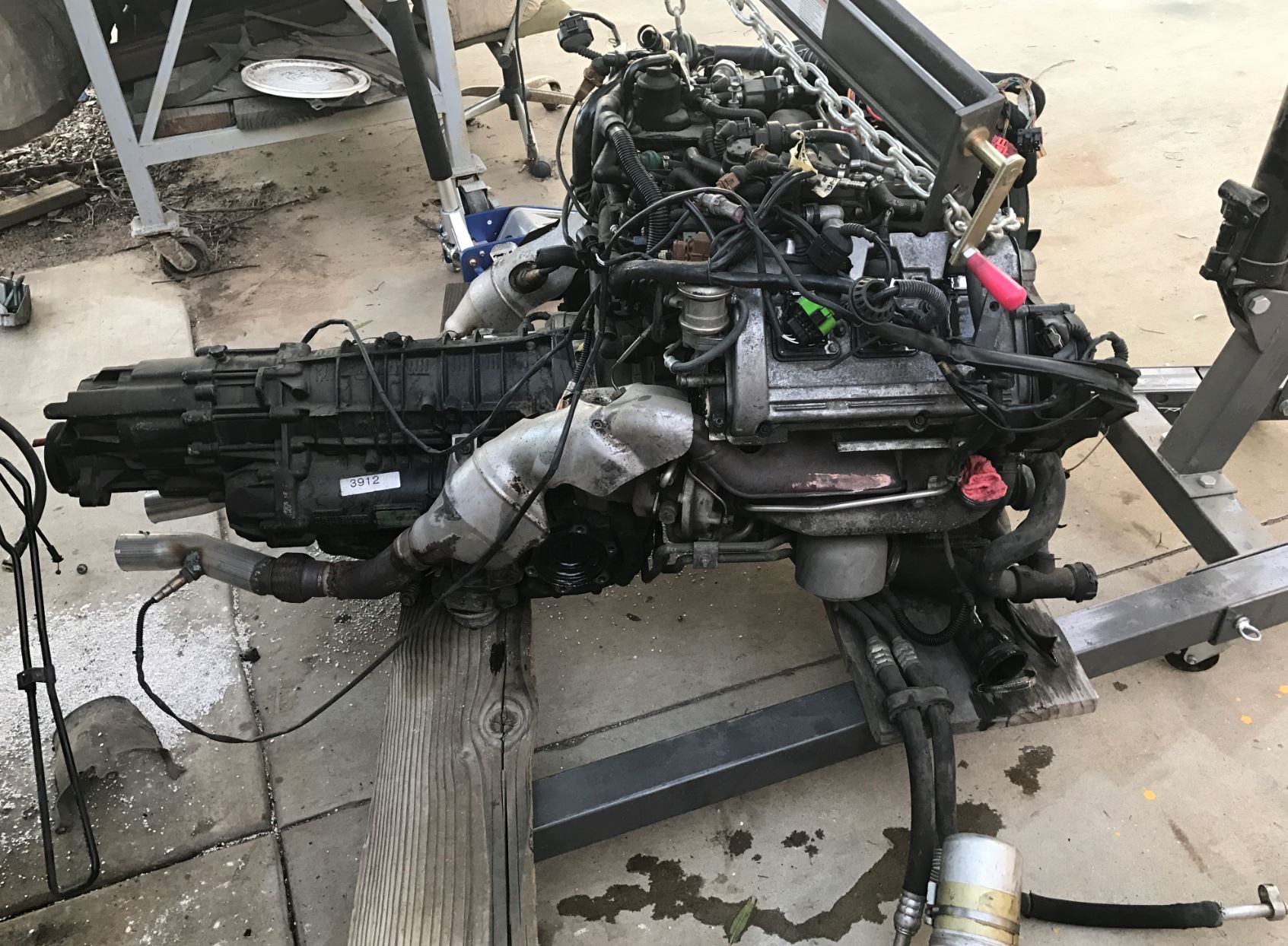

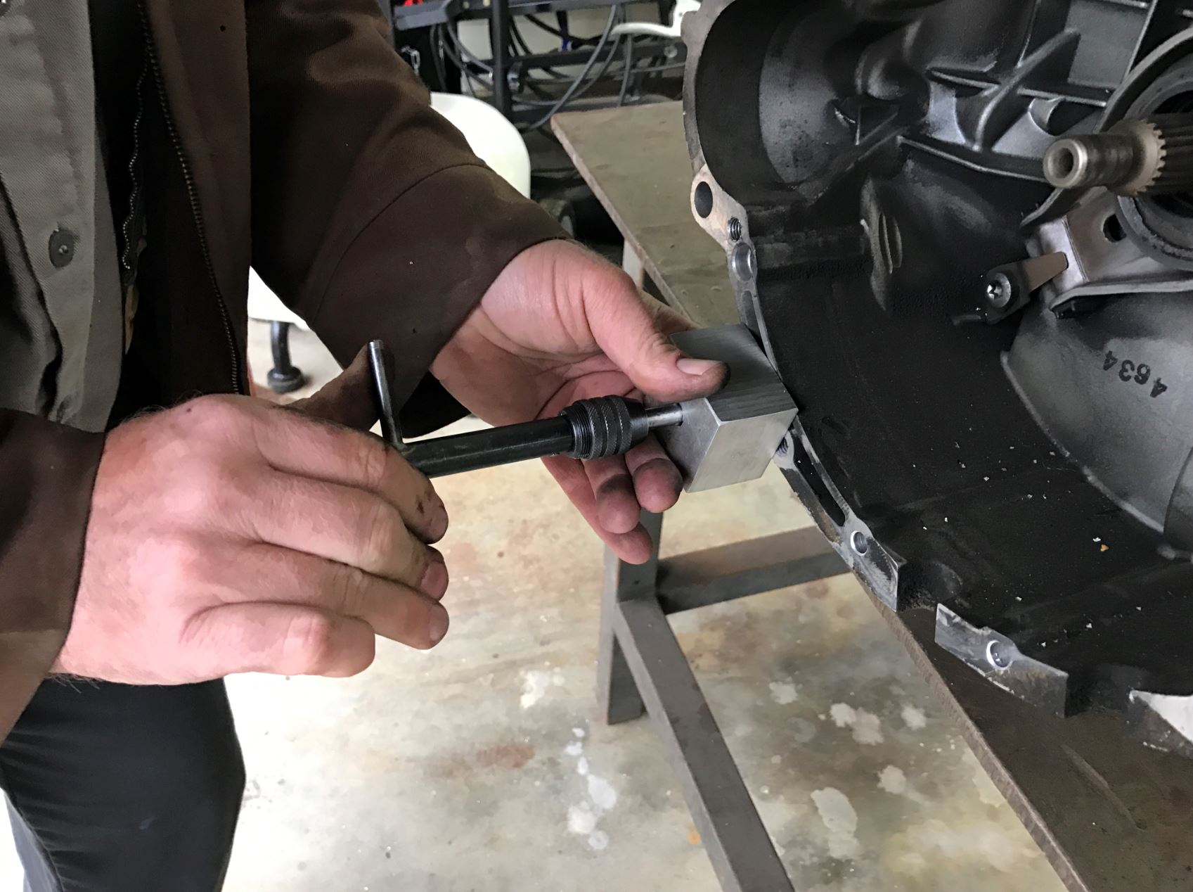

I went down South to Chip's house and he tapped in four additional studs to the Cayman transmission. You can see them in the first picture (Chip's motor and trans). He machined up a trick jig and was able to set it up and tap the trans in about five minutes. For those of you that may want to do this, these studs are not mandatory but we like our belts and suspenders around here.
Nice fixture, great to see you using the tapping block!

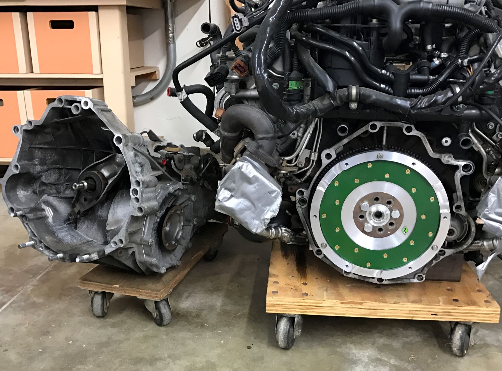

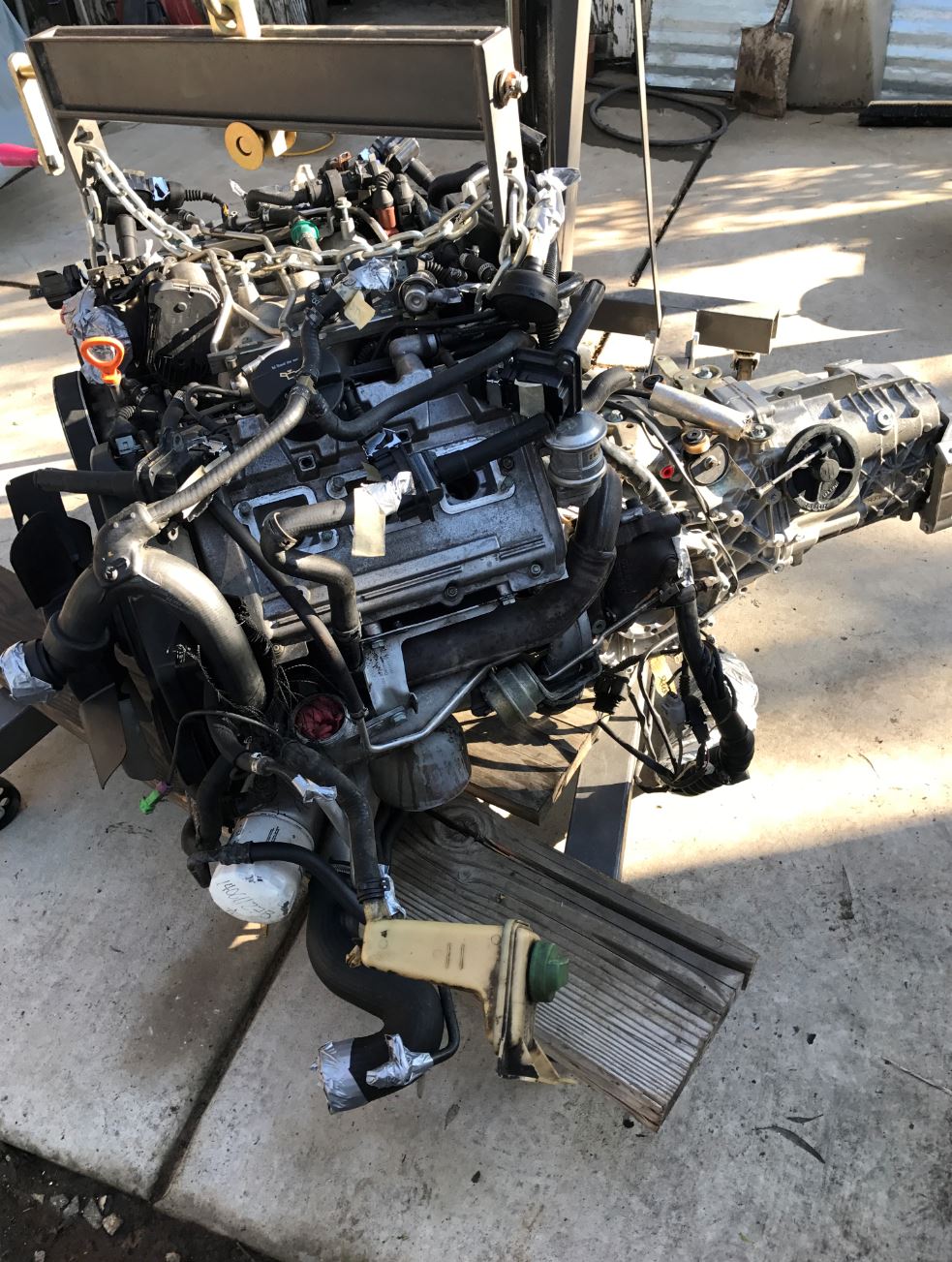

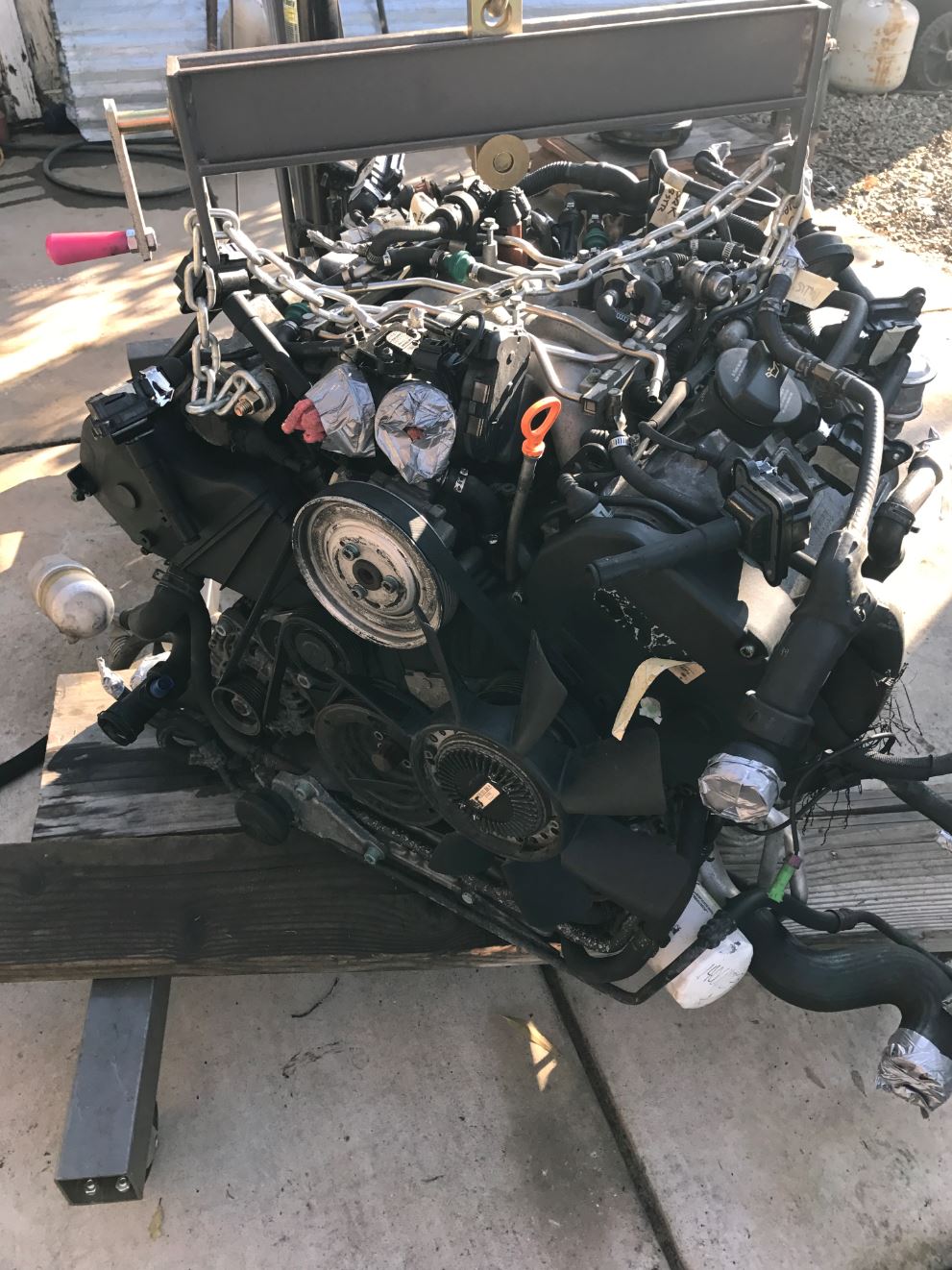

OK this weekend I mated the Cayman Trans with the Audi motor. I started removing all of the excess piping and tubing that are unnecessary (IMG:style_emoticons/default/smile.gif) (IMG:style_emoticons/default/smile.gif) . It really started to clean that rats nest of tubing up quite a bit. I'll post pictures when done. Hoping to place motor in this weekend and then make the motor mounts. Chip will then start mocking up for the custom headers. I'd like to have the motor completely bolted up this month since I will not be able to work on the work for the first two weeks of April.

That is one ugly @ss motor with all those hoses, wires and such, should look decent cleaned up!

(IMG:style_emoticons/default/agree.gif) I'll post a before and after picture. I'm removing the activated charcoal, the pcv and the secondary air pump. Ill build a puke tank for the PCV. Andrew whats been your experience on this?
