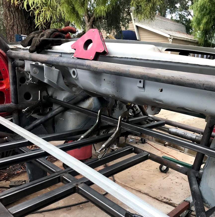

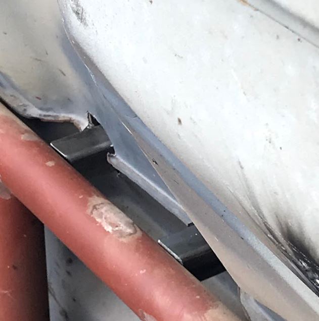

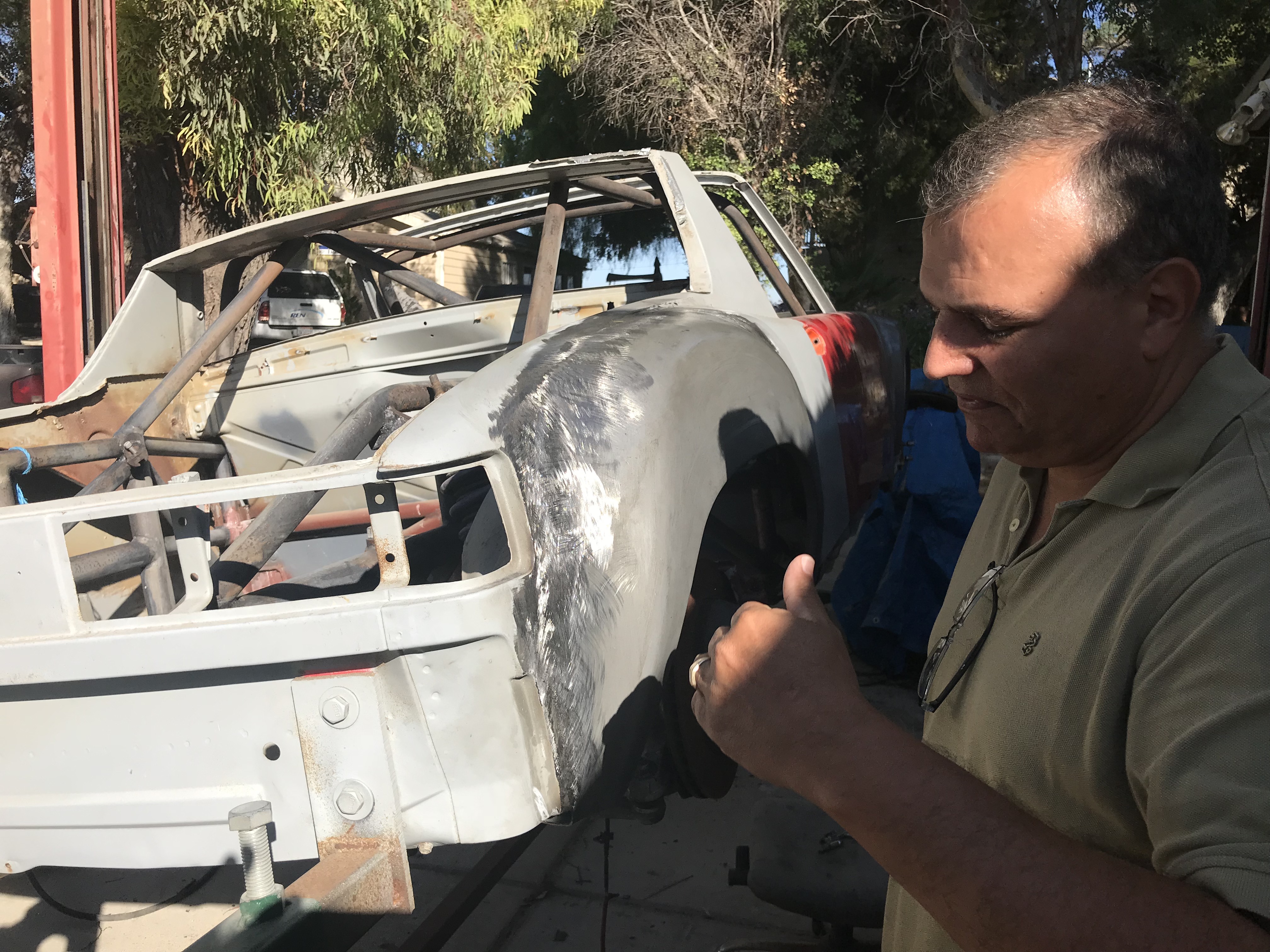

I dropped off my bumpers to Oscar and had breakfast w/ Rudy and him yesterday. I felt like I was in the presence of Royalty as I sat with these 2 metal-meister's. Afterwards I stopped by Rudy's to check his progress and snapped a couple of pic's. Very impressive build.Rudy took the time to walk me thru the flare install. He said it was easy peasy but me thinks it's a trap. (IMG:style_emoticons/default/av-943.gif) Seriously, he made it look simple but I know better. (IMG:style_emoticons/default/biggrin.gif) Anyway, here are a couple of shots of Rudy's project.

Hey Guys , @ValcoOscar @tygaboy @Andyrew @Maltese Falcon @914forme @76-914 thank you for the compliments they really do help with morale.....encouragement helps fuel the project.

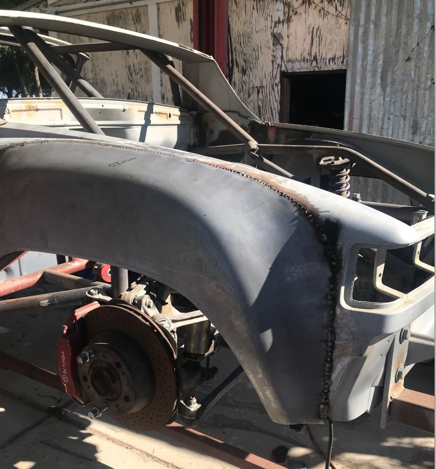

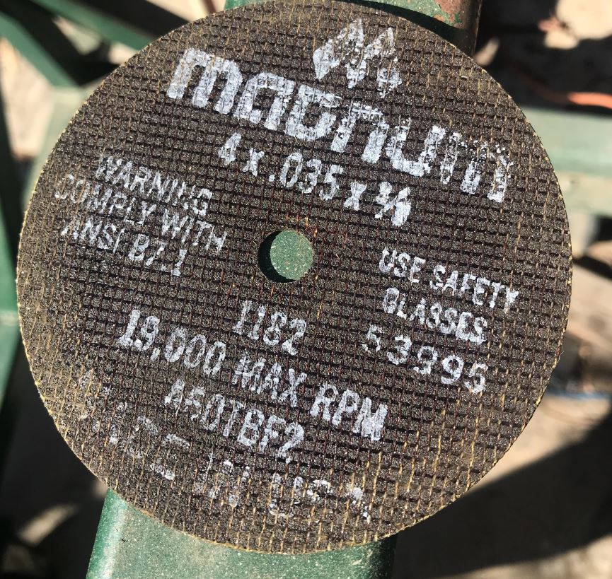

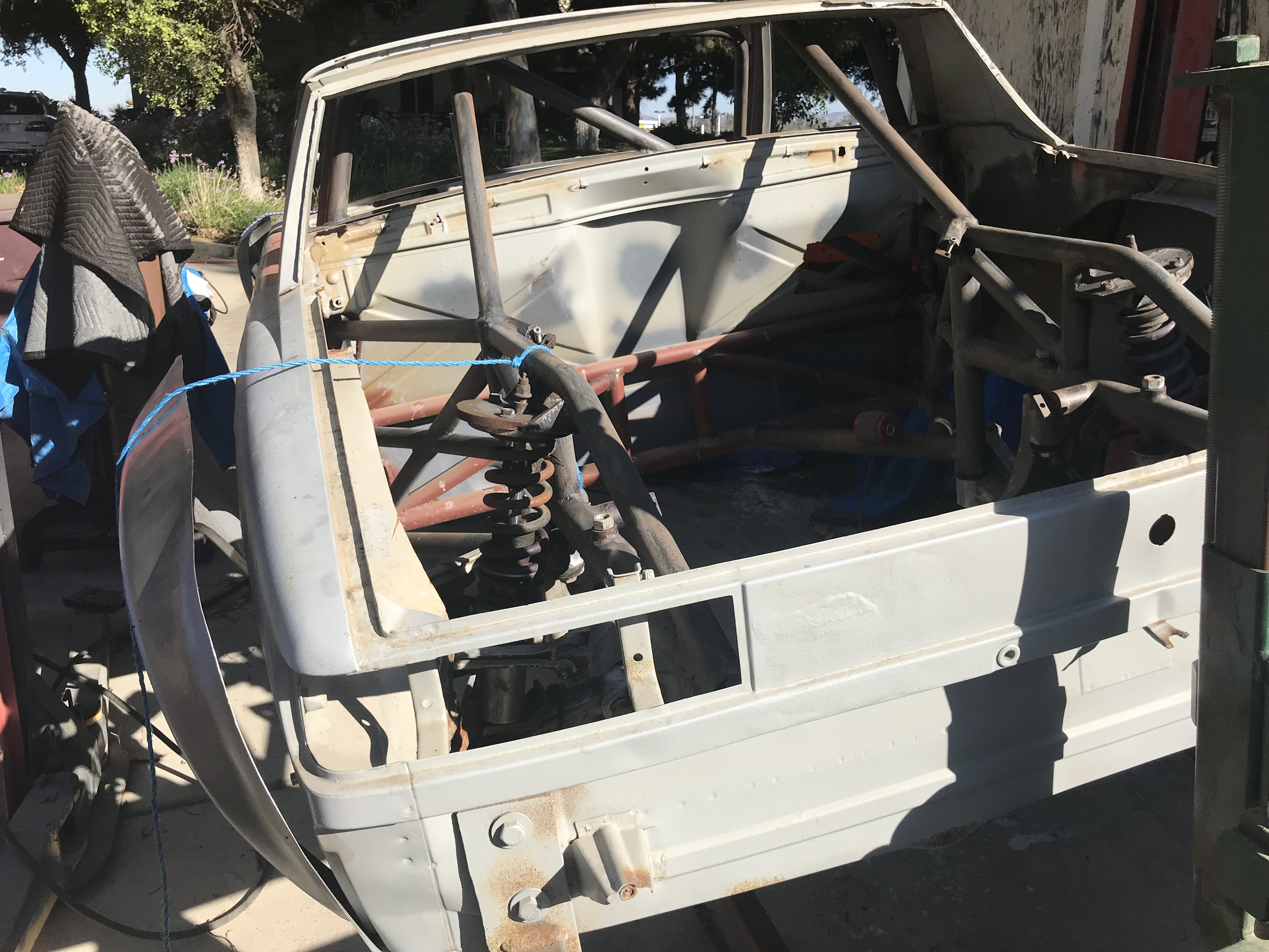

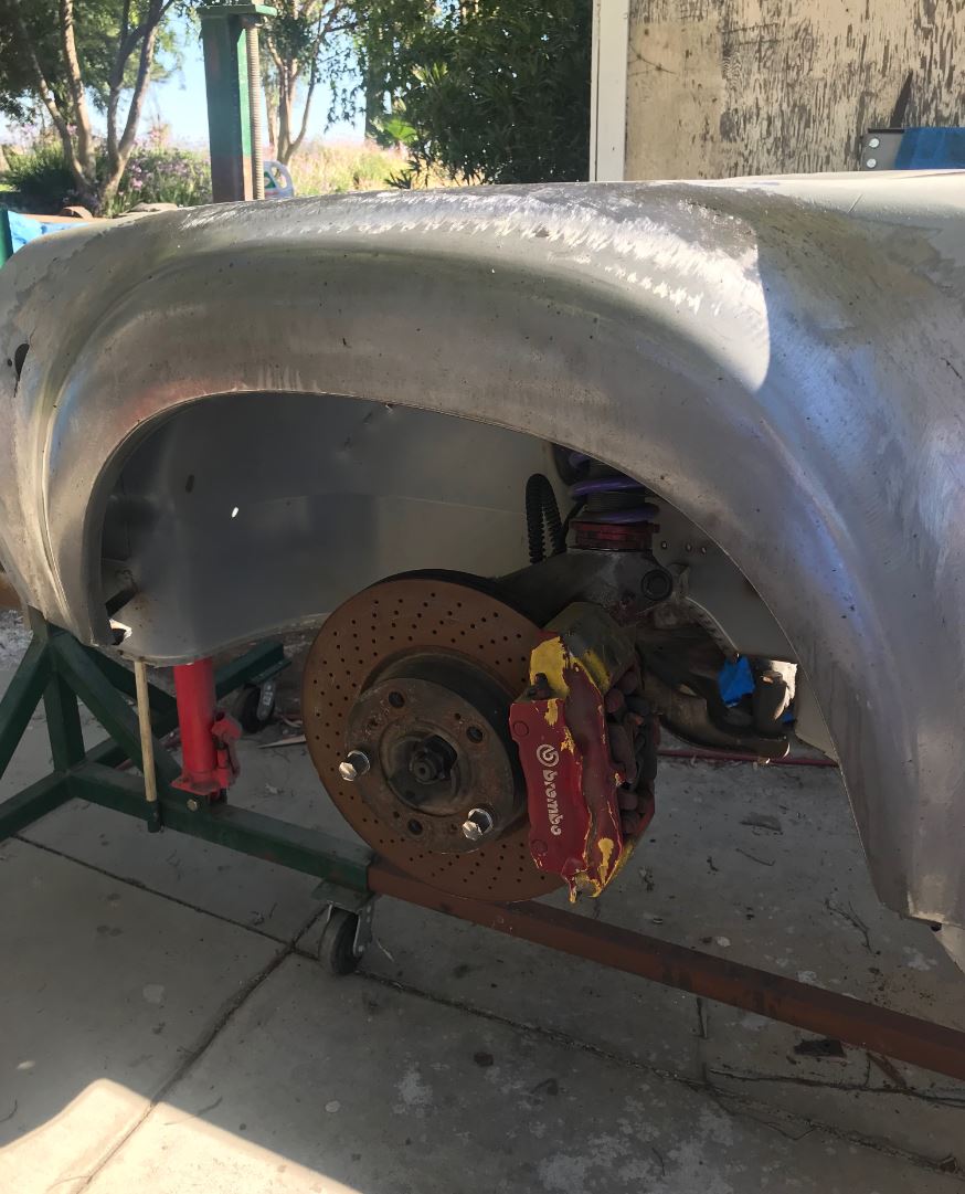

Those butt clamps were amazing, and cutting it with the thin 1/32" cut -off while using the fender as the scribe line was the trick. Also doing one half of the fender at one time was very helpful. I used 0.23 welding wire and a 110-volt Lincoln. It worked perfectly! My 200 amp wire welder was too big and it didn't like to push 0.023 wire 15' in the gun. I didn't want to tig cause I'm not good with Tig.
Well I completed the 3 fenders and the last fender is all tacked in. It now needs final welding and grinding. It will take about 30 minutes to complete. Then it's off to the floor and finish the openings in the chassis.
As for the cut-off wheel I didn't know it, but I stumbled onto some super good wheels. I was cutting along no problems and then ran out and got another brand since my local welding store ran out of the ones I was using. So I bought this other set which was expensive and was surprisingly, "made in the USA", but was pure crap. It lasted 12" of cutting into the fender before wasting away. You could watch it reduce in size in real time......ridiculous. And then, dust everywhere. The original ones would last about 12'....feet not inches. So the EXCELLENT cut off was by Pearl and it was a 1/32" thick wheel. It lasts for one fender if you include grinding. However, I think that if I did not grind with it that it could cut all four fenders.....it's that good.
Here is the Excellent wheel that I used.
Here is the crap one.
Left Front Fender
Left Rear Fender

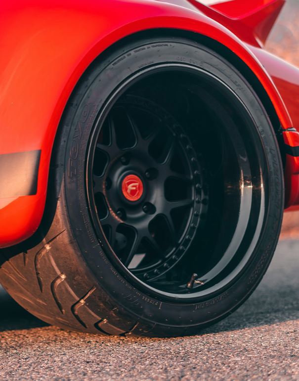

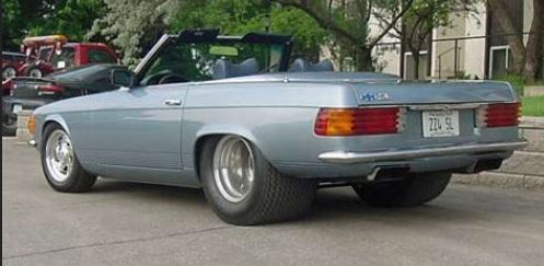

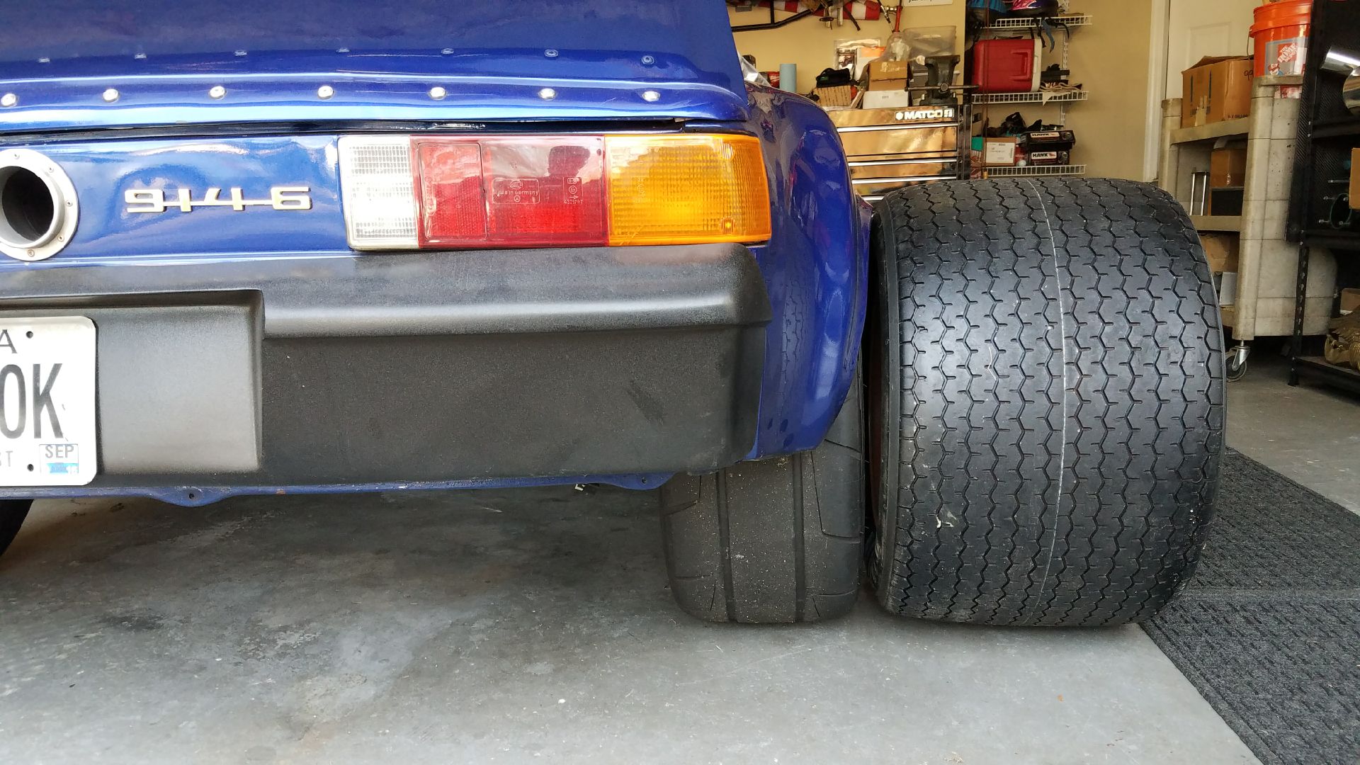

Yep, my car is too light and I need mechanical grip.
Here is a picture of the wheel and tire combo that I ordered. It will take 8-10 weeks.
Except that the lip will be polished like this.

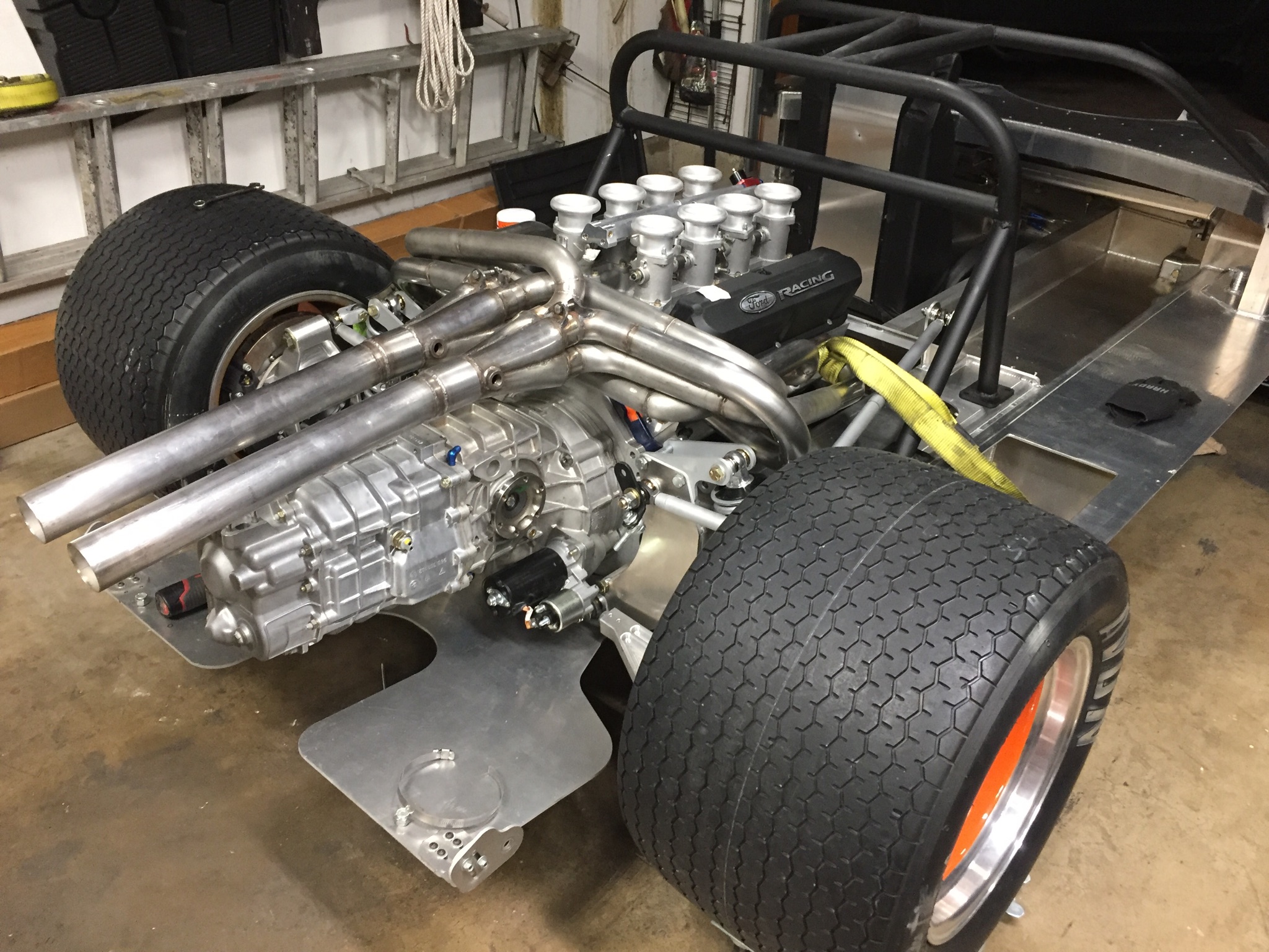

Very cool Rudy! Here is my (small) 275 rear next to the gt40's 415...it would've been waaaaay to big!

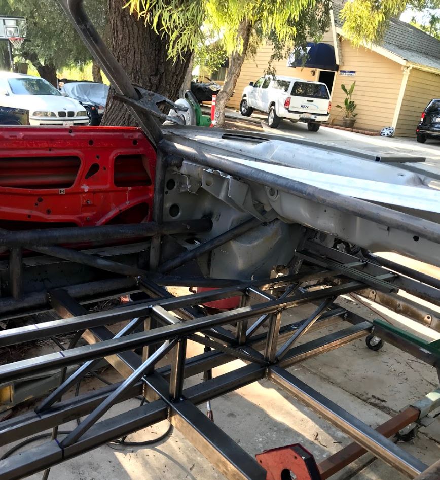

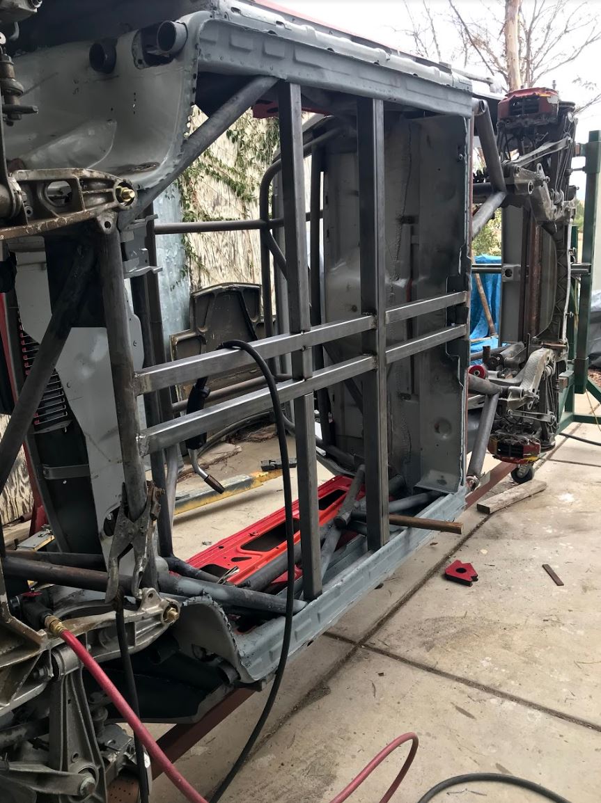

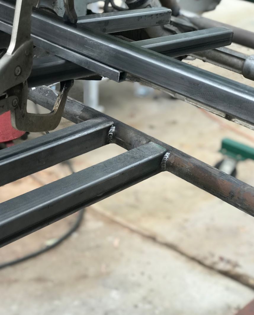

Update pictures of center tunnel and floor. Ill be finished with the center tunnel this weekend and will start with new floor. I decided on making my own floor so we will see how it turns out. I still need to add the web struts at each end of the center tunnel and it will be complete and fully structural. I plan on doing twist test soon and will be testing it with an without the top bar that tie both the rear roll bar hoop and the front roll bar hoop. If the twist test shows 1 or 2% stiffness improvement....then they will be removed.
