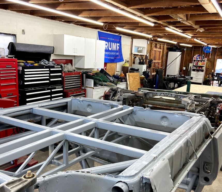

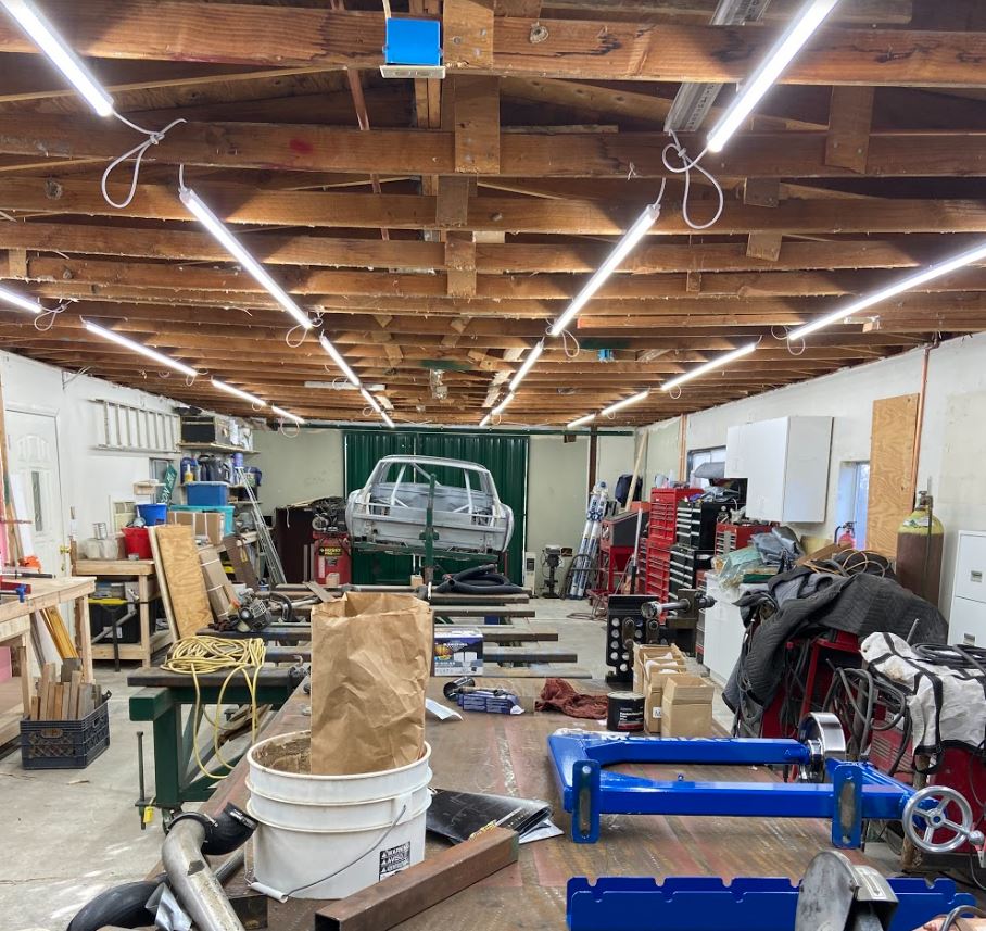

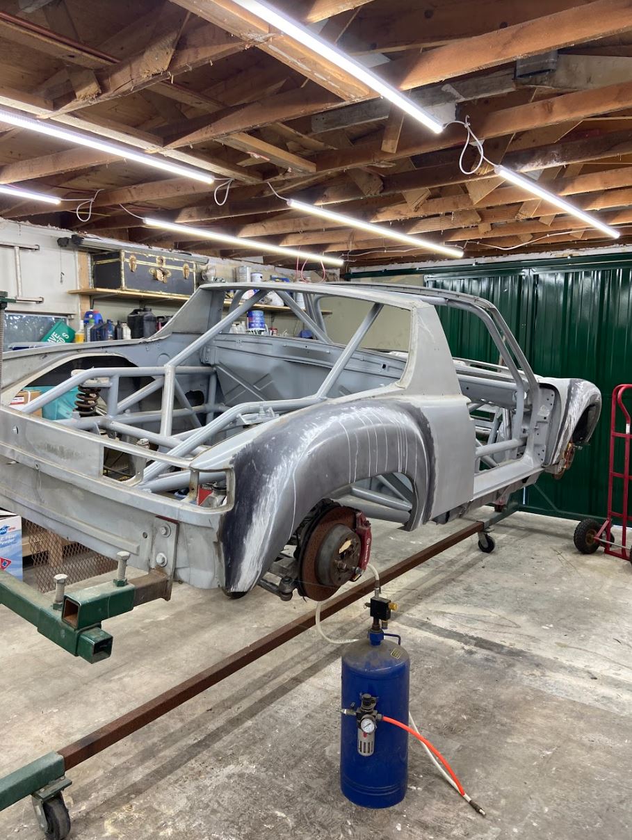

Well after a long hiatus I'm back. I moved the project into a workshop with a bunch of new fabricator tools that I needed to complete. It's on!!

Wow! Looks larger than you described. I need get over there and check it out. Do we have an "envious emoji"? (IMG:style_emoticons/default/laugh.gif)
Mueller
post Jun 9 2020, 09:35 AM
Post #570
914 Freak!
Posts: 17,150
Joined: 4-January 03
From: Antioch, CA
Member No.: 87
Nice shop, plenty of space to work on the 914. Glad to see more progress on this car.

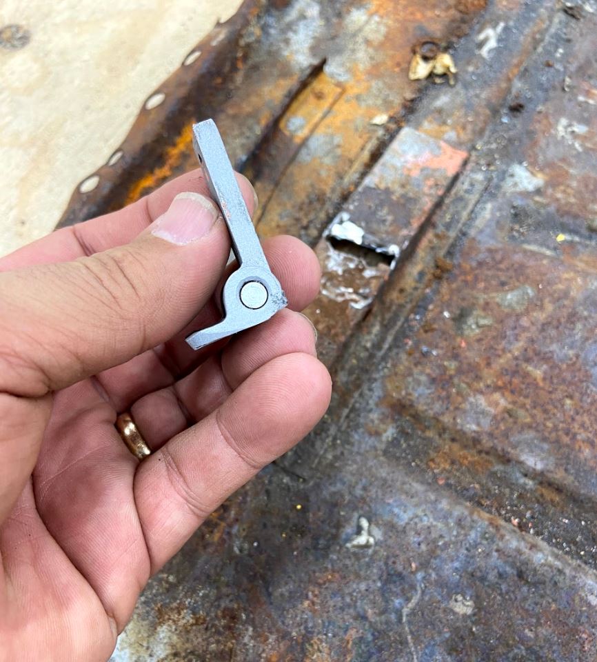

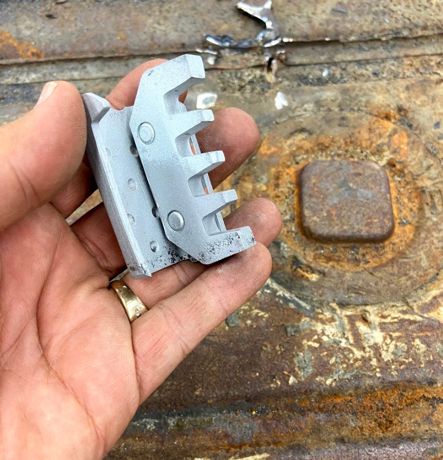

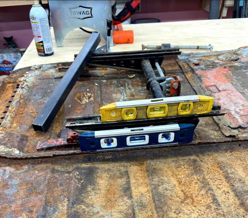

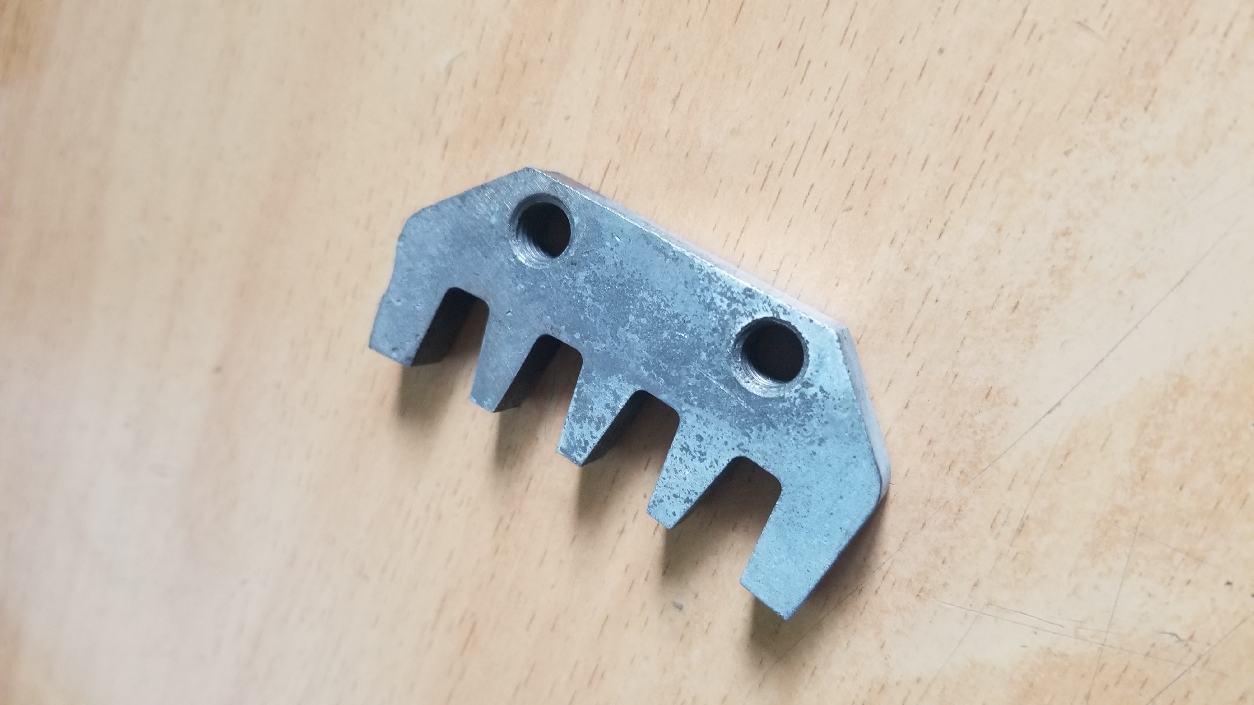

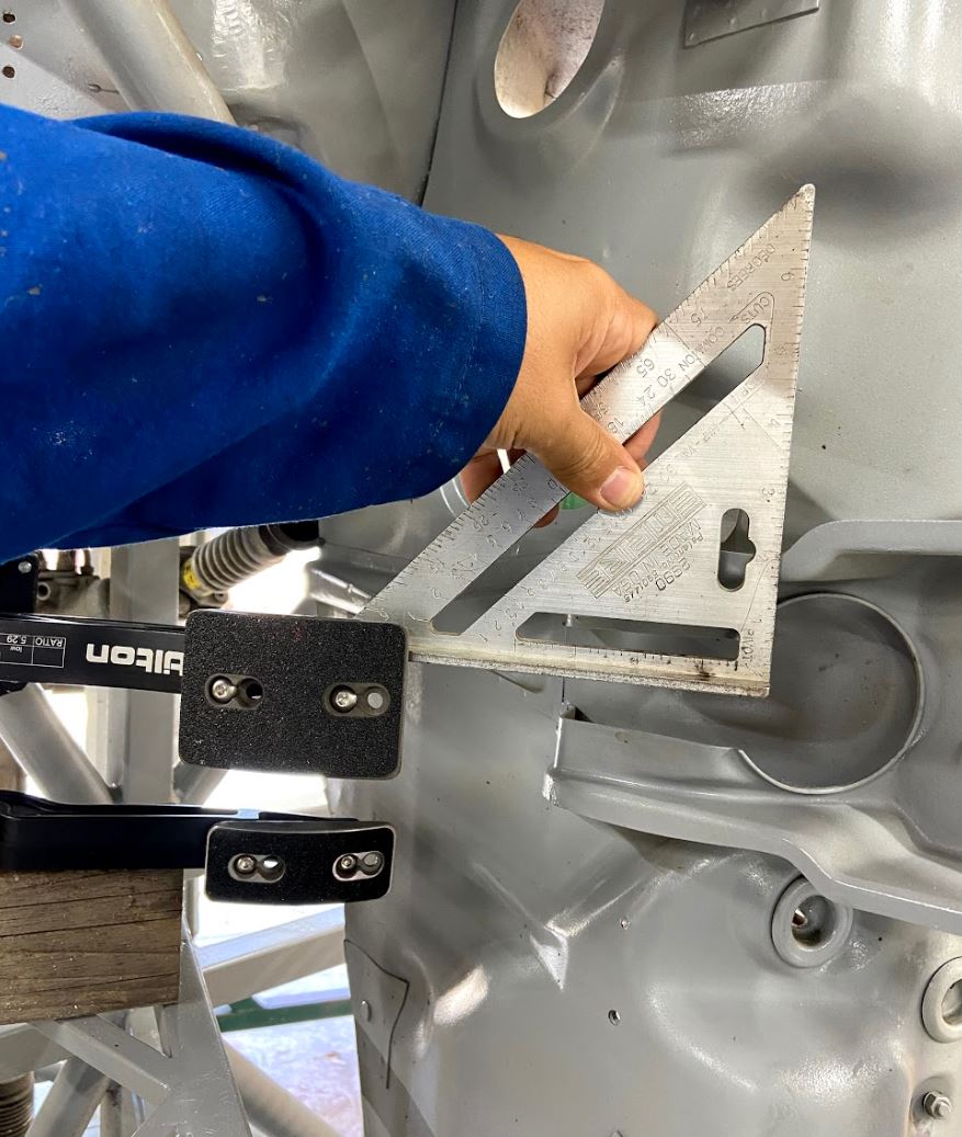

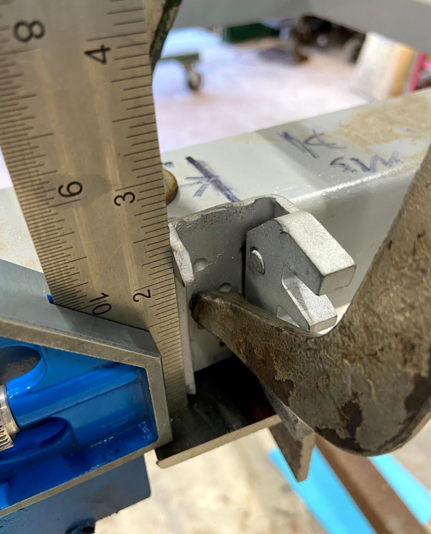

I've started building the floor pan Attached Image
but I first needed to add the supports for the 914 seats Attached Image
and for the Tilton pedal assembly. Attached Image
I was able to shift the seats 1-1/2" closer to the center of the car and the pedal assembly 3" further away from the center of the car. As you can see the brake pedal almost aligns with the steering wheel centerline Attached Image
By doing this I was able to more closely align the seats and the pedals with the steering wheel centerline. In doing this I found out that I am in need of the seat elevation control tab that attached to the floor pan.
If anybody is cutting one up let me know as I need this part. Attached Image
ALSO THANKS EVERYONE FOR THE WELCOME BACK......ITS NICE TO BE BACK!!

bdstone914
post Jul 20 2020, 08:29 PM
Post #579
bdstone914
Posts: 4,873
Joined: 8-November 03
From: Riverside CA
Member No.: 1,319

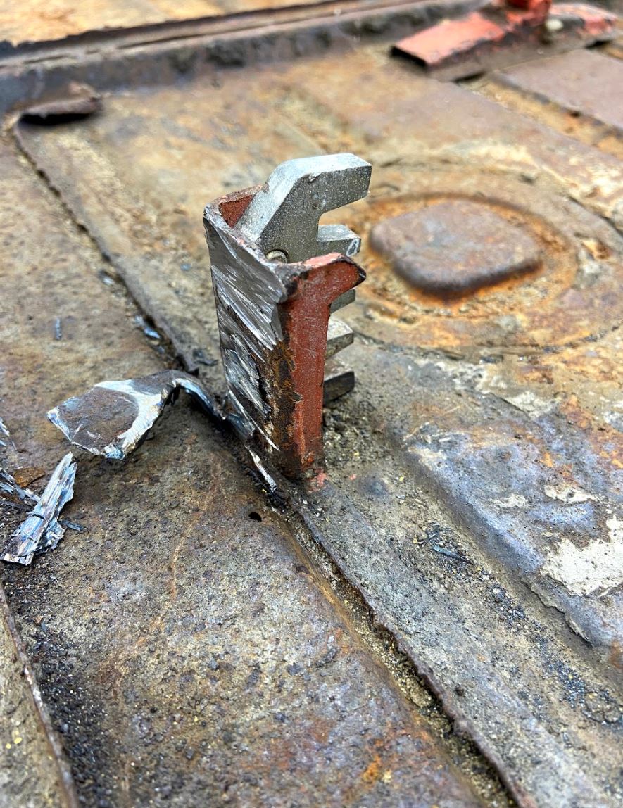

I have those parts.
I have on on a chunk of cross member and can cut it off.
The driver and passenger brackets are different. Is what you pictured the one you need or the one you have? I am not sure they can be swapped.
The one I have on the cross member is exactly like what you pictured. I think I cut both from the parts car.
Easier to ship unless you like to drive
@Curbandgutter
