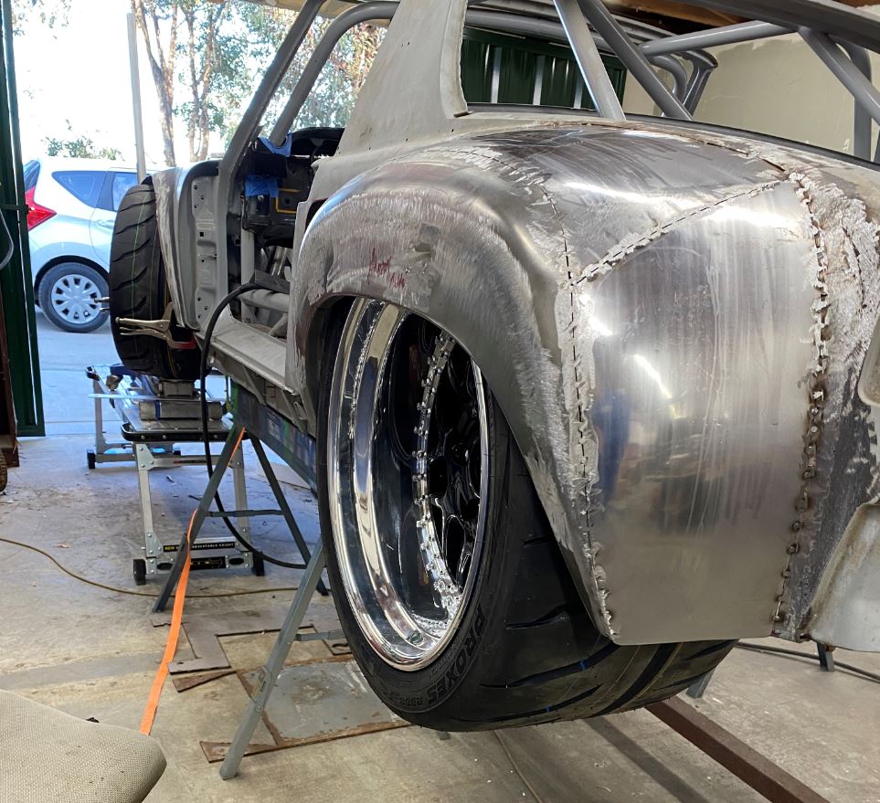

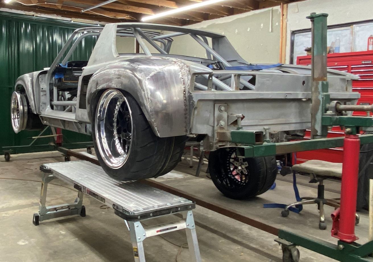

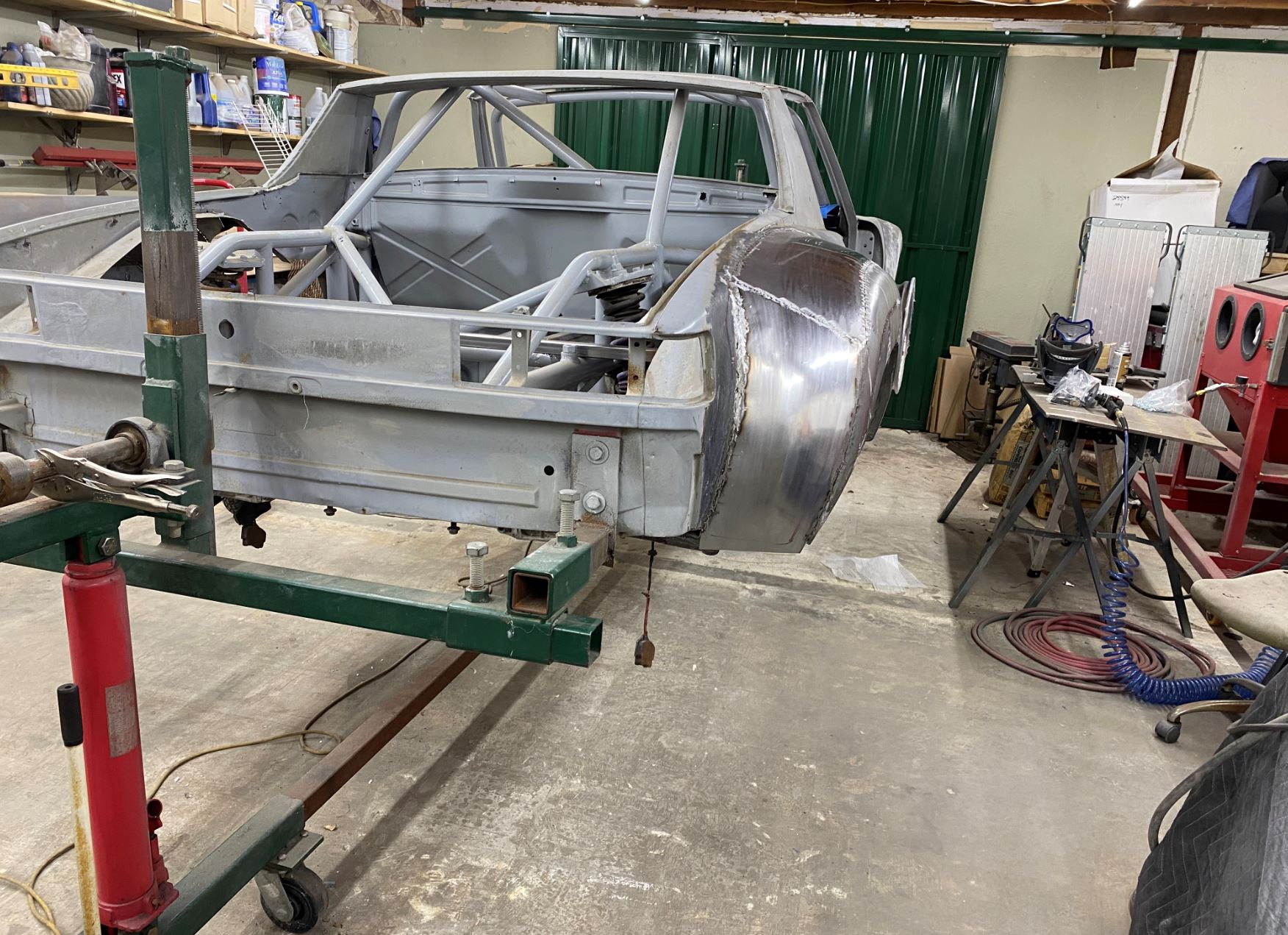

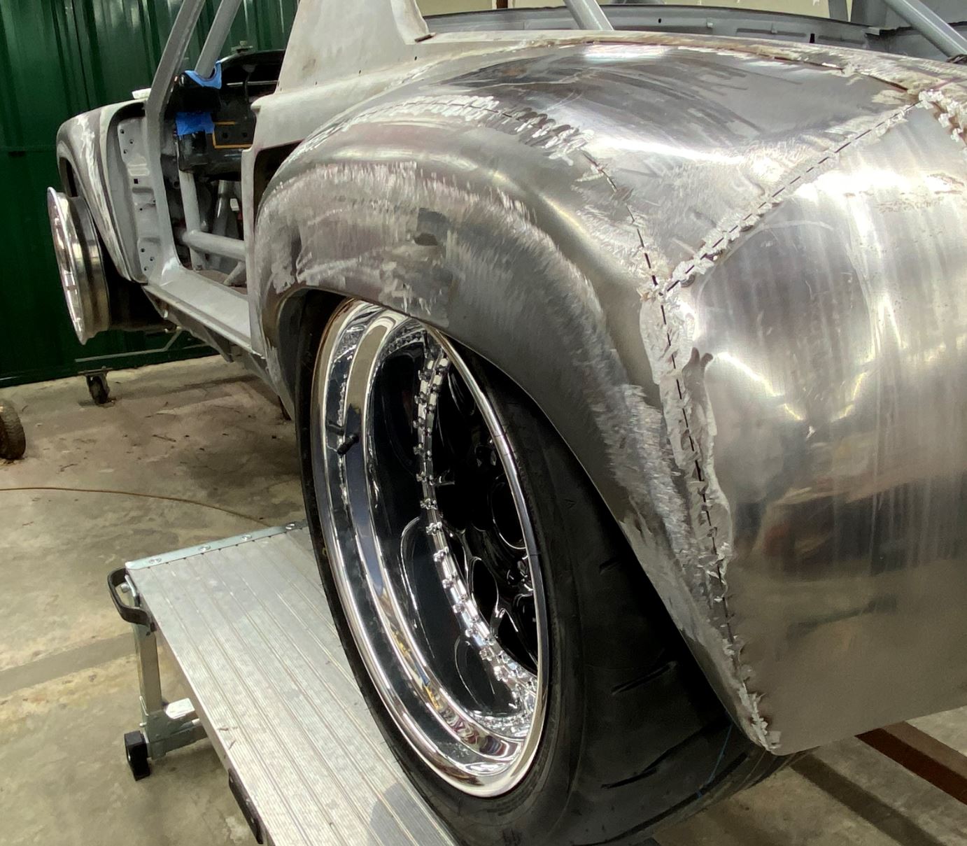

REAR FENDERS ARE PRETTY COMPLETE NOW. RUBBER COMING IN TOMORROW. JOPING TO START FRONT FENDERS THIS WEEKEND

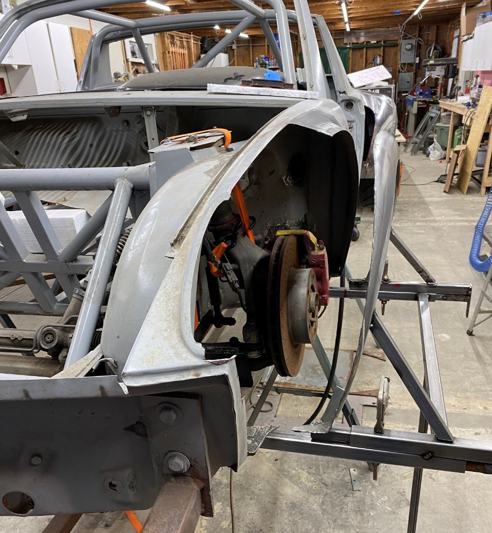

Hey does anyone have front portions of the front fenders available? I need the portion where the turn signal bucket goes in. I want to widen the front turn signal bucket about 1" so that I can stick some LED's in there. Since I will be working the front fenders this weekend.......timing will be just right.

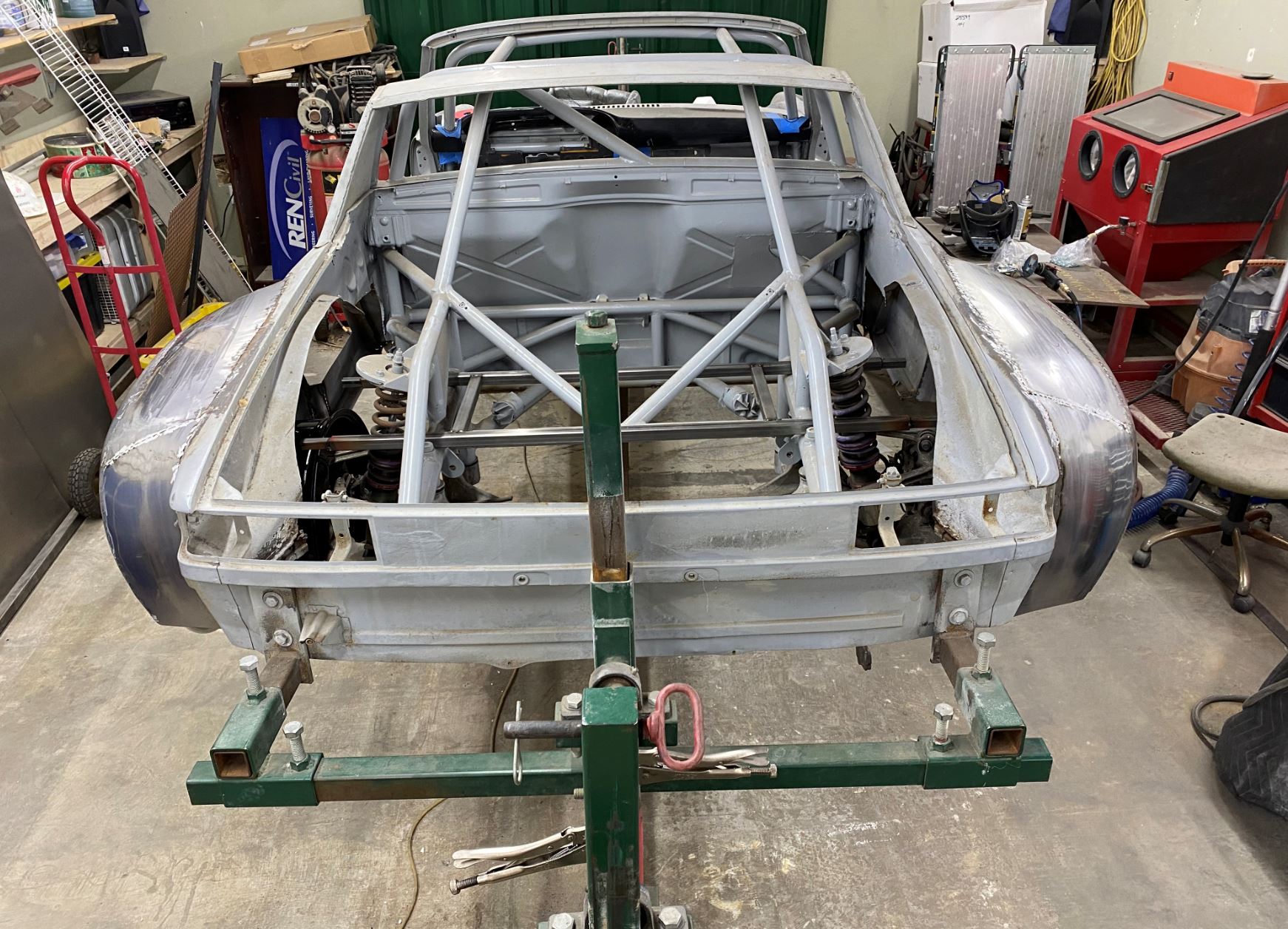

Totally awesome build. Huge props.
I have to ask... is that driver's side cage tube gonna be a head knocker? Seems low and right in line with a helmet. Sorry, don't mean to be negative at all, pic just begged the question.
Outstanding metalwork. (IMG:style_emoticons/default/beerchug.gif)

QUOTE(Curbandgutter @ Feb 23 2021, 02:49 PM) *
Why not just slit the fenders right down the crown from the middle of the turn signal bucket? A lot easier to work with the original shape intact and one cut on the top.

QUOTE(Rand @ Feb 23 2021, 07:48 PM) *
Rudy mentioned on facebook that he's going to remove the A to B pillar bars after he's done with chassis work, they were there just to keep the chassis straight during fab.

QUOTE(Jeff Hail @ Feb 24 2021, 12:37 AM) *
Jeff yes I see what you mean. That would work fine if I were going to split the entire top front to back. But, I'm only widening the front half of the fender on the outside edge.
I think it will be a three step process. 1) add 916 flare 2) widen 916 flare 3) add widened outside edge.
Basically I will spilt the top but I need the original front outside skin to stay in place until I build the widened outside skin and then cut the inside "now" inside skin out.

[CARNE.........IT'S WHATS FOR DINNER
dan10101
post Feb 25 2021, 10:44 PM
Post #671
TORQUE-o-holic
Posts: 1,140
Joined: 29-April 03
From: Eagle Point, Or
Member No.: 626
So Sexy!!
(IMG:style_emoticons/default/drooley.gif) (IMG:style_emoticons/default/drooley.gif)
mgp4591
post Feb 25 2021, 11:12 PM
Post #672
Posts: 5,607
Joined: 1-August 12
From: Salt Lake City Ut
Member No.: 14,748
That's a spicy meatball! (IMG:style_emoticons/default/aktion035.gif)

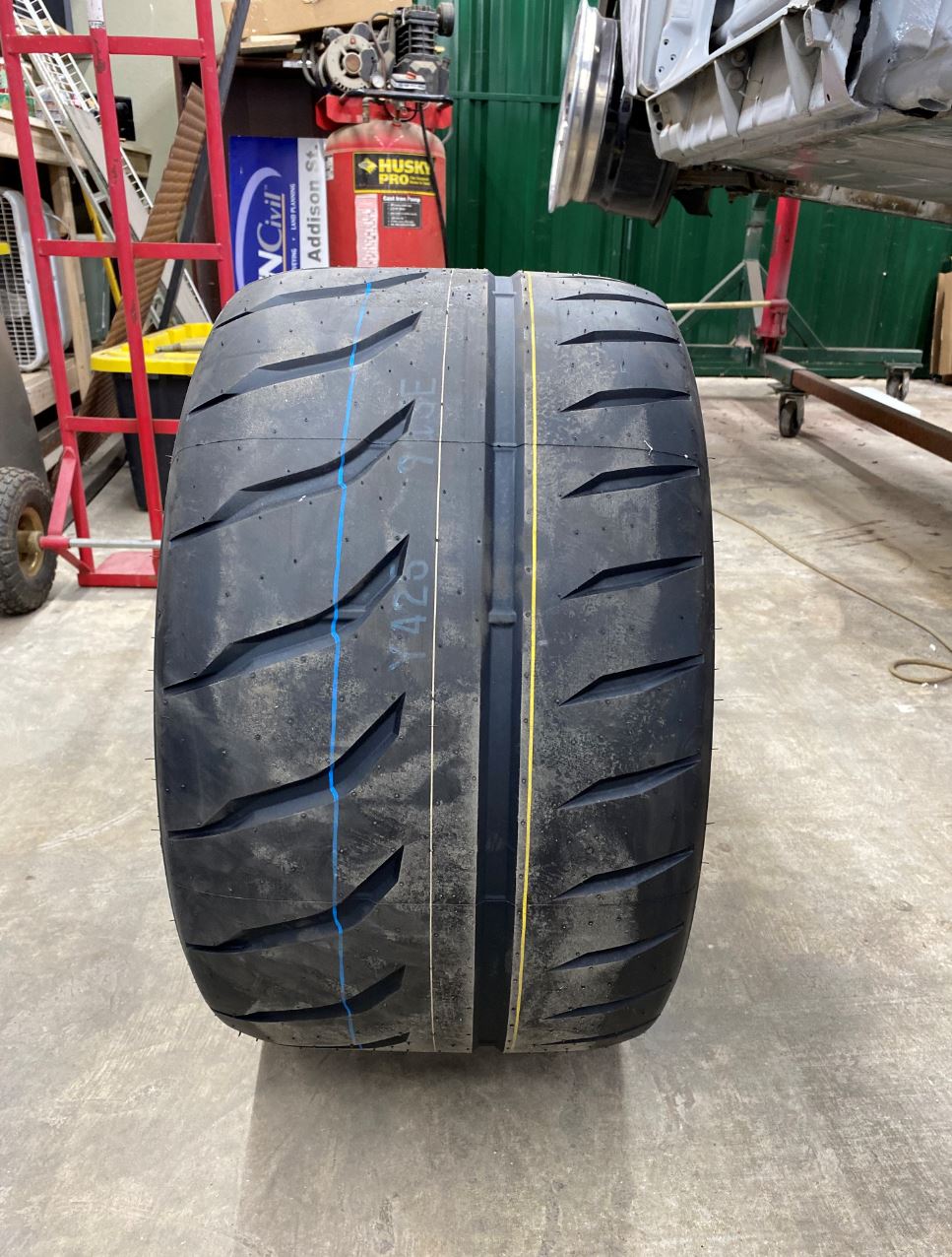

WIDE you pick those tires? (IMG:style_emoticons/default/av-943.gif)
Your traction makes me envious... Can't wait to see the fronts go on!
(IMG:style_emoticons/default/w00t.gif) (IMG:style_emoticons/default/w00t.gif) (IMG:style_emoticons/default/w00t.gif) (IMG:style_emoticons/default/w00t.gif) Don't know wide I choose them! I'm working on the fronts this weekend. I have to have the tire though since I can't have any rubbing issues. They're supposed to come in today but we shall see. I'm so stoked with the way it's coming out. You know you build it in your head and you think it's going to look a certain way........and then, after all that work it looks just like you imagined it......man that is an awesome feeling. I'm sure you know all about that! Once I have the fronts done then I will tackle installing the 7 radiators, then it's building a set of headers and down pipes for the turbos. I would like to get the car at least with the radiators installed and have a true roller by this summer......we shall see. But these fenders and rims have really put a lot of air in my sails. All of the work to this point has been hard and not as satisfying as seeing it come together with those fenders.

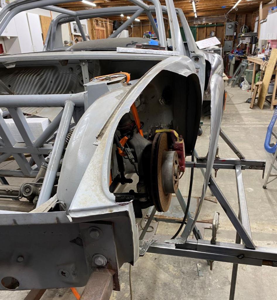

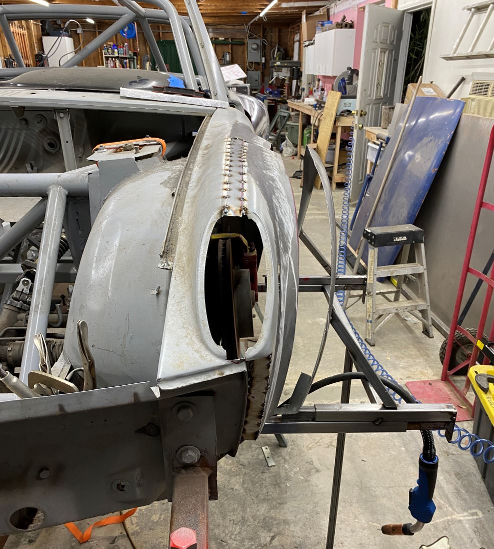

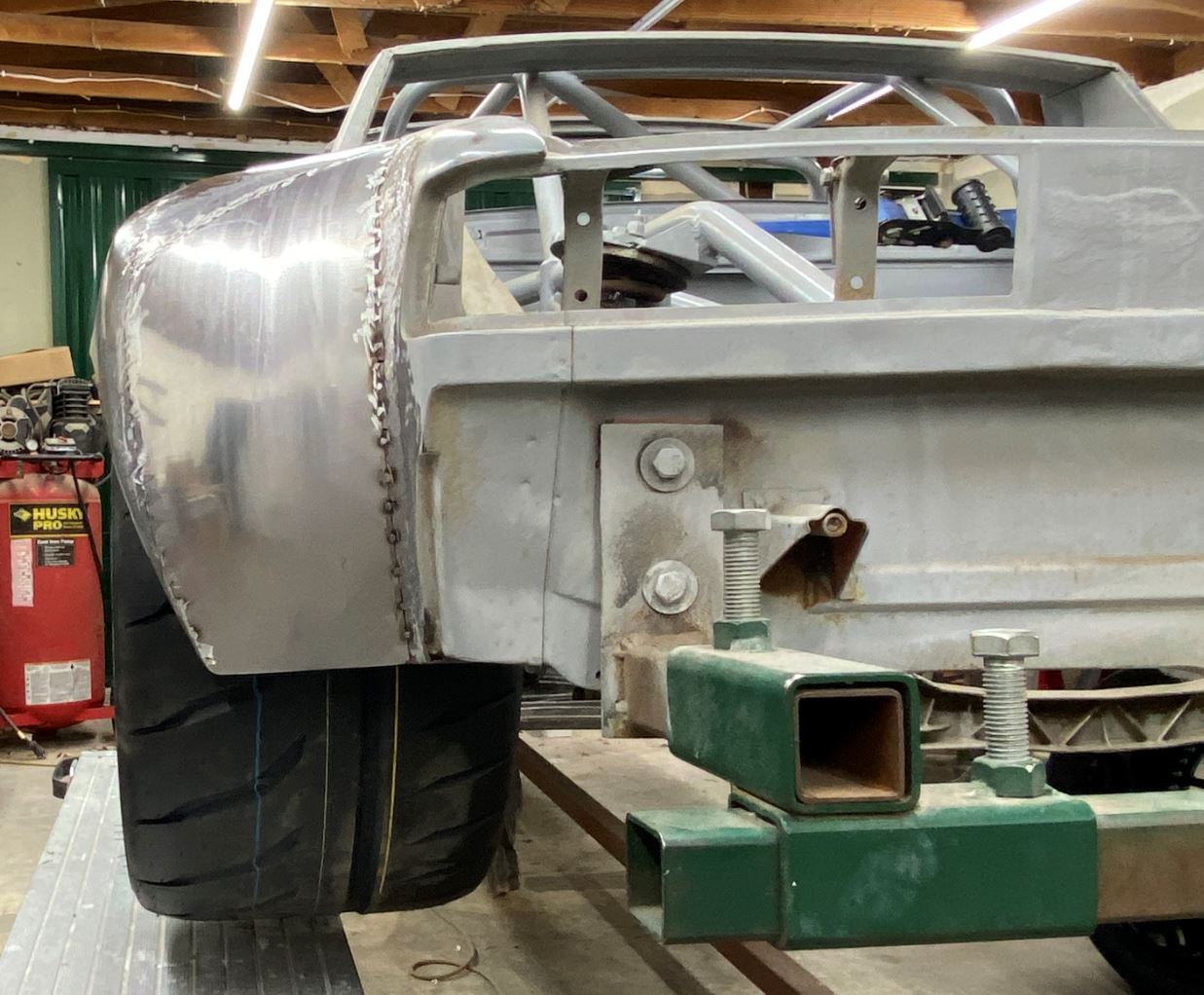

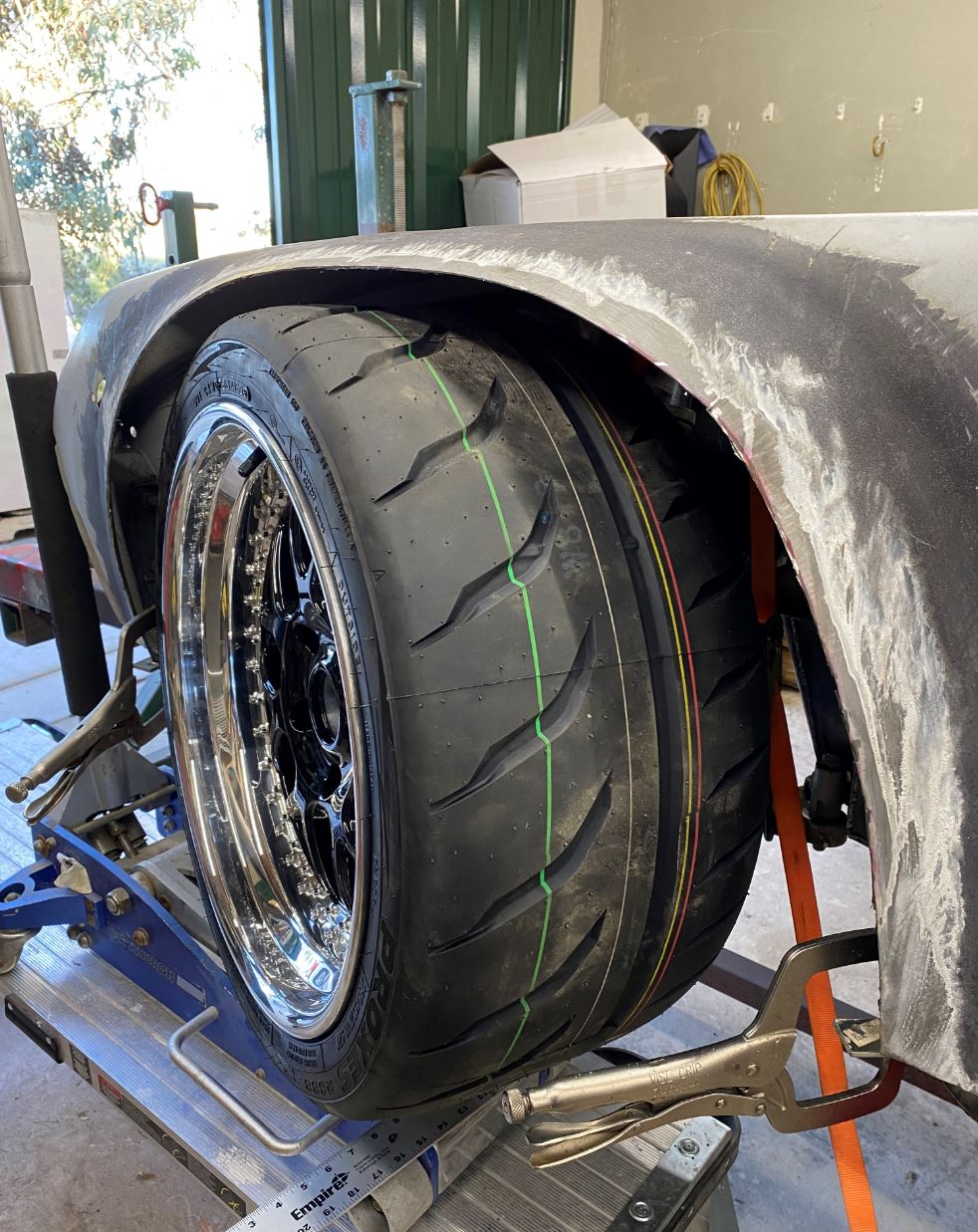

Moved on to the front. Had to compress the front wheel and turn both directions to make sure that the wheel would not rub. Also, the shot of the rear is still with 1" of uptravel before it bottoms out. I would like the at rest position to be 1" lower. I want 2" of uptravel.
1" uptravel left Attached Image
Compress and check for rubbing Attached Image
Cut out front half of fender outside face to widen the turn signal for LED projectors to fit in. Did what @JEff_Hail said to do since I couldn't get an outside skin in time, and his idea turned out to be better.Attached Image
widened 1" and insert LED Projectors in here. This also makes it so that the 3" extension on the front fenders (total of 5") doesn't look weird. Yes a jig for fronts as well. Attached Image
I think that I will have the drivers side front fender complete this weekend. The passenger side will be done in half the time. I spend a lot of time figuring and measuring but that's already known so it will be quick for fronts (4 hours or so).
