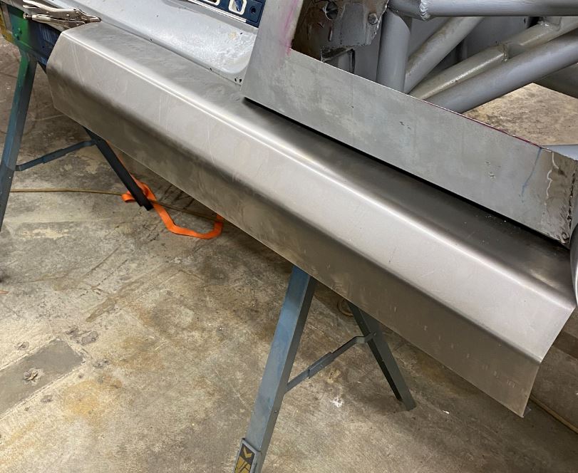

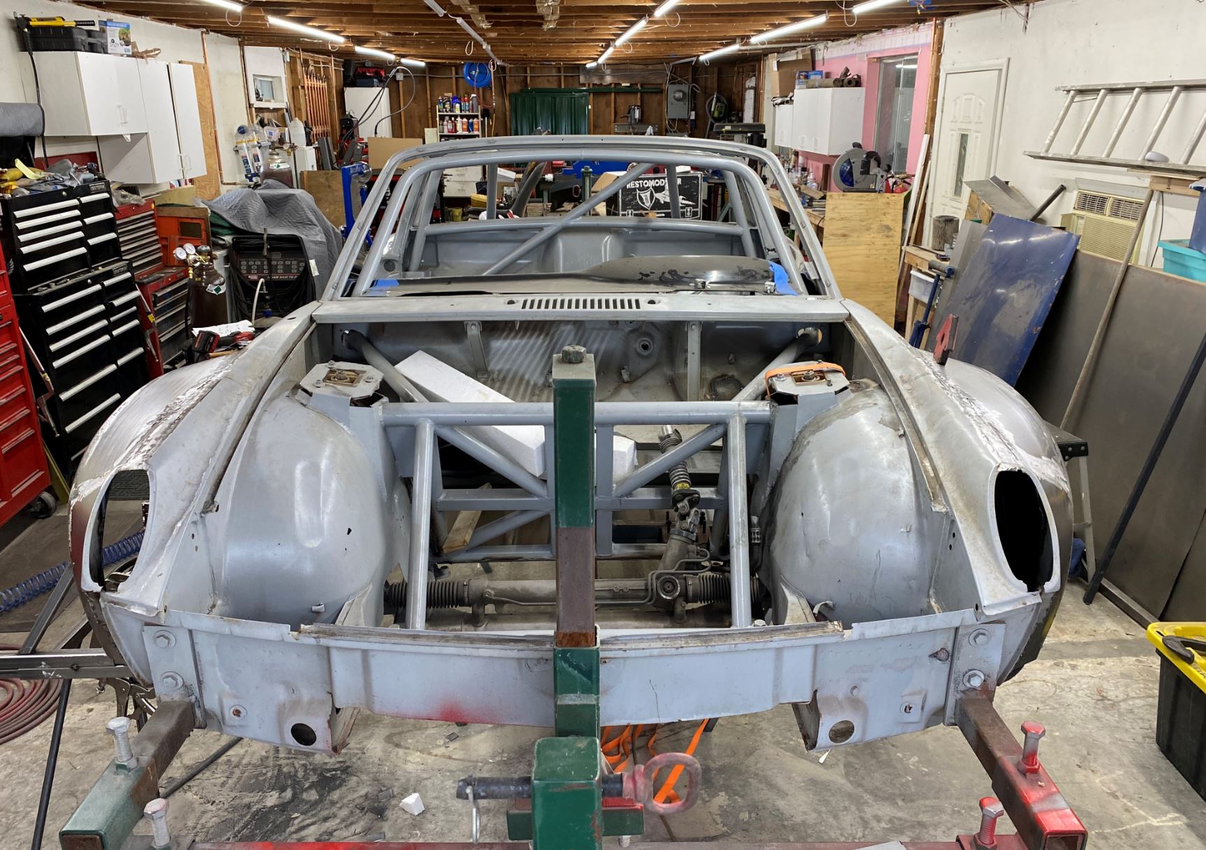

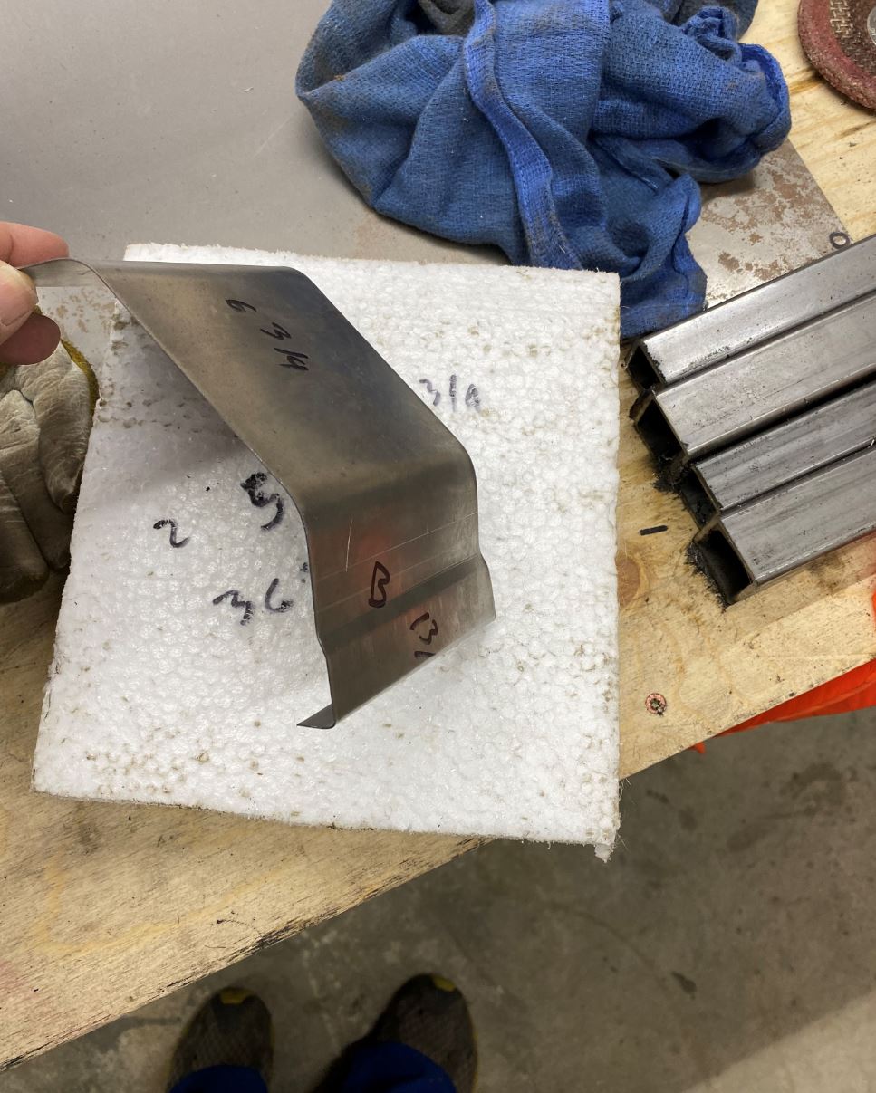

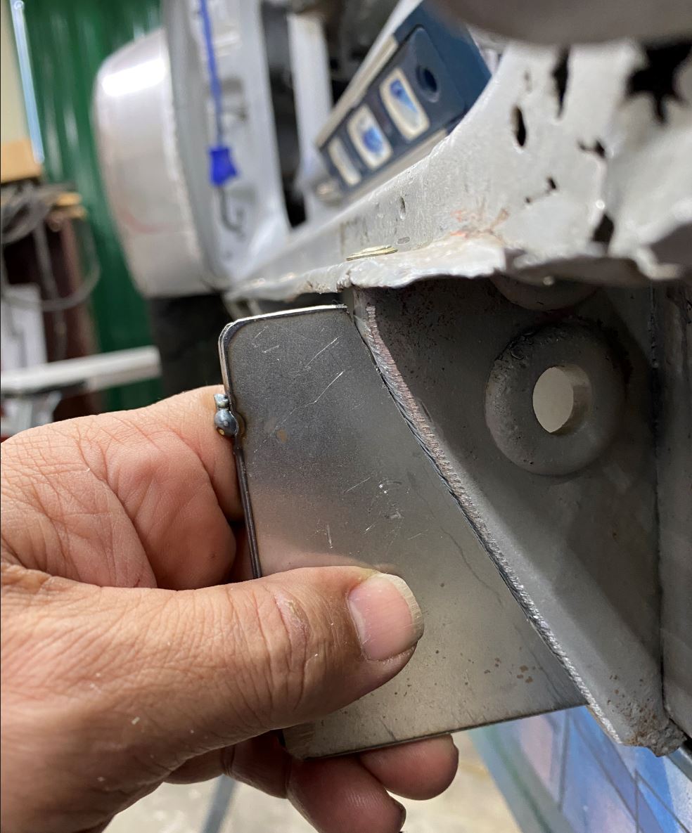

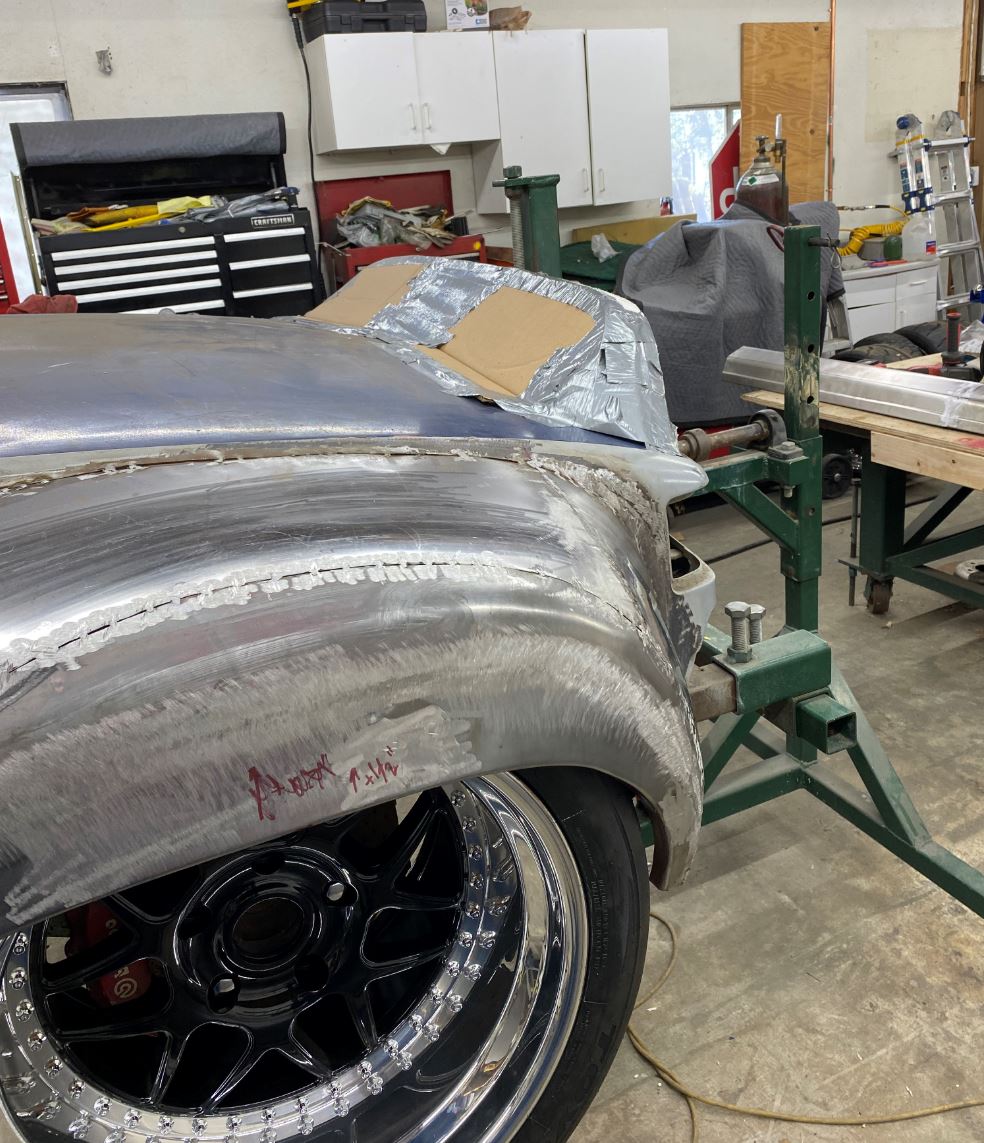

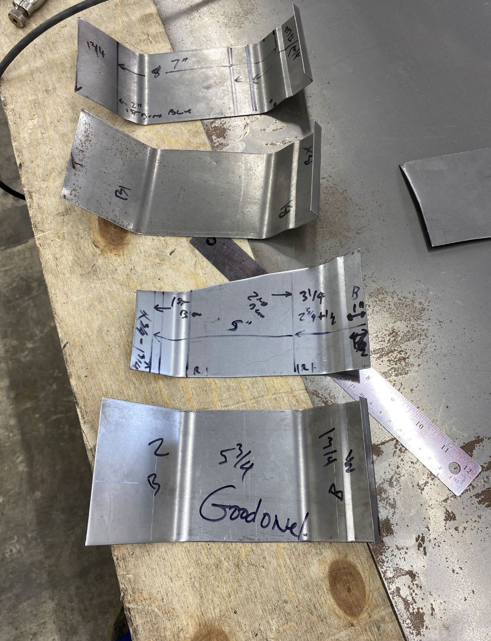

I semi completed all the fenders. I need to finish the rocker panels before I finish welding the fenders. I tried different bends to get to the final depth that I wanted. The final rocker will have a rubber strip and fastened like Marv's 6 project. Here are some update pictures.
This is how the the front wide-body is lookingAttached Image
bend cut try again Attached Image
getting closer Attached Image
this one ( 1.5" radius and offset along lower lip or Attached Image
this one ( 2" radius and no offset along lower lip) I think the previous one was starting to
look like crown molding Attached Image

Well done Rudy. What gauge are you using for the rocker panels? Also, can you describe/show what you're using to shape/bend the metal?

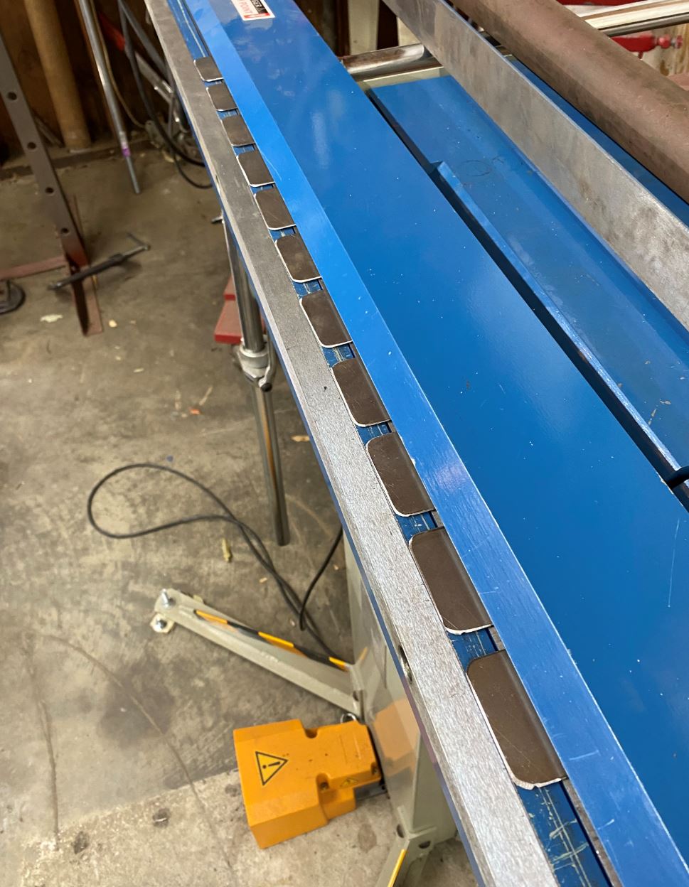

QUOTE(watsonrx13 @ Mar 19 2021, 05:53 AM) *
Im using 22 gauge on the rocker panels. I use a sheet metal magnetic brake to bend everything. I used a 2" pipe as a backer to get the brake to brake a radius as opposed to a sharp corner.

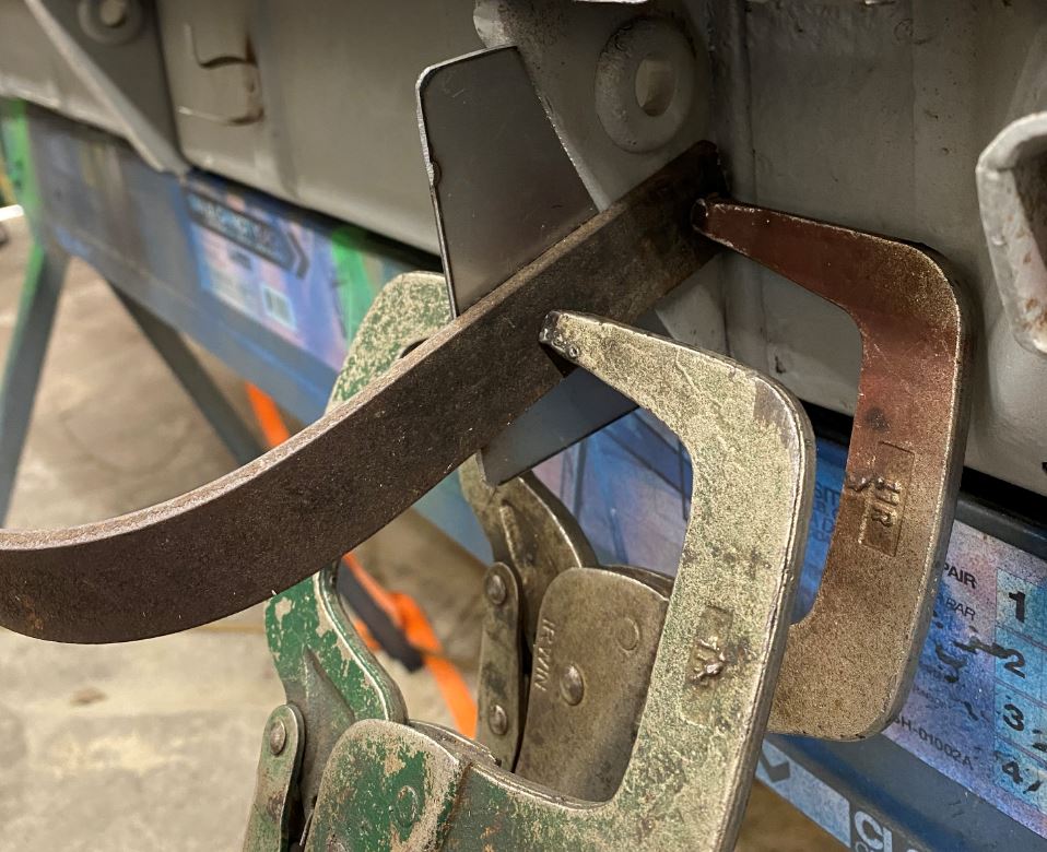

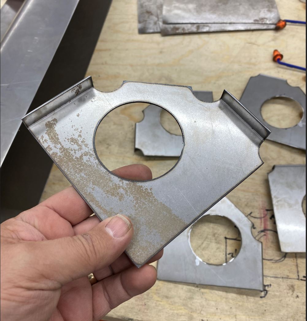

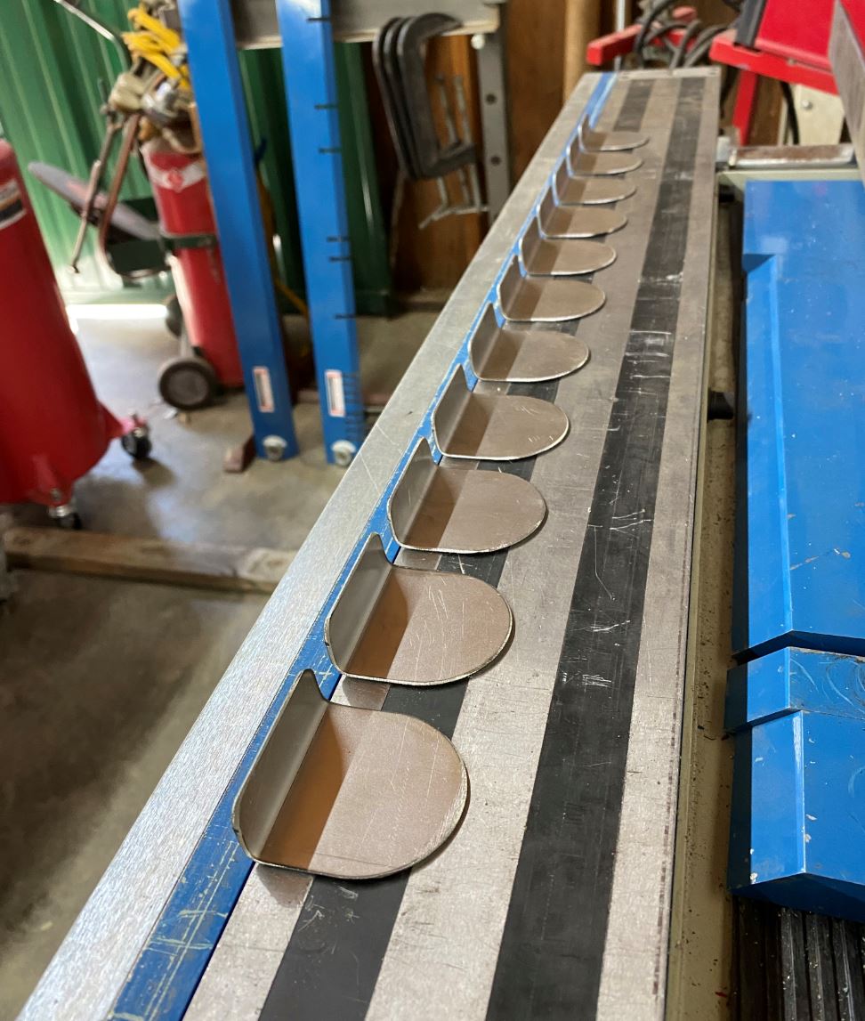

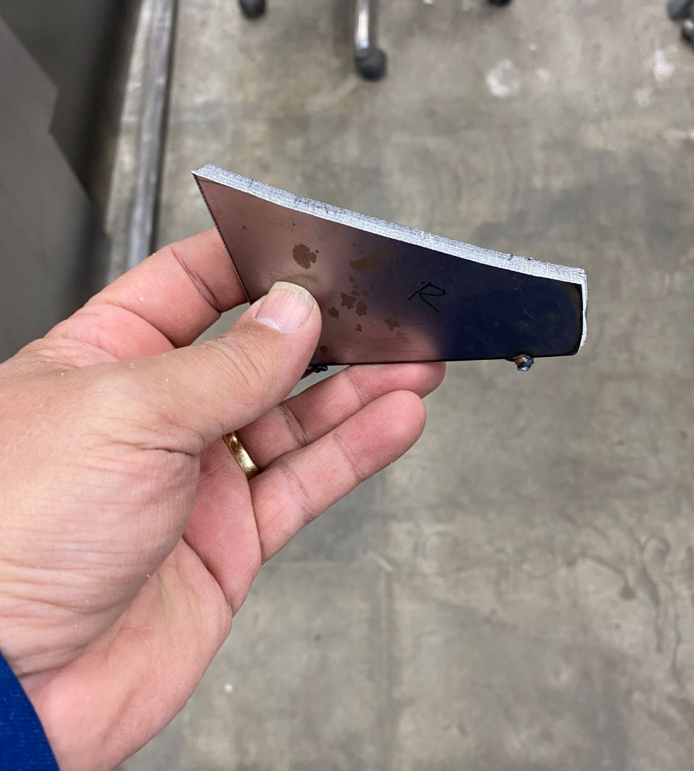

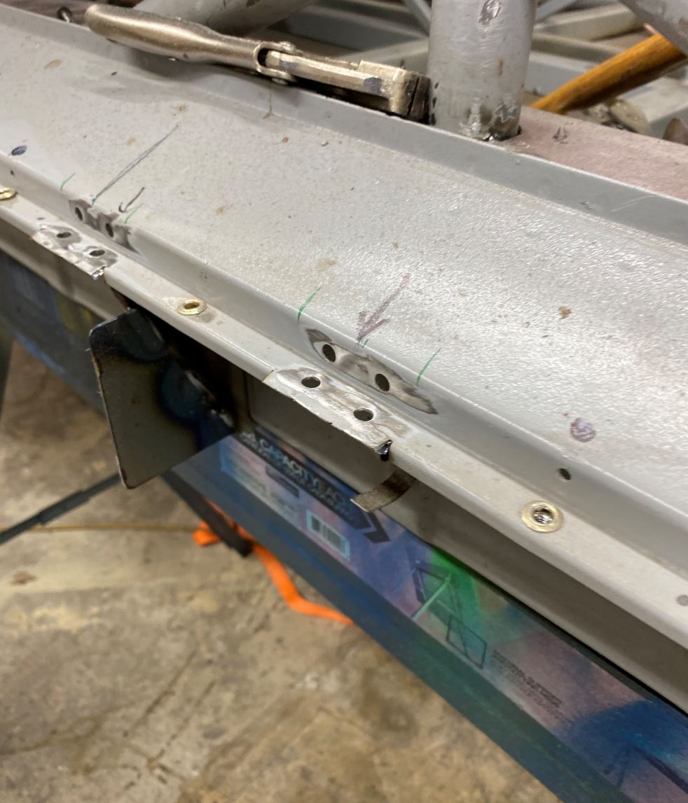

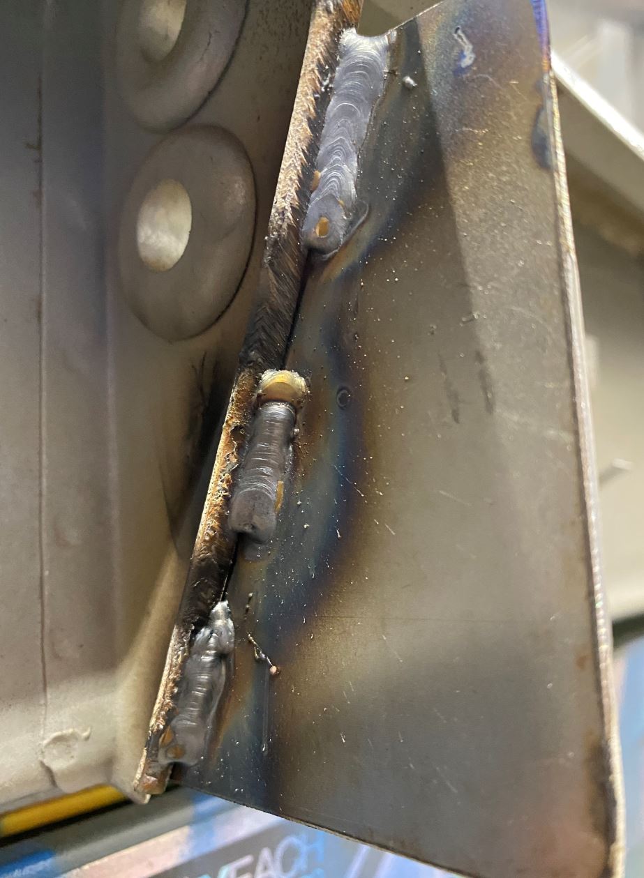

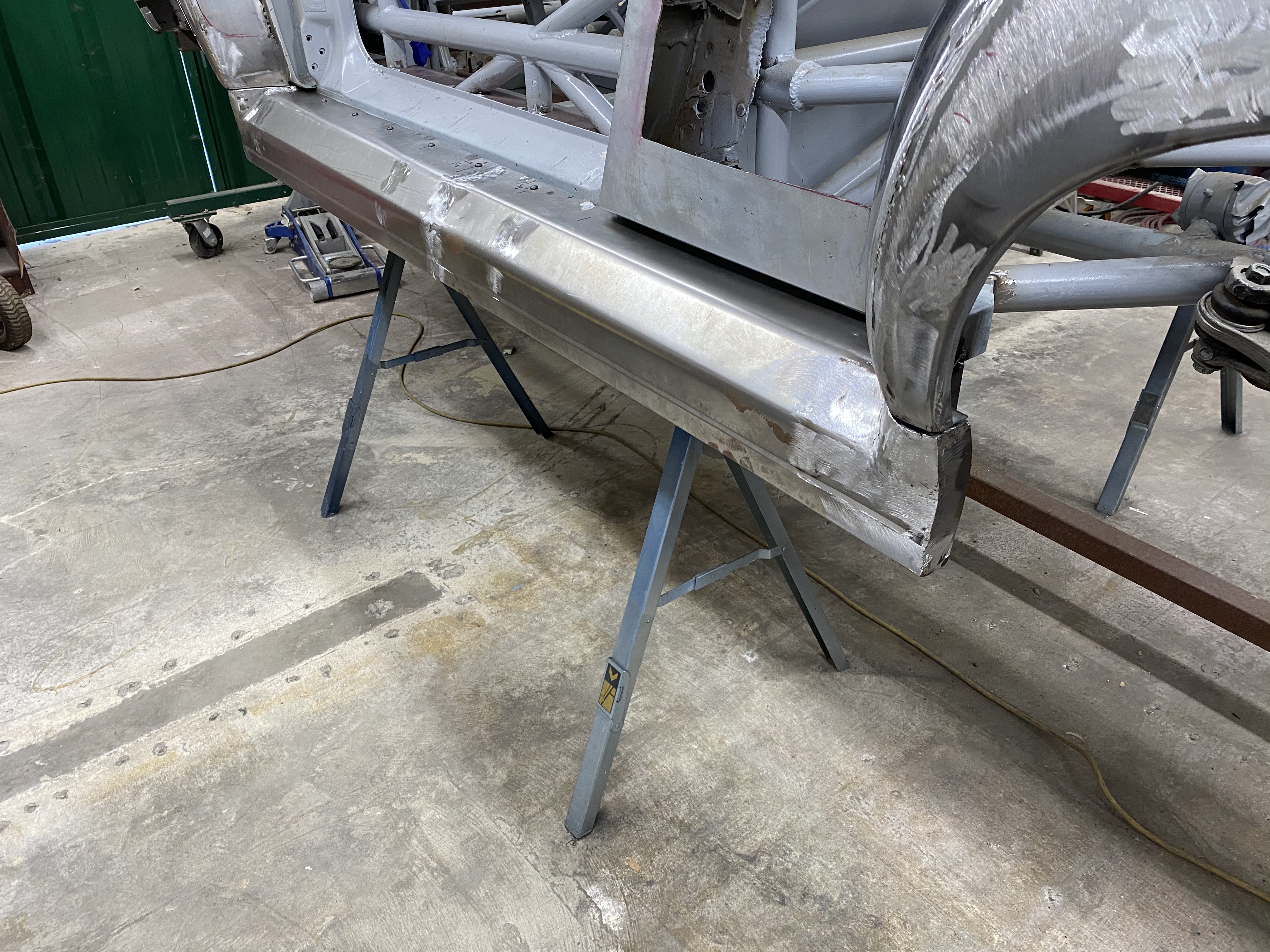

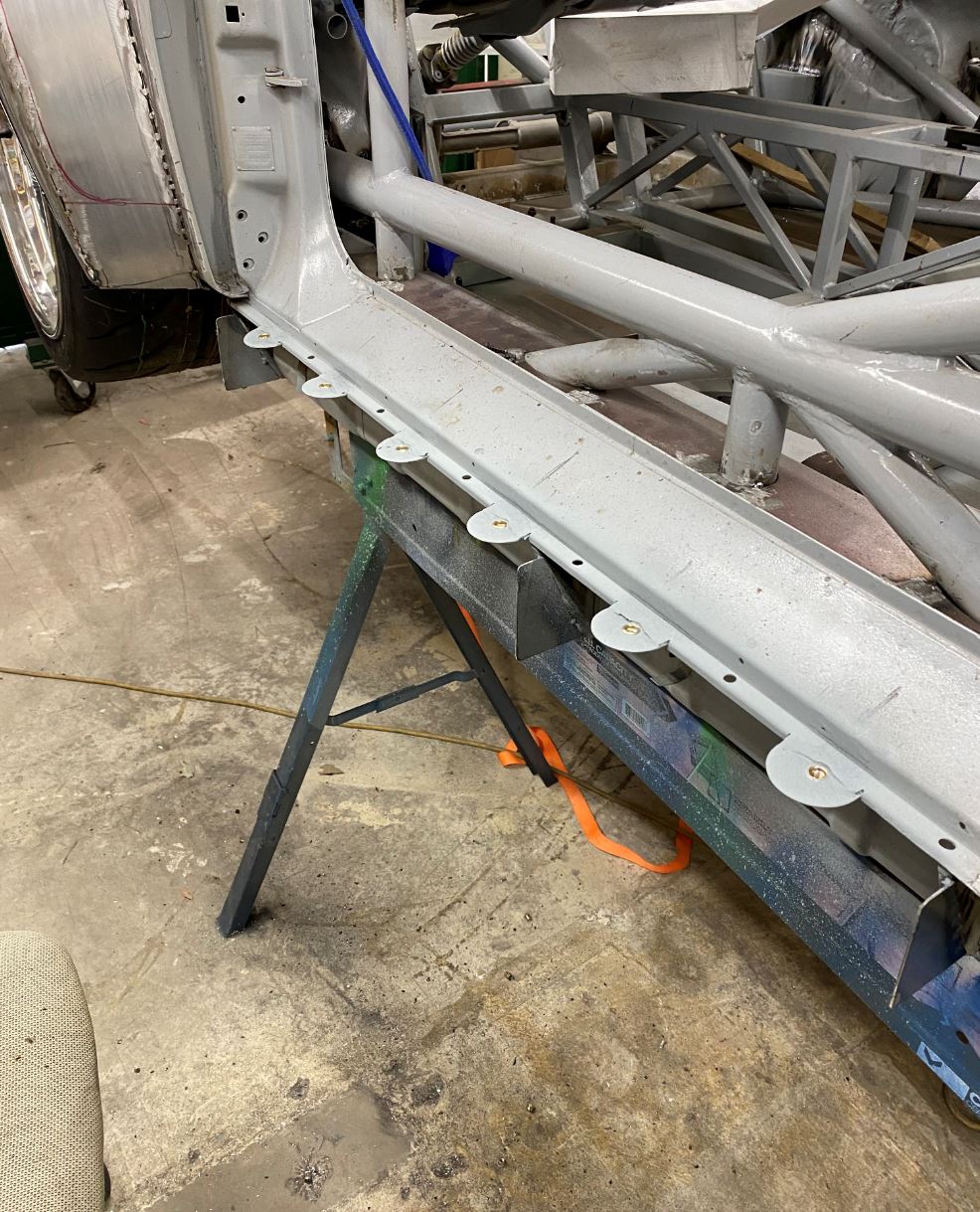

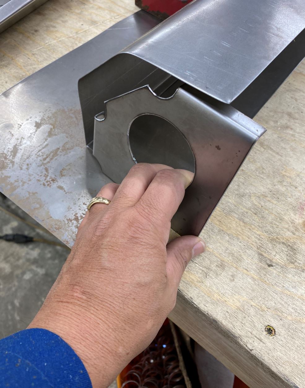

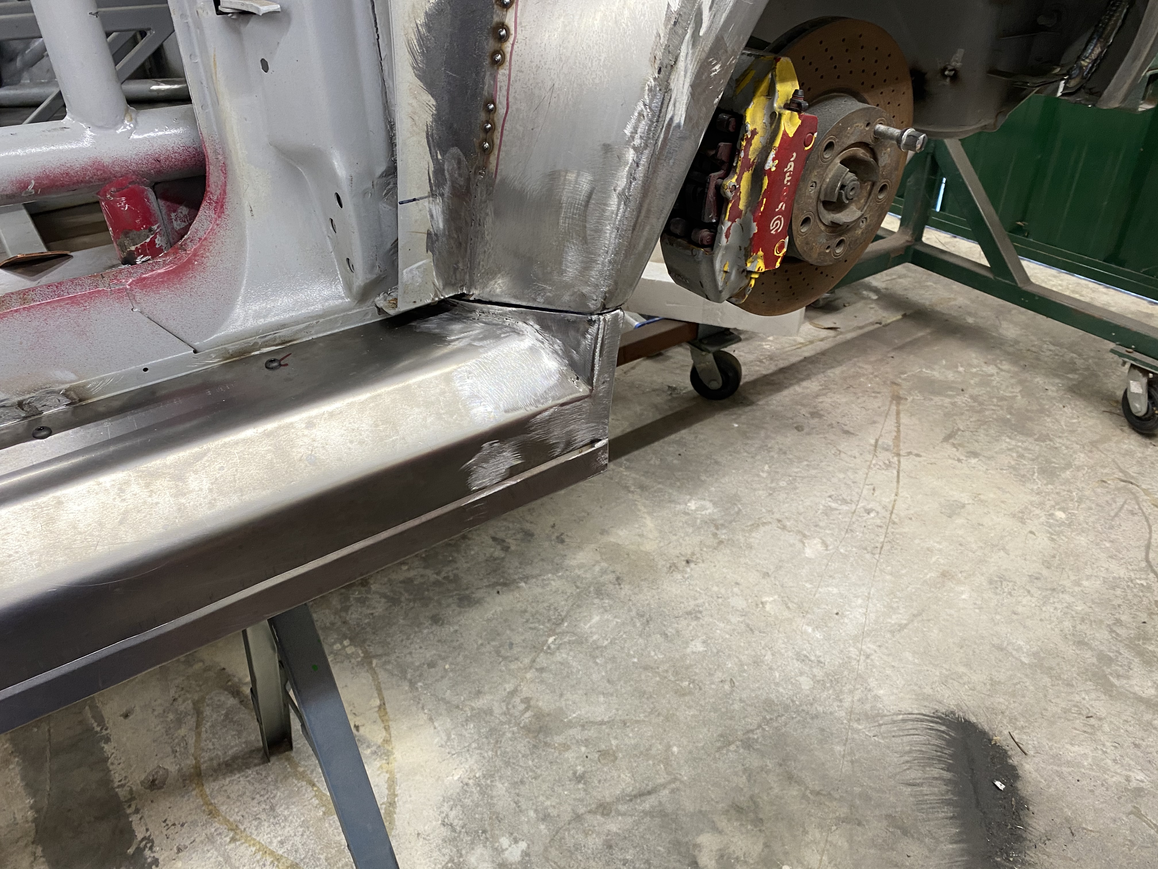

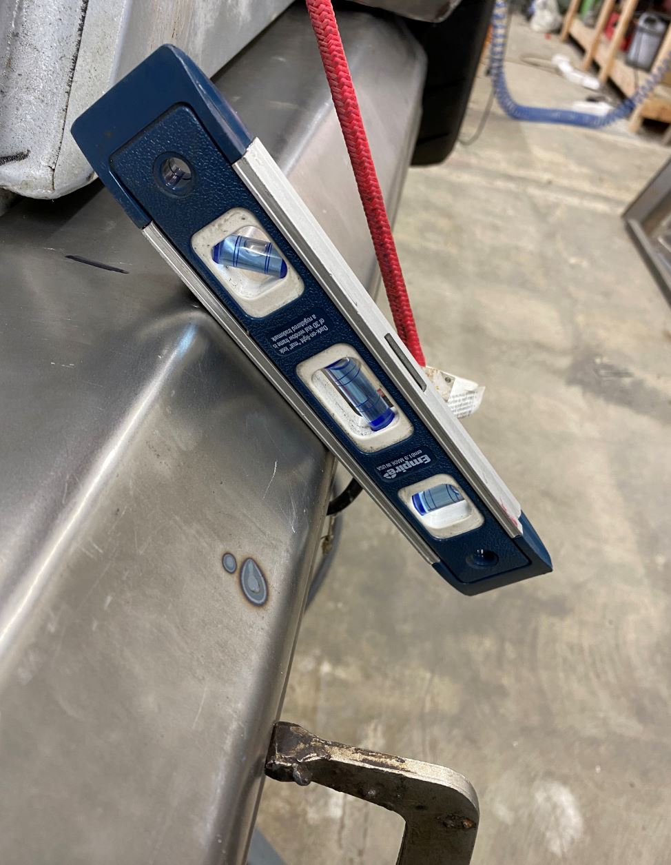

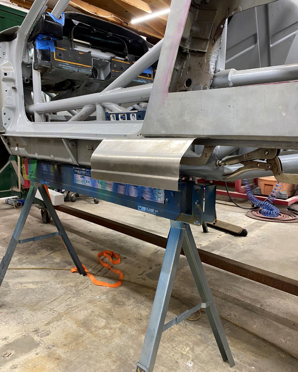

More update on the rocker panels. I just need to finish the ends.....that's easy. The hard part was getting these things to mount sturdily on the car and make them removable and allow conduits to pass through. I designed to give me flexibility to run whatever conduits I want in the rockers or the longs. (IMG:style_emoticons/default/biggrin.gif) (IMG:style_emoticons/default/biggrin.gif)
Attached Image Attached Image Attached Image Attached Image Attached Image Attached Image Attached Image Attached Image Attached Image Attached Image Attached Image Attached Image

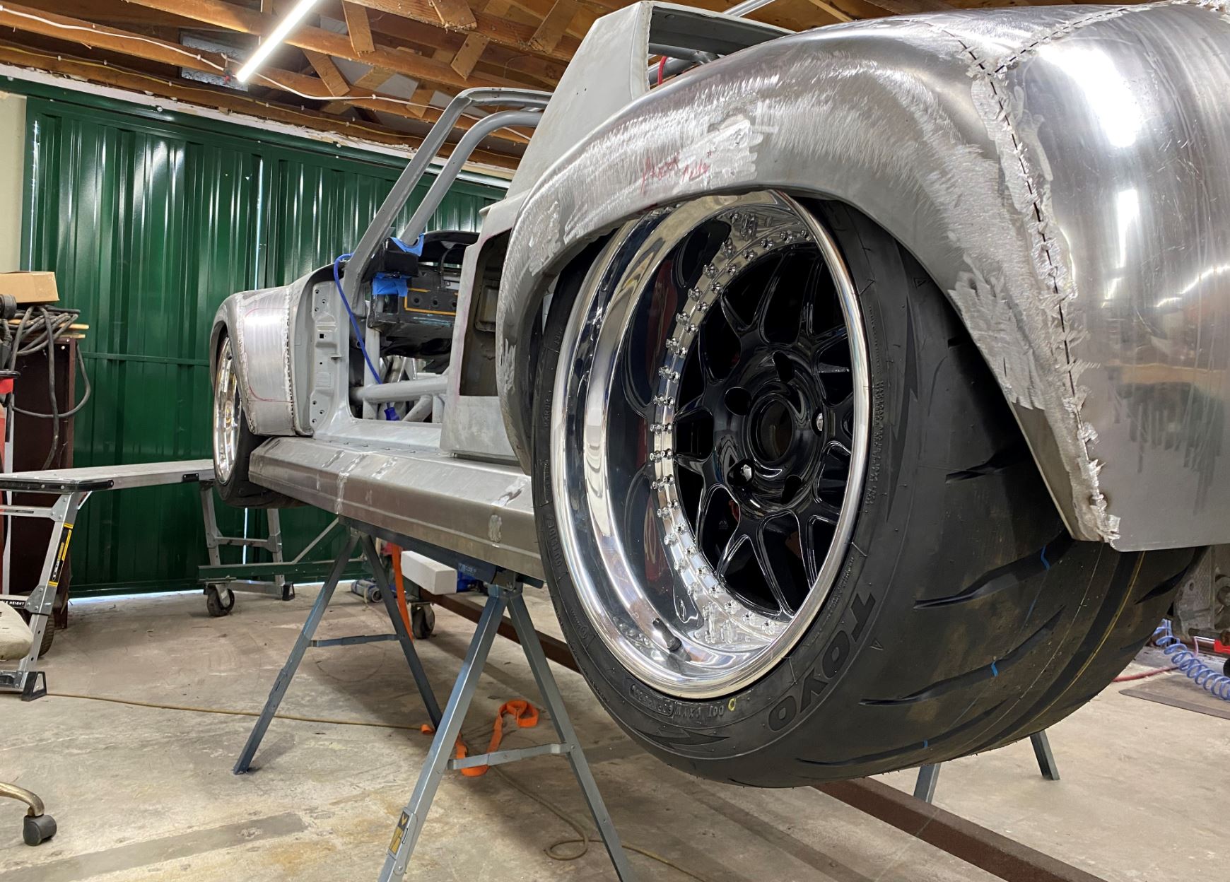

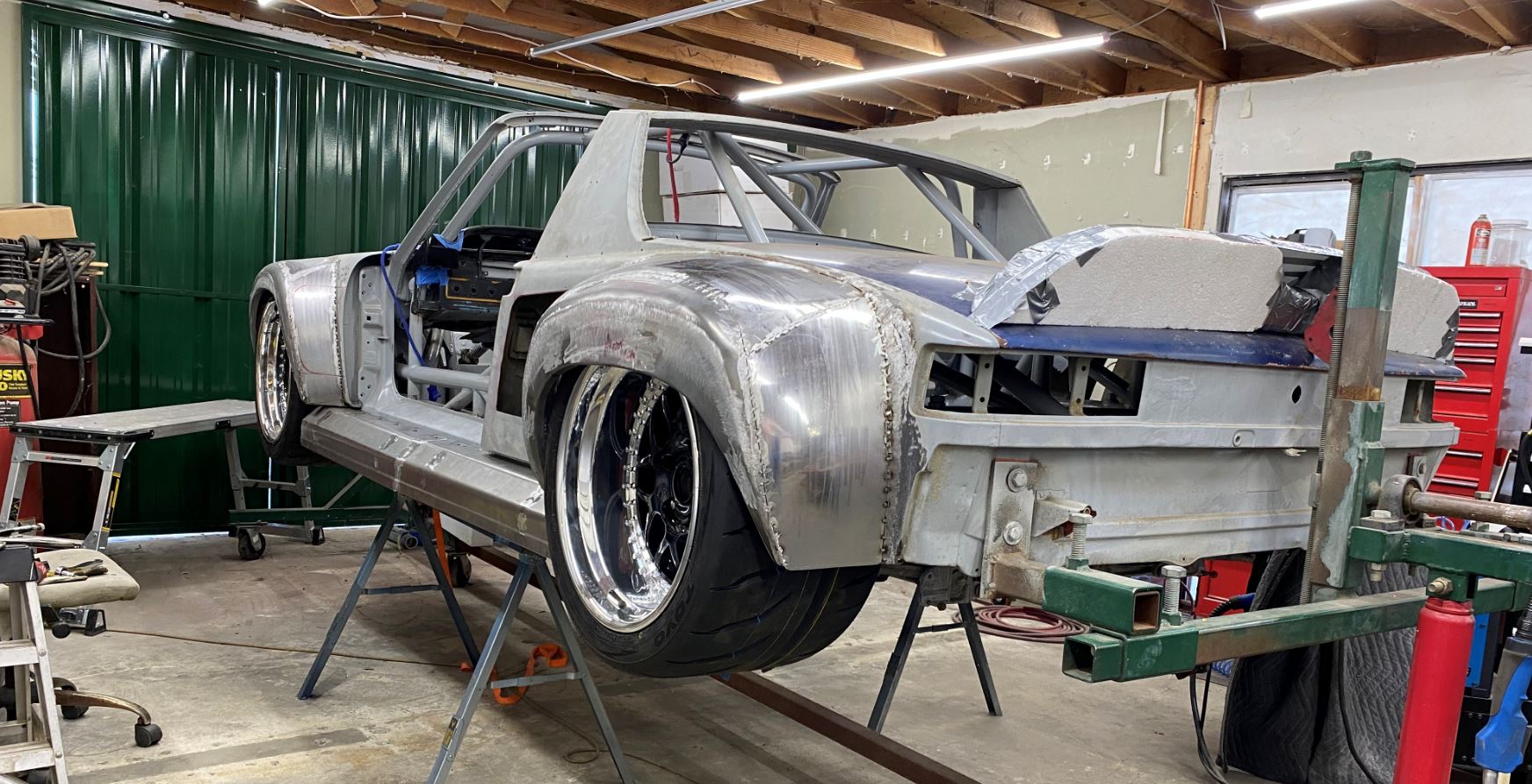

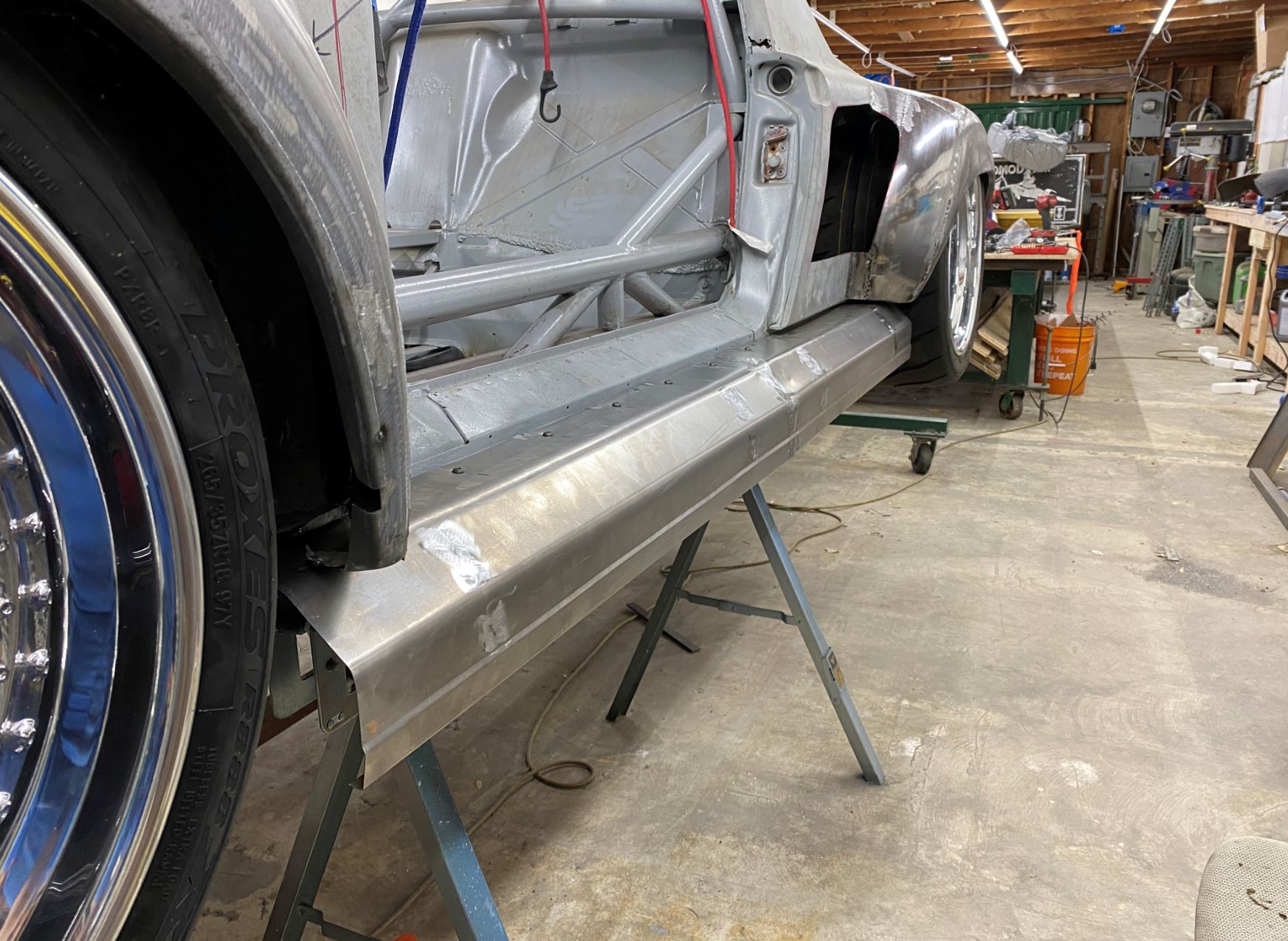

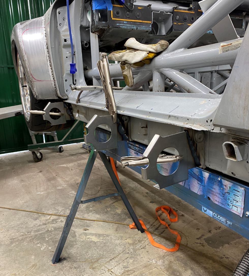

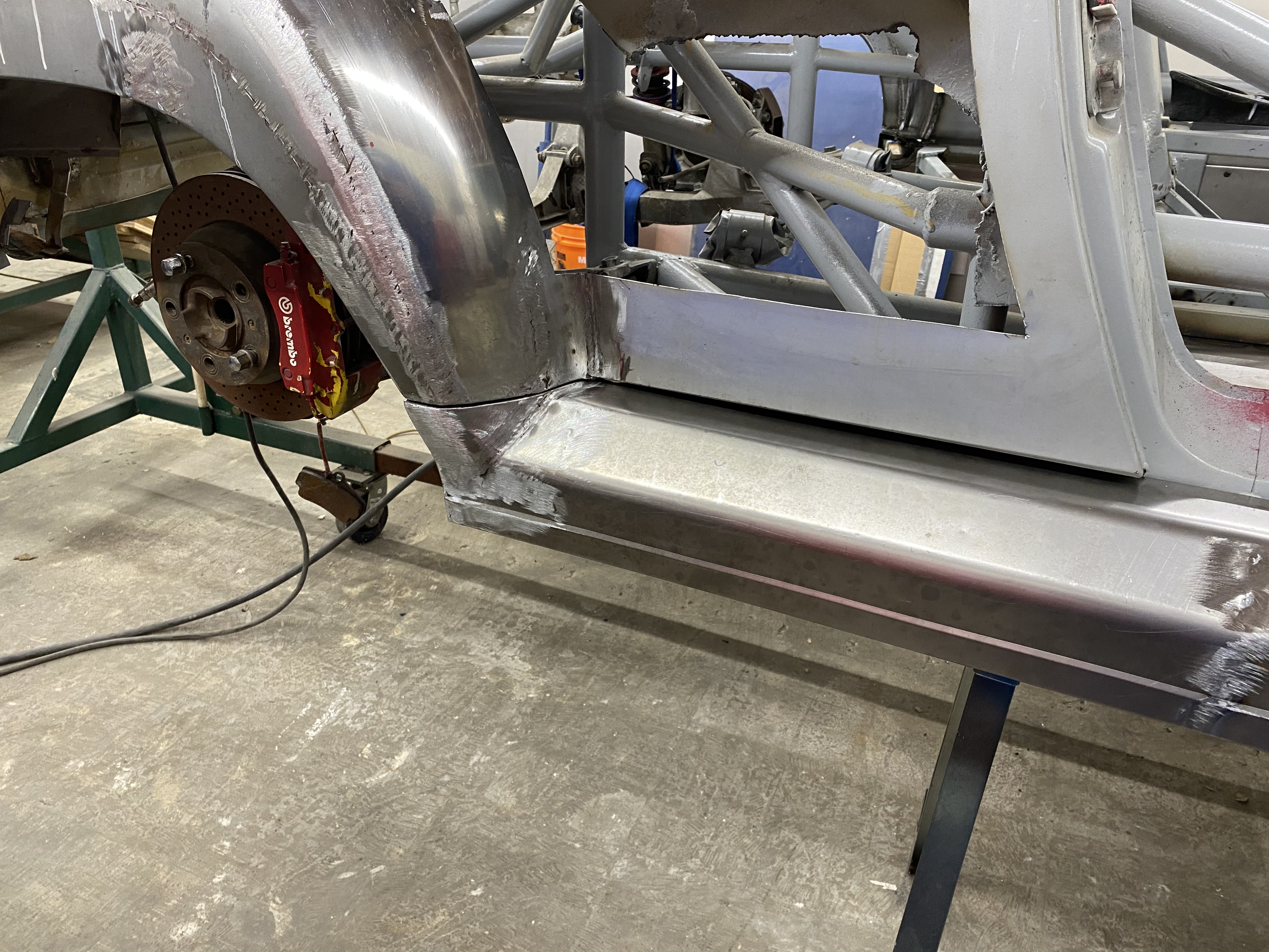

Side skirt metal work is done. Took 15 Riv nuts to install each side. Next is finish welding the fenders then on to the rear hood and metal duck spoiler. Attached Image

QUOTE(Curbandgutter @ Mar 20 2021, 08:32 PM) *
I don't think those tyres are wide enough (IMG:style_emoticons/default/blink.gif)
