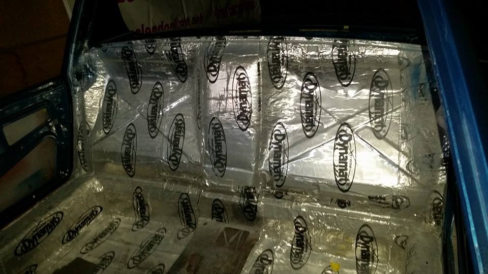

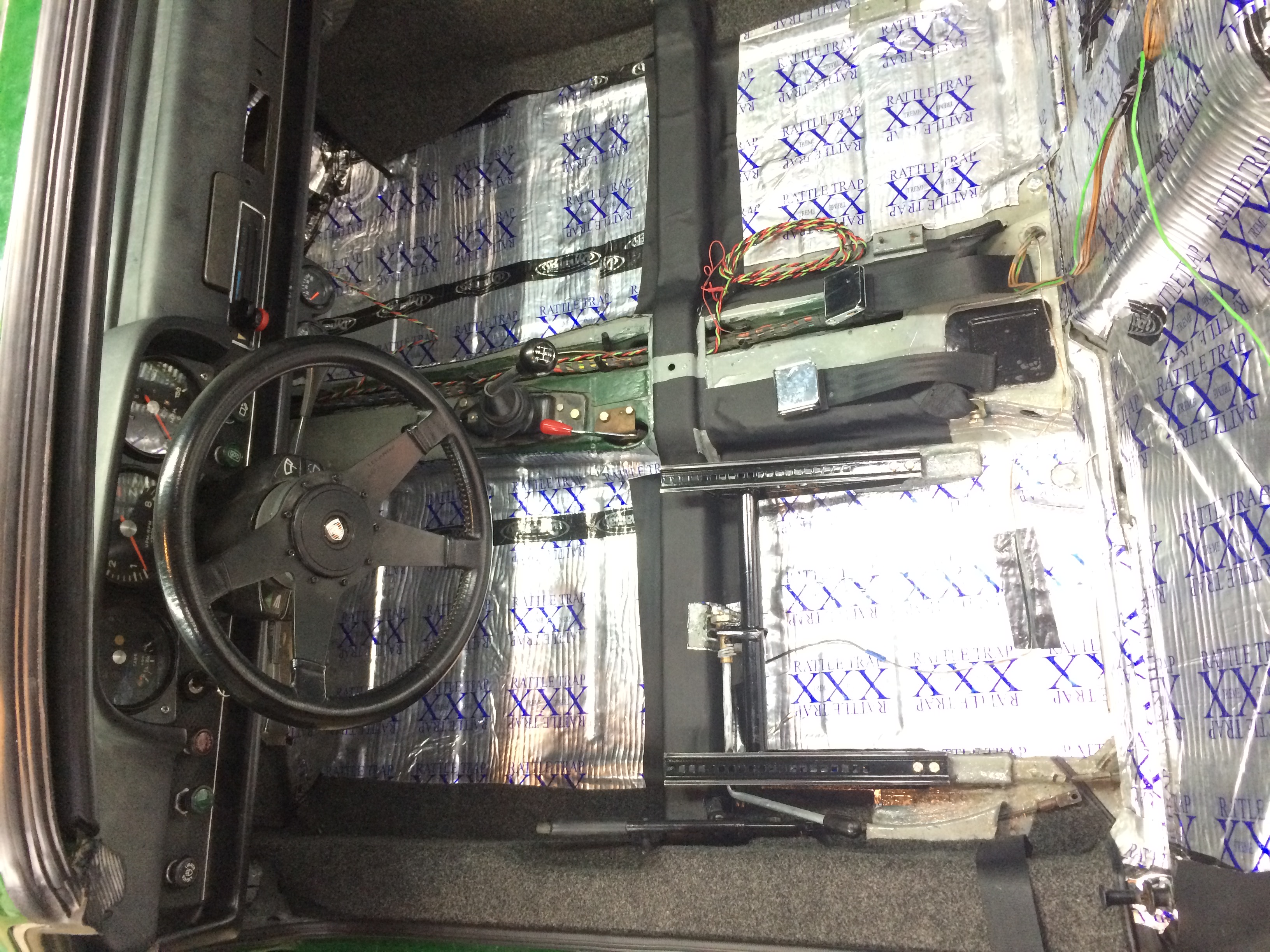

I have thought about the sound deadening foil-backed material for my Six. I believe I even sent a roll of it with the car when it went to Scotty's. We will be doing this as it keeps vibration and noise down inside and makes the car more comfortable to drive.
To be honest, I can't ever see my car sitting outside in the rain either. I think we would likely do the sound deadening material as siverson has done on his car. I know the school of thought regarding trapped moisture, but my car is not going to be a daily winter driver. How real is the threat of trapped moisture given those parameters?

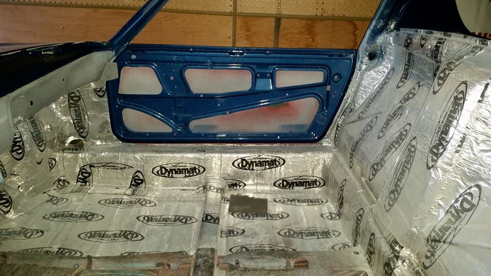

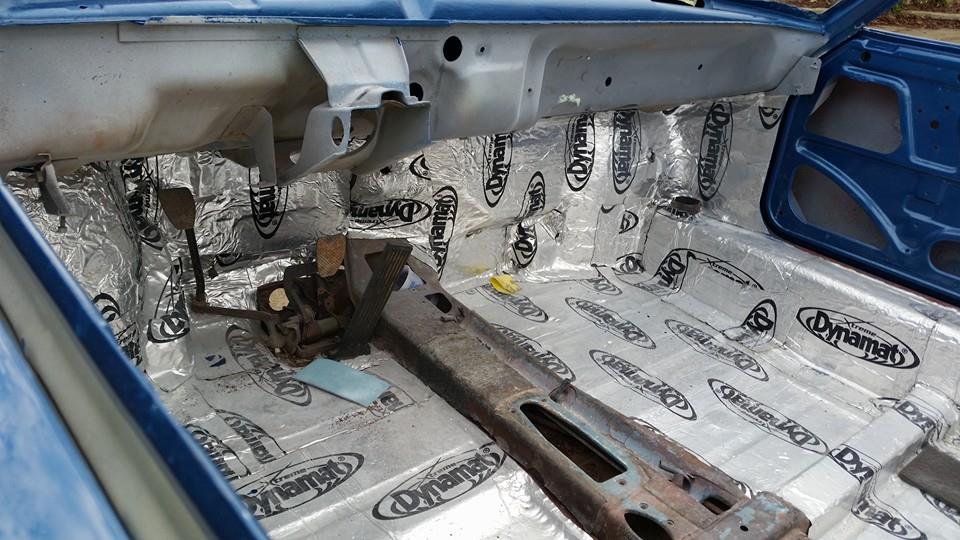

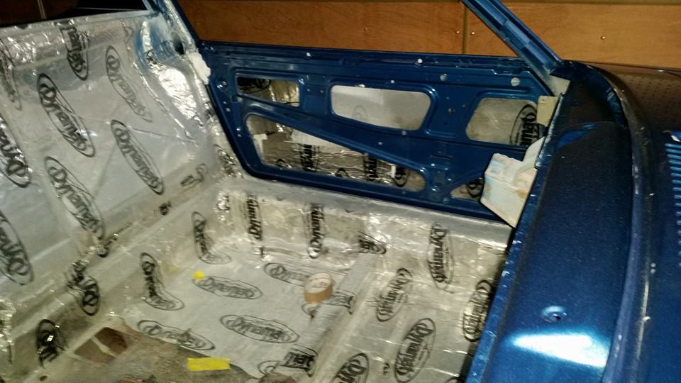

I did cut all edges/bends so there are no air pockets.
I think it is much better material than the factory tar, and provided you keep water out, even floors with the factory tar don't look that bad after 40 years.
So, I'm obviously betting it will be ok - only install flat sheets (when in doubt cut it out) and keep the water out of the car.

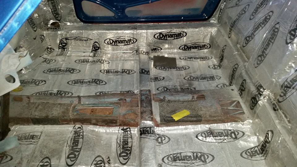

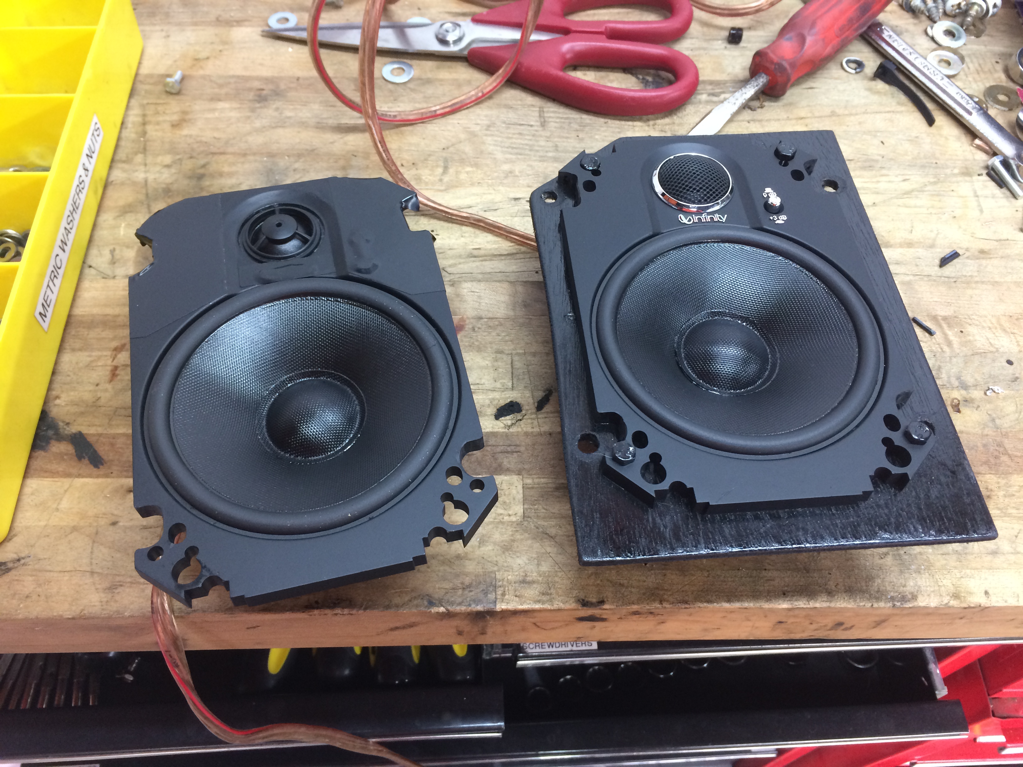

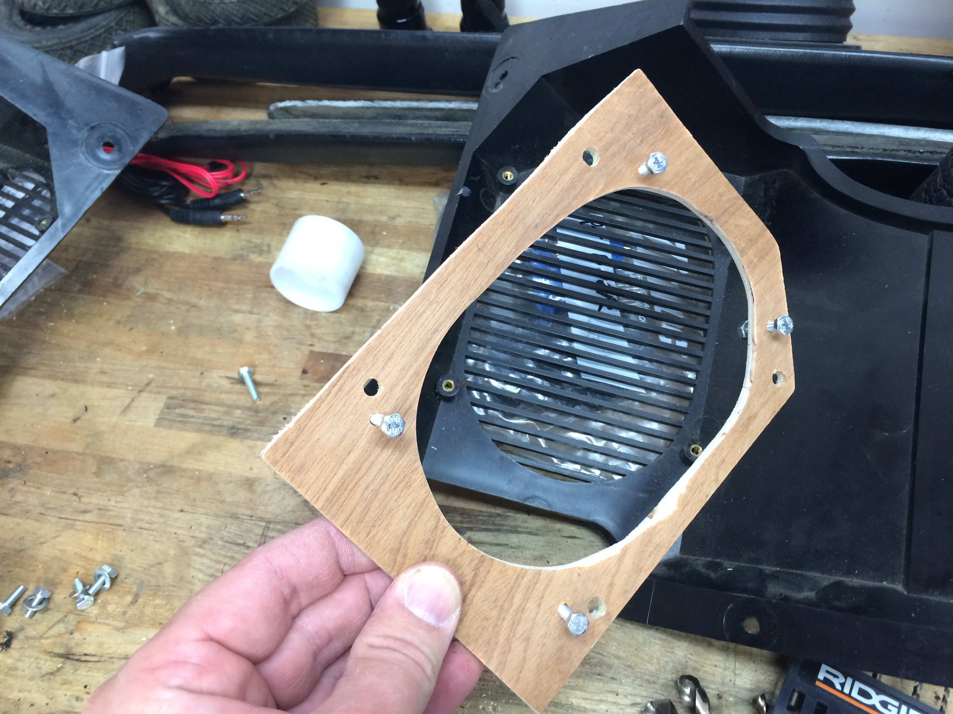

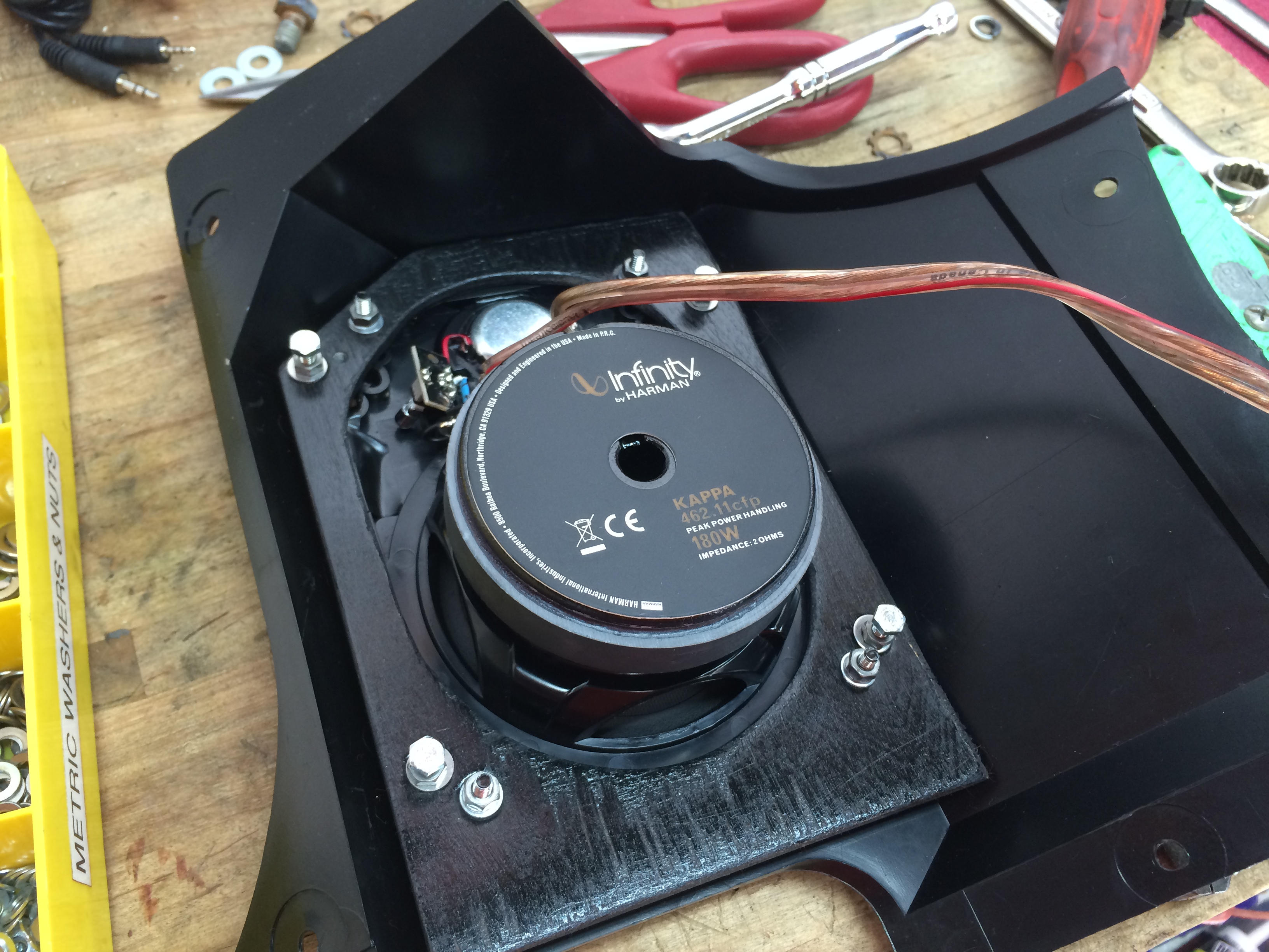

I got a lot more done on the car this weekend.
- Finished the sound deadening.
- Hacked together 6 black vinyl strips to sit below the carpet.
- Took me three attempts at building a speaker mount to get one that would fit. It's tight in there!
- Cleaned up the brake handle and seat rails.
- Starting installing the carpet.
- Installed the back pad and seats again and took him on a short drive.

Blacked out the shiny stuff.
-Steve

How it mounts.

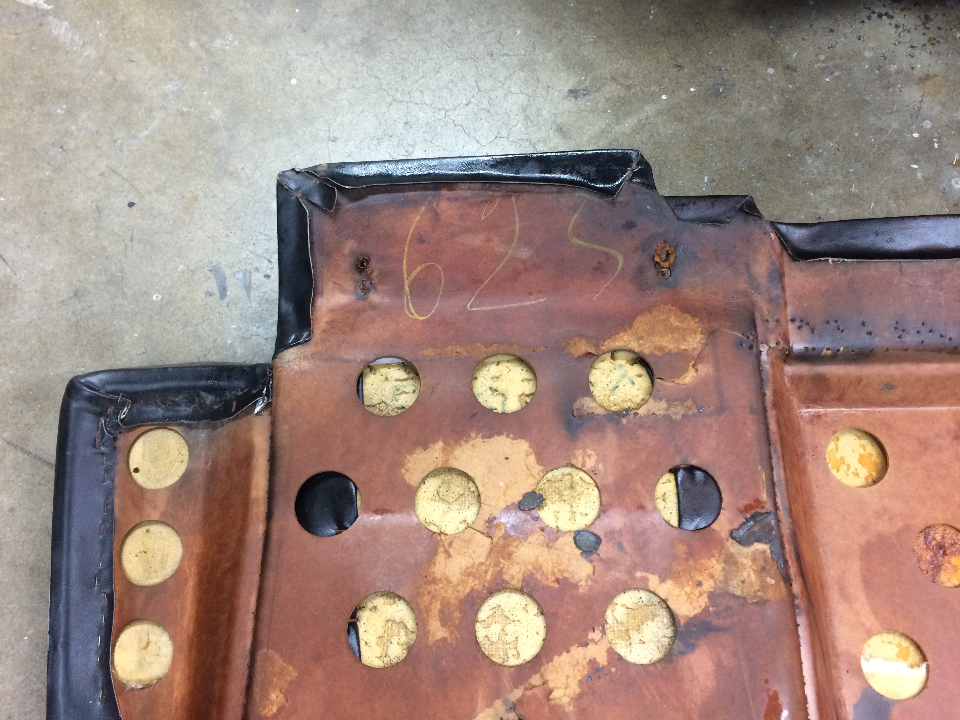

62S written on the back pad... ?

Terrific. Looks like 625 to my untrained eyes.

What's the chassis number again? Might have something to do with that. Might not...

#377 (9140430377)

QUOTE(Cairo94507 @ Dec 22 2014, 10:48 PM) *

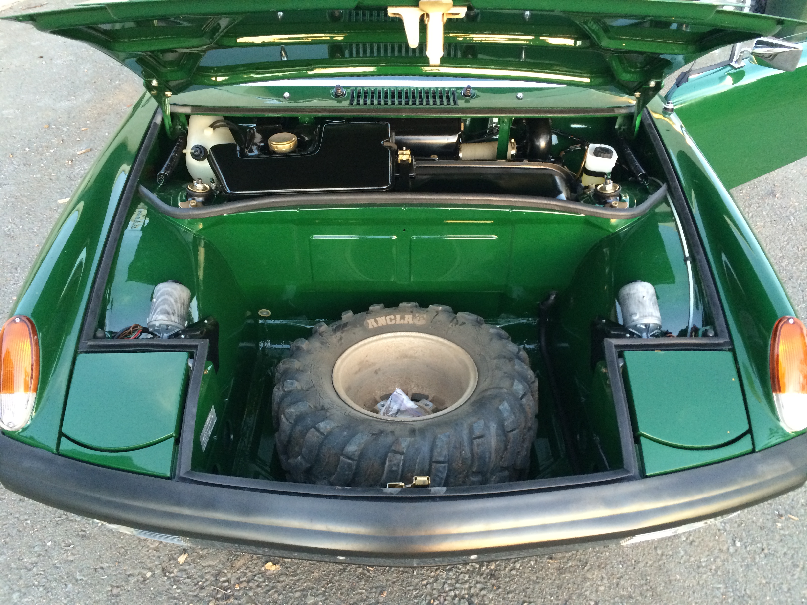

Now that my front trunk is pretty and super clean, might as well put it to work hauling some flat tires. Doh...
-Steve
siverson
post Dec 28 2014, 11:05 PM
Post #233
Posts: 2,458
Joined: 5-May 03
From: San Diego, CA
Member No.: 654
BTW - that is an OEM front trunk seal that replaced the super garbage repro seal. It is MUCH better.
