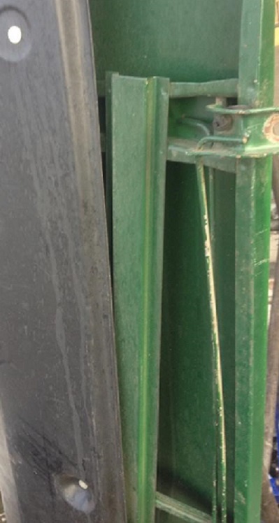

QUOTE(siverson @ Sep 9 2014, 01:36 PM) *
Is this right? I don't think I've had a car with this part before, I don't exactly remember what it looked like when I took it off.
-Steve
The torsion bars holding the engine lid up should be black not body color (IMG:style_emoticons/default/popcorn[1].gif) (IMG:style_emoticons/default/popcorn[1].gif)
Really? Are all 914s that way or just the sixes? I've never really noticed before, but I think my orange car (1974 914-4) has orange bars there too.
You have any photos to share?
But the rear trunk torsion bars are body color, right?
I guess I'll add that to my list of crimes against humanity I've committed. I suppose at some point we are all some future owners DPO. Someone, sometime in the future is going to open that engine lid and start swearing about some hack (me) couldn't take the time to paint the torsion bars the right color. (IMG:style_emoticons/default/smile.gif)

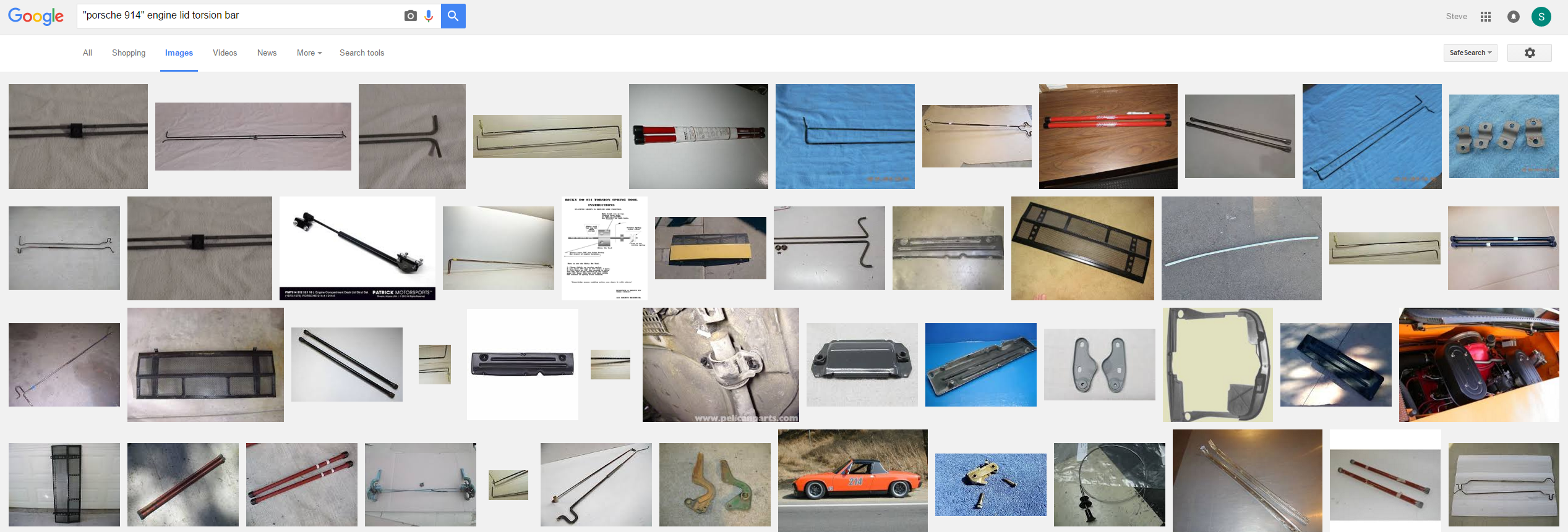

Weird. Not sure why I never thought of that. They do all appear to be black.
EDIT/UPDATE: this does appear just to be bars for -4 lids.
-Steve

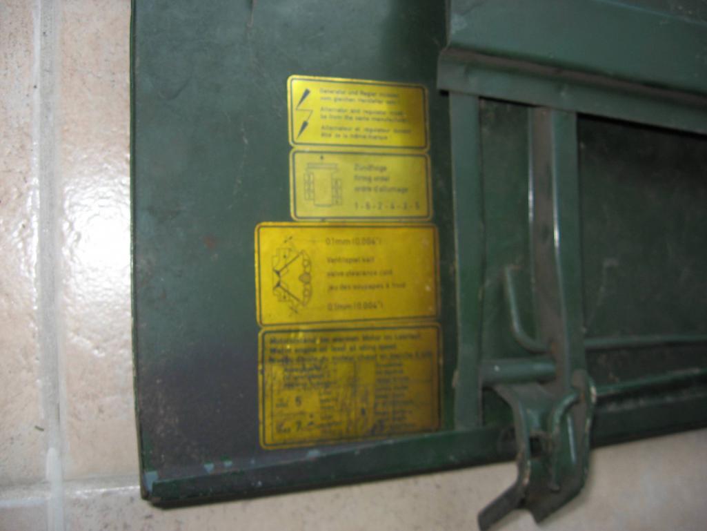

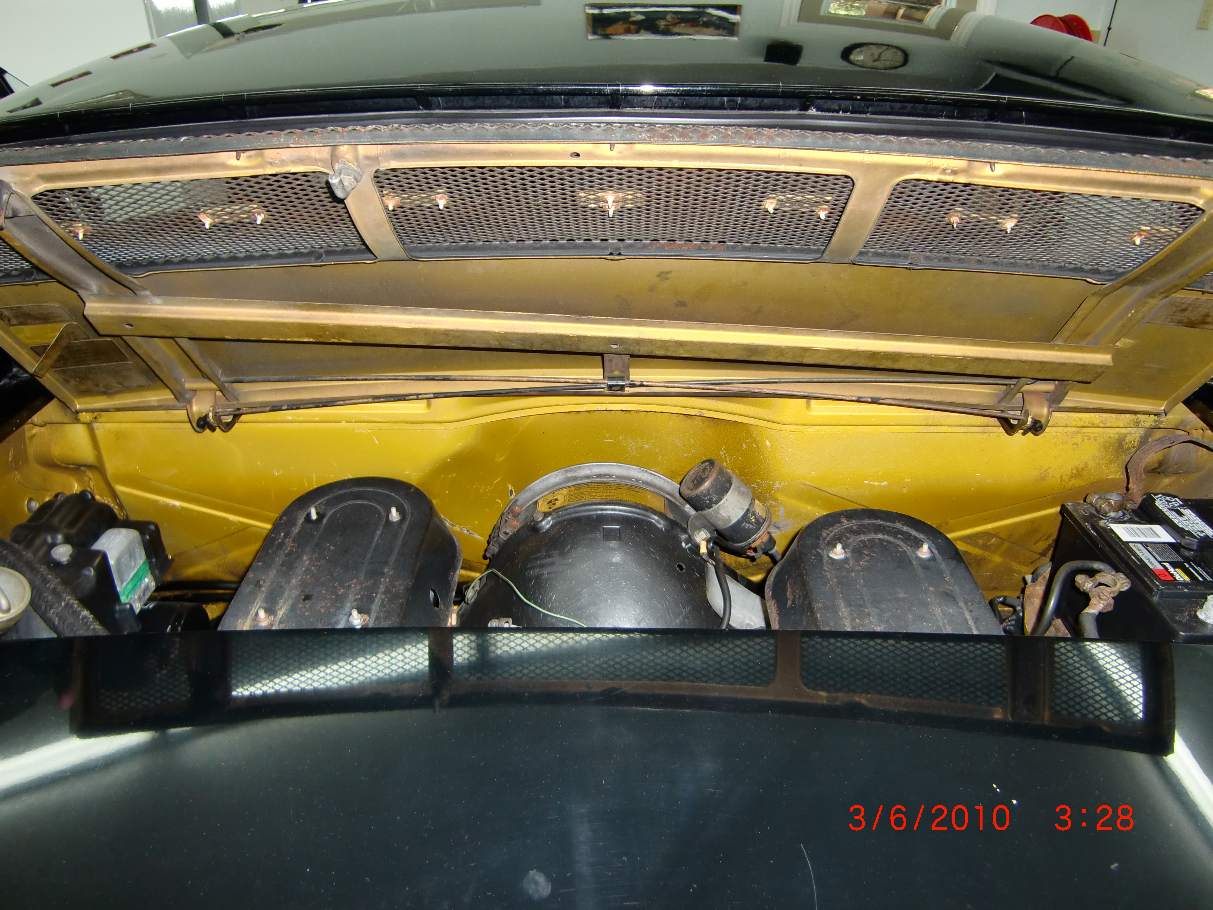

Sixes were body color....well all of mine are.. not repainted..
picture is rgalla9146

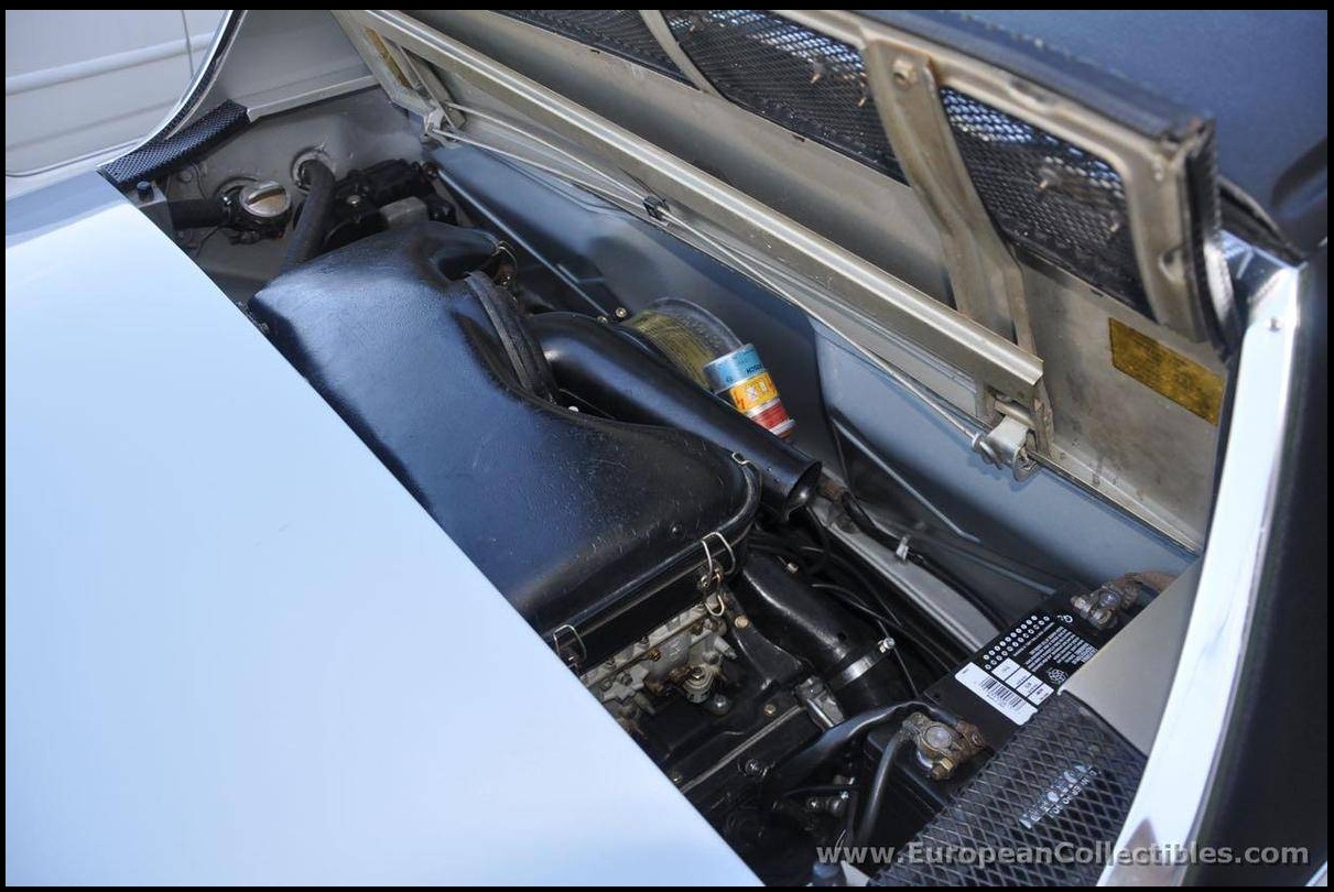

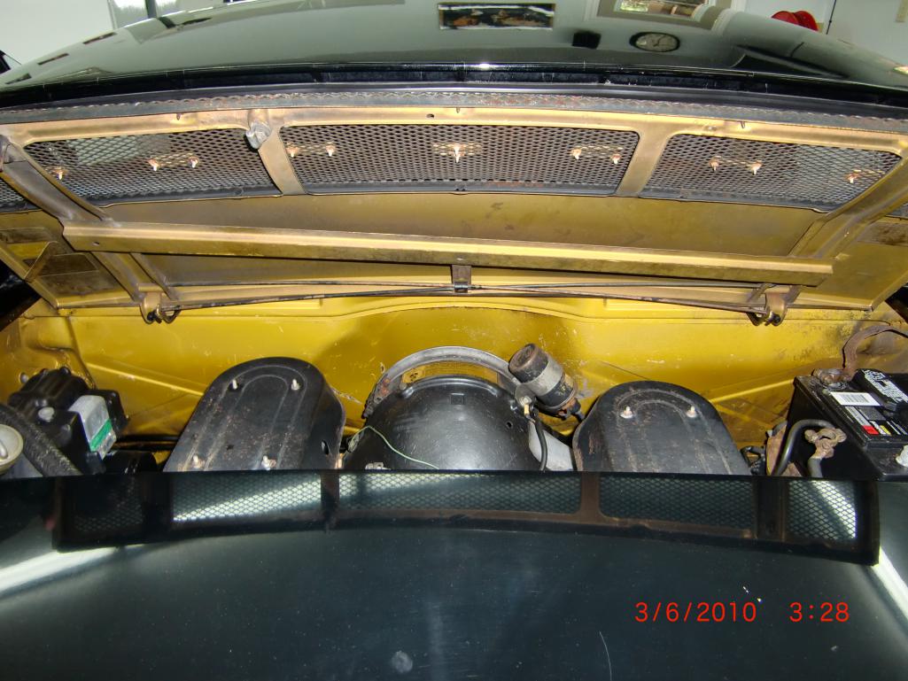

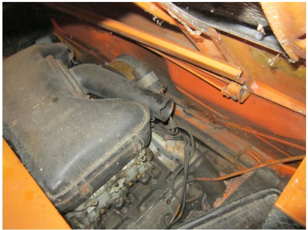

Hmmm... another quick search for just 914-6 engine lids does look they should be body color.
The silver photo is from a nice restored six, the orange one is from an unrestored supposedly never repainted original six.
-Steve

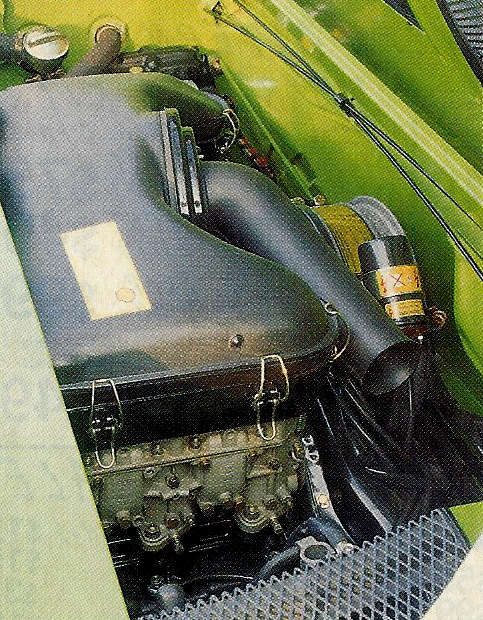

Very interesting.
Here is a photo scanned from a 1993 European Car magazine of the 5,600 mile willow green 914-6.

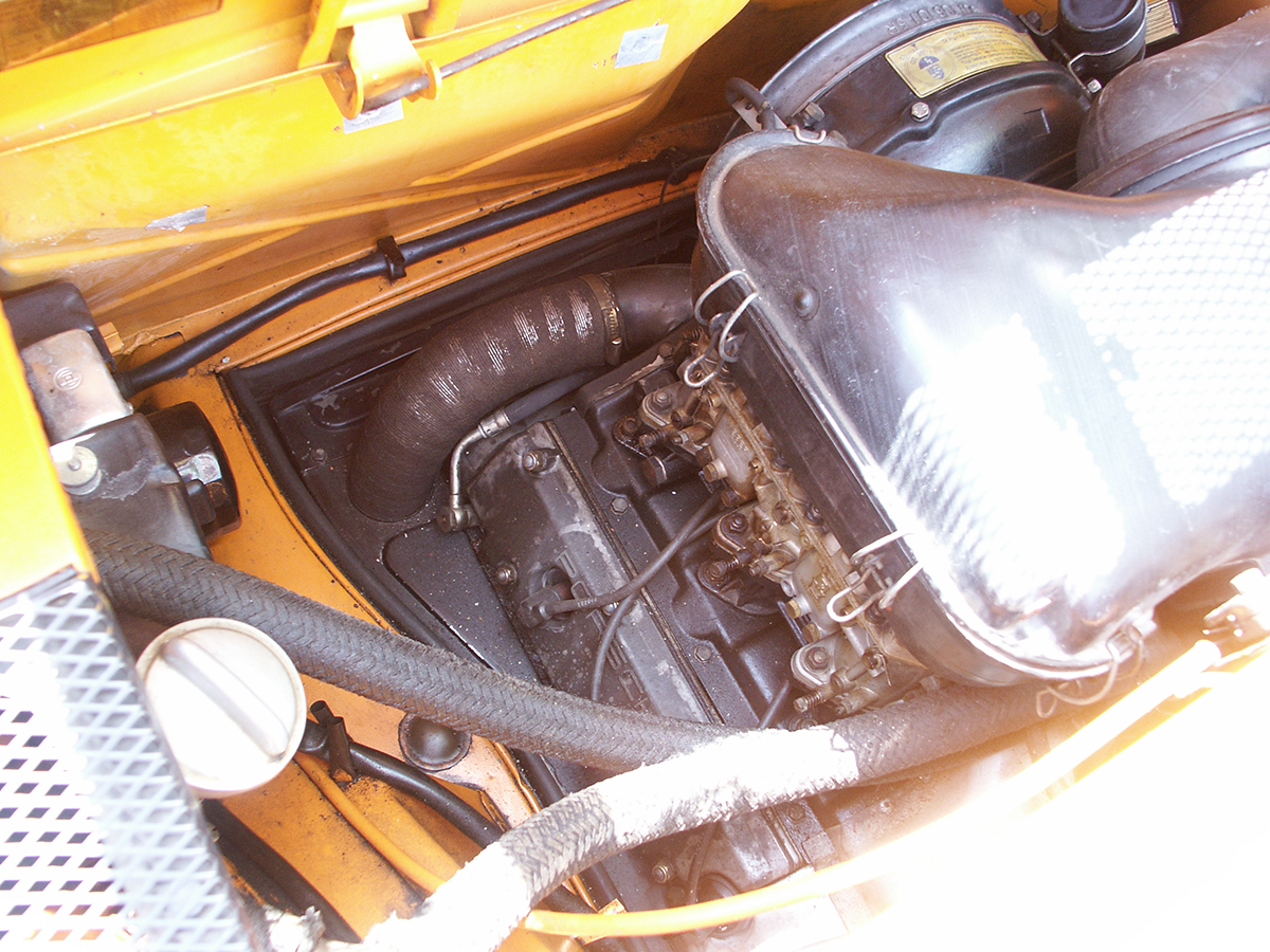

I went through some photos of sixes that I looked at purchasing in the past and found most were painted at some time body color during a repaint. Not sure what they were originally.
I did find one that was black, but not sure if they painted them black them selves.

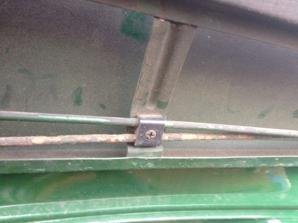

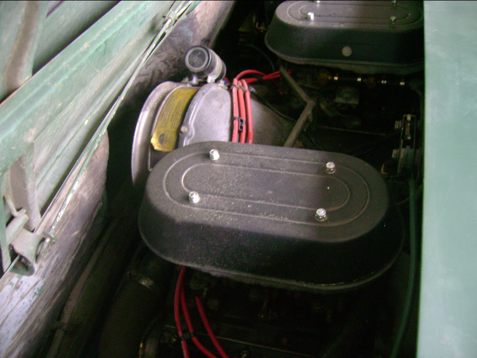

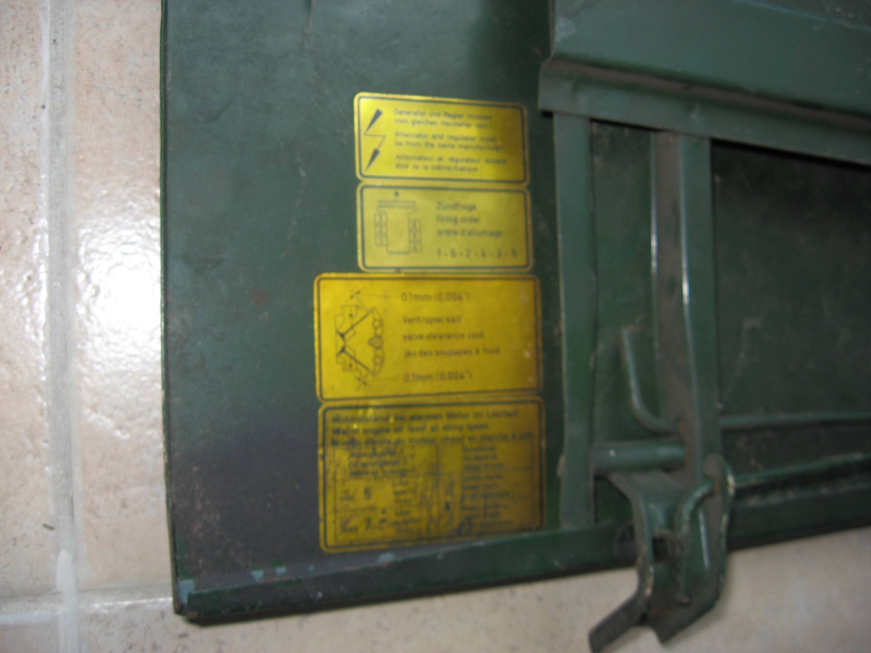

Here is 2 1970 4 banger engine lids and guess what the torsion springs are body color also...yes they are both Irish Green...I also measured the diameter of the spring and the -4 painted ones and the -6 painted ones are the same diameter.
I suspect when they changed the rain trey they needed a bit heftier spring..
So the myth of -6 having lighter torsion springs is almost correct , except that all the early 914's have lighter torsion springs...solved (IMG:style_emoticons/default/beerchug.gif)
AA's willow green 914-6 is a 71 , I have seen another 71 -6 and 2 -4's that have black torsion springs... (IMG:style_emoticons/default/icon_bump.gif)

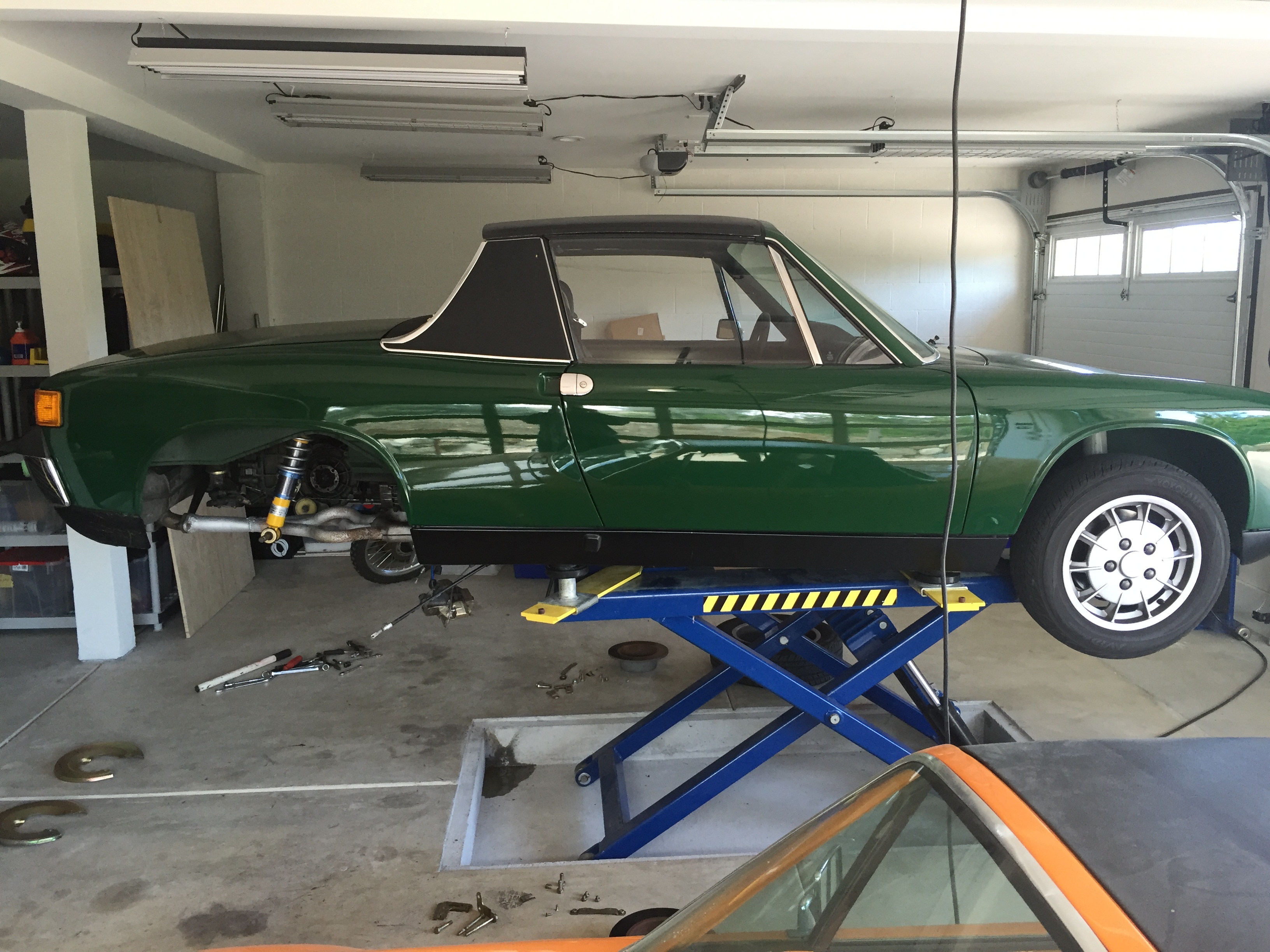

I brought the car into European Motorsports a couple weeks ago because I just couldn't get the carbs to work well. It was running "ok", but it seemed like throttle response was really poor, flat spots in the middle, etc. I'm not sure what happened because when the engine was first built (~5k miles ago) it was running really well.
Anyways, after two trips there (argh), two sets of new spark plugs, and increasing the venturis from 27mm to 30mm and jets from 105 to 120, it's a whole new car. Running much better and just rips all the way to 7k. Vrooom.
While it was there they thought both rear wheel bearings were noisy. I didn't really notice anything, but since I had the WCR trip to Oregon coming up, I didn't want to risk it and took it apart.
I'm glad I did, the passenger side was totally shot, so I just decided to replace both. I honestly can't think of any other wear component that I didn't replace during this entire rebuild and have been kicking myself for not replacing these while the car was apart. Good news is everything came apart pretty easily.
