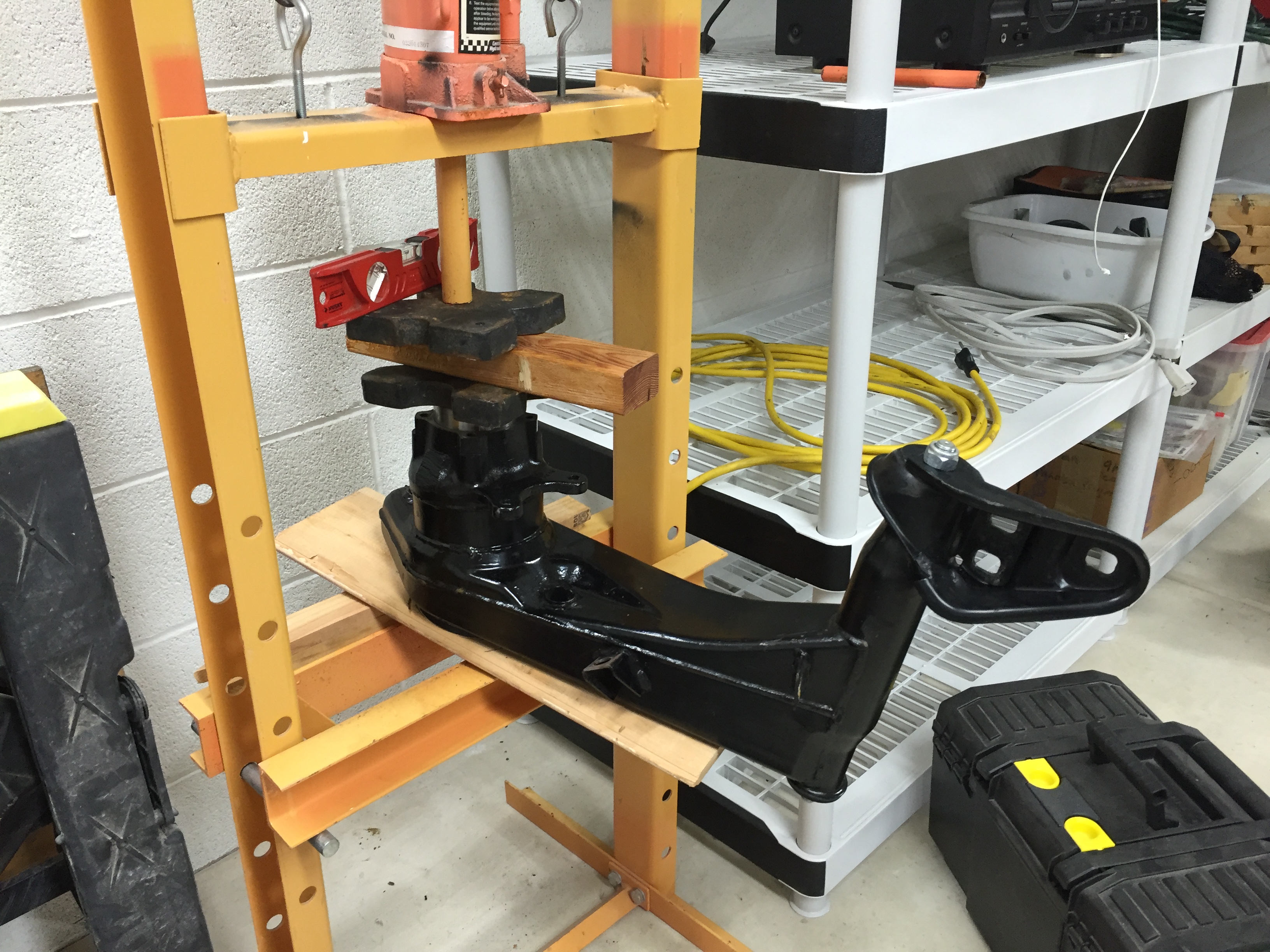

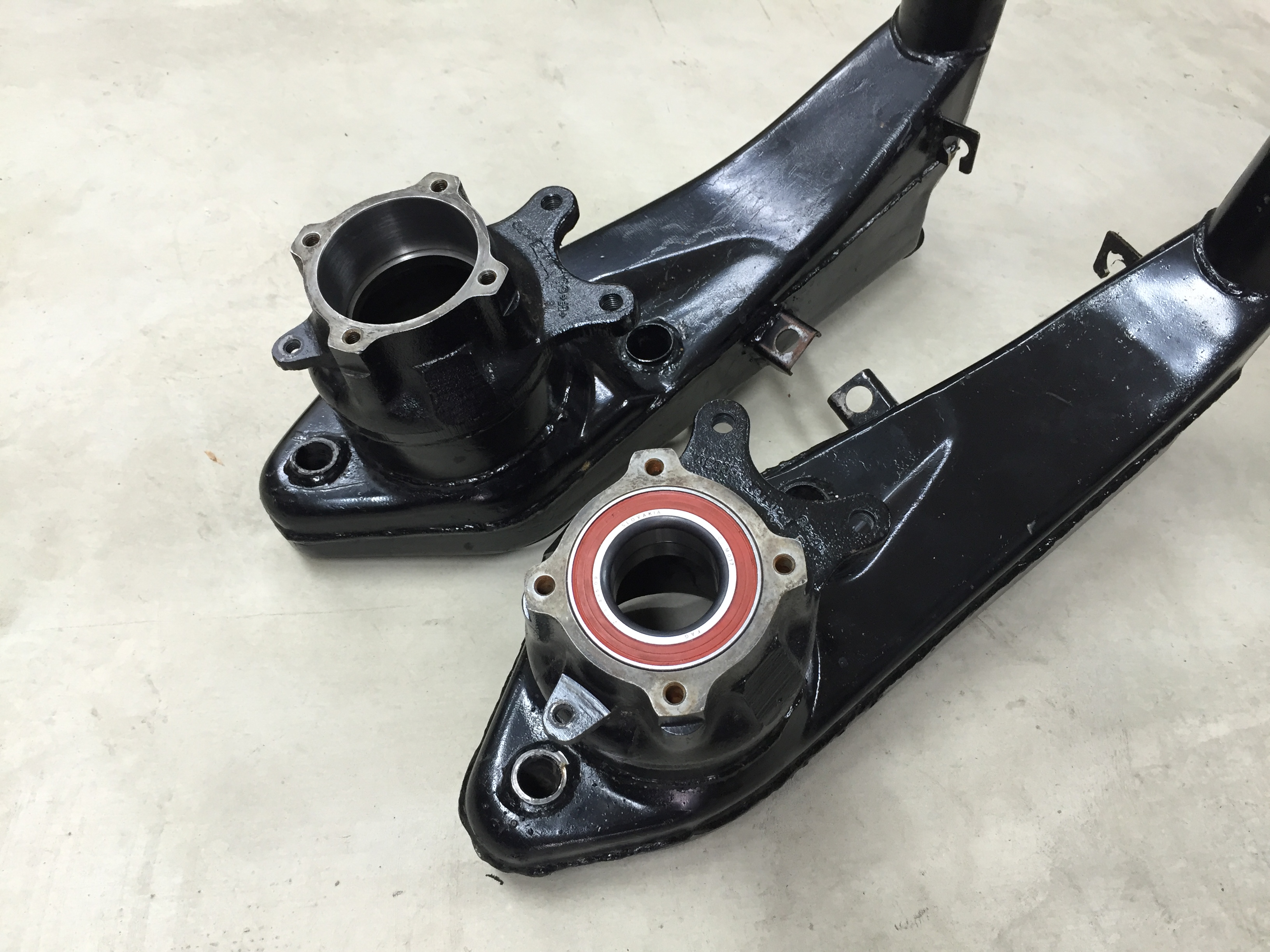

One bearing in...
siverson
post May 10 2016, 11:08 PM
Post #282
Posts: 2,464
Joined: 5-May 03
From: San Diego, CA
Member No.: 654

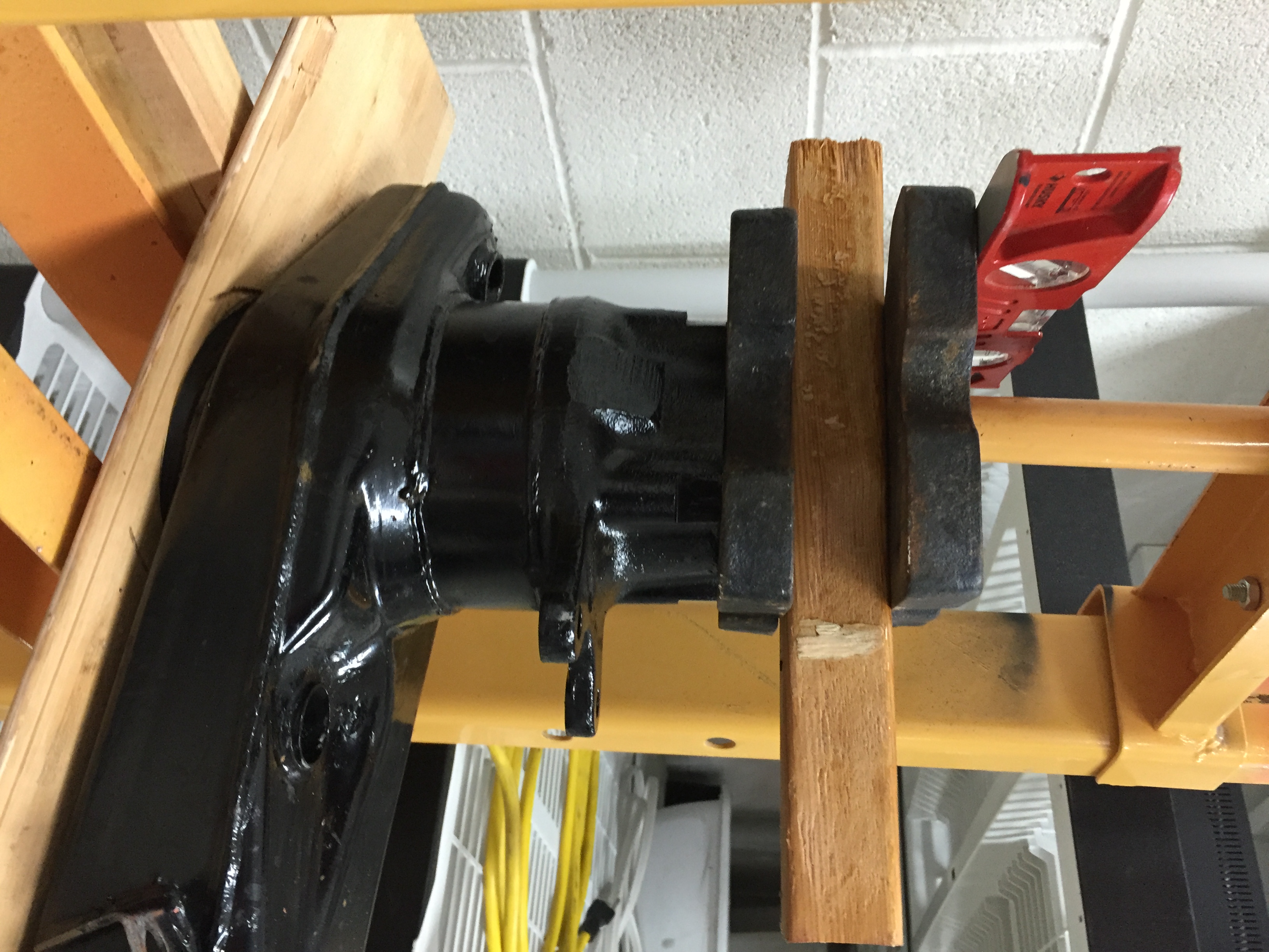

I know you're "supposed" to press the arm into the bearing (not the bearing into the arm), but I don't have any fancy bearing tools/jigs and could never really get that to work.
With a hacked together wooden control arm support though, the bearing still presses in pretty easily (IMO). Just start it with a rubber mallet, and then make sure you press everything in while the bearing is level (see red level on top).
-Steve

Smooosh.

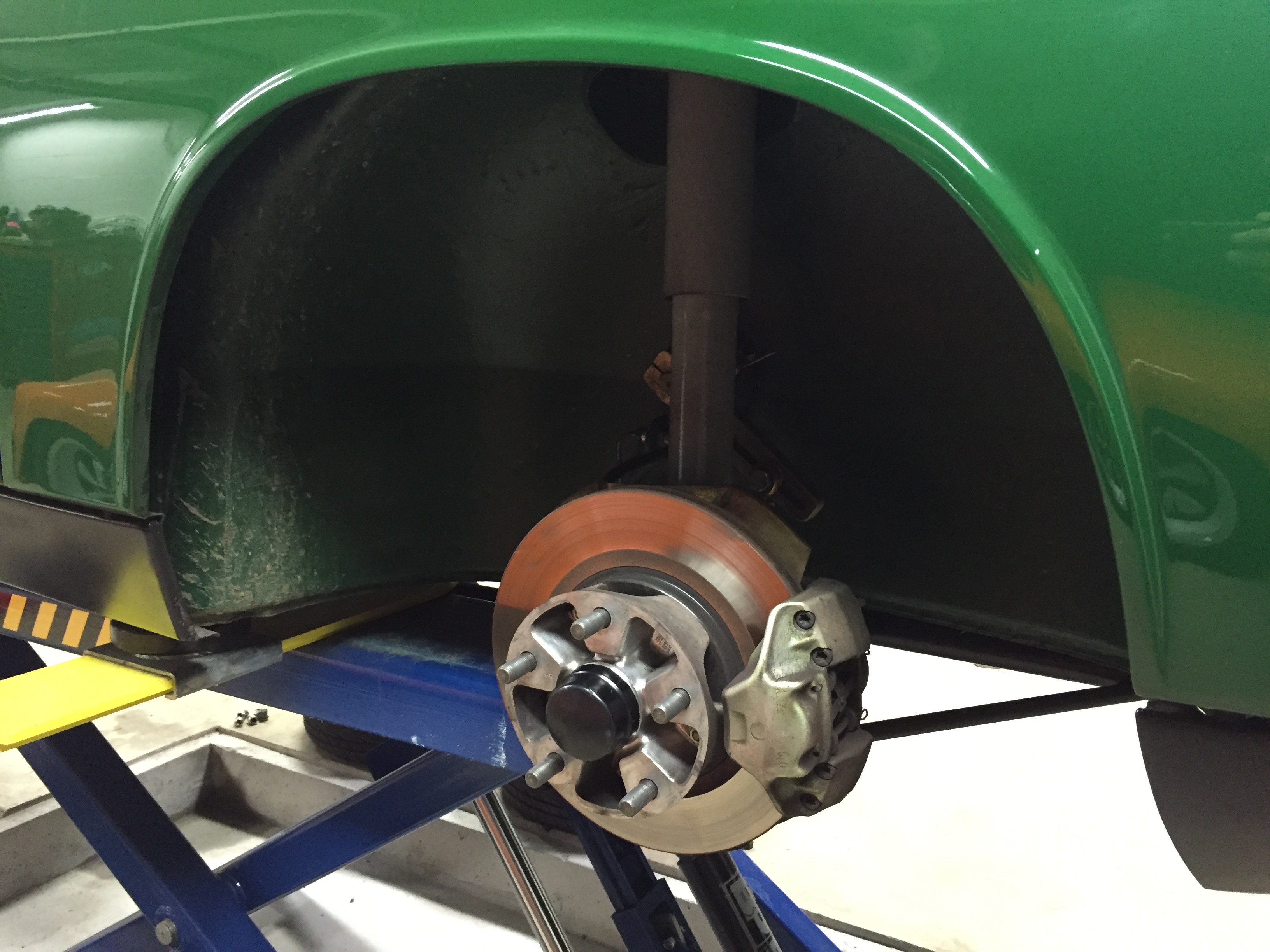

Front calipers really take a beating.

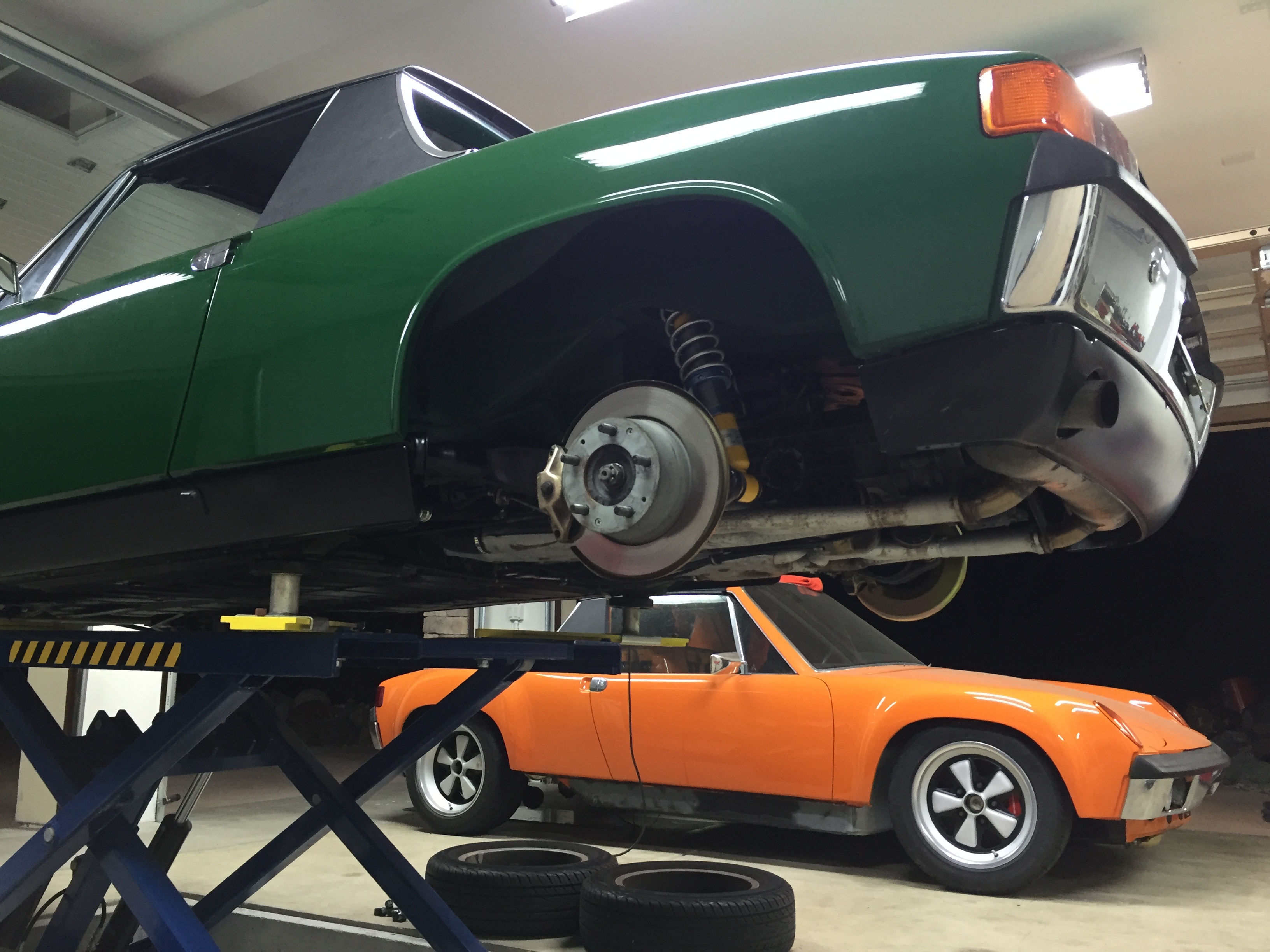

And an artsy shot with my super dusty and pissed off orange car wondering why he isn't being worked on. (IMG:style_emoticons/default/sad.gif) Sorry Orange 914...
-Steve

Love your recessed floor jack !
Spacious garage is to die for as well !

Love that car! (IMG:style_emoticons/default/wub.gif) Oh, so the orange Six does not feel left out, if I had another Six it would be flared and signal orange like my 1st Six was - color not flares.
I have to meet Steve one of these days because that is the same lift set-up that is going in my garage too. Maybe instead of being a twin I was a triplet and Steve was separated from us????

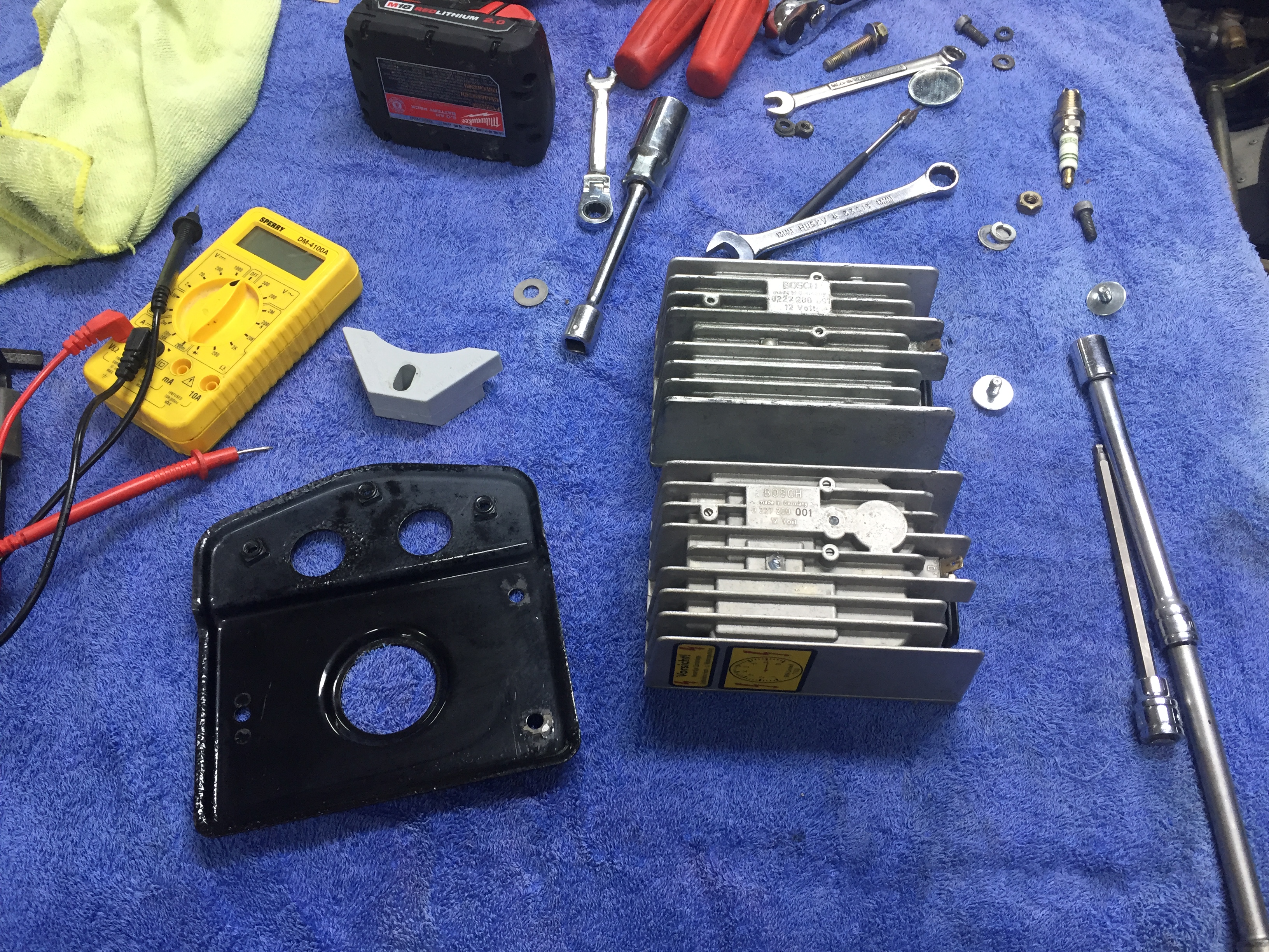

CDI box died on the way home from Oregon. (IMG:style_emoticons/default/sad.gif) That was less fun.
When it died, the CDI was still making a whining noise (it's supposed to), but it was a little different and louder. But given I had confirmed everything else seemed fine, I ordered a replacement and it worked. Vrooom.
PartsKlassik puts new electronics in the old box:
https://www.partsklassik.com/p-1508-cdi-box...d-rpm-7100.aspx
-Steve

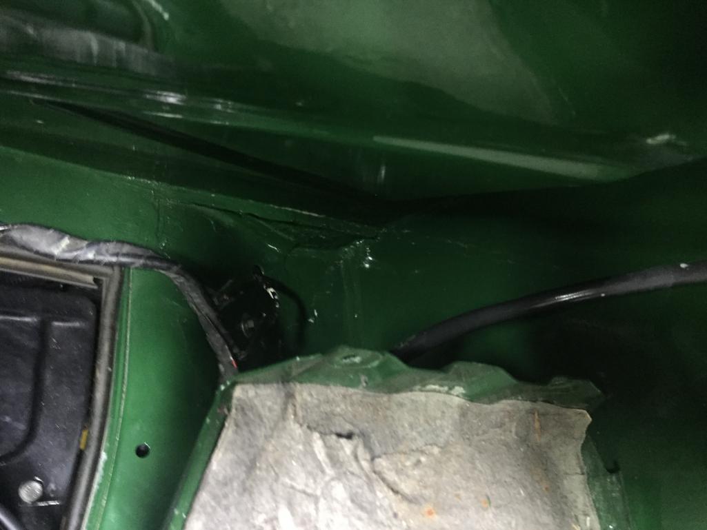

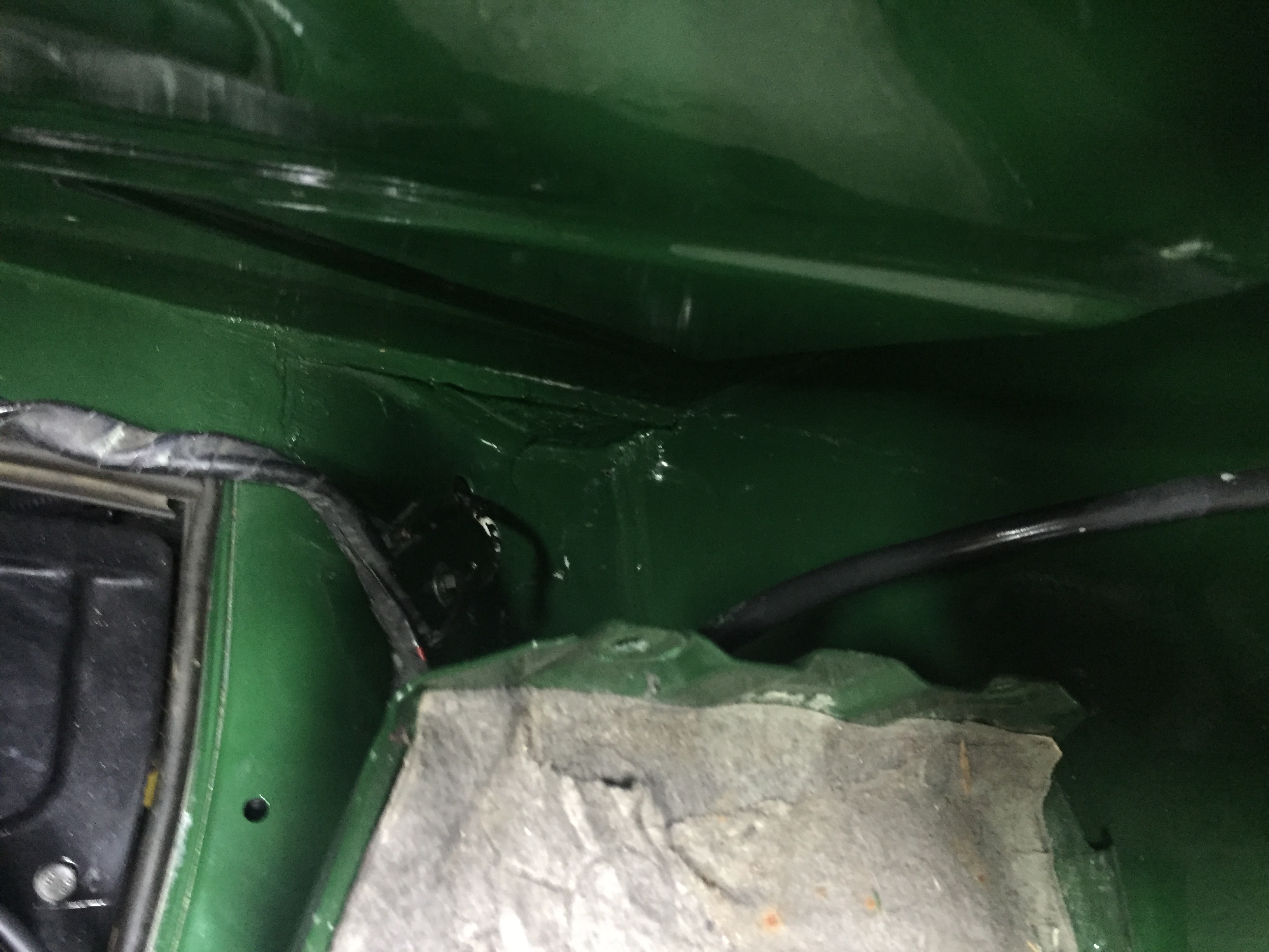

And it gave me a chance to clean out the hell hole. A leaf had fell down there!!!

Does the new cdi whine? I got a rblt cdi. Works great and all, but dead silent. I want my whine back! (IMG:style_emoticons/default/hissyfit.gif)

No, new CDI is dead silent. I honestly don't miss the whine.

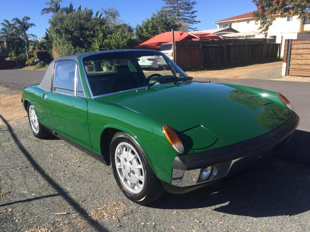

Washed green 914 yesterday...

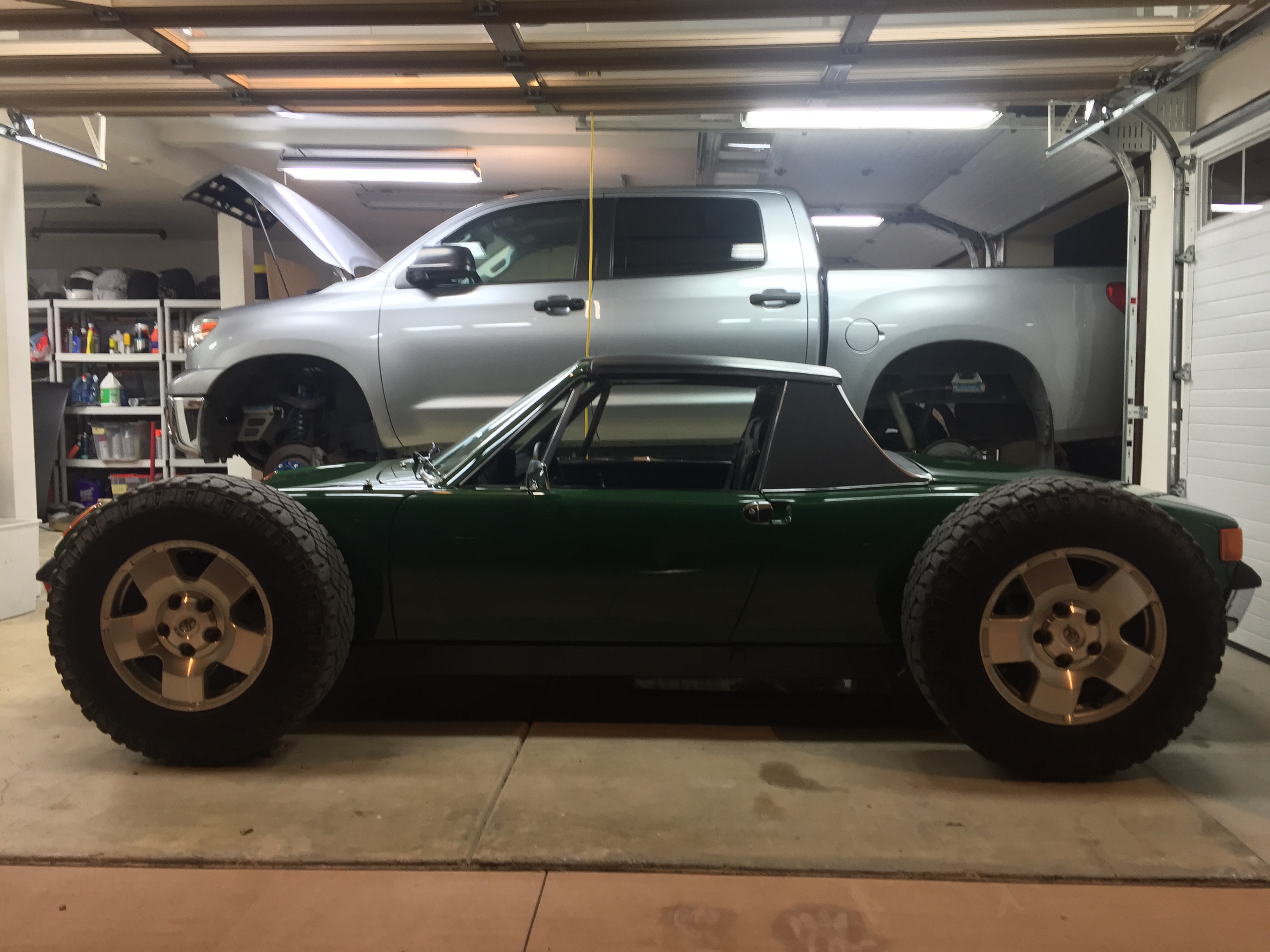

I thought about fitting some bigger tires... (Rally 914?)
siverson
post Dec 29 2016, 04:00 PM
Post #299
Posts: 2,464
Joined: 5-May 03
From: San Diego, CA
Member No.: 654
But then decided against it...
-Steve

The best of both worlds!! Love your orange car too!!
