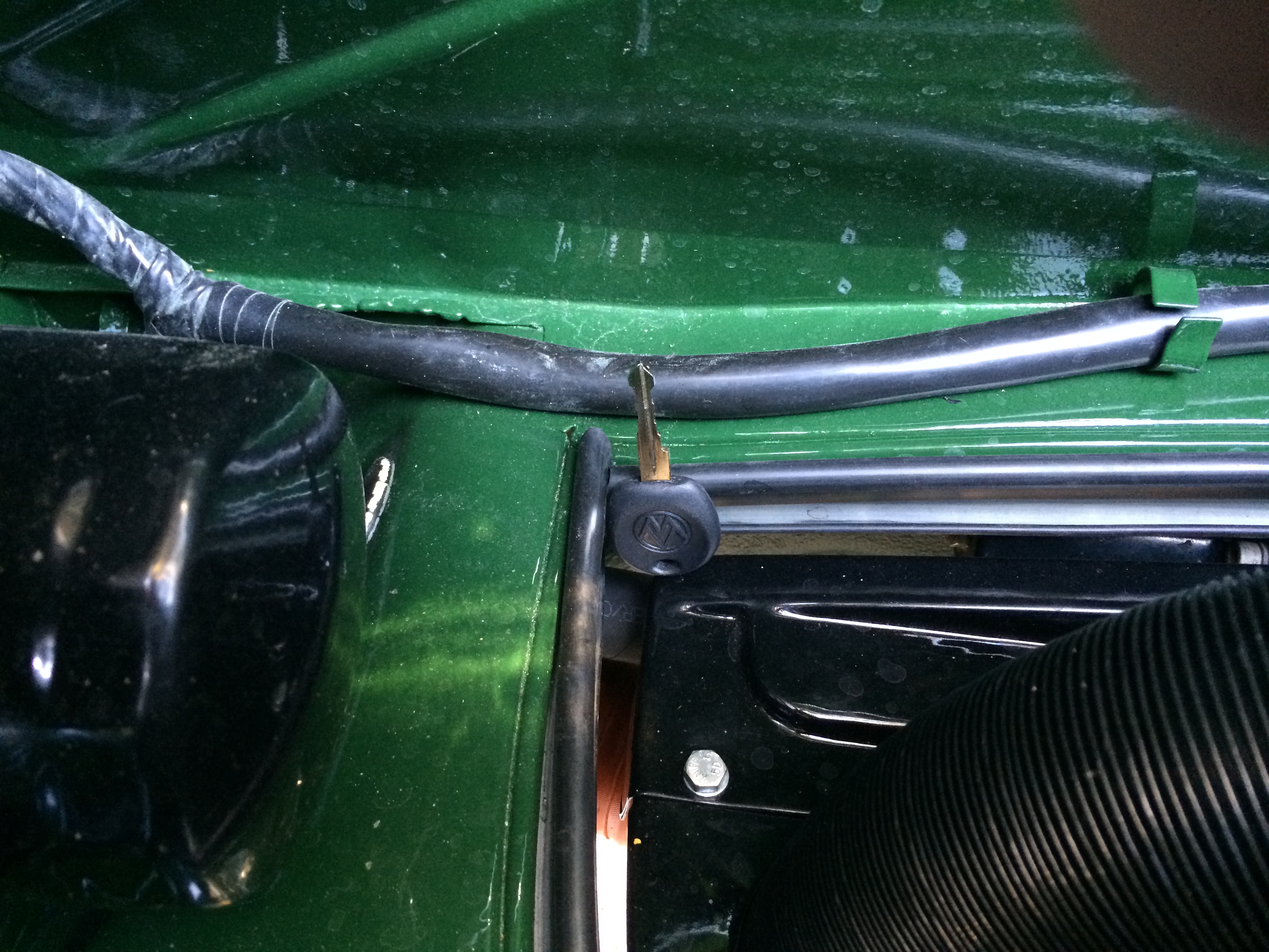

Car is back and has a fully rebuilt 2.0 now. Wow, that was expensive. In general, I've discovered that the less horsepower a Porsche engine makes, the more expensive they are to rebuild. Strange.
Anyways, doesn't it look like the engine is sitting too low?
-Steve

Yep, it's sitting too low, check to see which way the washers for the mount are installed (IMG:style_emoticons/default/confused24.gif)
I think a Porsche engine rebuild is about the same no matter the power. Stock/low HP versions usually use factory bits instead of aftermarket, so that may be the $$.

And some more photos... (before and after)
It's amazing how much faster this stuff happens when I'm not the one doing the work. (IMG:style_emoticons/default/smile.gif)
