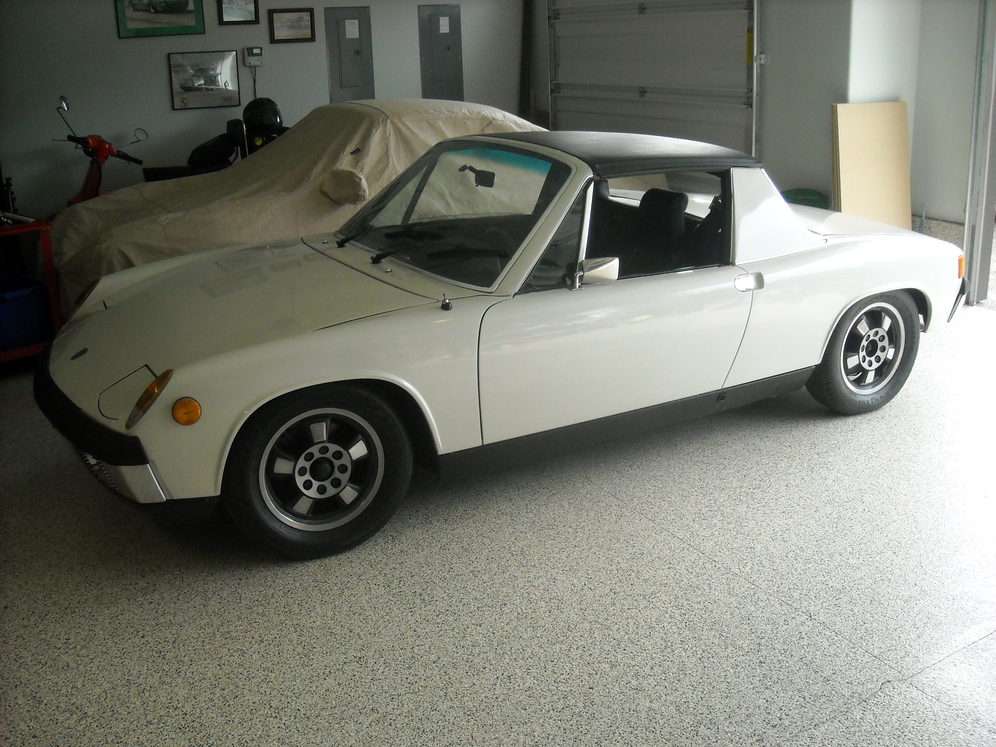

Bought a 71 1.7 liter today.
Car is in relatively good shape as far as I can tell.
Likely some hell hole and rear portion of the back trunk rust repair needed, but appears to be minor.
Time will tell.

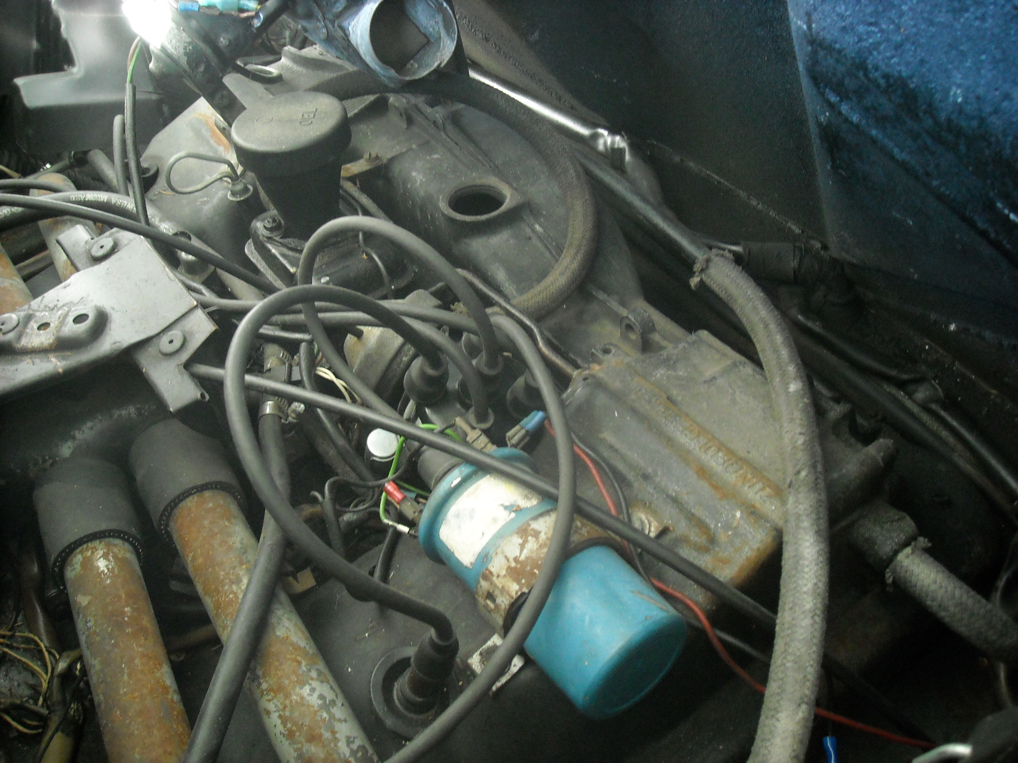

raynekat   Well....starting looking at what I have a little c...   Feb 12 2015, 10:10 PM

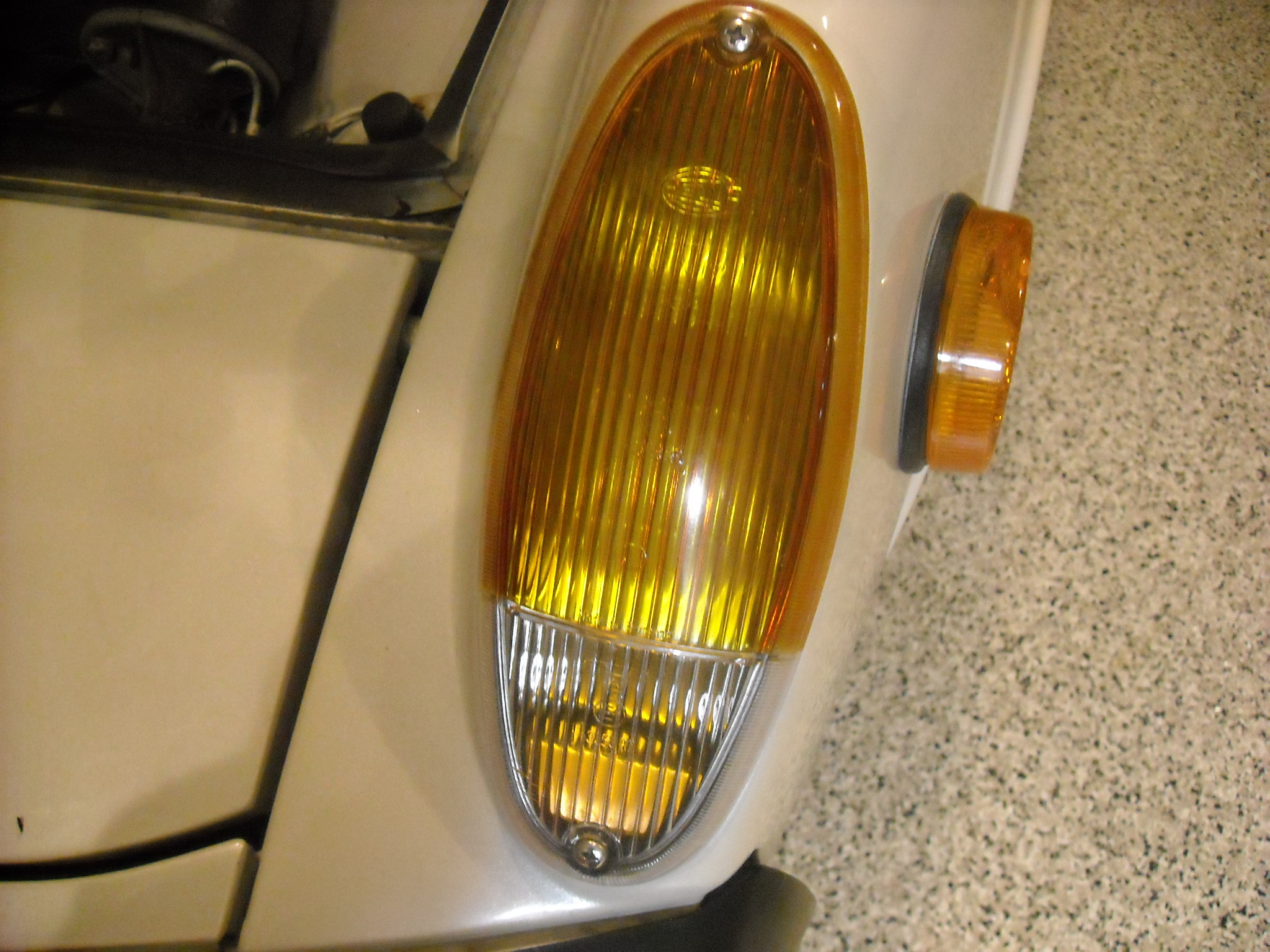

raynekat   You're seeing some of the Euro lens that came ...   Feb 12 2015, 10:12 PM

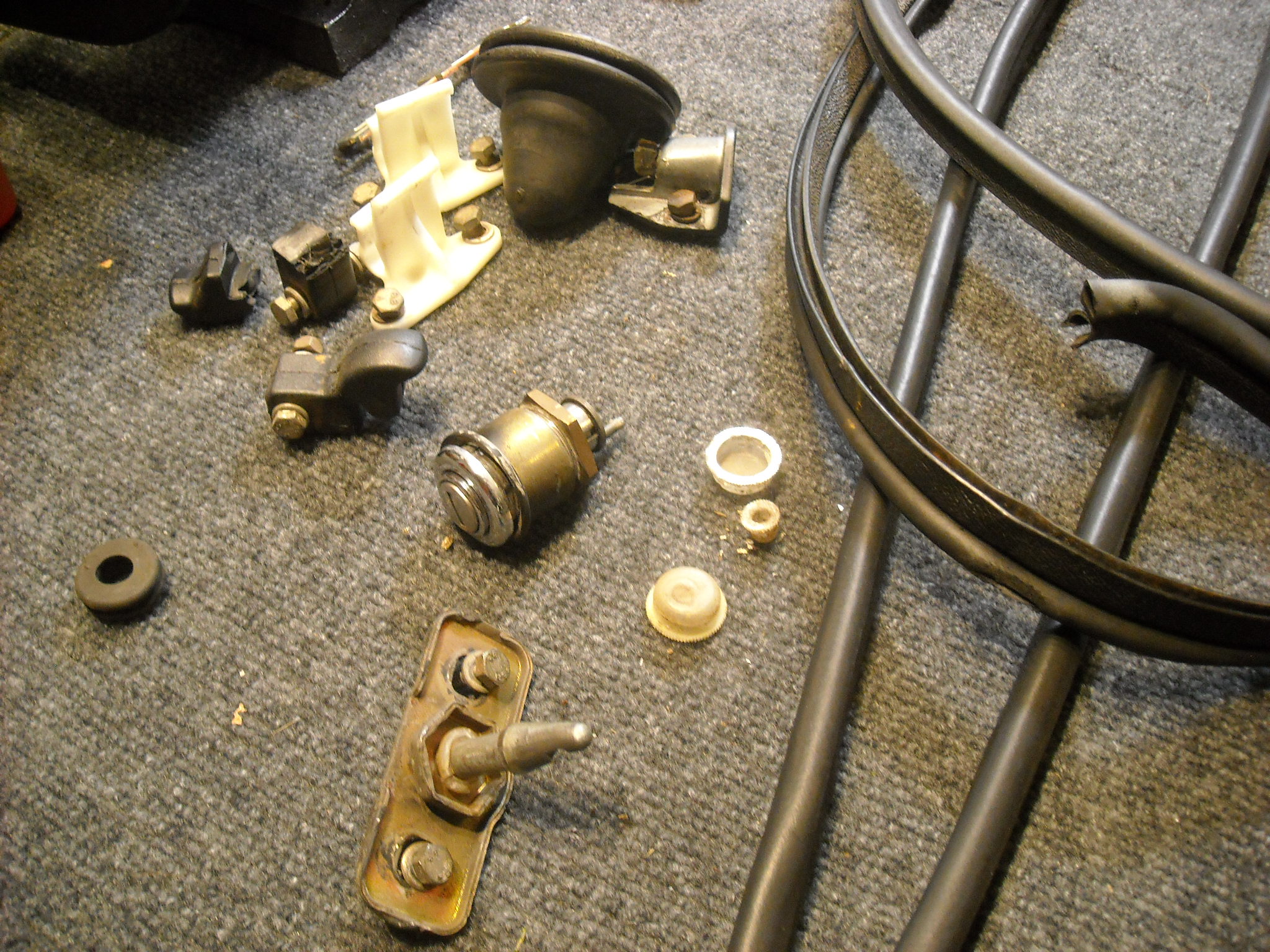

raynekat   So far all the rubber is like Kryptonite....or may...   Feb 12 2015, 10:14 PM

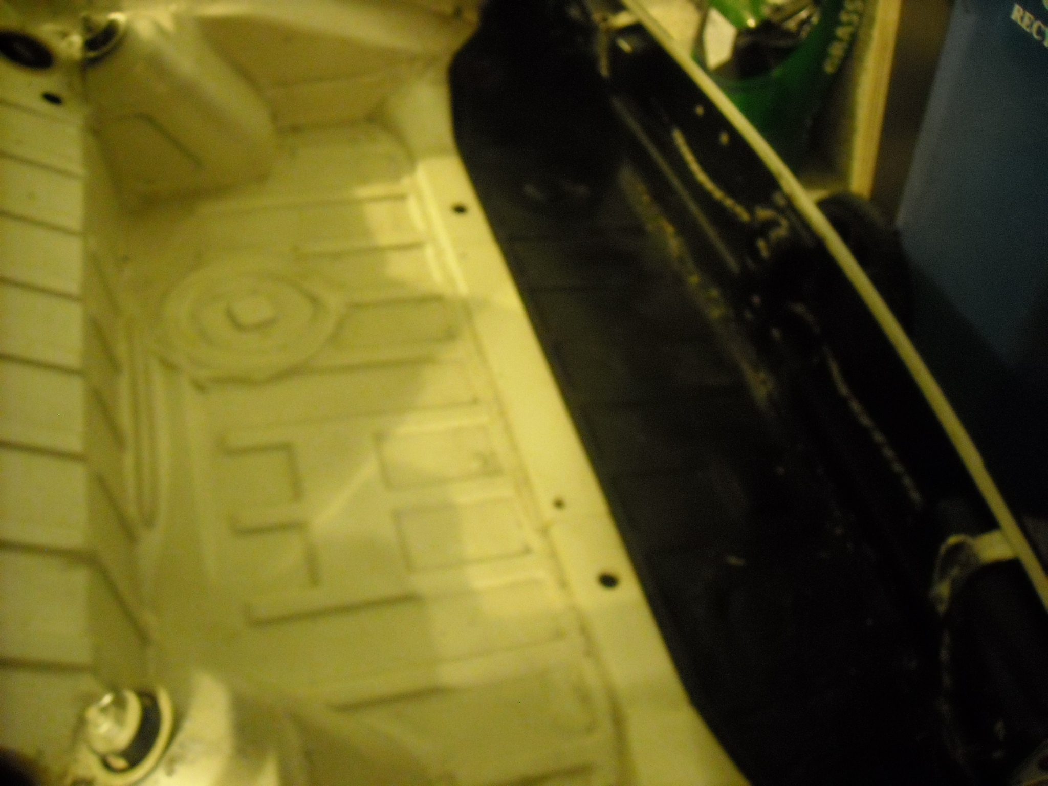

raynekat   Some more pics of the exterior.   Feb 12 2015, 10:22 PM

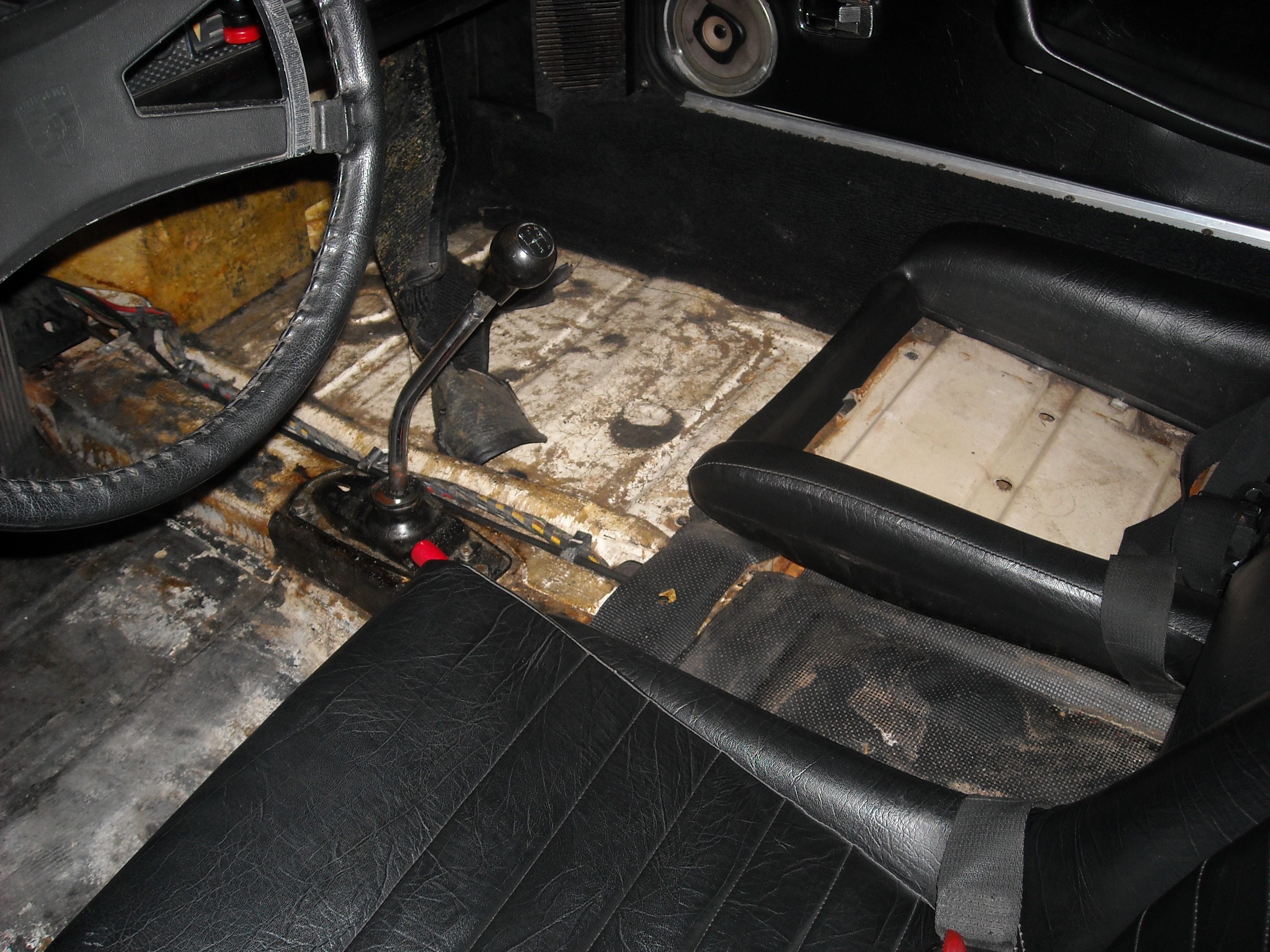

raynekat   Or interior.... Wow....it's difficult to add ...   Feb 12 2015, 10:26 PM
