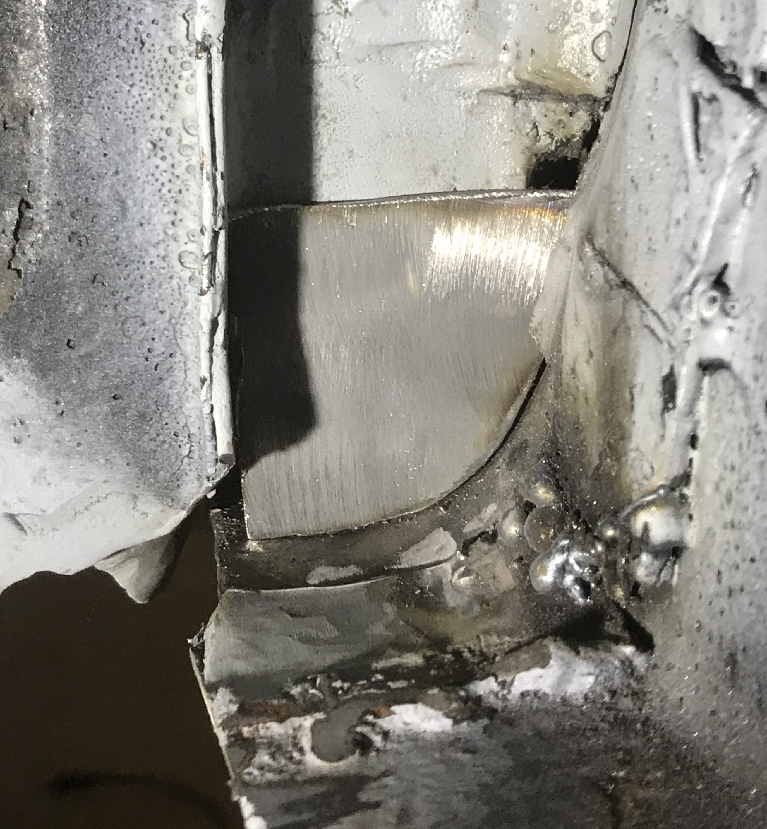

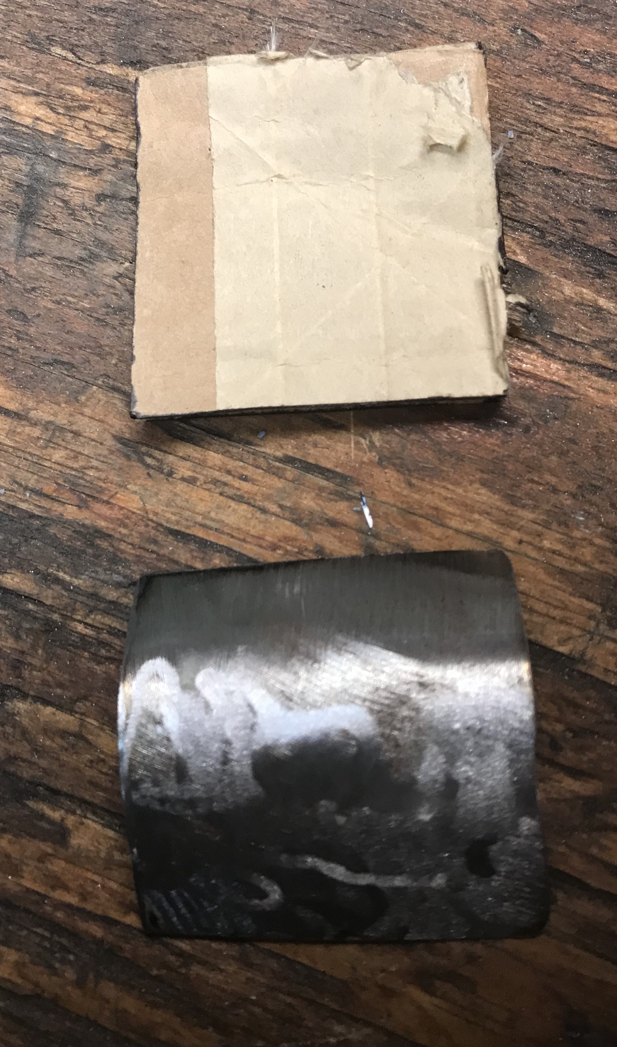

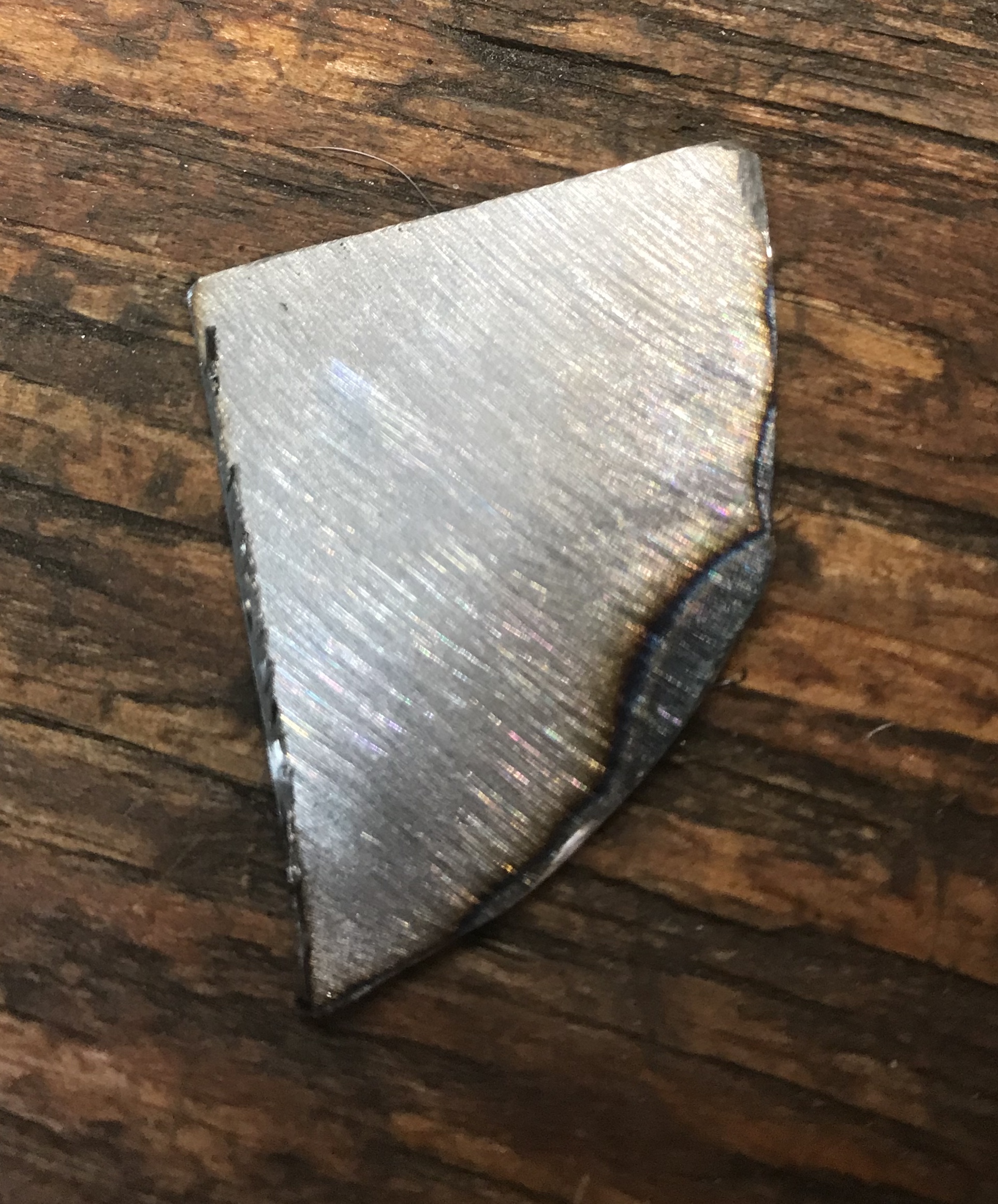

I worked on the front lower left fender today. What a treat this was.

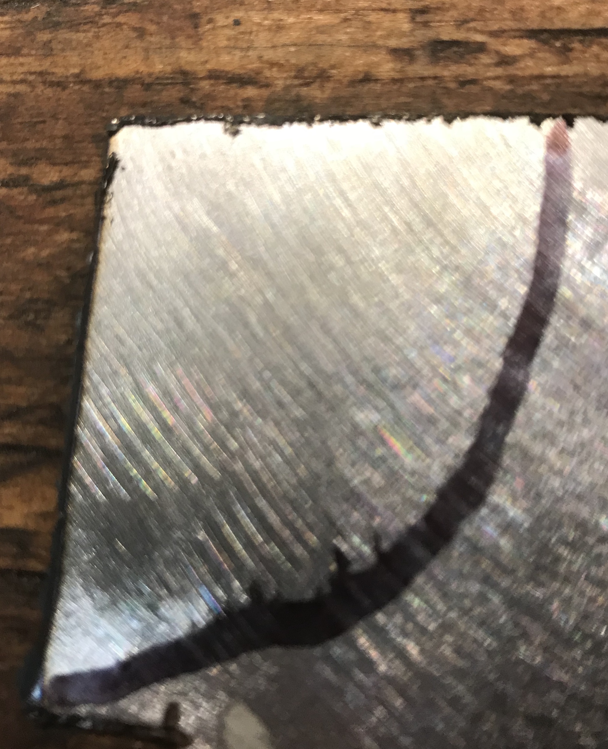

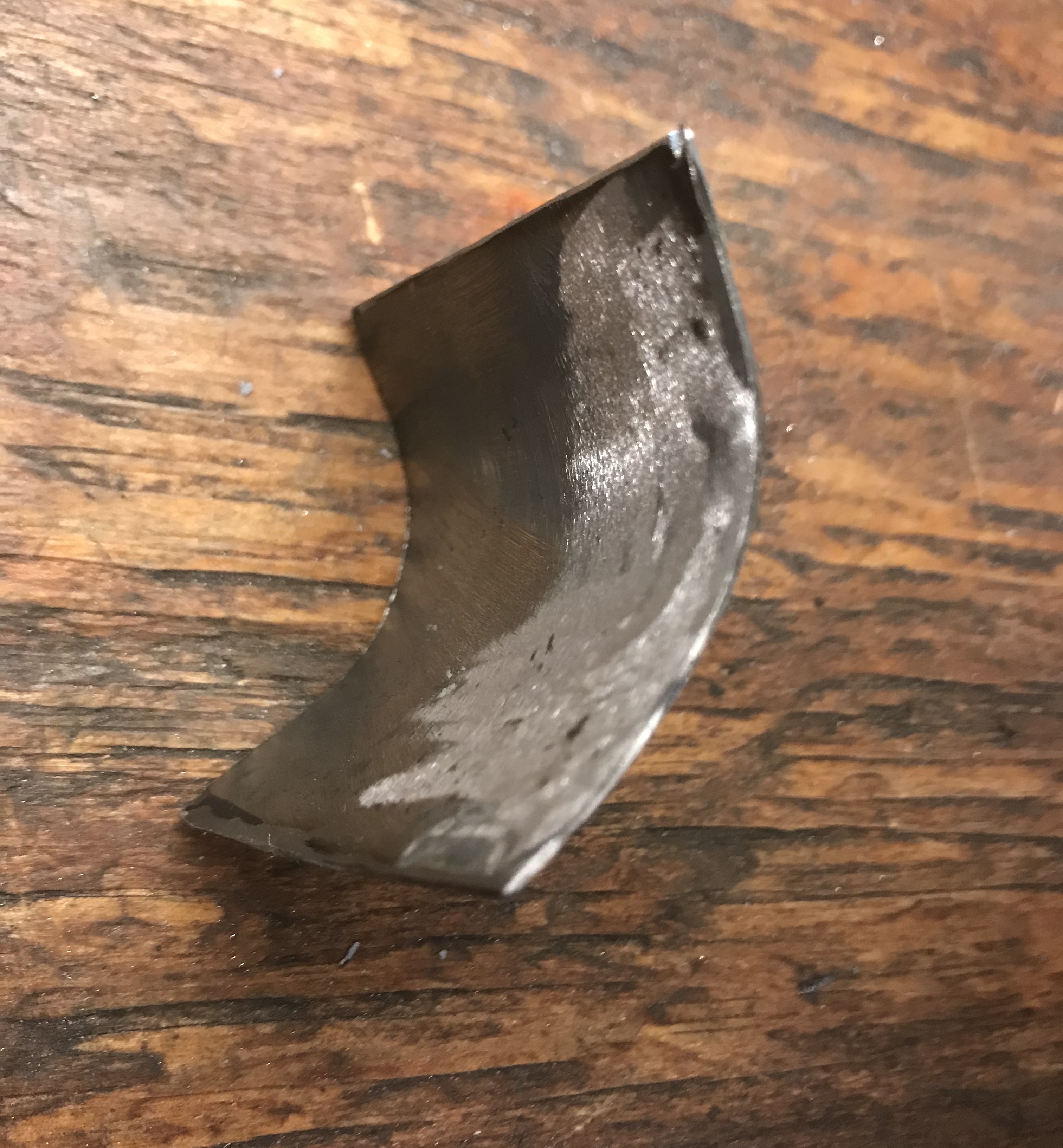

Made some cardboard templates and then cut my shapes.
Bending the one piece was tricky as I don’t have the proper tools for this so
some pipe of different diameters and a vice helped me shape the curve.
Dion

Shapes

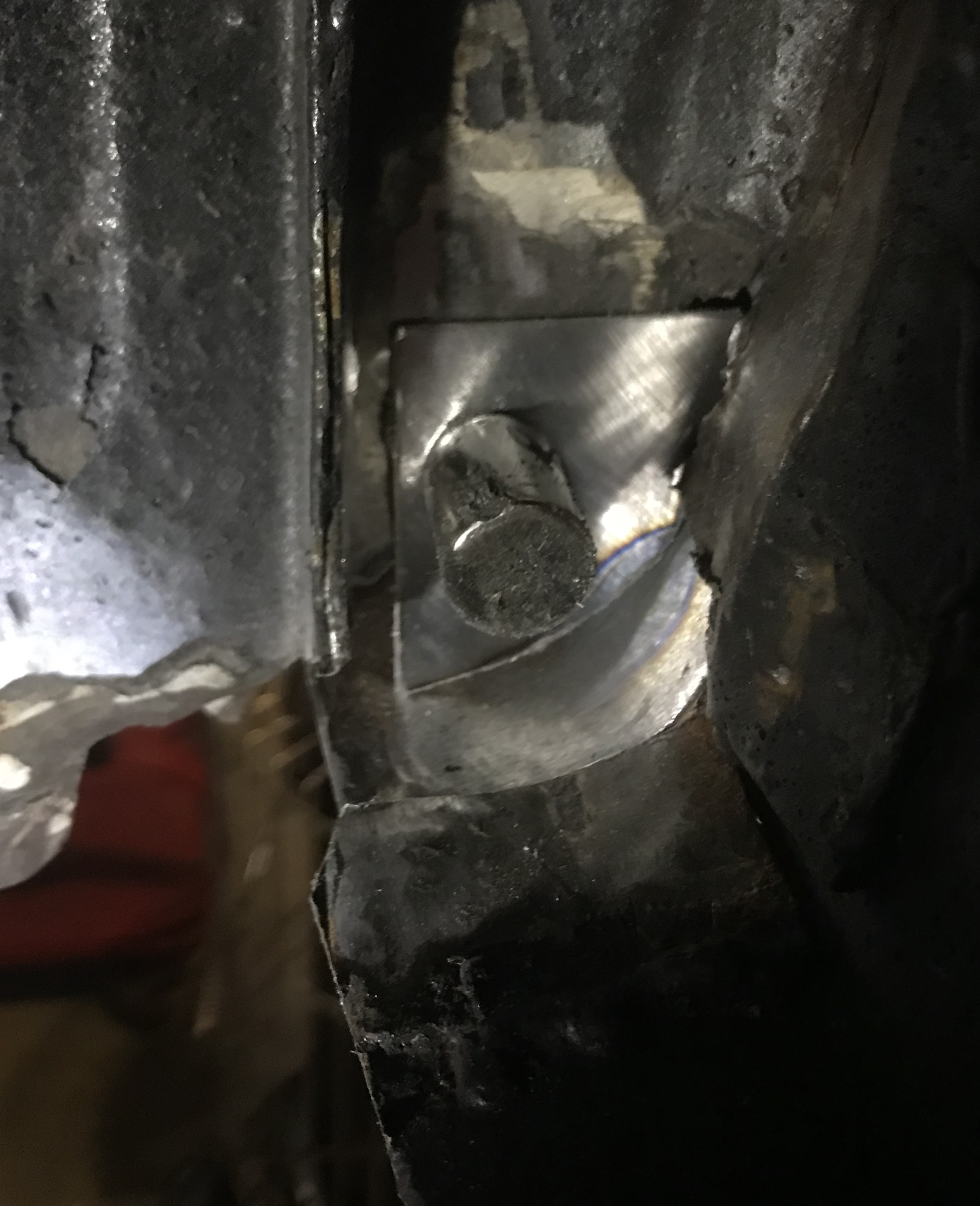

Placement

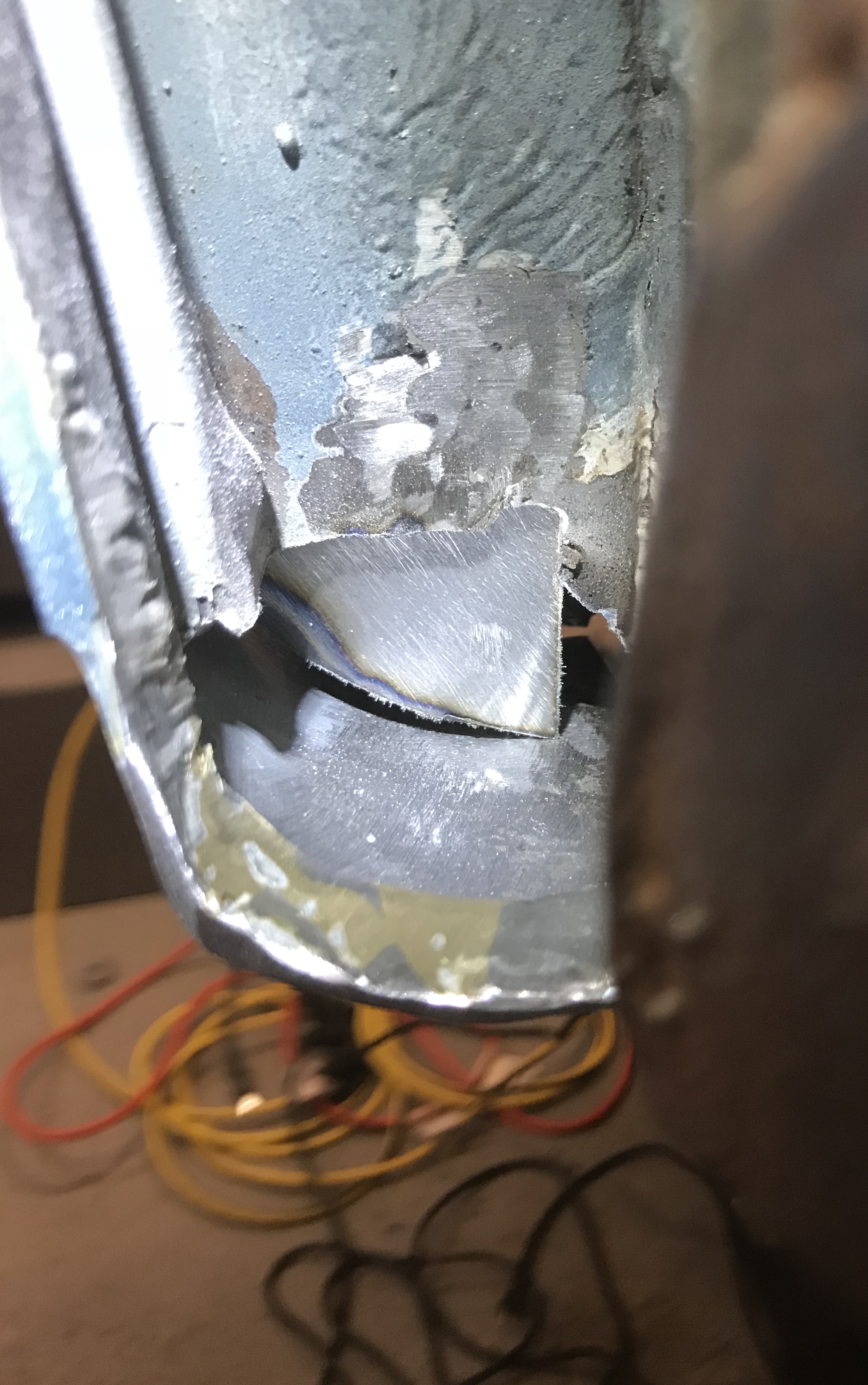

Curved outer piece mounted, welds ground & sanded.

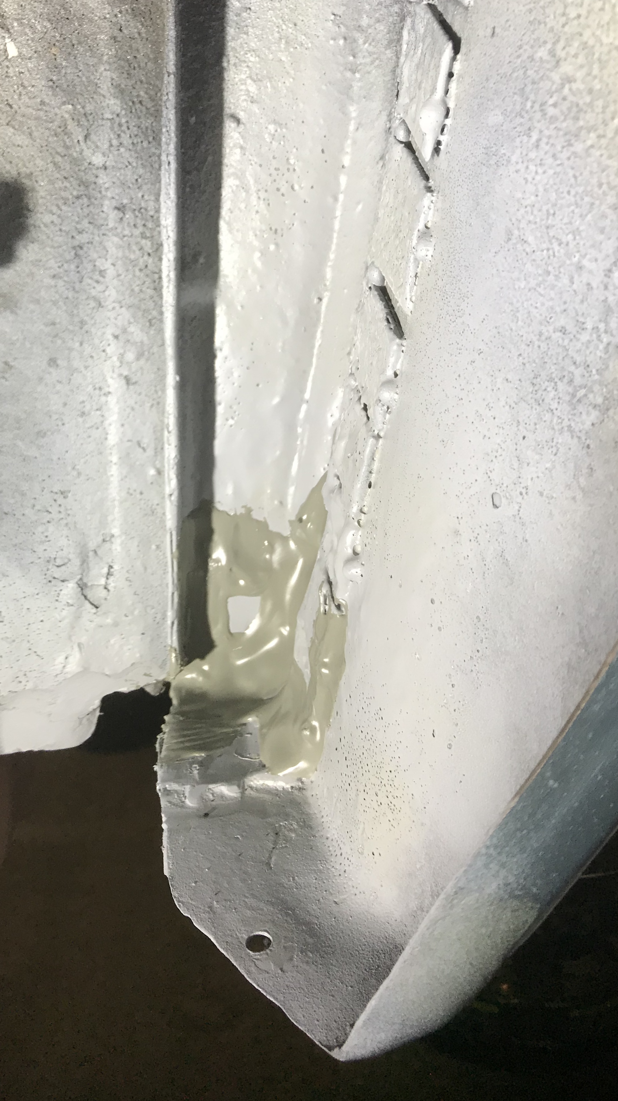

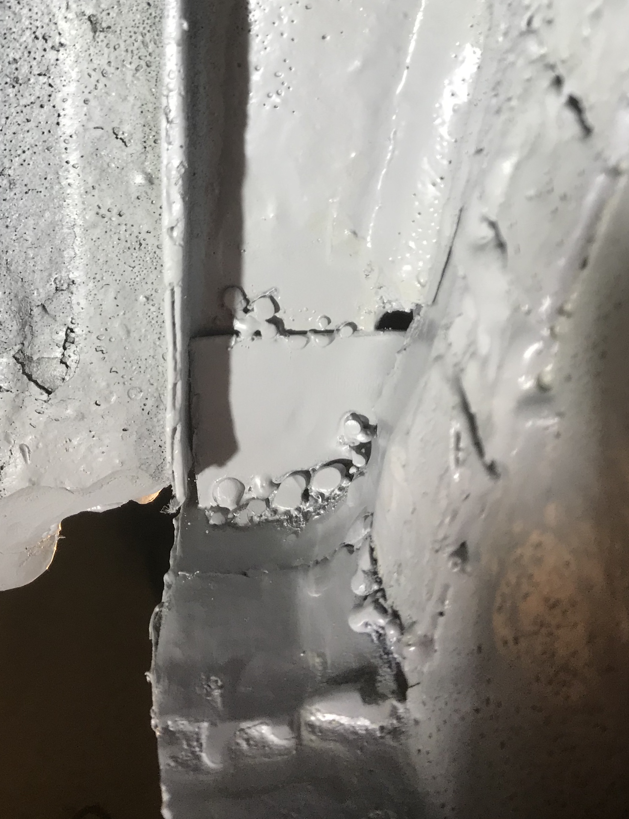

Inside door jamb welded piece. None of my tools for grinding or sanding would fit in this area. So had to rely on primer and sealer to button up. Not the best but weather proofed.

seam seal & primer

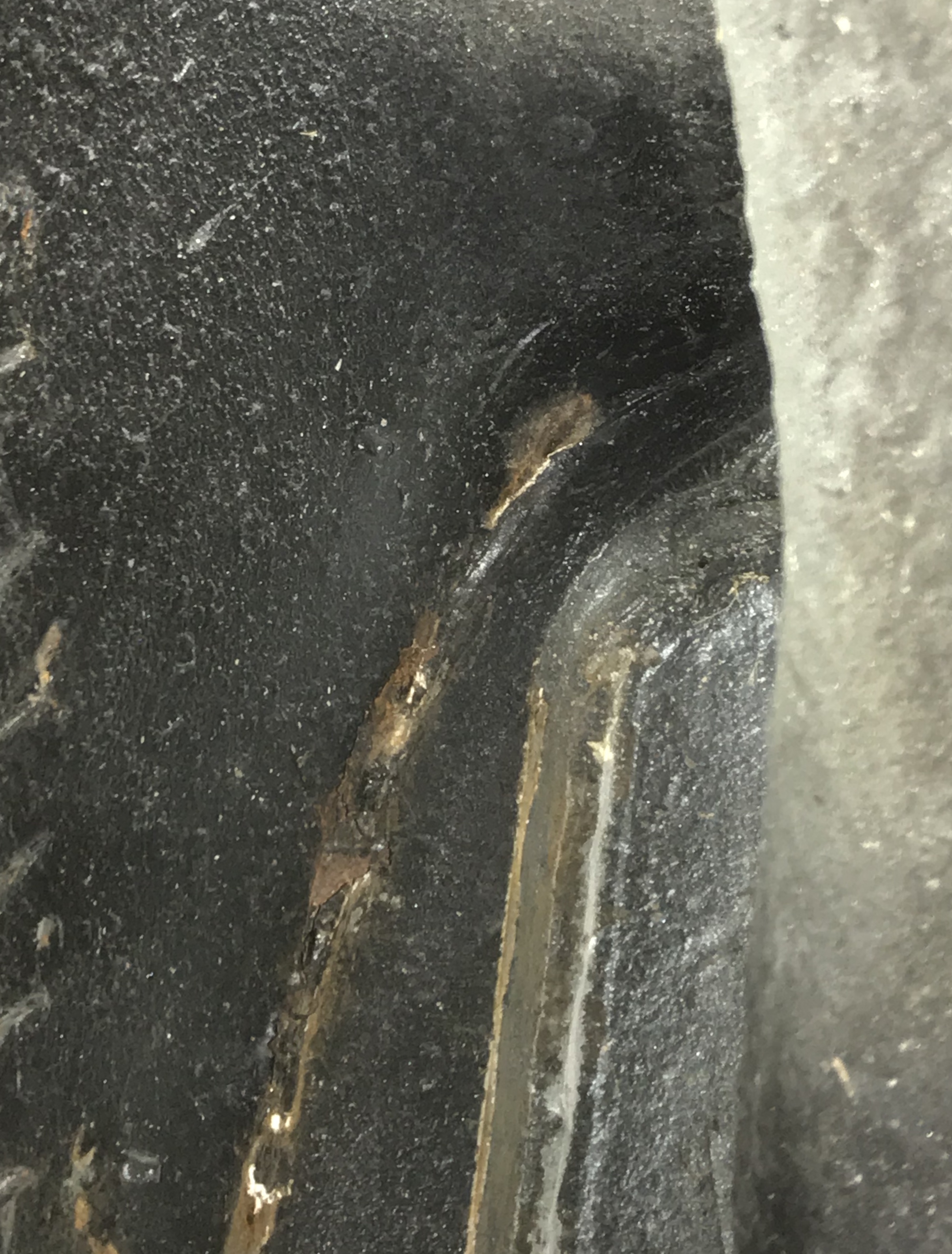

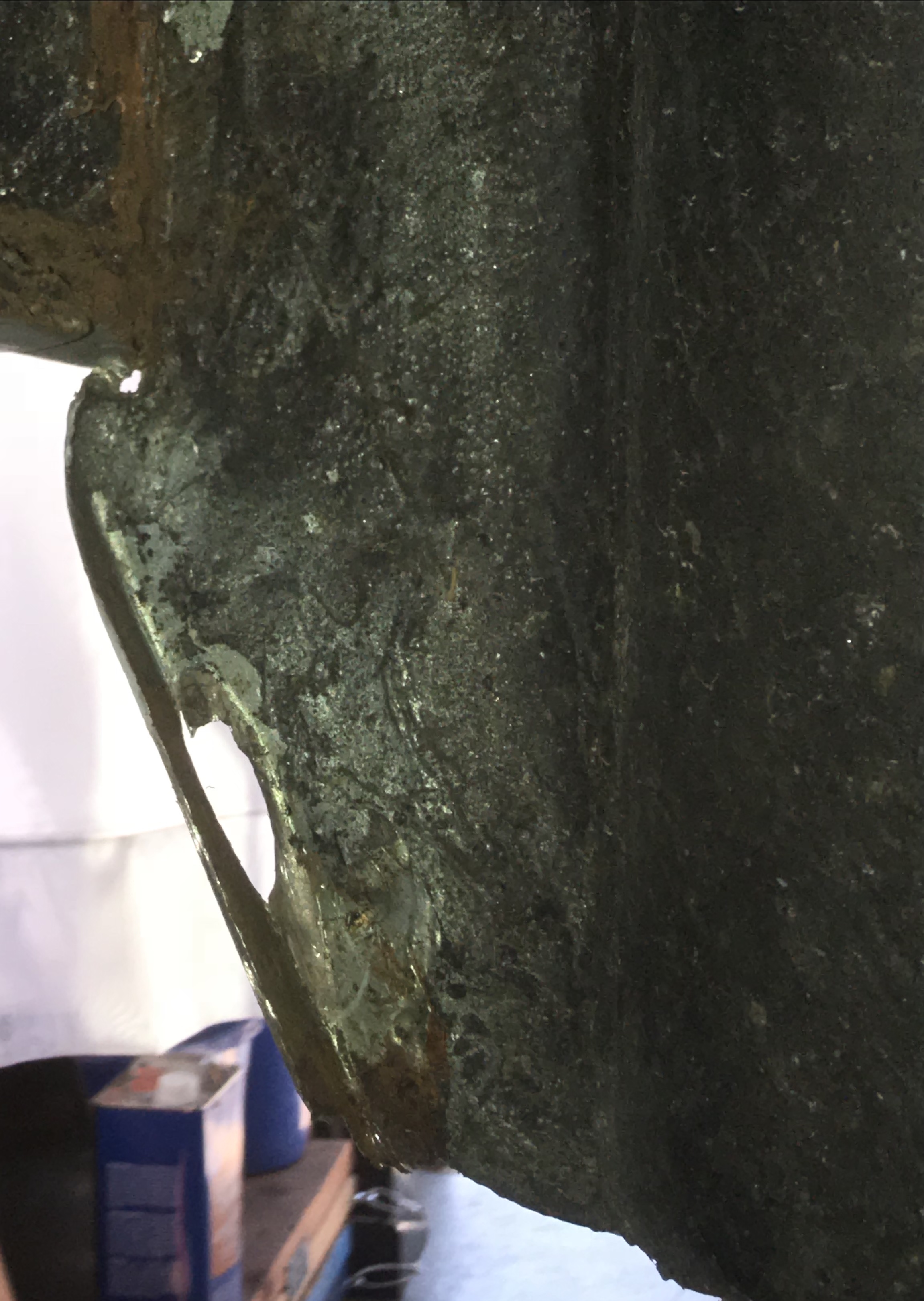

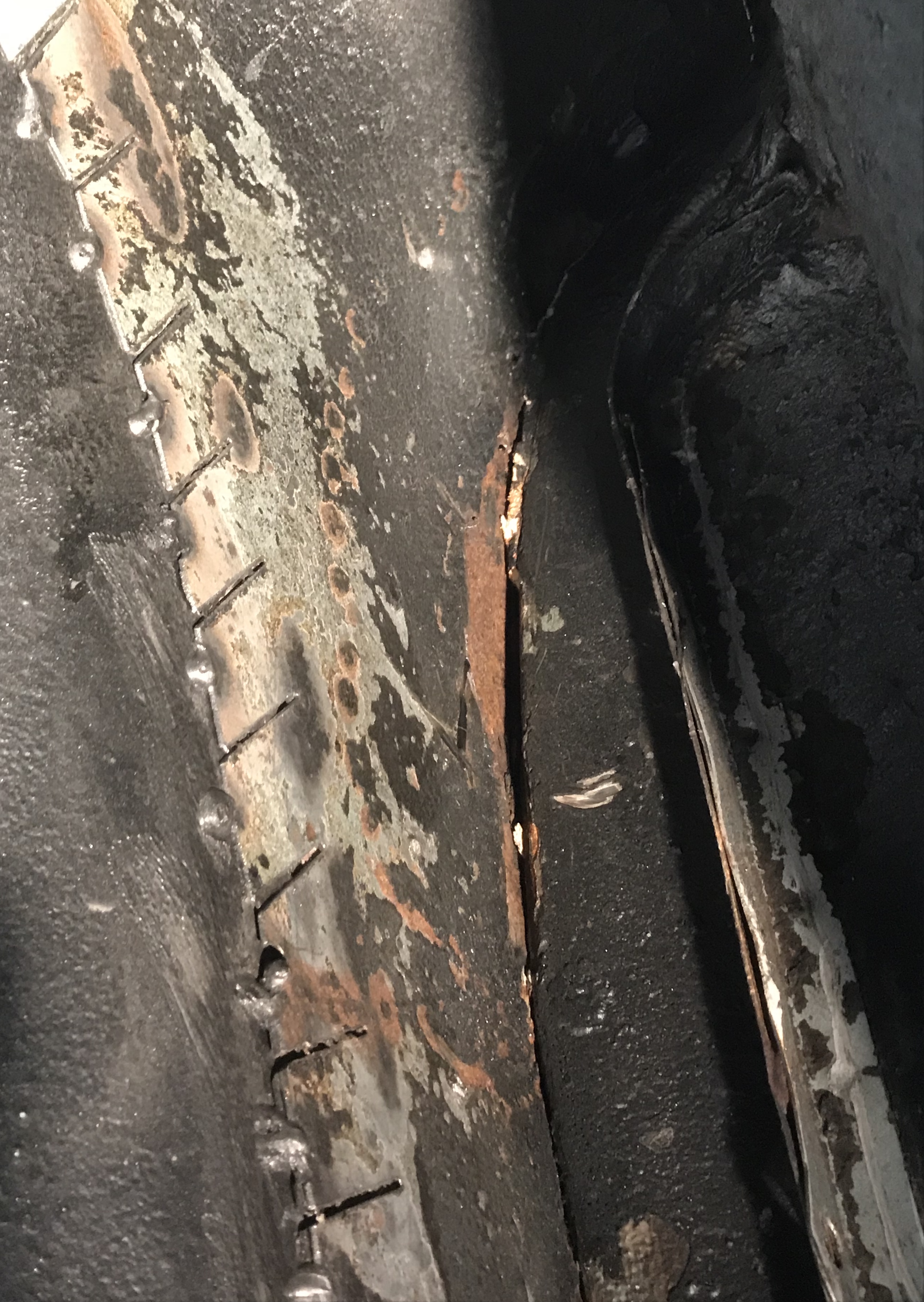

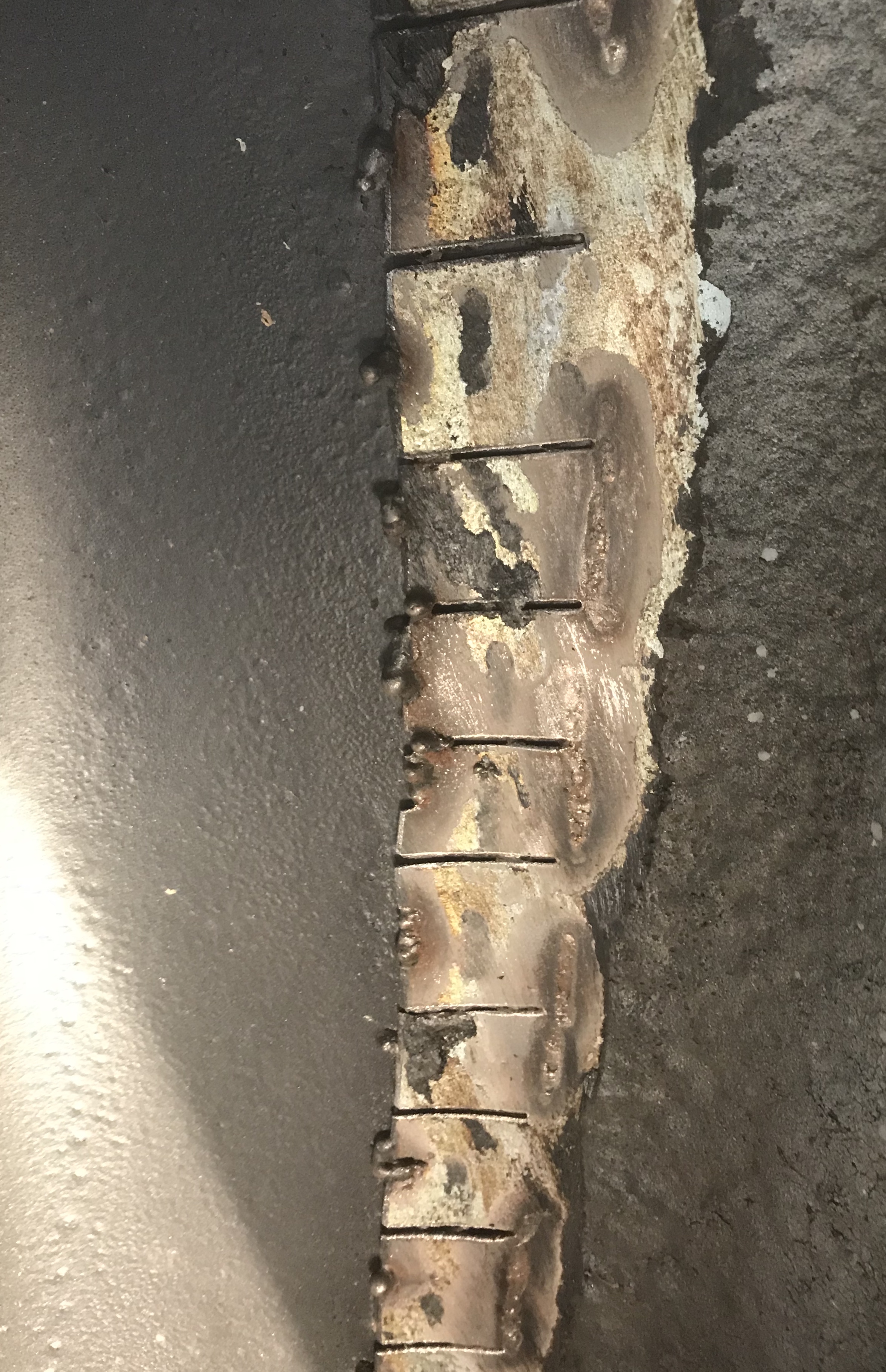

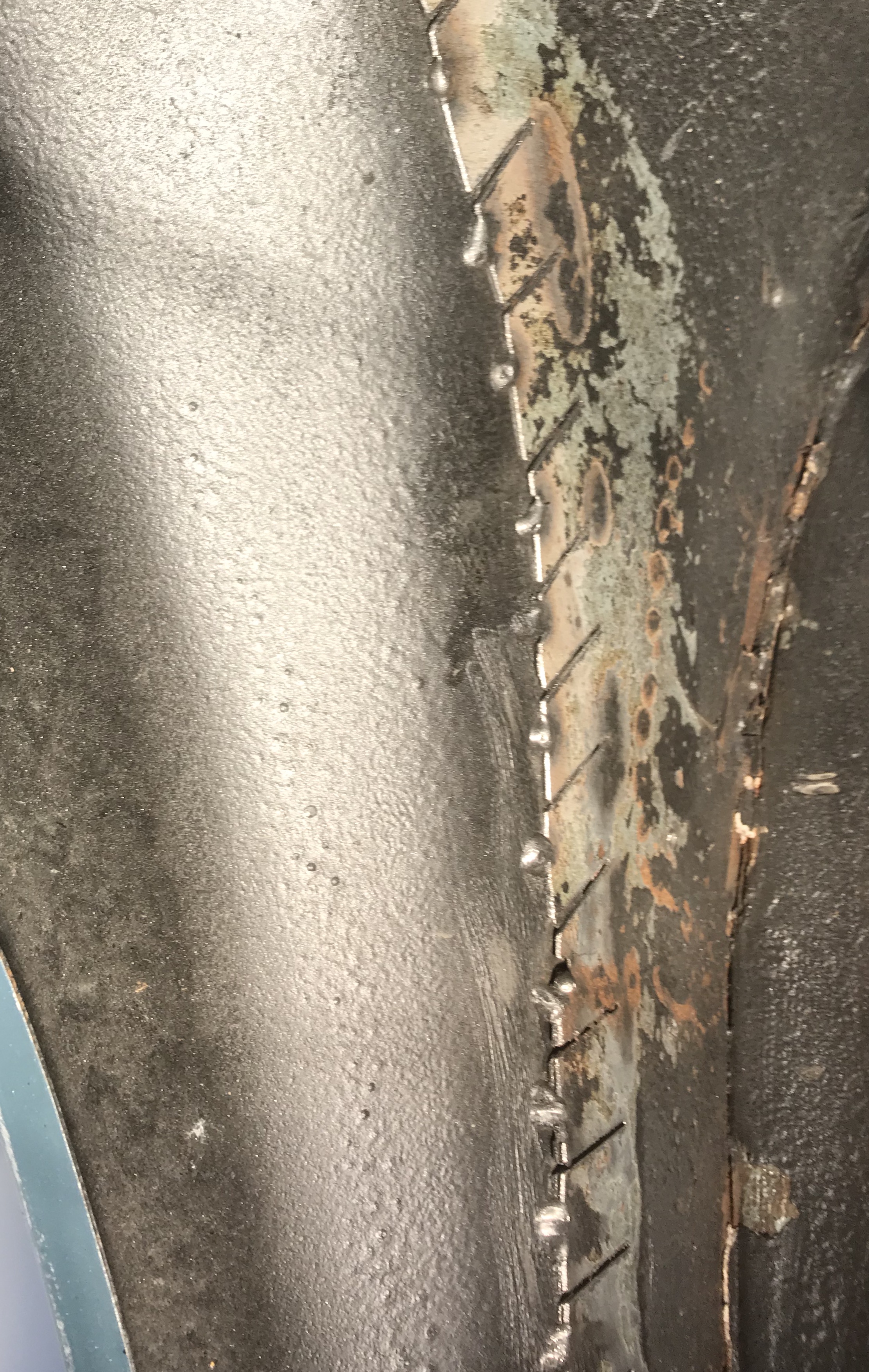

Ok gentlemen need advice. So my flares were welded on, not in the ideal way.
They used an overlap weld instead of butt welds. Removing and starting over is not on the table. Although that’s the ultimate answer. I’d like to prevent further rust. I have some surface rust below the thinly applied undercoating. I wire wheeled off the undercoating. I was thinking of using an acid etch and spraying it in all the seams then
use a rust “encapsulate” type spray and then prime/paint then undercoat.
Any other “ chemical suggestions for getting in those overlapping seams?
Thanks guys.

post Apr 14 2018, 12:23 PM
Post #257
RN
Posts: 2,839
Joined: 16-September 04
From: Audubon,PA
Member No.: 2,766
Seams

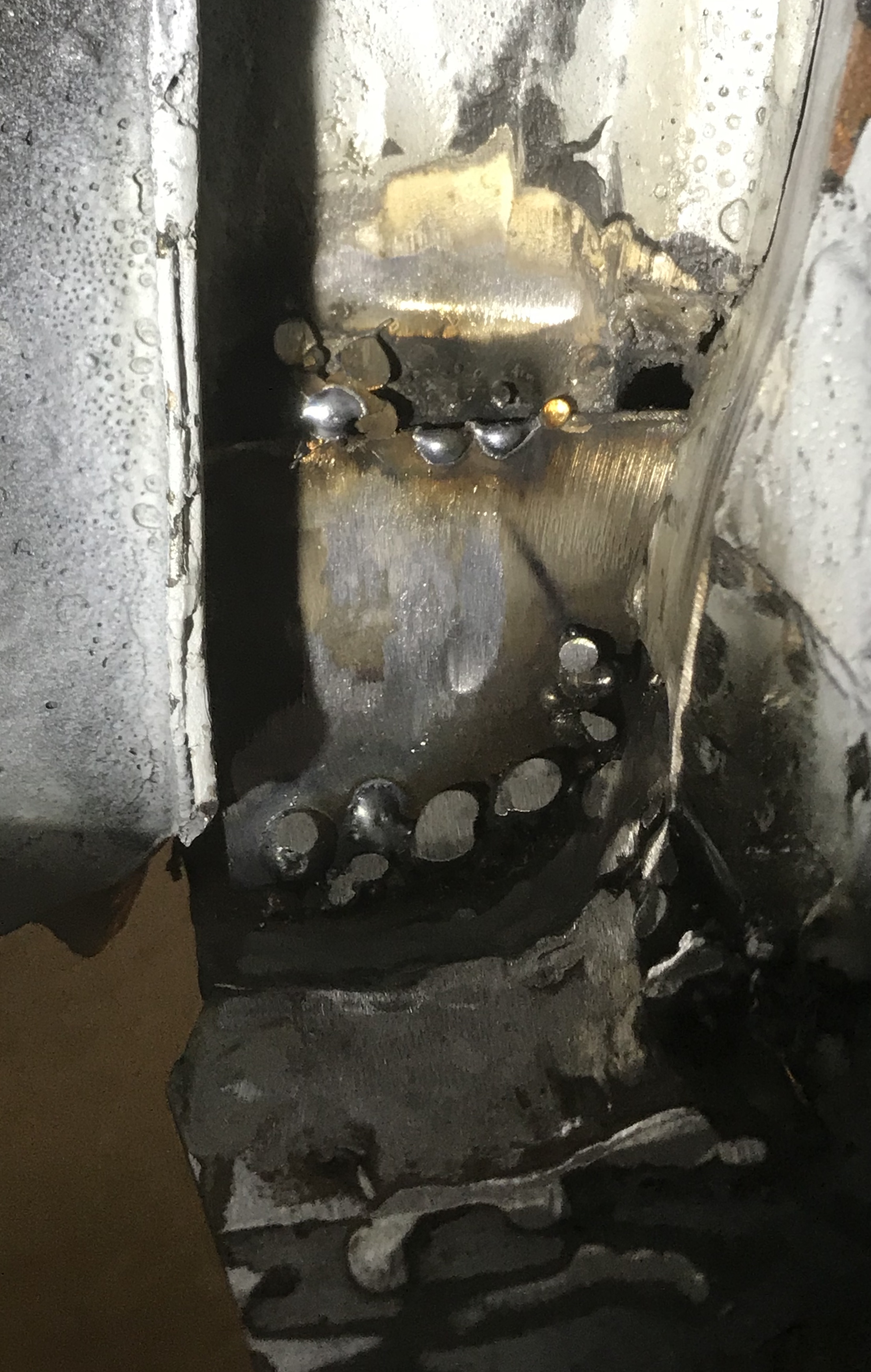

Also need to re do the seam seal on the rear of front fender where it meets chassis.
And a little welding.

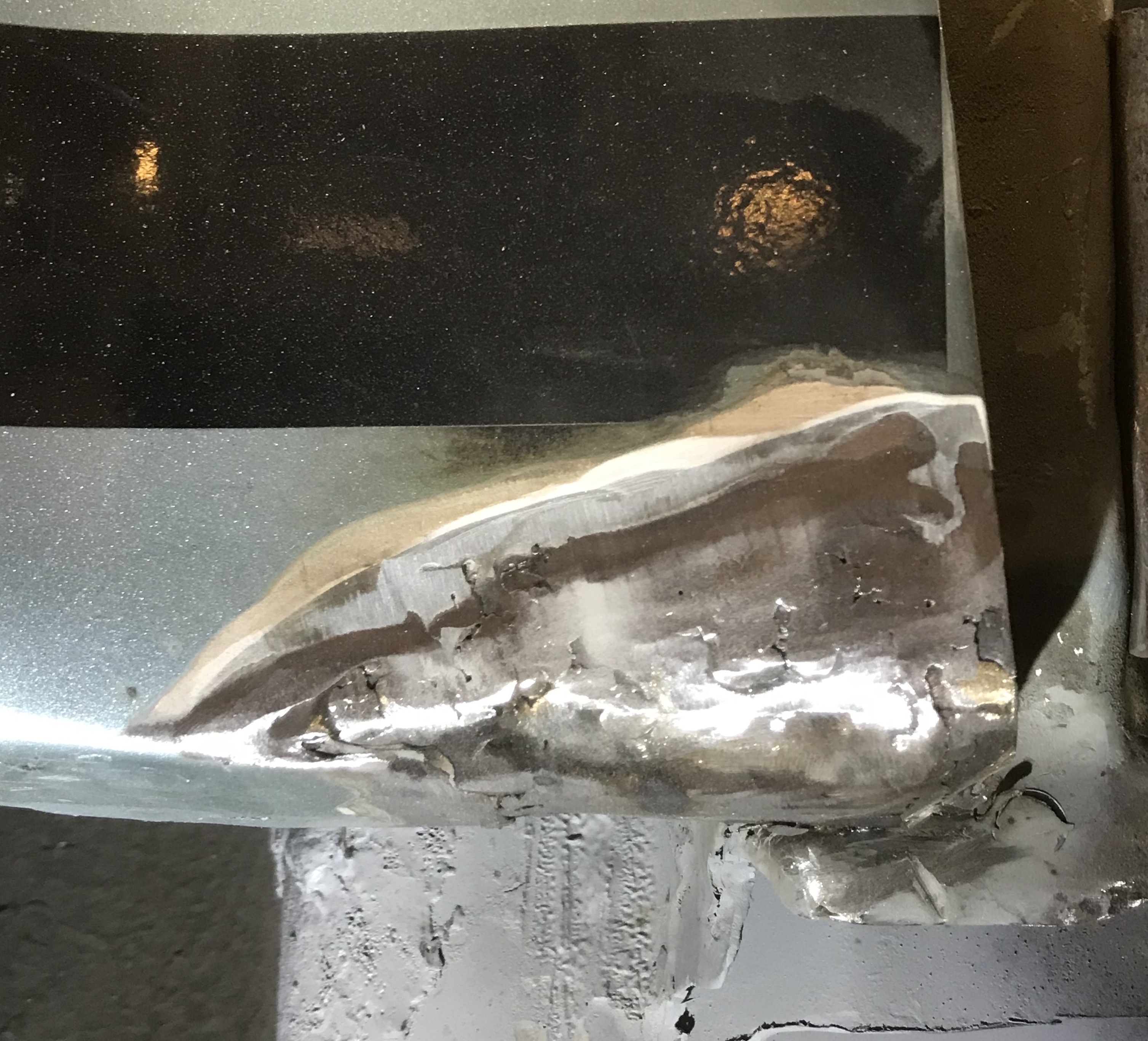

Damage that needs welding up. Lower portion in front of long. Base of front fender.
Dion

So had a suggestion to use the Eastwood Internal Frame coating.
I had that on hand. This stuff creeps into crevices so it made sense.
After washing it down with the “ Fast Etch” and cleanup with pre paint prep,
I hit it with the “frame coating” then coated with rubberized undercoating.
Didn’t get to the welding today. Drying time of the chemicals ate into weld time.
That’s for another weekend. Thanks for looking in!
